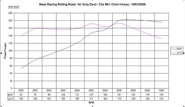

Had my exhaust done today, car is sounding like a monster.
Had the following mod's done so far...
(Car was originally running at 166bhp)
Inlet Manifold work @ GDI
De-cat (silenced)
SMT6 Ecu @ GDI
Here's the results... (rr-1.jpg)
Max Power: 182bhp
Max Torque: 173 lb.ft
That was with the stock IK and stock exhaust.

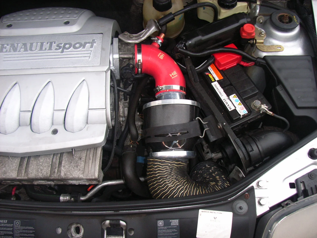

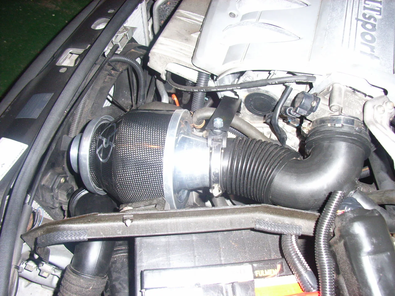

I have since replaced the IK with a Viper (viper.jpg) and had a Power Flow (silenced) stainless steel de-cat back exhaust. I've still got to take off the original air feed's, just not had time. The exhaust is still loud even though everything is meant to be silenced. Sounds good though. Pictures are poor quality of exhaust as was took on mobile and not digi camera.

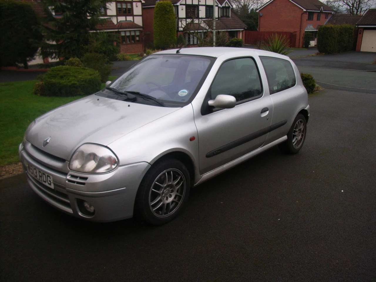

Apologies for the car looking so dirty.

This is without the hill-power bend on, anyone prefer the stock black one?

Have you still got the two air feeds to what was the original box?
As you've got a 100mm feed to the viper, i used to put both of the standard feeds in to the 1 viper feed, if that makes sense.
yeah you have.
if you take the plastic ends off, you can get the original feeds into the viper feed, direct air flow then mate.
To ge tthe plastic bits off, you need to look for, what can only be described as staples, you'll need to prise them out with pliers.
