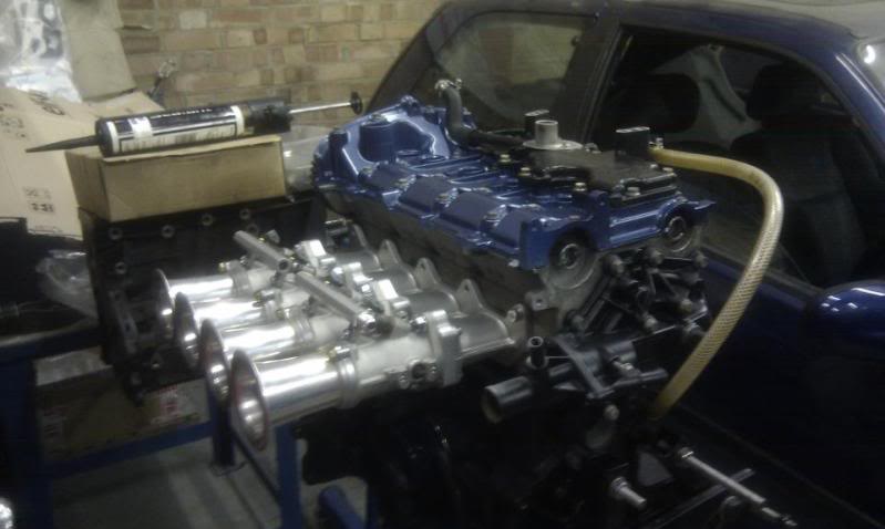

bought a Clio 172 MK2 2nd hand a couple of years ago and about 3 months ago we decided to do a rather strange project on it, namely add the throttle bodies from a BMW M3 E36 :)
After a bit of work and redoing the positioning of various elements like the power steering pump, doing a custom flange between the TB and the block etc. we ended up with the throttle bodies + M3 E36 injectors + stand alone ECU + etc. all up and running. Hurray! :D (I don't have pictures at hand right now, unfortunately, will post some).

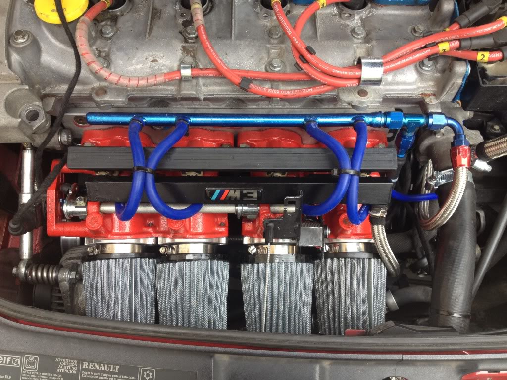

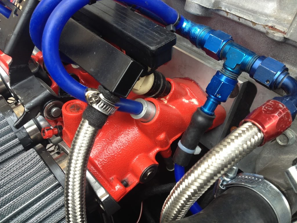

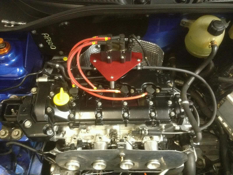

Hi Cr33do,
just before going to work I snapped a couple of pictures of the thingie. Here they are:

Lack of trumpets and lack of length are the most obvious problems just by looking at it, cant really comment on interntal turbulence etc as you havent put any pics of it from the inside.
Shame its not working well as it actually looks a nice install.

The question above about the manifold you have answered with your pictures, as basically there isnt one, just a flange.
