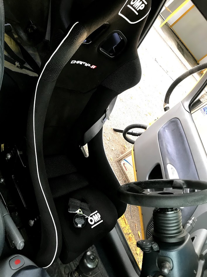

After a first few track sesions, like everyone, I realized the seats are s**t, and so is the driving position, and the steering wheel, so that was taken care of:

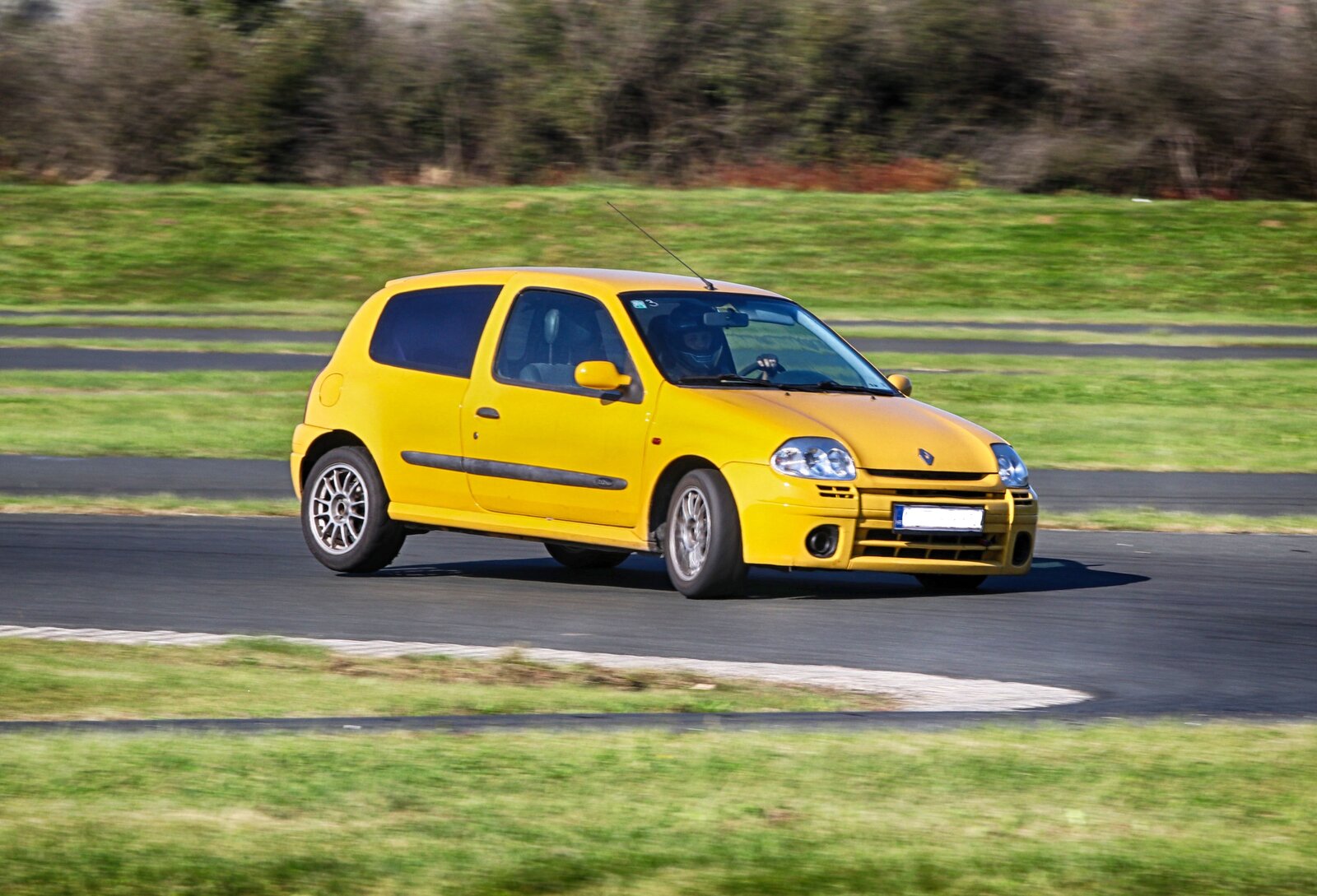

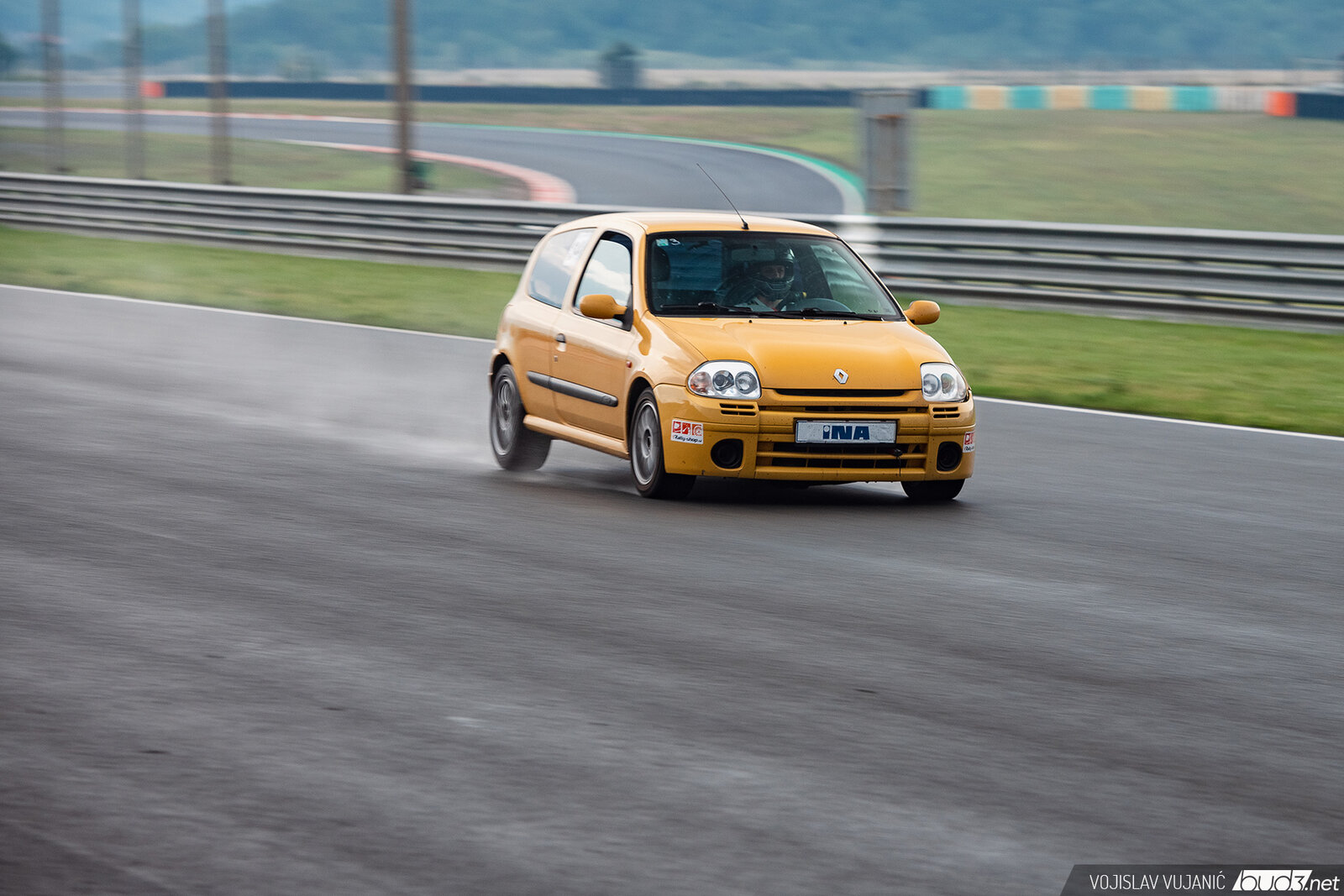

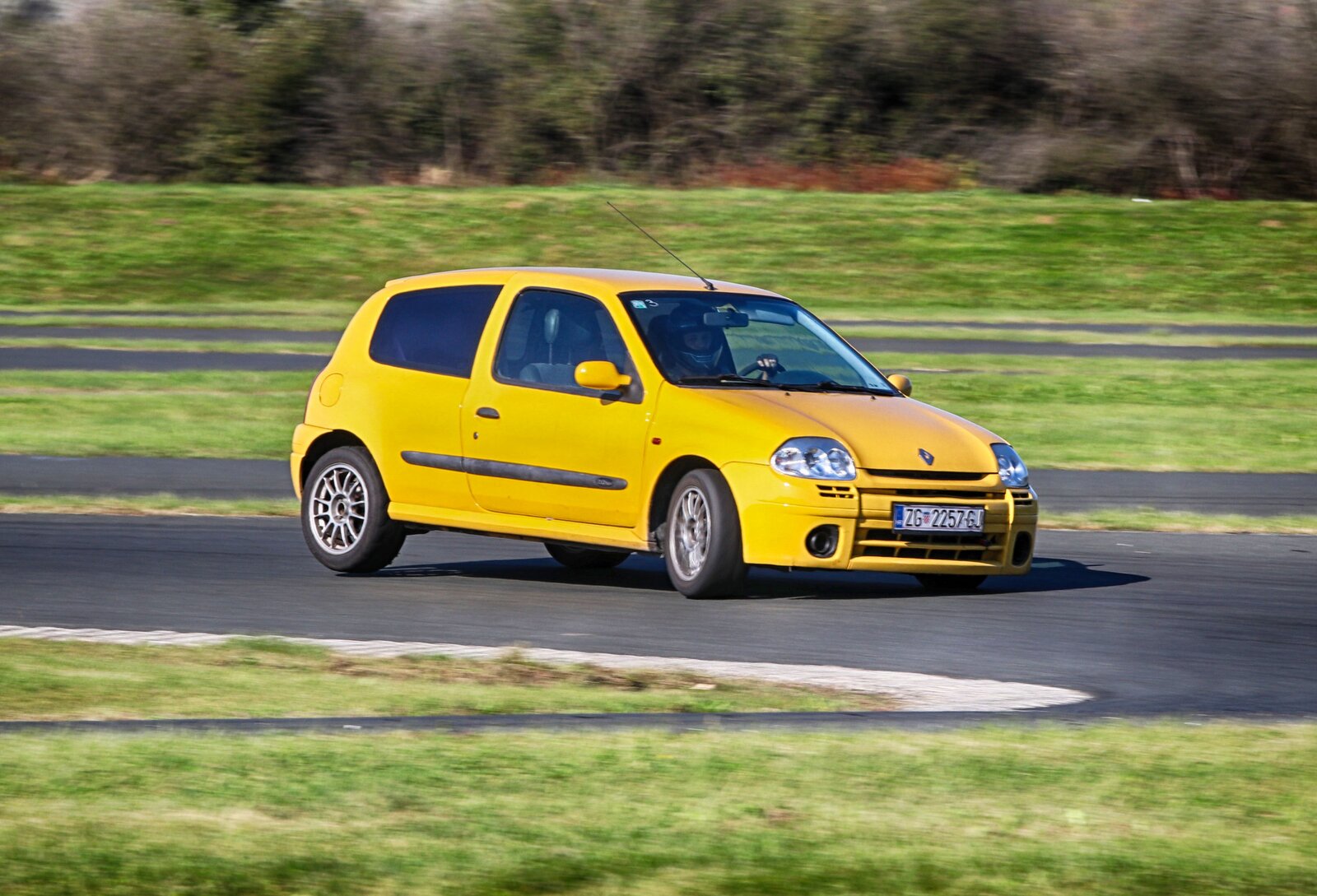

The car was on several trackdays as seen on the pictures. There is quite a bit of body roll when fitted with semislick tires like the r888r, but still the car handles great.

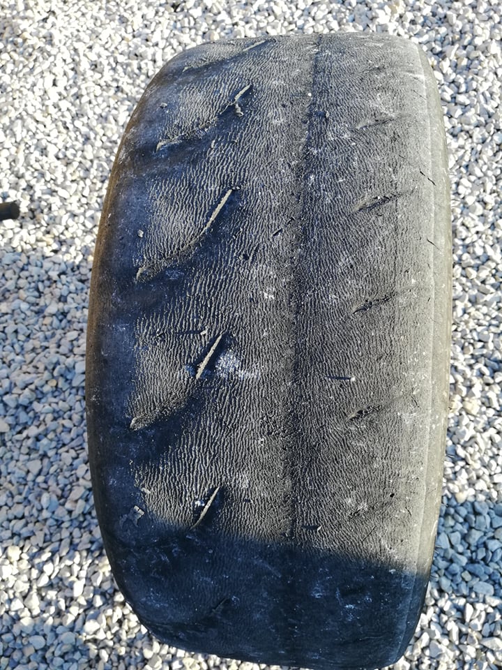

Front tires after use :ROFLMAO:, maybe I was overdriving the car a bit.
