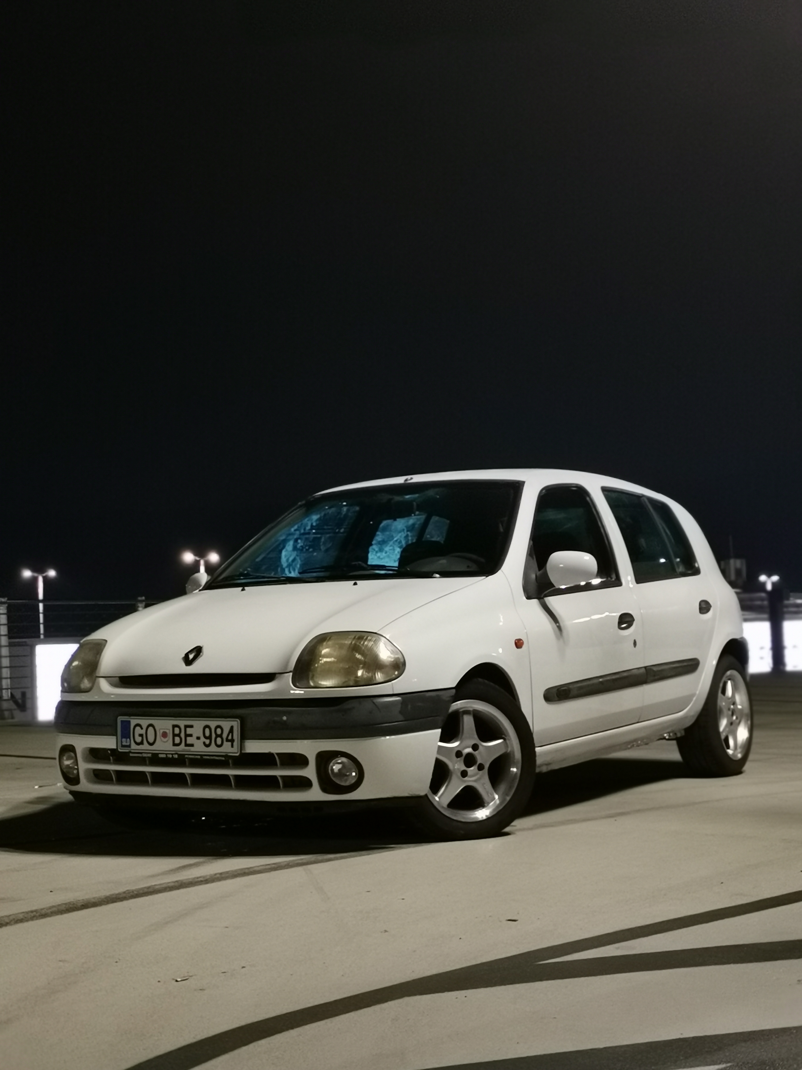

Hello. Recently i bought clio 1.6 8V rxe and I love it. It shows 150k kms and overall condition is not so bad. I also have some allu rims on it. I was thinking of having it as a project for winter/next year. Im thinking of ph1 172 look. I wonder if I can install bumper from clio 172 ph1 on my clio. If yes mby if you can tell me where can I get such bumper and if there will be some problems with homologation in Europe. Thanks for any info😁

To fit the 172 bumper you'll need the front wings as they are flared and wider, which means you pretty much need the skirts too, as they fit on the bottoms of the wings. Not sure if the skirts will fit the same on a 5 door, but they probably do? You need a full ph1 sport kit basically, means it'll need painting to match too.
Plenty of sport conversions been done, be worth having a search around.

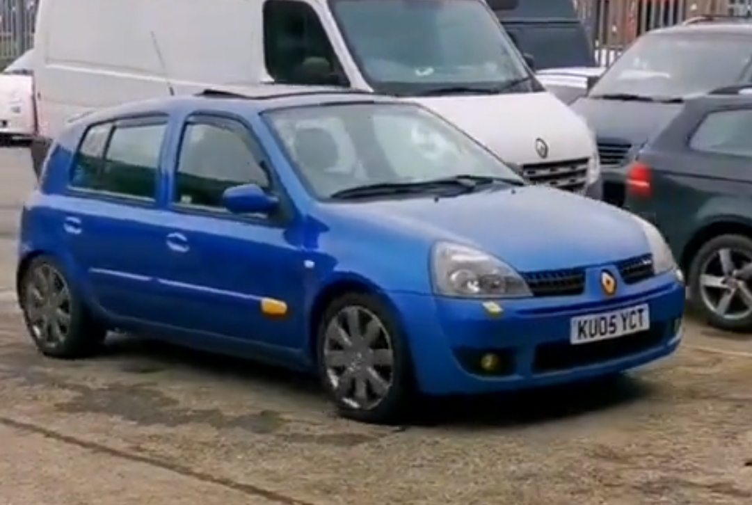

This is the car I’m thinking of, doesn’t have sport skirts so I’m sure where the wings and skirts are supposed to join will look strange. Arch liners will also be tricky, mainly because they’re close to unobtainium.

Hmm does this have the F4R in it? Also if it does then not only is it a 5-door 172, but it's a 172 with a sunroof! (I know it's not good for the centre of mass but it's cool)

Not my car, so can't say unfortunately, but I don't think it's been F4R swapped.
I think most of our non-sport mk2 Clios here were sunroof models, I had one on mine, they're not that great to be honest, love to leak and don't open very far.
