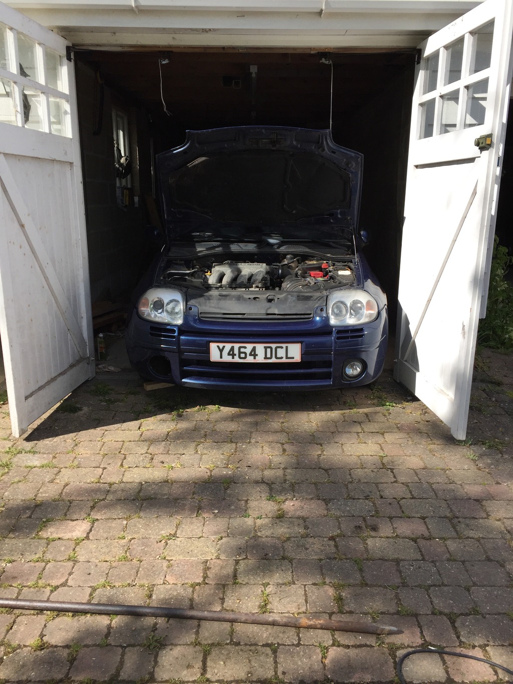

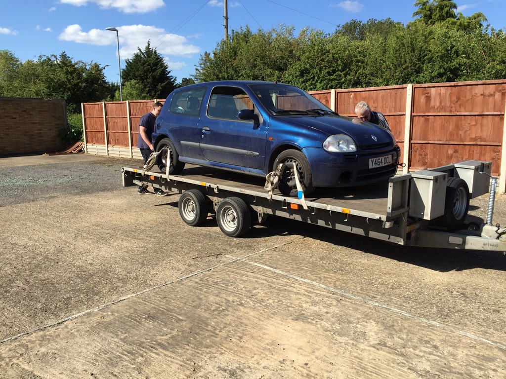

Now I went on a trip with a friend to pick up some freshly rebuilt bbs rms in Cambridge at the weekend and as we were talking with the bloke who done it I said I was looking for a 172 and he said his friend had a broken one , I said I'd love to look at it and 15 mins later I was handing over the cash and bringing it home with me , now it's a ph1 obviously in odyssey blue , correct me if I'm wrong, done 126k and although it looks rough isn't actually too bad bodywork wise , nothing a bit of pdr and my trusty polisher can't sort
£230 it was the car cost me

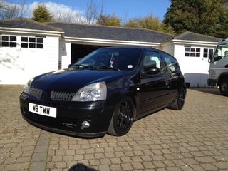

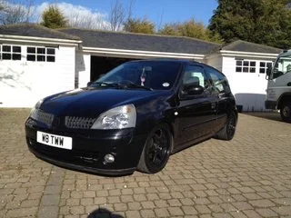

Thanks , no build thread was my first car but have a few pictures I'll post a couple

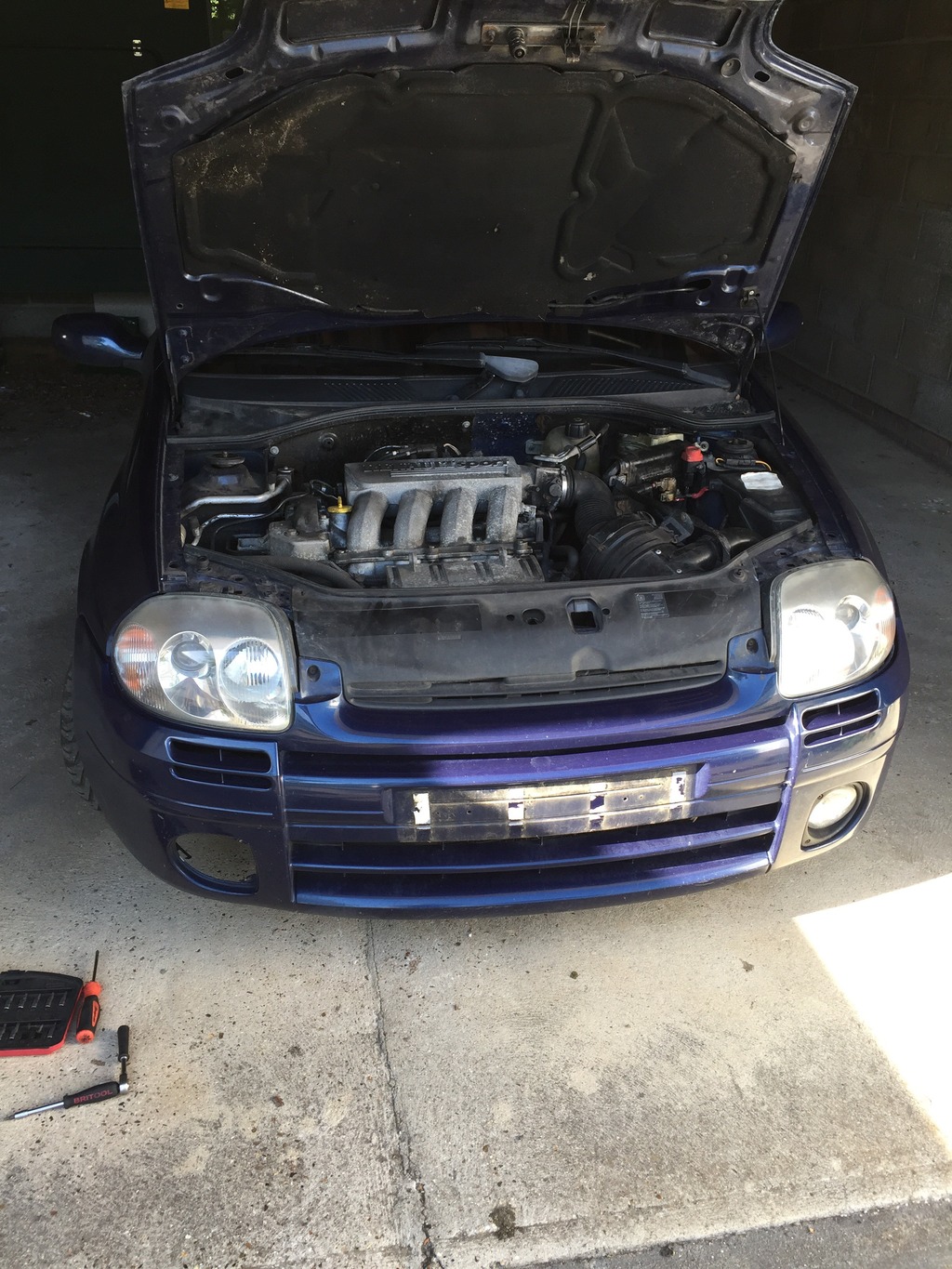

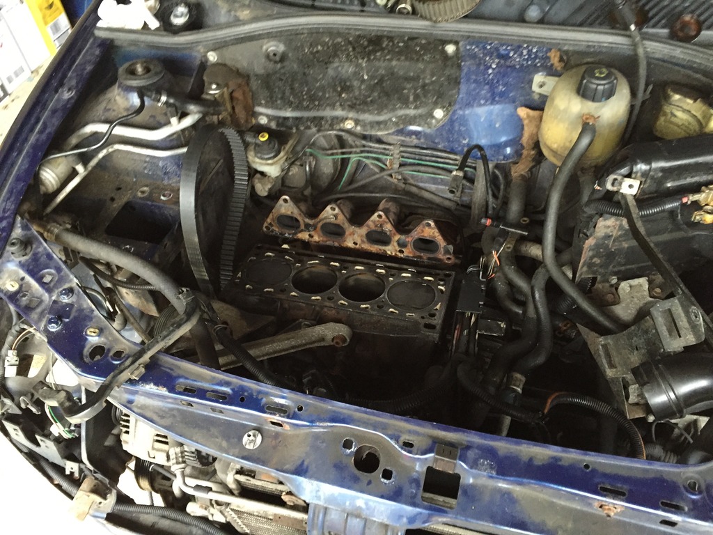

So I started ripping in to the clio tonight , was going to wait till Friday but I got inpatient this is how it started

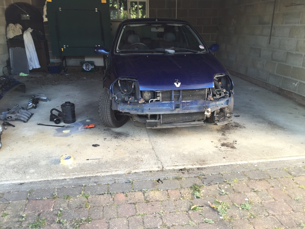

And left it tonight looking very sorry for itself but soon will be running without overheating and smoking
Good quick progress also wish my garage was like yours lol can't even fit my car in mine lol
Hate seeing stuff sitting around doing nothing
Haha pretty lucky with the garages ,parents arnt happy that they can't out there cars away but oh well

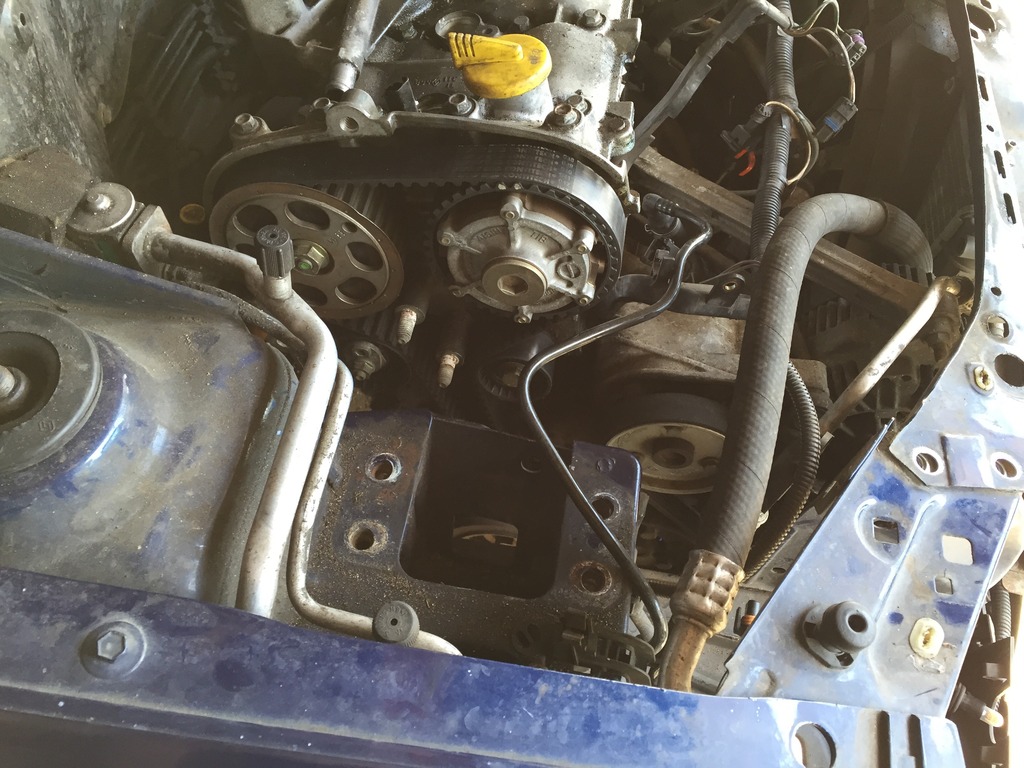

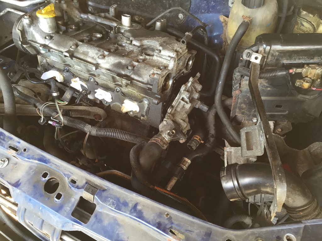

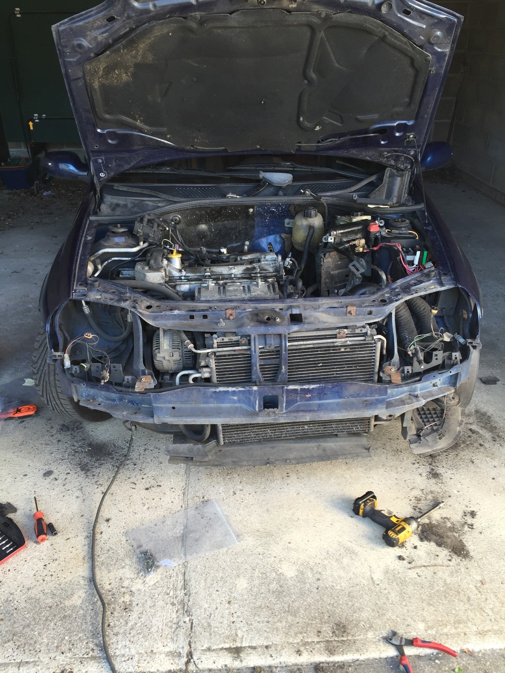

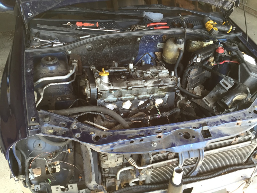

Bit of an update got the head off today , what a b*****d it was but got there in the end , gave it to local engineering firm to face it and pressure test then will all go back on with new cambelt dephaser and new gaskets
Yeah I know , when I took it off someone has had it off before as there is instant gasket on everything and marks all on the head where someone can't do anything properly but should slowly take shape , lovely ph2 by the way

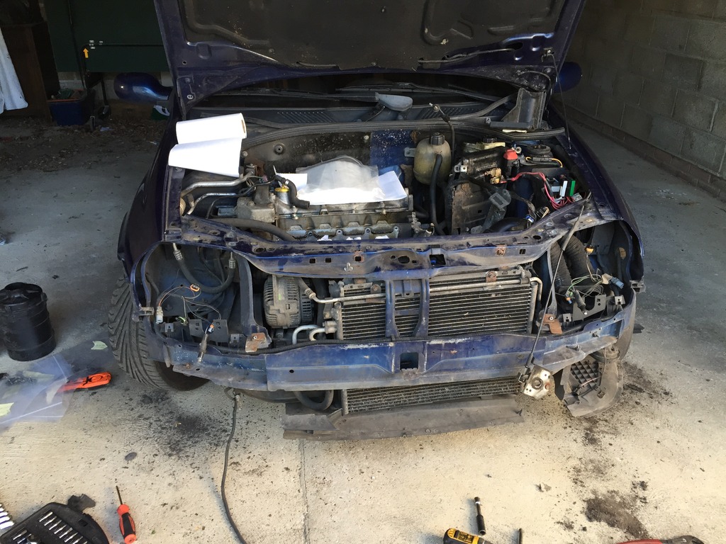

Should be together next week I hope , getting wheels tomorrow and coilovers next month , inlet , rocker and cam cover got painted black today too
Around £340 I think not too bad but once I get a cage , seats harness , steering wheel should cost me around £1200 all in which is pretty cheap for a track car I think in a nice colour and cheap fun
