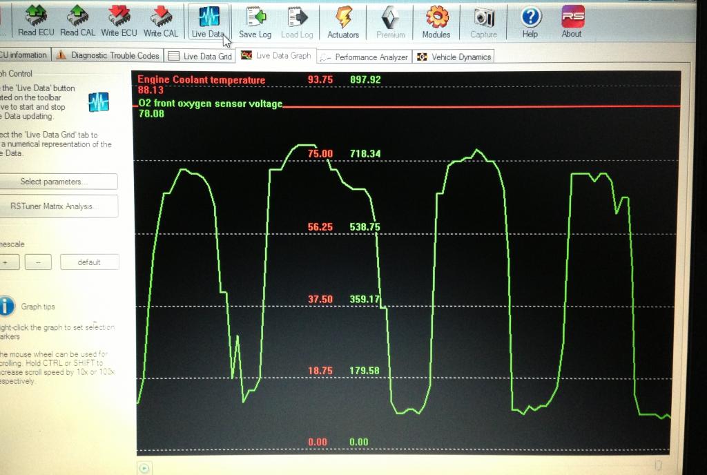

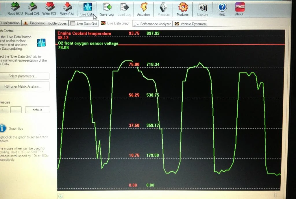

Look at the live data for the front o2 sensor, it should look like this, I suspect it does not.
Check electrical continuity of all wires from o2 sensor to ecu connector.
