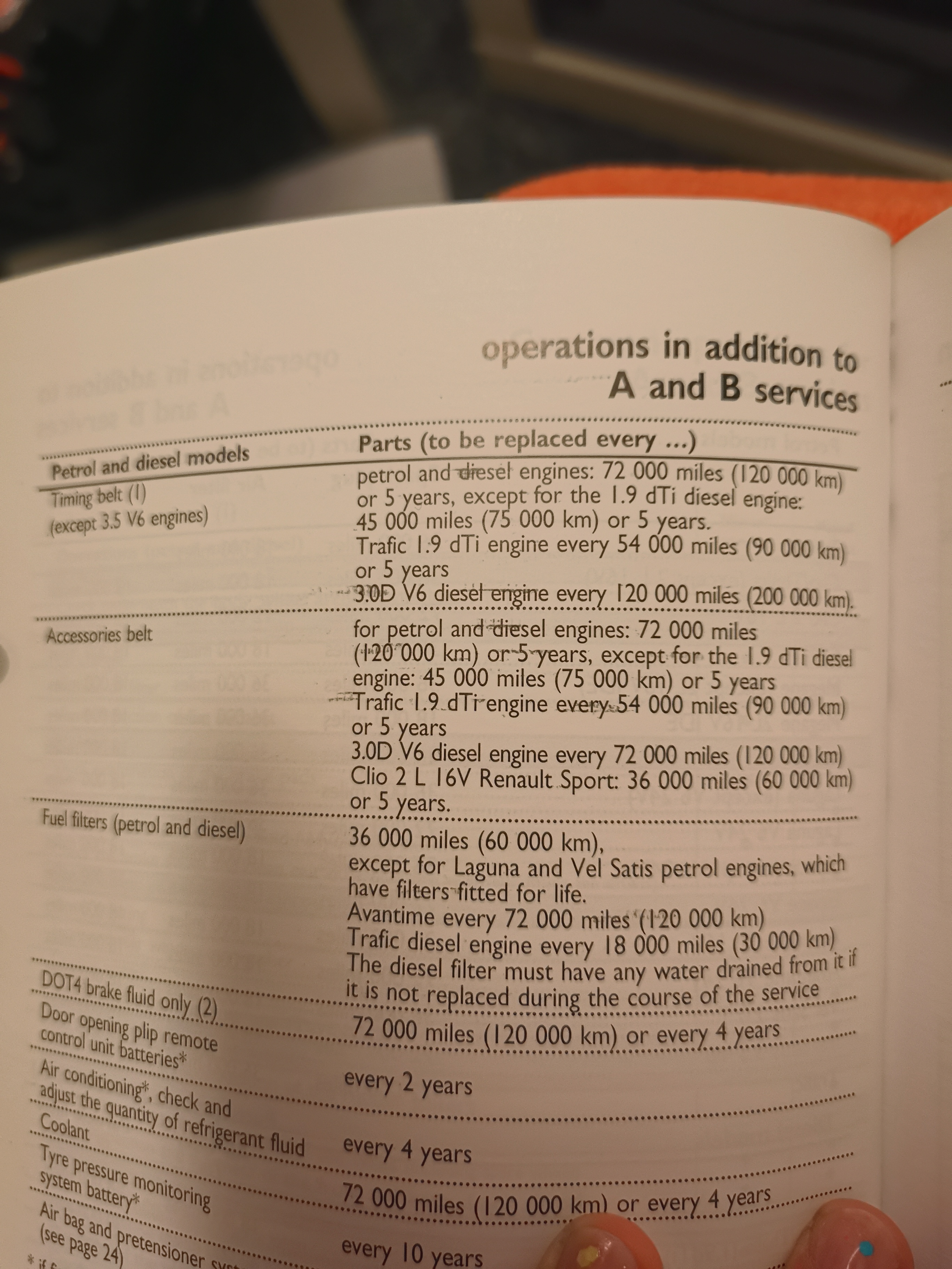

Have you got a picture of this? Never seen this before.
Here you go, so it's actually 36k miles not 72 🤨 this book defo came with the car, chassis number in it is the same 😂

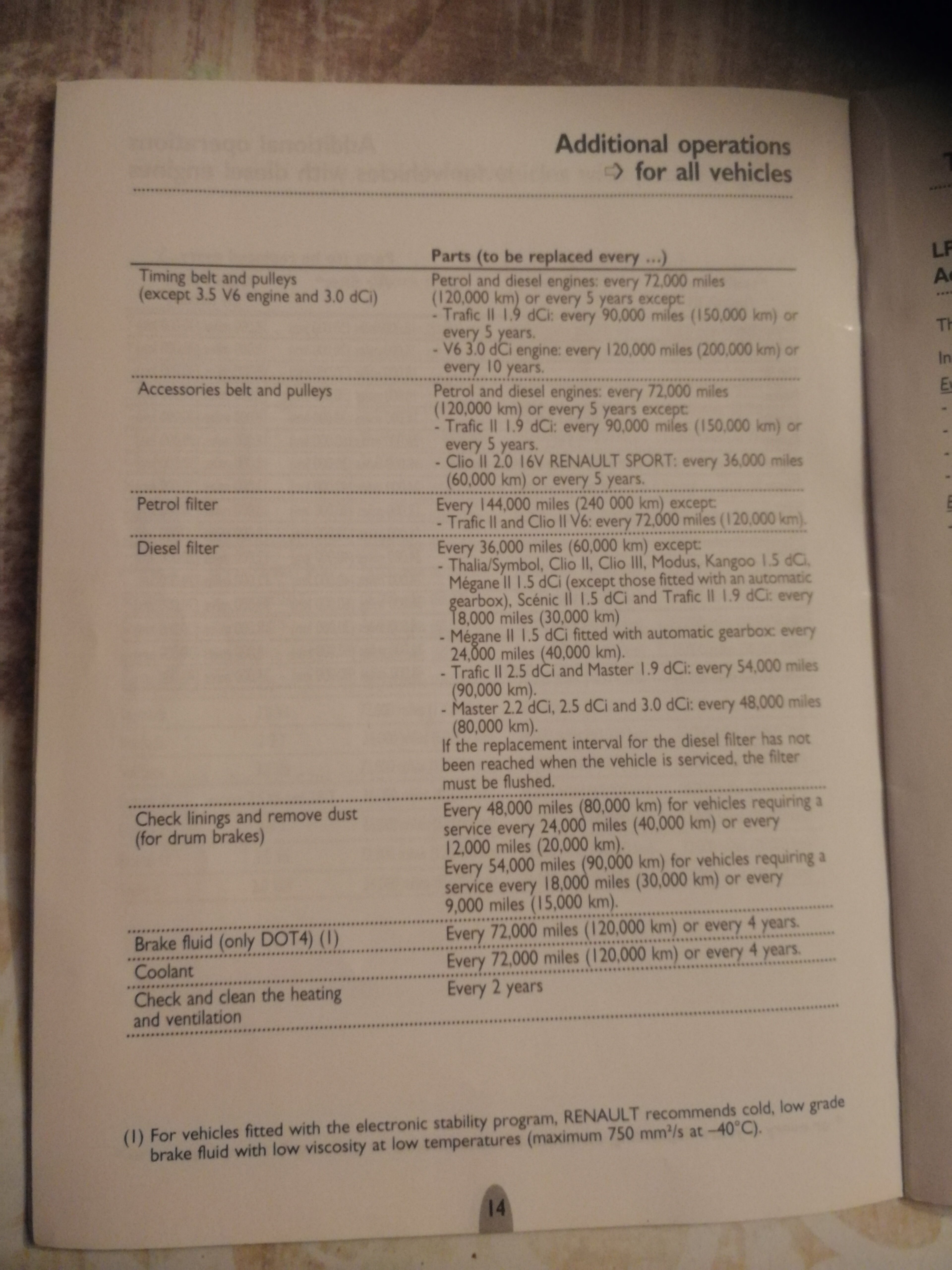

This is the service book that came with my 182 from new and it says fuel filter change is every 144k miles. I also had a 172 from new and that service book also said the same 🤔

You think they issued wrong book for mine? 😂😂 What year was yours made in?
Mines a 55 plate bought in February 2006. My 172 was bought in November 2001.
I don't know if they've issued you the wrong book? But I've never seen or heard of the fuel filter change interval being 72 or 36k miles 😮
All the years of being on Cliosport I've only ever seen it mentioned 150k or thereabouts 🤔
Just had a quick Google which took me back to some old posts a guy called edde who used to come in here and was a fountain of knowledge when it came to all things Clio said 150k also Fred Hopkins said the same.
Maybe your book is for a ph1 172?
