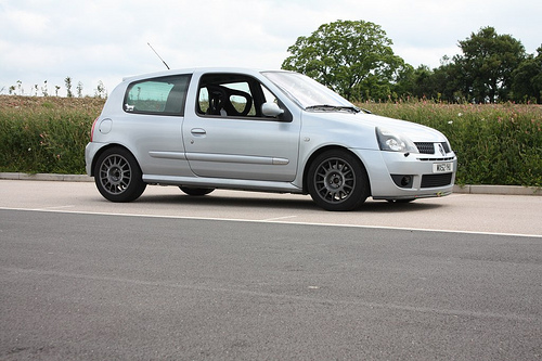

what 15s do you guys recommend ? any pics on a silver clio?
15" 2118s not that light, but look good (IMO) and are strong.
[/url]
IMG_7377 by fletcher10, on Flickr

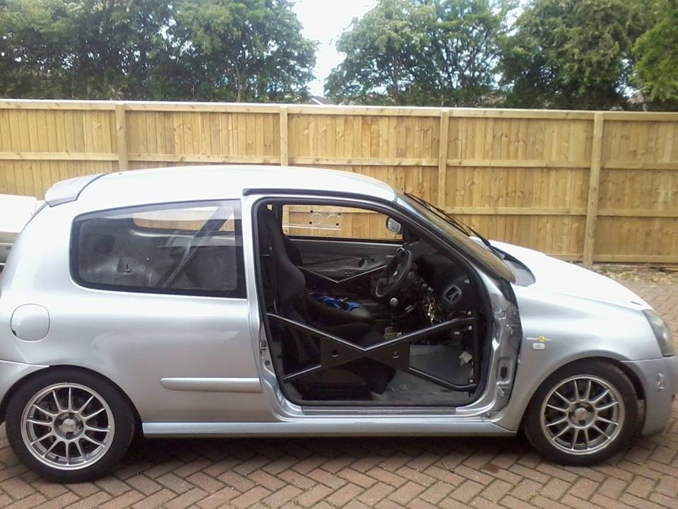

Also my Clio is totally stripped out one seat etc.
