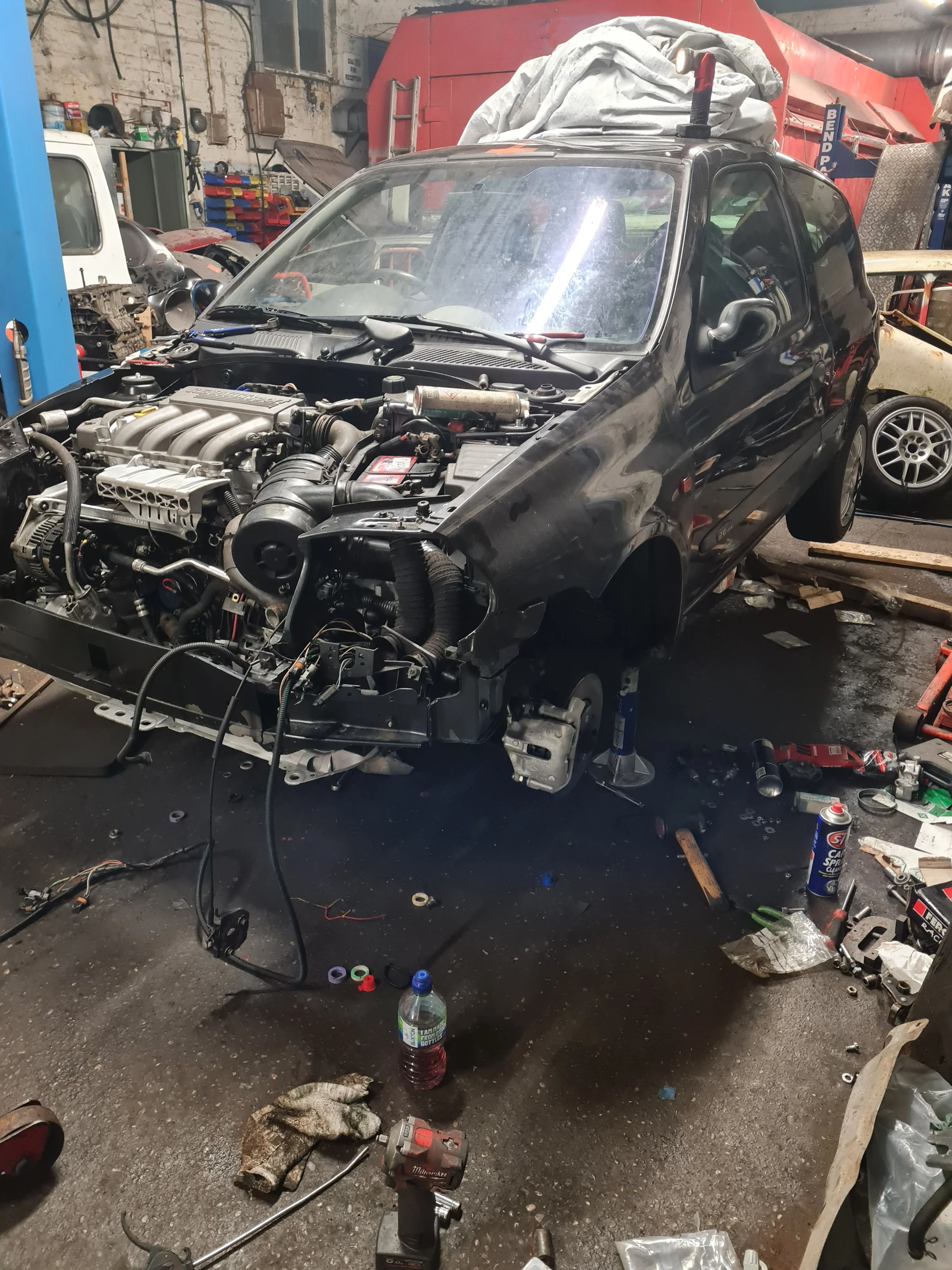

Evening all,

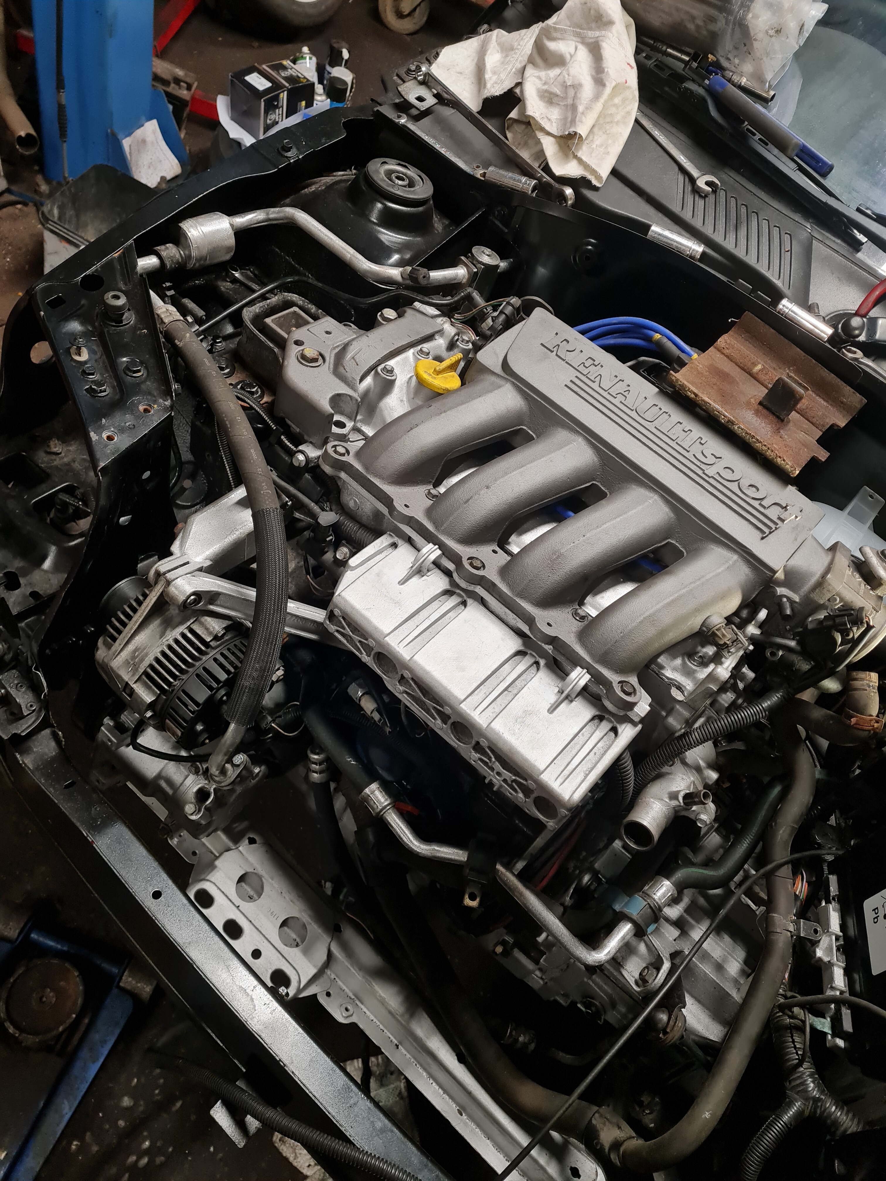

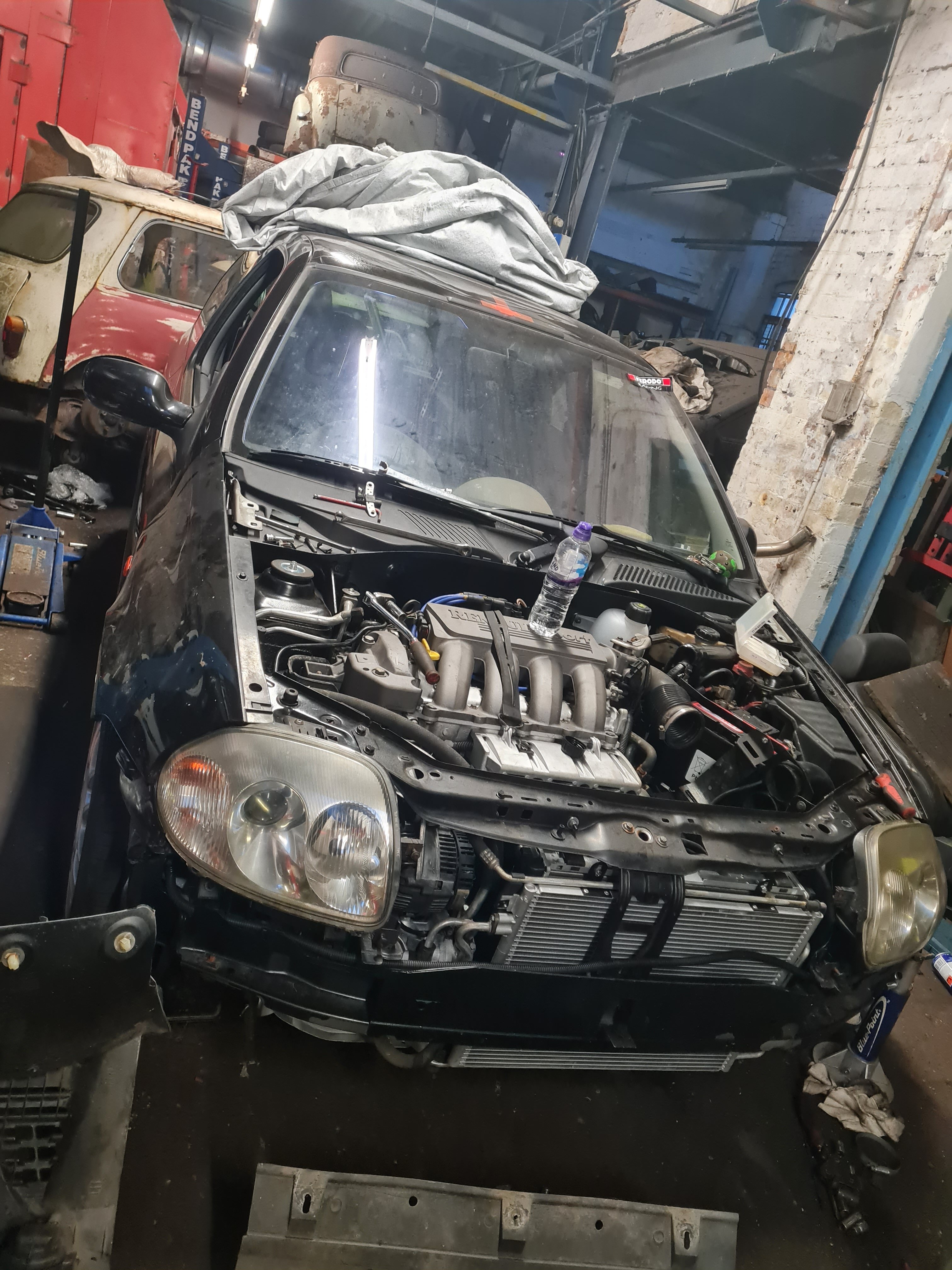

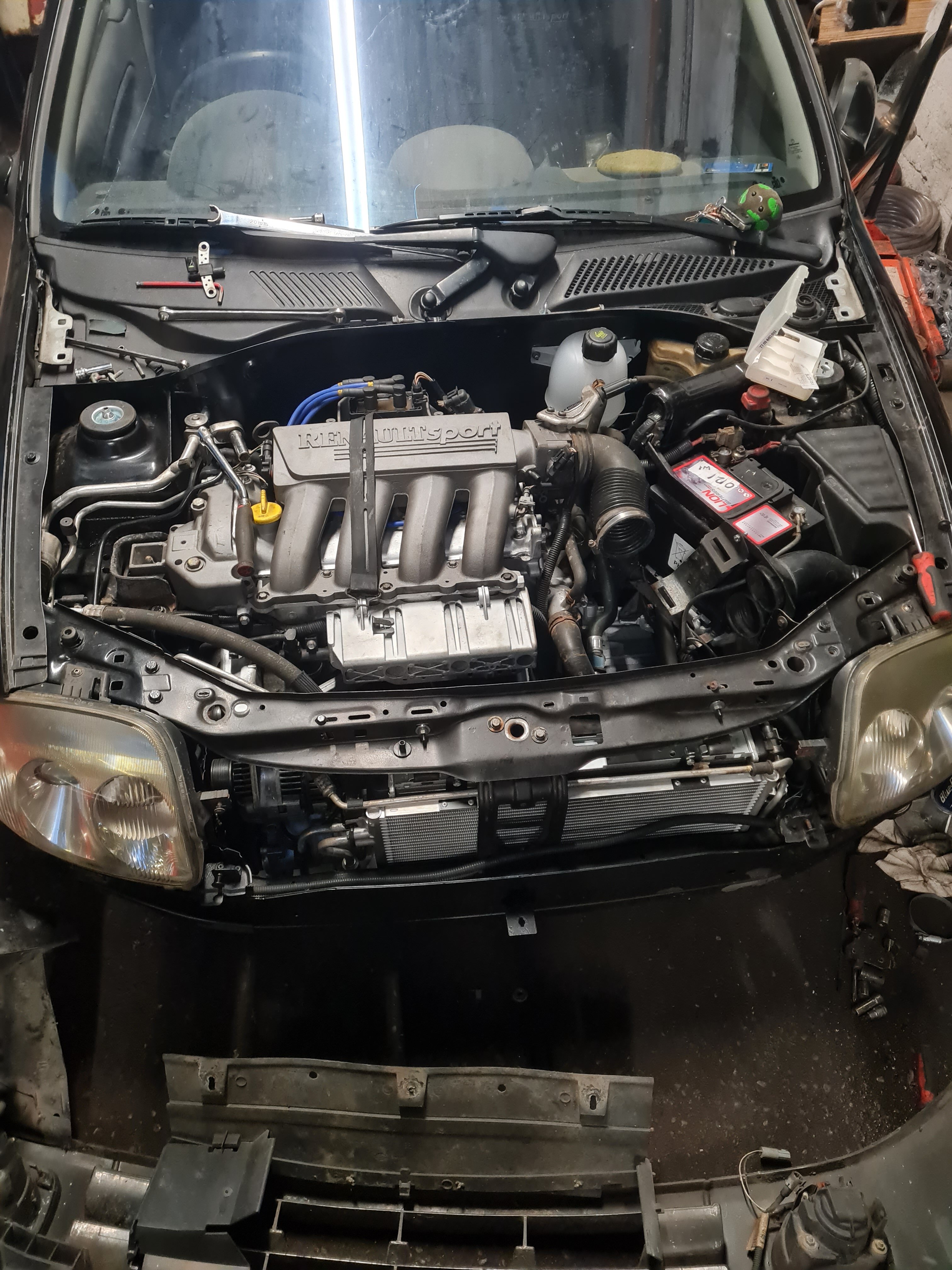

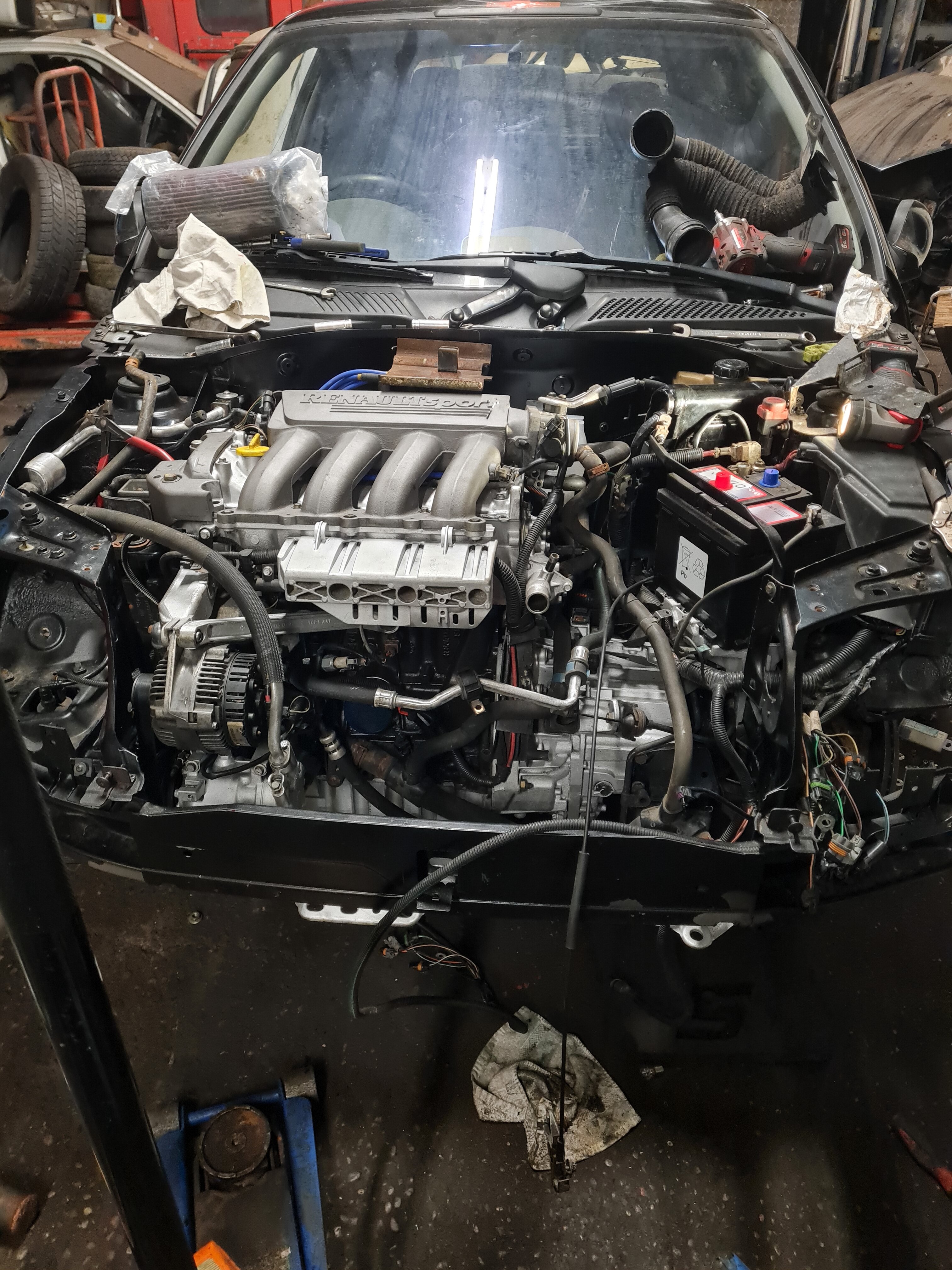

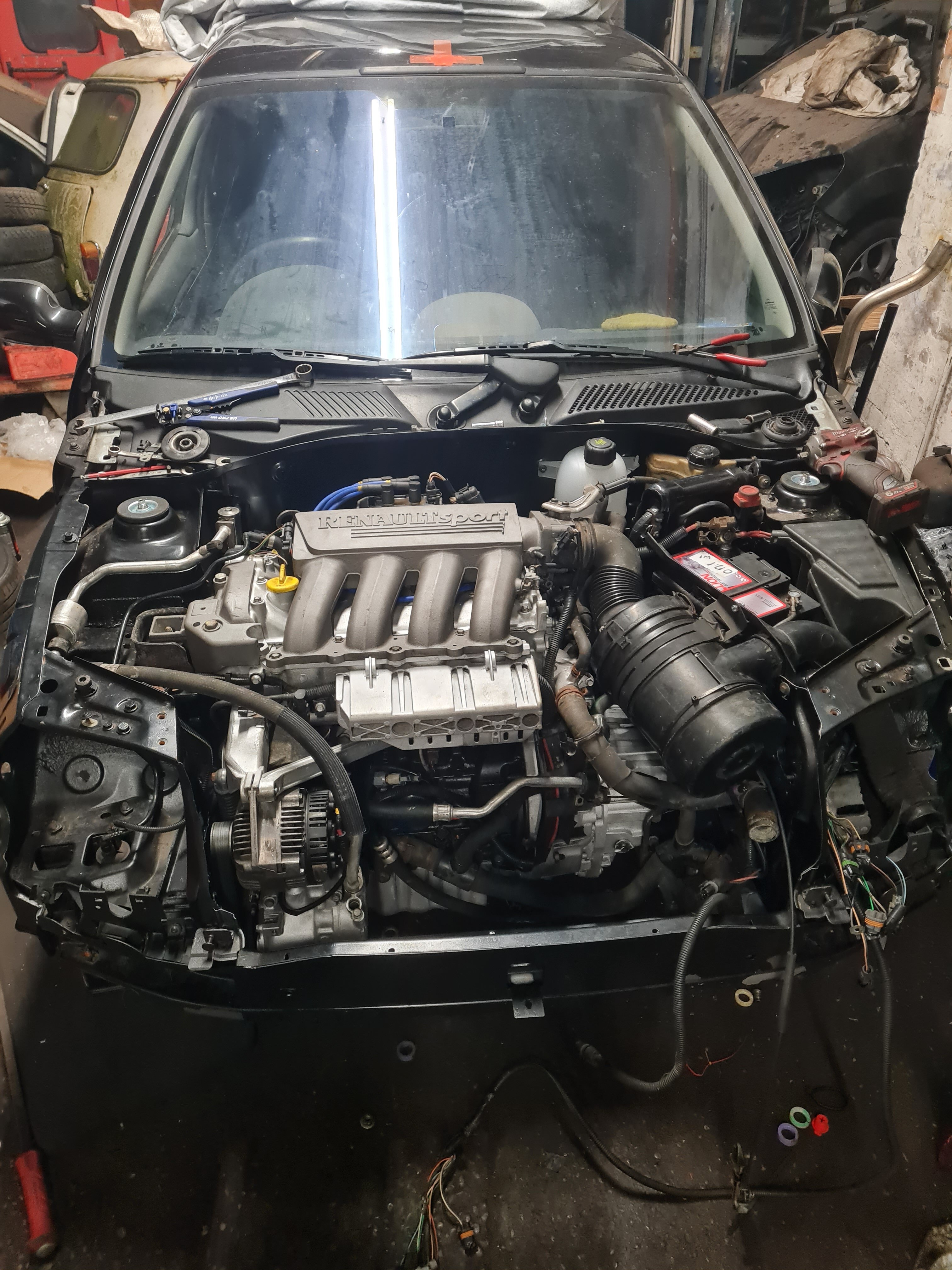

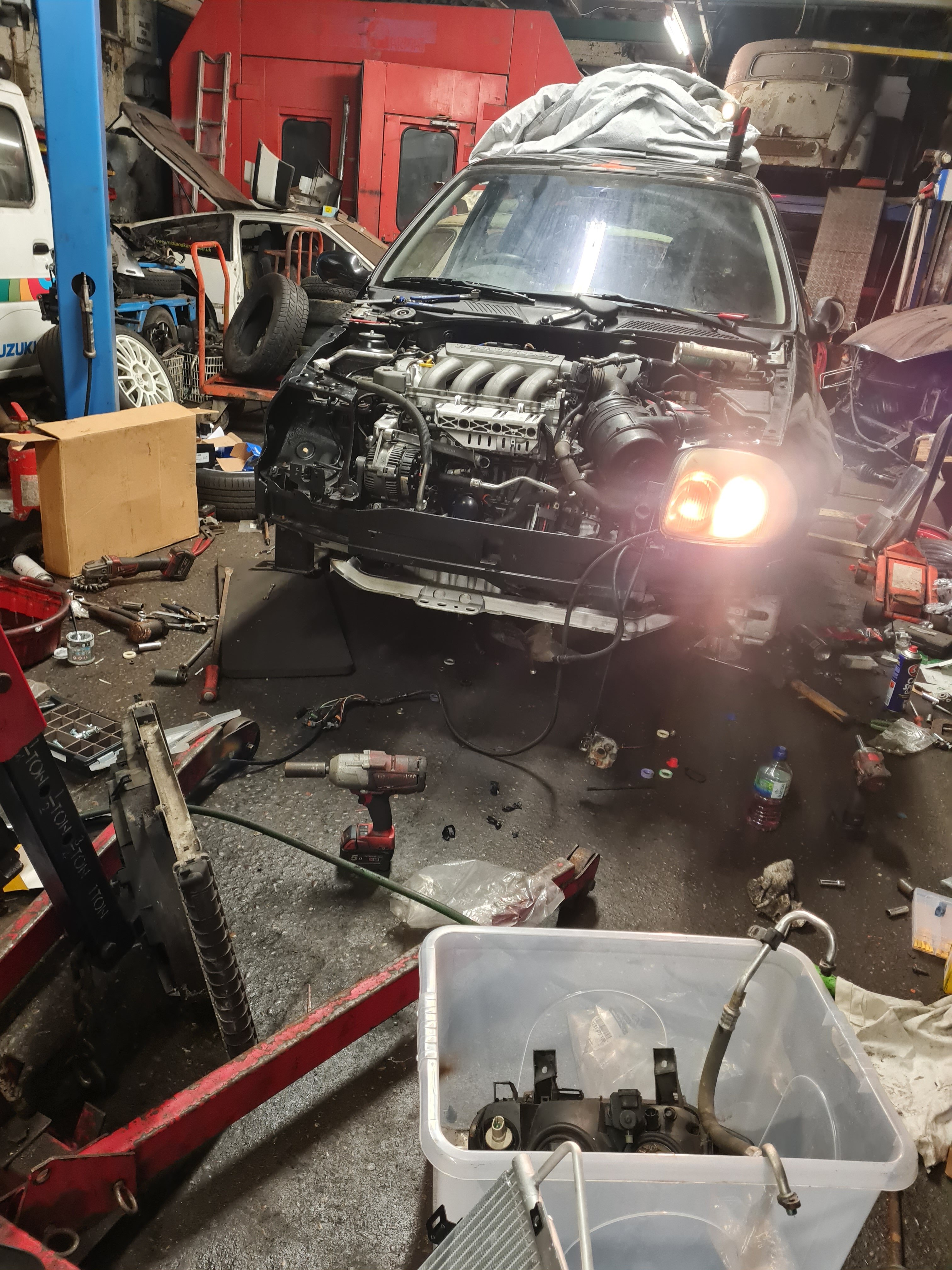

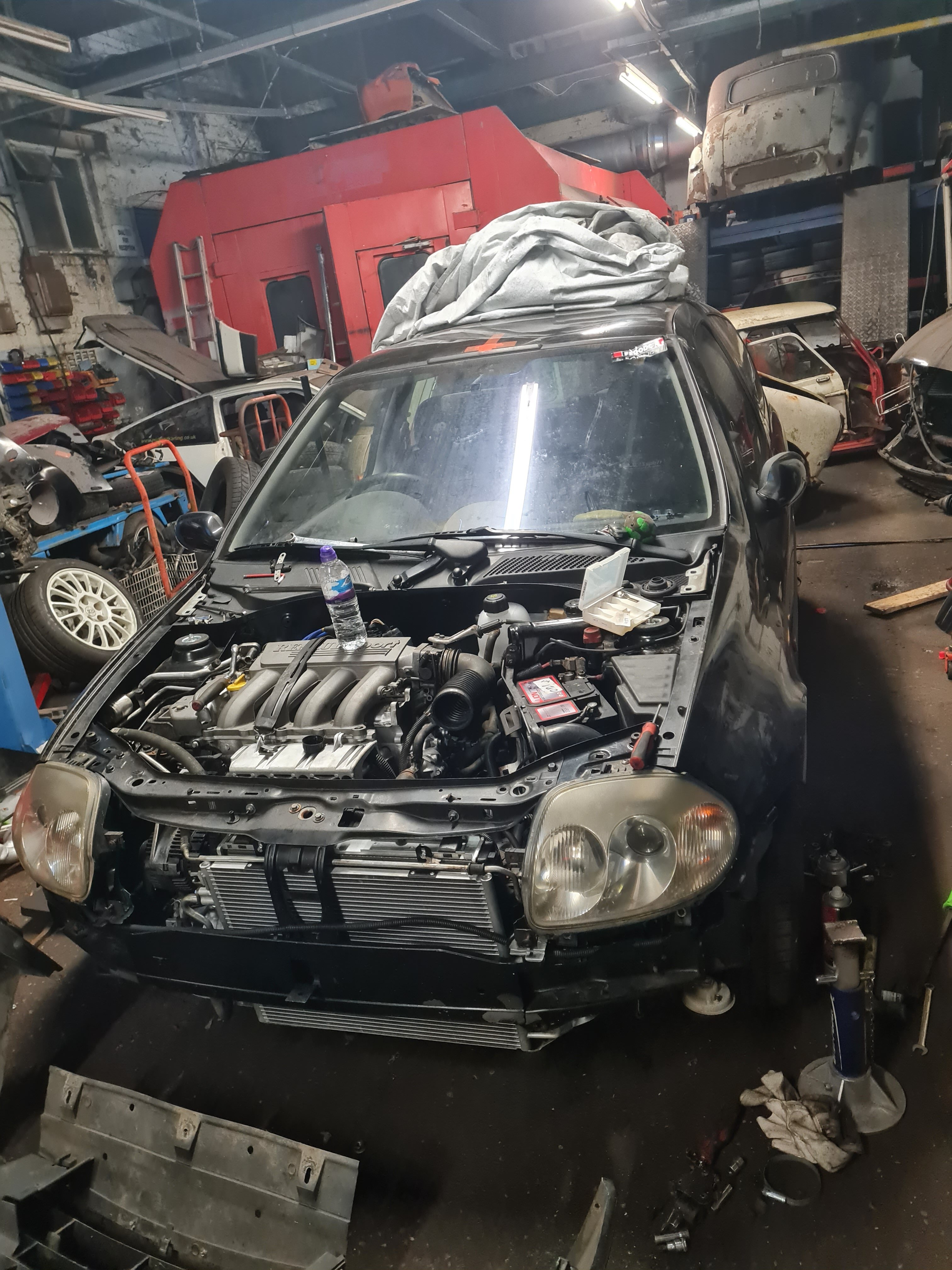

Been a long day today of routing the loom. Took the thing out over a year ago now so it's been a real minefield putting it back in but we are there now! Definitely not as neat as I would like but all brackets are screwed into their relevant holes so I'm assuming that's where everything goes.

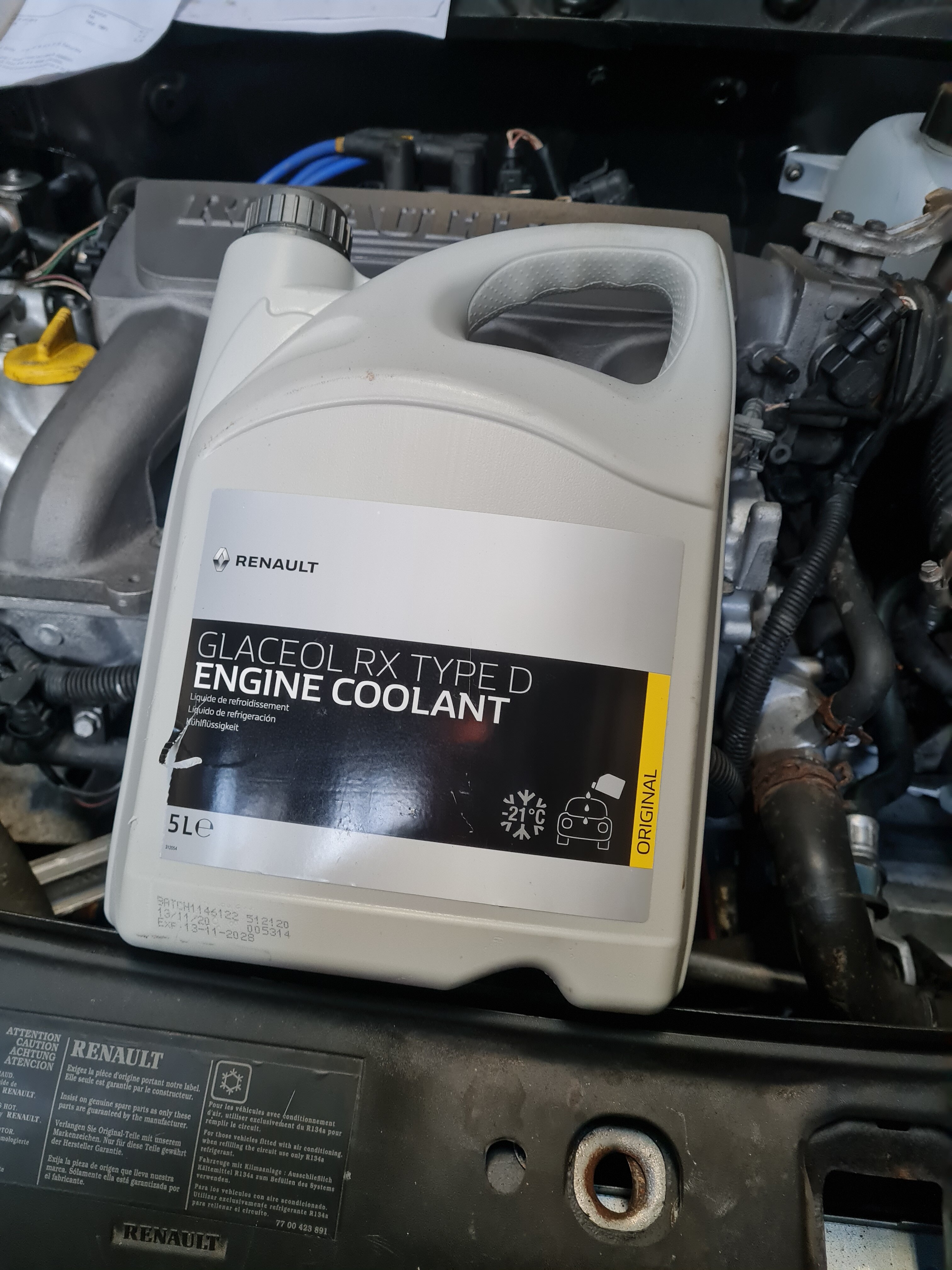

Top aircon pipe on, also connected the hoses to the heater matrix pipes and plumbed in the bottom engine hose and the thermostat hose. Properly unhappy with the state of the water hoses so a silicone kit is in order, but just getting it on the road first. Got a new aircon rad that arrived today to be fitted tomorrow 🤞 along with a new radiator and brackets.
Only outlier I have now is a single loop connector at the back of the engine where the starter is, I've put the starter live on already. It's on the same branch of plugs as the two plugs for the lambadas 🤔
Massive thanks to @Big_Steve_T, been studying your pictures from your RB resto and where all your wiring went, would have been a much longer day otherwise.
This is a sight I haven't seen for some time 😳
Fingers crossed the front end will be on tomorrow.

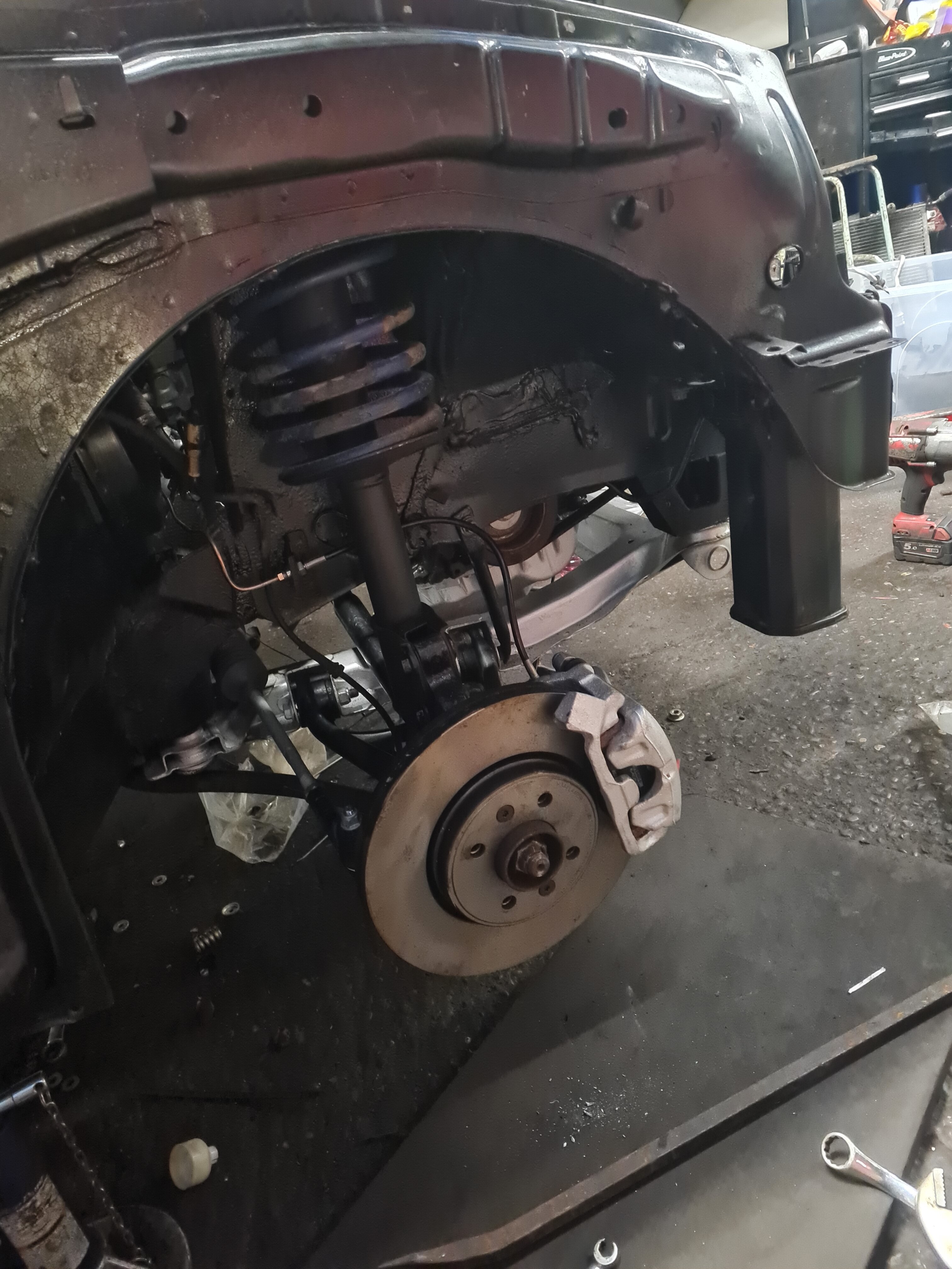

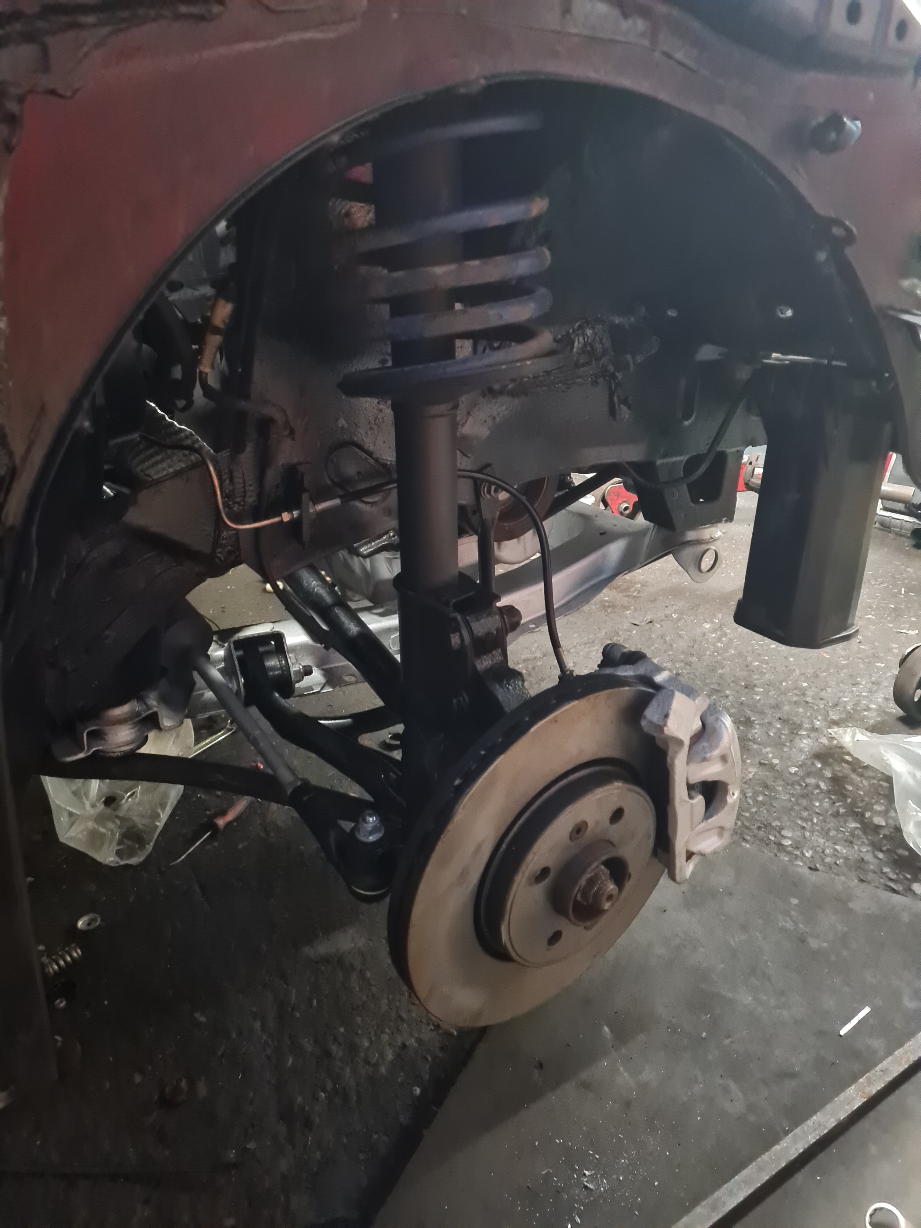

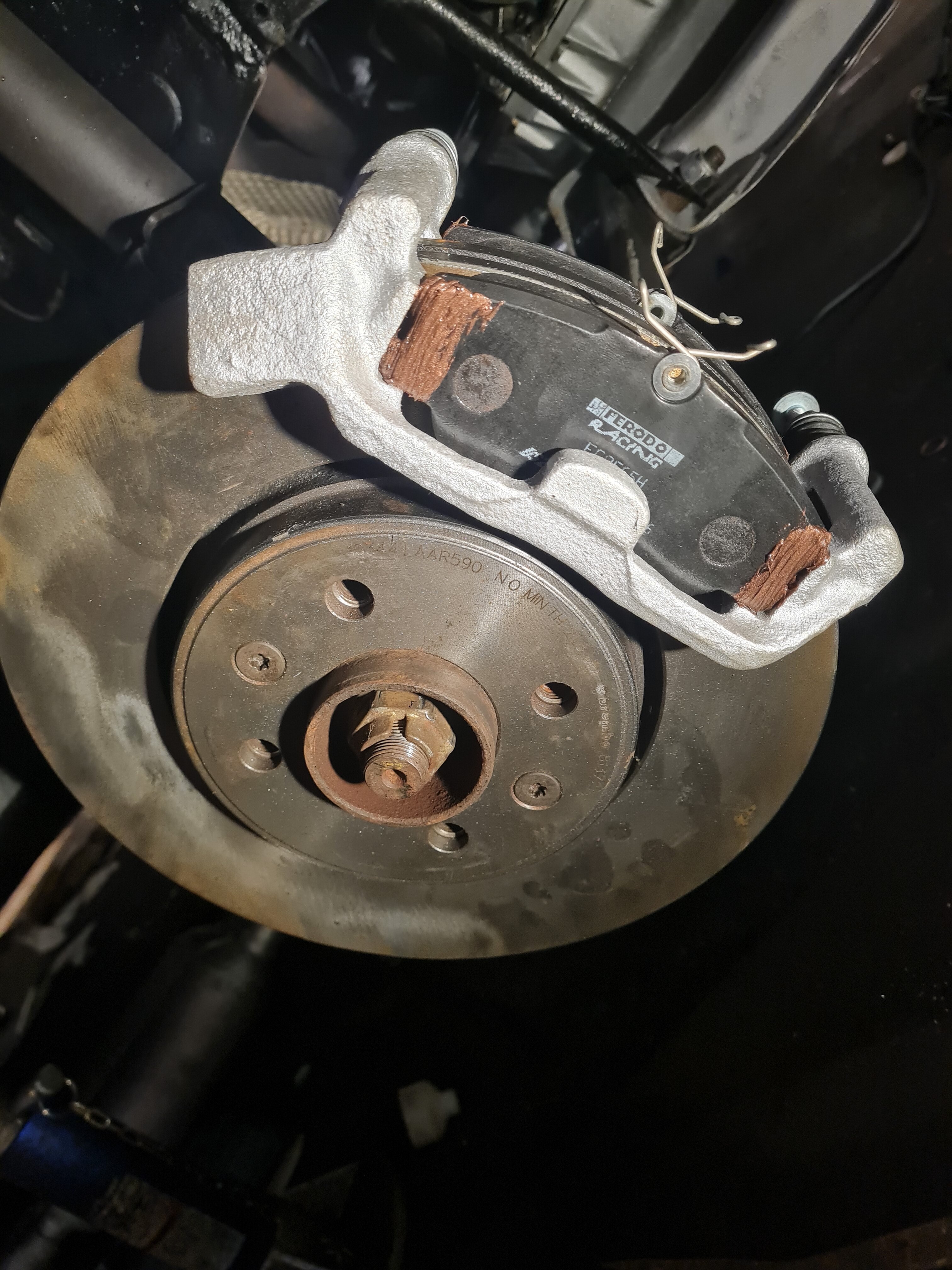

Ferodo ds3500 pads in with brembo HC discs courtesy of @Coops Mk1 's shed 😅 discs have been on for a while now so are starting to gather a bit of surface.
Got both front back together, Renault tie rods and rack ends, wish ones with power flex black bushes, new track rods, new cup struts and new top mounts and bearings. H&r springs are looking a touch worse for wear but they will do for now! Rebuilt calipers and sliders fitted, braided line connected to the new copper-zinc brake lines. Ready to go back on wheels.

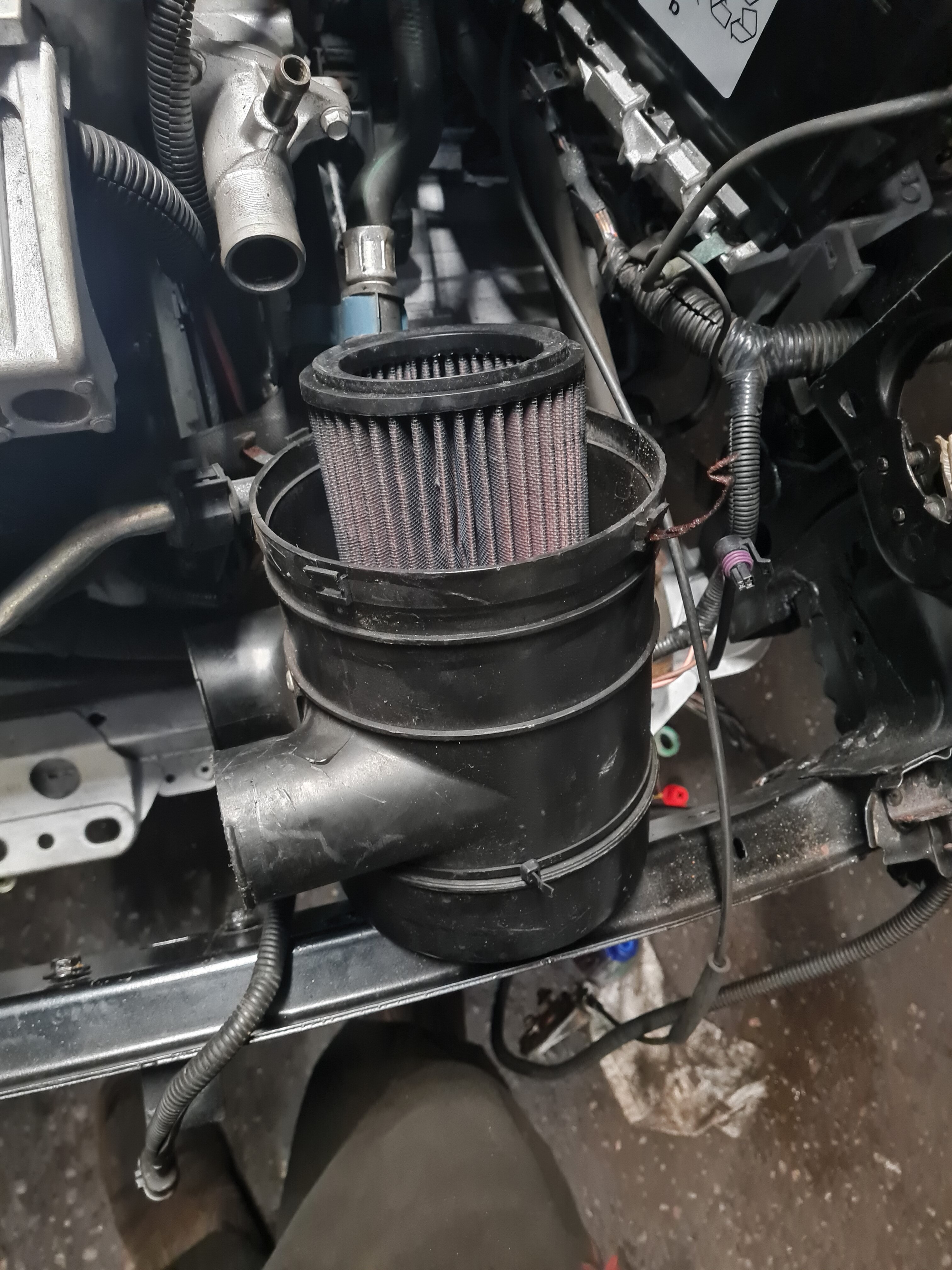

Cheeky washable filter chucked in.

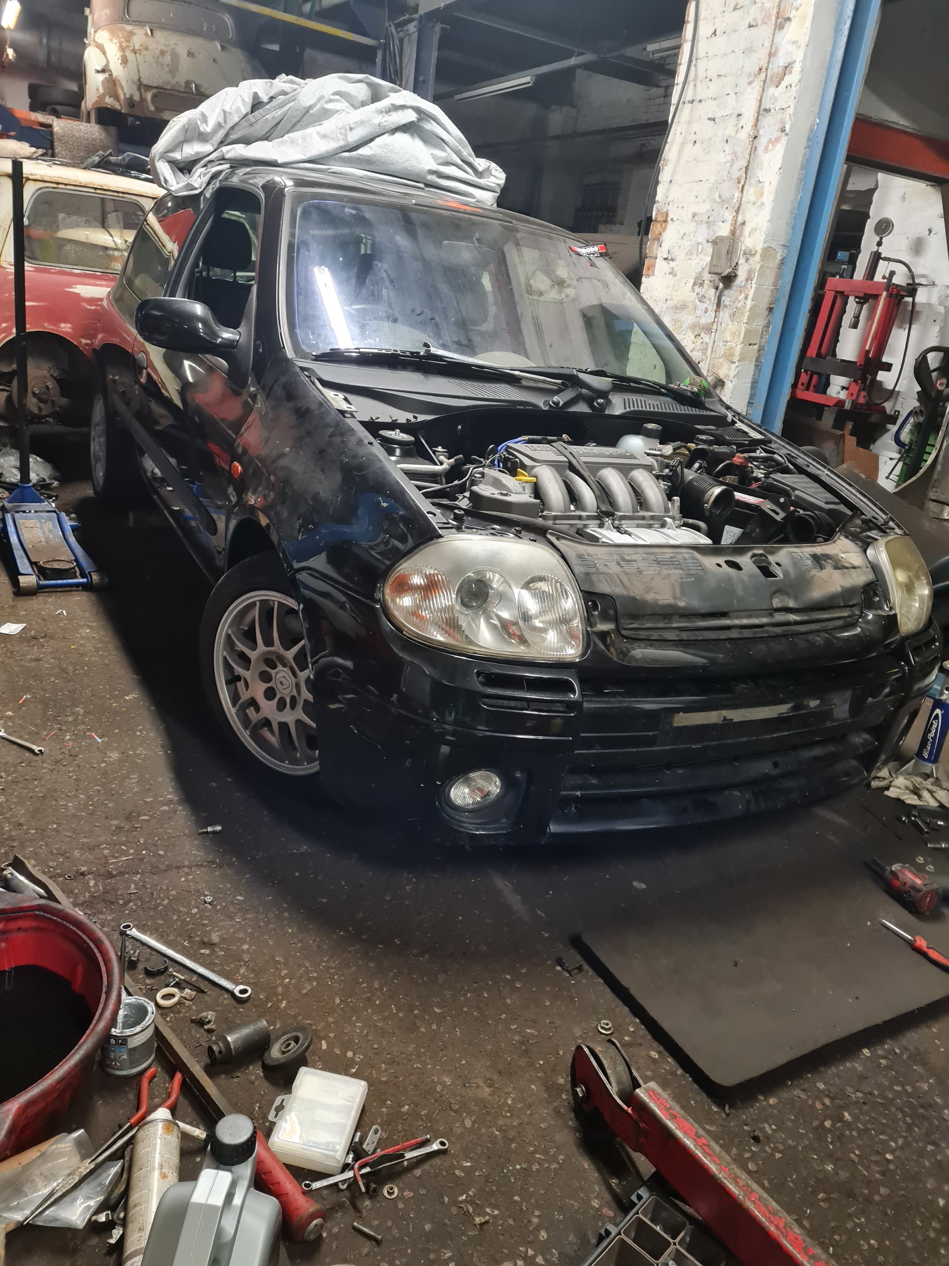

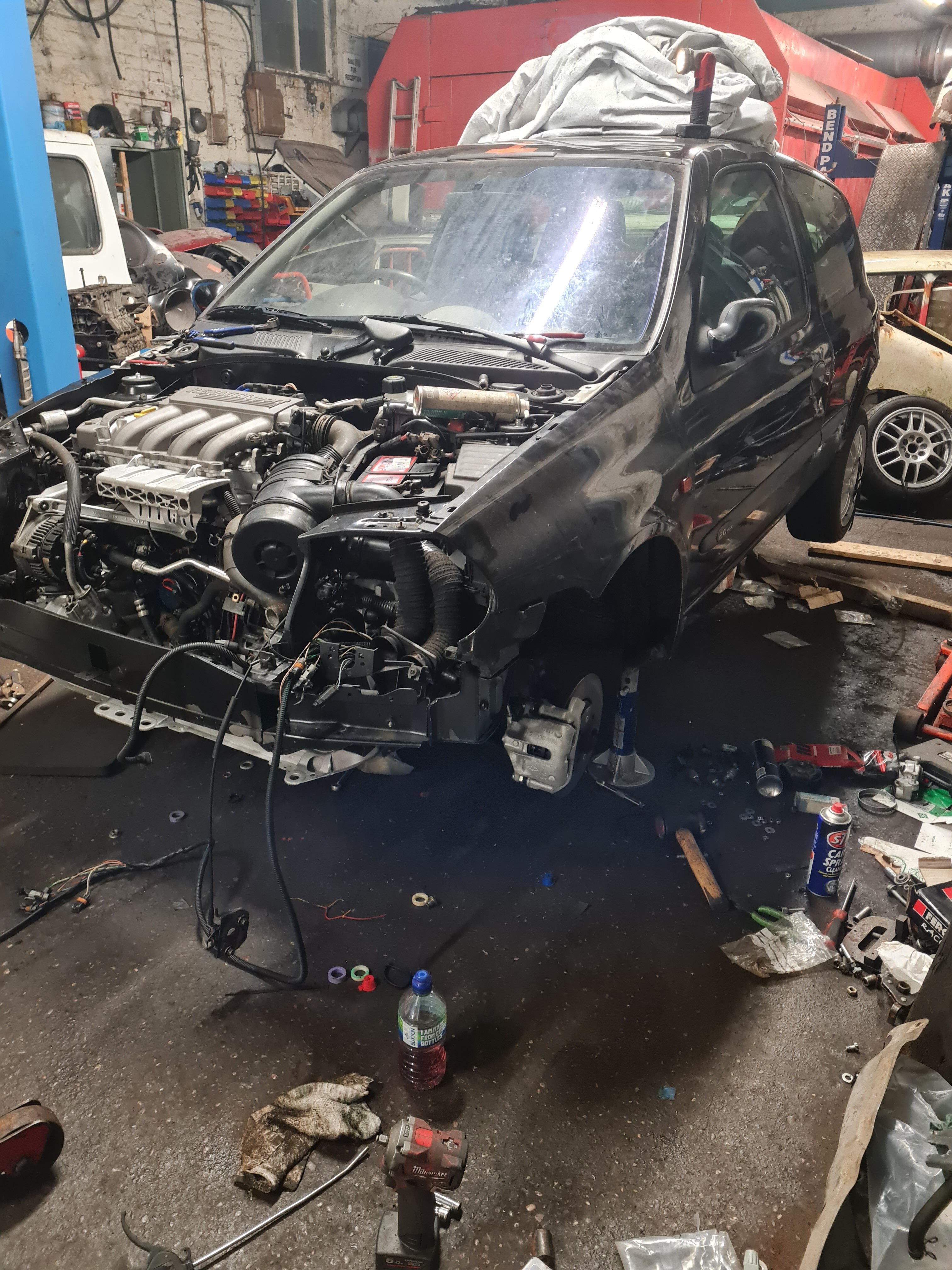

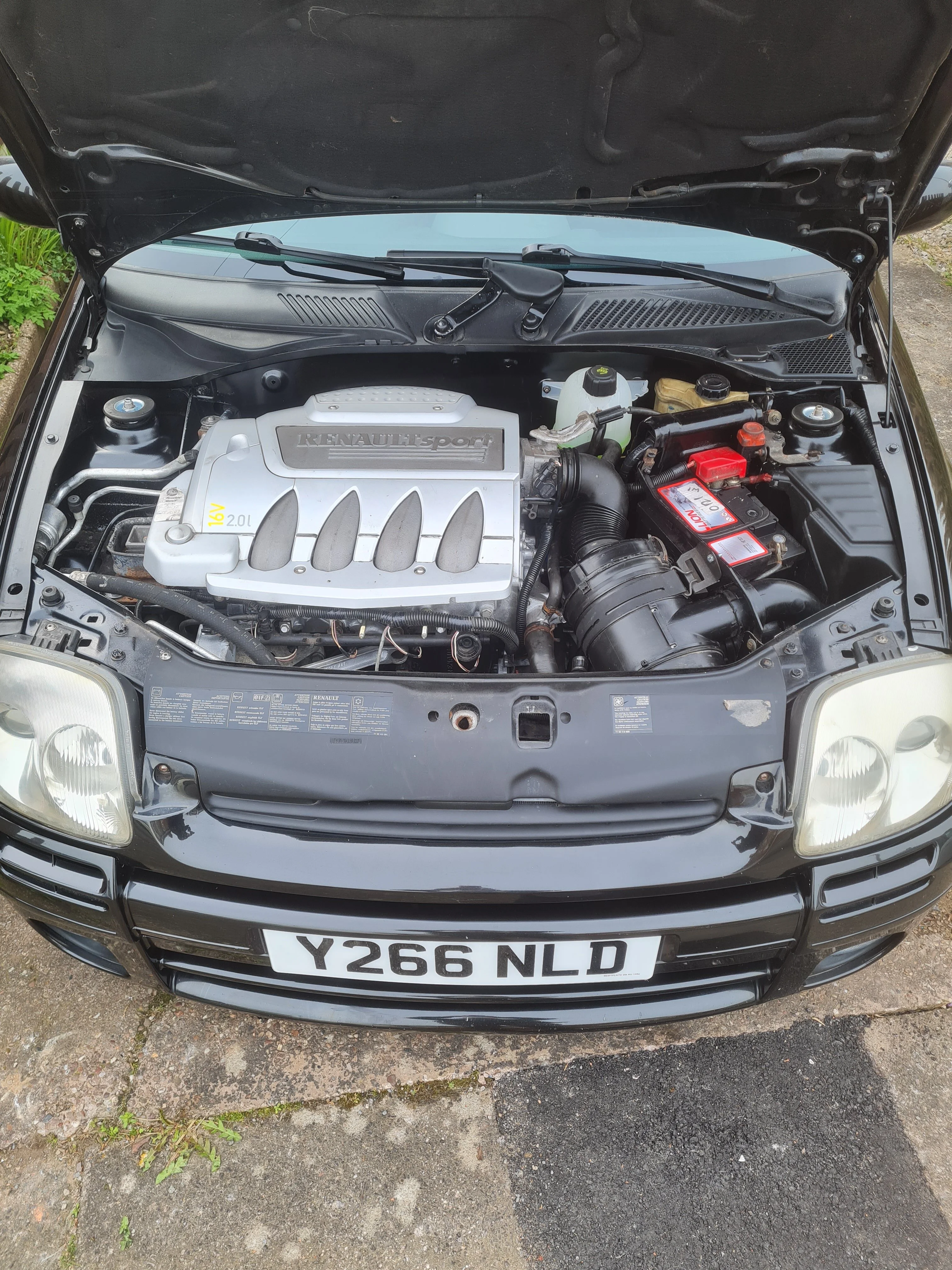

Finished wiring the engine in and started it up on squirty go juice, with no exhaust.....scared the garage cat out, but it runs 🥳 because I decided to chop the end of my left thumb off I physically dont have the dexterity to hold the cat in place and screw on the little 8mm nuts, so I'm going to have to go and make friends with a two thumbed person.
Got excited then and bolted a wing on.
Gave it an eye 👀

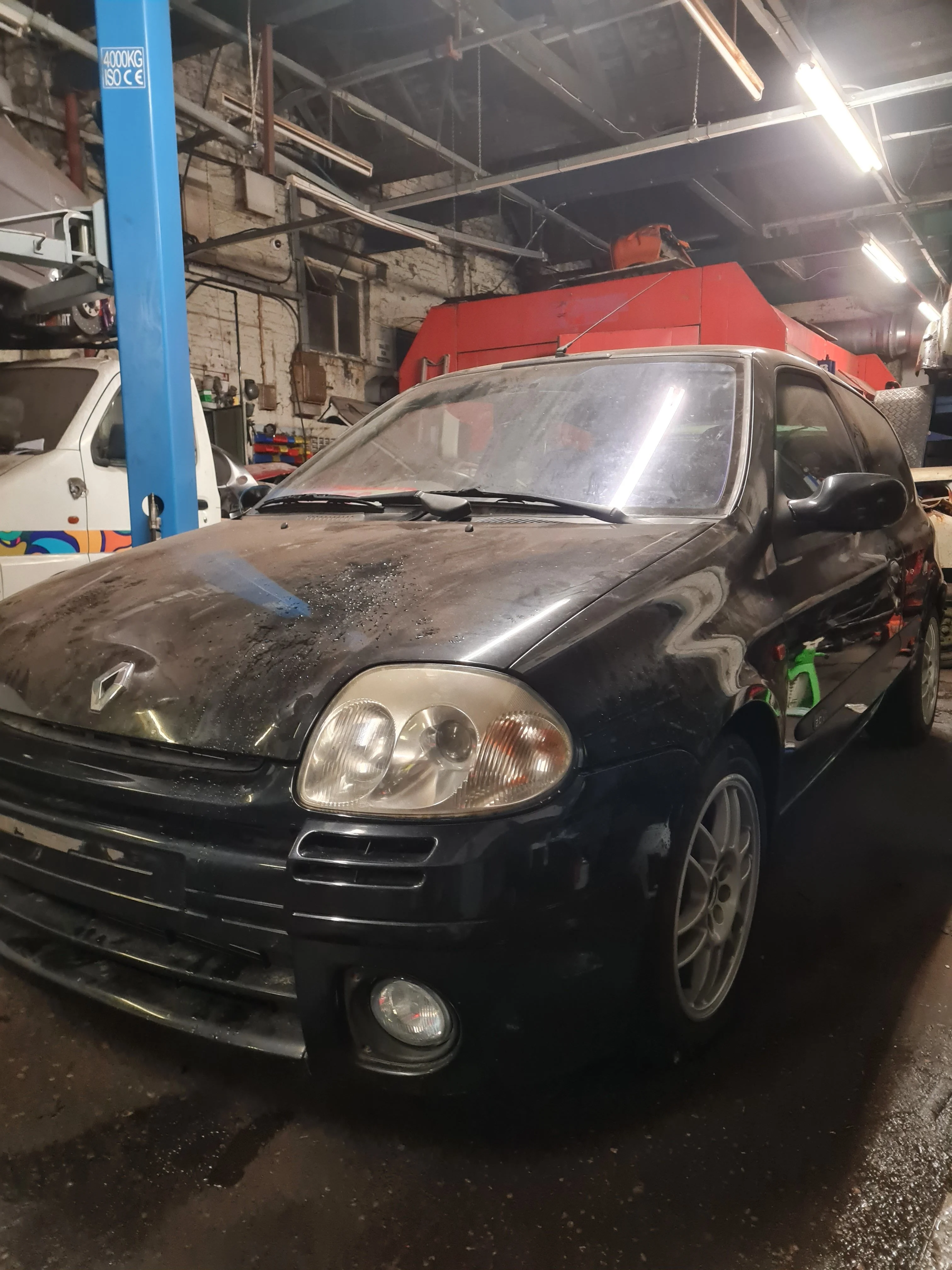

Evening all, been another sh*te day.

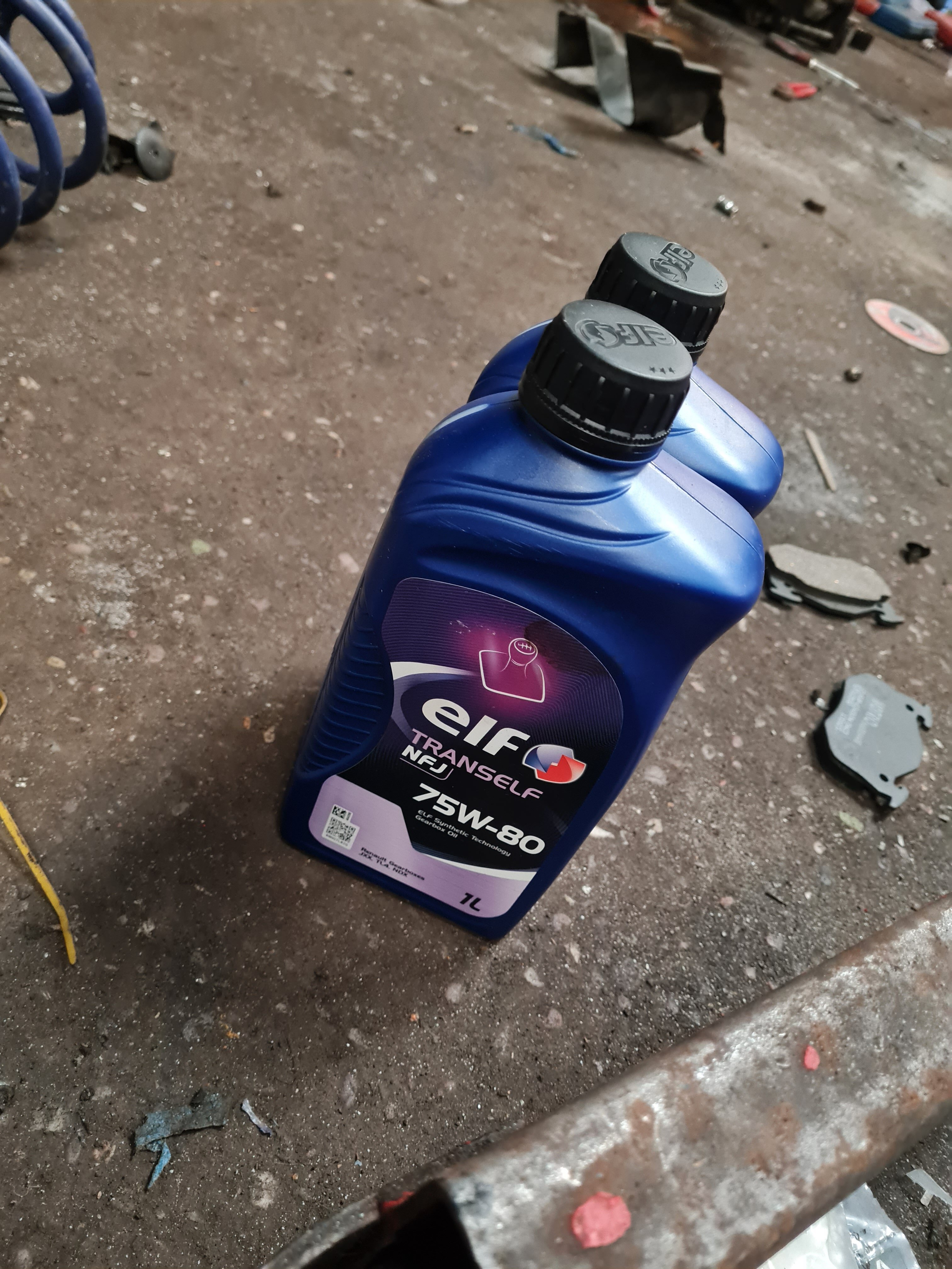

Gearbox filled with the proper stuff, smells fooking awful🤮

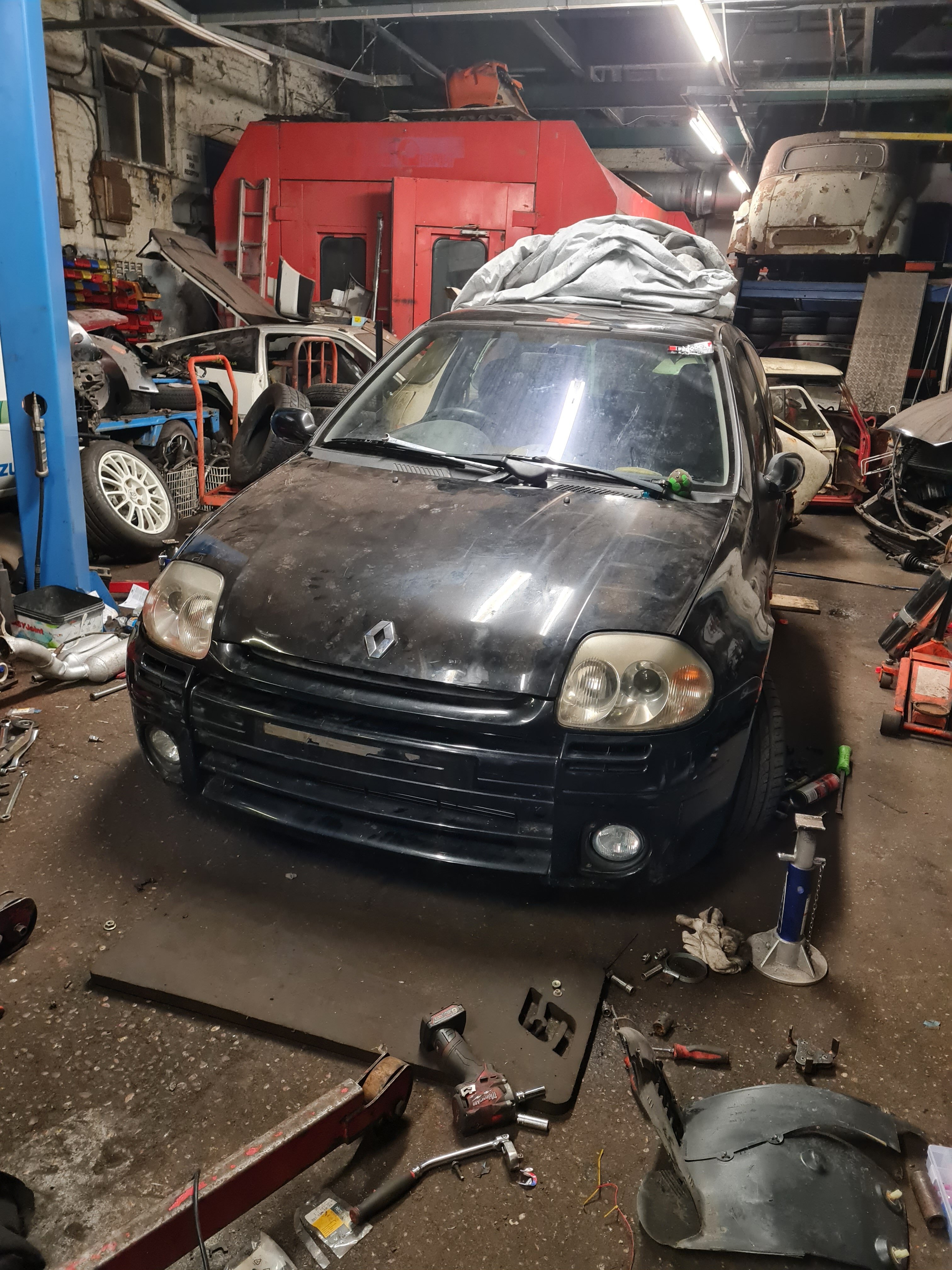

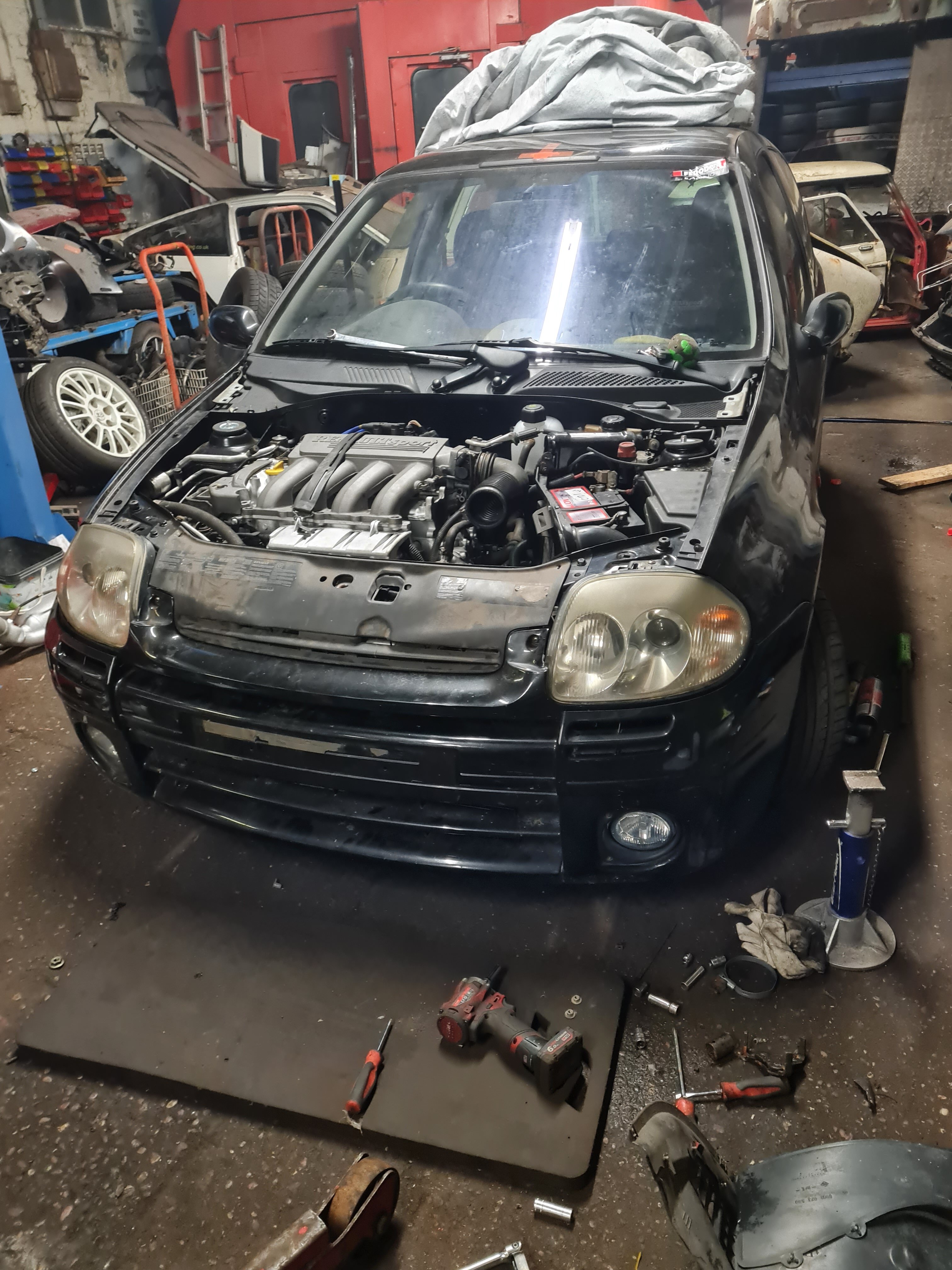

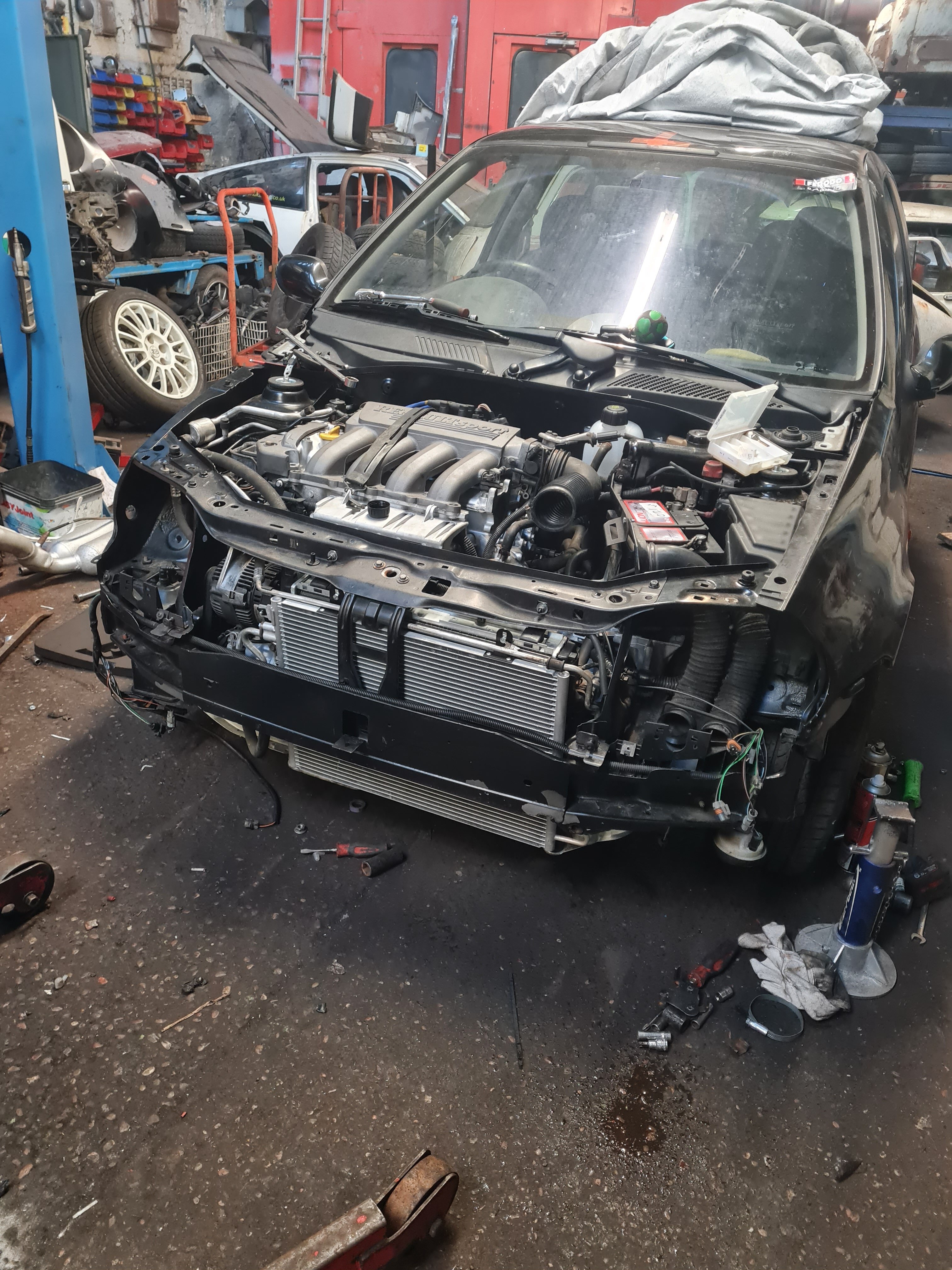

New EIS Rad curtousey of Europarts with a new air con rad.
Gave it some eyes and wings.
Bumpers on!

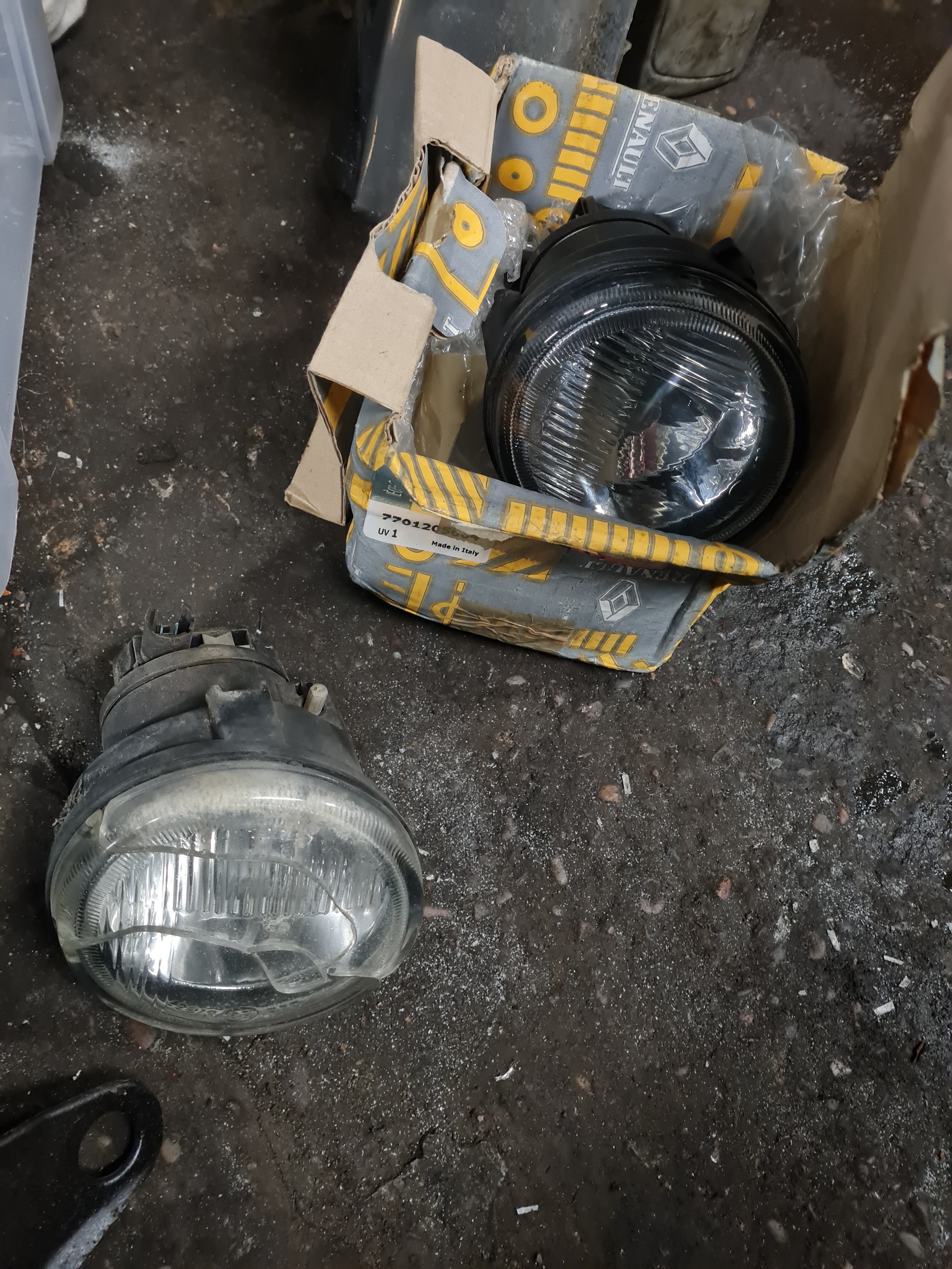

New Renault Foggies
Et voila. Finished front end.

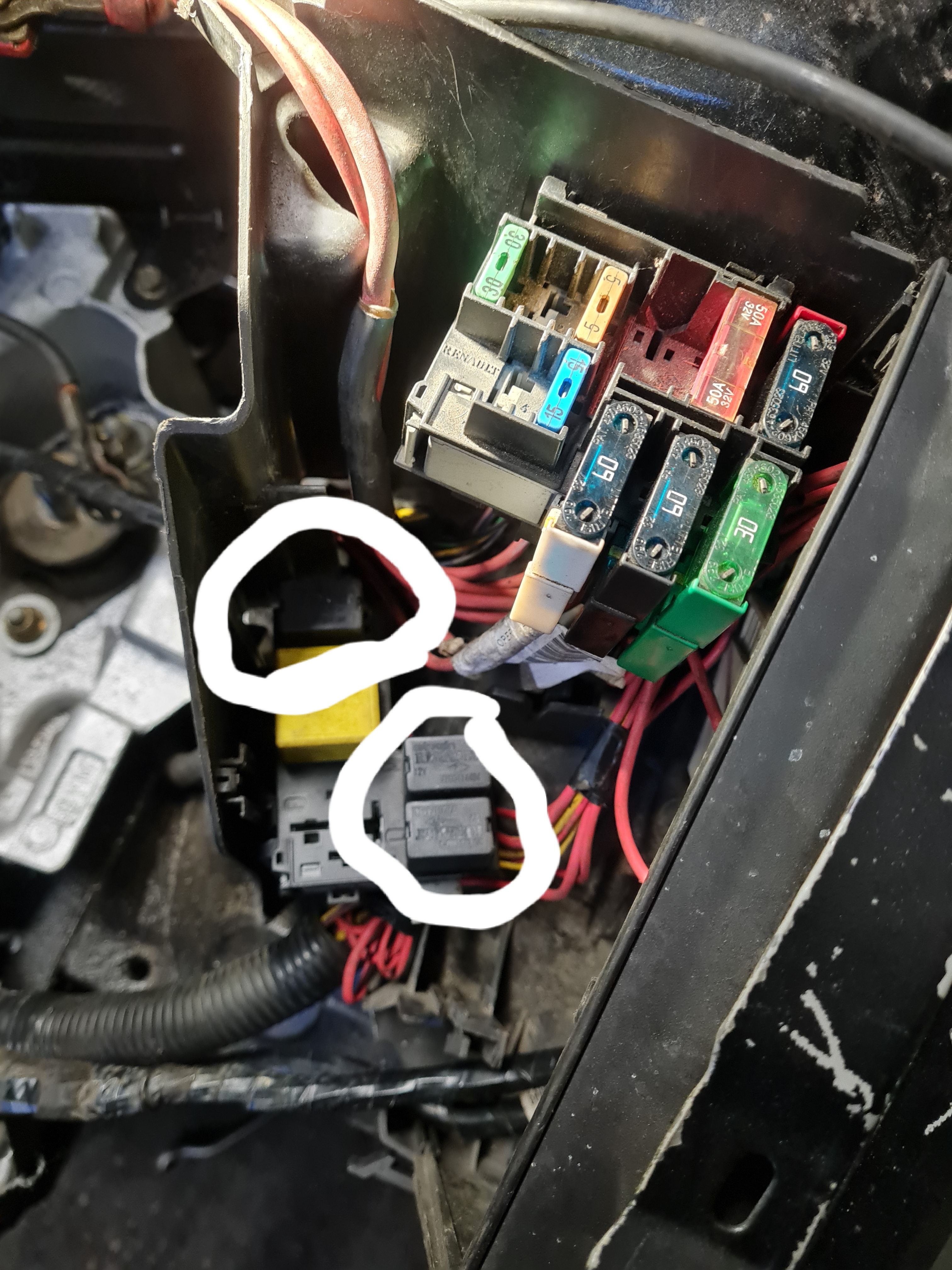

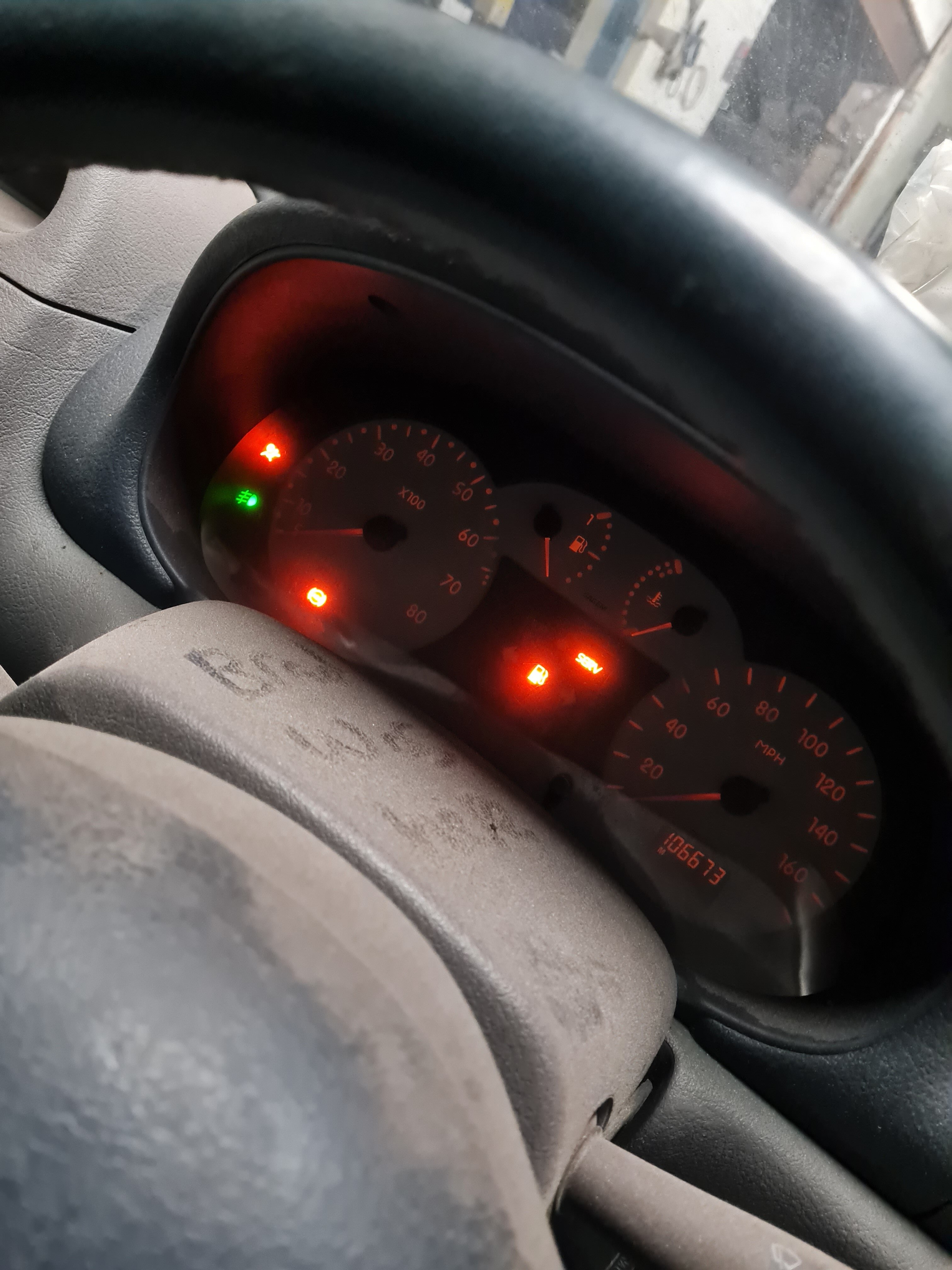

No pictures this evening but am going to put this up for anyone potentially having similar issues. Been tearing my hair out trying to figure out why it won't start, cranks over freely, immobiliser light goes out but no spark. All the more frustrating as I've had it going on squirty juice. Got 12 at the pump and coil pack but on cranking drops to 6v, similar story at the ecu pins. Ends up being the three plugs in the fusebox, upon pulling them out they had gone green with oxidation, a bit of a polish up with emery tape and some contact cleaner, jobs a goodun! Fires fire crank happy days.
Them's be the ones!

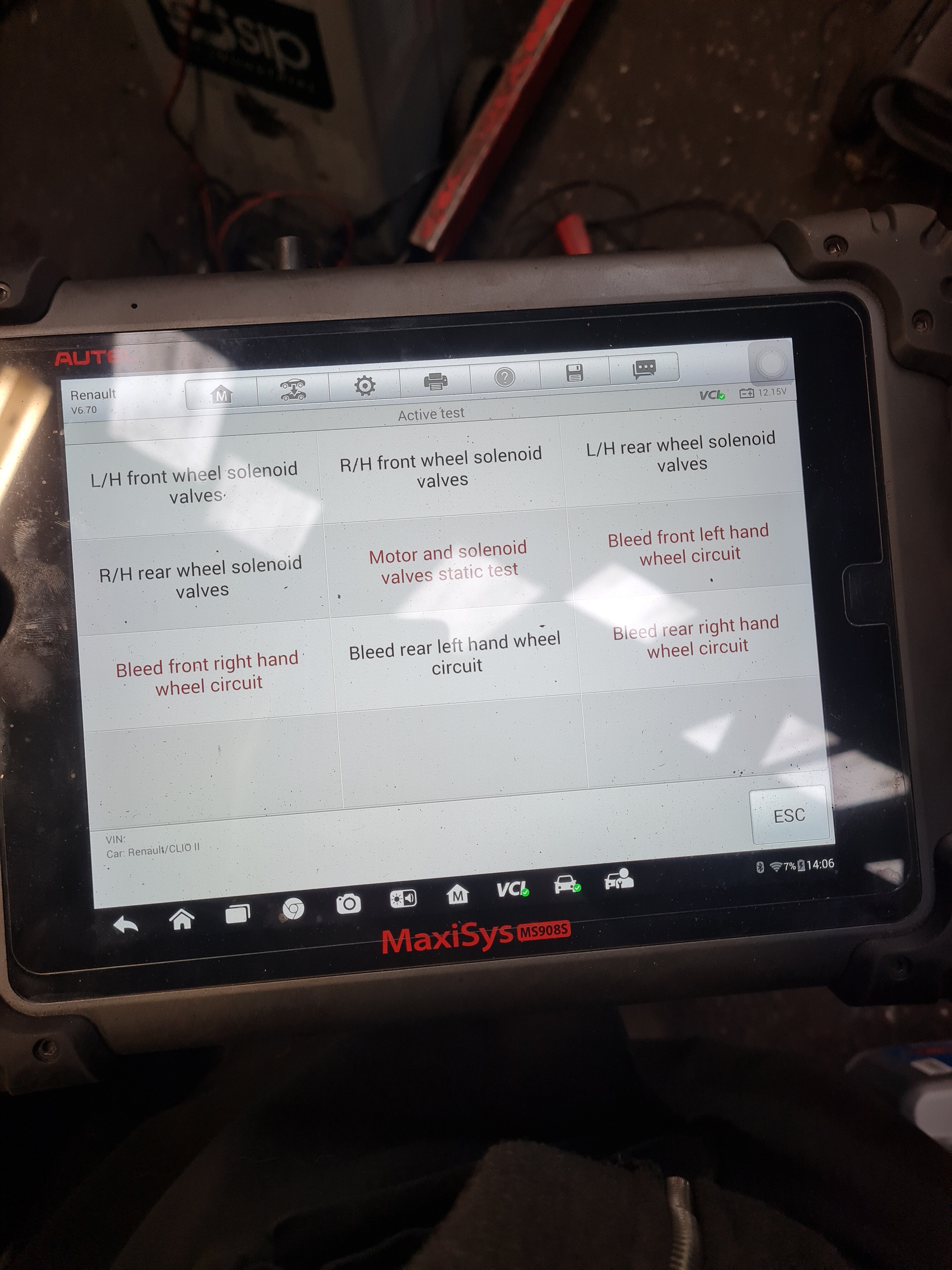

Bled all the brakes through the ABS pump on the Autel. Pedals got a lovely feel now, only problem I've got is a faulty rear right wheel speed sensor which after sitting for so long I'll chalk up to a win, may just want a clean up on the contact points 🤞

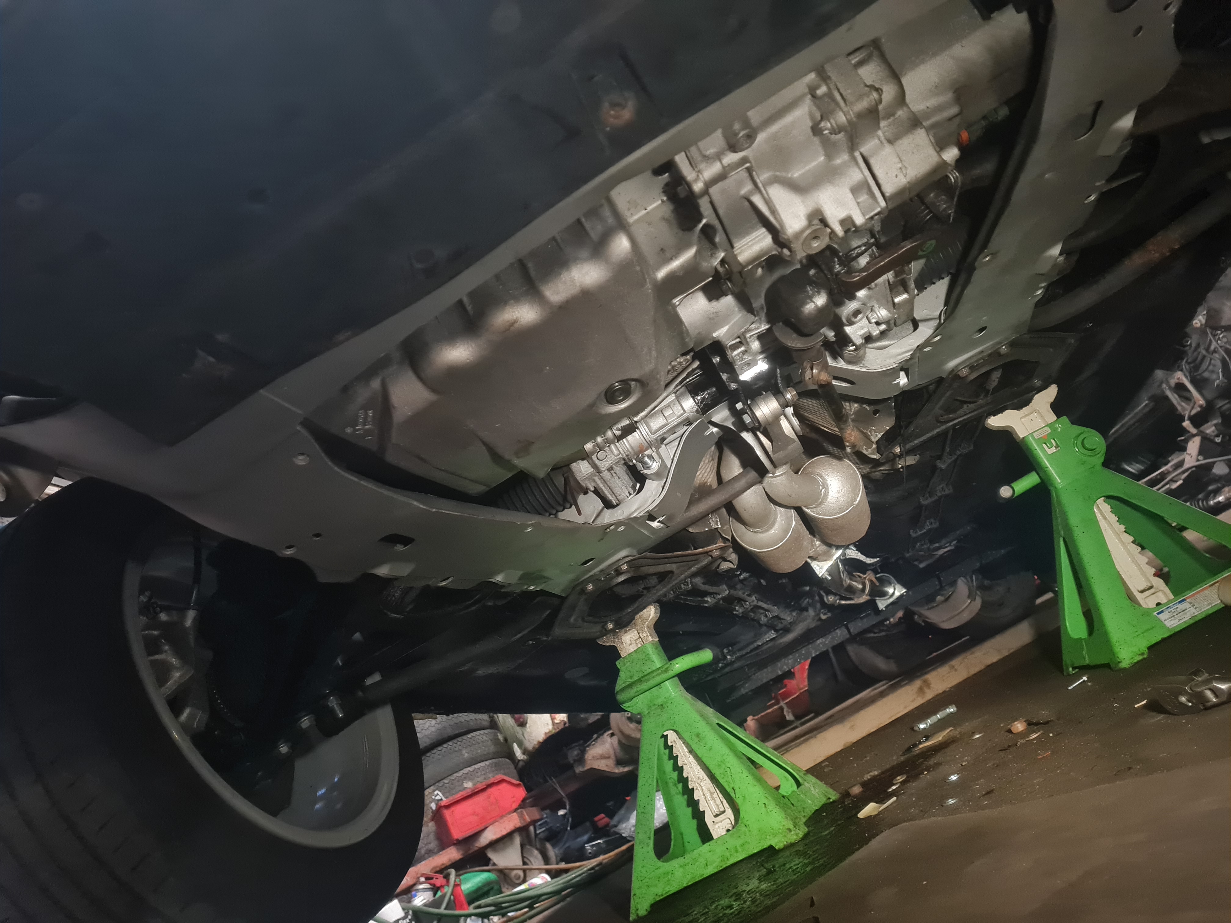

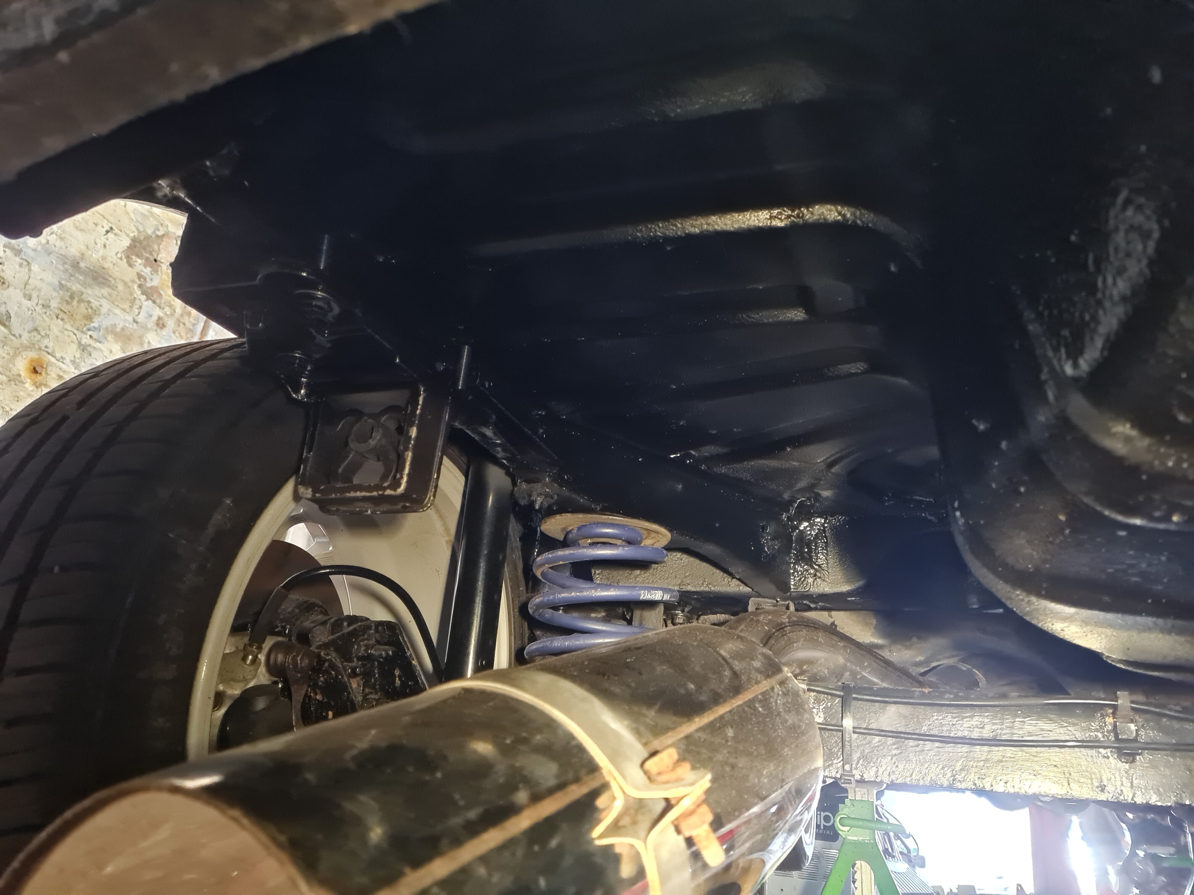

Dogbone came today, thought whilst I was messing under there I would take a quick picture before the undertray goes on. Rather pleased with the outcome, looks tidy enough.
Handbrake cables are en route for Friday, then It's just exhaust and rear abs sensor.
Big puddle is brake fluid, not going to explain why it's there, I will just admit to having a mong moment....😅

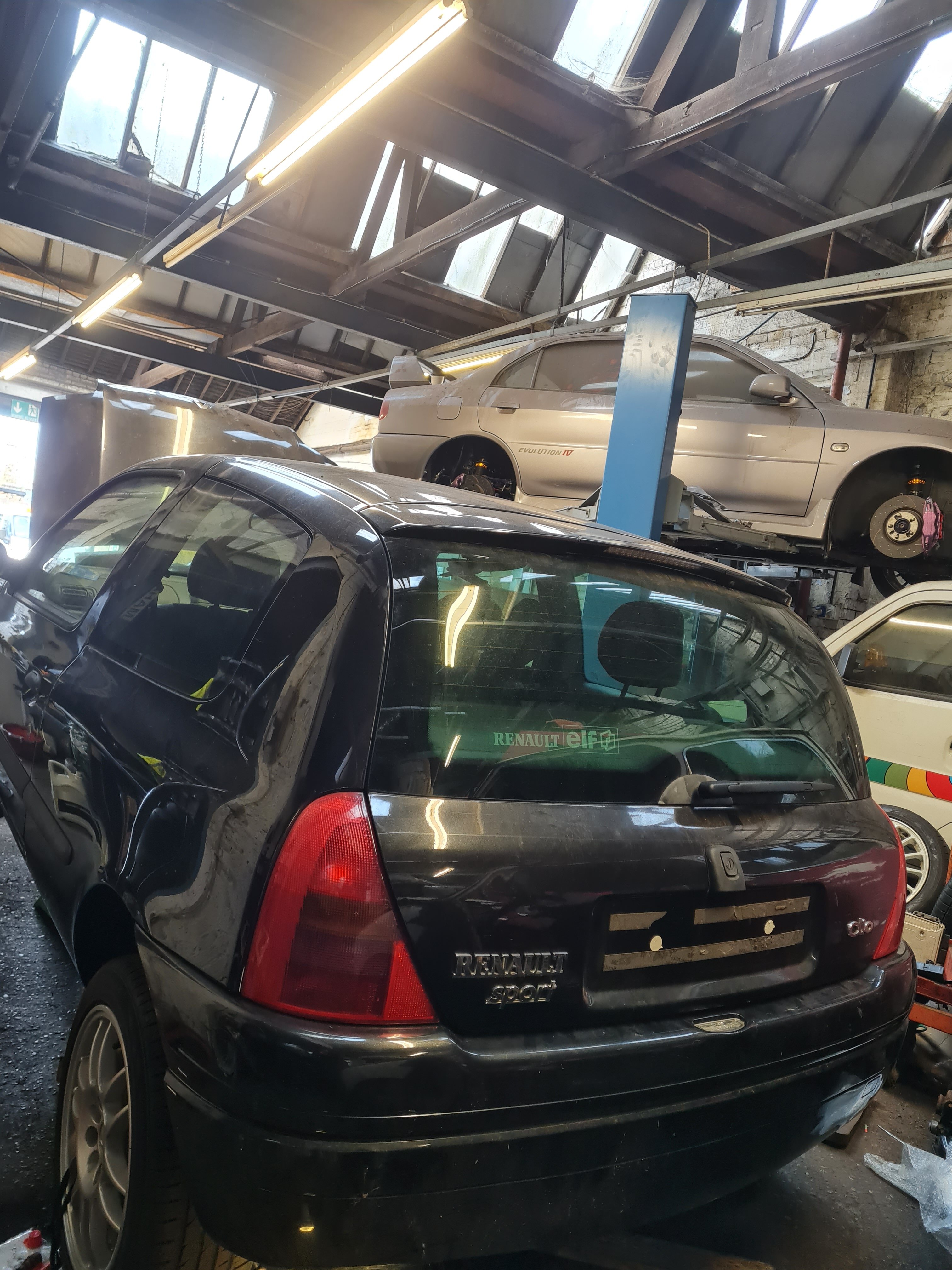

Rear bumper now fitted, can't wait to get it out and washed. There is a solid few mm of dust all over the car it looks awful!
Also fitted my rear exhaust mount, underside is still looking fantastic 👌

  Rb 182
Nice little write up. Good to see another being saved.
Your front caliper carriers are on the wrong side though, easy mistake to make.

Cheers mate, didn't know the carriers were on wrong, might explain the brake pedal having a slightly clunk at the top 🤔

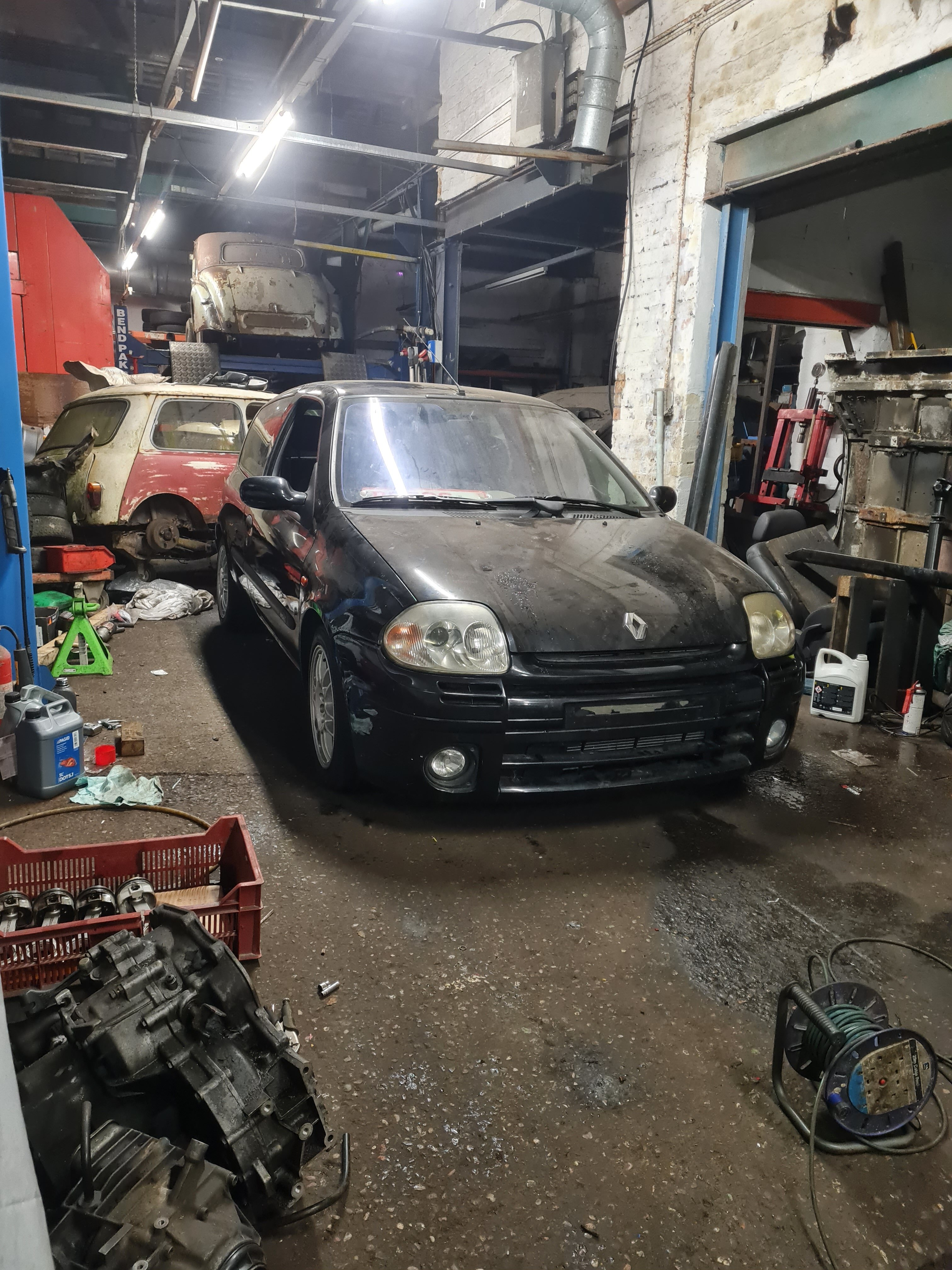

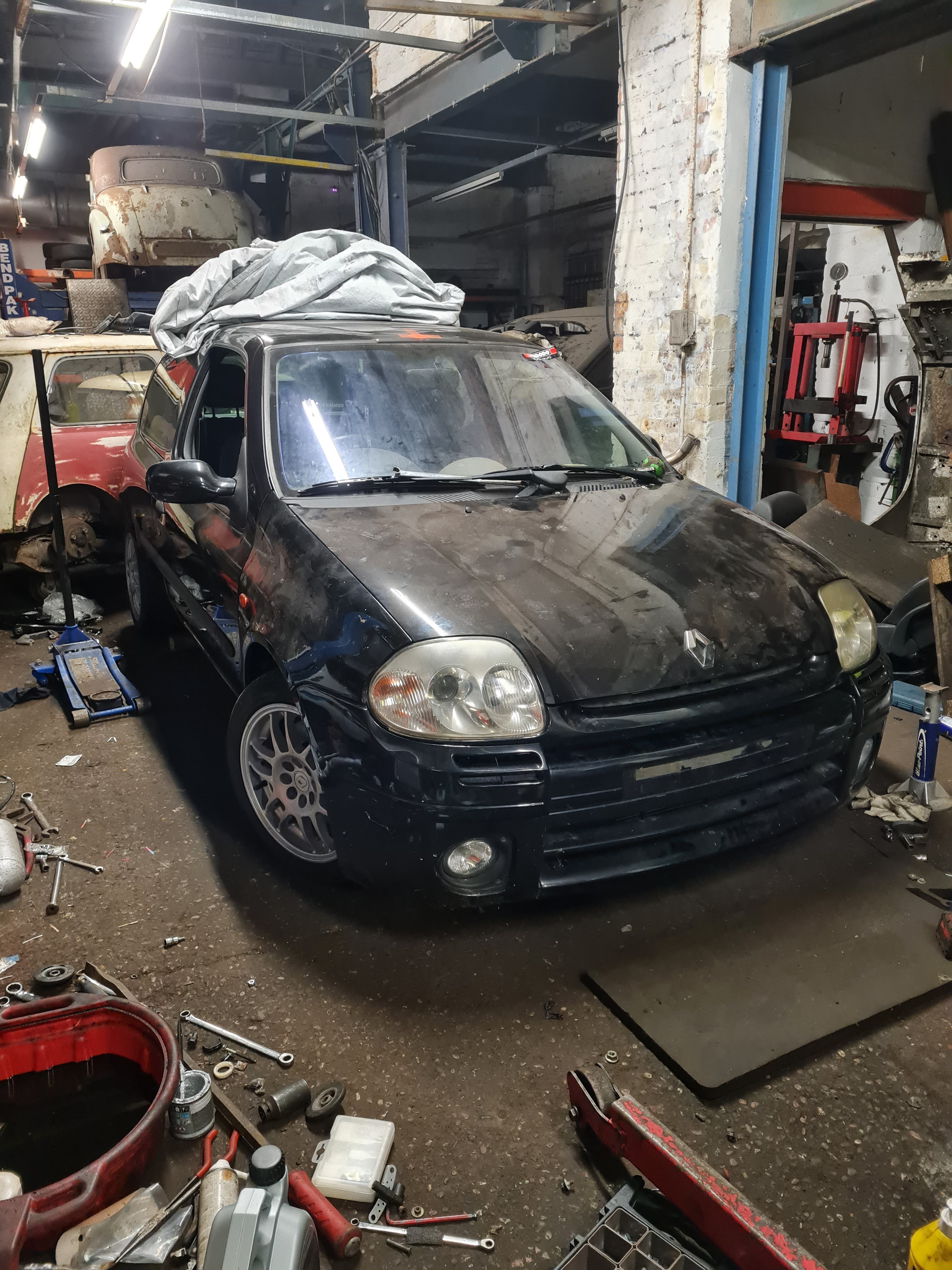

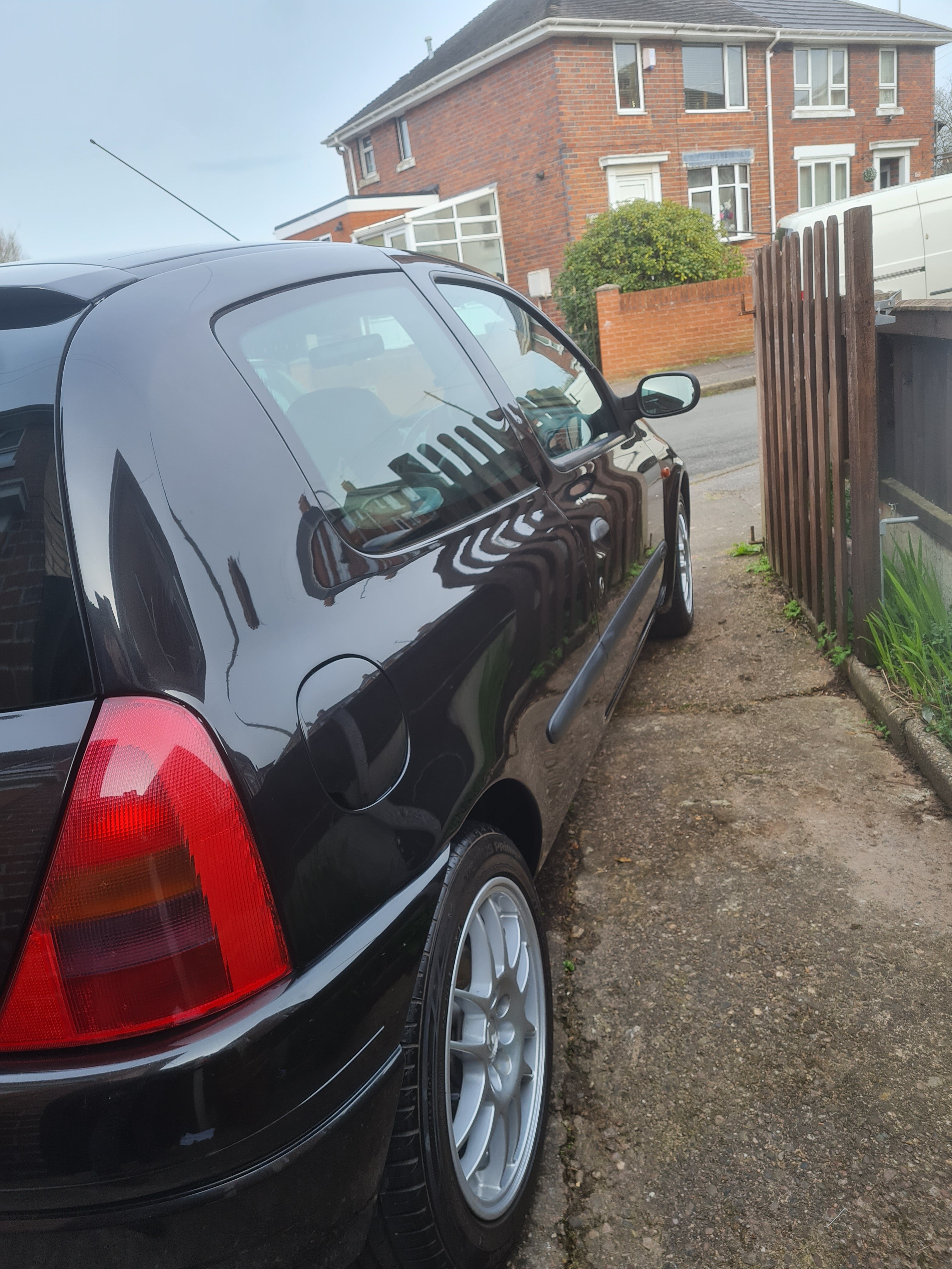

Outside today with year's worth of dust still present 😅
Daren't even touch the paint until I have a jetwash to hand.

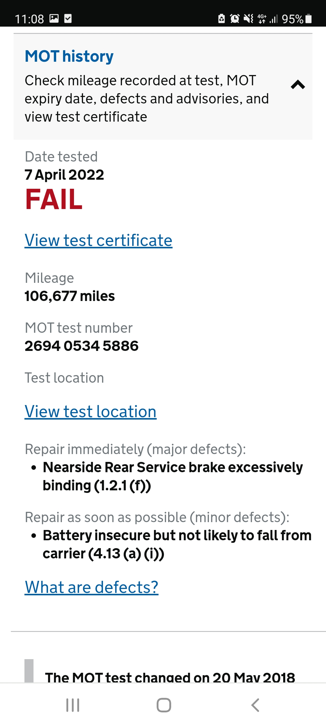

Went for pre-mot today, only failed on a few trivial items, the cracked glass and lack of handbrake cable being one but other than that just a few notes pointing to a few insecure braided brake hoses, stuck on brake lights (assuming the pedal switch) and a headlamp aim being to low. Result in my book!

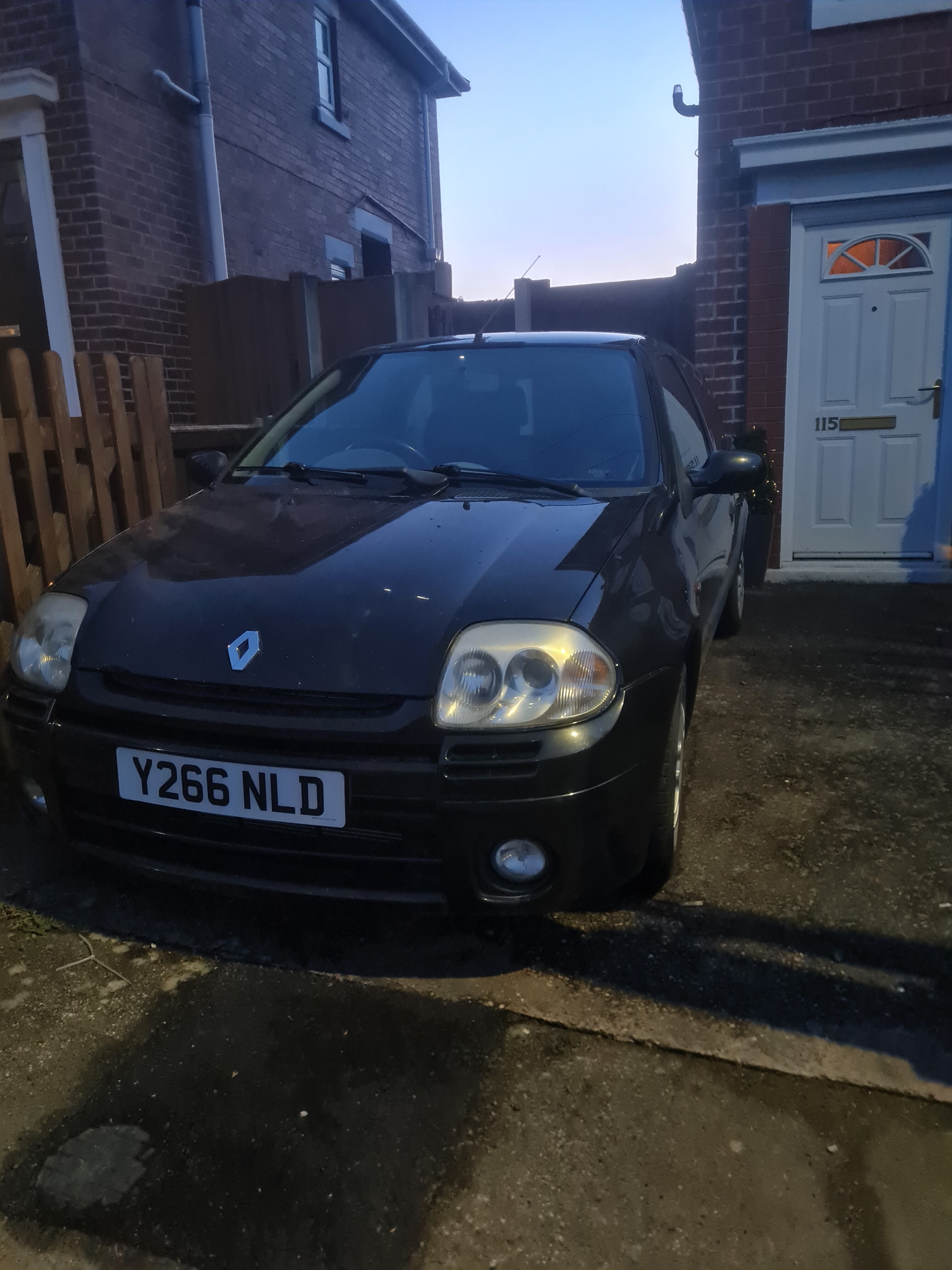

Slight update:

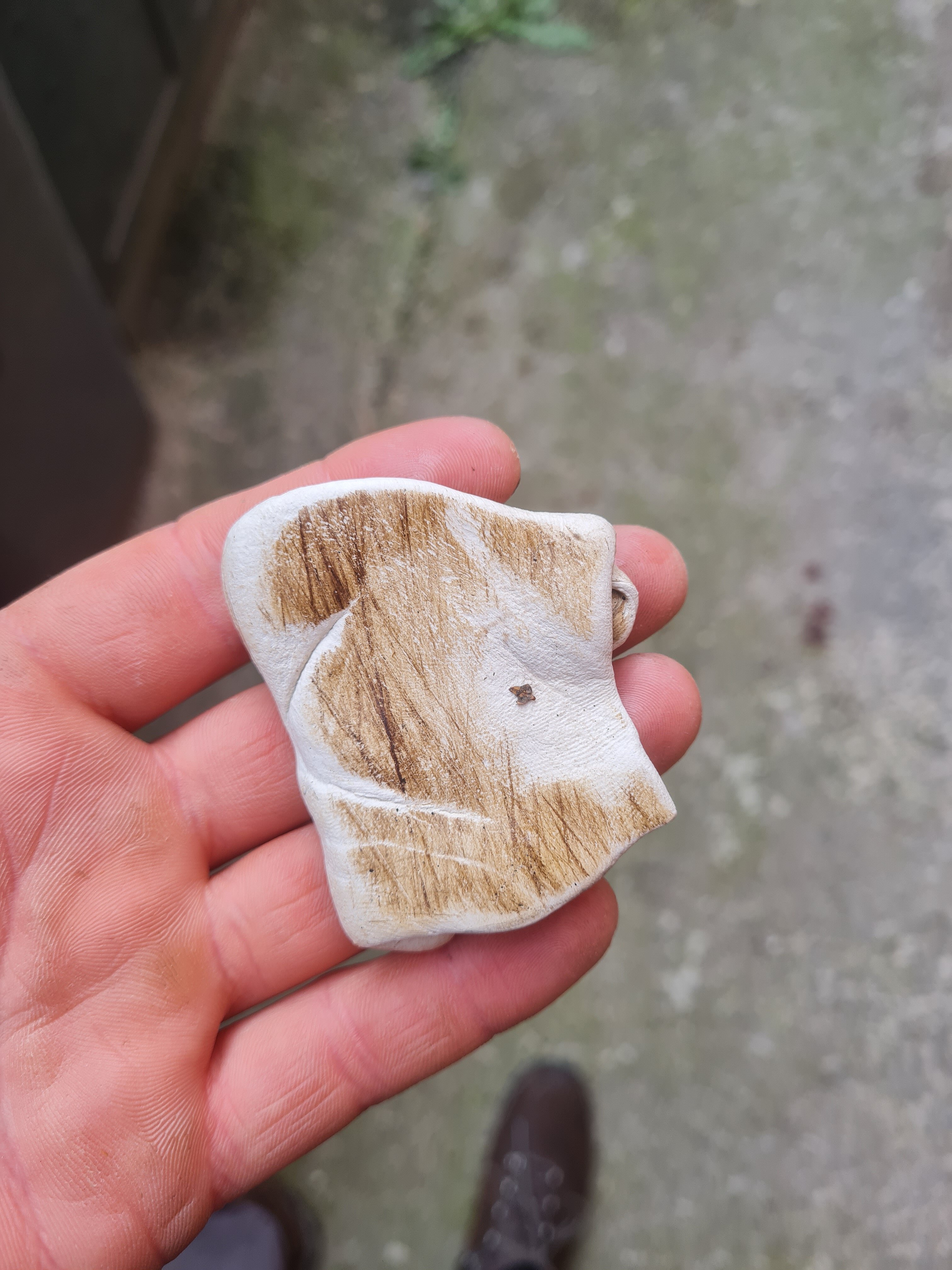

Got it home as it was getting in the way at the garage. On the few miles drive home it felt like I was driving with my foot on the brake. Both rear calipers have seized up, I'm assuming the handbrake mechanism is stuck on inside as the calipers have new seals! The discs felt like id done a few laps on track, fronts were also suspectly hot so I'm wondering if the big redd rebuild kit isn't quite as good as I thought 🤷‍♀️
Either way, knocked the hot spot off the disc to avoid cracking and am pricing up new calipers all around just to be safe.
