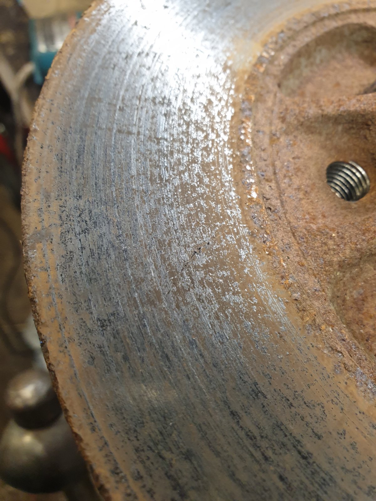

All pretty much went well after that, although had to buy a new set of pads down Europart (£7.75 for set of 4 I thought pretty good) as the other new ones I put on about 70 miles ago had big channels in them, where the disc was so uneven

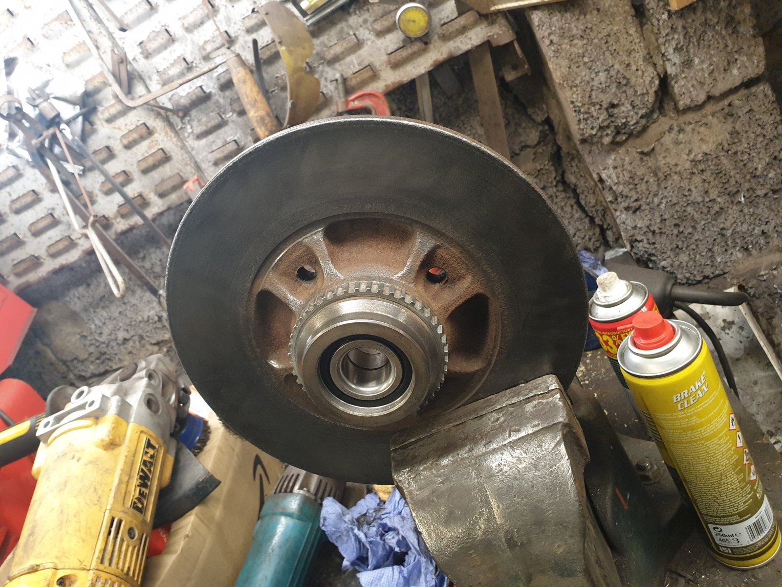

Had a game remembering which way the bearing on the hub face. And the hub nut was pretty strong to get off, but breaker bar worked well. BTW you get a new 30mm nyloc nut with the discs- well I did

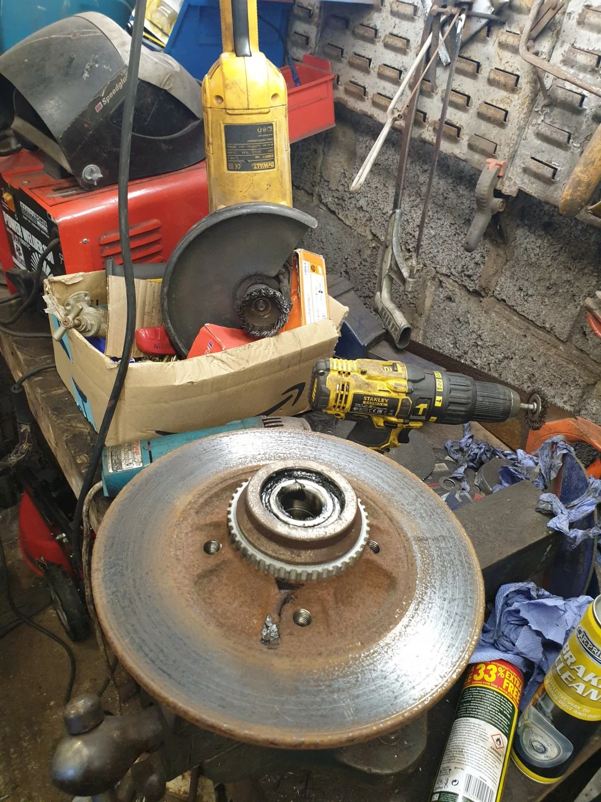

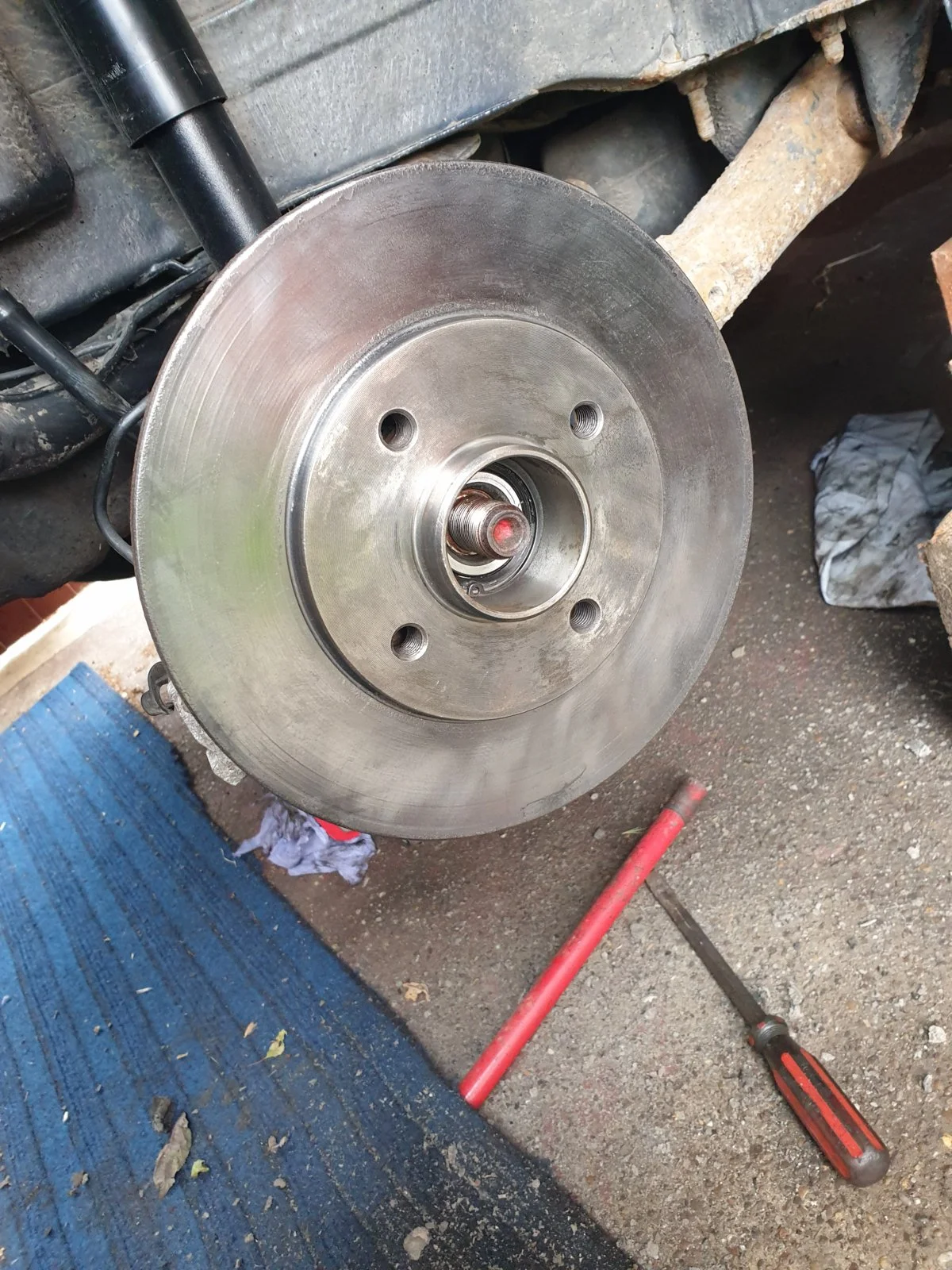

Cleaned my rear discs up as my 172 has been sat over a year
Came out like new and I didn't have to struggle with any bolts because I have the luxury of a strap-on 1/2 impact?? Just thought I'd post that to rub it in good and proper @chris blue ??

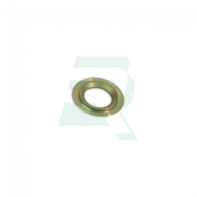

remember an check if you have spacers for your bearings. Not sure why tho. I'm sure someone on here will explain why they are there and why sometimes you don't need them.
As on my old disc's I had no spacer everything was fine but changed them and needed spacers before I could fit new ones.

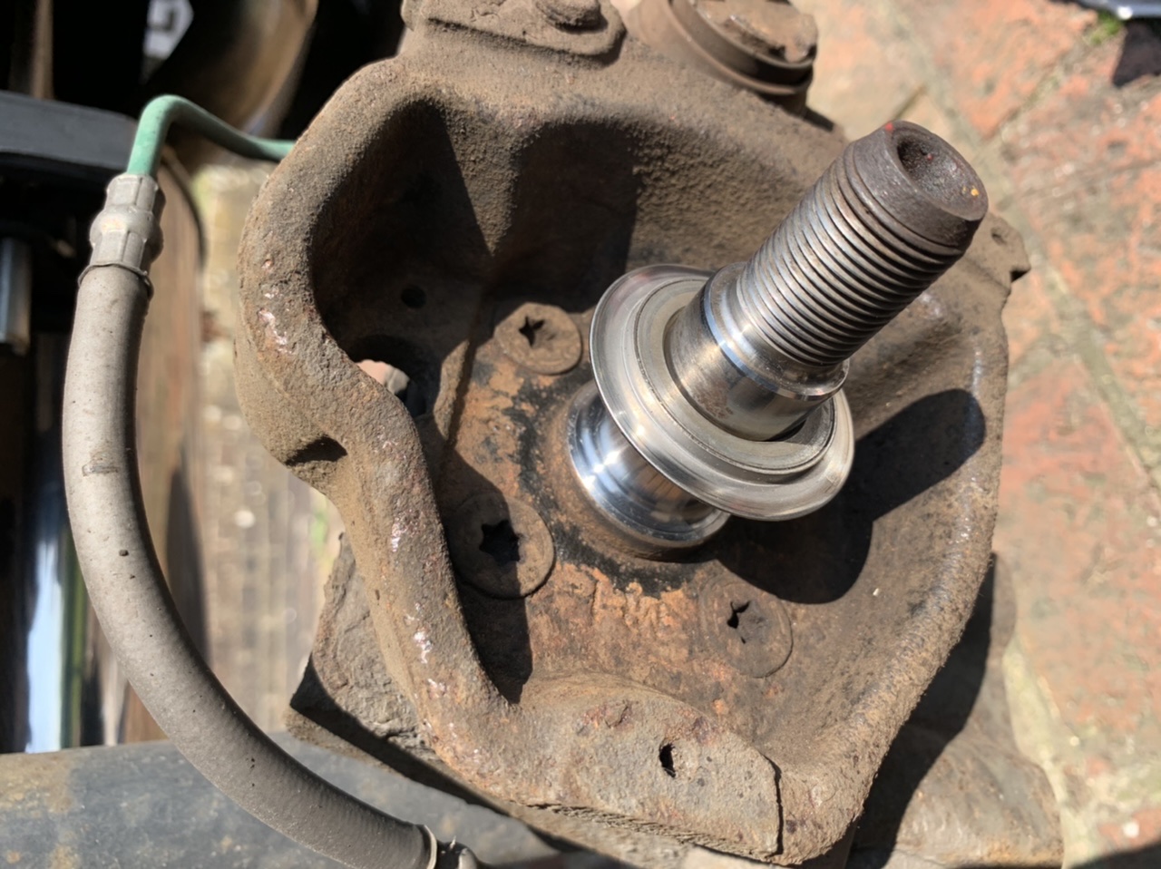

the spacer washers must be fitted/refitted behind all 172/182 rear discs, they're part of the design from the factory. They often get thrown away by mistake (stick to old discs) . They mate the flat side of the bearing casing to the tapered base of the stub axle , the bearings will fail prematurely if missing

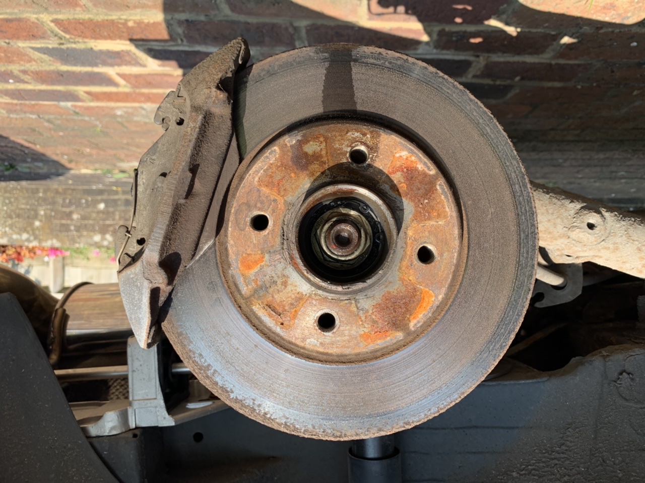

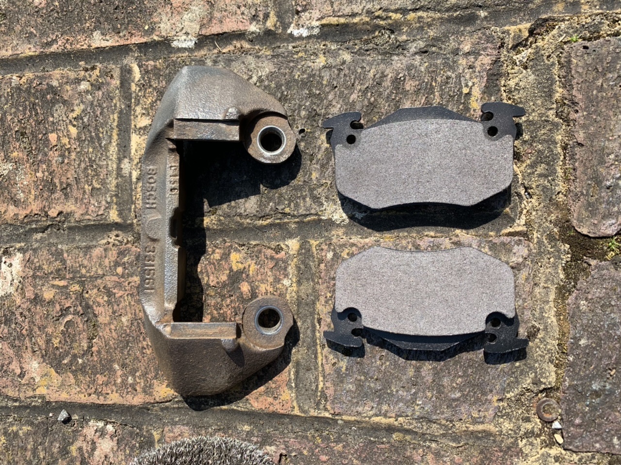

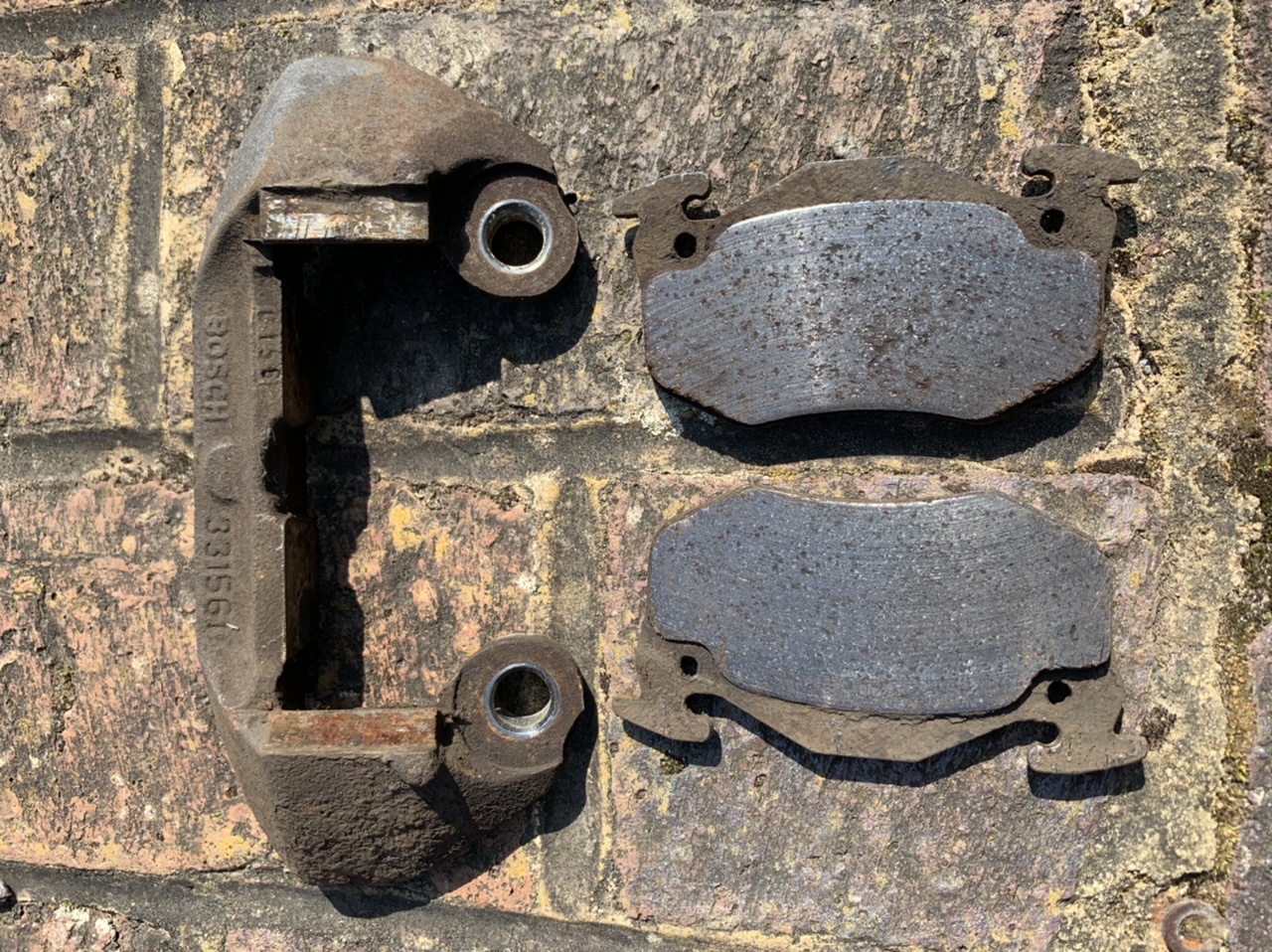

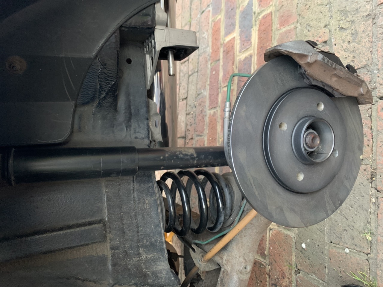

I’m doing my rear discs now, callipers and discs came off fine with the breaker bar. I've got the old spacer washers off and cleaned them up, along with the callipers with a wire brush drill attachment.
My question is where should I be applying copper grease before putting the wheel bearing/disc assembly back on? I know I need to put a bit between backs of pad and piston, and between disc and back of wheel, but should I be putting any on the stub axle, spacer washer etc?
I’ve got the 175 Nm torque for the 30 mm nyloc nut, is there a torque setting for the 17 mm carrier bolts? I think they were tightened to 1,000 Nm previously, or possibly superglued in.
Cheers. All done. I put copper grease everywhere just to be sure. The pads should scrub the excess off the discs I would have thought.
I hope I'm reading this wrong. Do you mean that the pads will scrape excess copper grease off the discs?
Apologies if I am reading it wrong and you already know this but grease on the pad friction material and disc surface is a bad thing
Sorry yes I was being silly. I obviously didn’t put it on the discs and pads. But I do sometimes find it hard to know where grease should be applied, I remember there being long running and often fierce debates on LotusElan.net about how greasing bolt threads affects the torque settings. And then further debates about using Loctite threadlocker. It’s a minefield.
phew 😎
