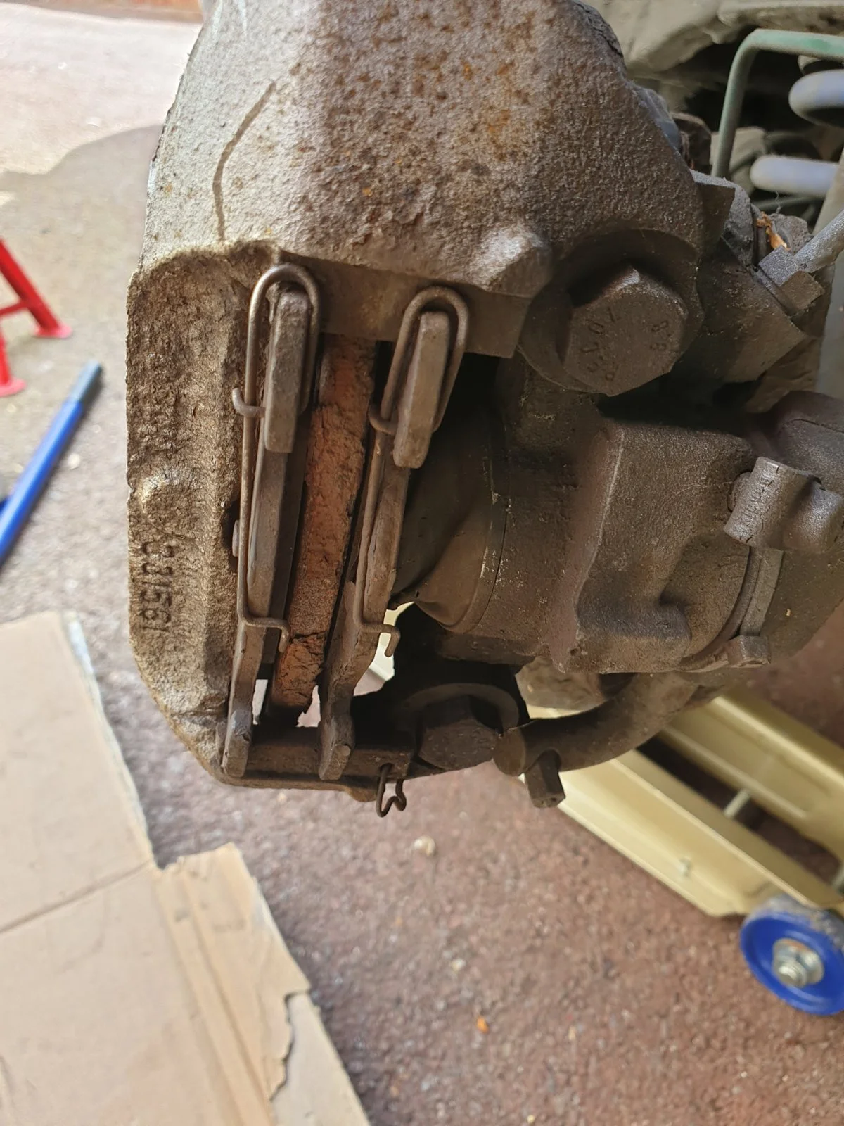

So- was looking at photo below, which is nearside rear, after replacing with new pads, and wondering whether the clips have been put in right?
Looks like both pad retenrion clips hit the brake disc surface? So gonna go back and have a closer look as the brakes squeal occasionally
As you can see from previous posts, i wanted to change both rear discs as the outer inch seems destroyed. Now i think these metal clips have been the destroyer!
Still havent loosened the seized nut ( which is the lower one in this photo but on the rear offside) and am waiting for a new 17mm hex socket, or will heat the nut up if that dont work, so i can finally change the knackered discs.

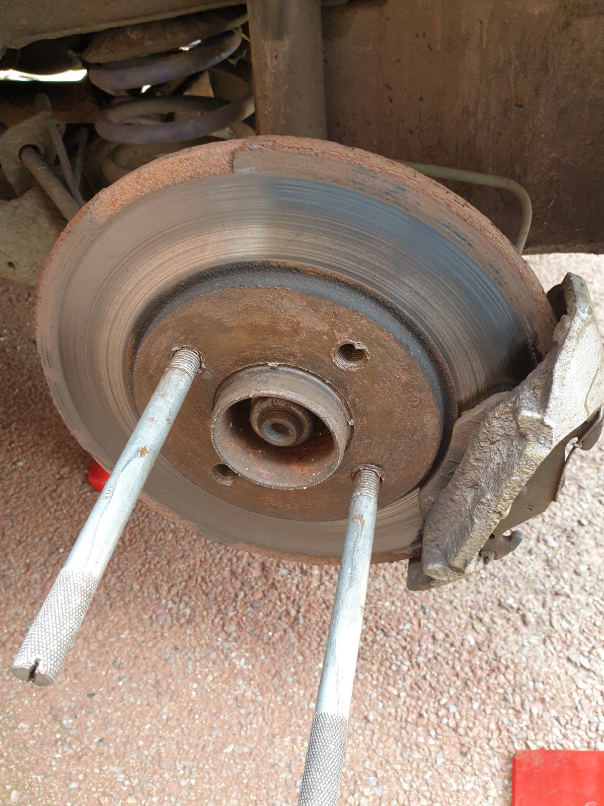

chris blue
  172 Ph1 2001
And this is what i mean about the state of the discs. This is the worse one, but as you can see on the outer rim, this is where i believe those clips have been scratching the surface?
Do those clips have to be there?
  182 clio
They look like fine to me. Are they touching when spinning disc?
you can remove full caliper by removing bolts at the back of caliper
They didnt seem like they were touching the discs when I spun the wheel after fitting the new pads, but looking at the photo I am gonna double check. All I could hear were the pads touching the disc just a little bit. The brakes do loudly squeal when full pressure put on.
OK, Will have a look at the bolts on the back of the caliper bracket. I assume the 2 bolts we can see in the first photo are to remove caliper only, and the bolts you are talking about could be holding the bracket, that holds the caliper? That make sense
Didnt see those 2 bolts at the back, but will hava look see. Hope they aint seized too!!!
chris blue
  172 Ph1 2001
If you look at the rusty bit about 6 mm in the photo, between the 2 clips, that's the disc!
They both look like they are touching it- might just be the way the photo looks
EDIT: Thinking about it, the clips will bee on the edges of the brake pad, so should be quite a few millimetres away from the edge of the disc, but will look.

Your telling me . LOL. But then again the fronts do %80 of the work, and they have new (1144) pads, and discs are good
  182 clio
And I still reckon it could possibly be those clips that have scratched the, outer inch or so, discs to bits like that
I think it's your pads buffing away all the build up of rust etc.
doubt those would even get close to touching as far down as that.
It honestly looks fine to me.
Just to replace disc's. ?
Krarl
The problem is that you've let the pads get so b*****d low and the boot on the caliper piston is shagged so your piston is probably caked in s**t and sticking now too which will cause it to bind
If you don't have the clips in then your rear pads will fall out and you'll have an even bigger headache
To me, that bar inserted at the bottom of the pads seems to fix the pads in place with great force. Cant see 2 piddly pieces of wire holding them in place.
But hey, what do I know :)
  182 clio
the bar is there to stop the pad rattling when moving along uneven ground etc.
which is most of UK ?.
Krarl
Bottom bar is to stop rattle, spring clips are there to retain the pads when pressing against the mating surface.
