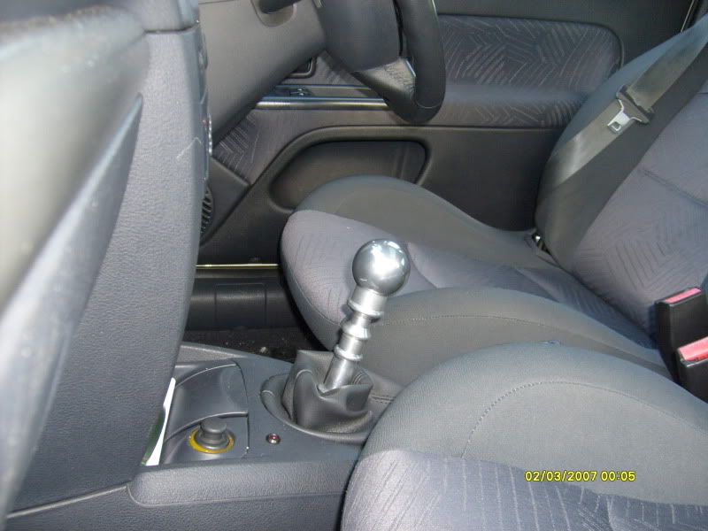

It's quite simple: a short shifter has different dimension compared to the original gear lever and gear linkage and this causes different ratio in the movement (at the gear lever and the small gear linkage).
I have a DIY short shifter conversion kit for Clio Williams and Clio Mk II, which looks like the genuine gear lever but gives reduced movement (25 or 30 percent depending on which small gear linkage is used):

Fitted into my Williams:

(The angle is important in that case if you lenghten the gear lever above the ball joint... may cause problems if the 5th is too far from me (uncomfortable - left hand drive). Now I'm using a 'Fast Road Shifter' (also designed by me) in my Williams which is lenghtened by 35 mm (compared to the genuine gear lever) but moves in the same throw lenght as the genuine one and the 'shift force' (the force to select gears) is easily adjustable in wide range from the driverseat. 2 pics:
I love it because the gearknob is closer to the steering wheel and does not move in a longer way and I can determine the shift force from sloppy/very easy to stiff(er).

Ah ha excatly what i'm looking for an extended lever with short shift, Can you make one for the Phase 1 172? I be willing to purchase one if you can.
Yanoo
  Clio Williams
I have a spare set of extended gear lever. Although it's developed for Clio Mk 1, but the whole Clio MK 2 gear linkage (including gear lever and gear lever housing ) is very similar to the Clio MK1, therefore I think it would fit well in your Clio. Please drop a PM for details.
