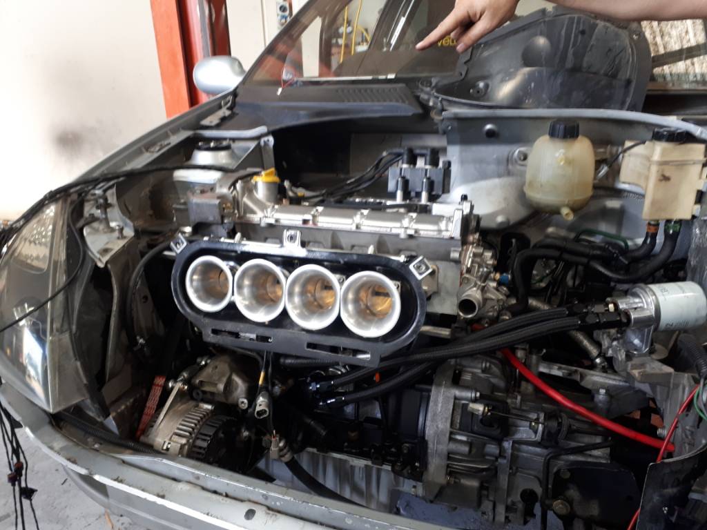

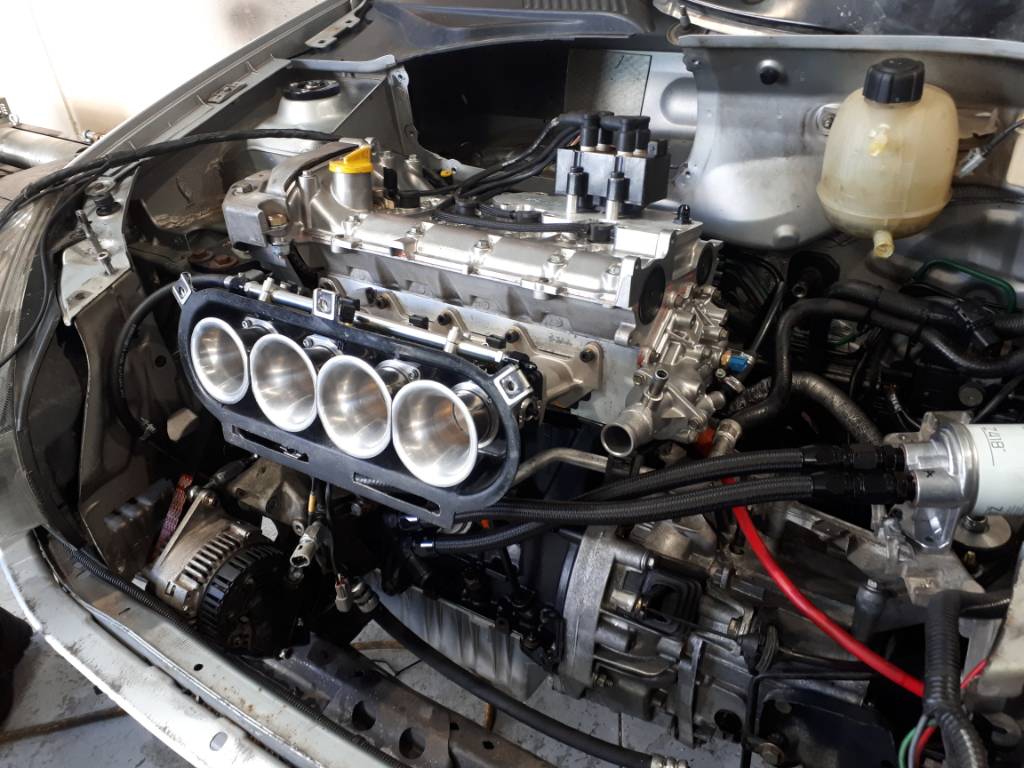

The engine is finally together and going in with the 5th gear upgrade and the quaiffe tommorow.
Its looking beastly

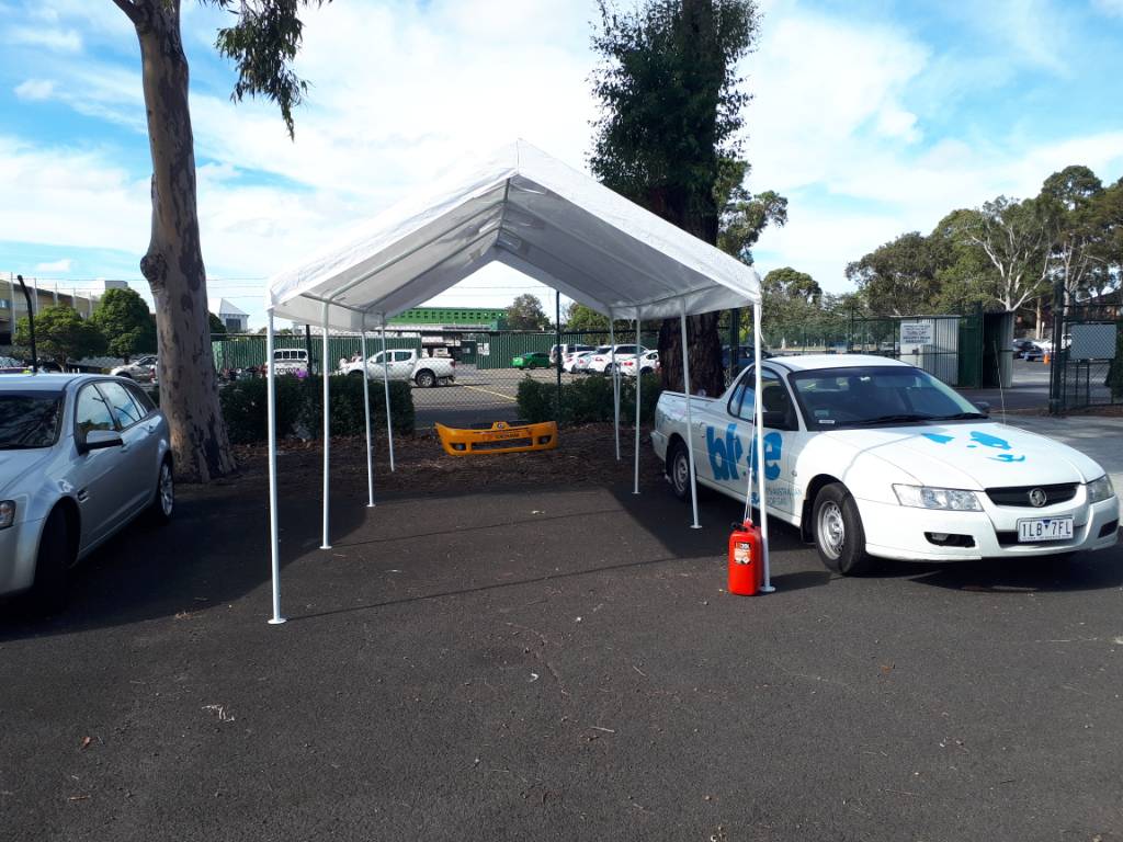

See my carport below its missing my friggen car.

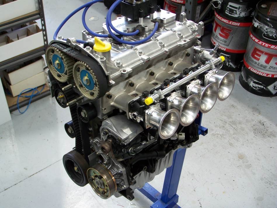

Enjoyed reading this, such a shame that its not ready to be picked up. The engine looks cracking!

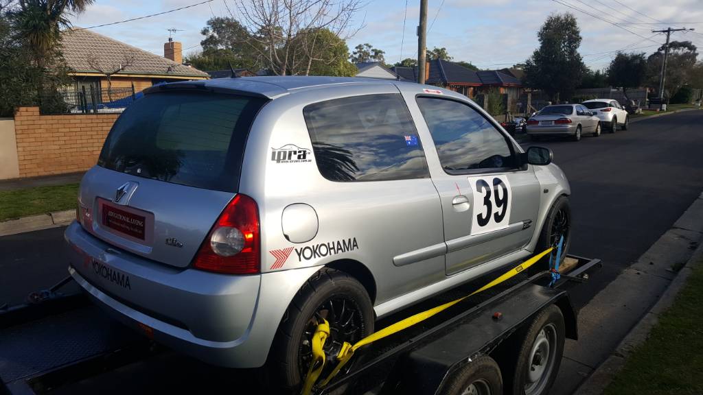

Im pretty sure ive seen pics of your car last week. Did you have a guy called Anthony who has a red Trophy helping you with your rear brakes and had a bleed screw break. Car looked amazing in his pictures if it is yours - was a silver 172 with silver brembos, cant be too many in Melbourne.
Shame it wasn't ready, what sort of times are you expecting at Sandown ?
I would expect to be near the top of the time sheet which makes it even more frustrating
3 x 13 racing. 3 x the luck
No that must be a differenyt one. There was a silver 172 at the last MSCA track day, I think that might be the car your thinking of. He has some good PMS bits on his car.
