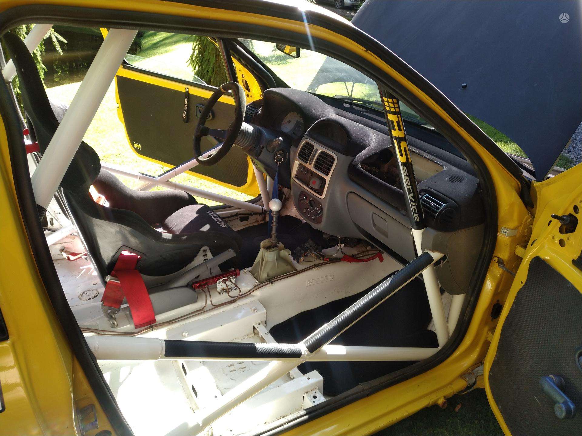

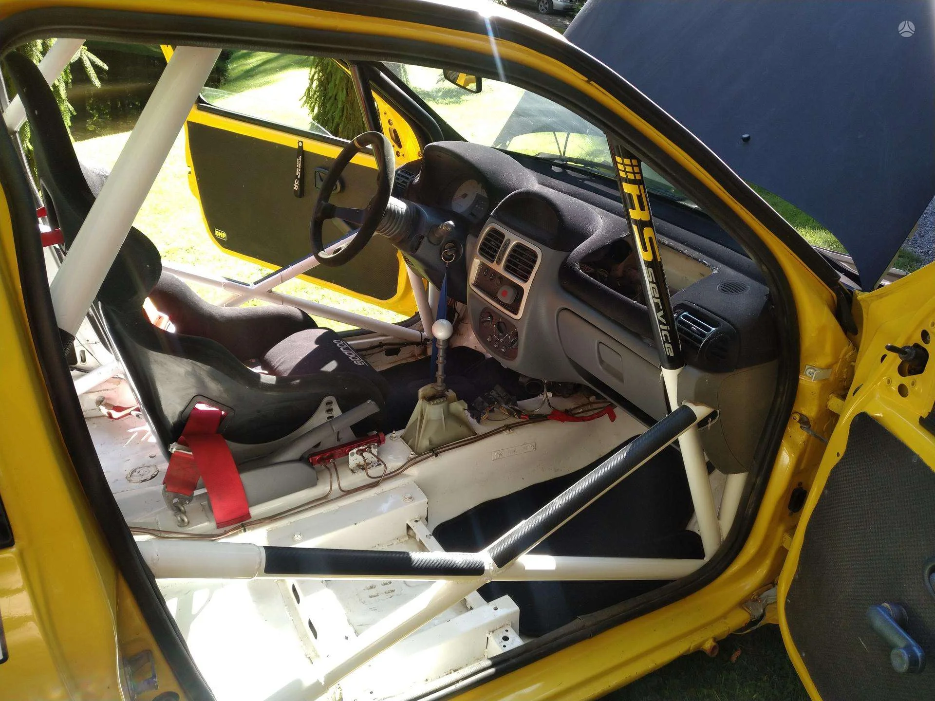

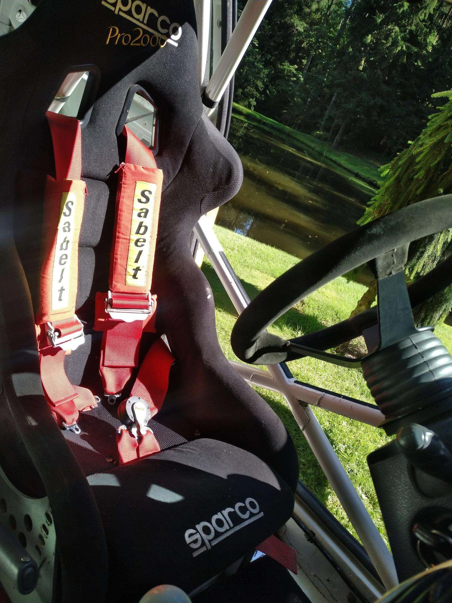

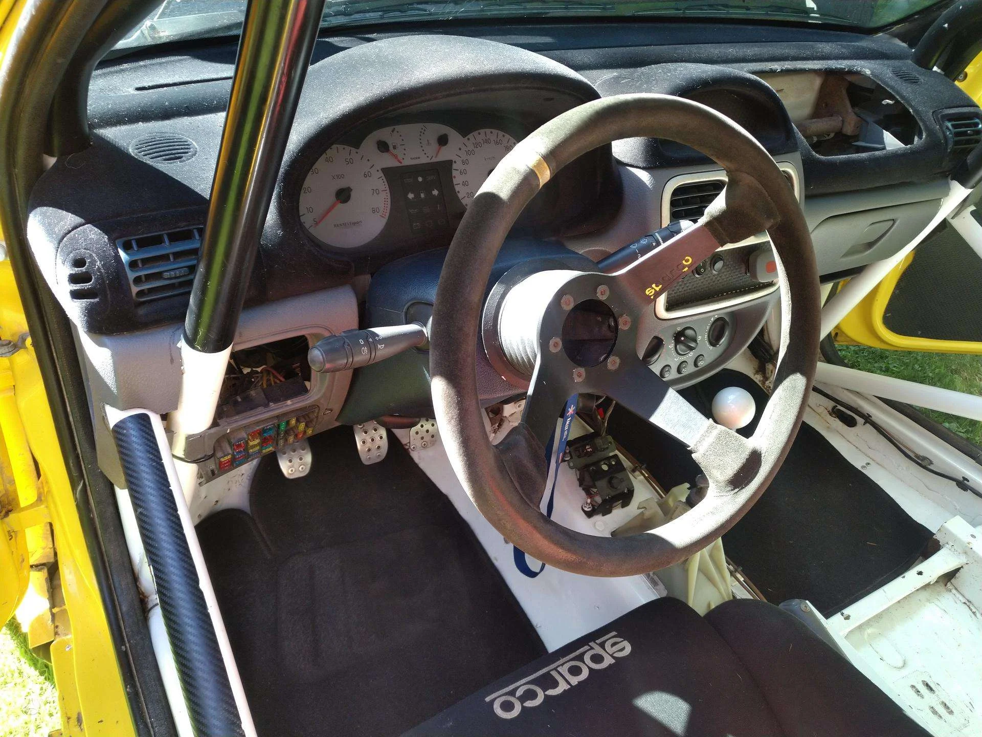

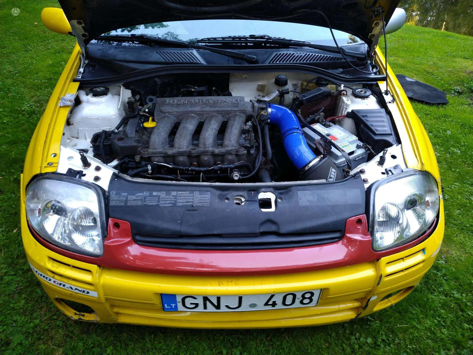

Good bits:
- Full cage

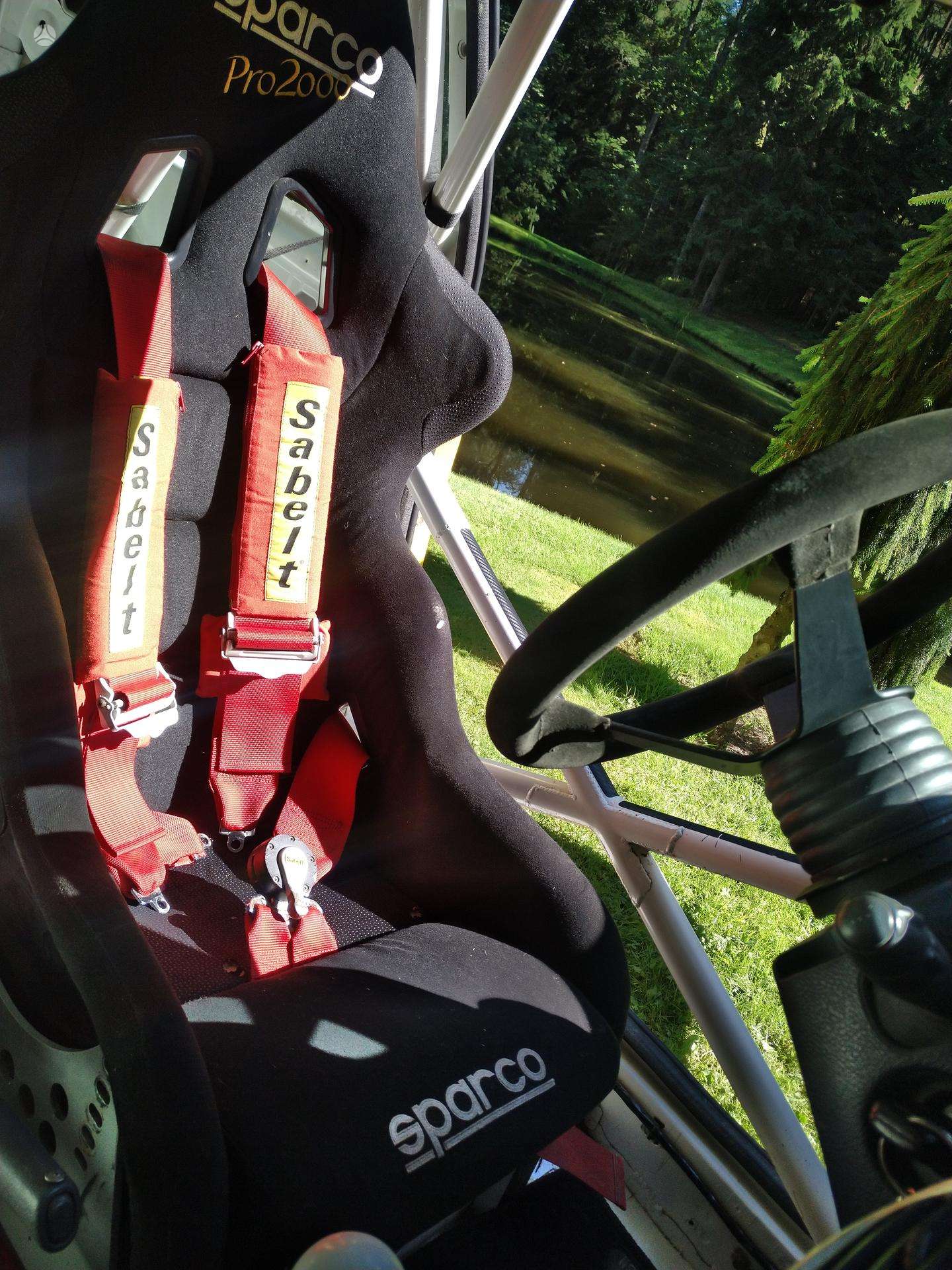

- Seat, belts, steering wheel, flocked dash
- Brake regulator
- Custom rally shocks
- 182 gearbox

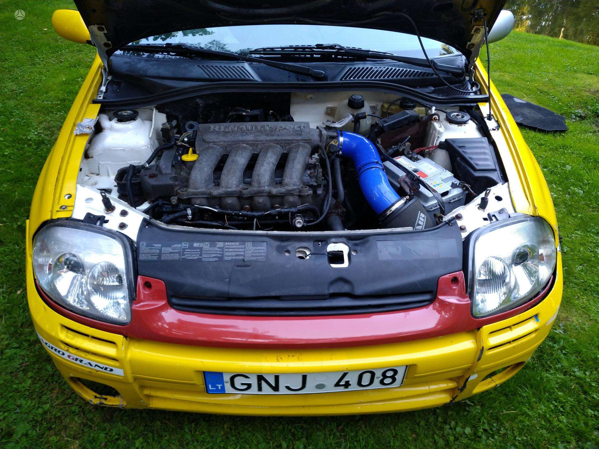

- 182 mani + 2.5" custom exhaust
- Rally sump guard
- Custom intake
- Custom engine mounts.

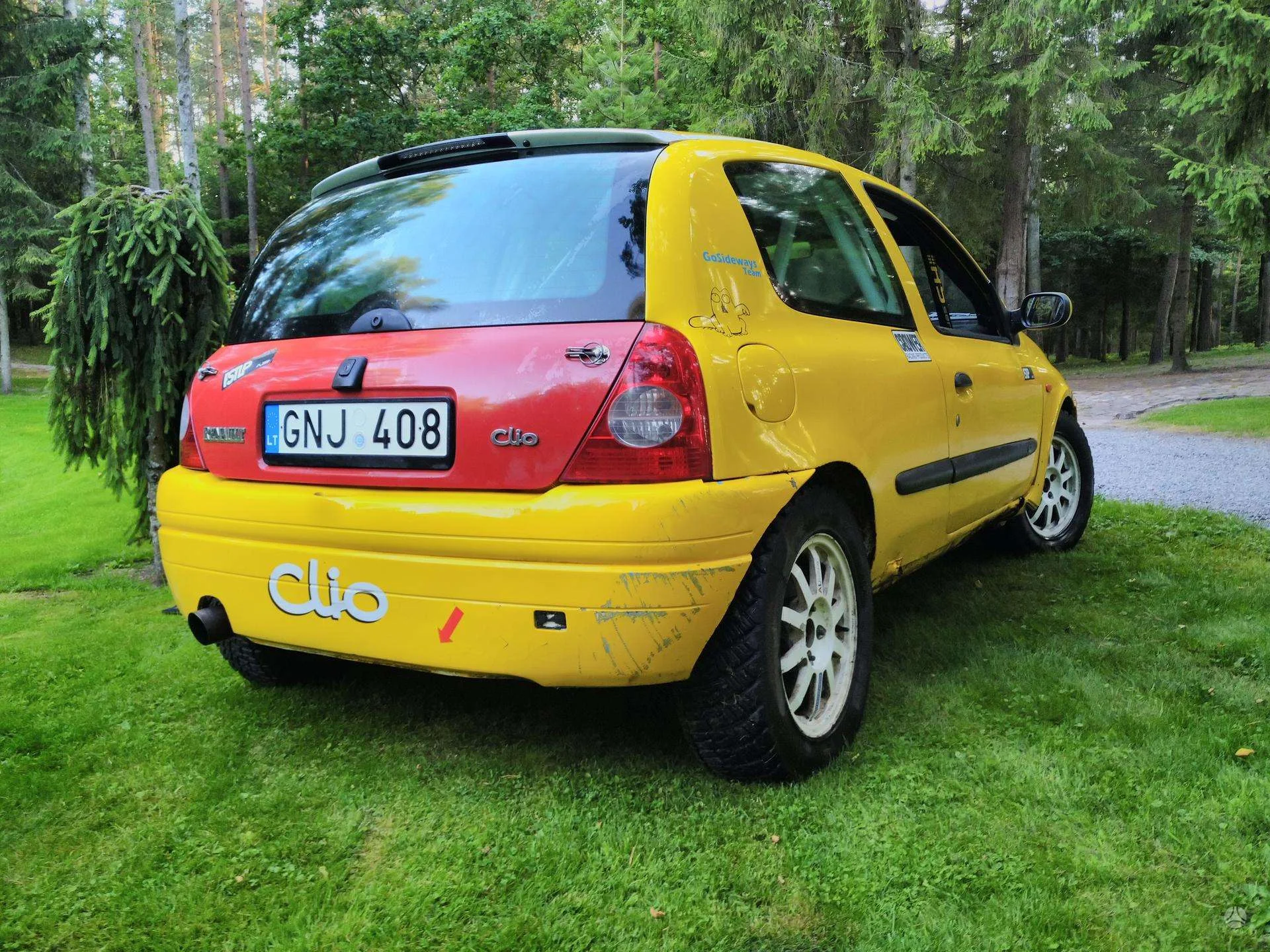

I would like to cut out the old side skirt parts and re-weld new ones. However, for the life of me, I cannot find body parts for this little Clio.
If you do know who makes fiberglass bumpers, fenders, side skirts, or have some ideas please let me know.
Also, the brakes suck, but first I need to get out there and test the car properly.

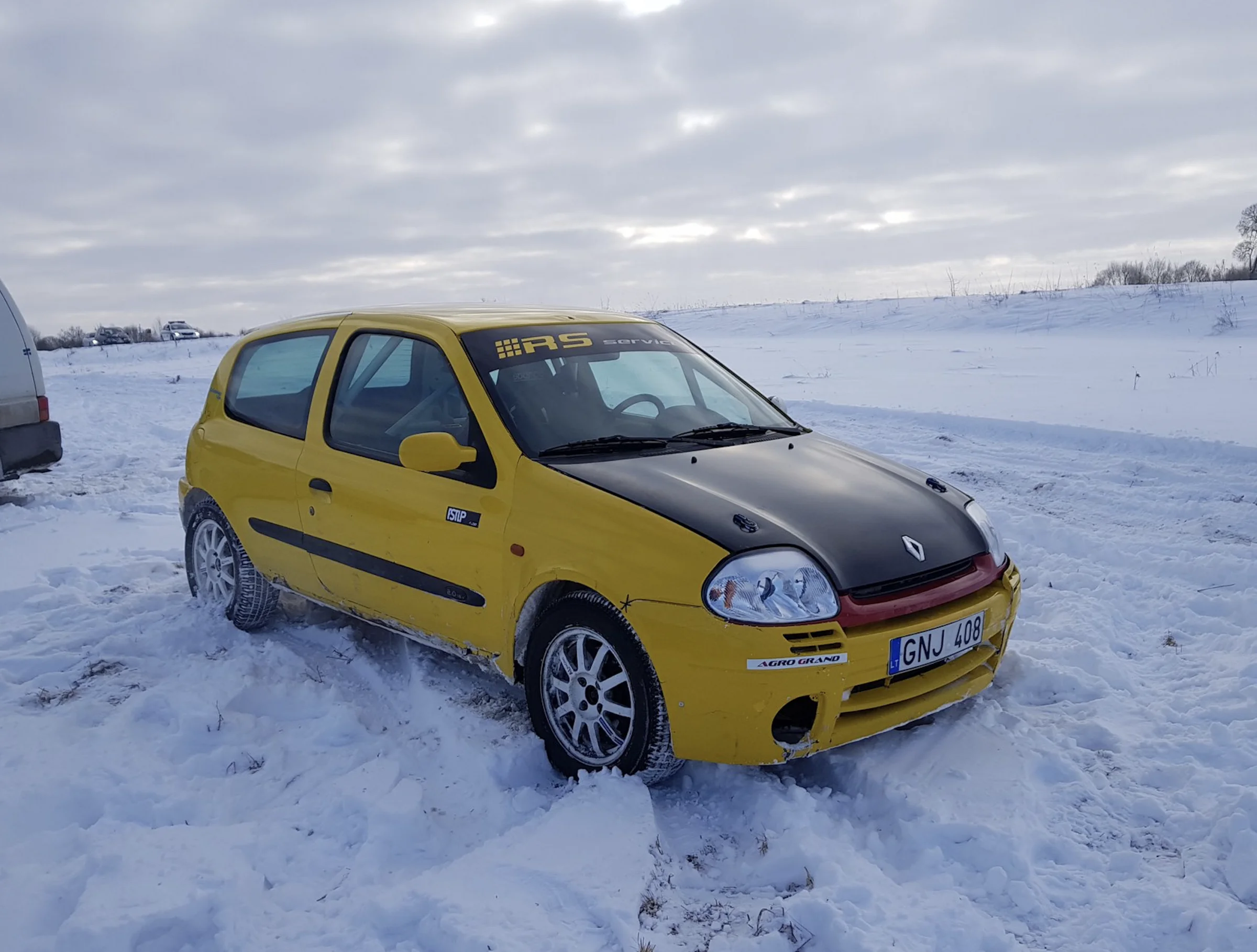

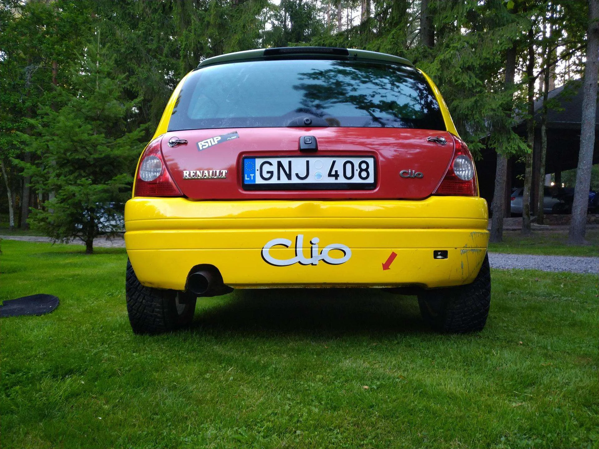

I wonder if you can find how many different Clio's are in my car?
I plan to keep this ridiculous theme going with mismatching colors.

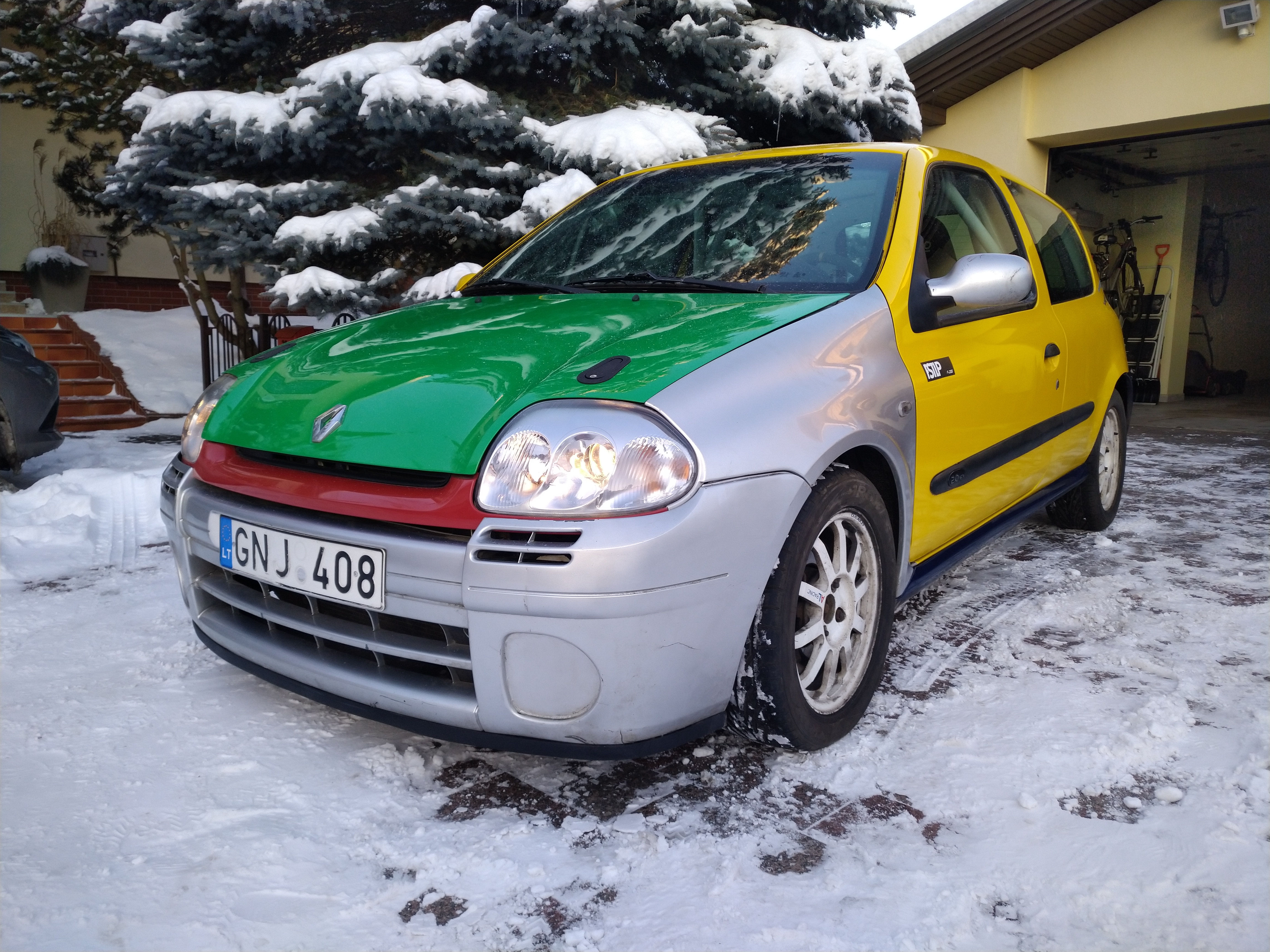

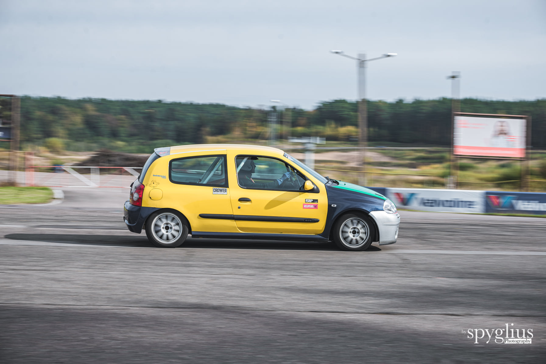

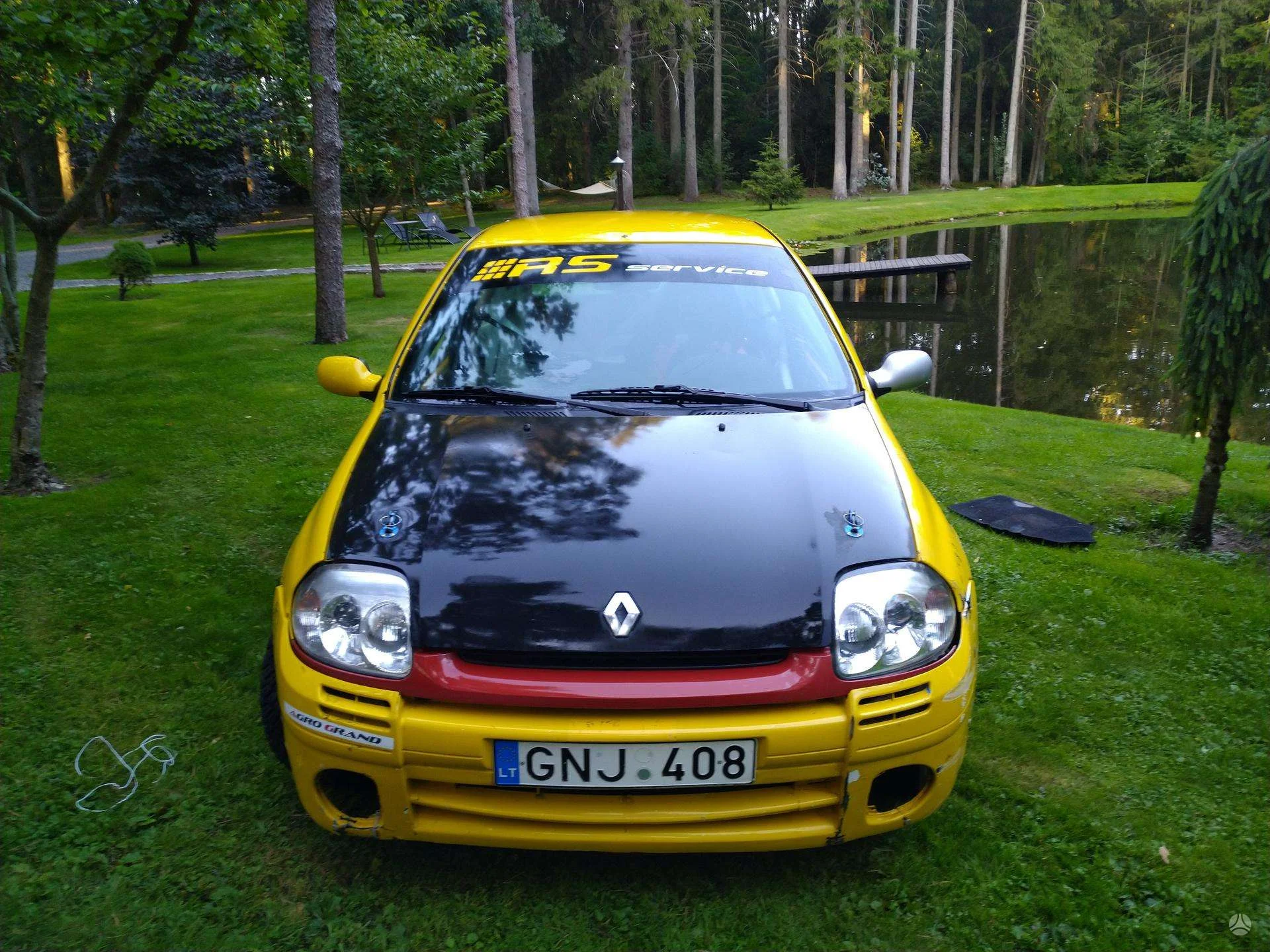

Update time!
I had quite a bit of work done to the little Clio.
- Spark plugs changed
- T1R tires
- Grams springs with cup shocks
- Exhaust fixed
- New brake rotors, pads, and calipers.
- Fixed the brake bias regulator.
- New alignment, camber of negative -1.5.
Question of the day - what is the best camber/toe set up for track days?

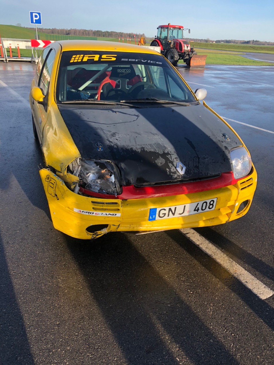

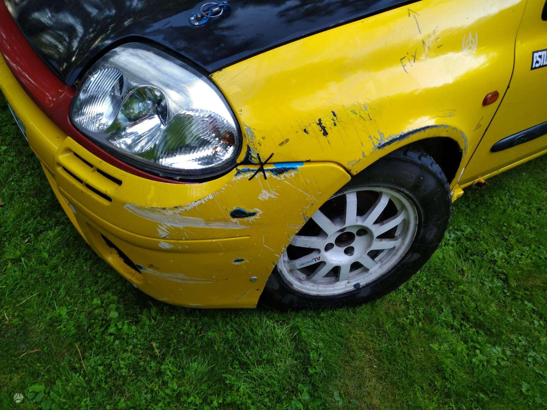

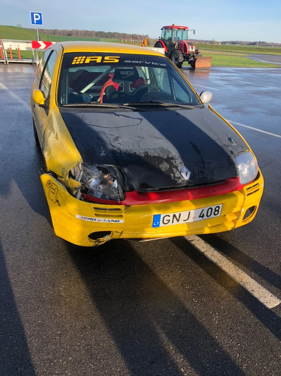

Also, it just happens so that one eye of the car got punched out.

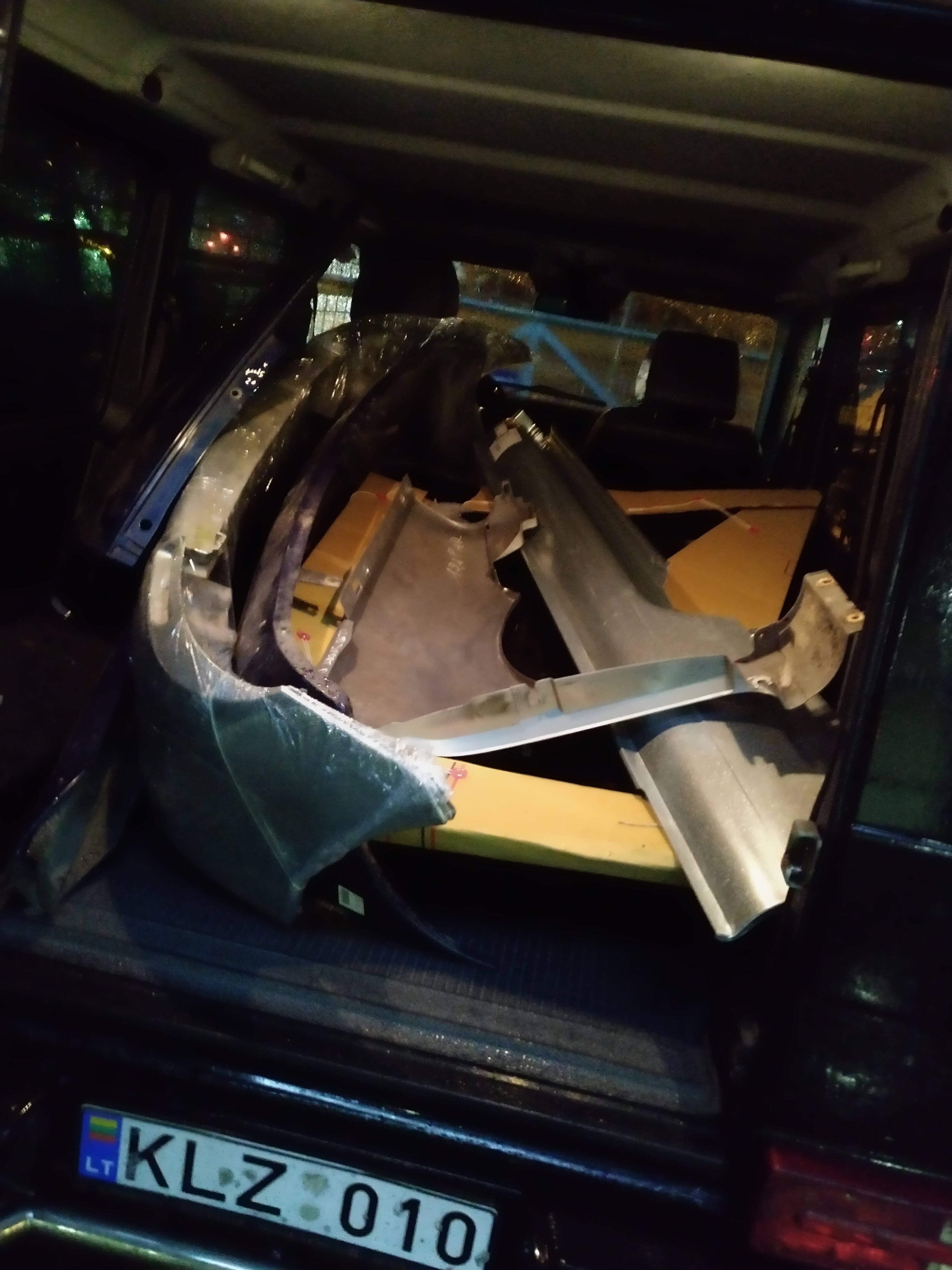

So, I have looked all over the world to try and get these used or new parts for my car, but they are now ULTRA rare it seems.
I got myself a new bonnet, new headlight, and a side skirt/body metal repair kit for the rust.
Furthermore, I found used front bumper and both front fenders! I am so glad I got them.
Also, got rear bumper and both sideskirts from a 172 ph2.
Lastly, I got a fabia splitter.
I cannot wait for my beat up rally car to become a colorful refreshed frankenclio for track days/road racing.
There is still a weird noise of rubbing coming from somewhere and quite a few issues left with it.
I will keep you posted!

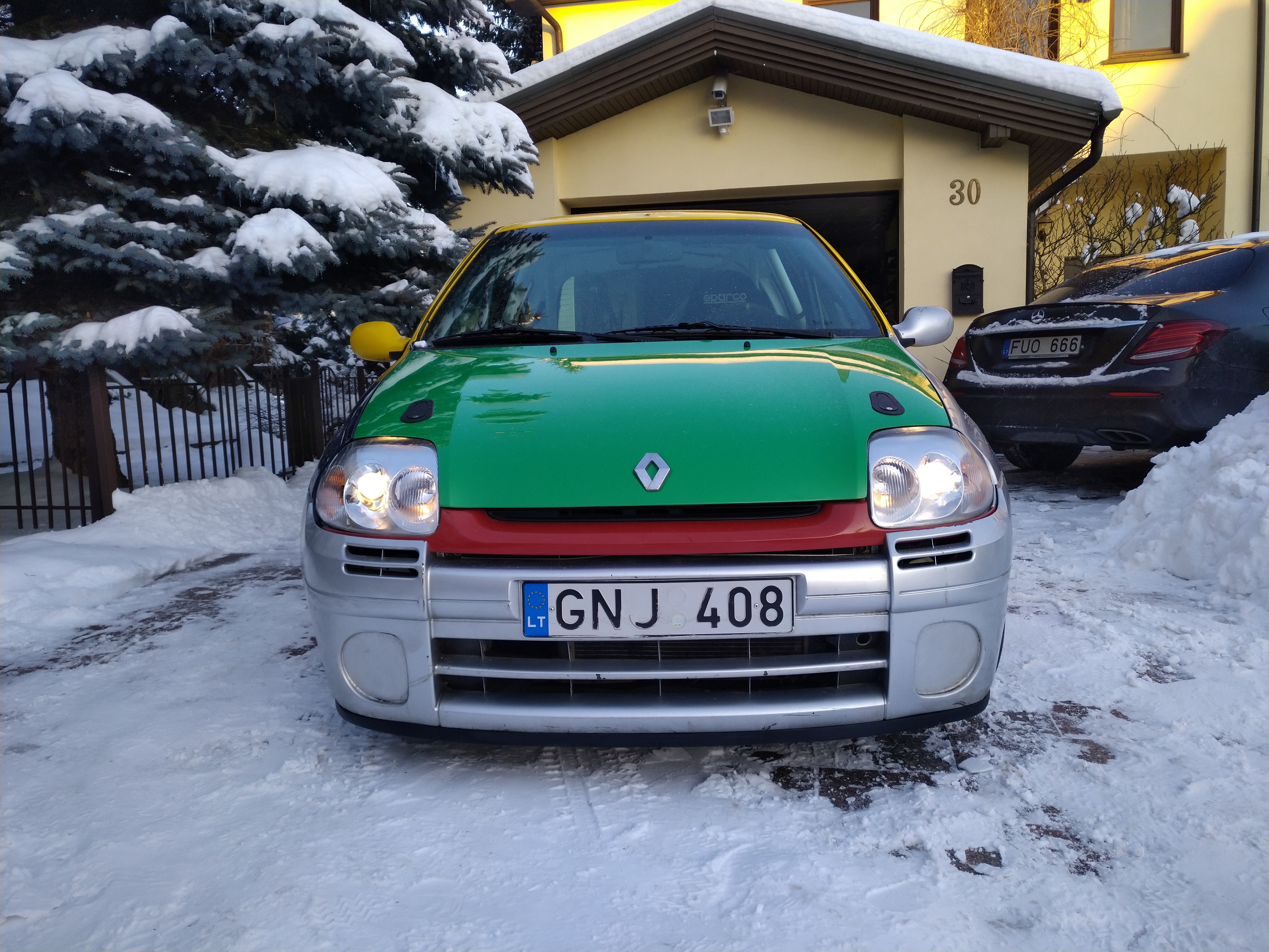

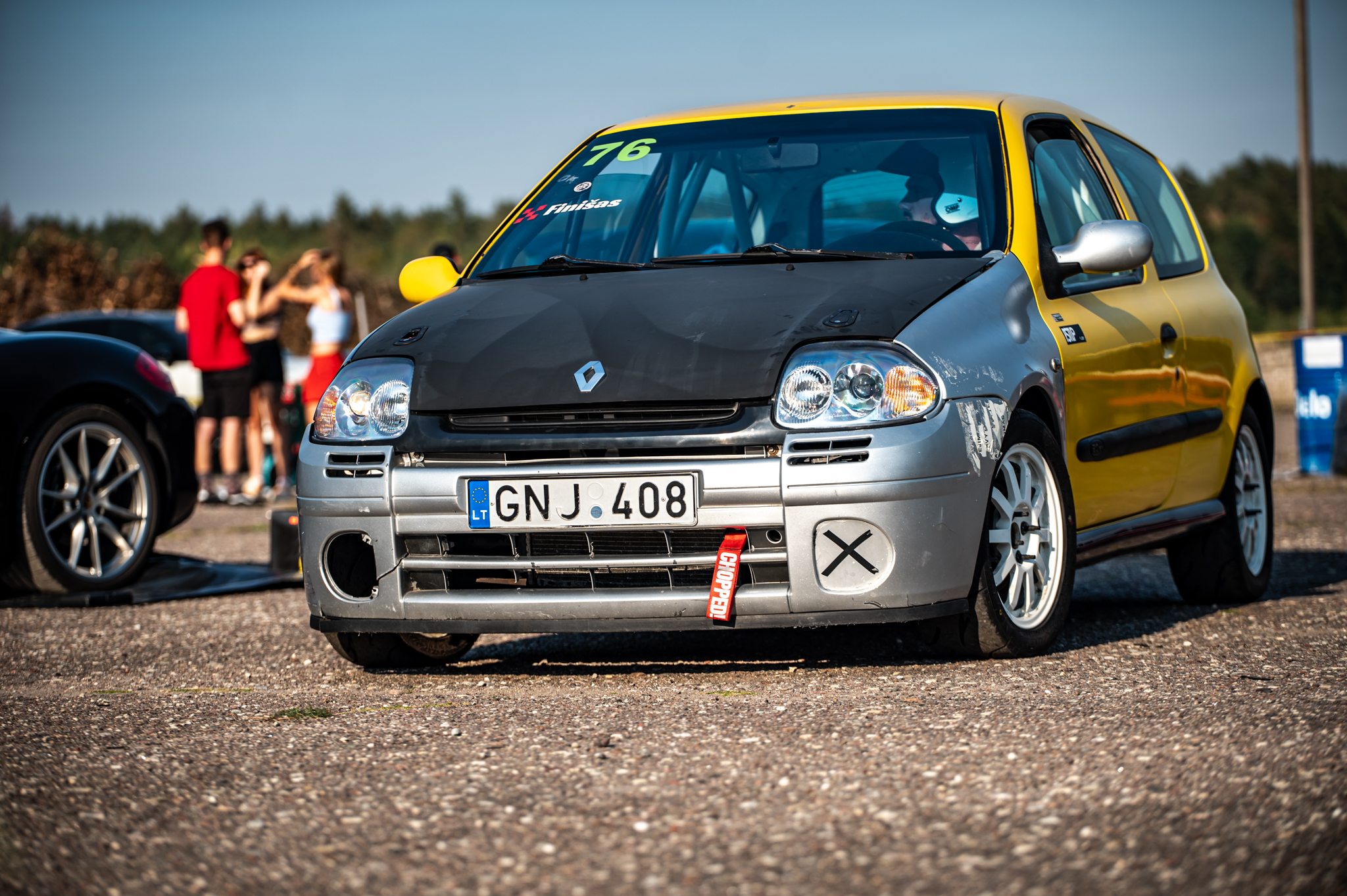

Darn pandemic got in the way of me going racing again, but that does not mean I shouldn't prepare the little rocket for fun.
First things first, as noted before I got almost all used exterior parts that I wanted/needed to be installed, as well as my rear fender arches and side skirts welded.
I spent extra money being silly - I got my hood painted 197 alien green color because I think it is cool AF. Also, hood pins are expensive.
The only things that I wish for exterior-wise are a trophy spoiler, tow straps, trimming exhaust pipe, sport/cup172 badge, and foglight mounts made into air inlets.
I got no idea where to get those plastic foglight things tho.
I want many things for this harlequin-looking beast, but I need to start with some more maintenance:
- Full belt change, gearbox/engine oil, coolant replacement. Clean the air intake.
- 2x KTR engine mounts and Powerflex bushings for transmission mount ( I hope this is a good choice? )
- I want a bunch of interior things like a second seat and Sabelt 330mm steering wheel.
- After all engine stuff I want to try and figure out why the damned RS tuner won't connect to my car.
- Maybe change my front anti-roll bar bushings
- Maybe order speedline corse 2118 wheels, does anyone have those for sale? ( I really like the look! )
Maybe there is an electrical/Rs tuner guru here I could message, or is the service totally dead? I got 2x RS tuners. Here is the old link to it:
Any comments about things to improve my track project are very welcome!

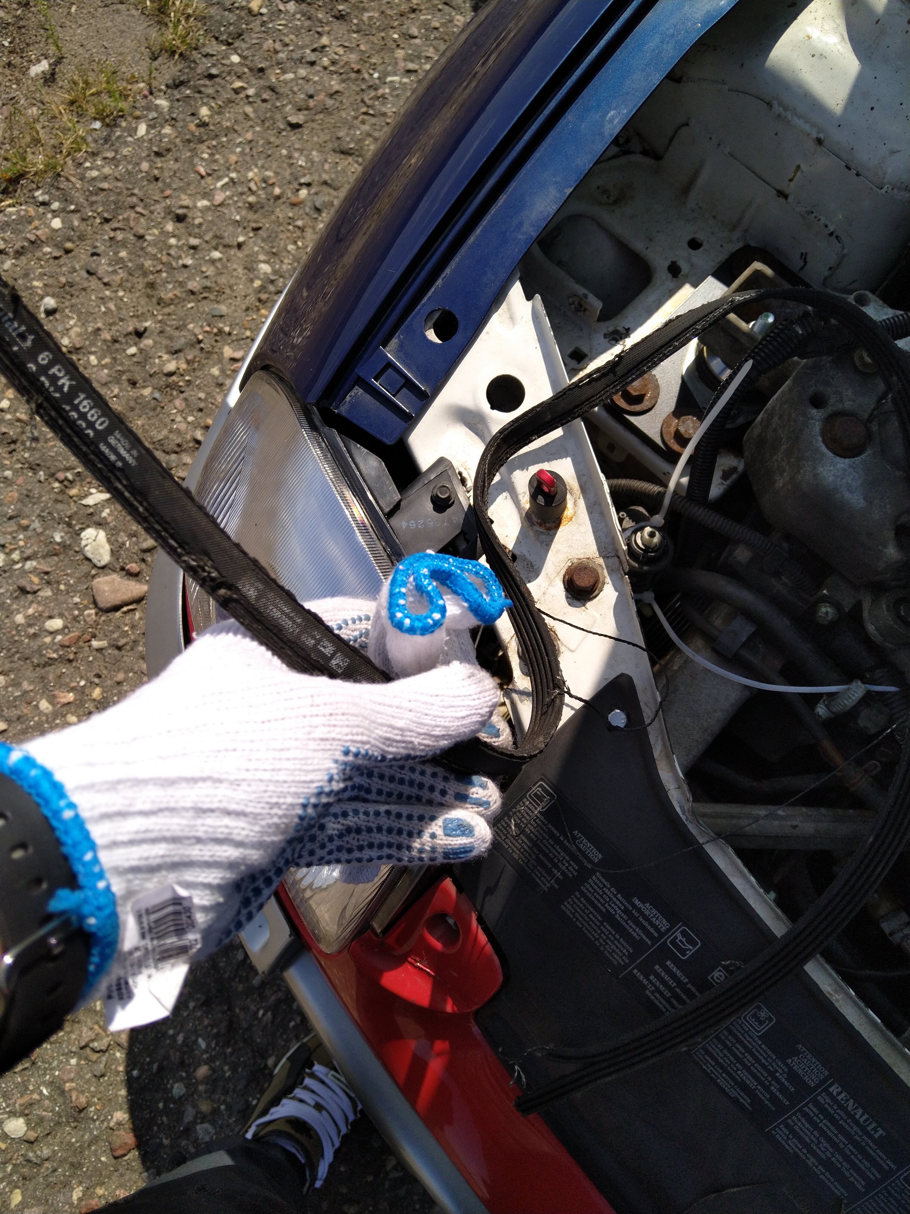

- Changed all the belts

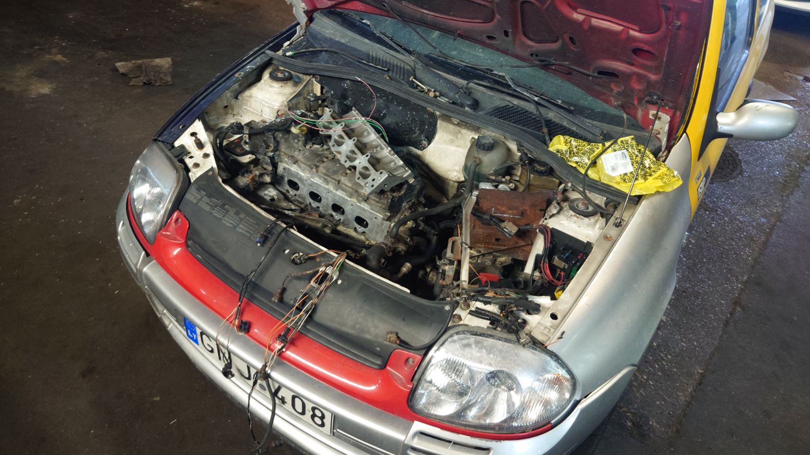

Since my car in 8 years of ownership never had it's cambelts changed, I decided to make that happen, I think we probably changed quite a few additional things at that time, but basically after a second trackday the engine blew up after the service.
It could be because I had removed the aluminum rally shield, and a piece of gravel got in it, and made the belt jump, or it could be a faulty job, OR it could just be that my luck finally burnt out.
Long story short - I had the engine head rebuilt.

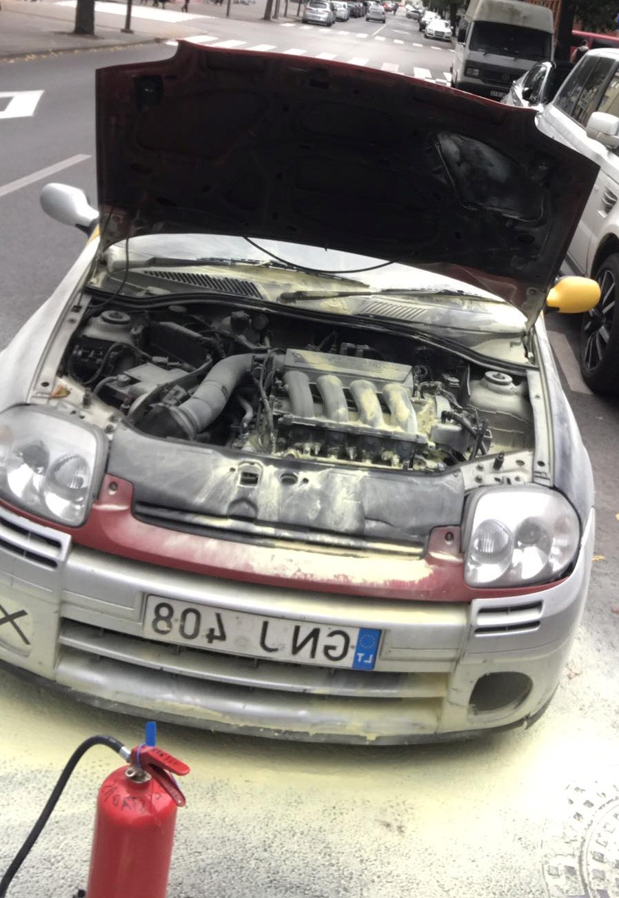

After that the car still did not run well, I had my usual fueling/electrical problems, it not revving high enough, stuttering etc.
And, it seems like after solving all the mechanical issues, when the car was being driven from the mechanic to an electrician, the old fuel line broke, or it always could be a faulty job, but whatever the case the car lit itself on fire.
Thank goodness I had installed a new fire extinguisher just a week ago.
So after last years summer it all went to s**t basically. Blown engine and the car on fire with rebuilt engine after the things were finally looking up. Then at one track day the car caught a cone which damaged the front bumper, and of course the whole electrical part and fueling lines are cooked.

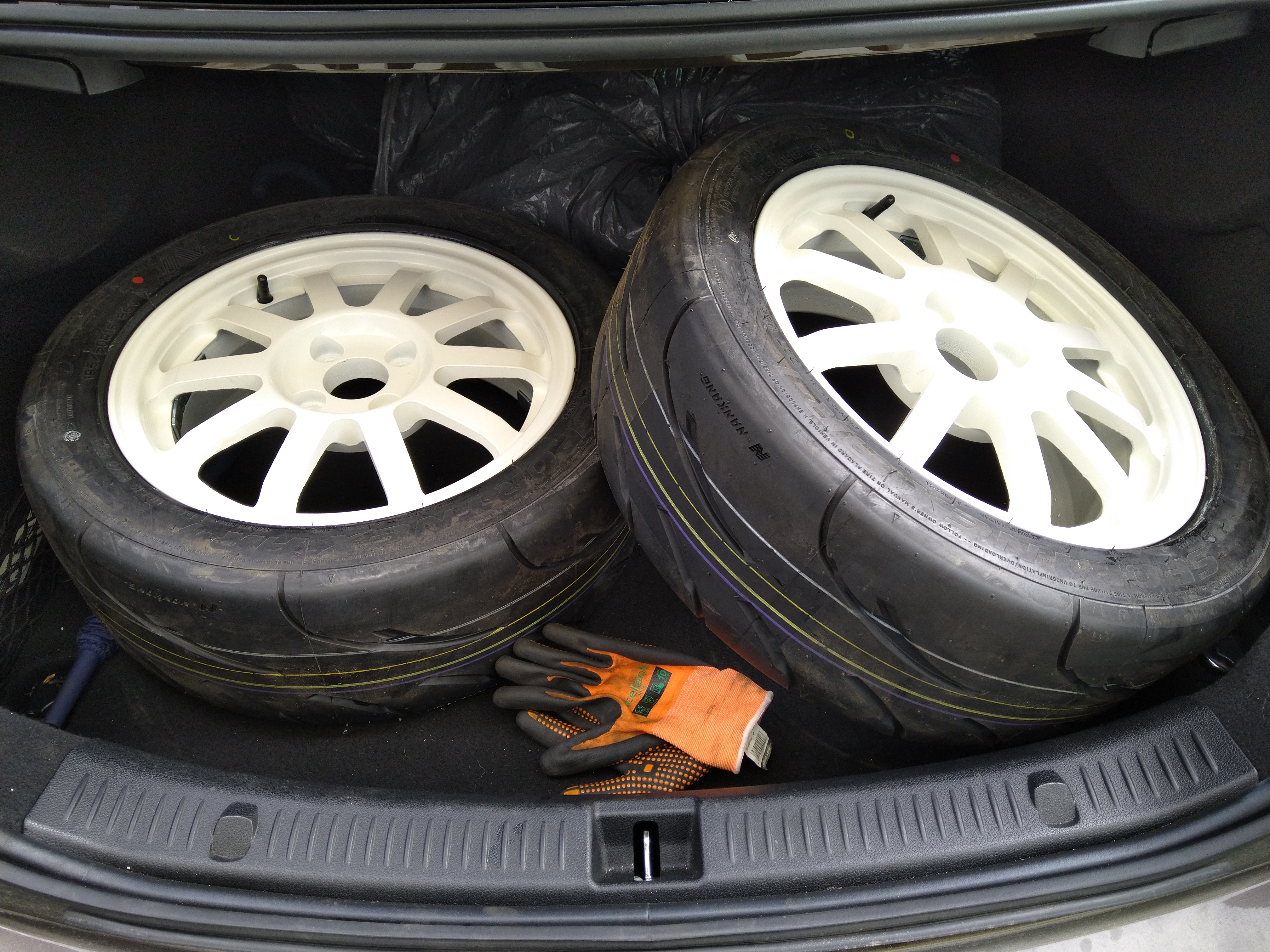

P.s. here is a picture of wheels after painting.

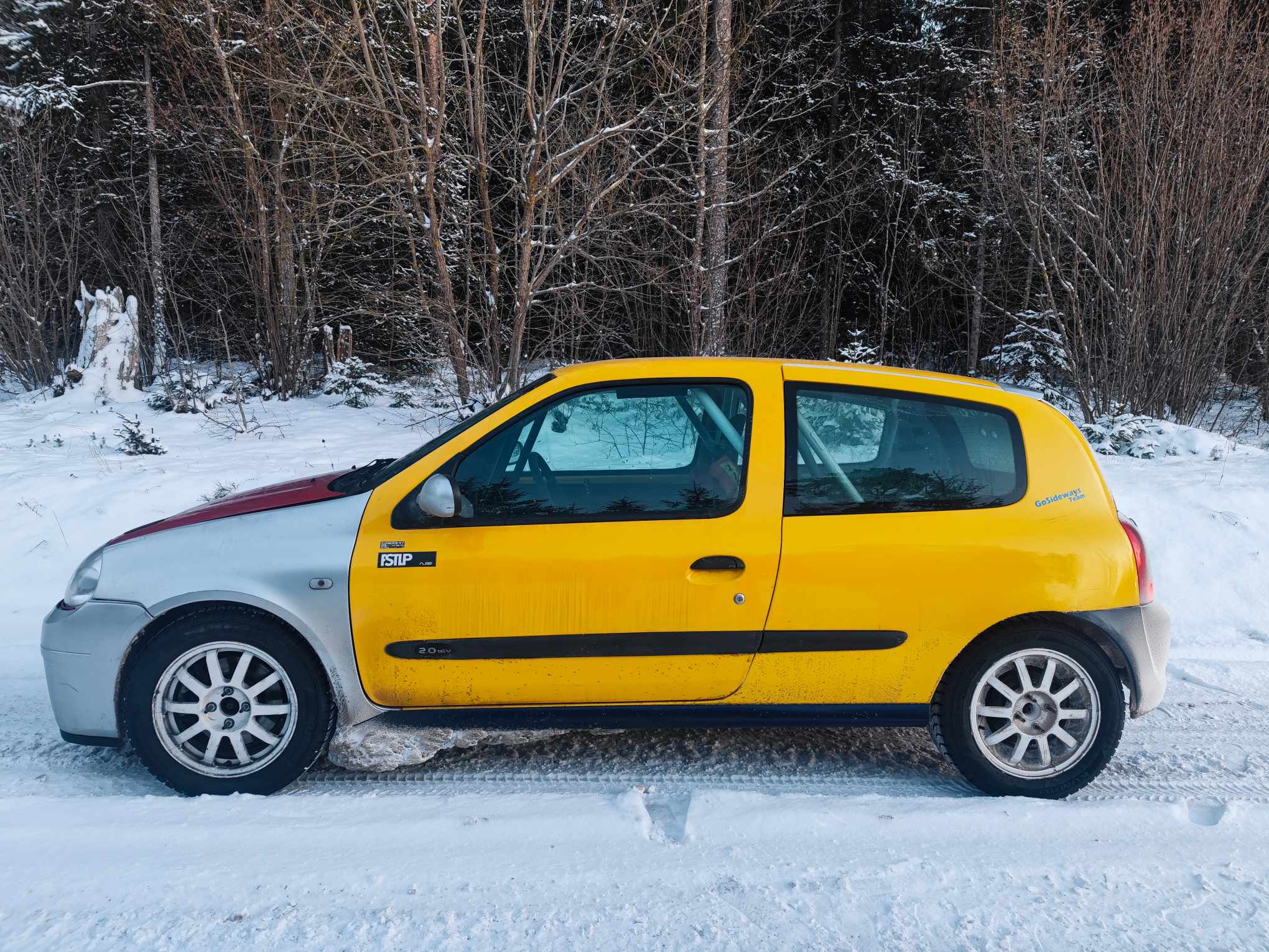

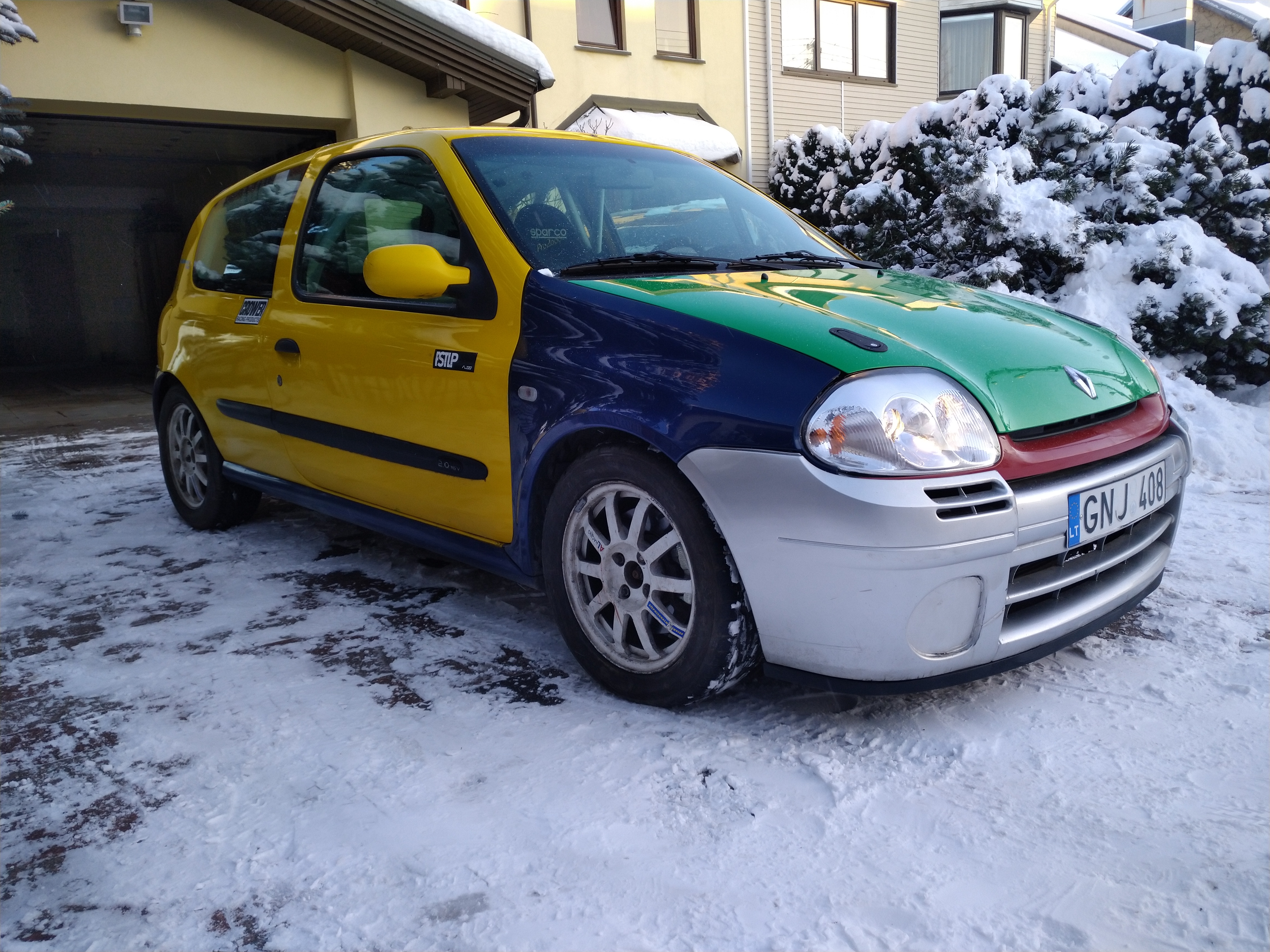

Good news!
I got the car back right as the temperatures hit -17C here in northeast europe.
- Got new winter tires 185/60 R15 Kumho WinterCraft WI51 with very soft compound
- New wheel studs and nuts
- Wheel alignment for snow (less camber)
The good part - car held out my gravel/snow road driving with circuit dampers/springs, and it is mechanically working great.
The bad part is that it needs way more love inside and outside to make it look as good as it drives.
Hopefully 2024 is the year of my clio coming back to it's best condition.

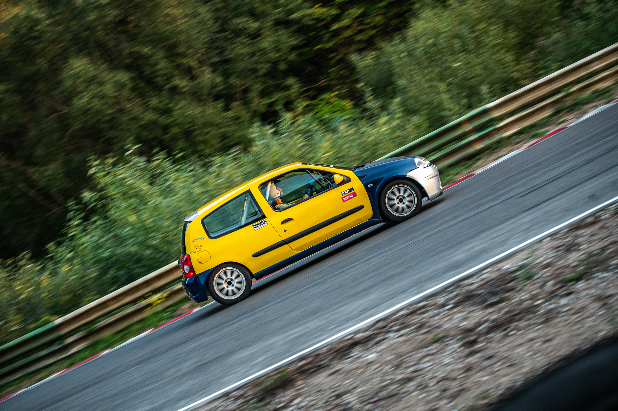

Finally we had a section of our home track upgraded and I got a chance to give my clio a whirl!
For now I got a new hood and underlip ordered, and it needs some new tires on the back.
Hopefully I will get to go on another track day soon!

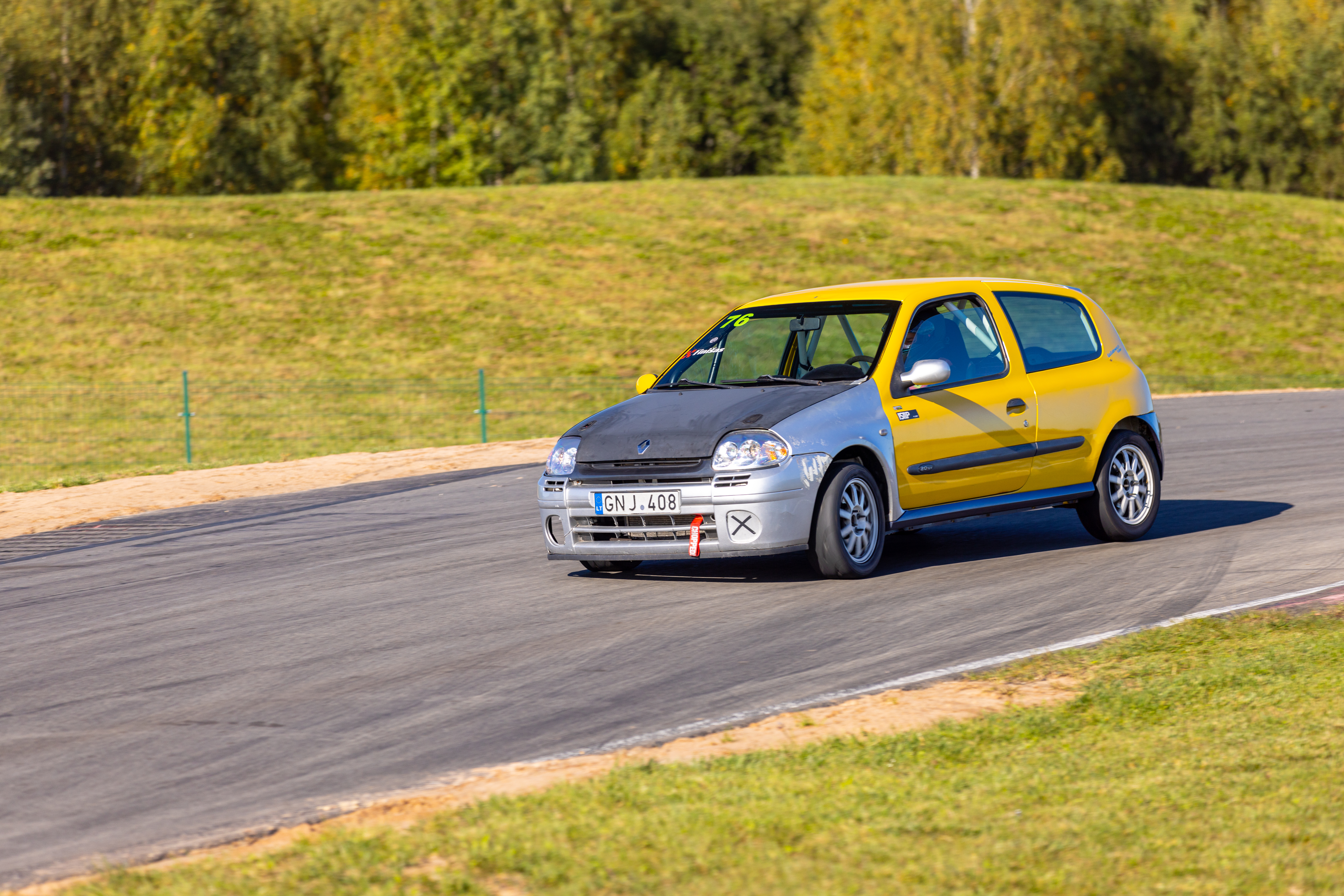

Good day! I had two track days done.
The season of circuit racing is probably done, since winter is right around the corner.
Many updates are to come including exterior and suspension.
Engine seems very healthy and I am looking forward to making little Clio go faster and look better then ever!

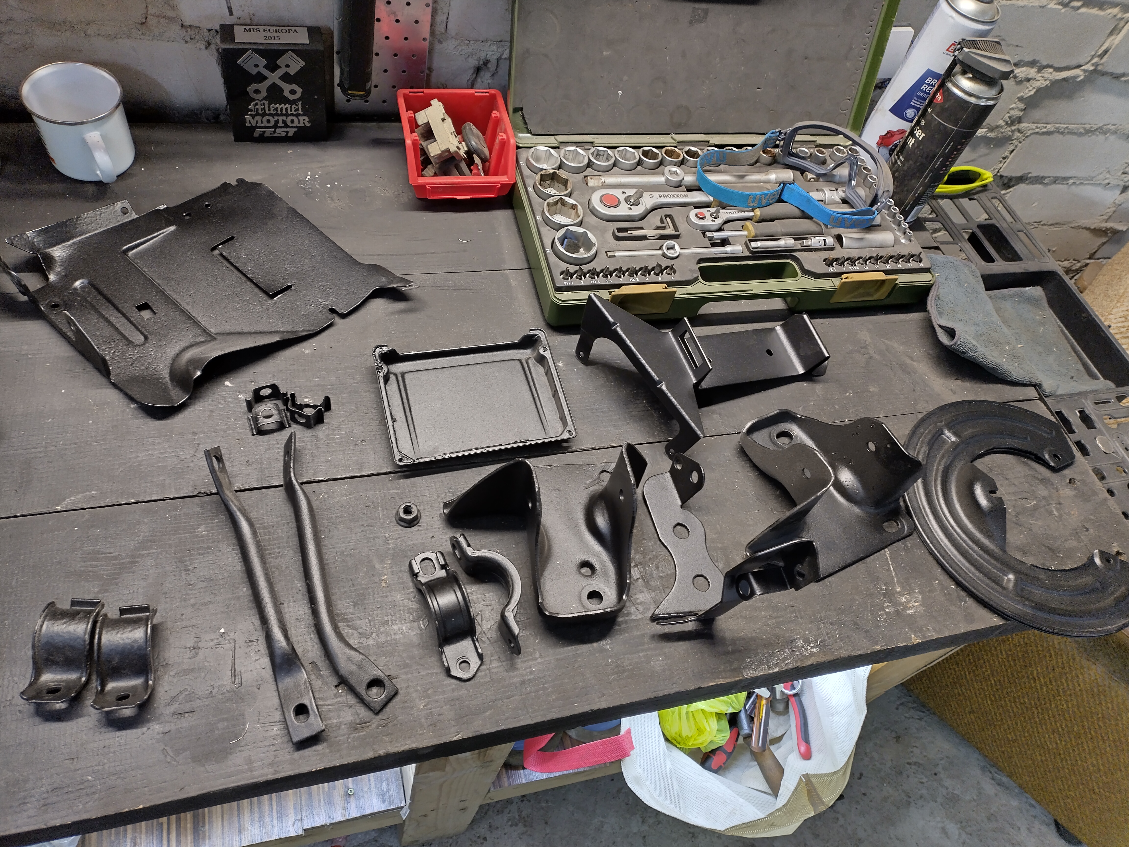

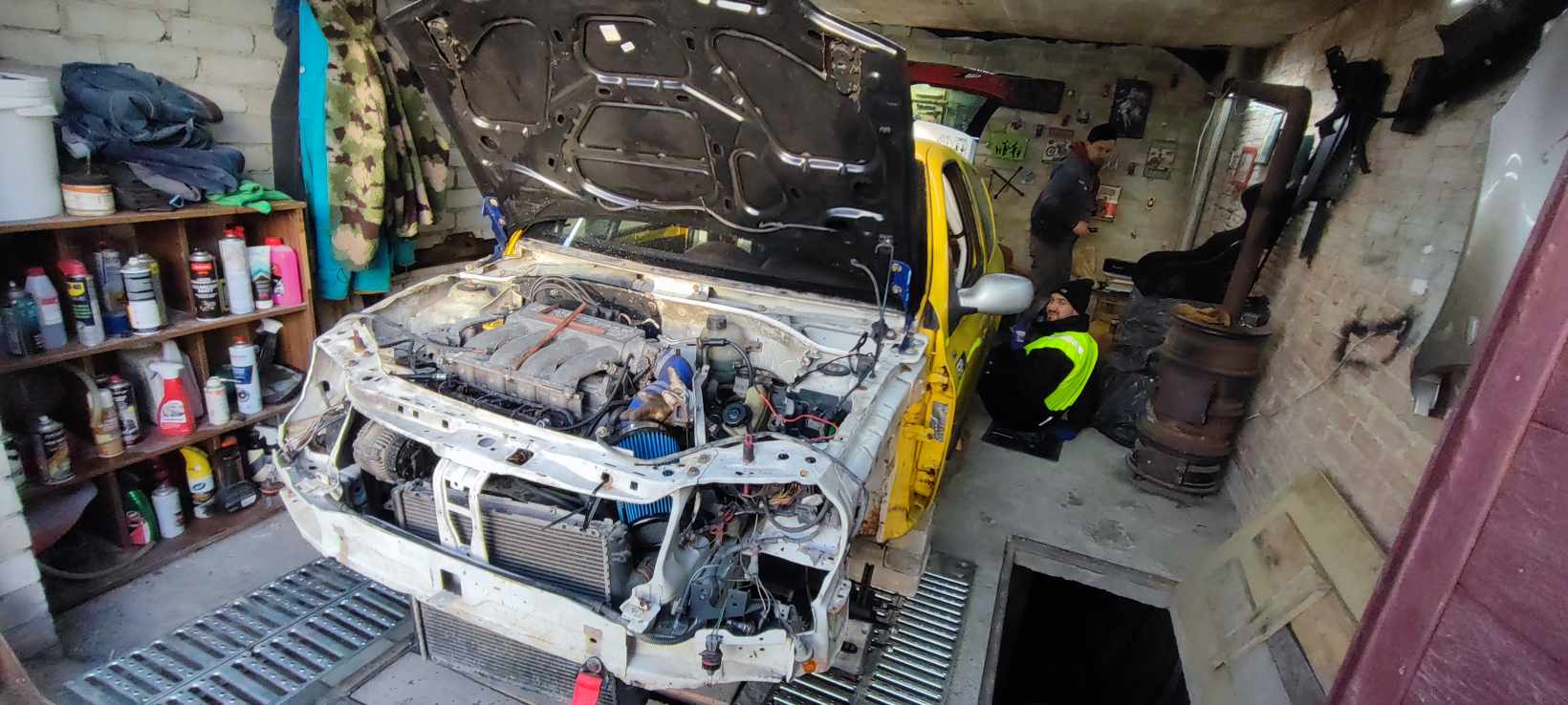

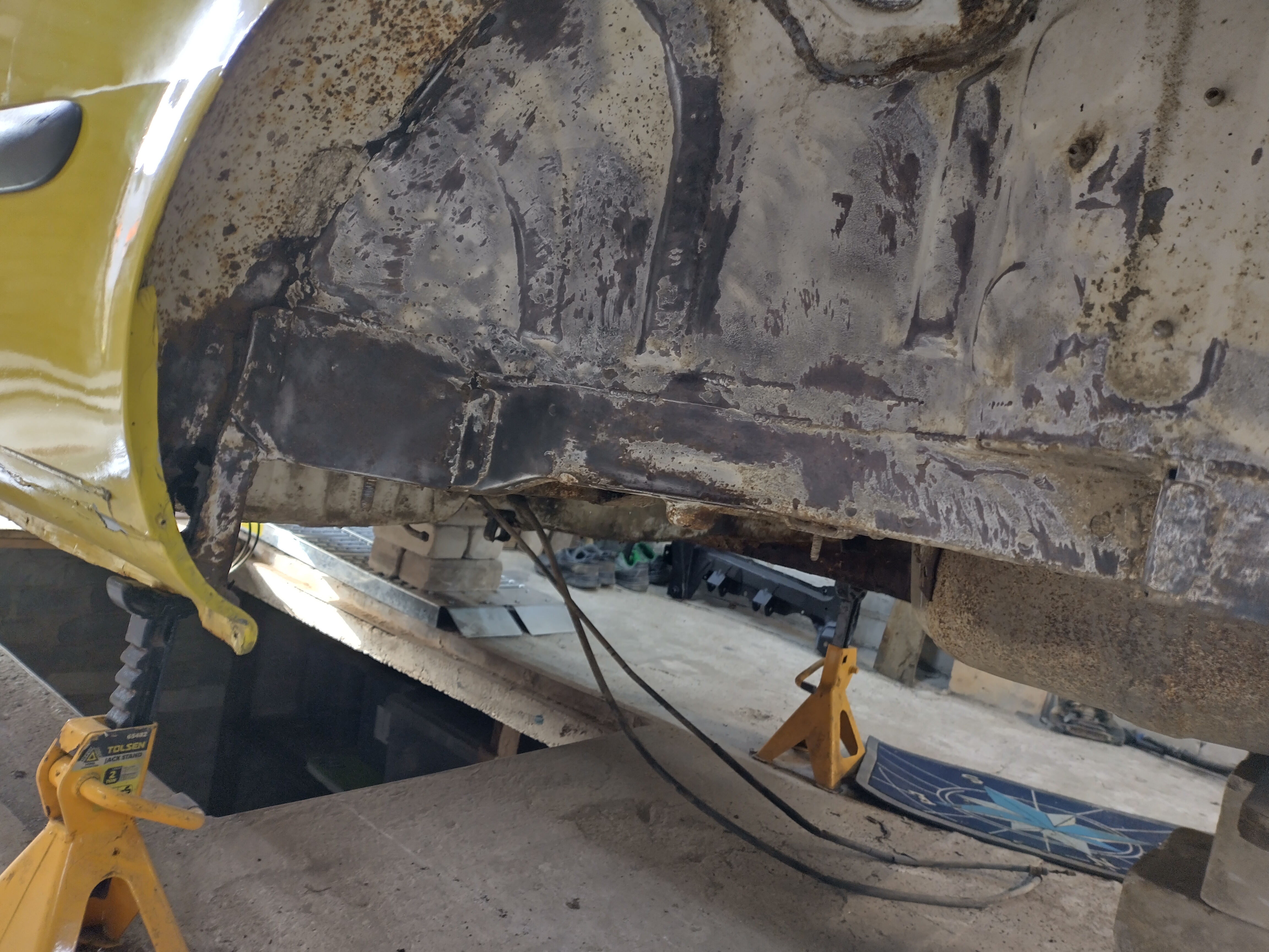

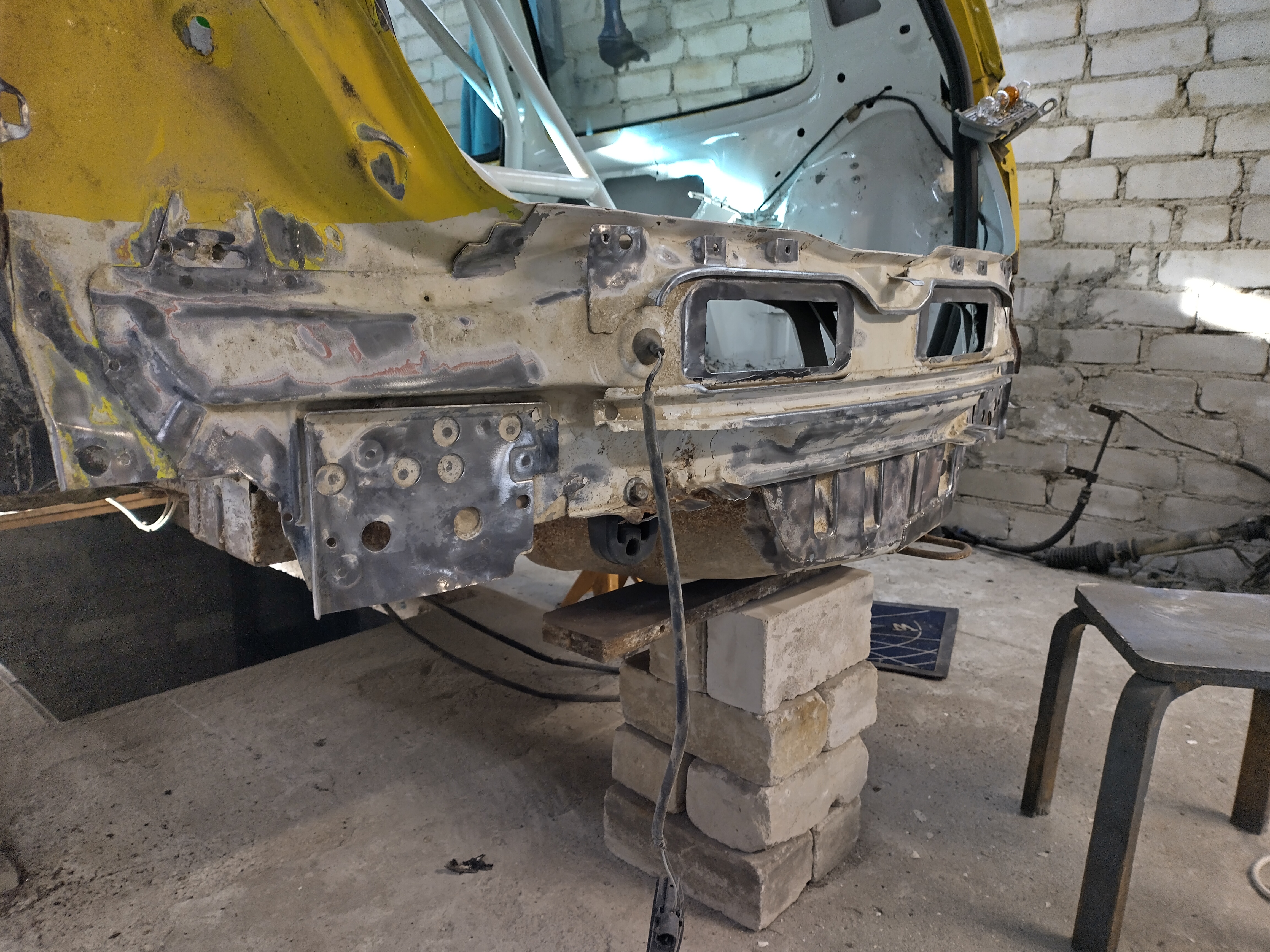

An update is due on what is happening with my Clio, since the season is already here.

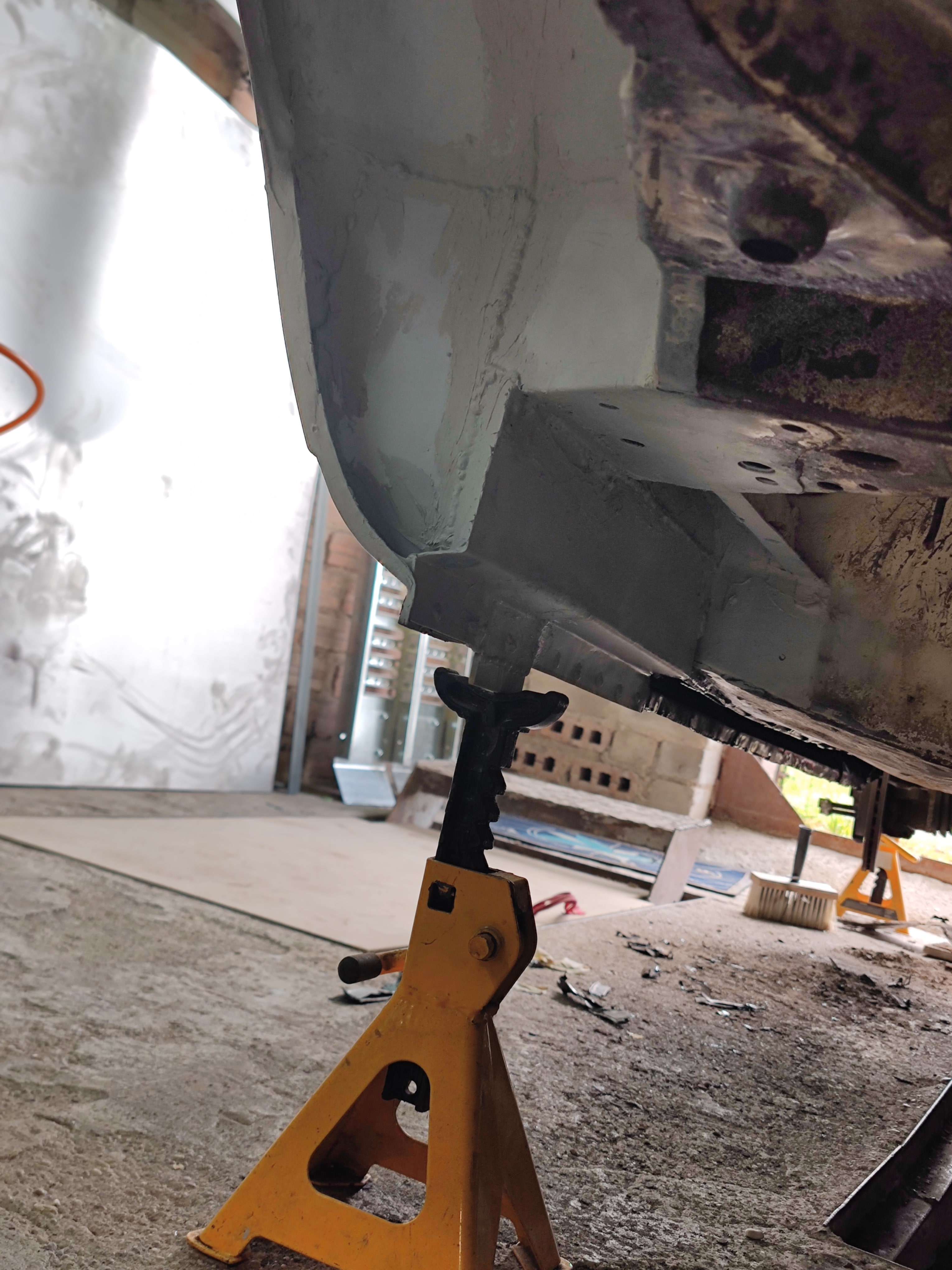

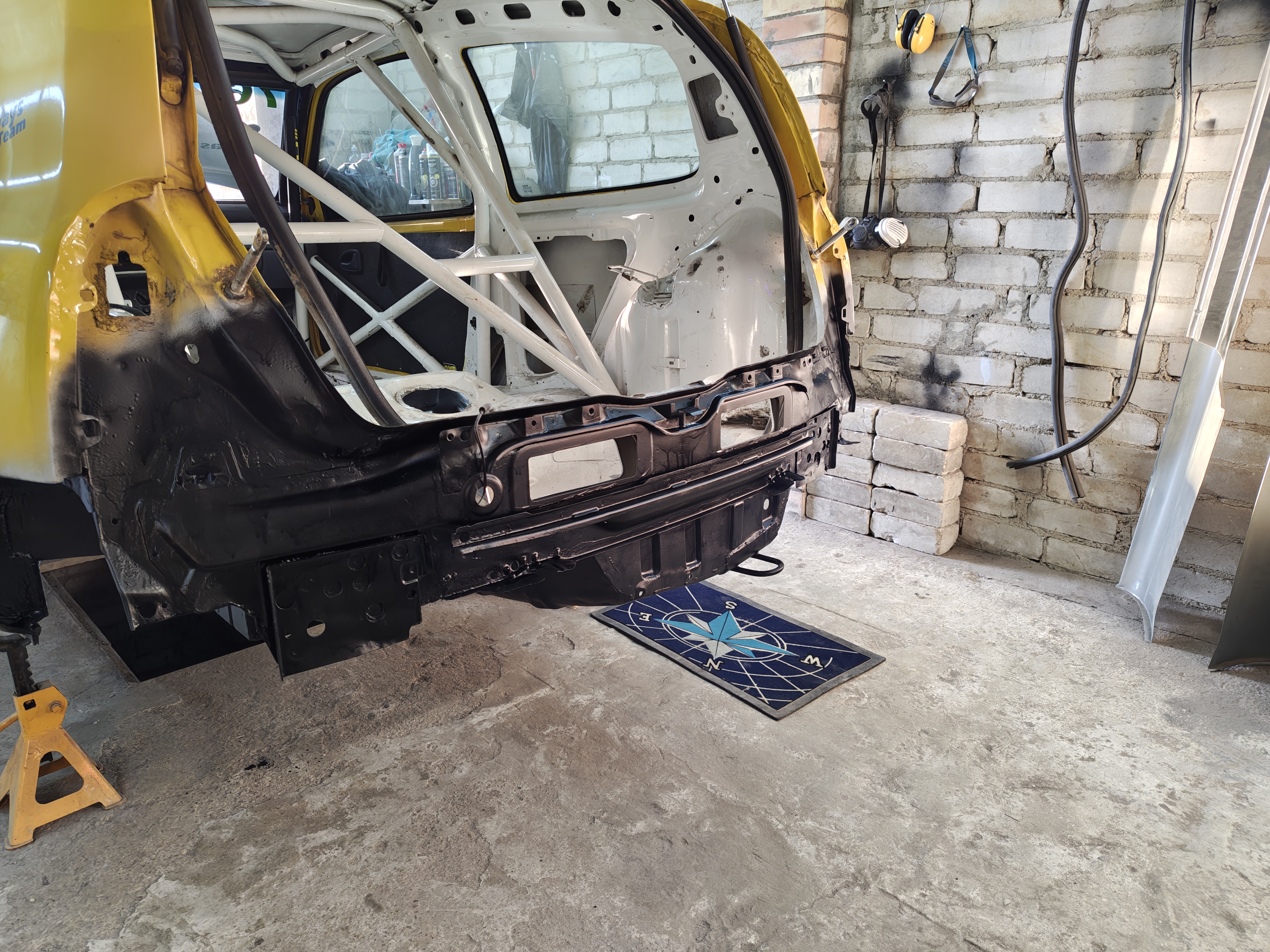

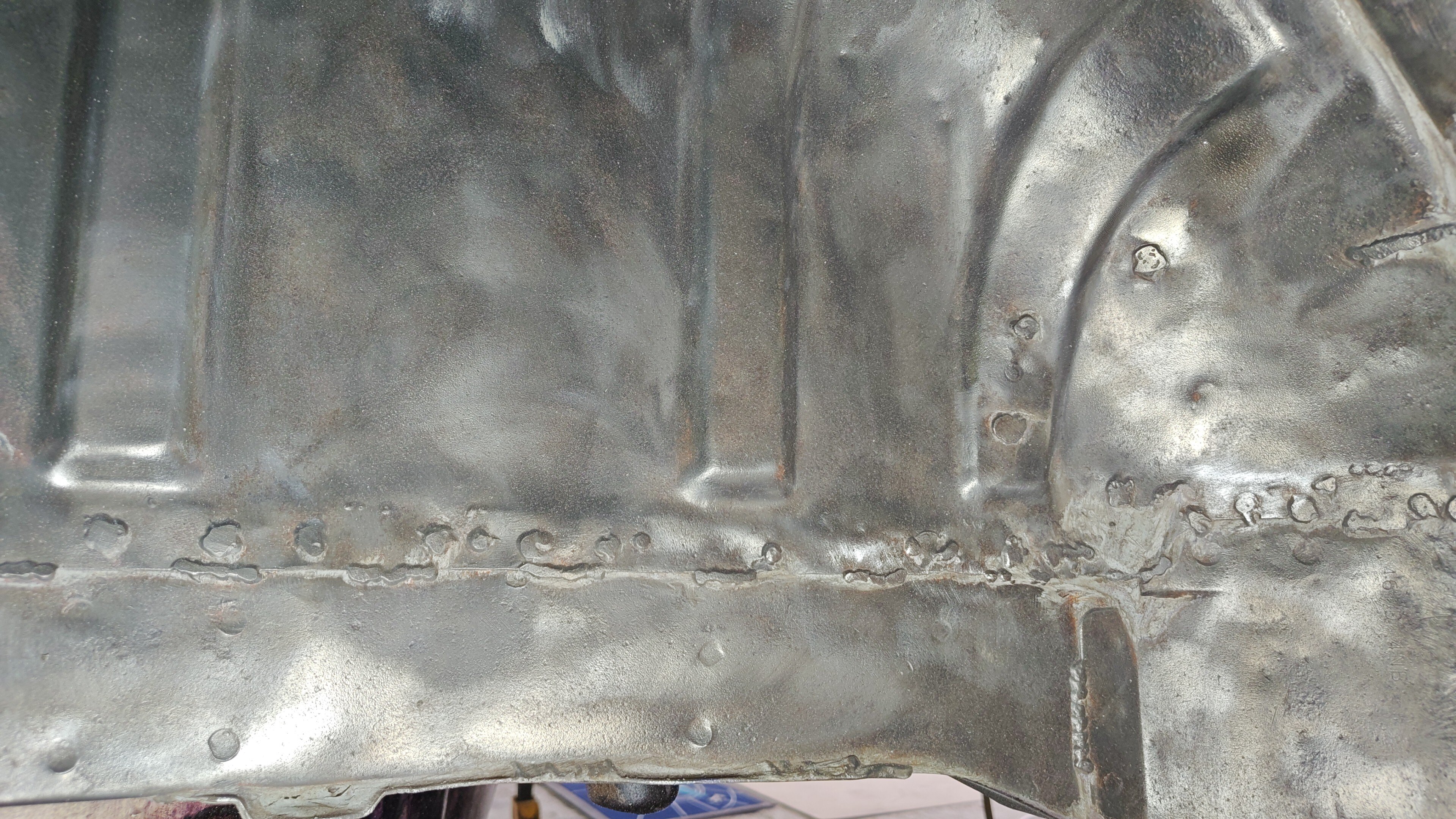

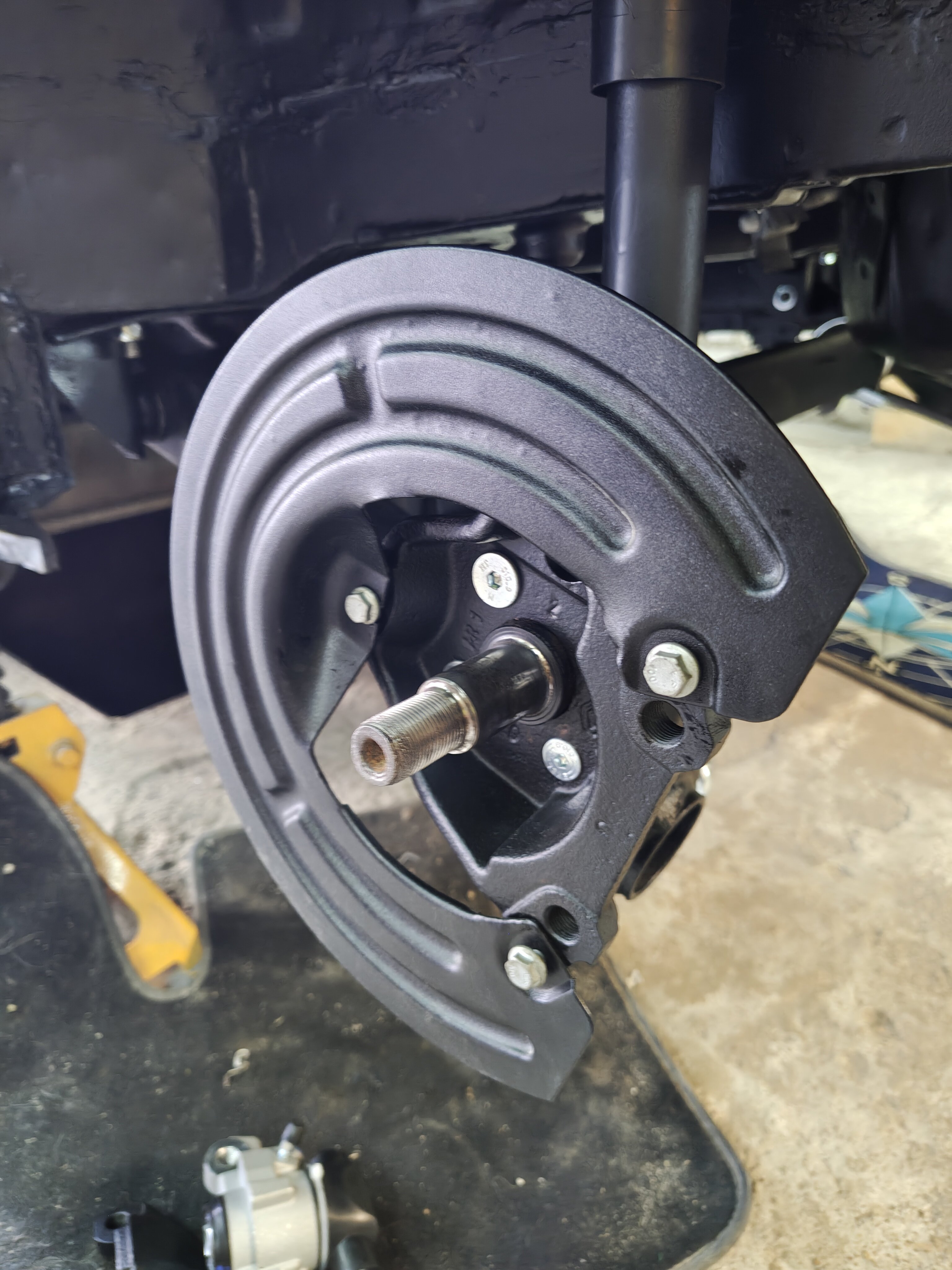

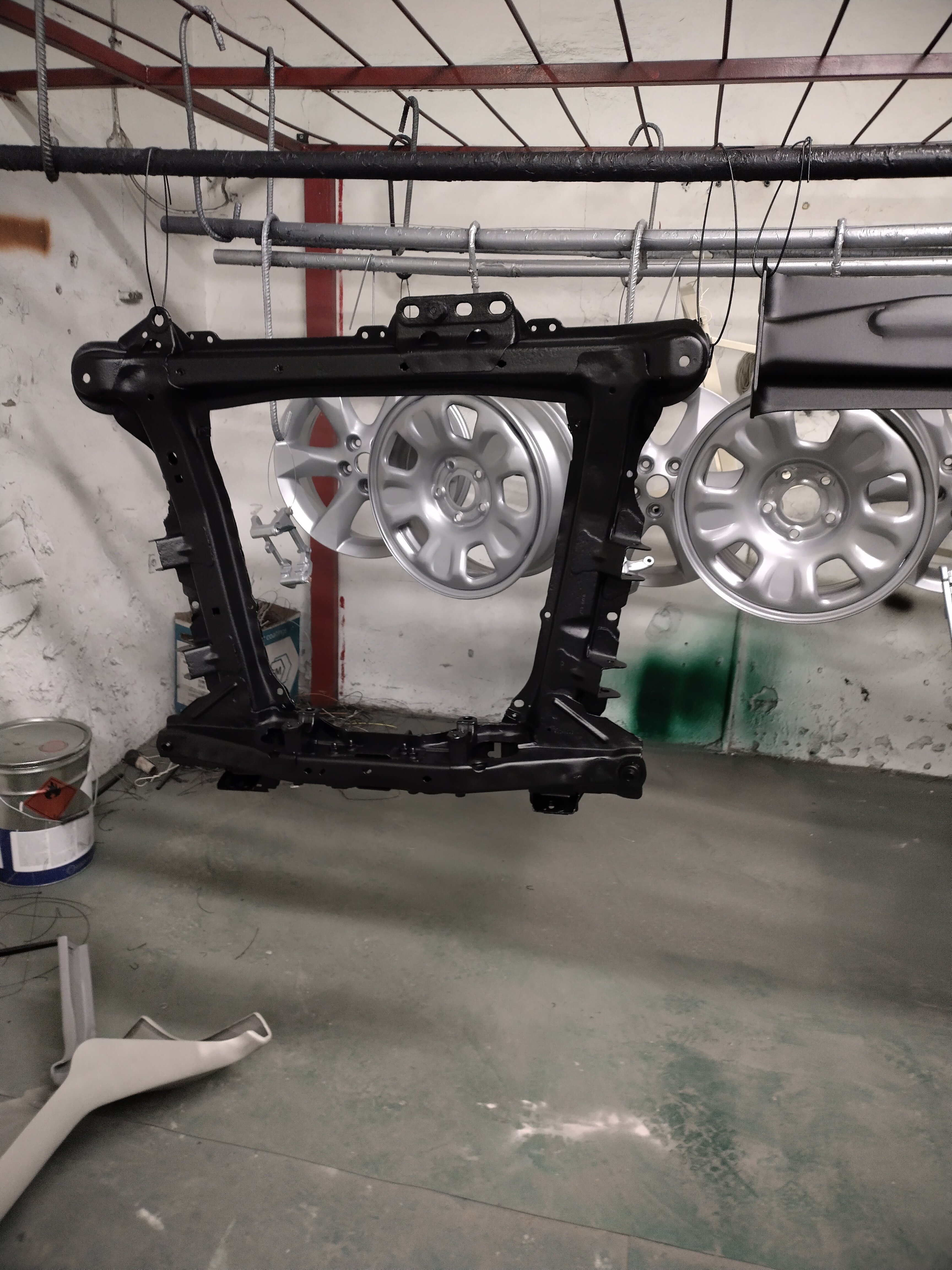

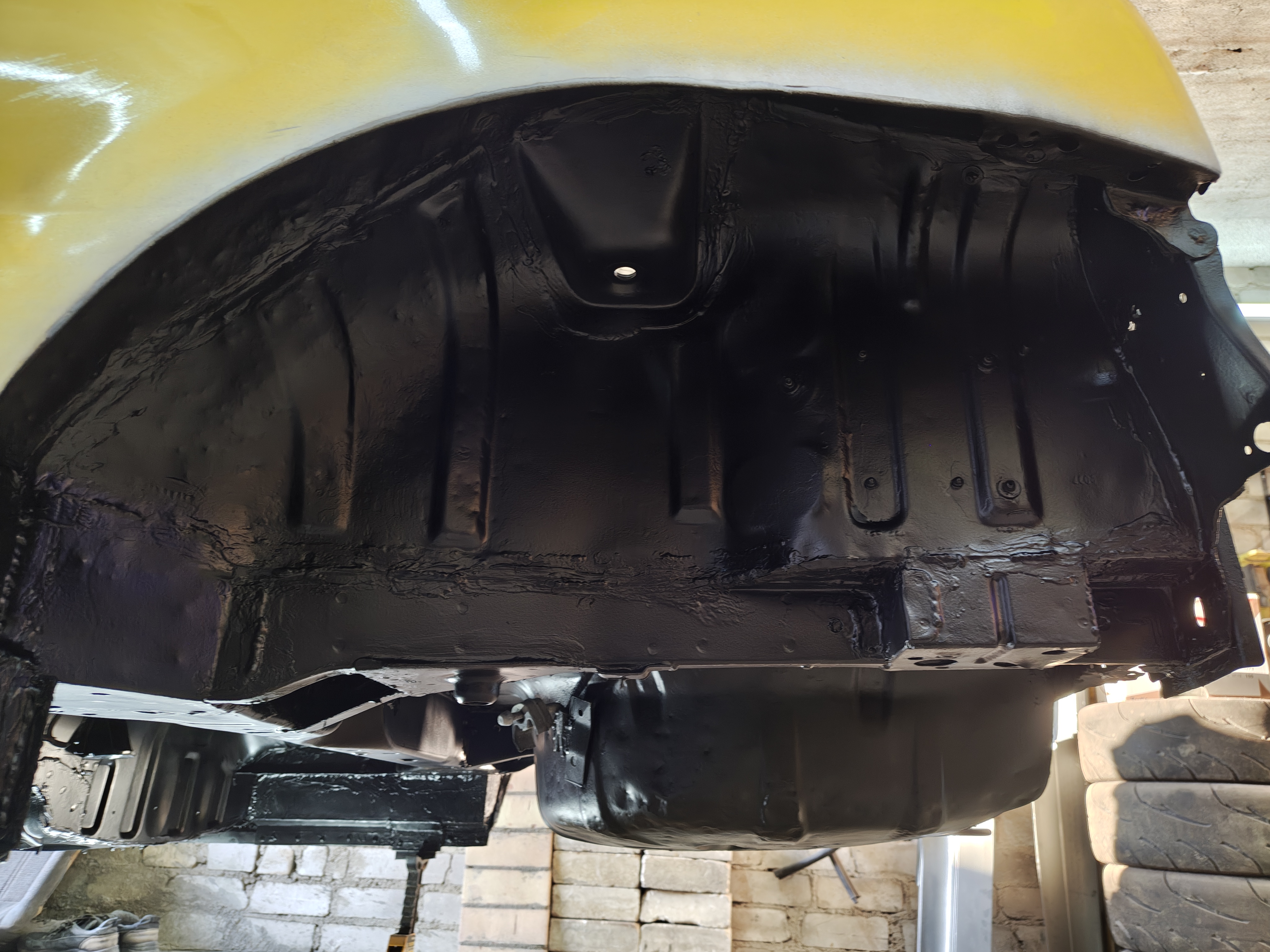

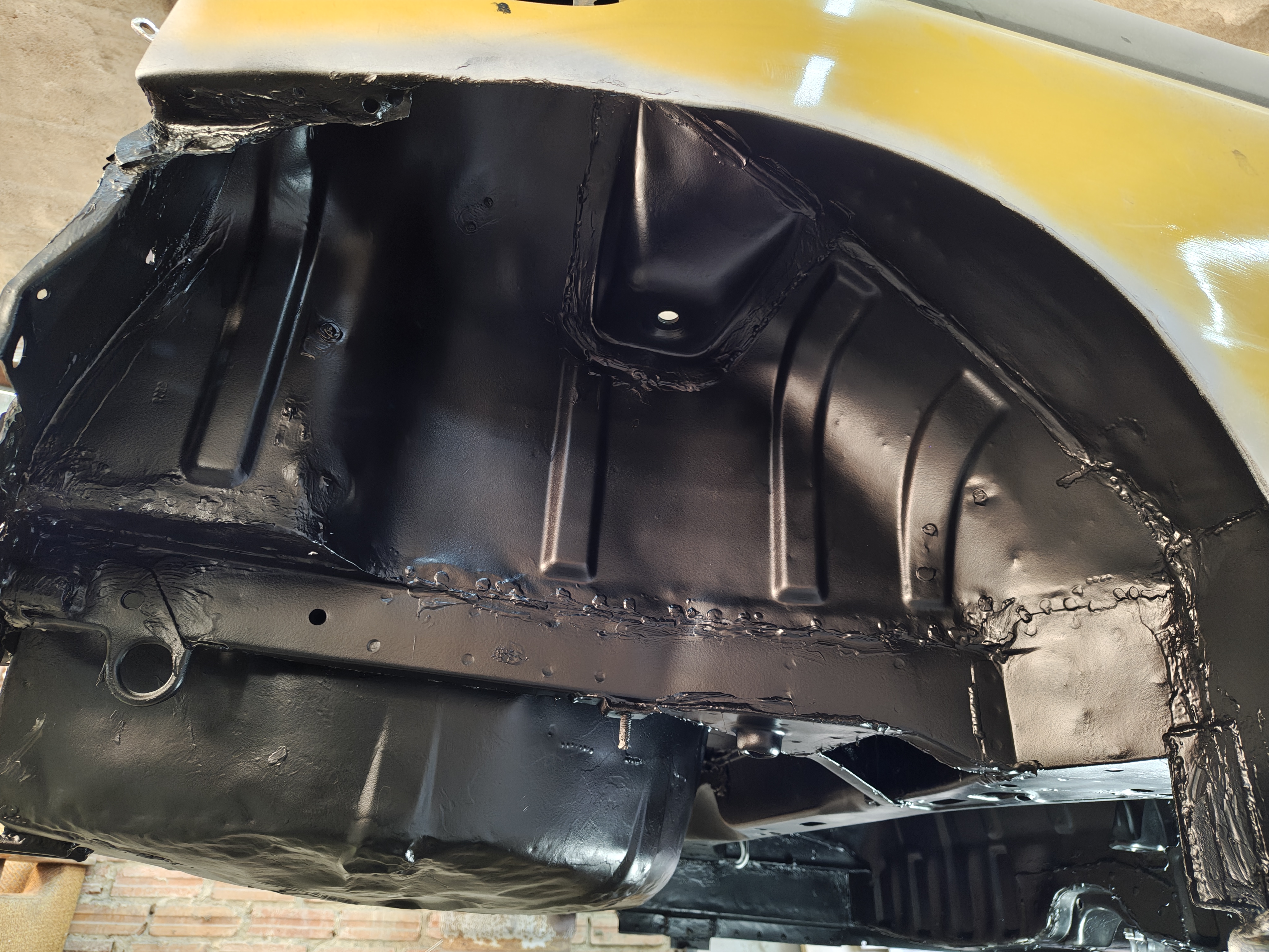

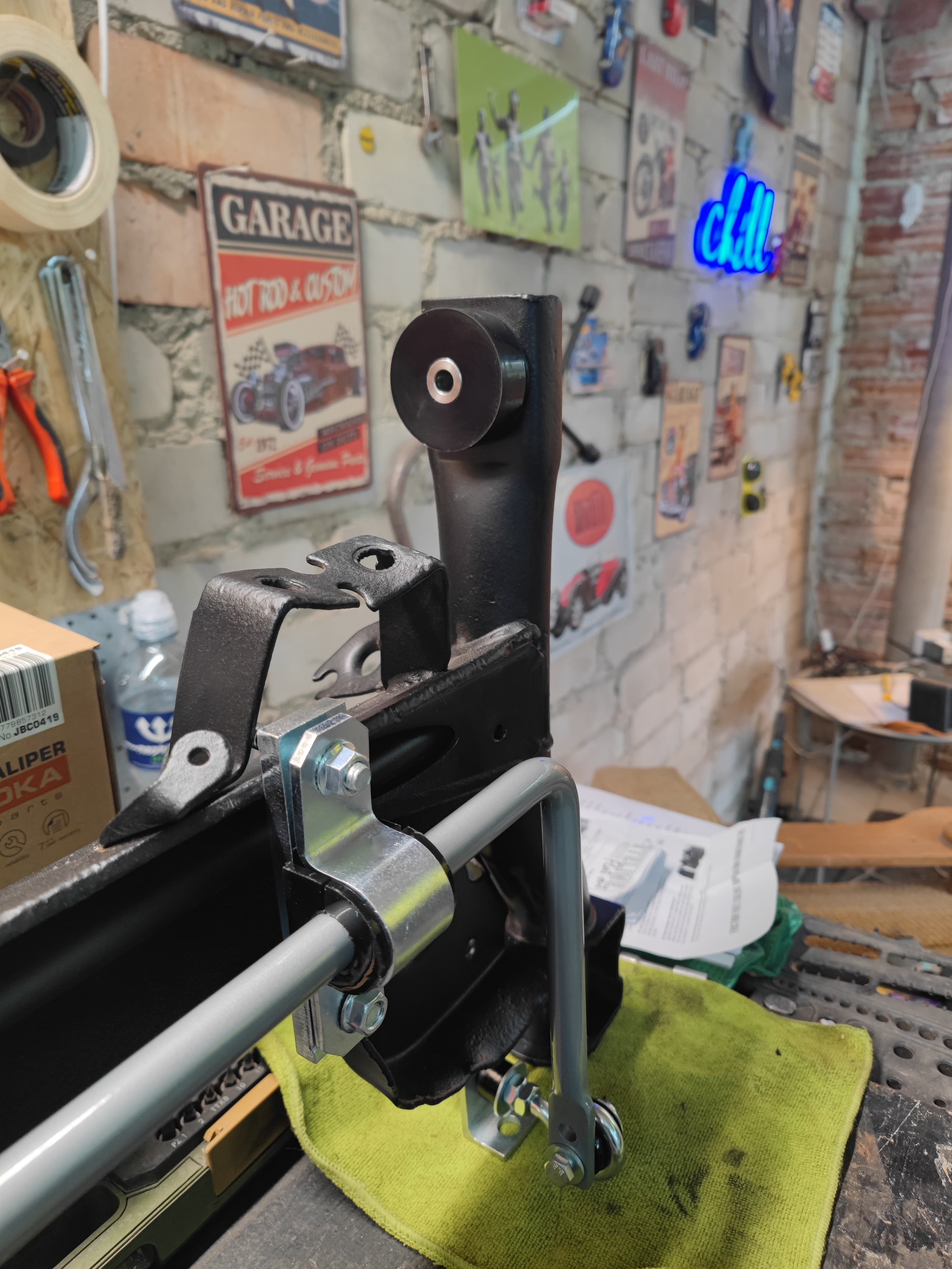

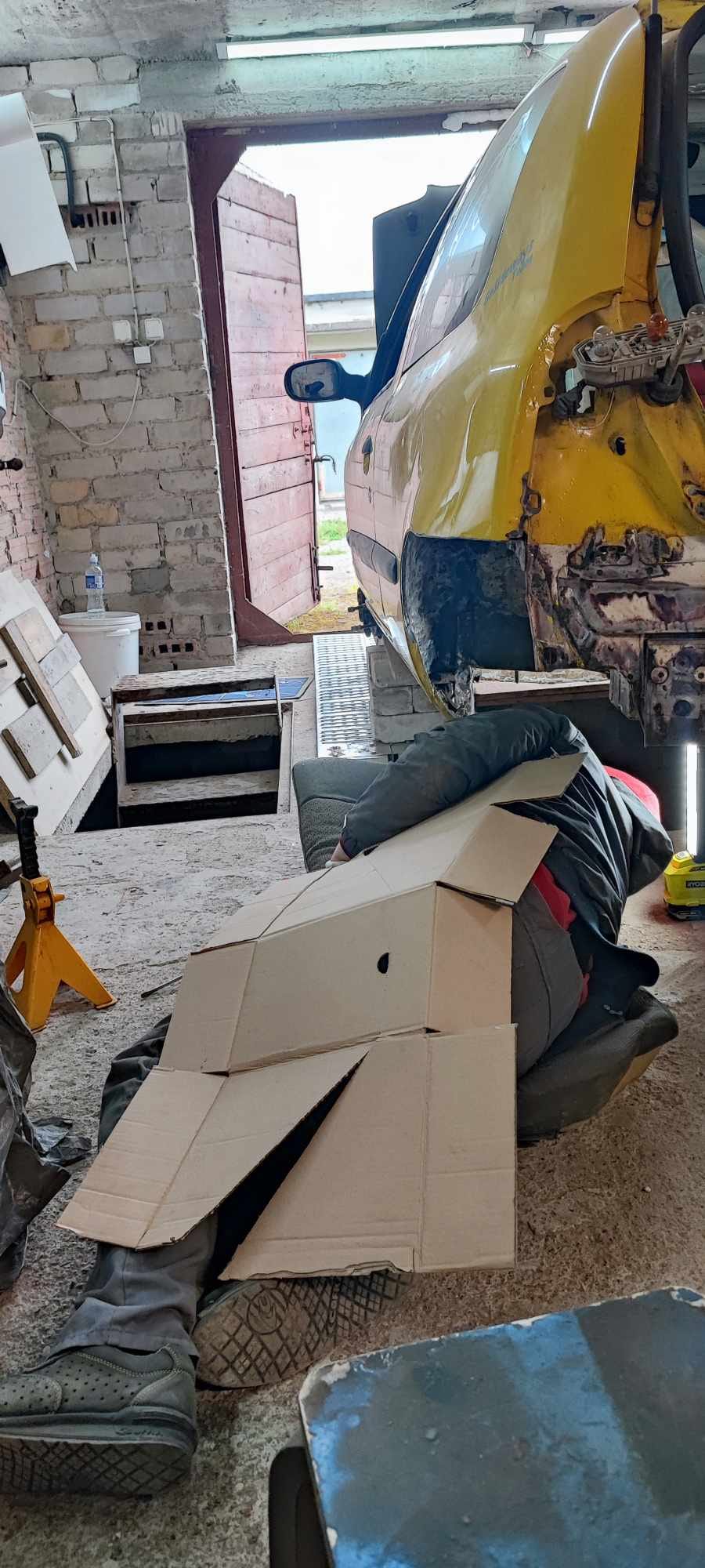

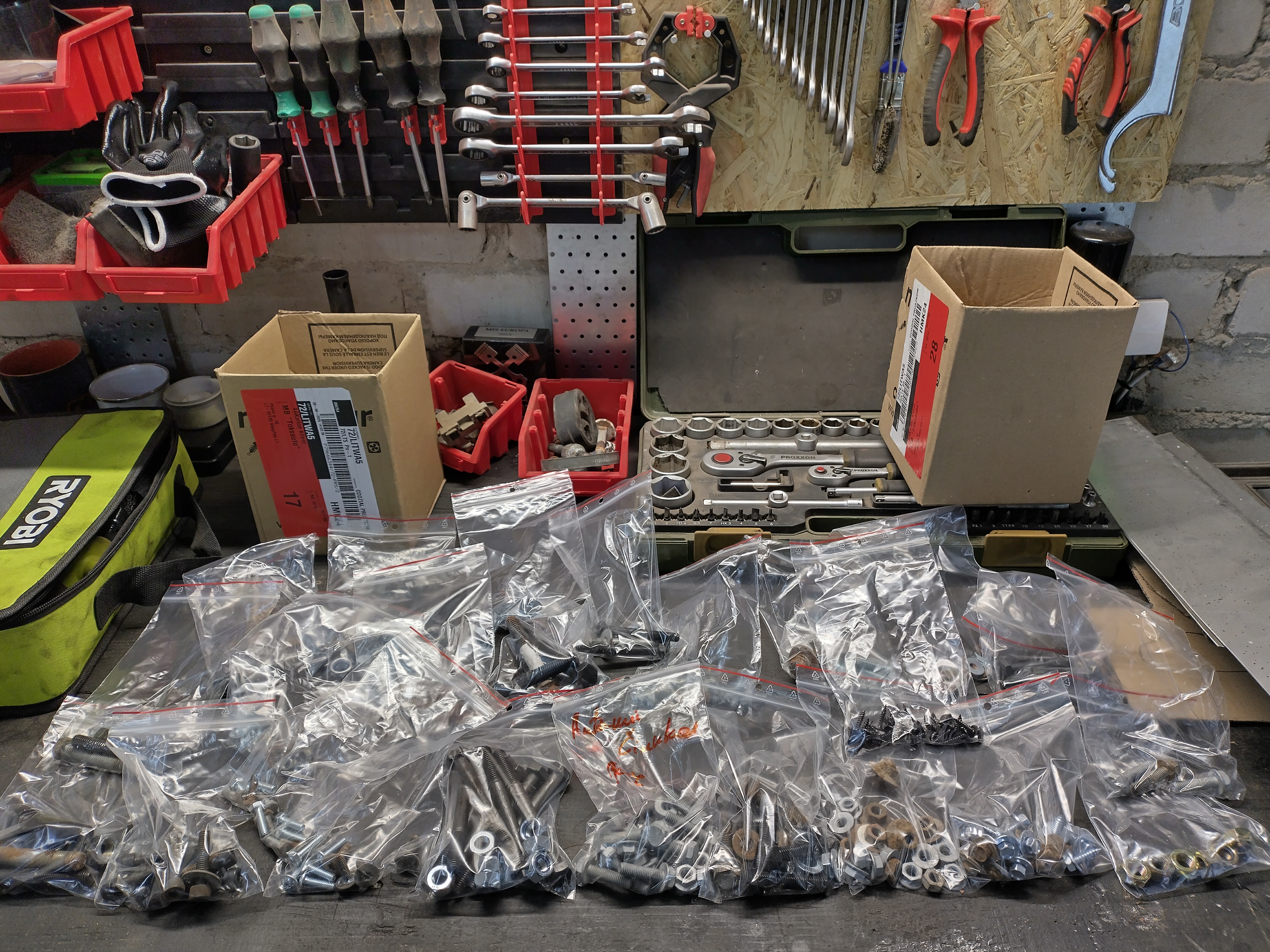

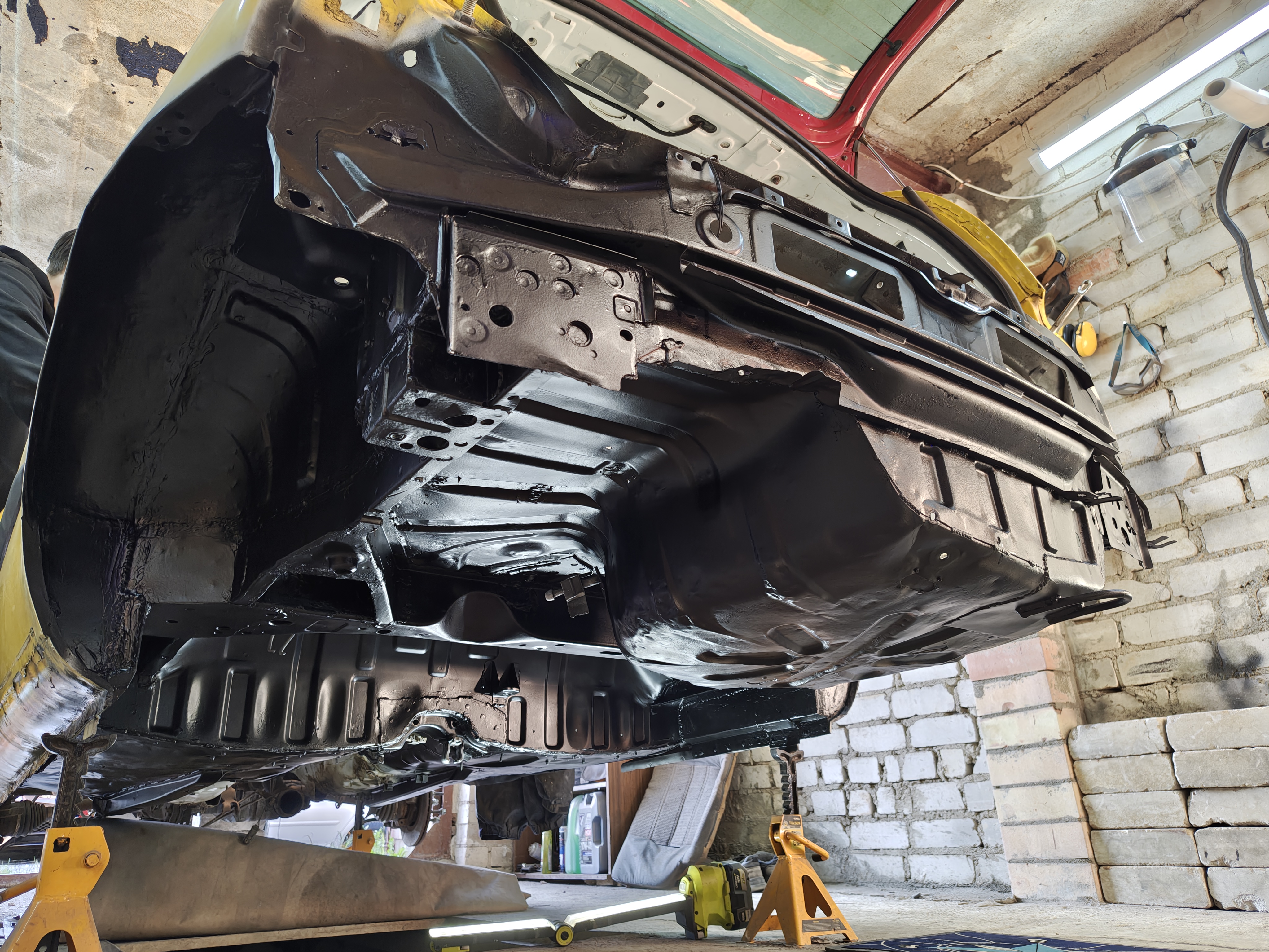

Basically, since the car was used for gravel roads and snow for over 10+ years, the underside needs quite a bit of work.
It was a hard decision but, I decided to do it with friends and at the same time swap all the bad parts, sandblast the suspension, and replace all the rubber bits with powerflex items.
The car was in quite a sorry state, so it is time to give it some proper fixing!
So there you have it, lots of grinding, lots more work, a bunch of new parts and some refurbished bits. More to come for sure!
So an update! Finally we started working on the Clio again, since only now we had a median temperature in garage of +10c.
The whole rear fenders, front fenders and whole underside needed to be shaved to bare metal, then we applied around 6 coats of anti corrosion things (Dinitrol anti rust, anti-gravel, primer and paint).

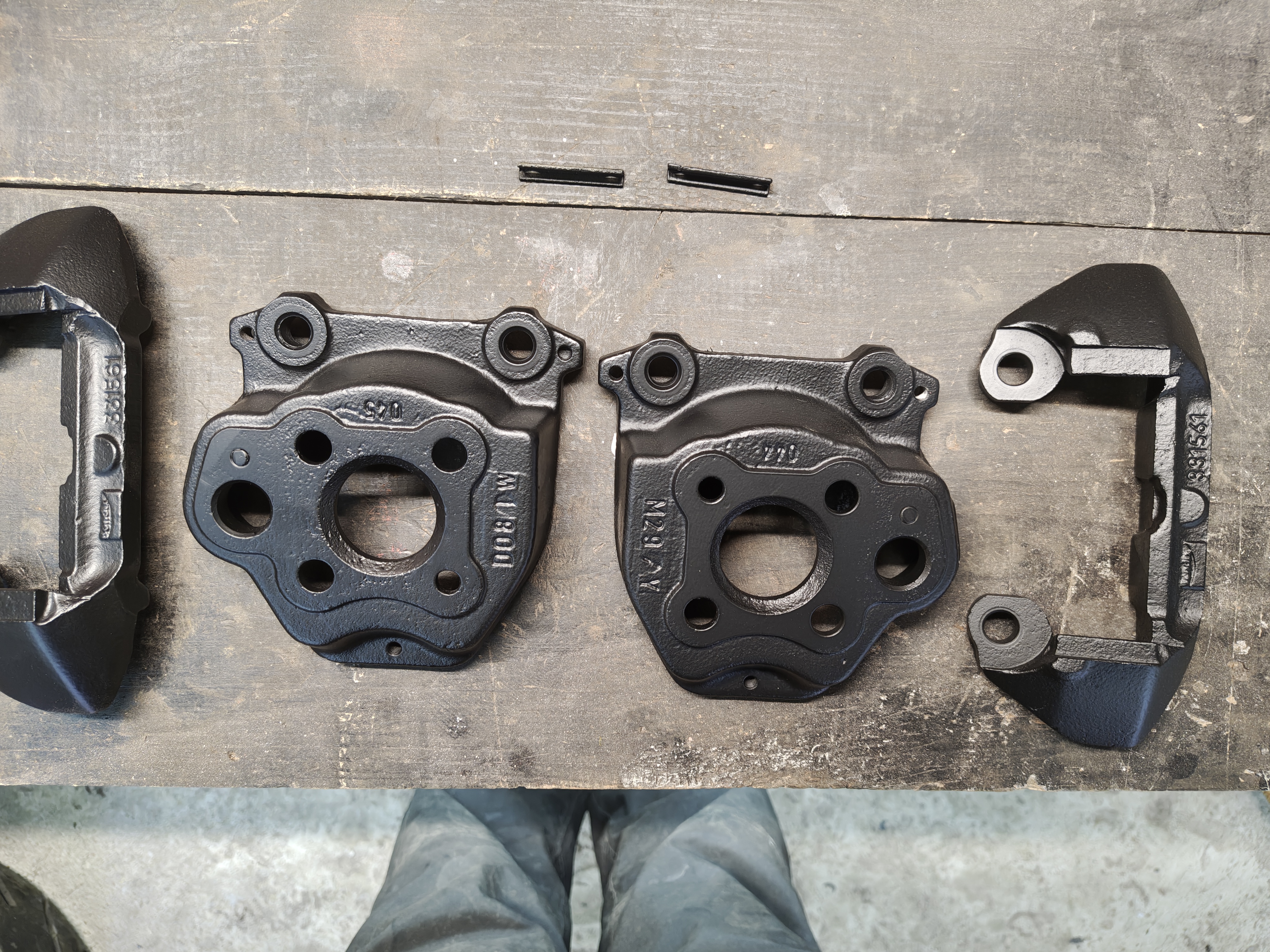

As you can see, we finally rebuilt the lifting spots from brand new metal, since all of the sides were gone. Also, cooking of parts were done!
Here is a crazy picture, I got ALL NEW bolts for the whole suspension of the car.

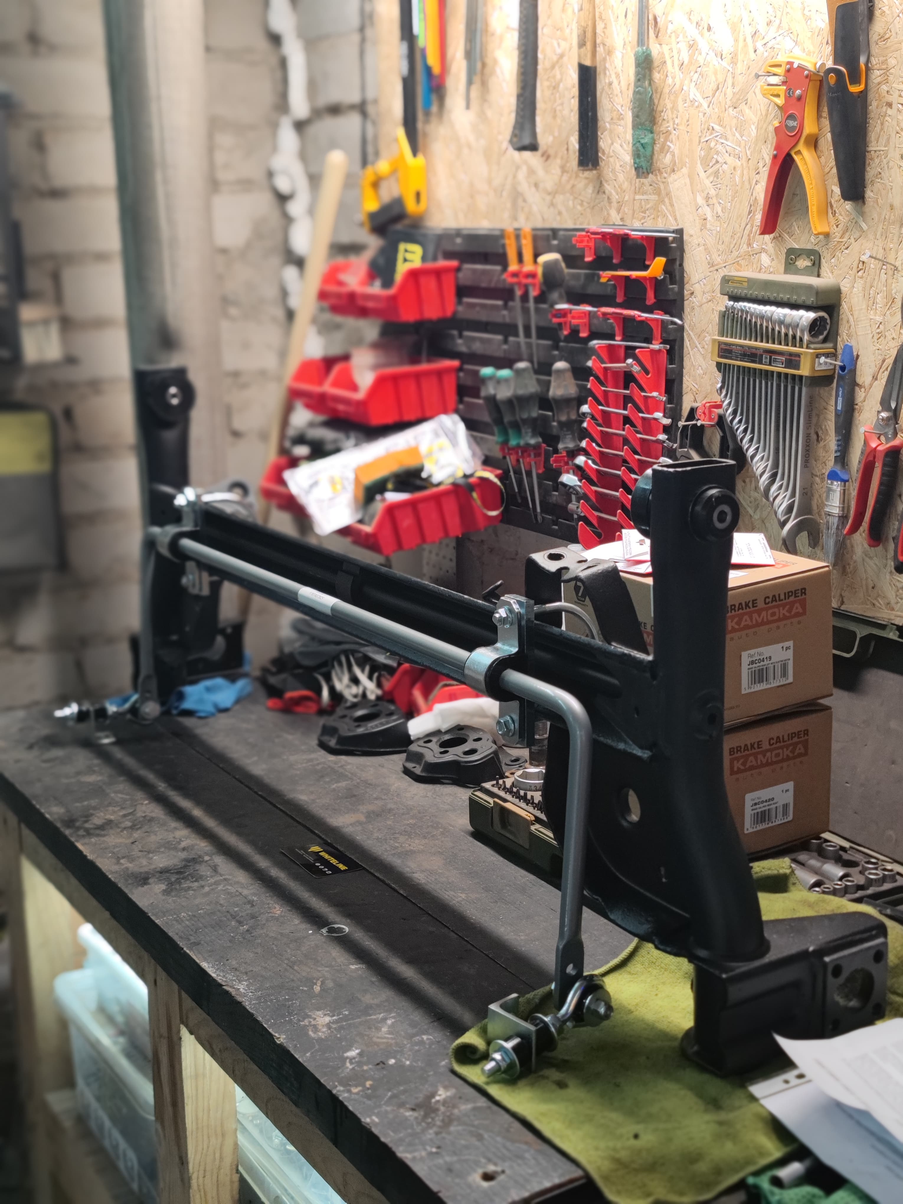

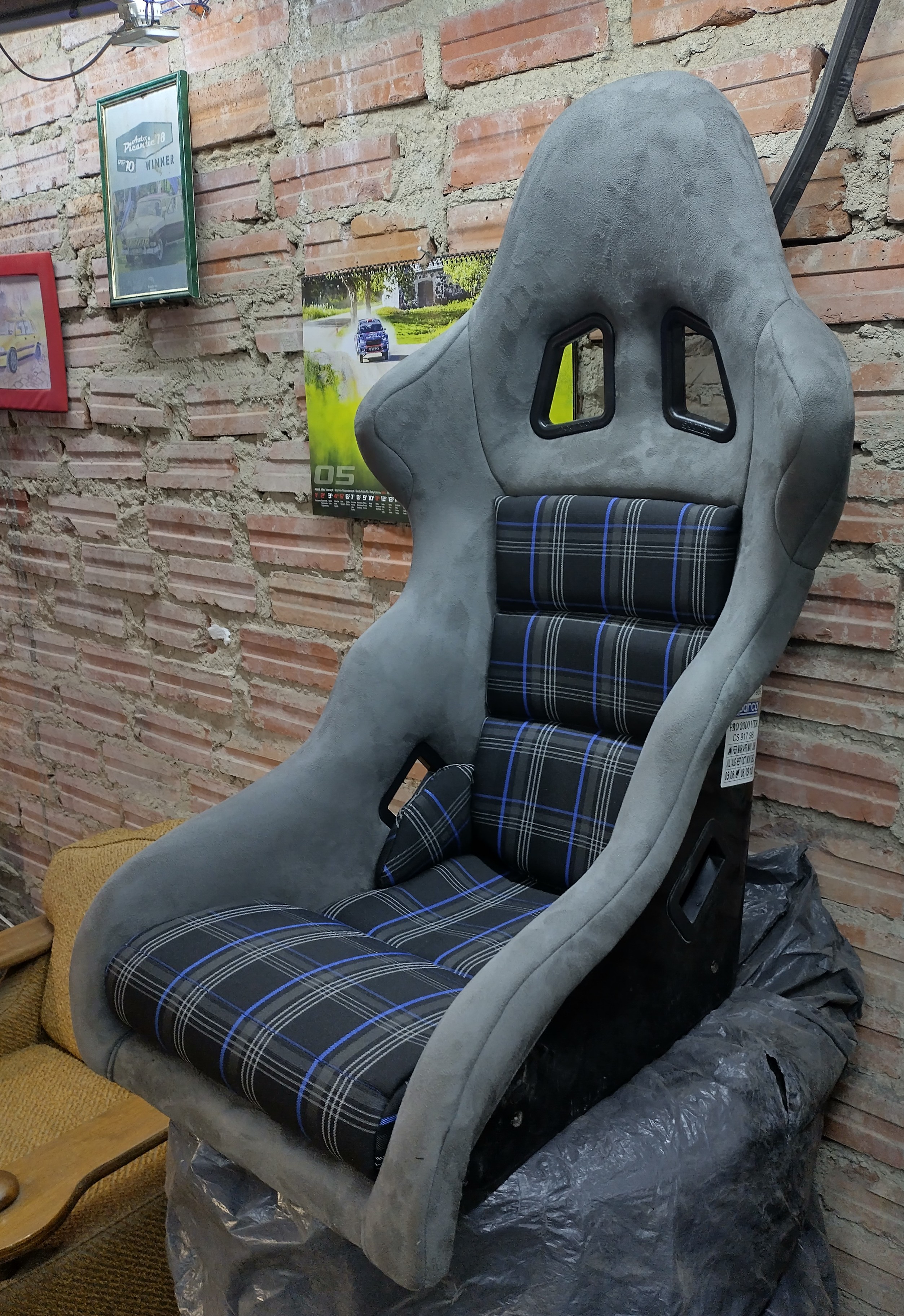

Got the chair reupholstered, as well as all rear beam redone.

Here is my outfit for most of the time and my friend without who I would not have undertaken the project. He is the guy who makes all the welds!

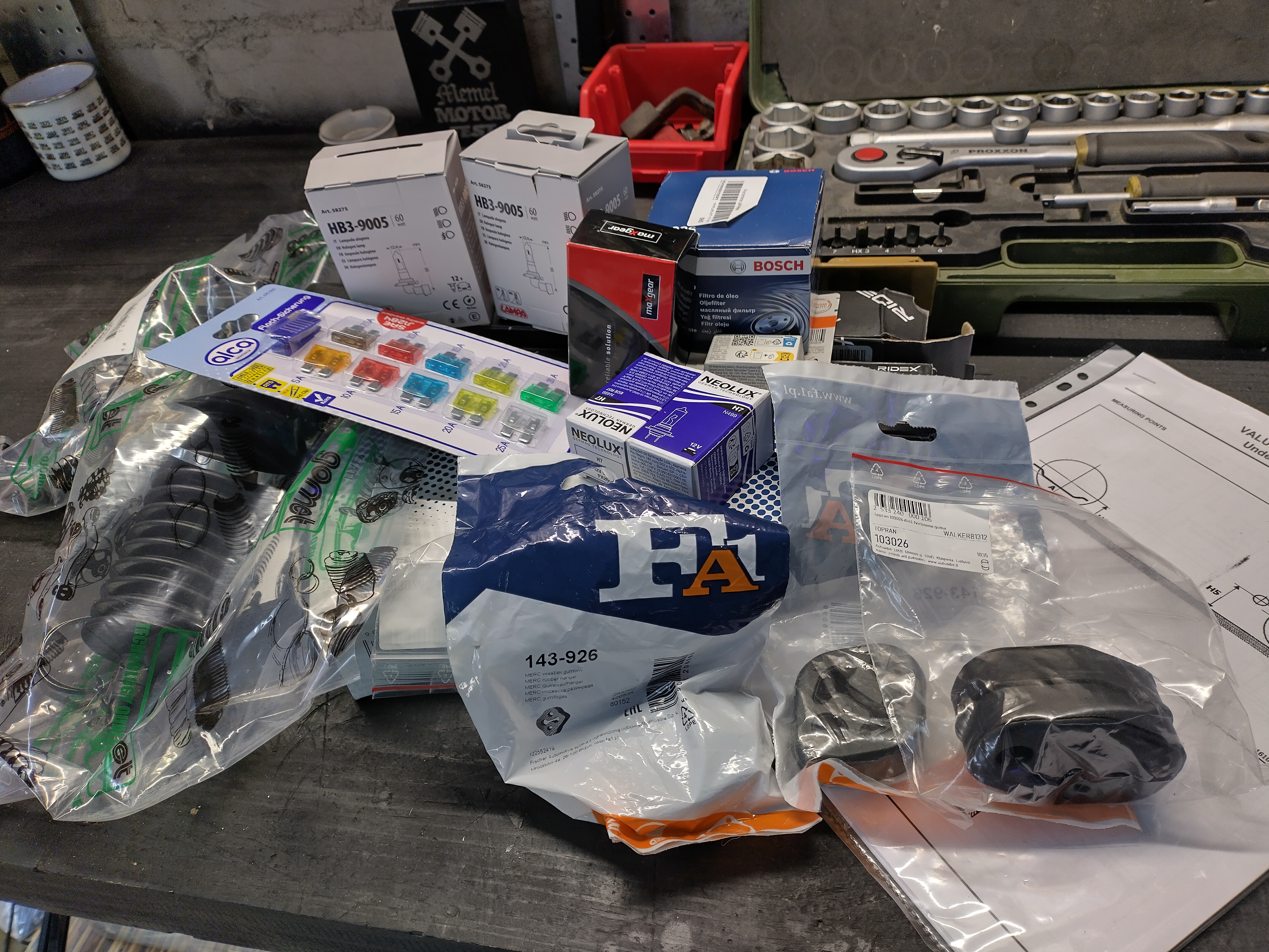

Also, I have bought way too many things for the clio, so I even lost count of what I got, but here is some of the things for it:
  • bosch spark plugs
  • idle control valve
  • subframe mount
  • exhaust mounts
  • all front headlight bulbs
  • footrests
  • goodridge braided brake lines
  • Rear discs
  • Rear pads and clips
  • front bumper
  • 3d fog light ducts
  • Oil and filter
  • power steering rods, ends and rubbers
  • Powerflex Black Race Series Rear Beam Bushes
  • Whiteline Rear Anti Roll Bar + Kit
  • Aftermarket Heavy Duty Lower Arms – Pair
  • Powerflex Non-Cup Front ARB Kit – Black Race
  • Eibach Clio 2RS Rear Camber Shims - 0.5 Degree
  • Powerflex Clio 2RS SMI Steering Rack Bushes
  • Powerflex Clio 2RS 14mm Camber Bolts
  • All new bolts for suspension
  • Chair reupholstered
  • Fuel Filter
  • Handbrake cables
  • Rear brake lines
  • Cabin filter
