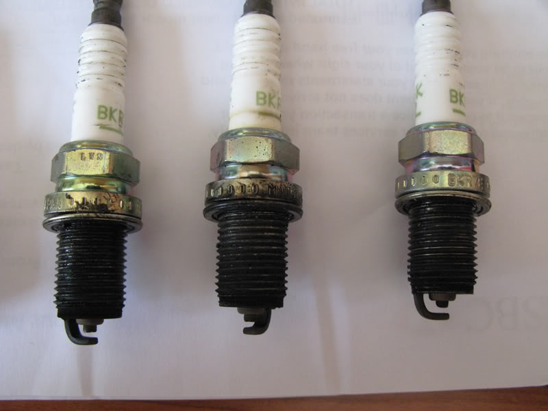

Andy you say you have proven it testing on a rolling road. Surely a road car will go through a much larger heat range when used as a daily driver and a test over say a month of driving and checking the state, visually, of the plug after this period would be more conclusive.
I swapped those plugs for the standard 1*2 plugs. What effects would you expect to see by dropping a heat grade?
Actually regarding the test. I will check the state of the standard plugs I have fitted in my car after a month of driving. Thats unless my engine has blown ;)
