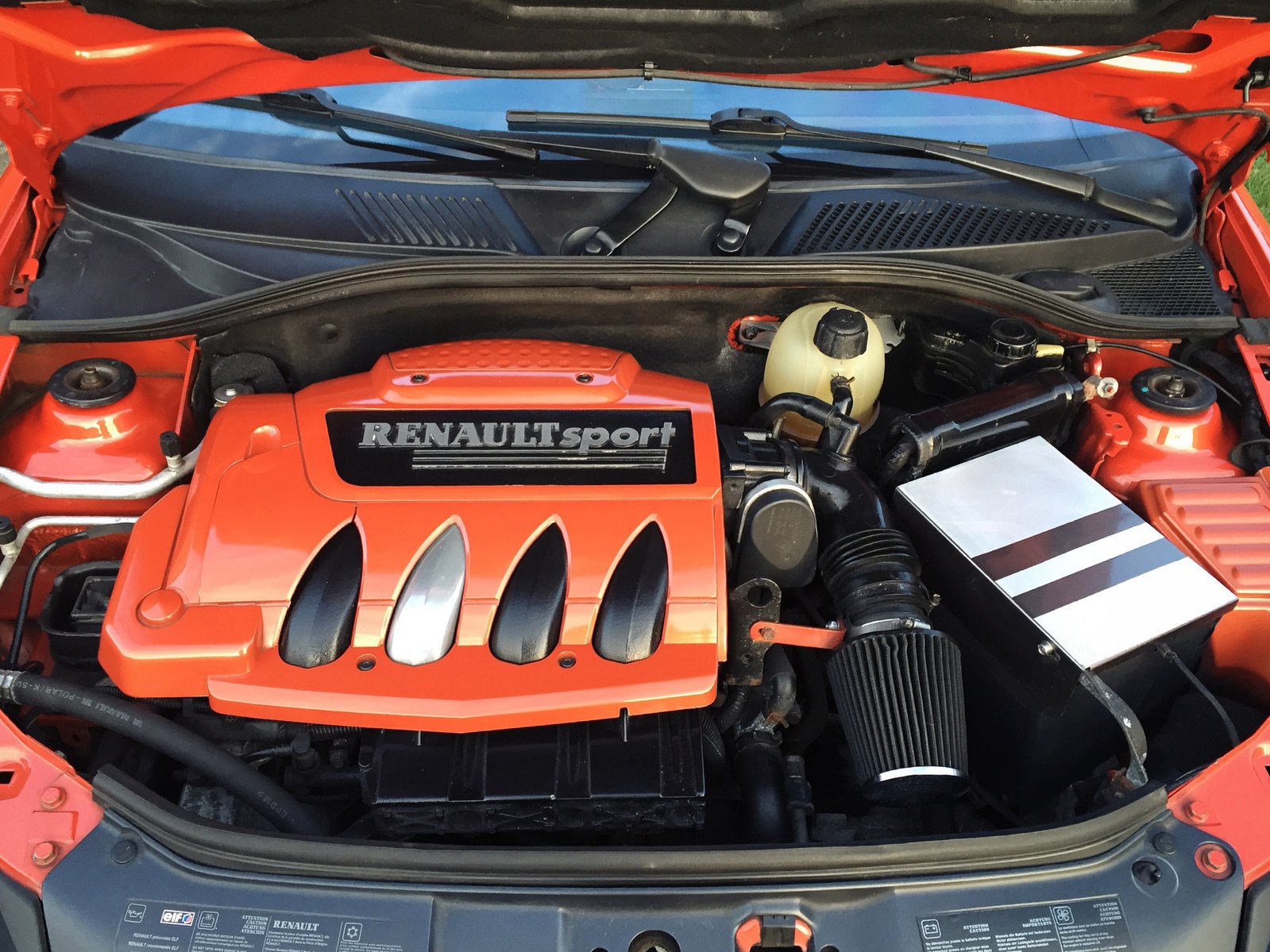

Ok, I've attached a photo so you can see exactly what it all looks like, but what can I do to improve the performance etc.? Induction kit etc. I also want to get the right colour code so I can paint the battery box cover and other parts (if anyone knows the code for Inferno Orange) - thanks :)

Ok, I've attached a photo so you can see exactly what it all looks like, but what can I do to improve the performance etc.? Induction kit etc. I also want to get the right colour code so I can paint the battery box cover and other parts (if anyone knows the code for Inferno Orange) - thanks :smile:
Yea, standard airbox is a better setup than that.
You're just sucking in tons of hot air, and loosing power in the process.
R3k1355
Here is where you need to install a cone filter, preferably with a ducting and a heat shield or something to stop it drawing hot air from the engine bay.
Wouldn't have the filter sat there for a start :)

When I went to efi for my car mapped he said the car performs and acts well with the ktec style type induction kits that sit behind the headlight, he said the ones with the cone just sat on the end of the oem 90 degree bend like yours gives out some really weird readings.
He said the longer the induction hose the better the readings seem to be.
