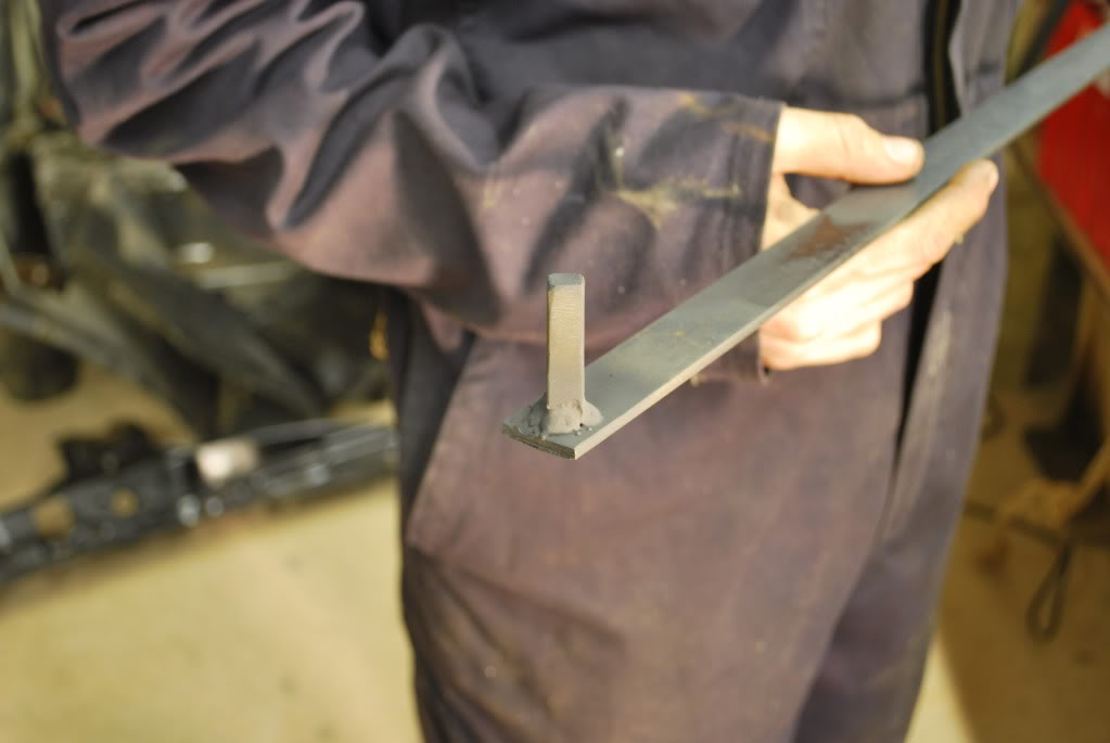

something like this, we also welded a female torx to the other side for the tensioner bolts as there is f**k all room down there

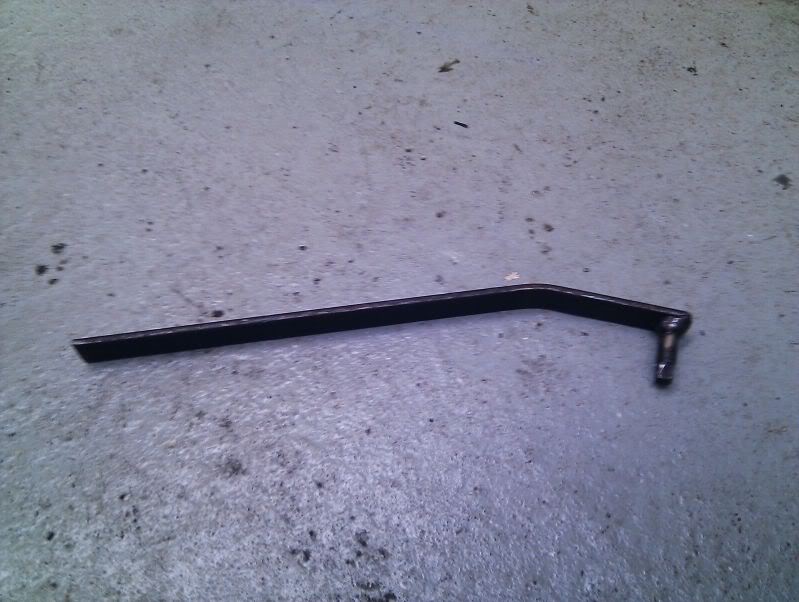

I used a 3/8 extension and snapped the bottom clean off the new tensioner. I made one to the exact size. Had to strip down and rebuild the old tensioner body with all the new parts.

I'll post a pic of the finished product.
