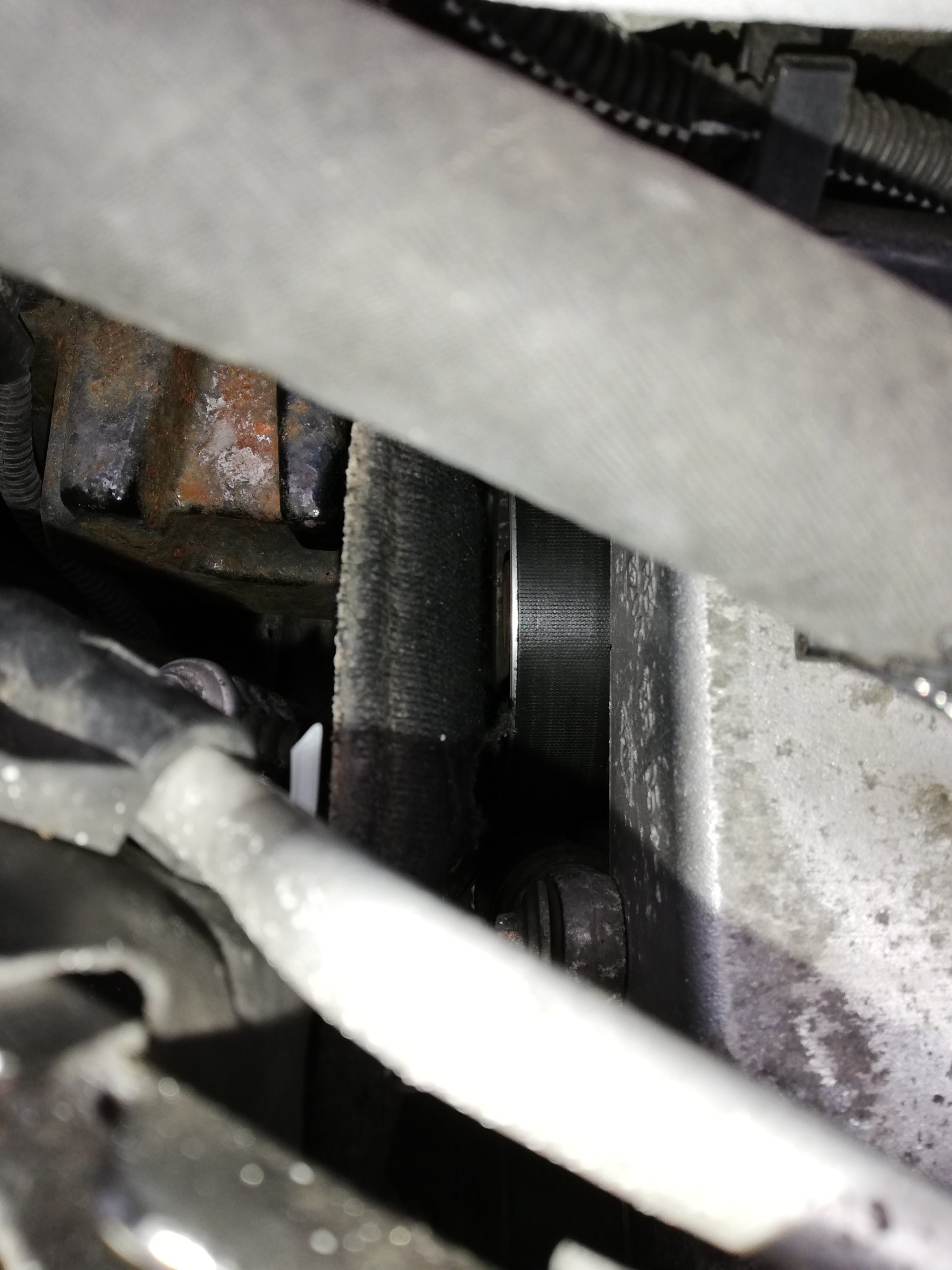

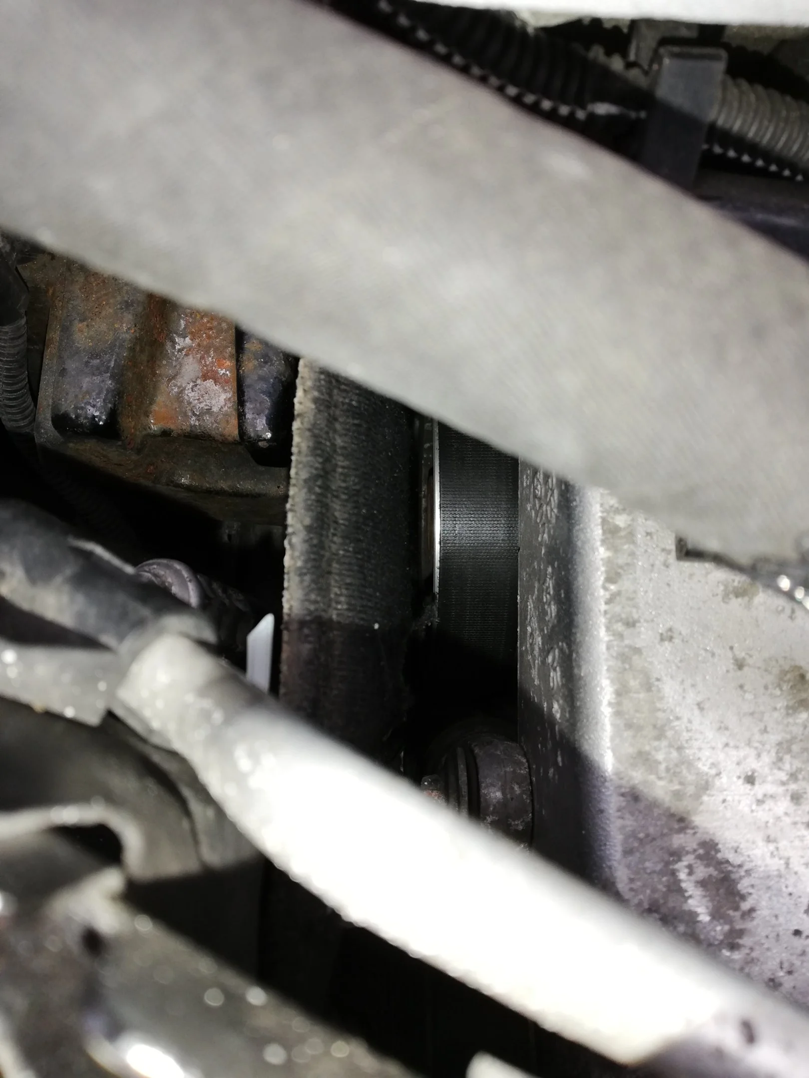

After spending some time this afternoon under the bonnet I've found that what seems to be a piece of sound deadening? Grey carpet material which was wedged down by the cam belt. The bottom of it seems connected but the top is loose, I have lifted the corner closest to the front and there seems to be a fixing holejust in front of the headlight . Does anyone know what part I need to fix it into place?

Would you say this looks right as to where it fits?
