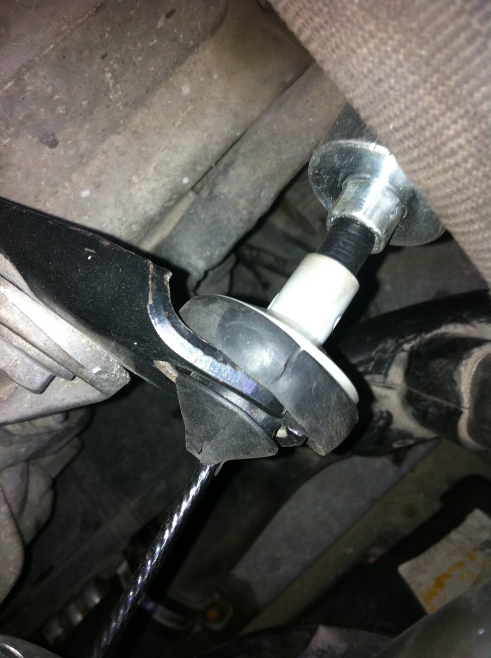

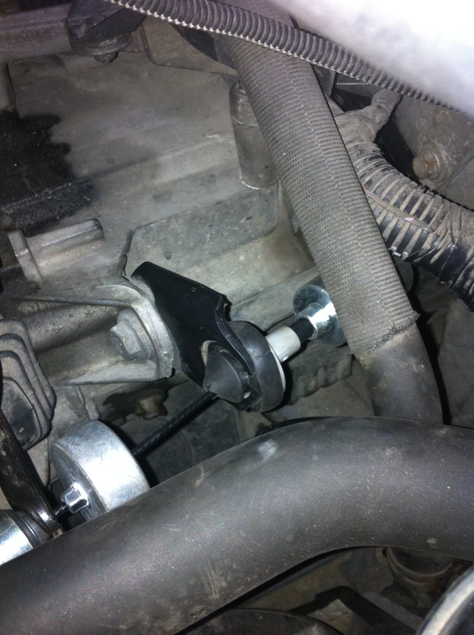

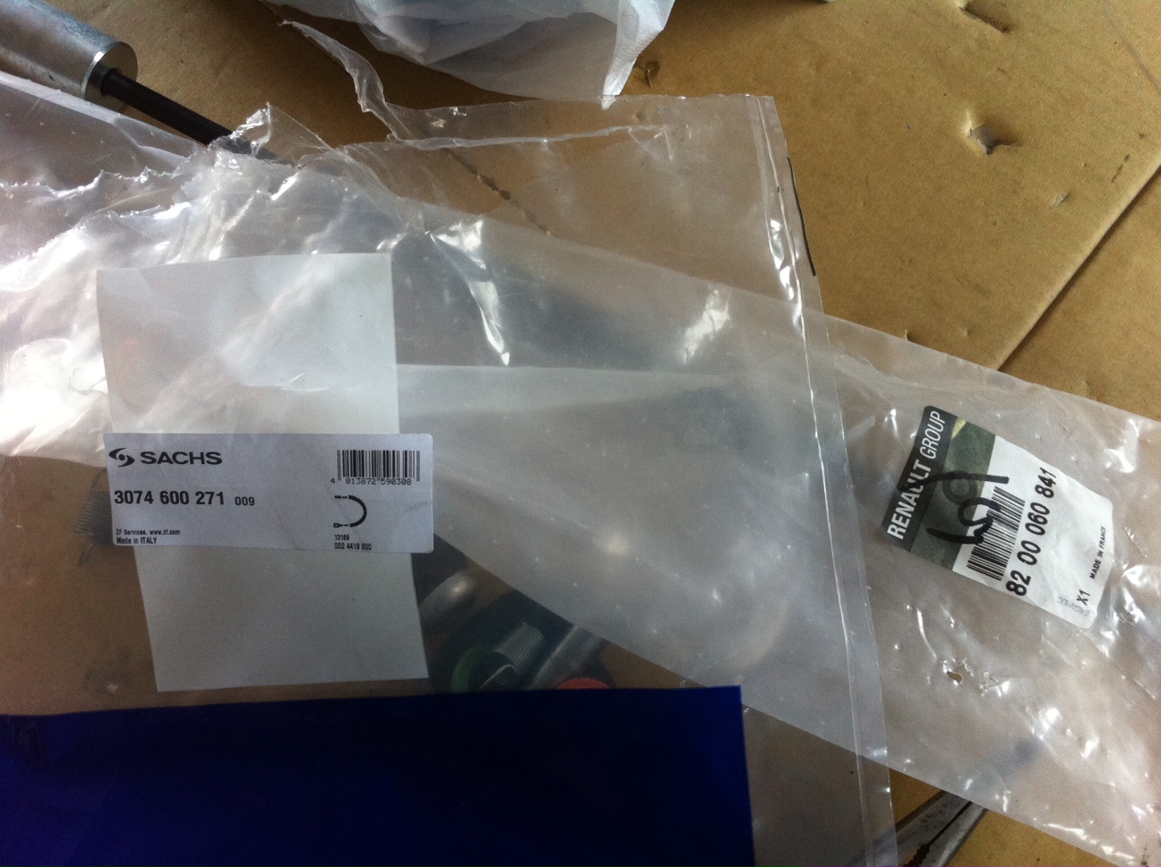

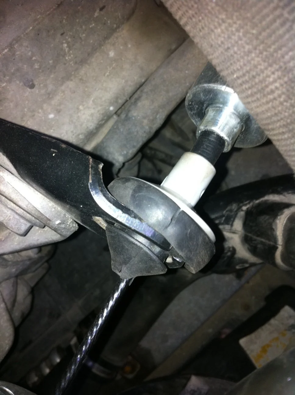

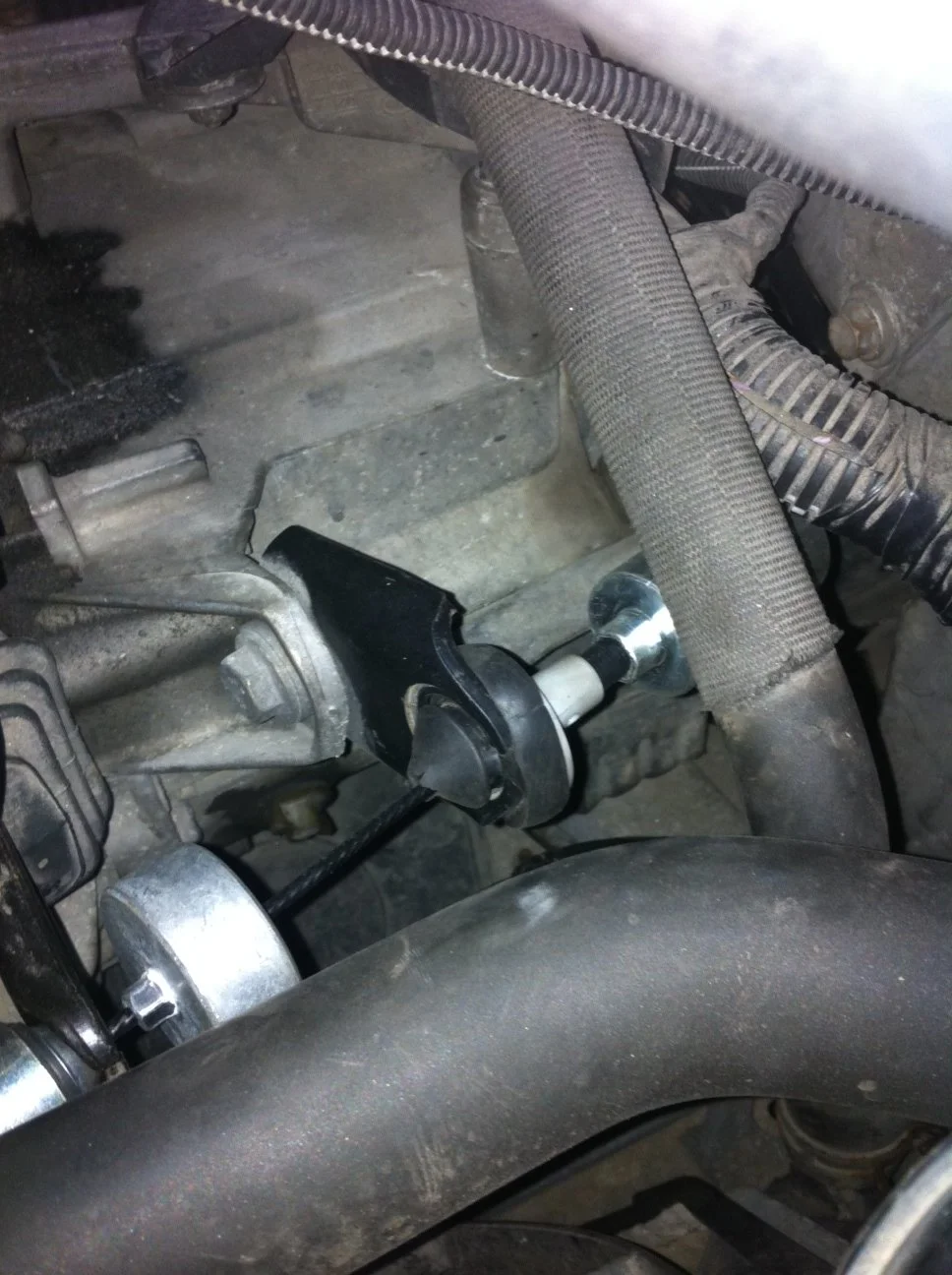

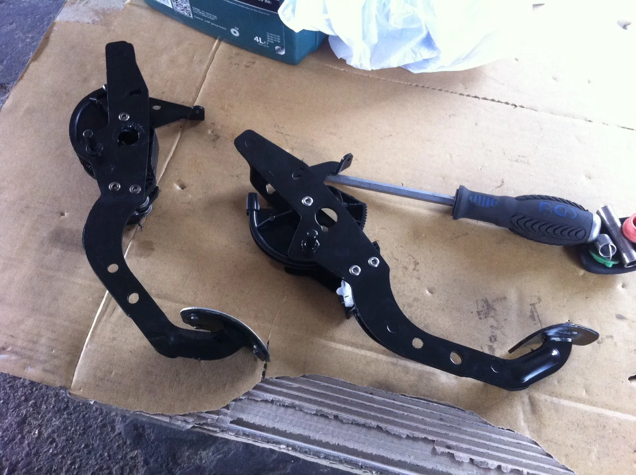

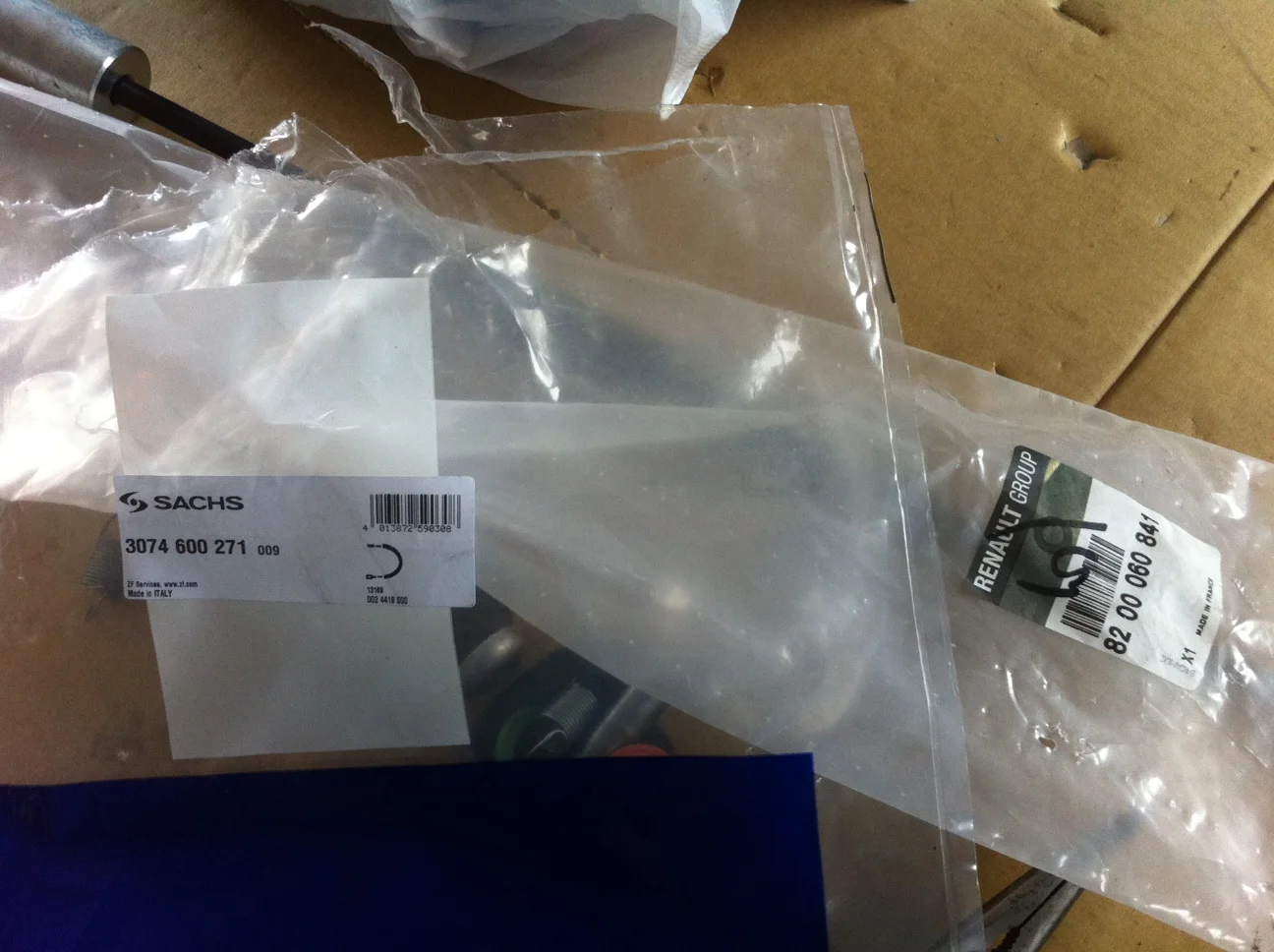

I own a 2004 Clio 182 and a while ago my problems started with the clutch, cable and pedal. I'll put the story in order:
- first of all my old cable started working a bit ruff so i changed it;
- after a while the clutch started working hard until 2 months ago the cable got out the pedal and couldn't be put back;

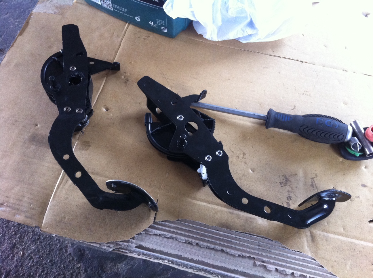

- i bought a new pedal, a new cable and changed those;
- after just 1 week the cable had the same problem with the rubber bush and i decided to also change the clutch.
Now i have new pedal, a new cable and a new SACHS clutch. Everything is working fine, i'm happy with the clutch feeling but as you can see in the pics, the rubber bush from the cable decided o snap again. I have to mention that the clutch isn't too hard, it's normal for a Clio.
Please help me with a advice. I don't know what to do :(

That looks like it's pulling at a funny angle. Do you perhaps need to realign the black plate to line up with the entry angle and fork better?
Thank you very much. I think you are right and i'll try to align the cable and also to buy a genuine cable instead of the Sachs one. I'll be back with the result :)
