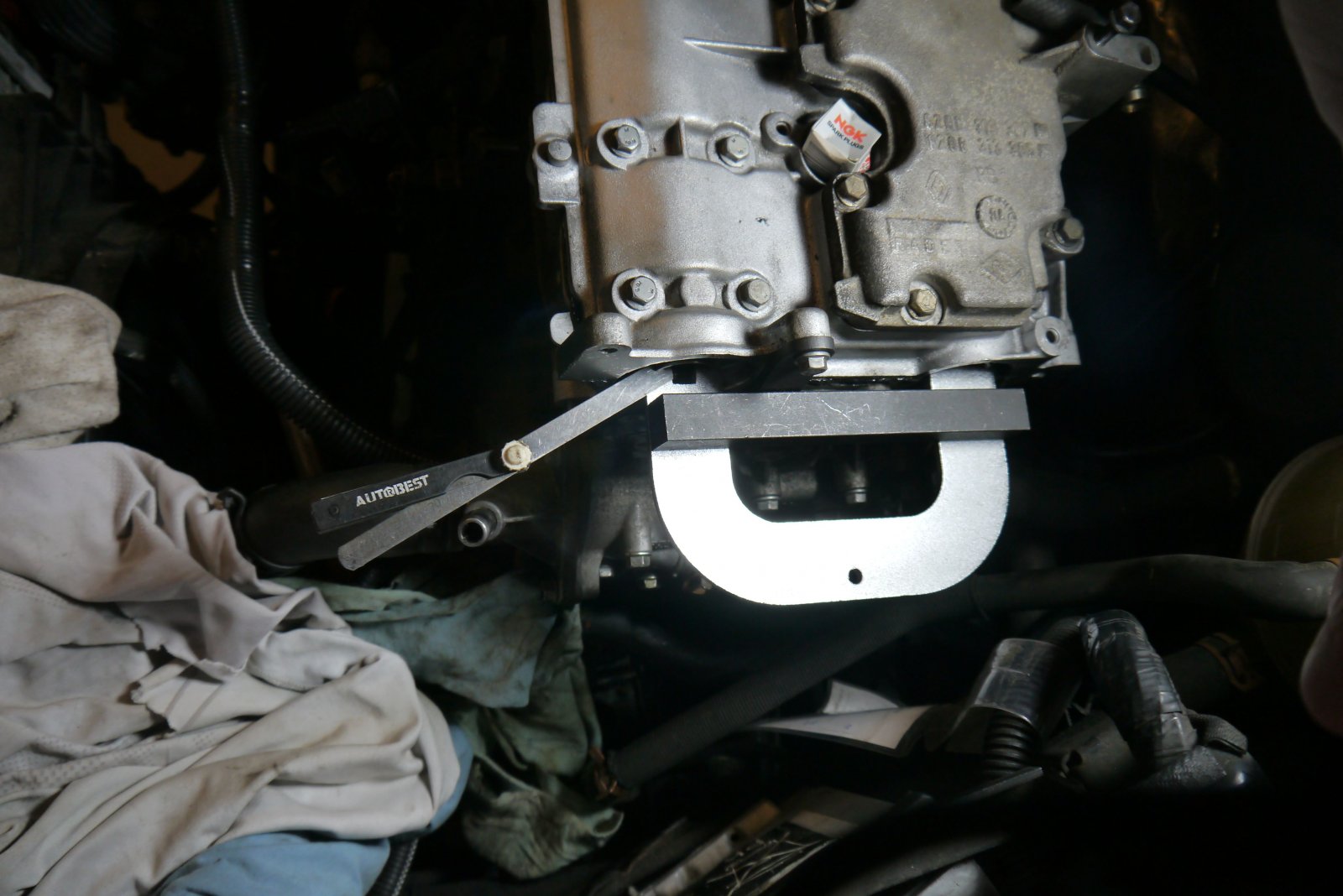

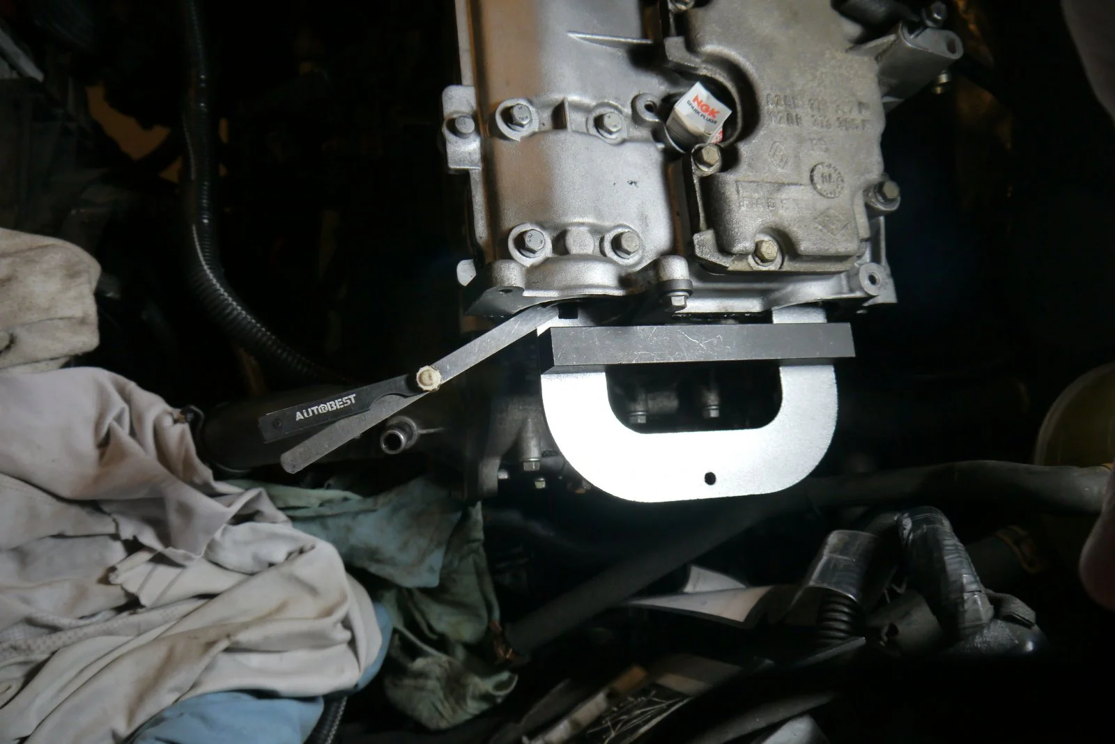

it's all so damed close to being perfect …. the final check of slotting the camshaft alignment tool back in place …. well I can get it in with a minimal amount of force … see attached picture showing the very slight mis-alignment ….. so … is it good enough ????

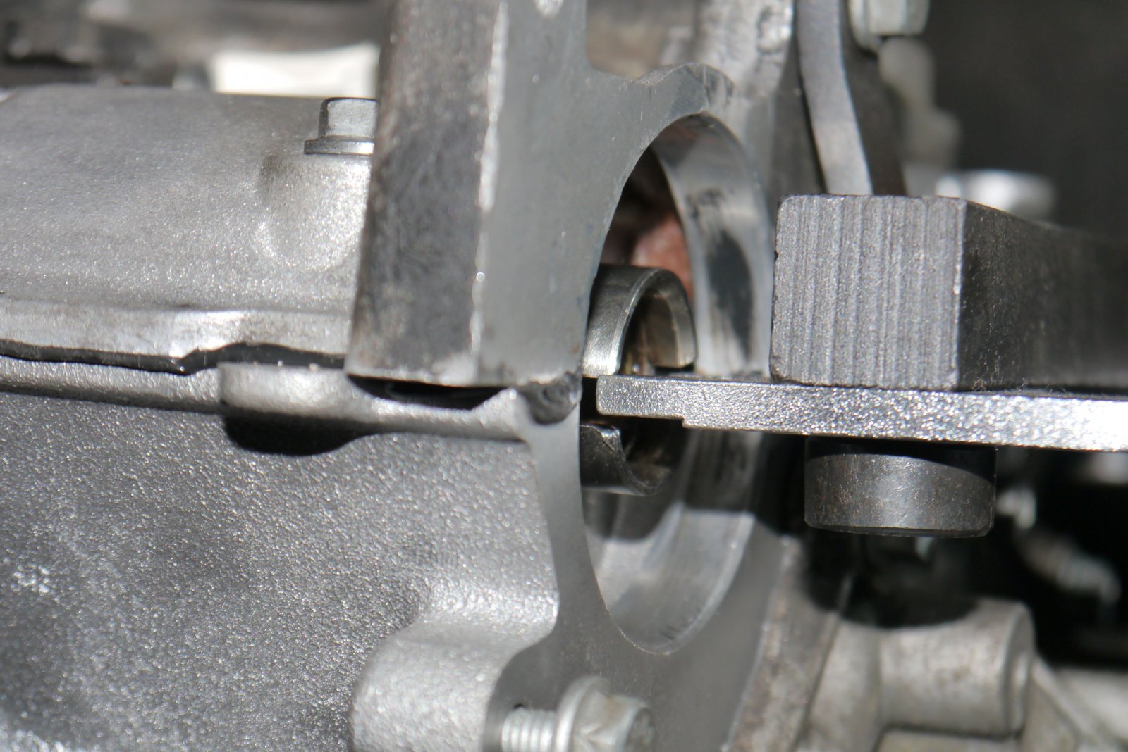

cam tool jig1.webp OK peeps … thanks for all the tips … not!

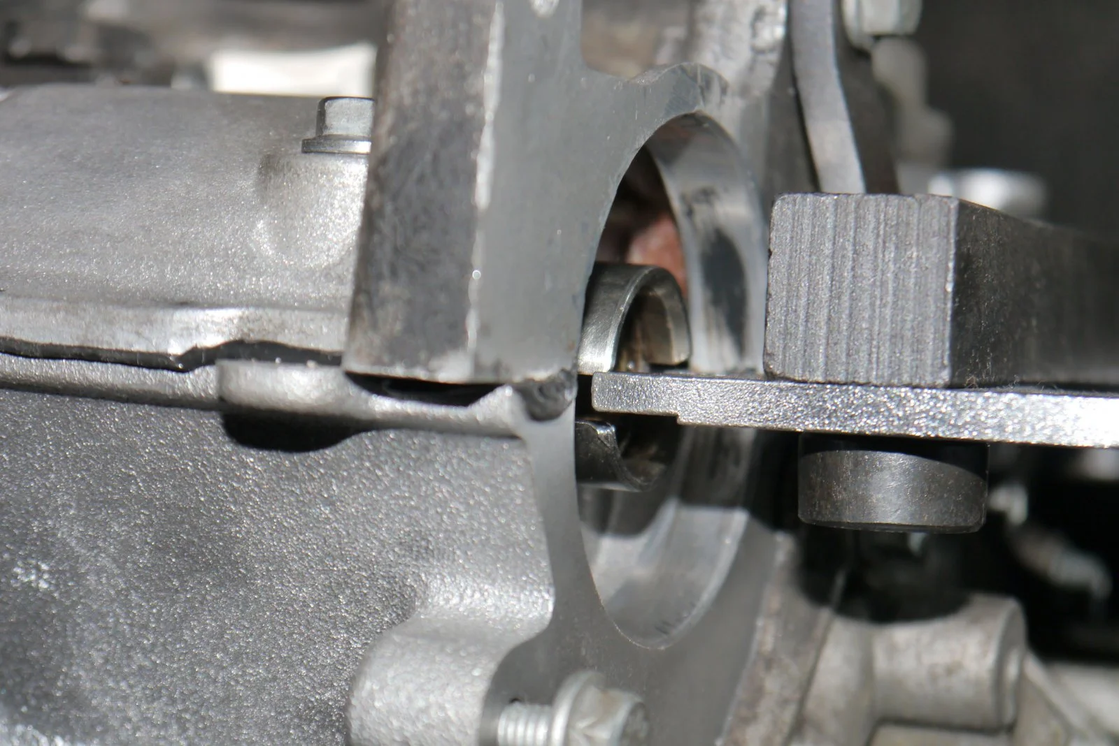

if you have the same problem getting that last little bit of adjustment in the cams so that the alignment tool can genuinely slip in/out in the final alignment check ….. i.e. after everything is bolted up and tools removed …. then trying inserting feeler gauges like this ….

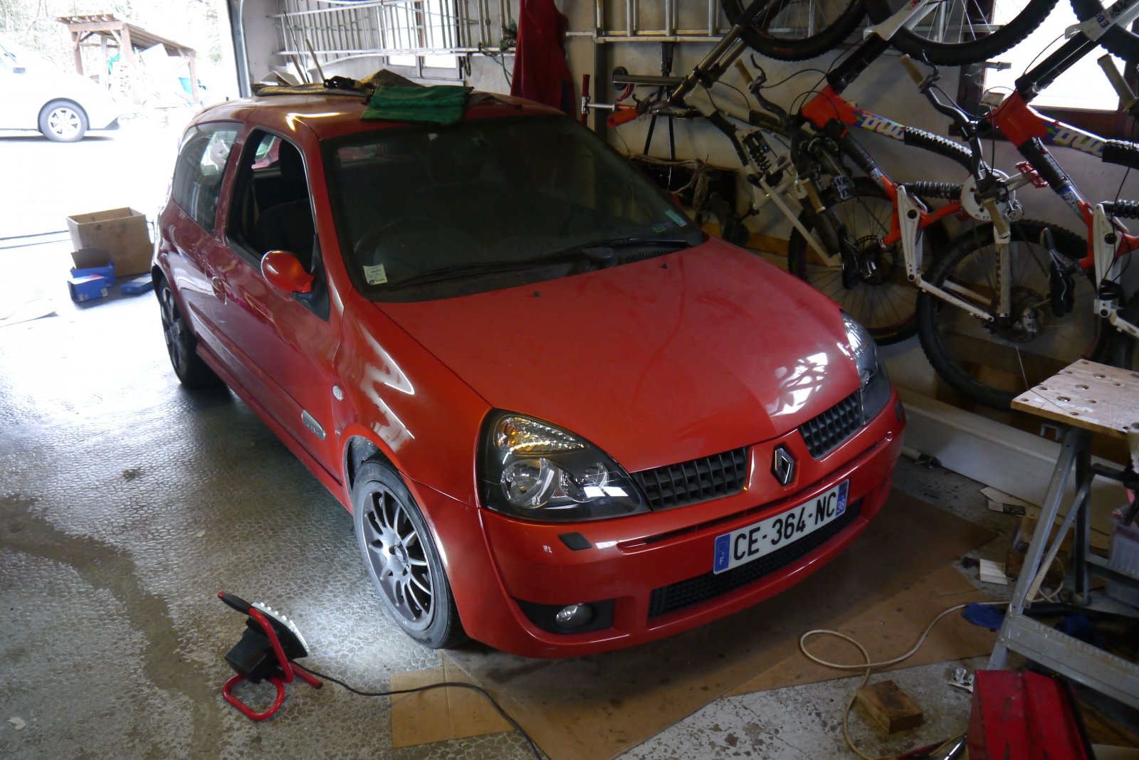

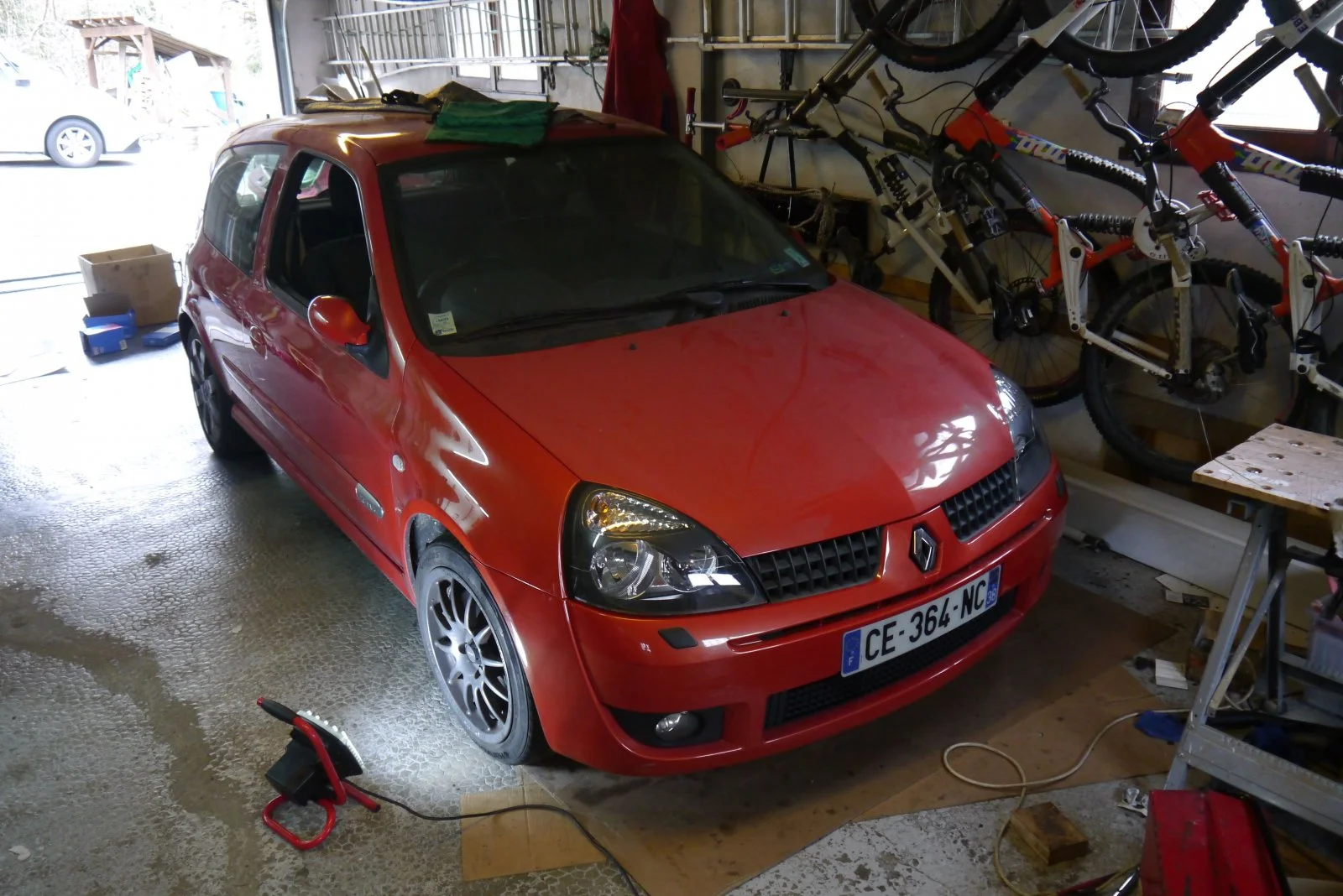

Well … would you believe it …… it started first turn of the key …. wheels on and ready to go to the car wash :smile:

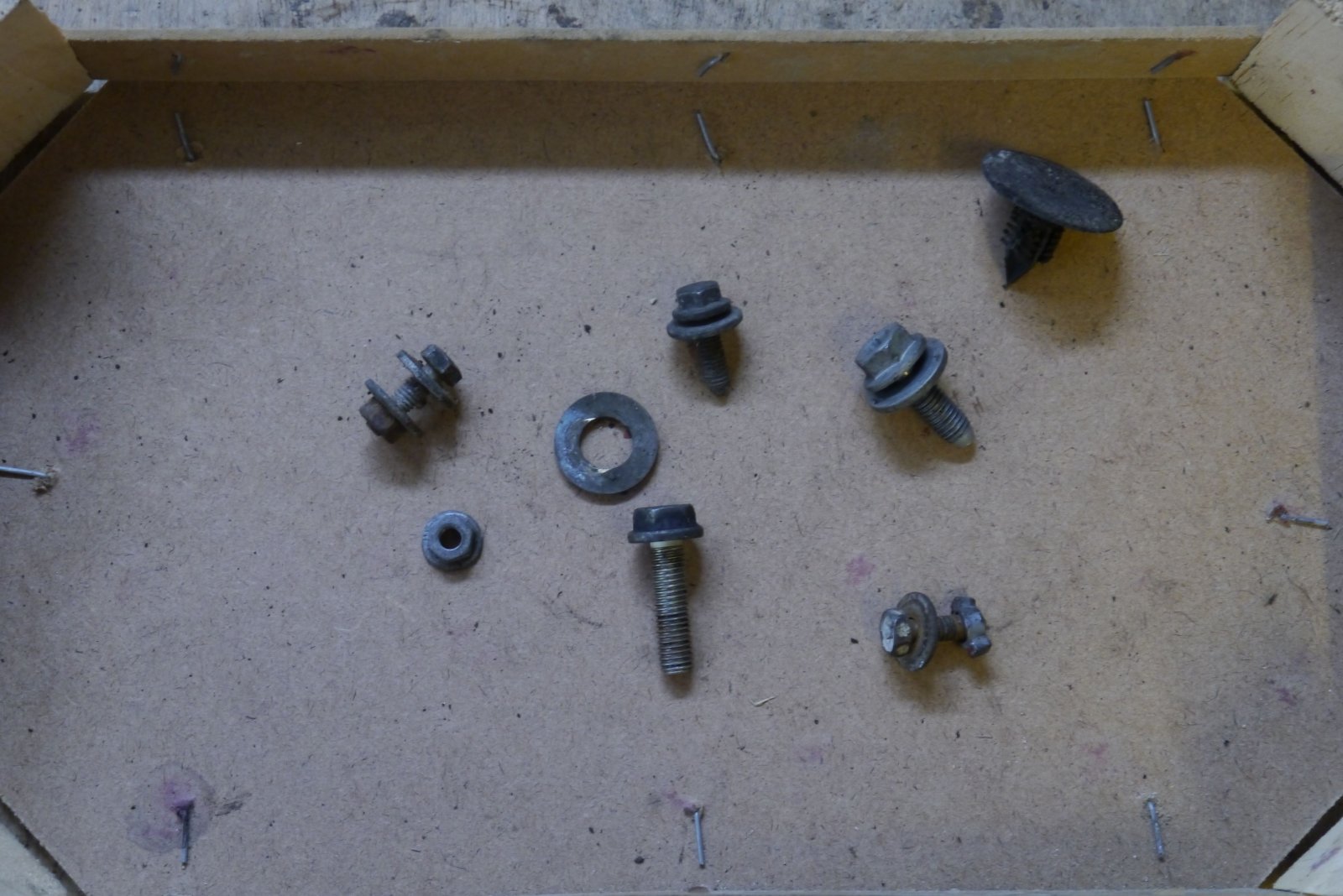

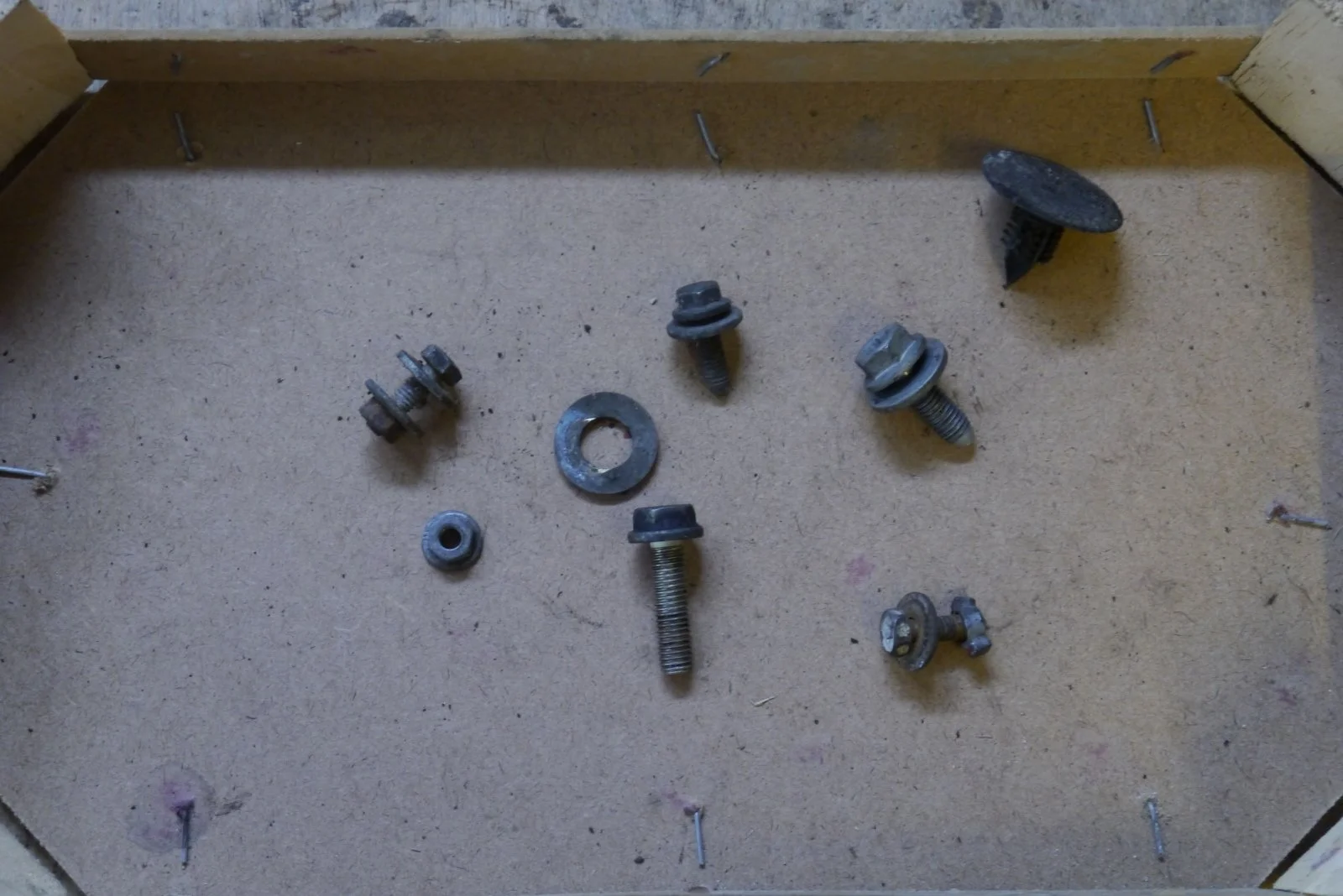

hmmmm as usual a few spares last over ???? rather curious … wonder what is going to fall off first ???

top tip 4 : use feeler gauges in the cam alignment tool if you just can quite get it set right
