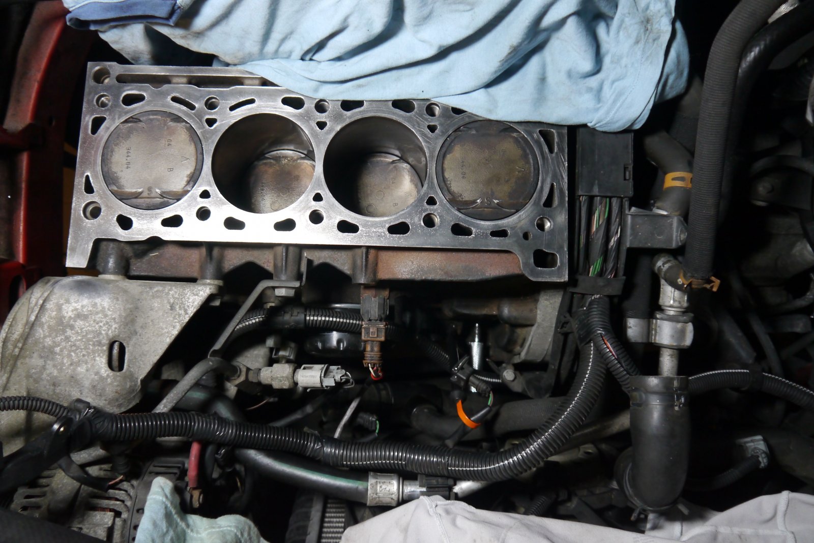

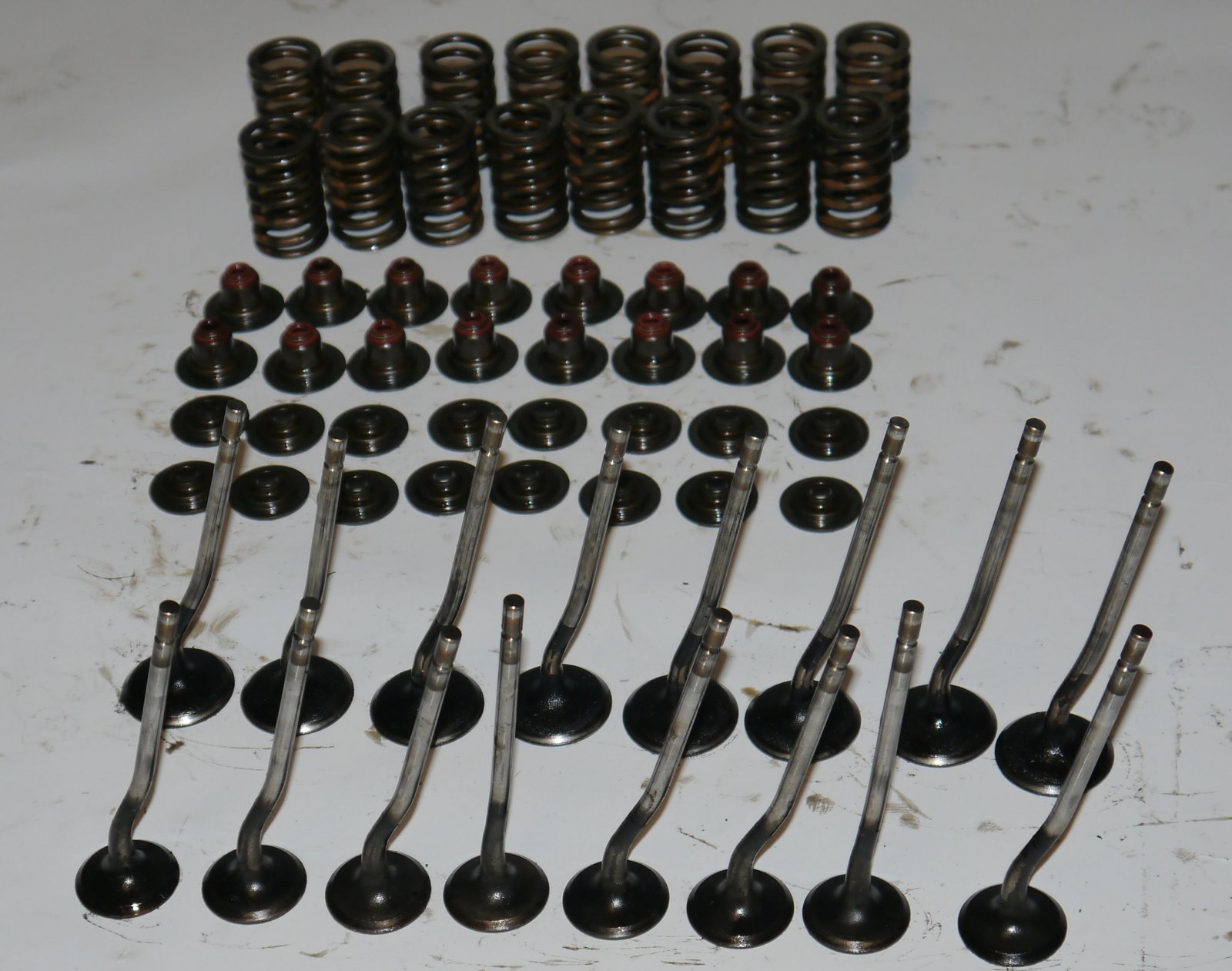

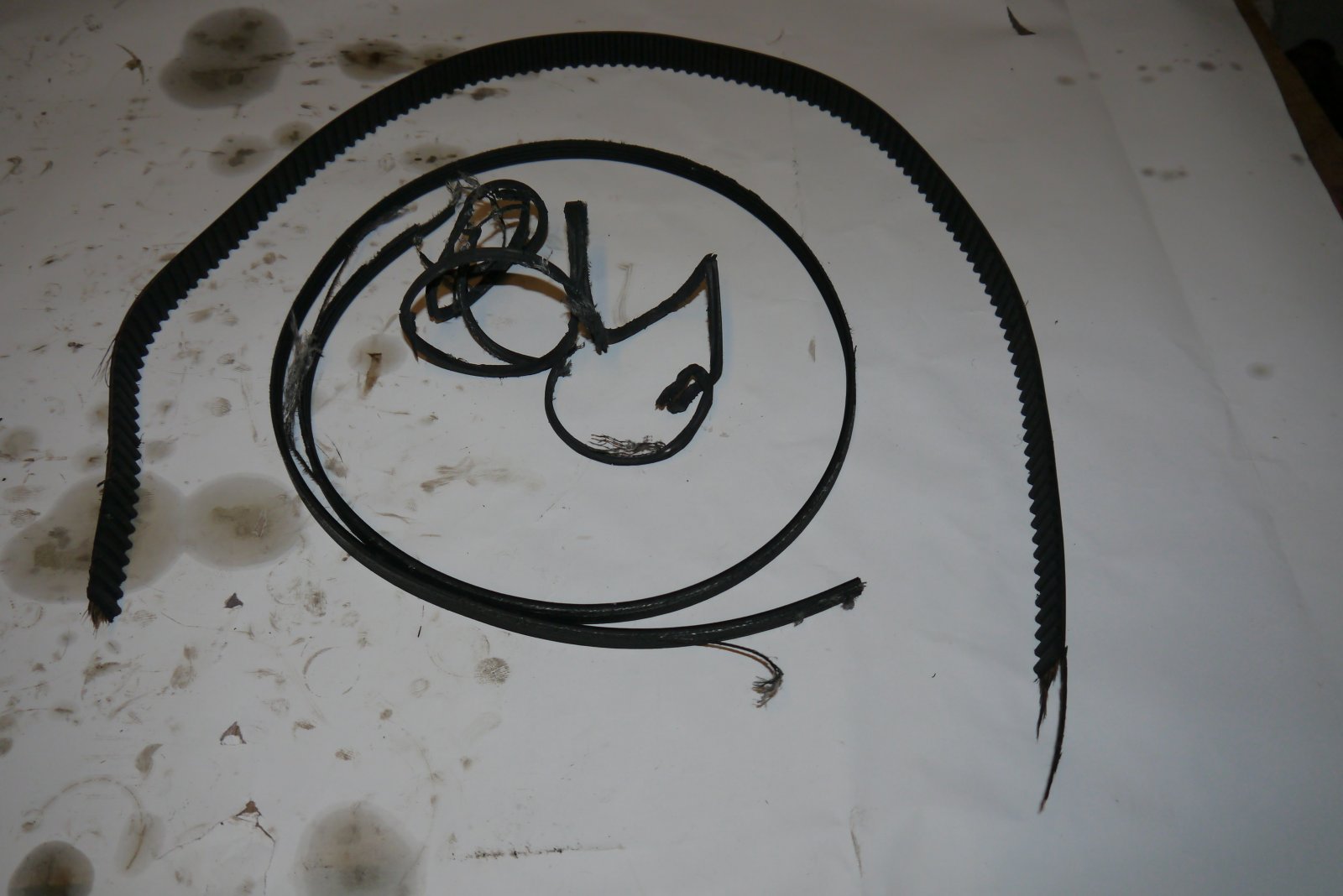

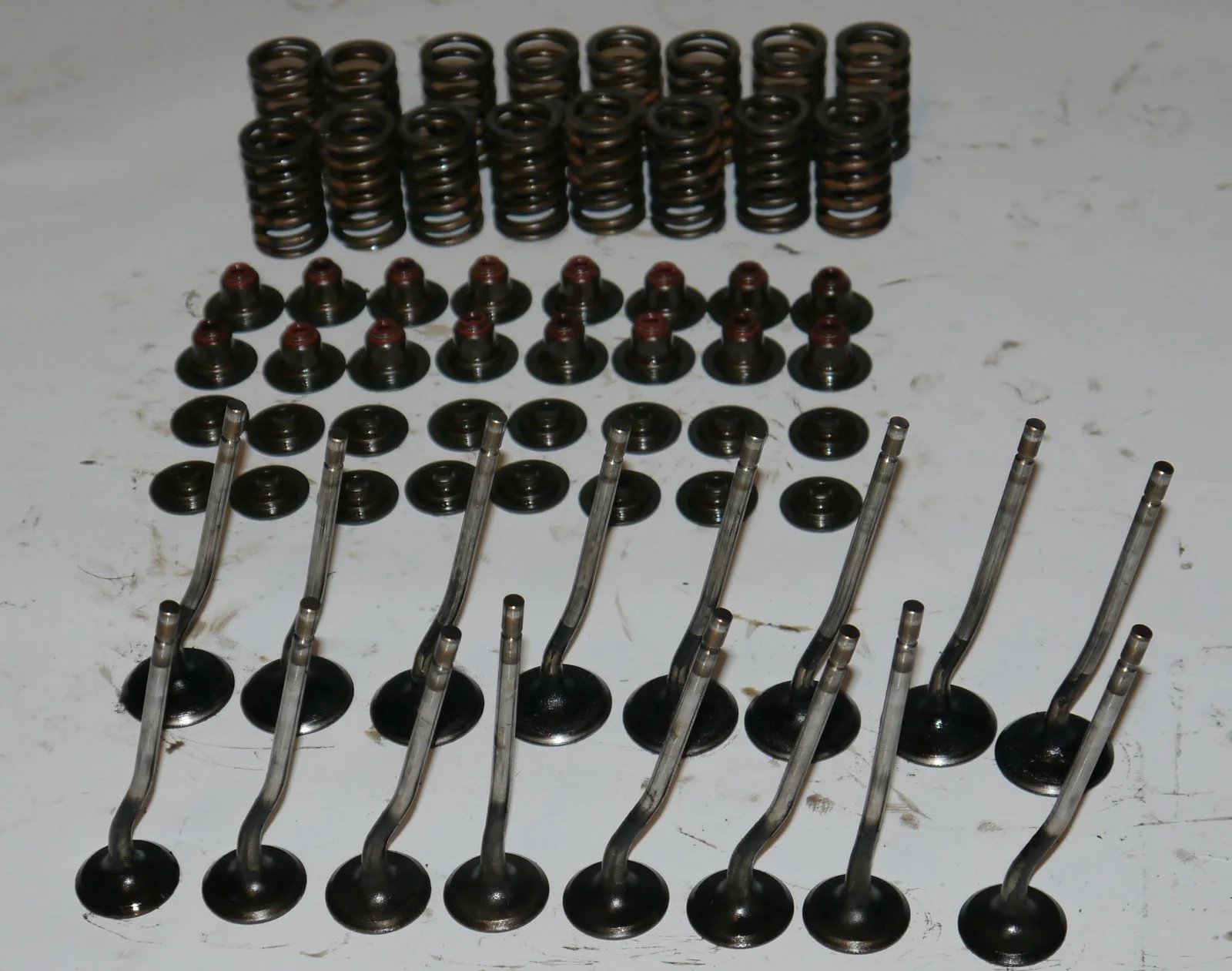

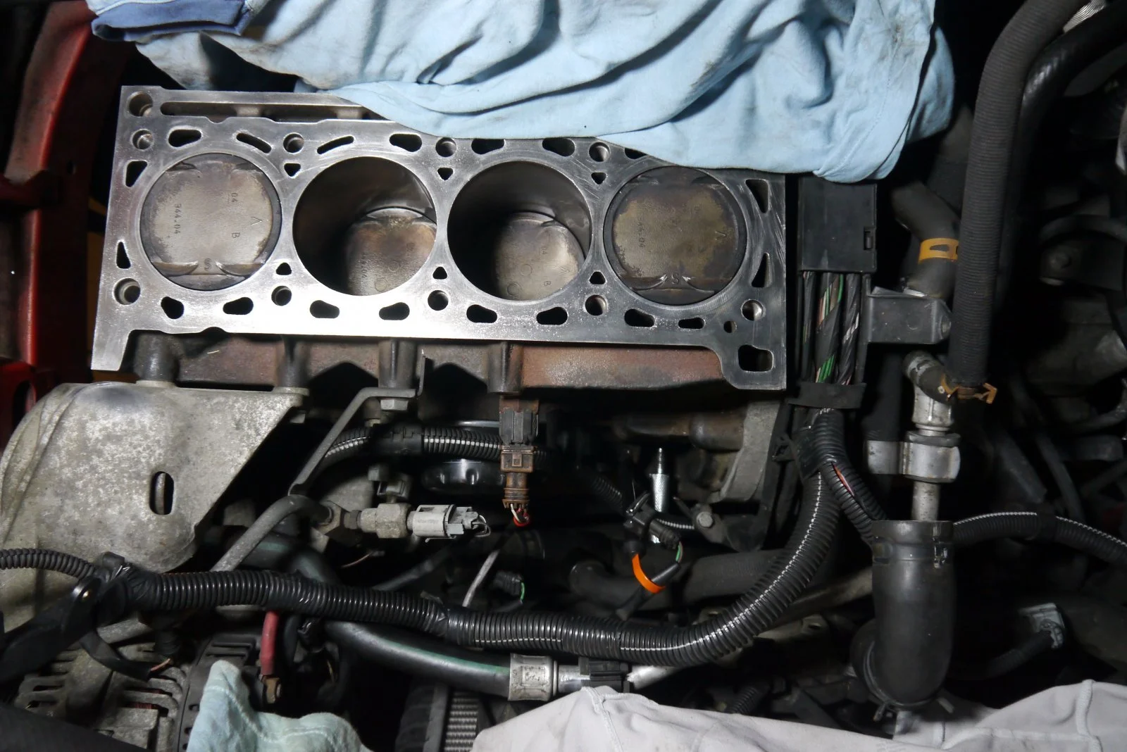

14 mths later the aux belt goes while over-taking up a hill (so flat out) ... with it goes the cam-belt and all the valves
prognosis from same garage who changed the belt kits (apart from not my fault!) was ~2400 quids to put it right !!!!
So I am starting down the DIY rebuild path
I have uploaded pictures of the before ... showing bent valves etc ... no idea how to link an album to this thread (advise welcome)

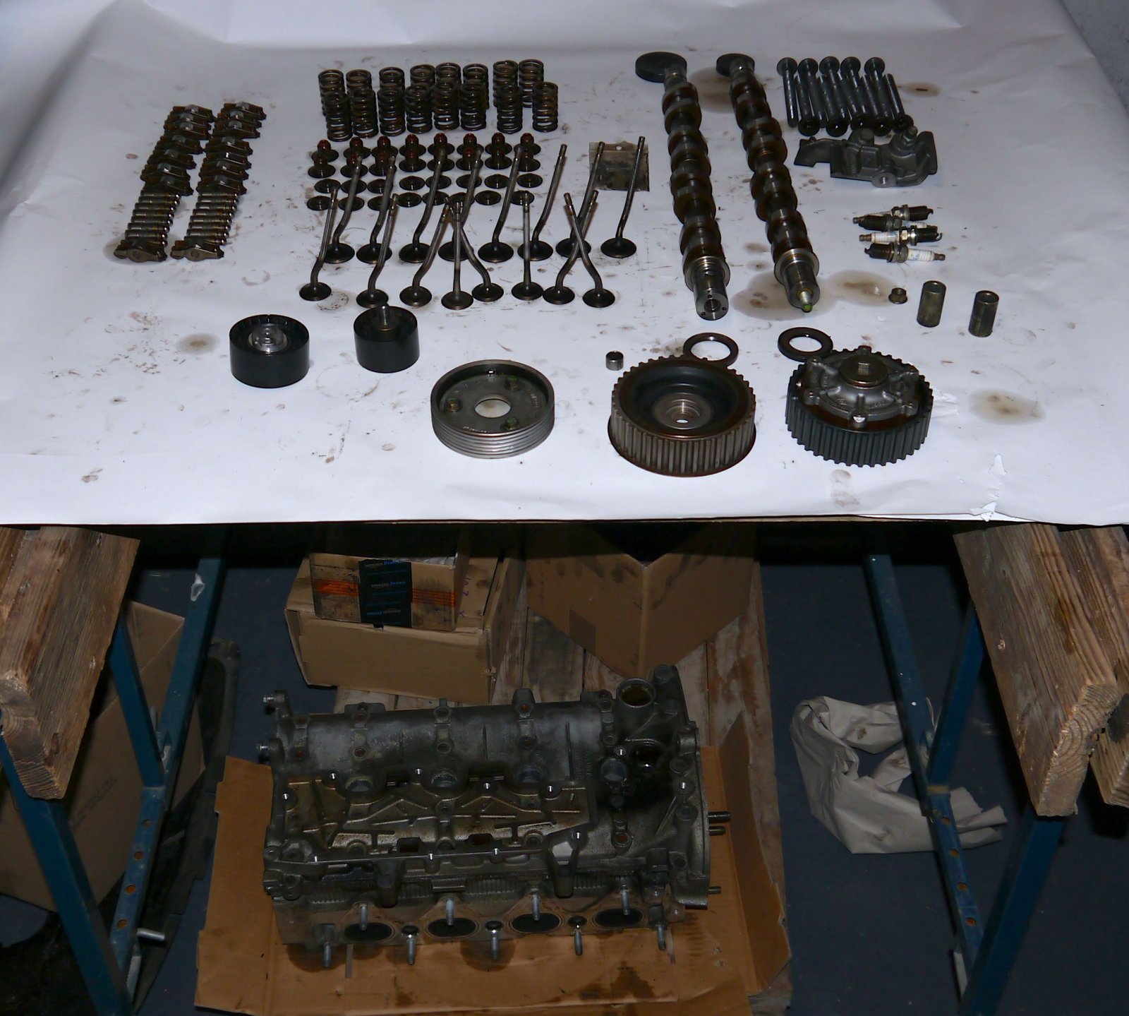

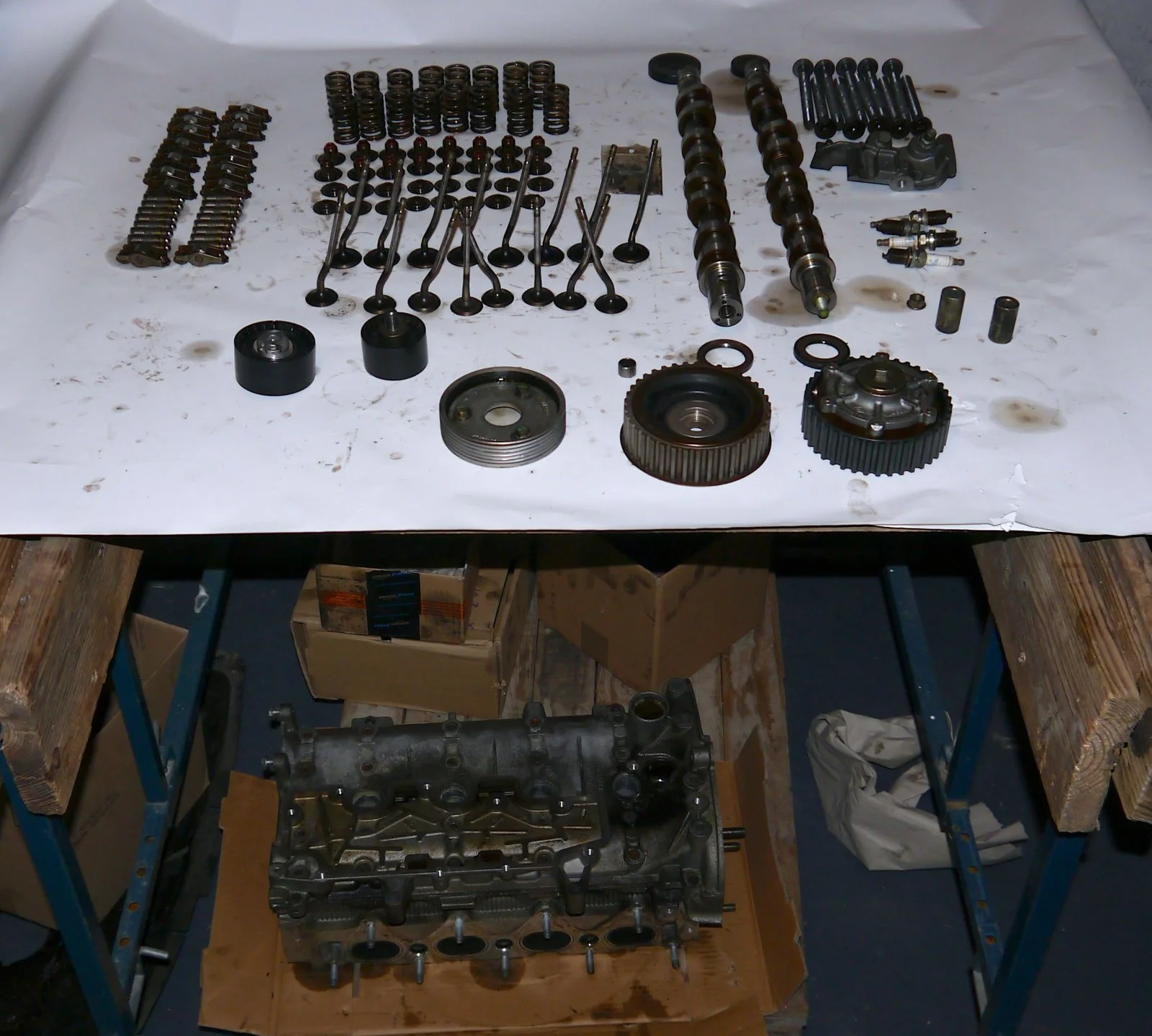

Update …… I have the recon head back from Rochdale motors ….. looks good! ….. new valves, oil seals and cam followers + skim and clean for 260 quid delivery and pick-up included!!! ….. now I have a stack of kit - aux & cam belt kits incl.pulleys, VVT cog, gasket set, camshaft seals, head bolts, water pump, cam setting tools, TORX tools …… block is shinny clean and checked flat to better than 0.1mm …….. so ready for the starting gun …. not quite …. still waiting for those replacement head alignment plugs … small & cheap …. but not optional …... I have a photo diary on google docs but no idea how to share it here ???

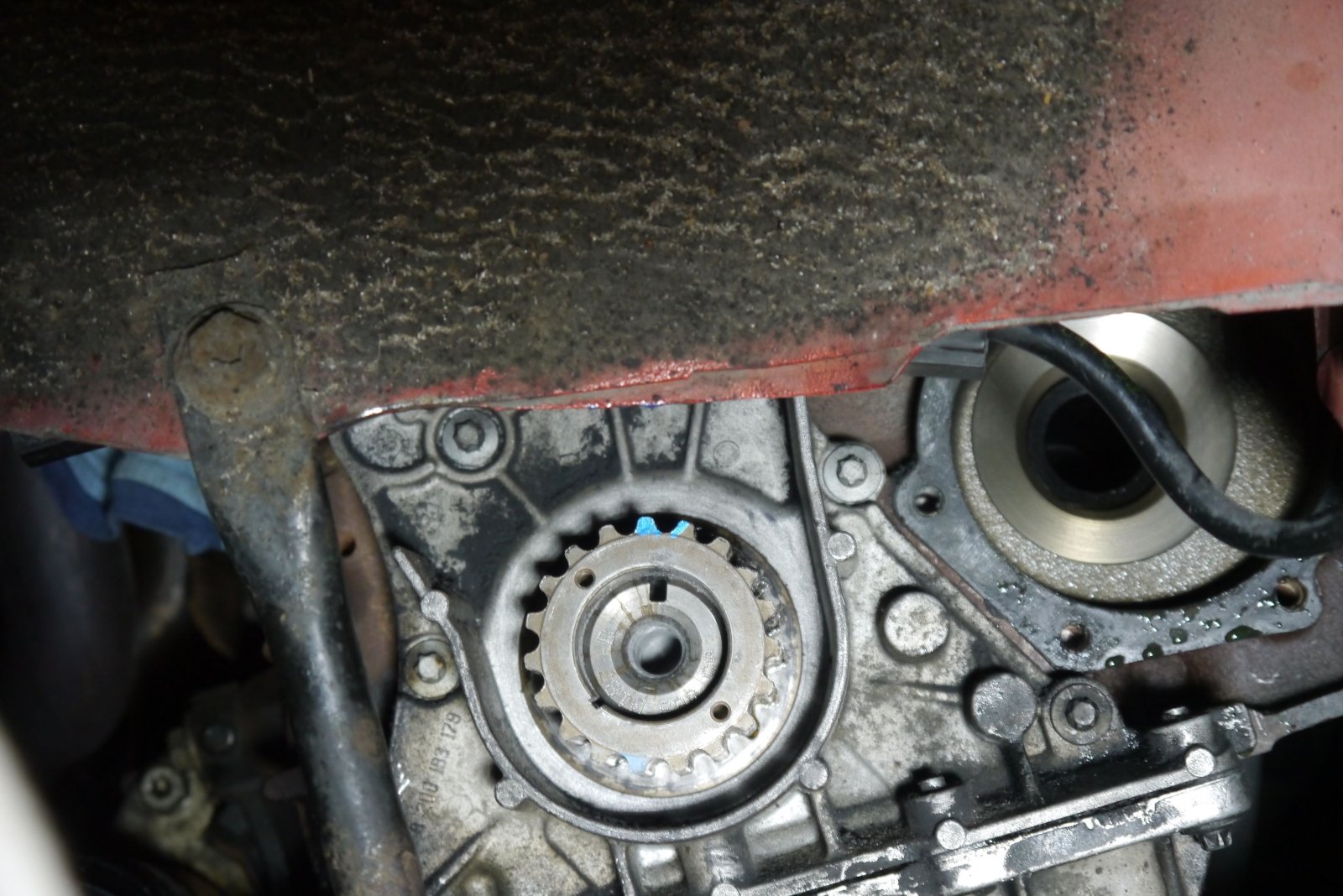

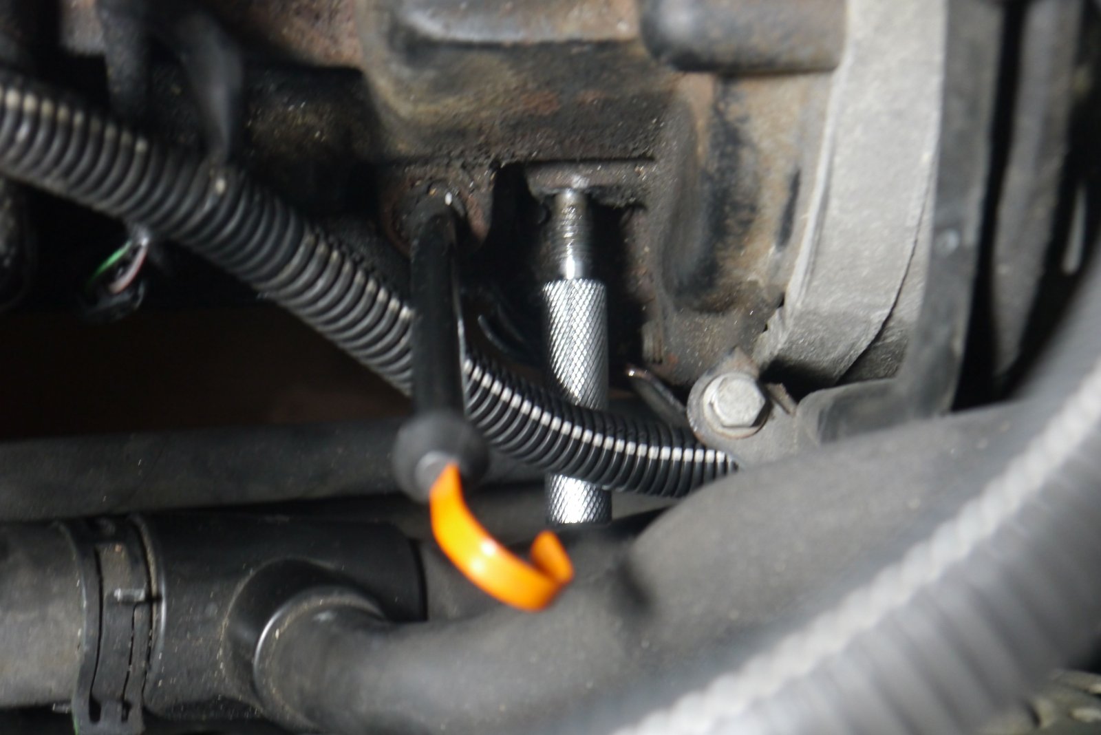

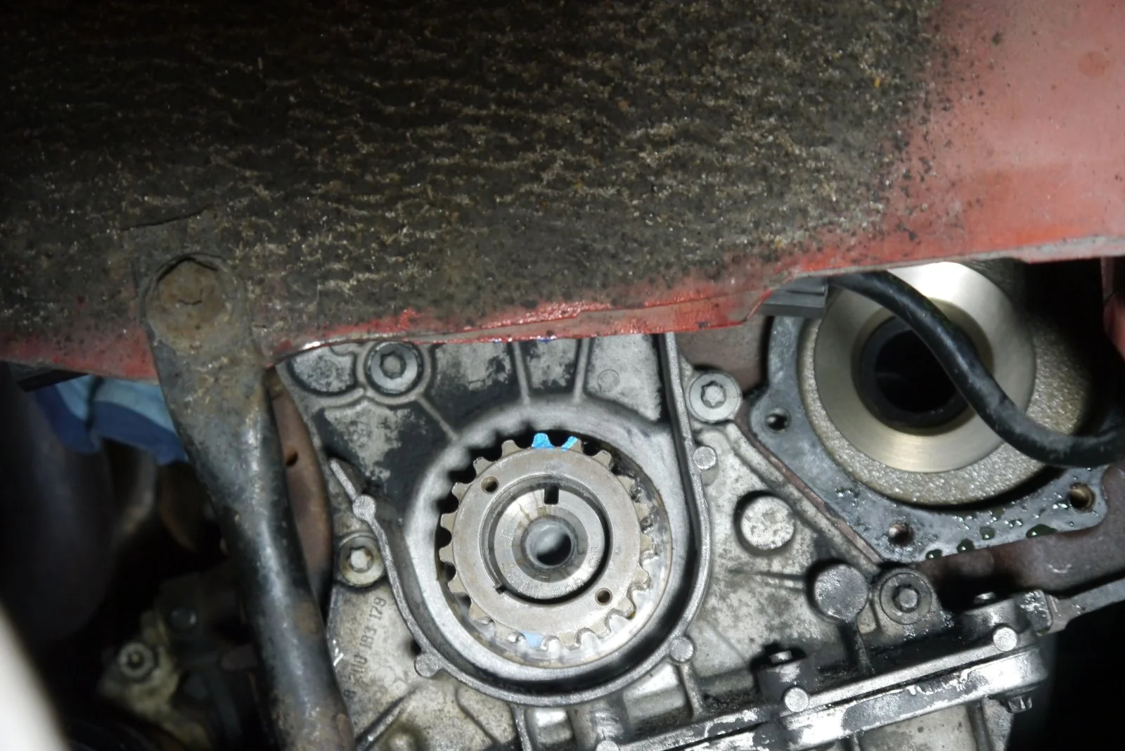

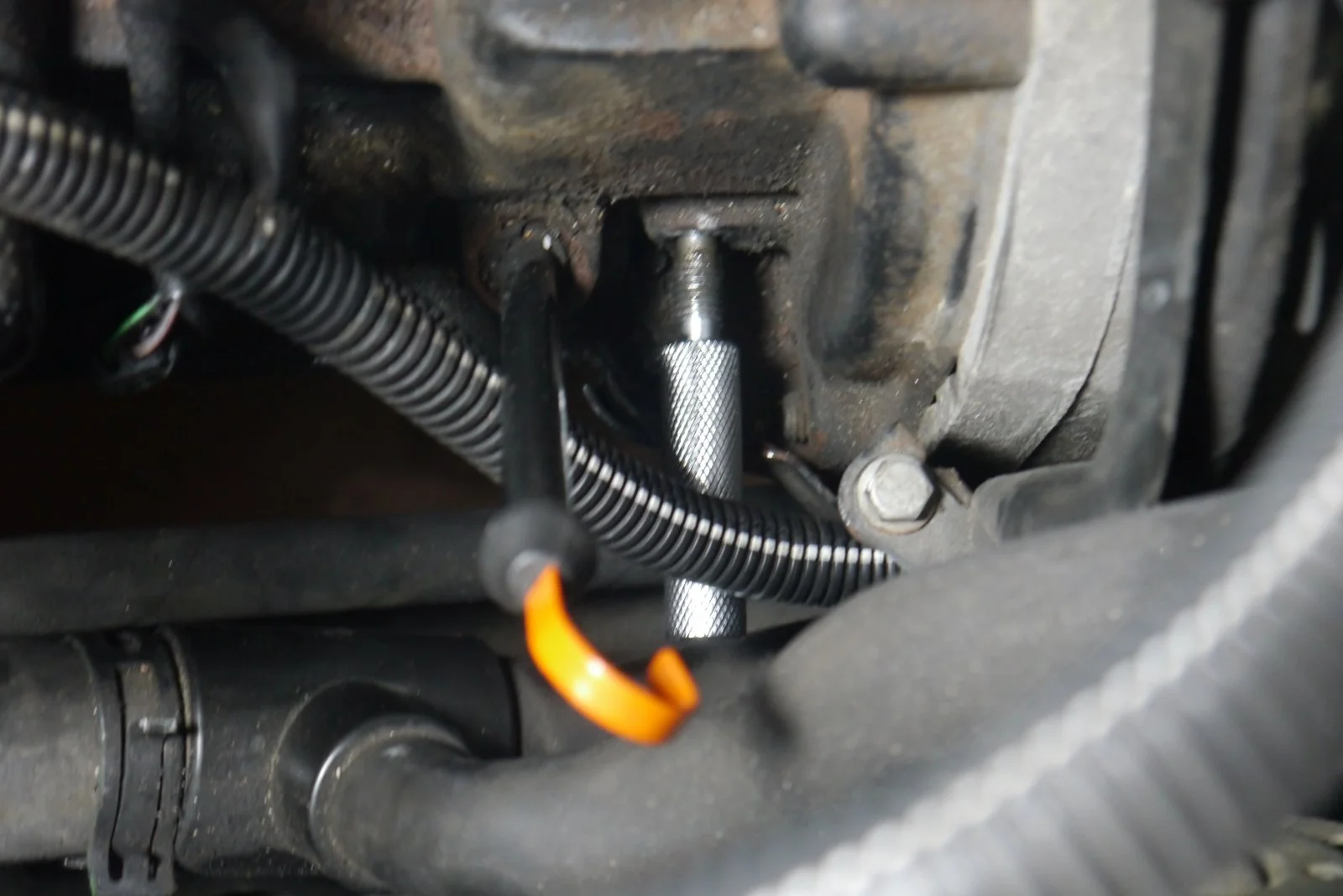

I thought I would checkout a few things before putting too much together ….. more space to get at the water pump without the head on (for example) and TDC should be more obvious because I can see the pistons ….. hmmmm well it seems as though there are TWO TDC positions when I can get the flywheel blocking tool to insert fully ….. which correspond to pistons 2 & 3 or pistons 1 & 4 ???? so which is it and how would I avoid that when the head was on the block ??????????
Furthermore ….. The crankshaft piñon does not want to come off which worries me ….. obviously the bolt has been removed !!!
So it's difficult to verify the TDC as I can not see the piñon key/slot ….. will take a picture ….
OK….after turning the engine and checking every blocking point …. it seems I was using the wrong locking pin!!!!! (too long one)
ARSE!!! ….. Now I have only one solid blocking point that corresponds pistons 1 & 4 at TDC!!! ….
The fact that the crankshaft piñon/cog does not come off ….. well I guess it does not need to come off :o)
the water pump is off but 99% of the gasket is firmly attached to the engine housing ….. apparently it's best to use some kind of gasket cleaning agent .. something pretty nasty …. any recommendations ???
else it's pretty sure the surface is going to get hacked about, if I go at it with a paint scraper in such a constricted space….
All tips welcome ;)
1&4 will always be at tdc at the same time. crank pulley needs t come off and clean the rust from the crank tail/inside of pulley as it has to be able to spin freely.
is the locking pin push in one or screw in one?
locking pin has no screw ..... the one with the screw seems to be too long .... only screws in, in non TDC points x2 ... caused some issues today! ...
crankshaft PULLEY is off ...it's the crankshaft cog or pinon that the cambelt runs on that I can not get off ..... and since there is a locking key ..... I am not sure how it can (or should) able to spin freely ..... but then again I've never done this before ... so what do I know ...... just what I've read .....
I assume..... that so long as the crank shaft pinon or cog is 'welded' on and does not slip or move, then the camshaft pulleys can be set to match it ..... else dead engine ... before it even gets going ... which would be really s**t ...... time will tell .....

Progress … the head is on … albeit a bit of a fight to get it to sit on the locating plugs ….. just hope the head surface was not scrapped up too much ….. cams in and cover on ….. thermostat housing on and exhaust attached too ….. but struggling BIG TIME with the water pump ….. getting the old gasket off that seems to be 'welded' on in such a tight space …… ALL TIPS will be welcome …… I think it's going to need some nasty chemical to eat it away … I have tried a paint scrapper and drill + wire brush ….. neither seem to be getting good results :(

Budgie ..... any tips for getting it off without damaging it or the casing ..... it's pretty solidly stuck on !!!
There are two screw holes in it ..... see picture TDC_setting1.jpg in previous post .... thought I could rig something up using a brake piston tool ..... but knowing me ... something would brake!!
i normally screw a grub screw in each one and then wind it with a bar, can sometimes take five minutes to get the pulley off.
you need the pin without the screw and make sure you are in the locking hole not the balance drilling, it's very easy to get it in the wrong hole!!
That's life :tongueclosed:
but you can avoid that error by checking the crankshaft position !!?? ... plus when I had the head off I could only find ONE fully locked TDC position .. perhaps I am lucky with the balancing holes ???
