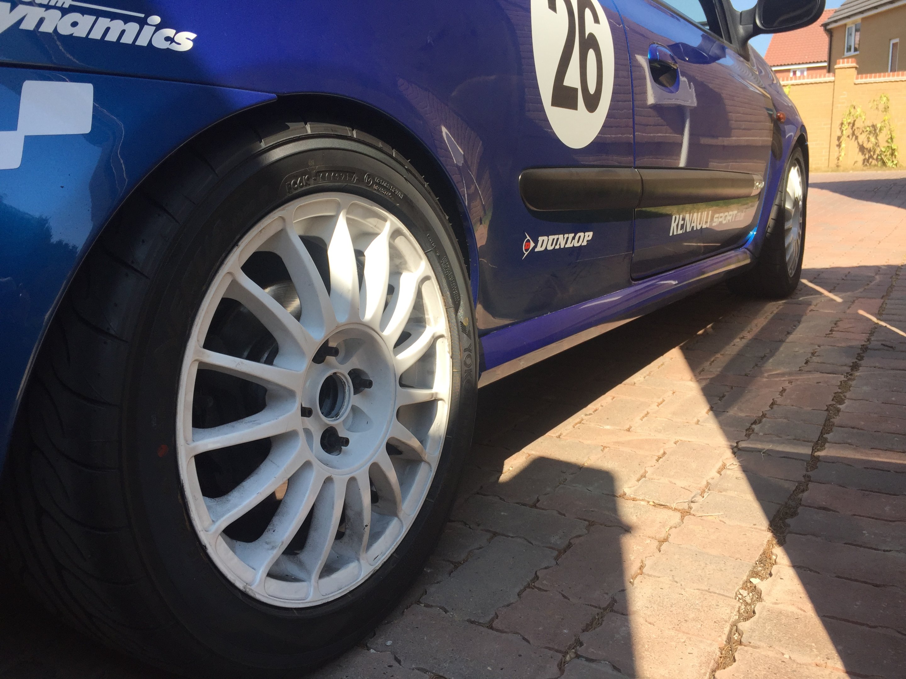

I ran 10mm stub axle spacers on the rear and 16mm hubcentric on the front on my cup with Oz F1's, they looked like below, not the best pics but hopefully they help ?
