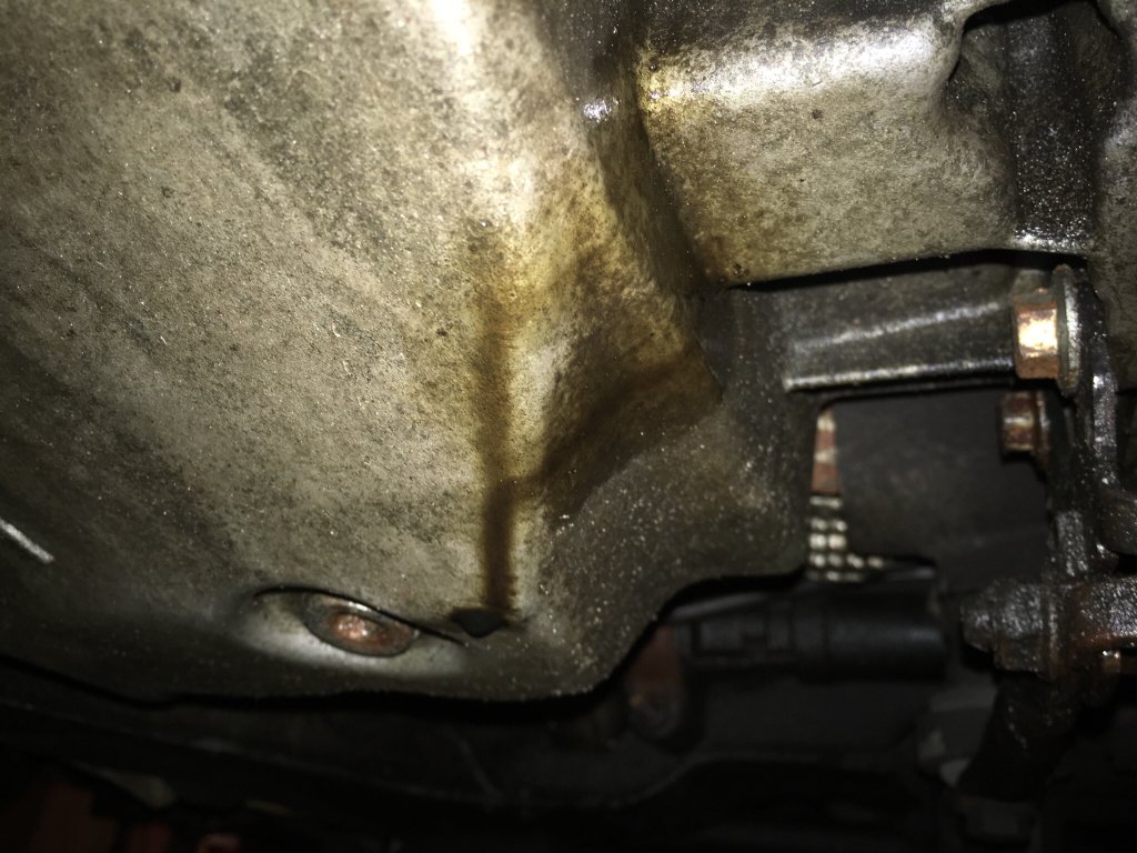

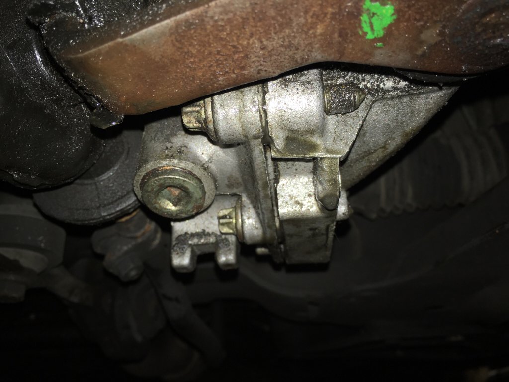

So a few newbie observations and lessons. Rear discs bought from local motor factor (APEC) are shite. Had to transfer abs ring. Bearing on one is worse than the discs I took off. Done this cos they had them in stock and it was handy. Buying Renault ones off eBay now and will be asking for my money back on at least the one with the crap bearing.
Also bought a sump plug, oil and filter as on first inspection my oil leak looked like a quick fix. Once cleaned up you can see its leaking from further up. Any suggestions? Sump gasket or anything else?

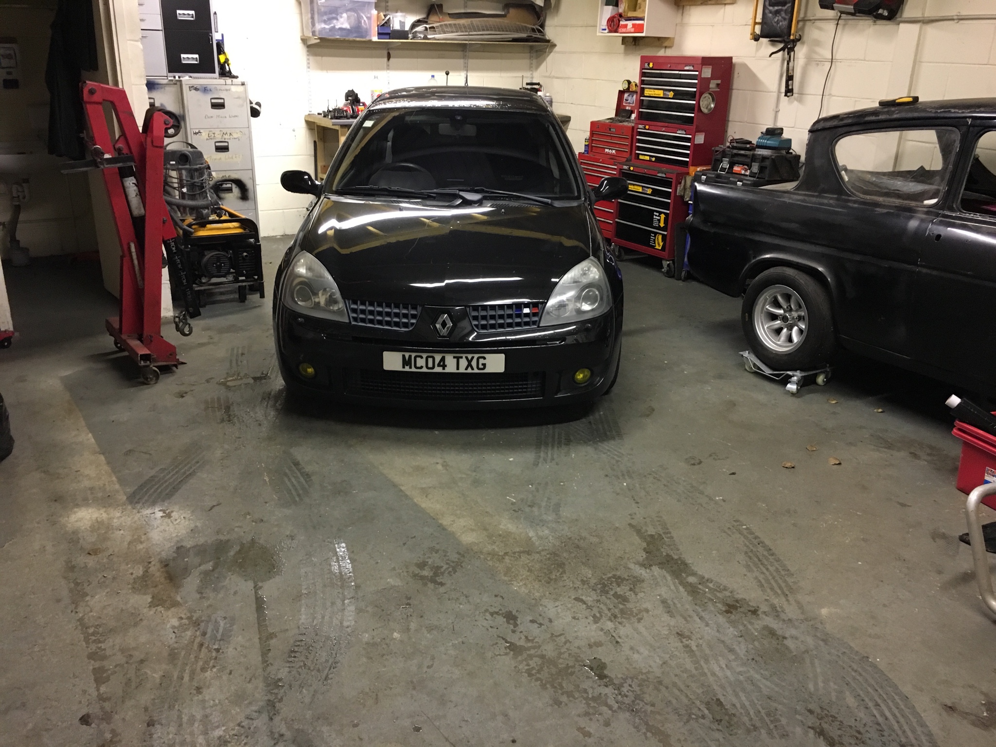

So after a few weeks getting one of my minis sorted and a day clearing out the lock up today iv started on my clio project.
Nice tidy workspace.

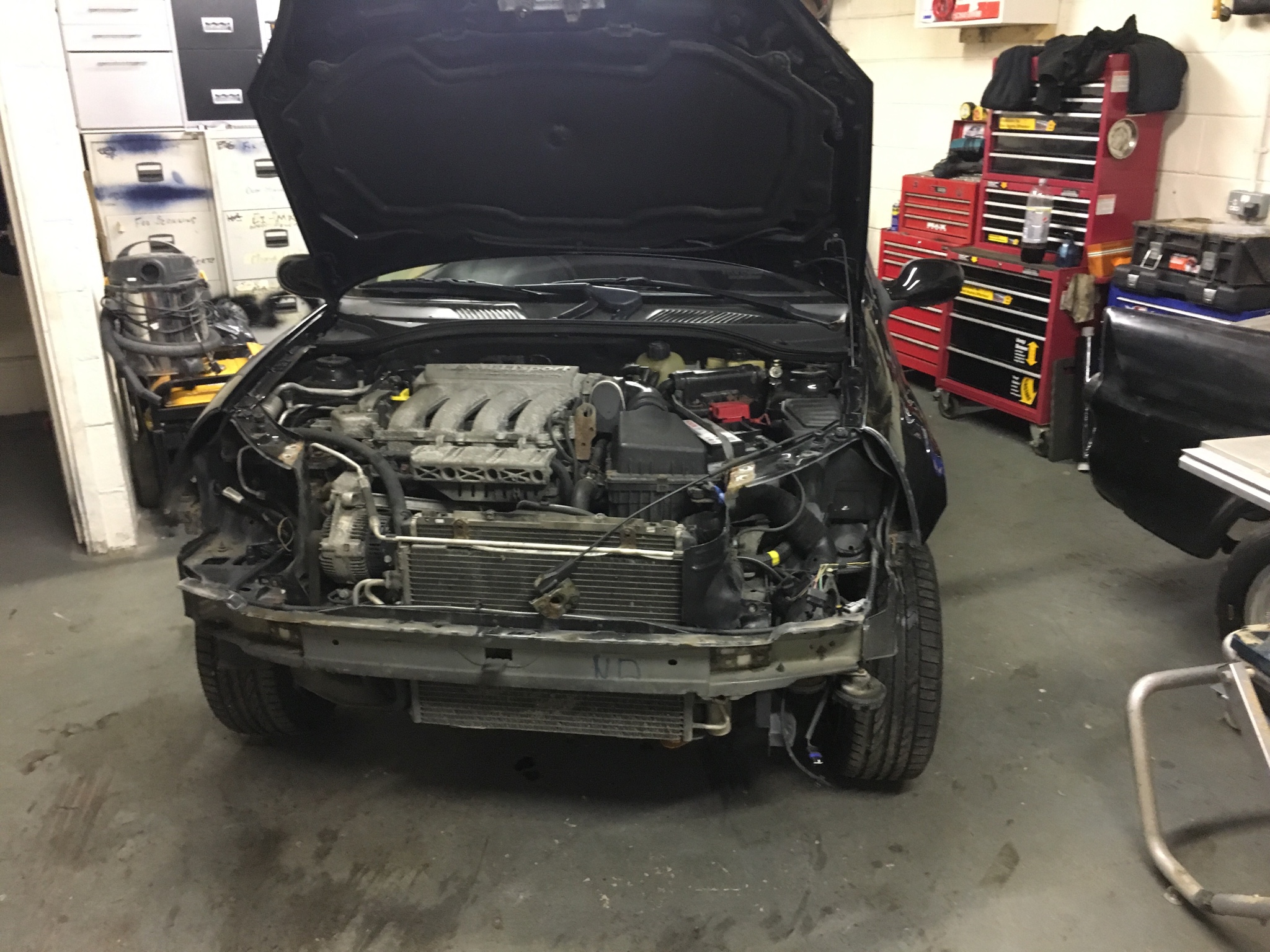

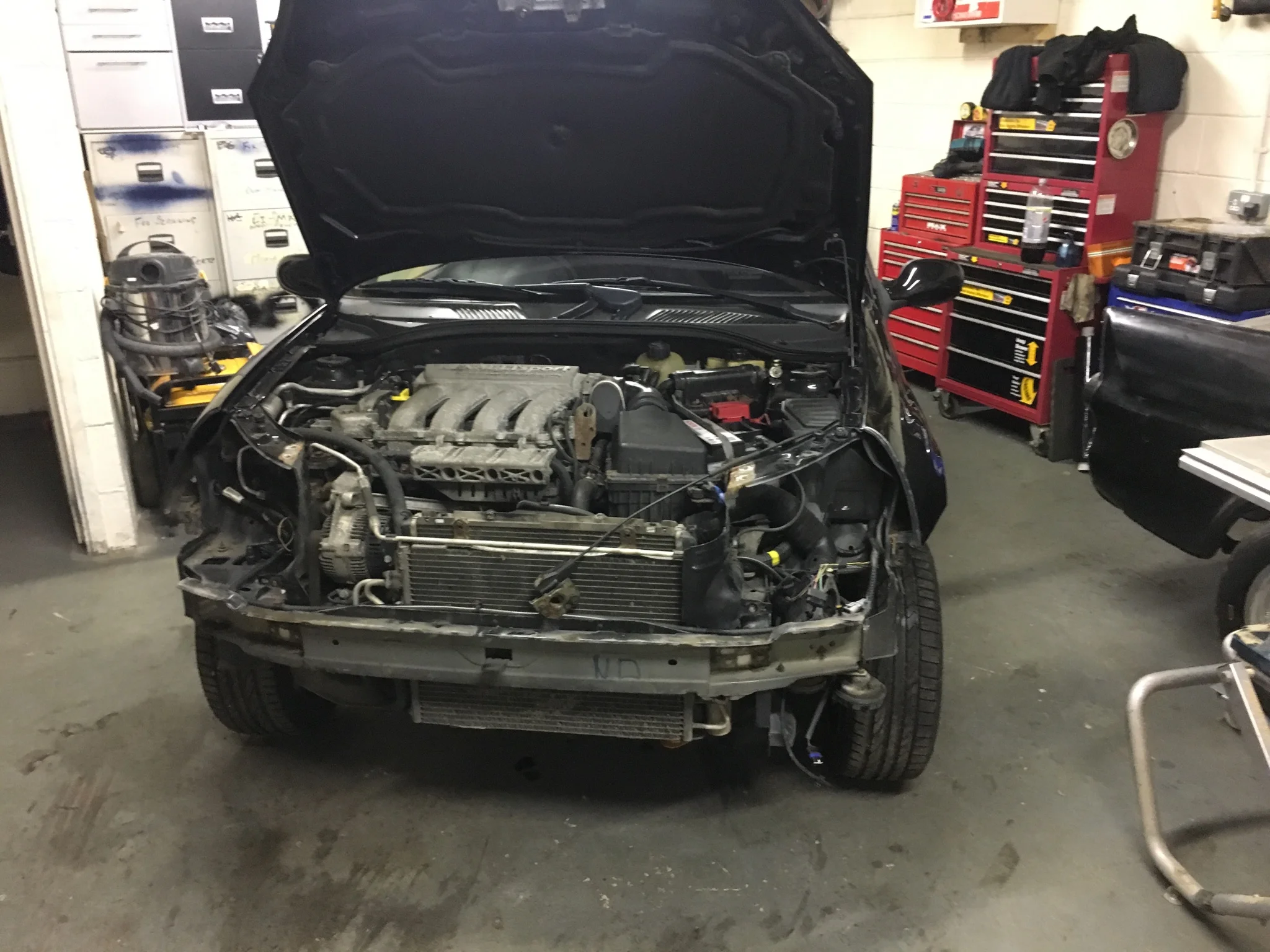

After a wee while I've got the front end off.
Main job here is the timing belt. But I'm taking the engine out as I've got 3 jobs and overall it will be less time and hassle.

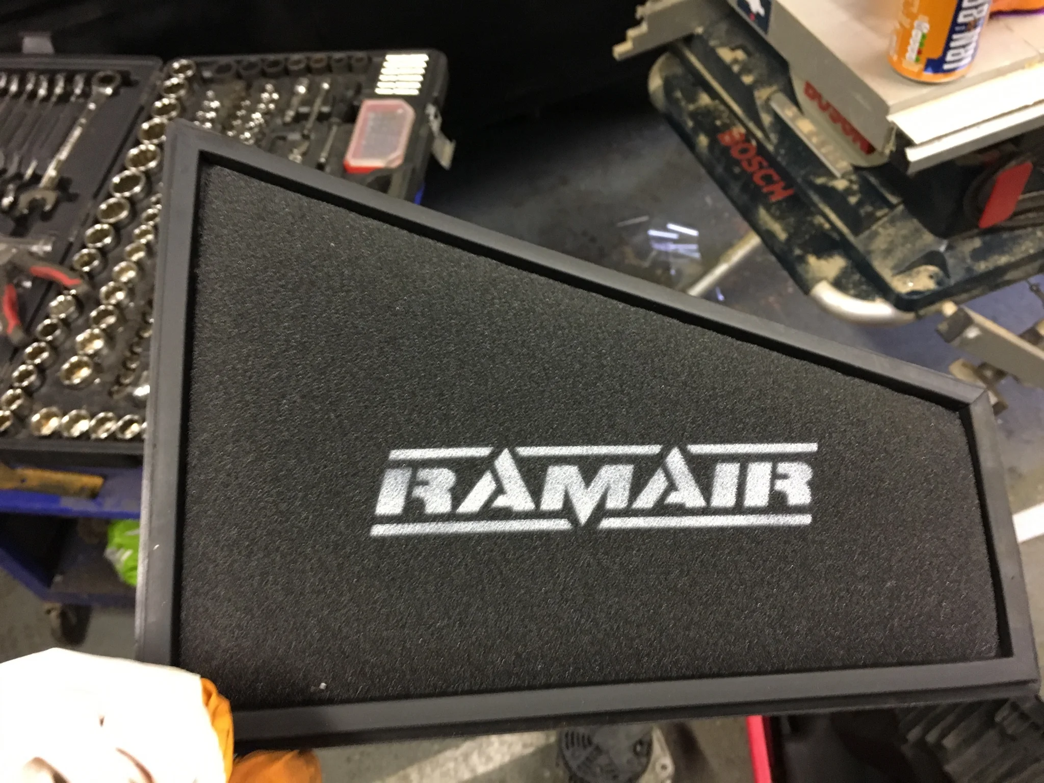

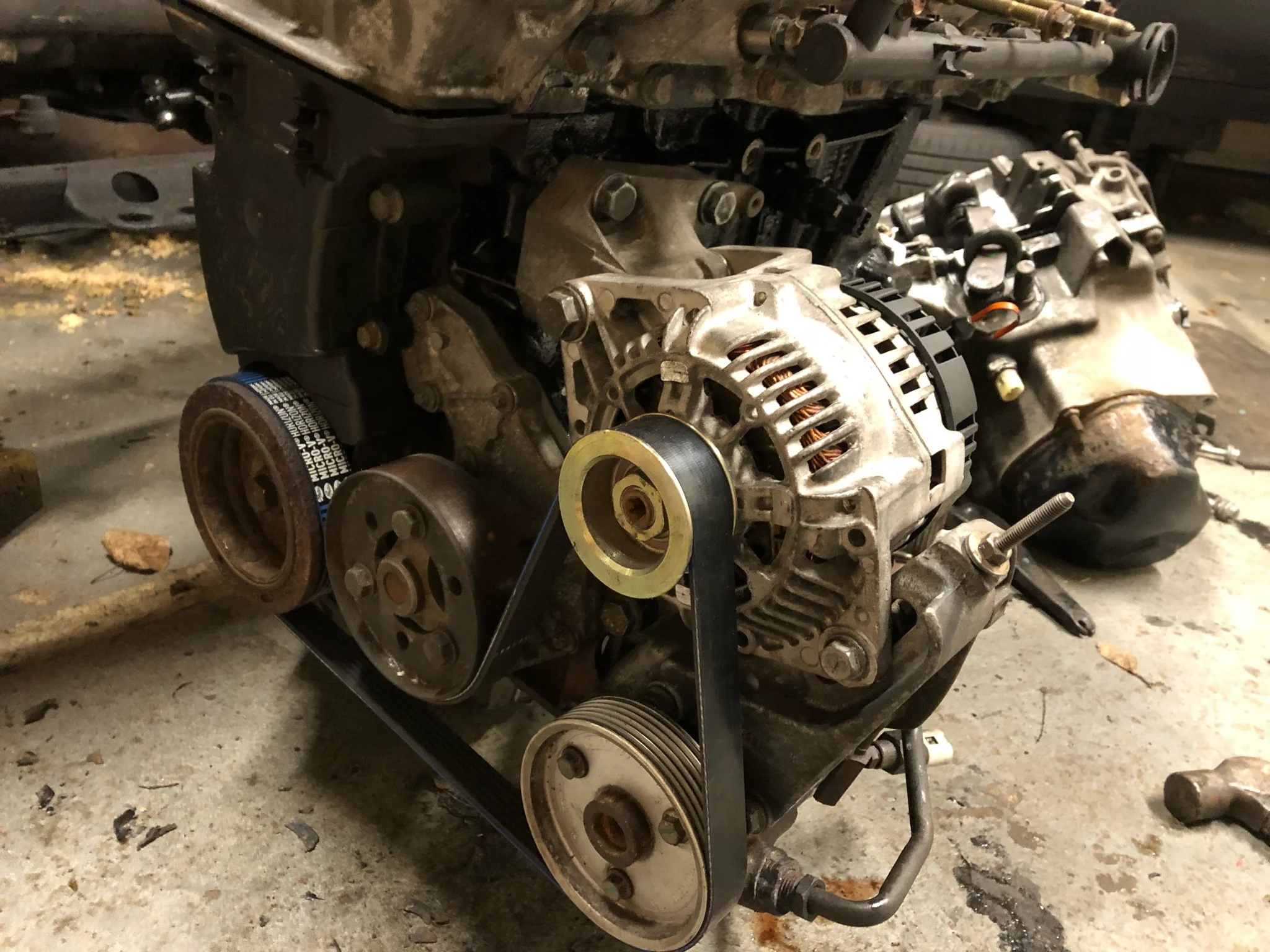

Got a spare hour today on my day off. Got the air con condenser and radiator off. Water pipes all disconnected. Also off with the alternator and air con pump.
Nice wee surprise inside the air box. Saved me £30 and looks almost brand new.

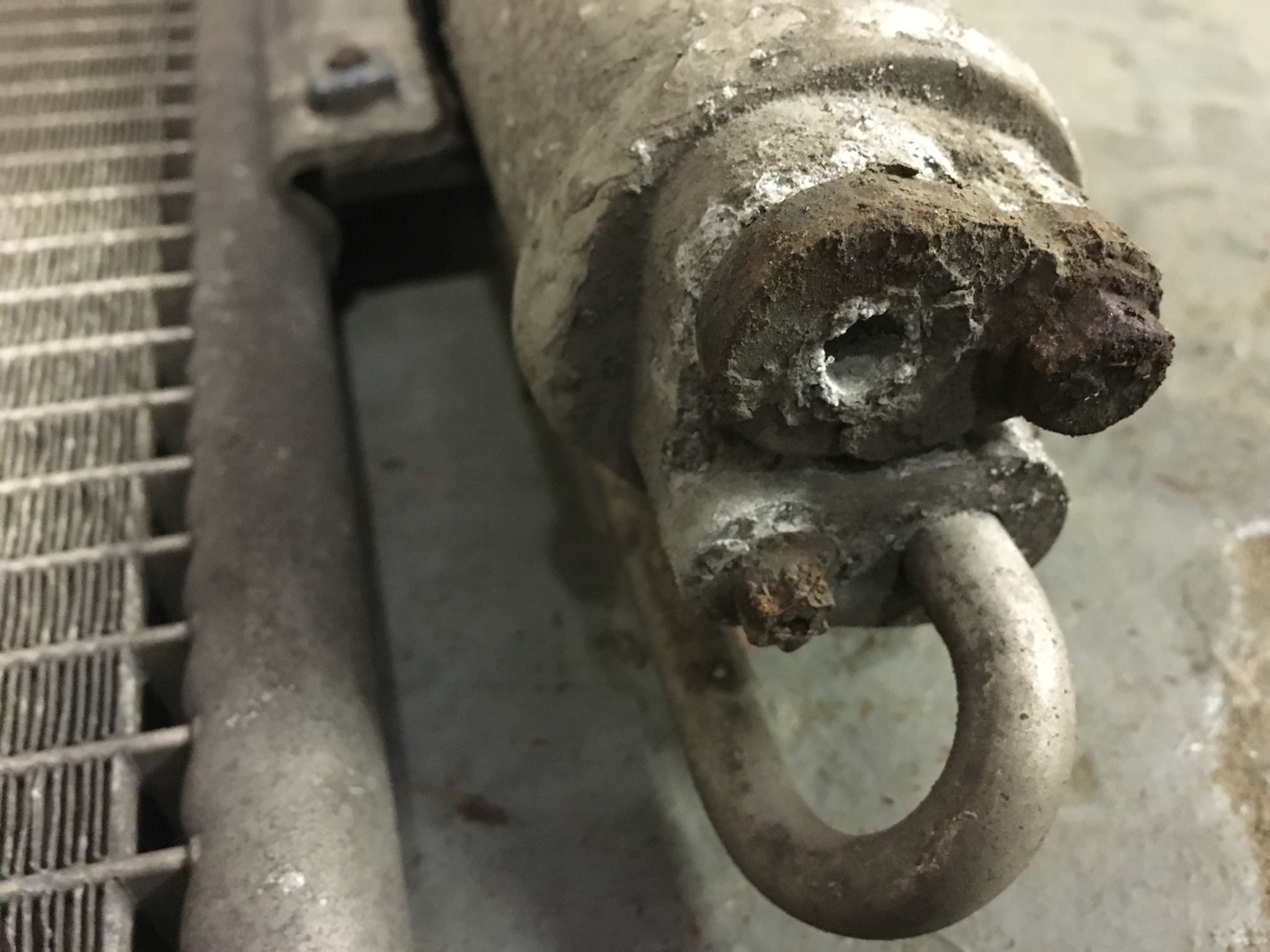

Also made my mind up on the air con. I was going to reinstate it but found the dryer like this.
So I'll not be putting the air con back and will be on the look out / open to advice on how to put it back together writhing the compressor.

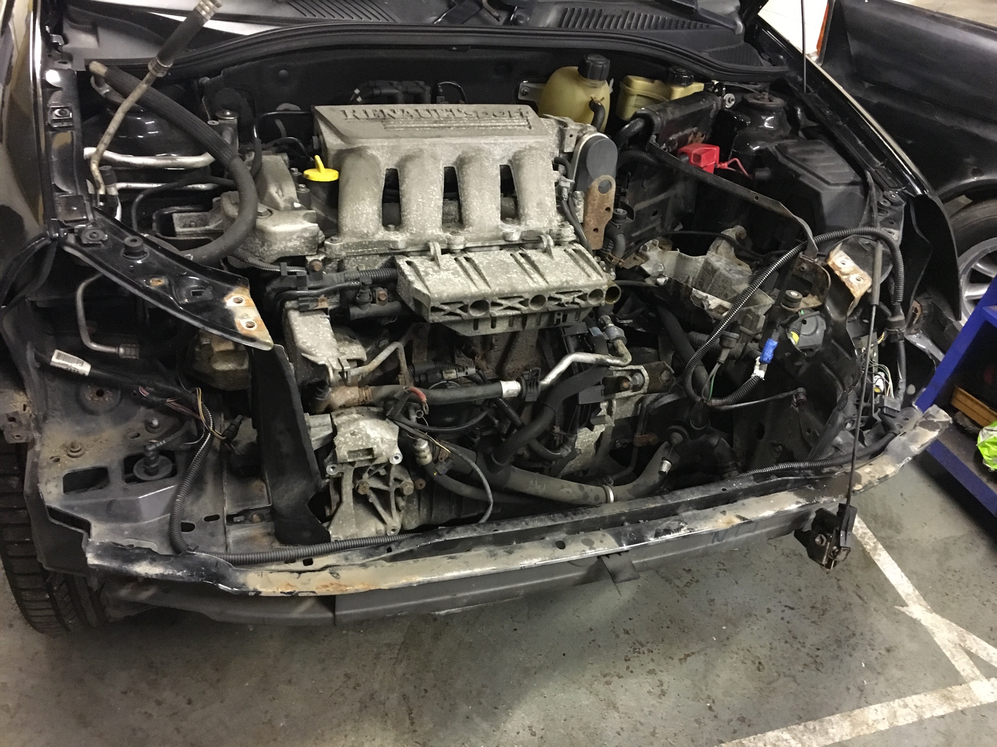

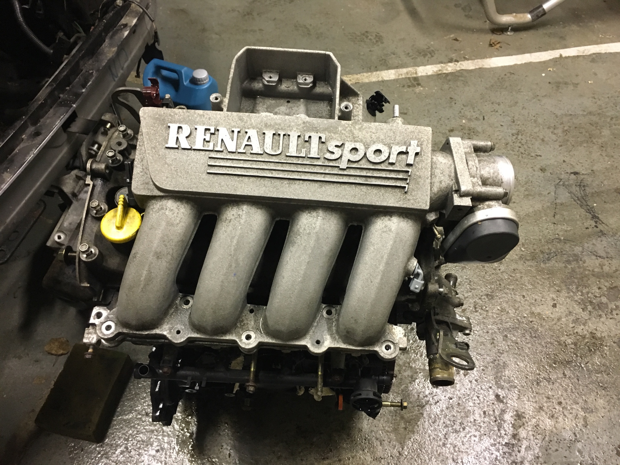

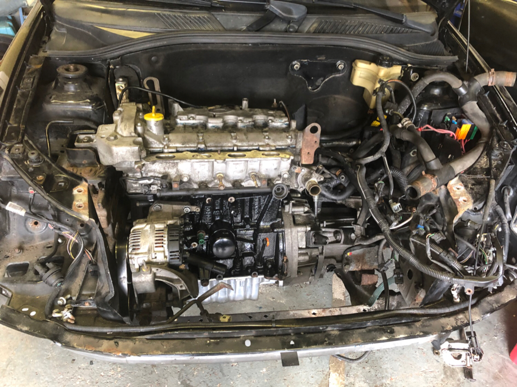

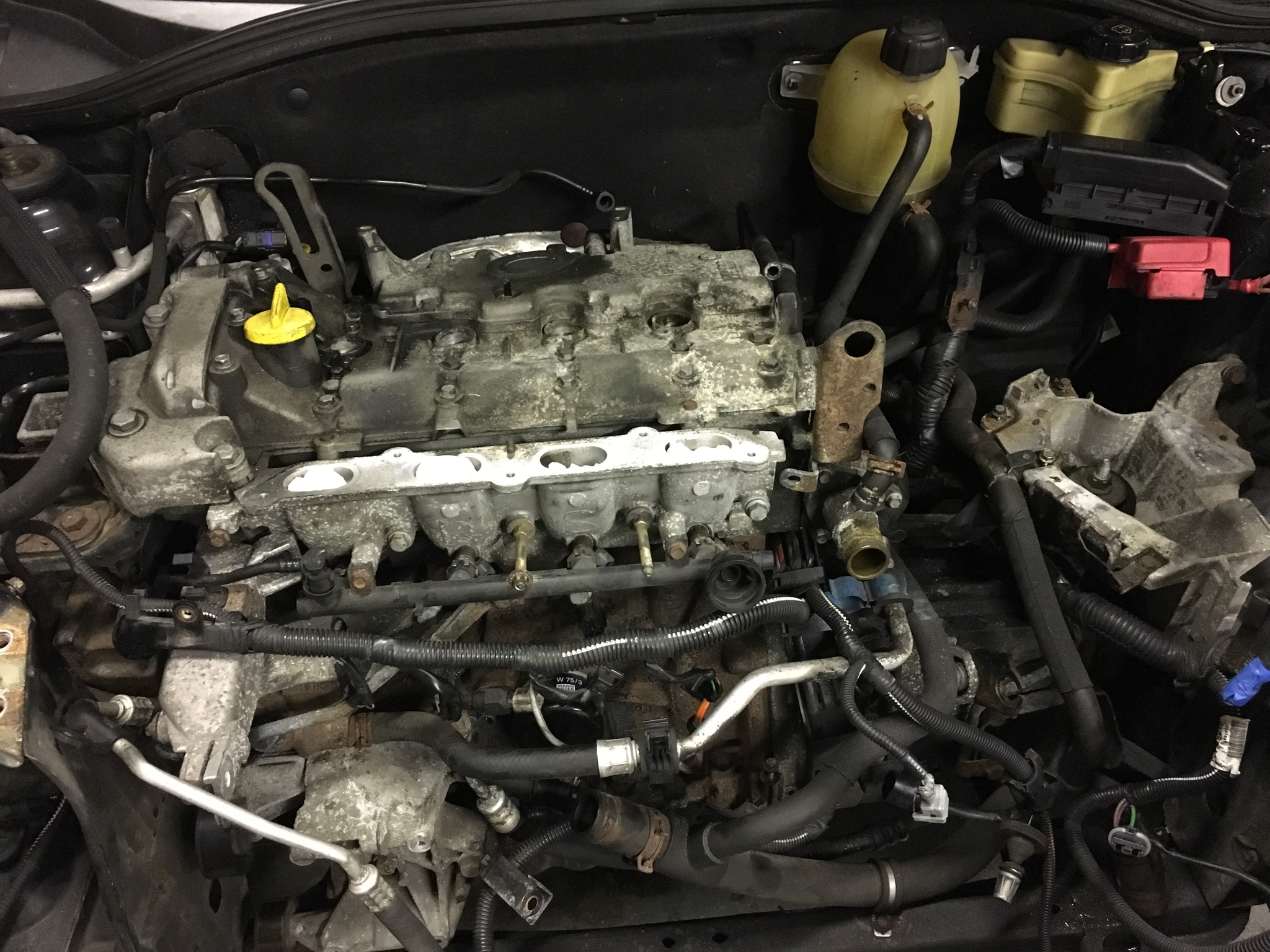

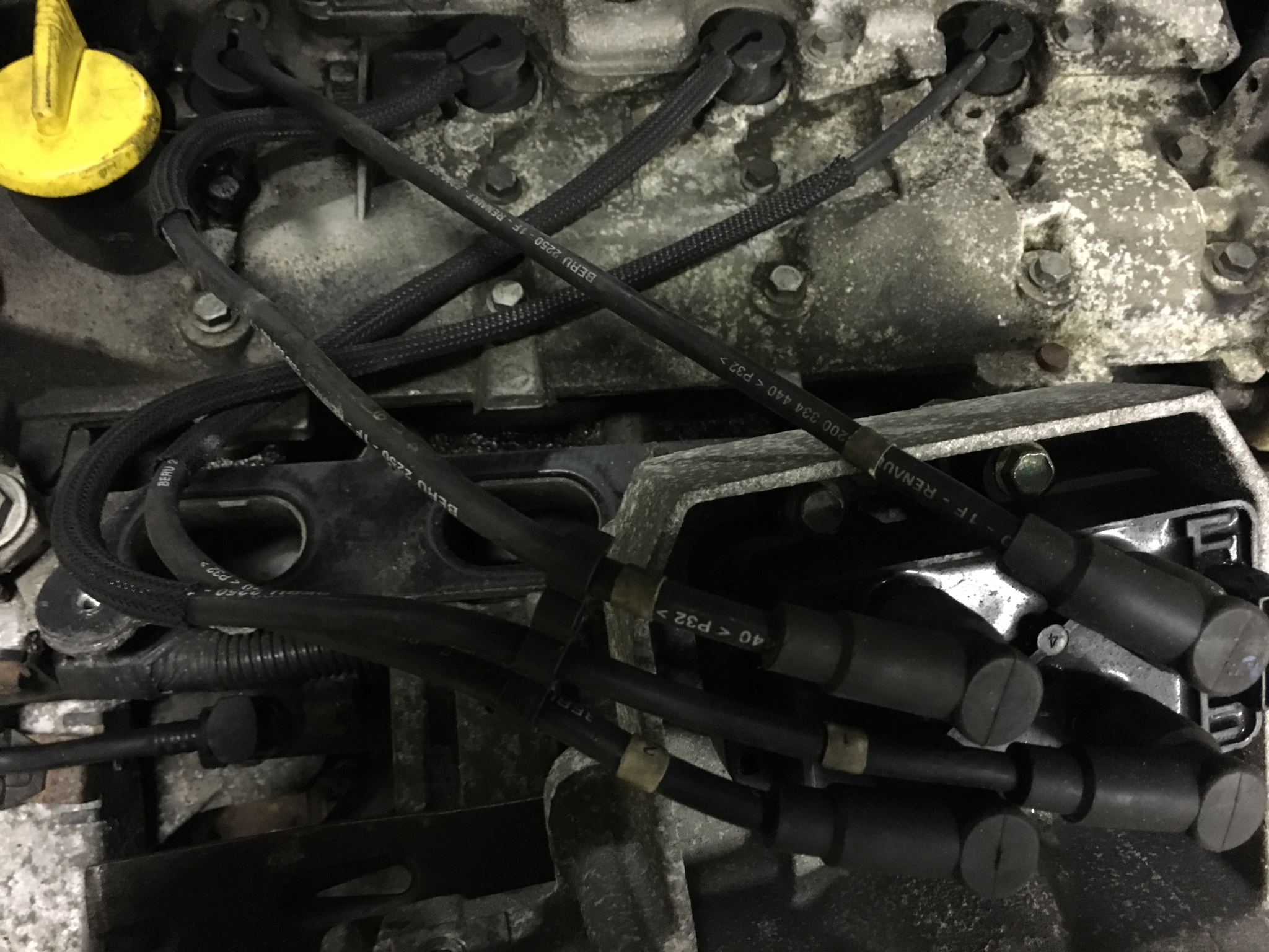

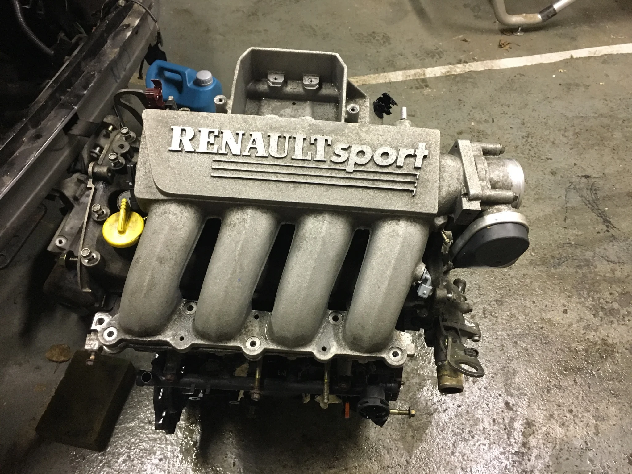

The strip down continues. I'm new to clios so spark plug lead reference [emoji23]
Inlet manifold off and a bunch of wiring disconnected.

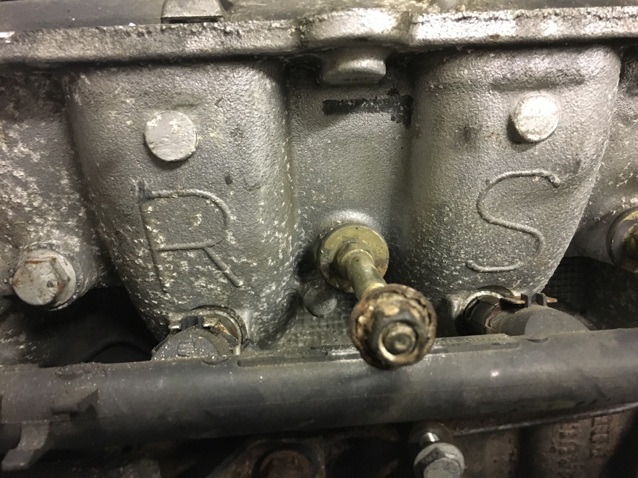

I've seen a few of these stamped RS up for sale and this car has one. What does it mean exactly?

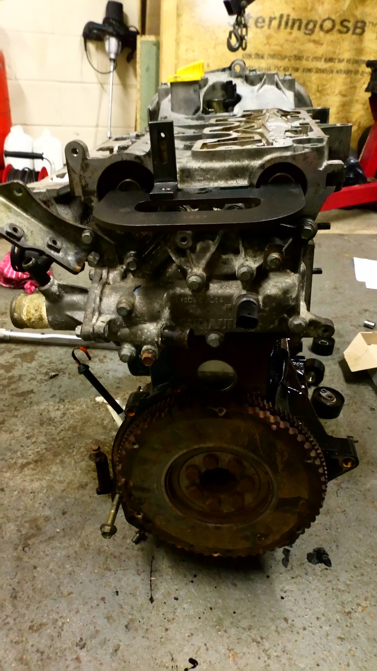

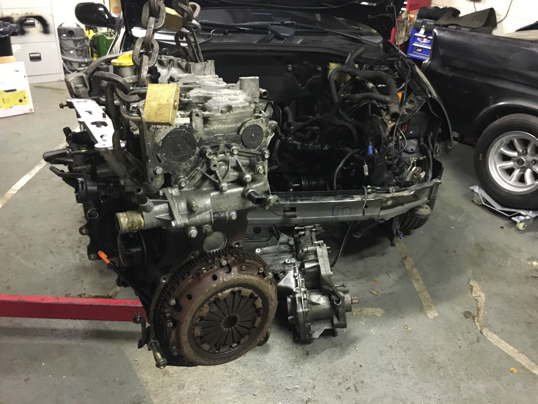

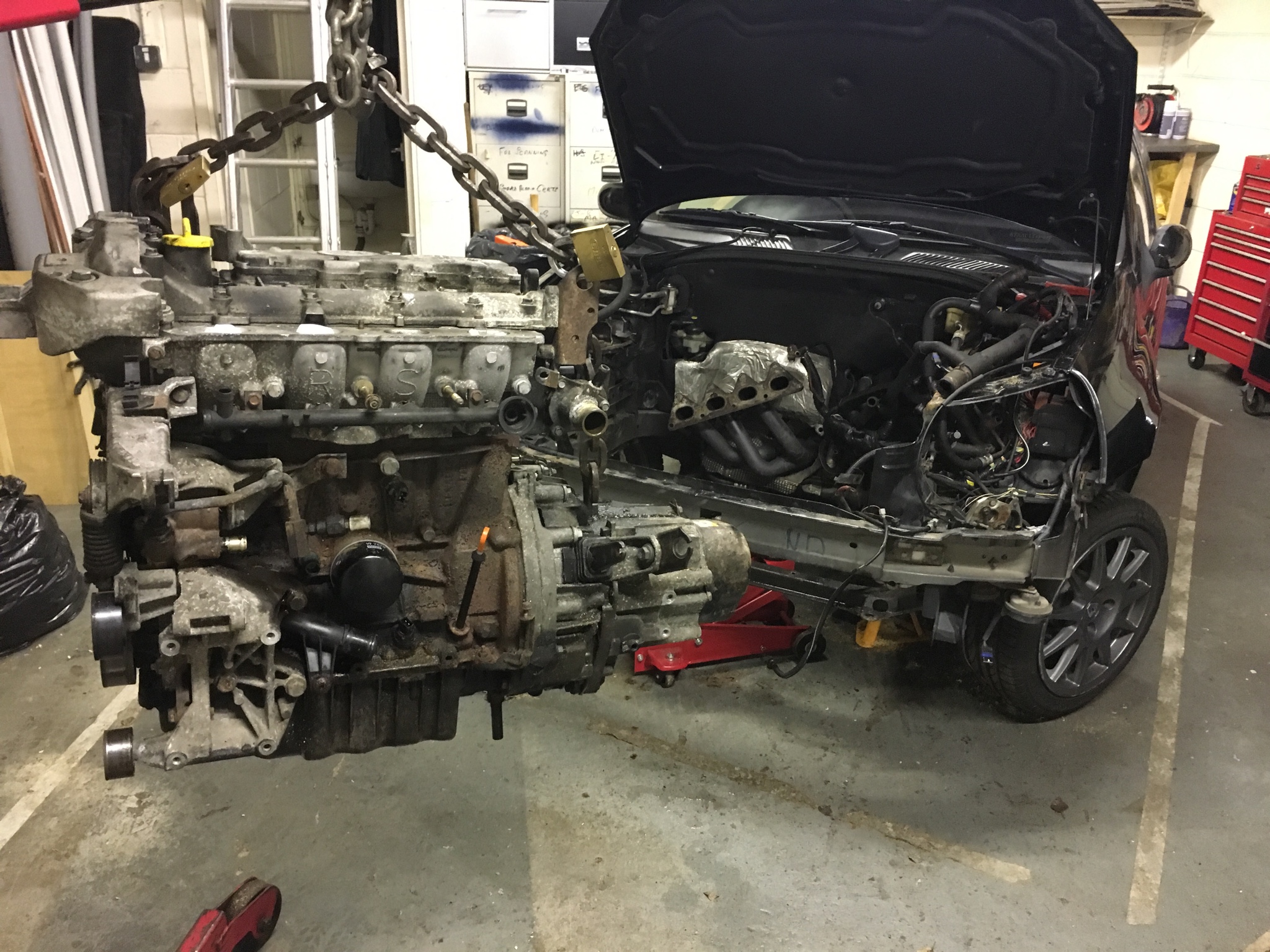

Engine now out.
All quite straight forward so far. I did snap the bolt securing the main 12v supply to the starter motor. Is this common? Not sure if I done it wrong.
Also. How much of that crap do people leave in the engine bay on track day cars?

RS inlets are known as the best ones for flow. Just better machined than the other ones.
I've never snapped the starter bolt but a new starter isn't much if you get one from one of the many breakers on here.
Folk tend to remove all the aircon gubbons and some go to epas instead of the existing pas.

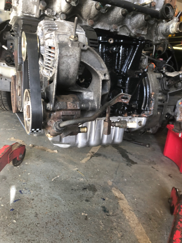

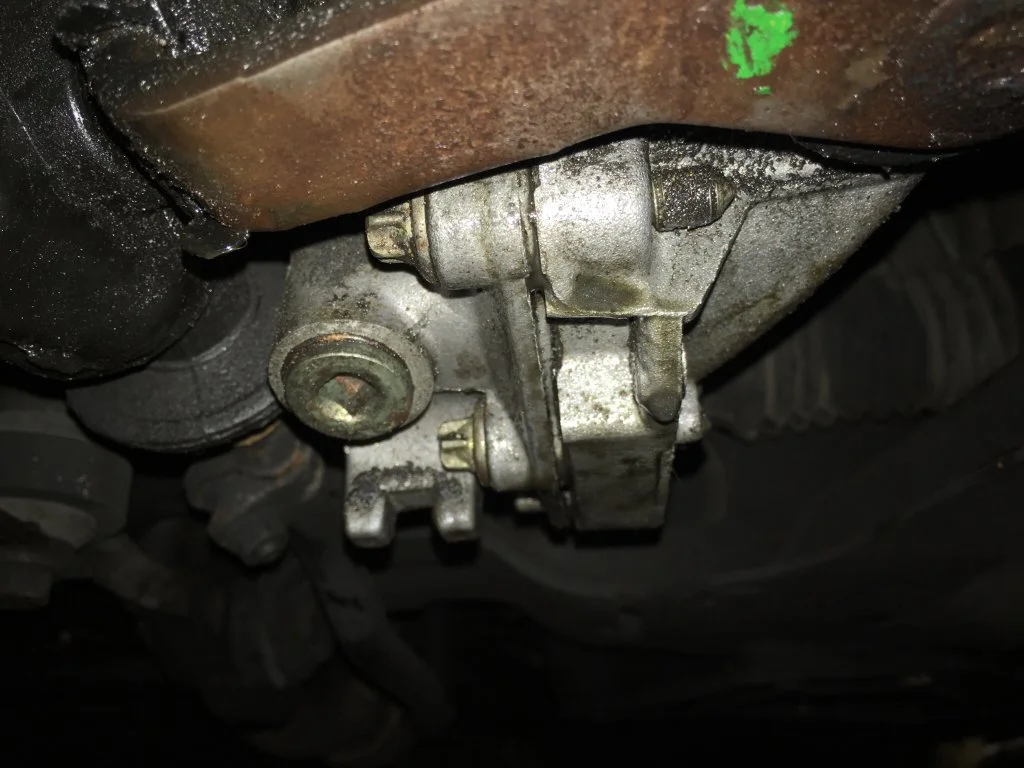

Pressure washed the engine and gearbox tonight then split the two.

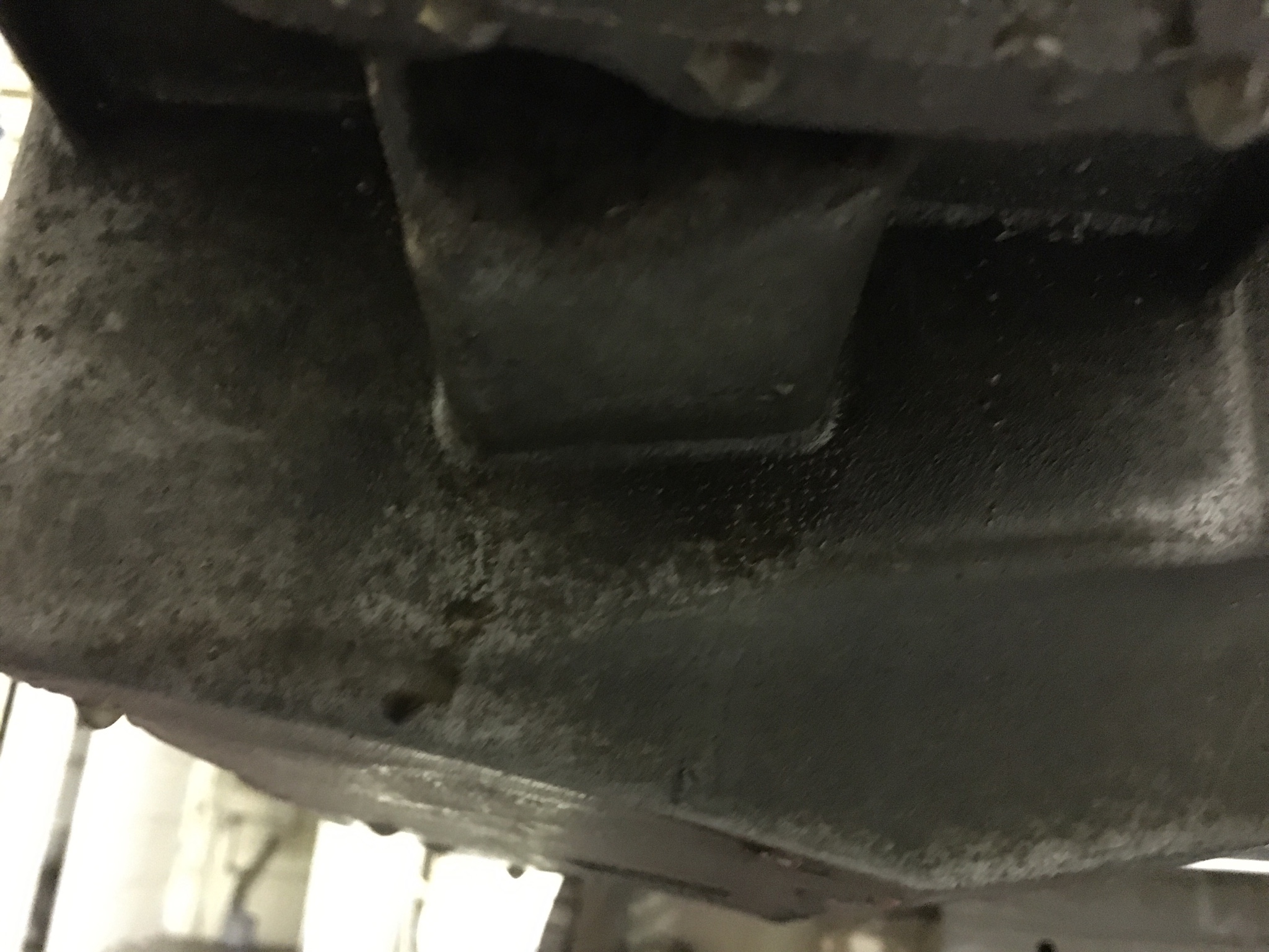

Then left for the oil leak to build. Looks like it just appears from nowhere on the sump. Can't see any cracks. I'll take it off for a look inside.

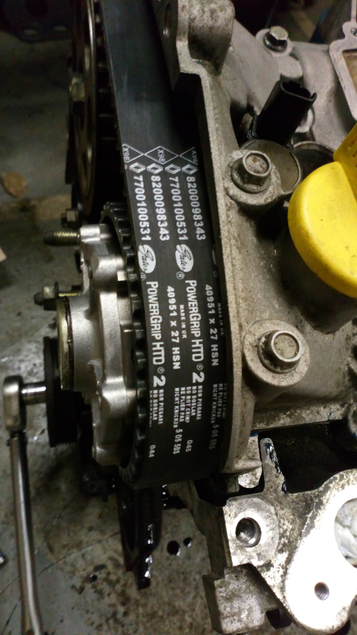

Belt and pulleys off. Cam cover off. What sealant do people use to reseal this?
I also removed the waterpump. Inside this looks brand new so will be going back on.

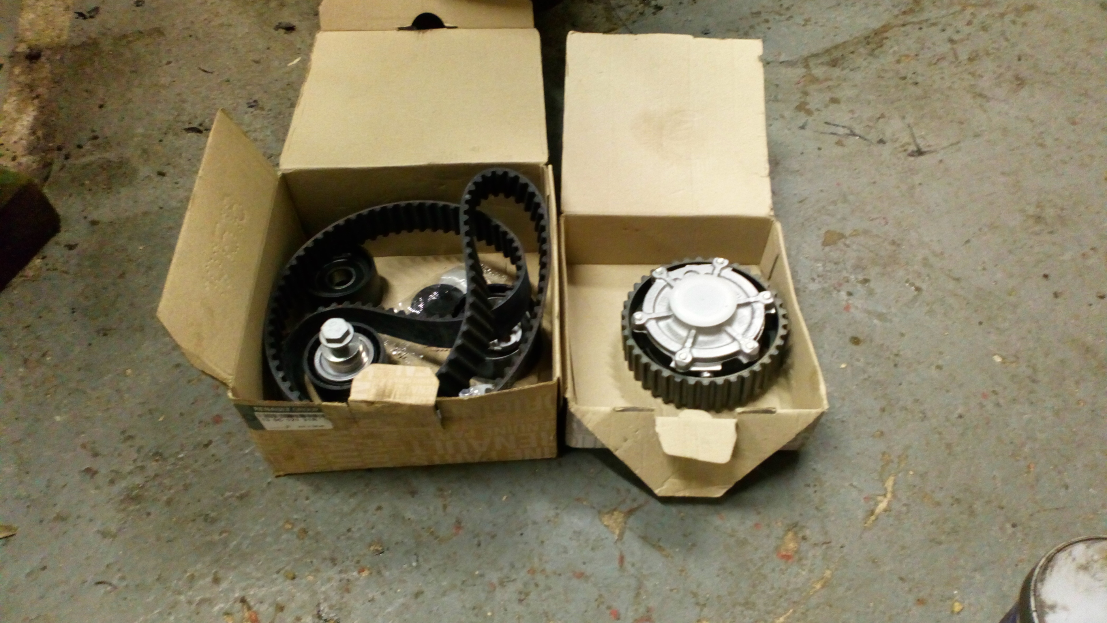

New dephaser pulley on order.

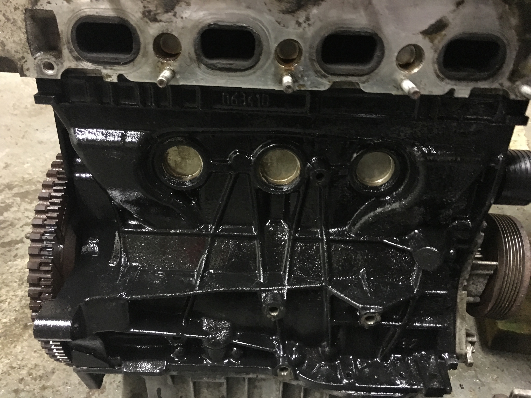

Unexpected free night tonight but waiting on parts. So decided to do a bit more cleaning than I initially set out to do.
Painted the block.
Using some auto smart wheel cleaner and a brilo pad cleaned some alloy parts as well.
Hoping the cam cover sealant and dephaser pulley come for the weekend.

Feeling good about the progress on this car. Got the big job of timing the cams in off the list.

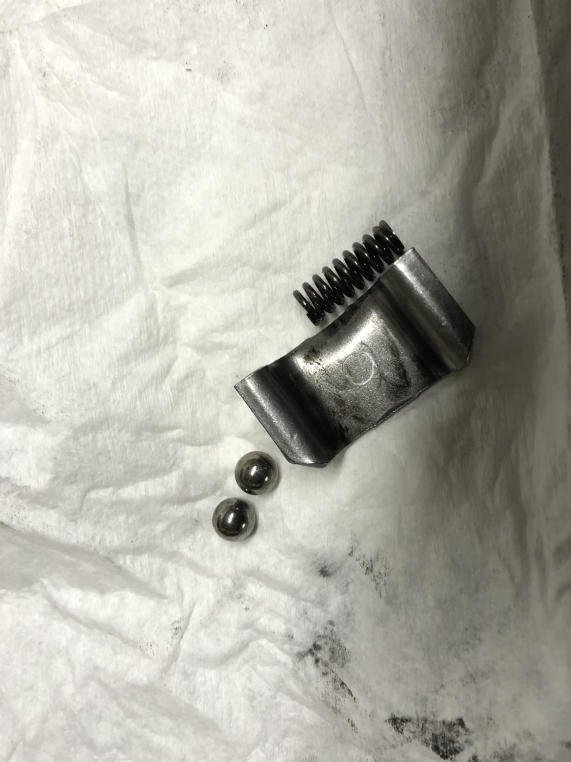

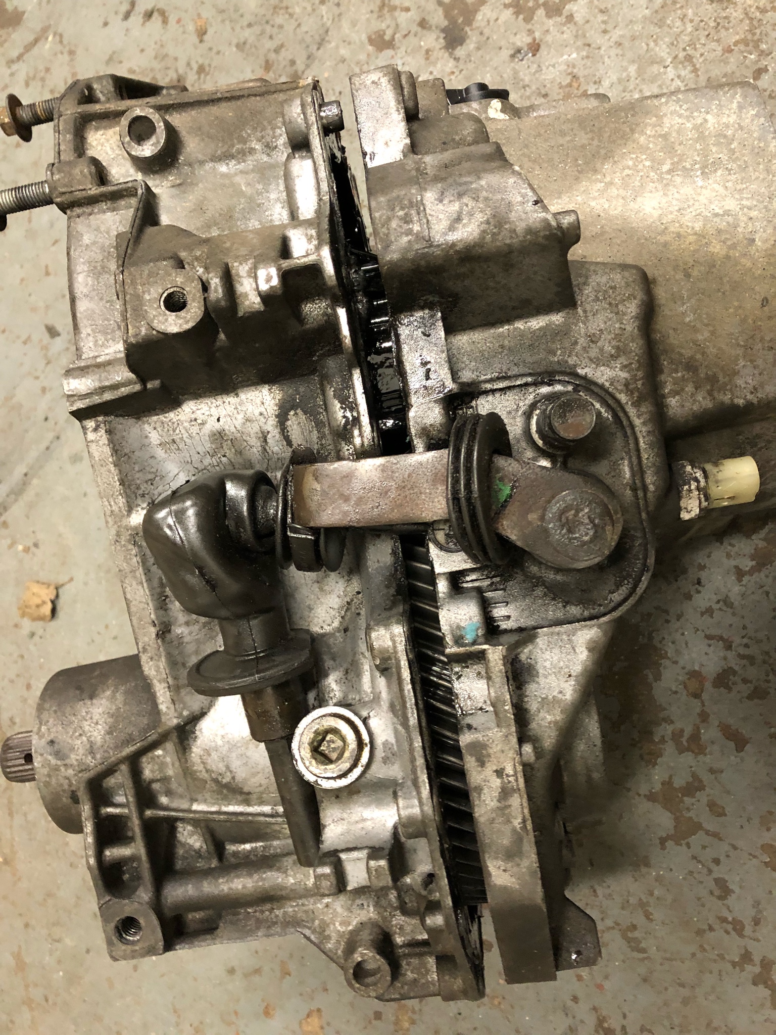

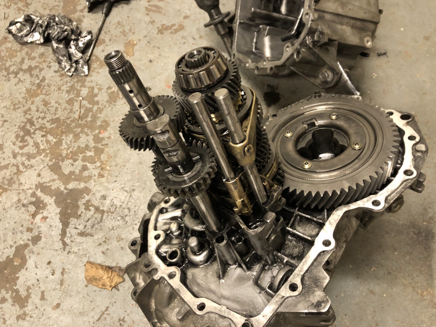

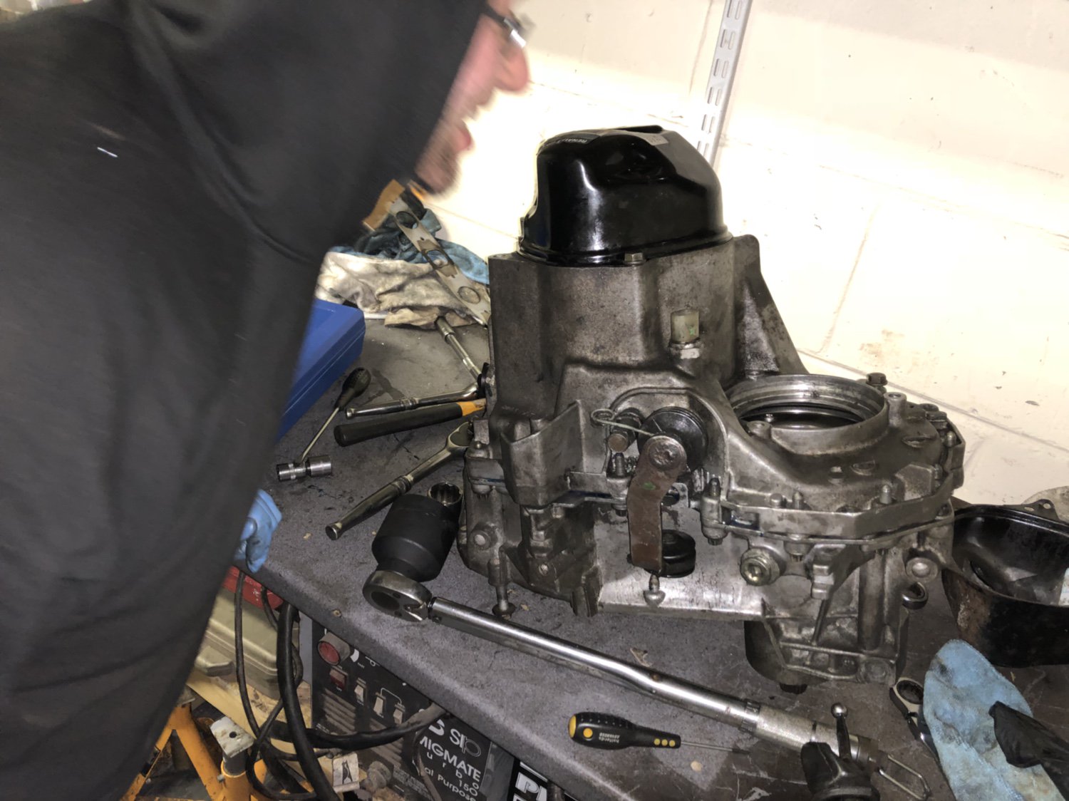

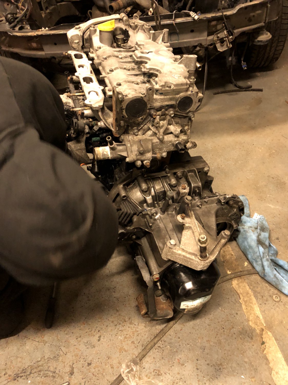

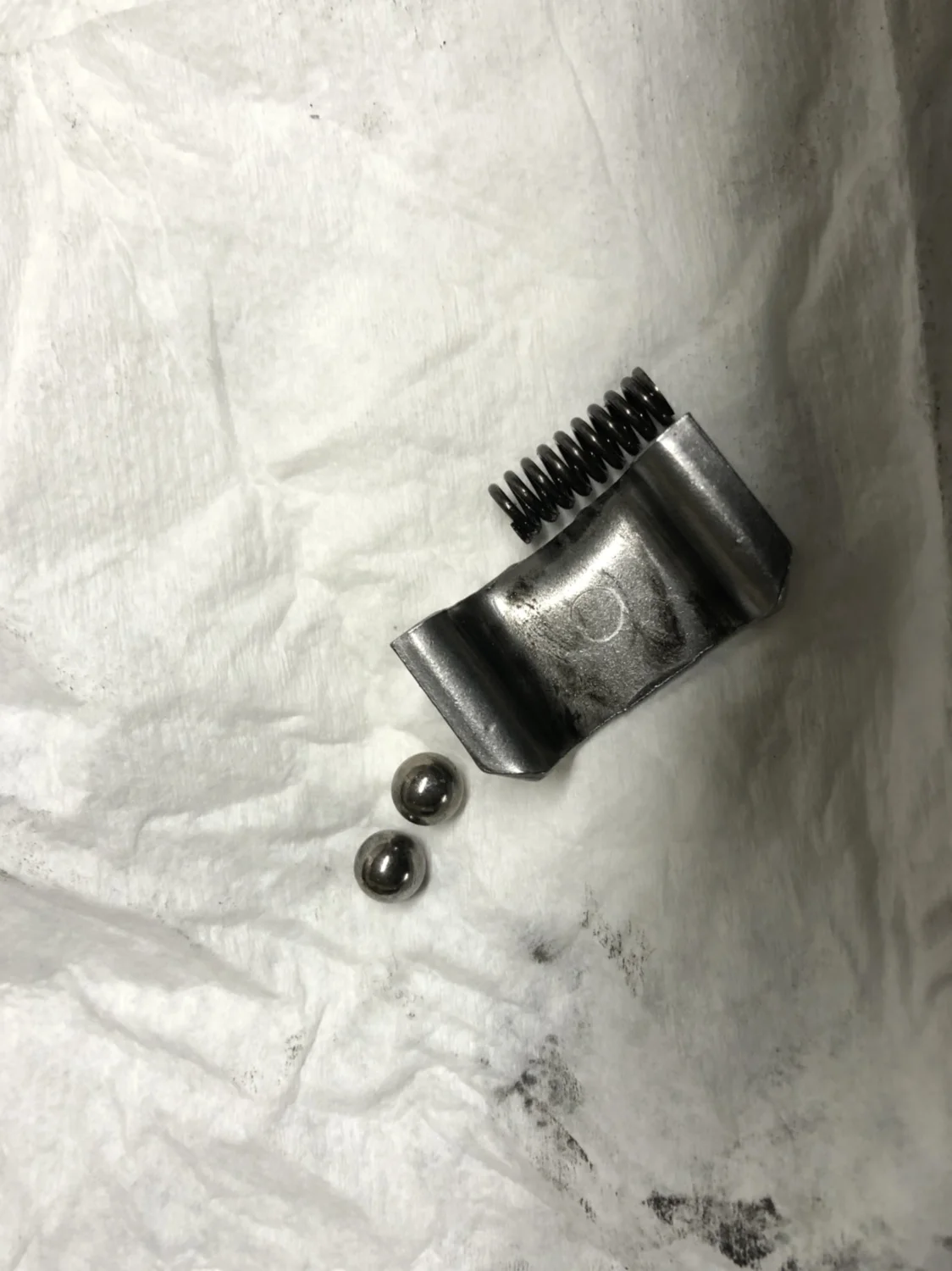

Gearbox split.

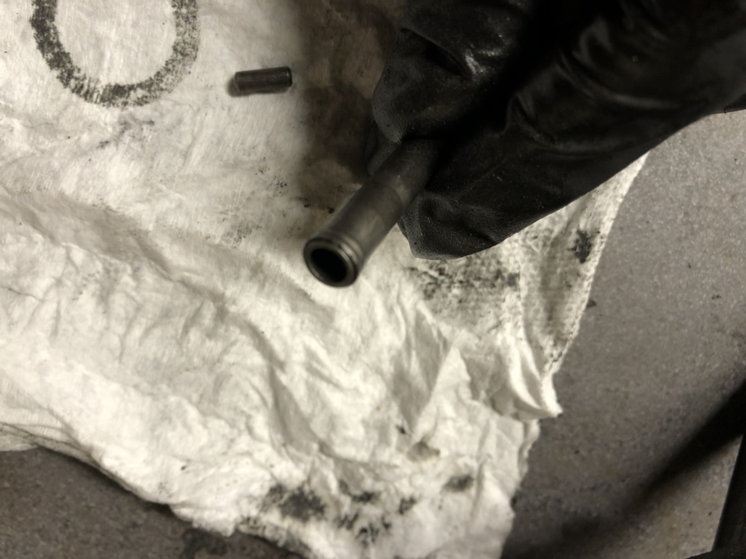

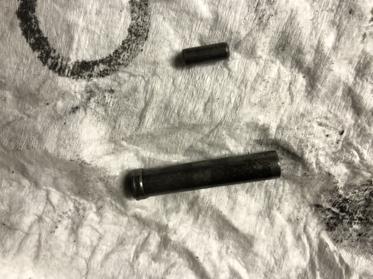

Some parts fell out.
Pretty sure these support the selectors going through the end of the casing but please tell me! Or if anyone has a Renault Manual I can refer to.

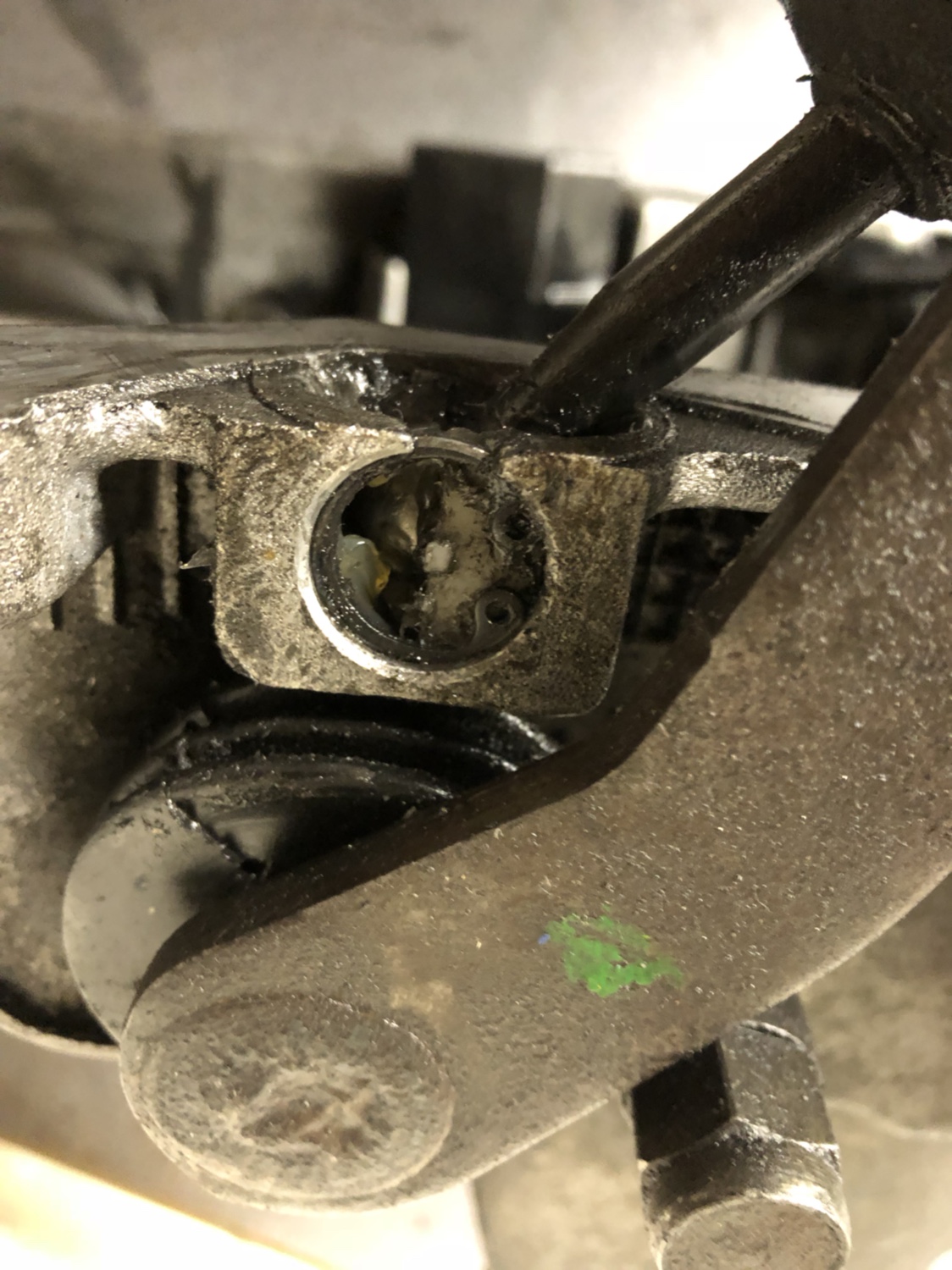

For the attention of gearbox gurus. Can you help identify this part. Putting the gearbox back together and no clue where it goes.
Also need to buy a few parts. I damaged this plastic piece removing the linkage to replace the seal.
And I need 2 of the small springs that keep the ball bearing against the selector rod. Any tips on the best place I can buy this stuff from.

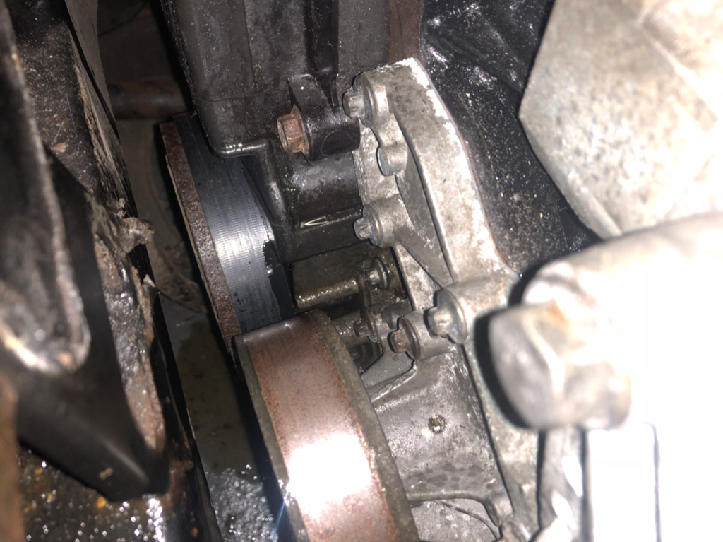

So I have the engine back together enough to start but I have a few issues.
I’m getting some back firing but that should be easy to sort.
More major issue is the oil leak. It’s coming from one of the camshaft seals so I suspect I have pinched one or put them too far in.

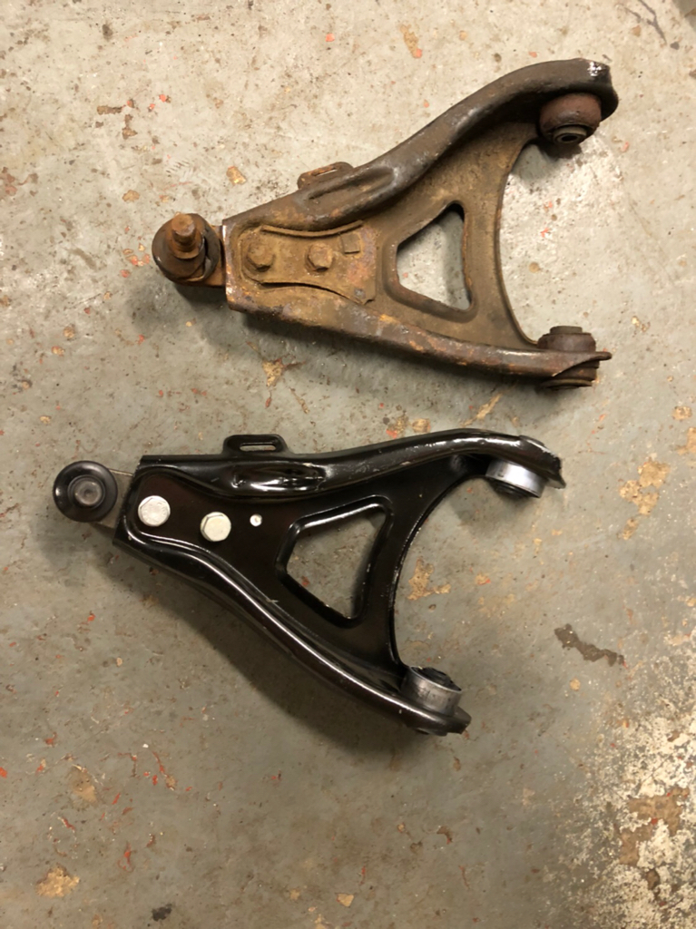

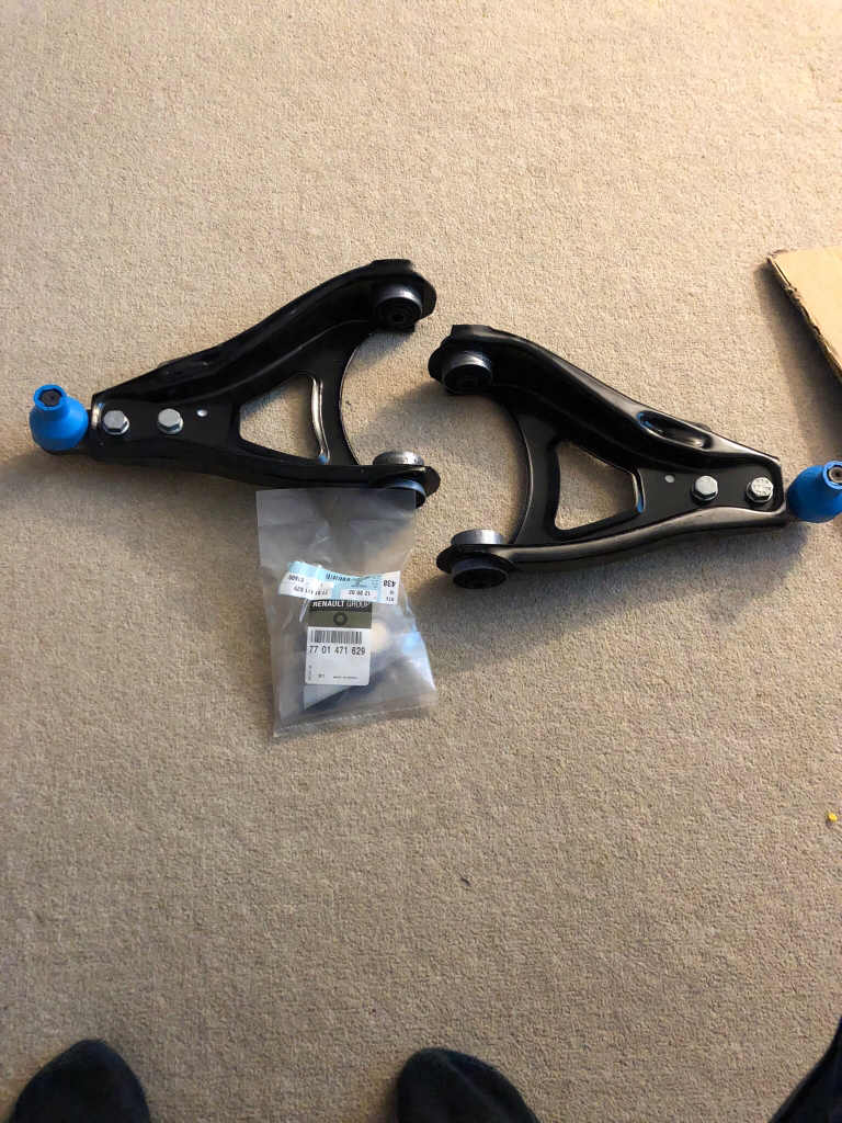

Also discovered one of the ballpoints dust cover is split. I was planning on putting two new arms on in future and powder coating the subframe. So went and bought the 2 new arms. I’ll power cost the subframe later when I know that car is done.

Tonight. New wishbone in drivers side.

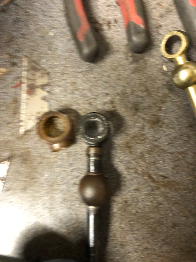

Also fitted the quick shift and gear linkage. Fells good for less than £30 [emoji106]
Had to transfer this little rubber section from the old link. Or you could use washers to spacer it correctly. Sorry about the crap photo.

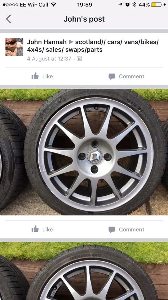

Clio_fool
I've just read all this and have to say good effort with the DIY spannering! The turini's look great, but for a track car you'll want 15" wheels for better feel and cheaper sticky tyres.
