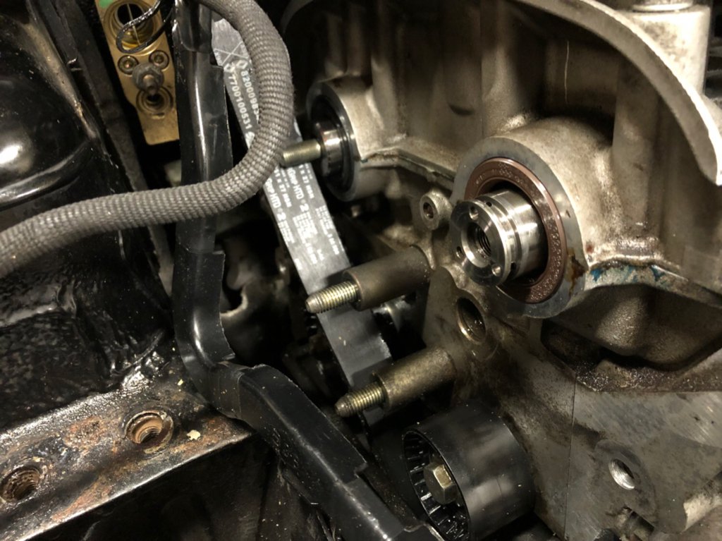

So a bit of a faf and definitely a me problem but that’s the cam seals sorted.

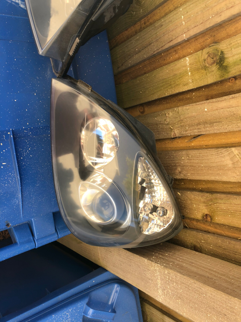

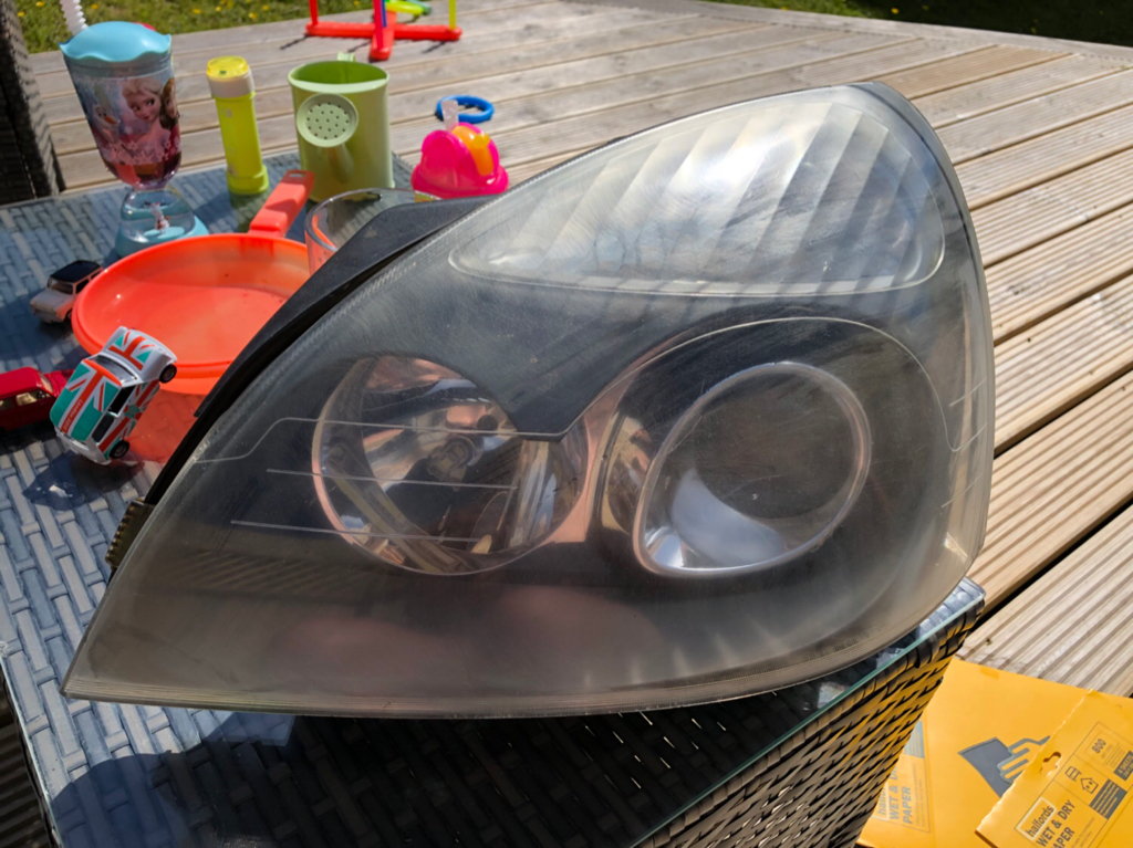

This weekends job was to polish the headlights. On the final straight for the front going back on.
Got some replacements for these.
Got some help polishing.
And finished like this.

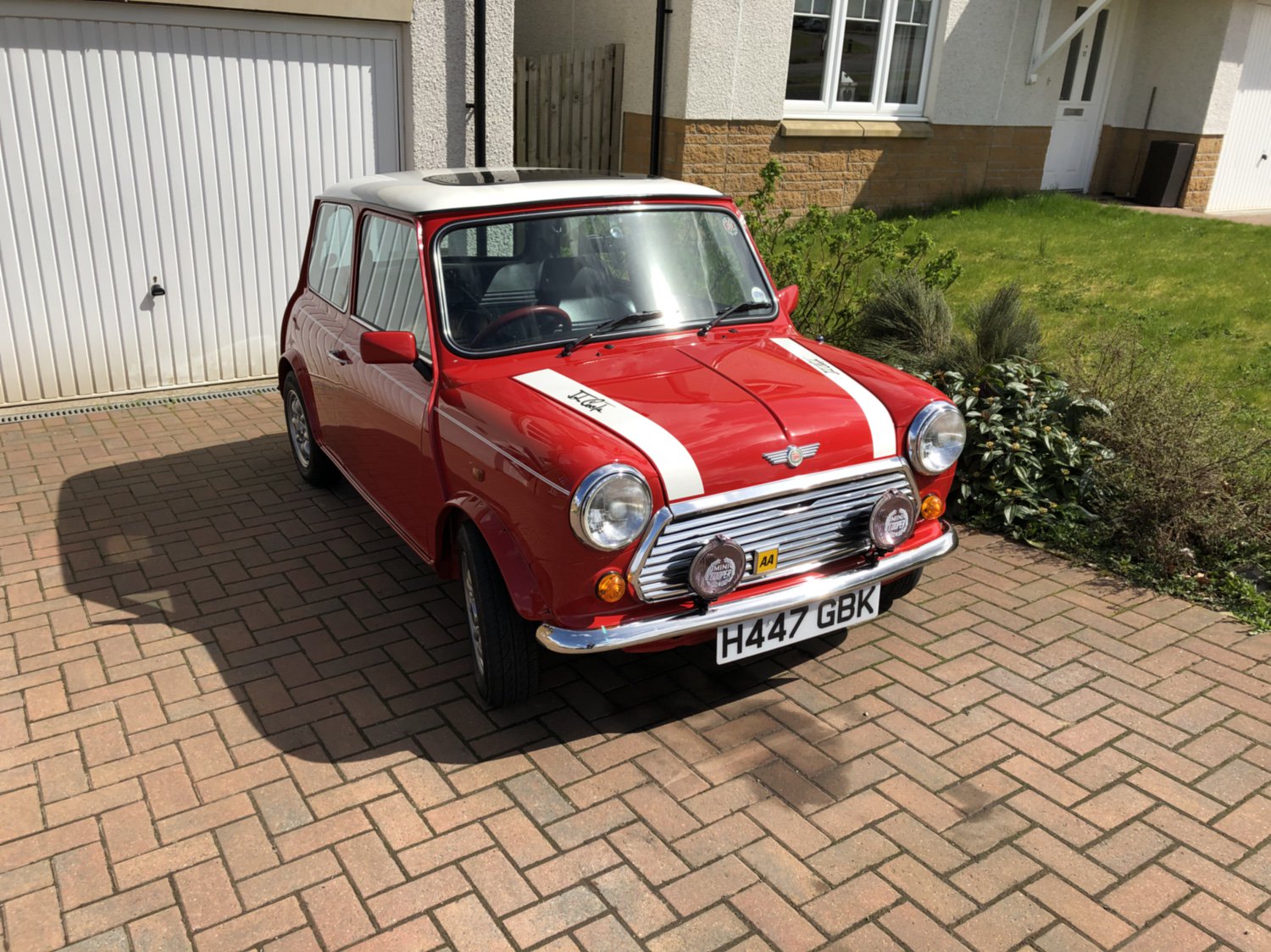

Also has some time in the mini today at a local car show (Glamis Castle). Man this car is a good one. It gets lots of attention at shows.
Some of my favourites.

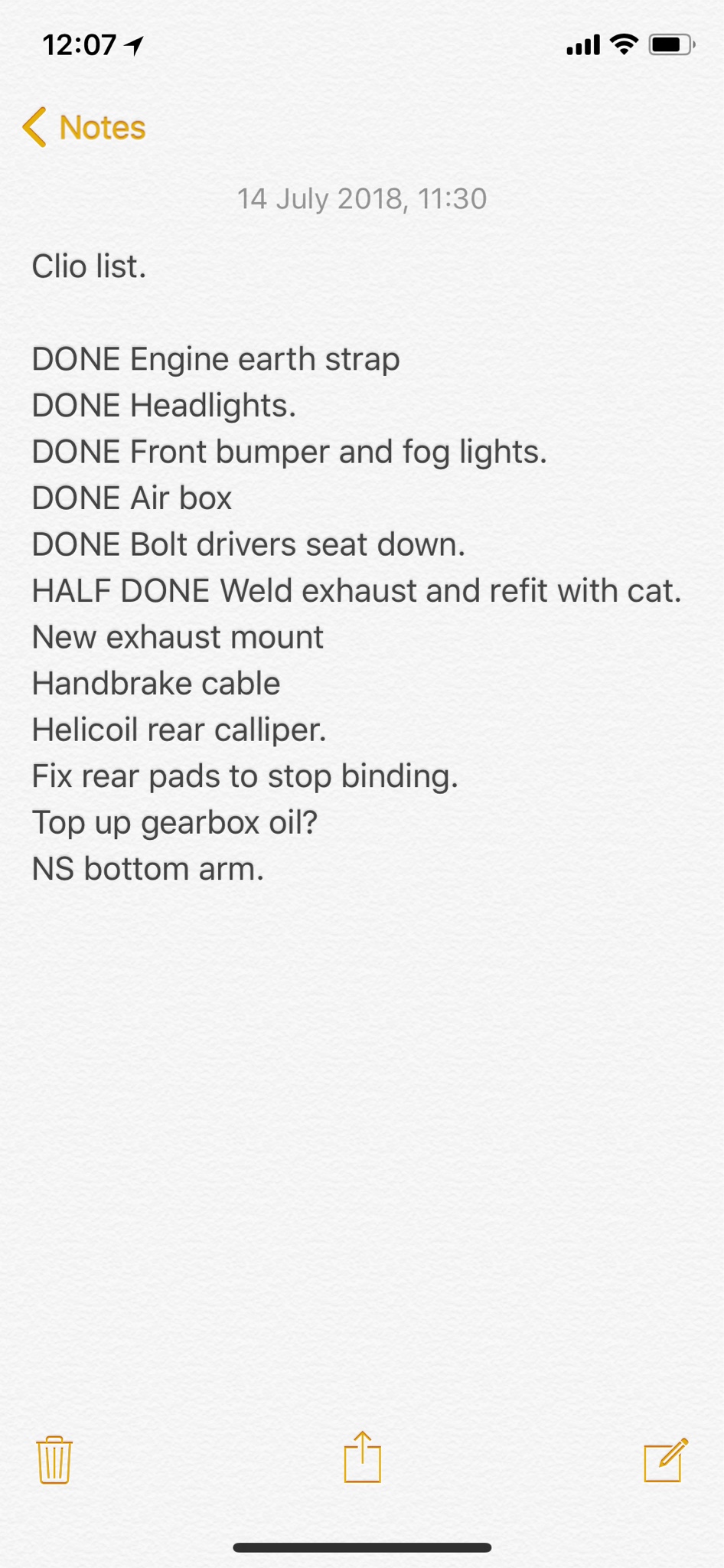

The list from the start:
As you can see I got about half way through.

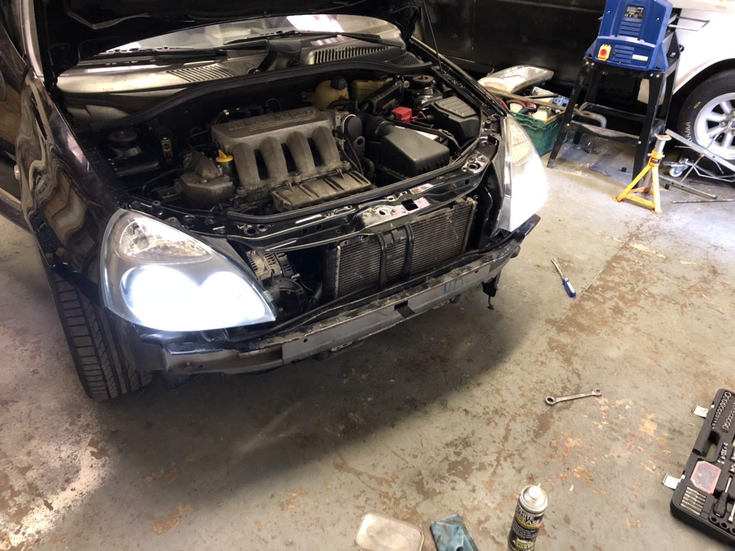

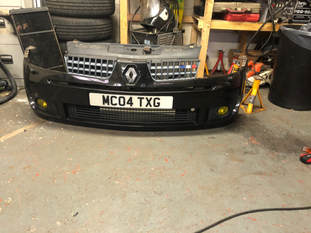

First the lights are back on.
Bumper ready.
I’ve replaced the fogs with a clear set I got off of @Djw John.

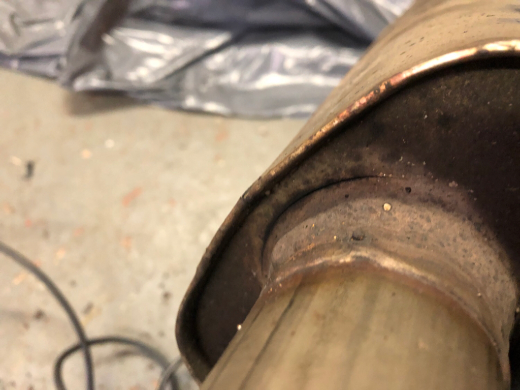

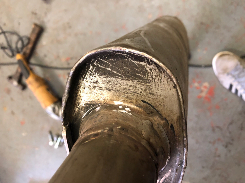

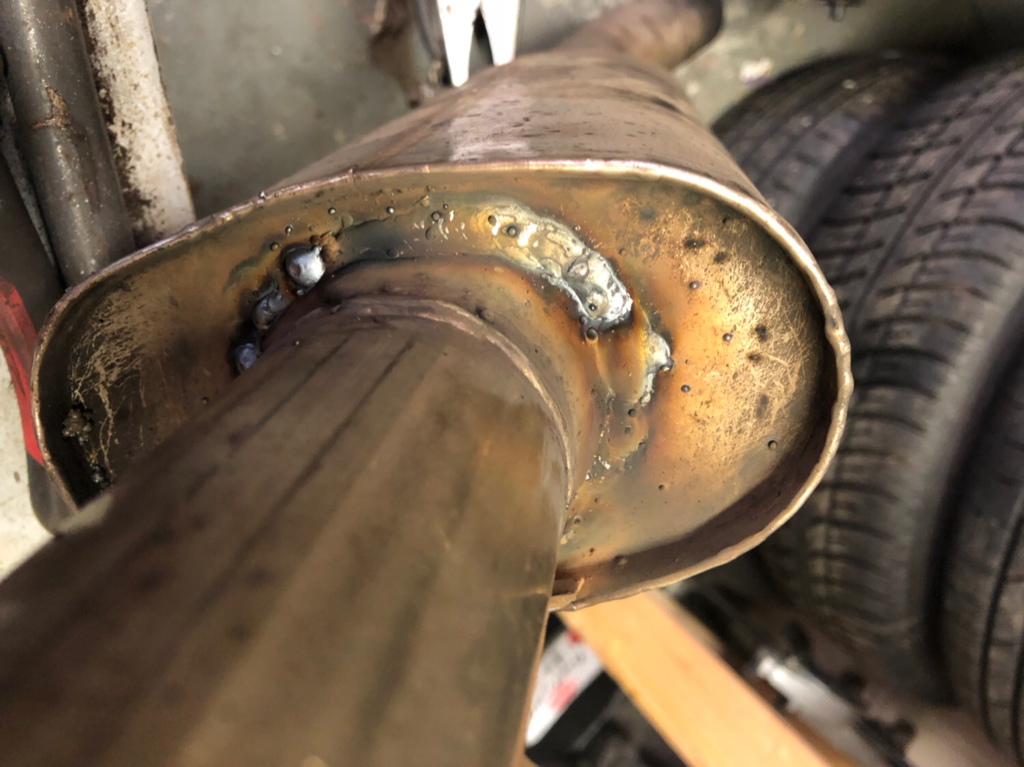

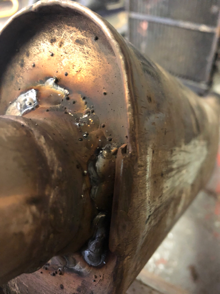

Also got the exhaust mod section off for some welding. You can see it has cracked in the usual place.
Cleaned up slightly.
Welding done.
I little spatter but overall I’m happy with it. For the job it’s all the time I wanted to put in to it.

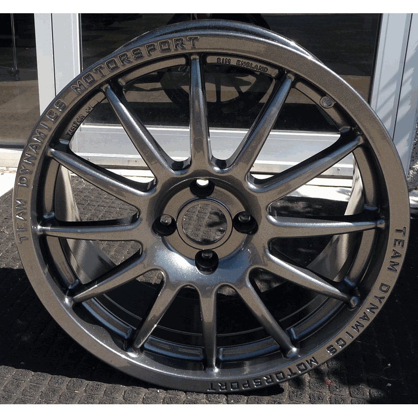

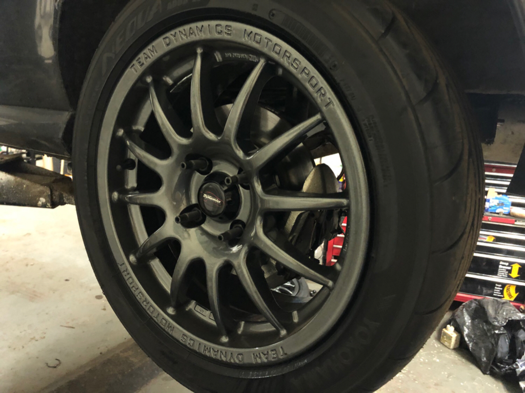

Almost finished. I’ve taken the spacers off because the rears would rub. They were 20mm.
It probably needs spacers looking at it though. I might try 10mm and see how it looks. Any opinions please. It’s a non cup suspension with cup turinis.

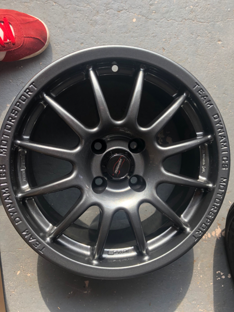

To that end I’ve ordered these and the Kwik Fit deal on yoko ad08r’s
I’ve also ordered some uniroyal rain sports for the turinis as my road / wet tyre.

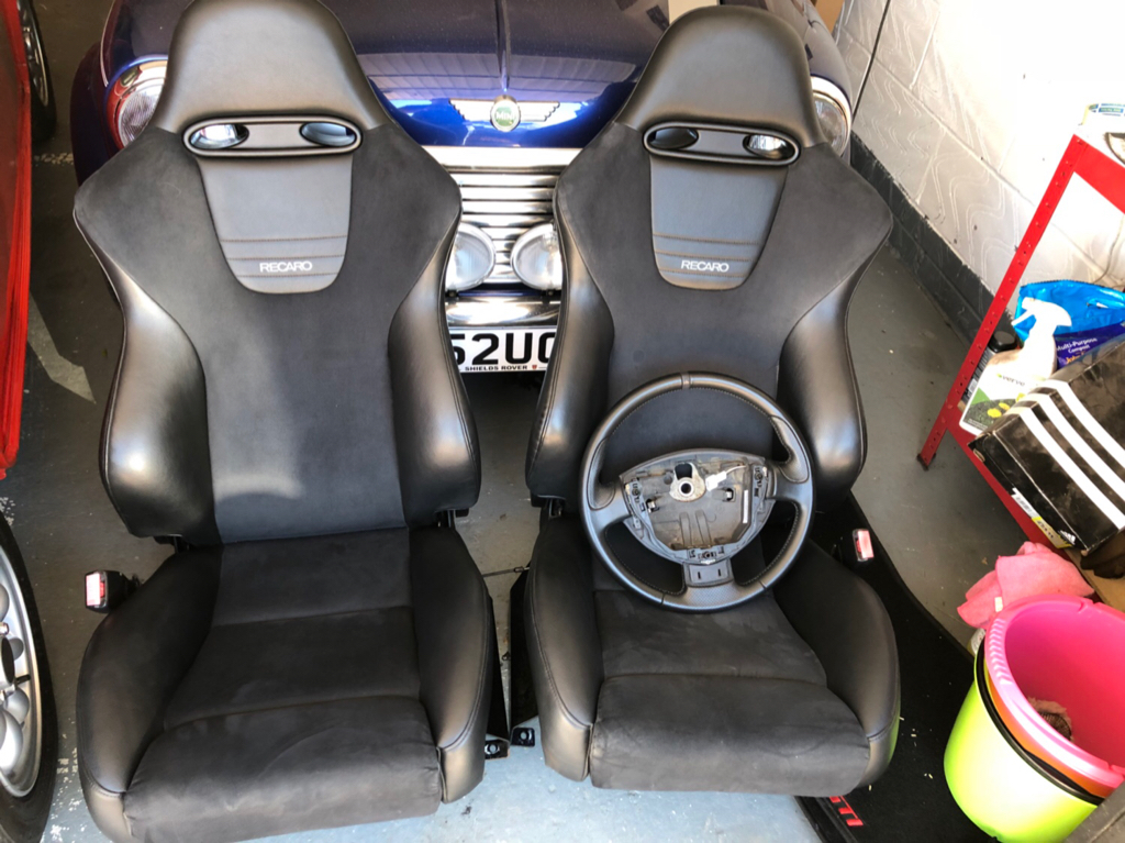

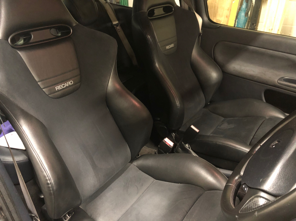

In said unit round the corner. Recaro trendlines were fitted tonight. Done them without the plastic spacers and pretty happy with the driving position. Photo isn’t great tbf.

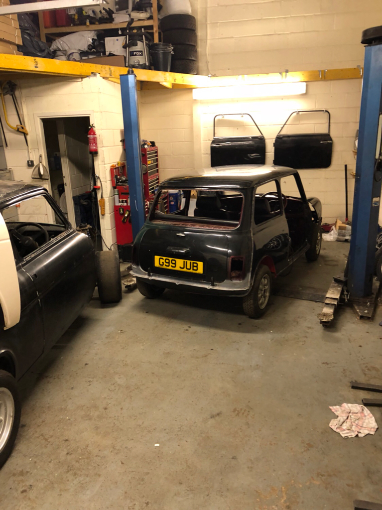

On a plus side. I spent a whole 3 days with just the 3 cars and now up to 4 again. Well 3.5 as this is a project I’ll share with my brother.
Collect on Friday [emoji23]

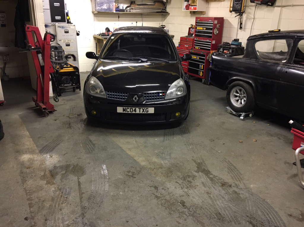

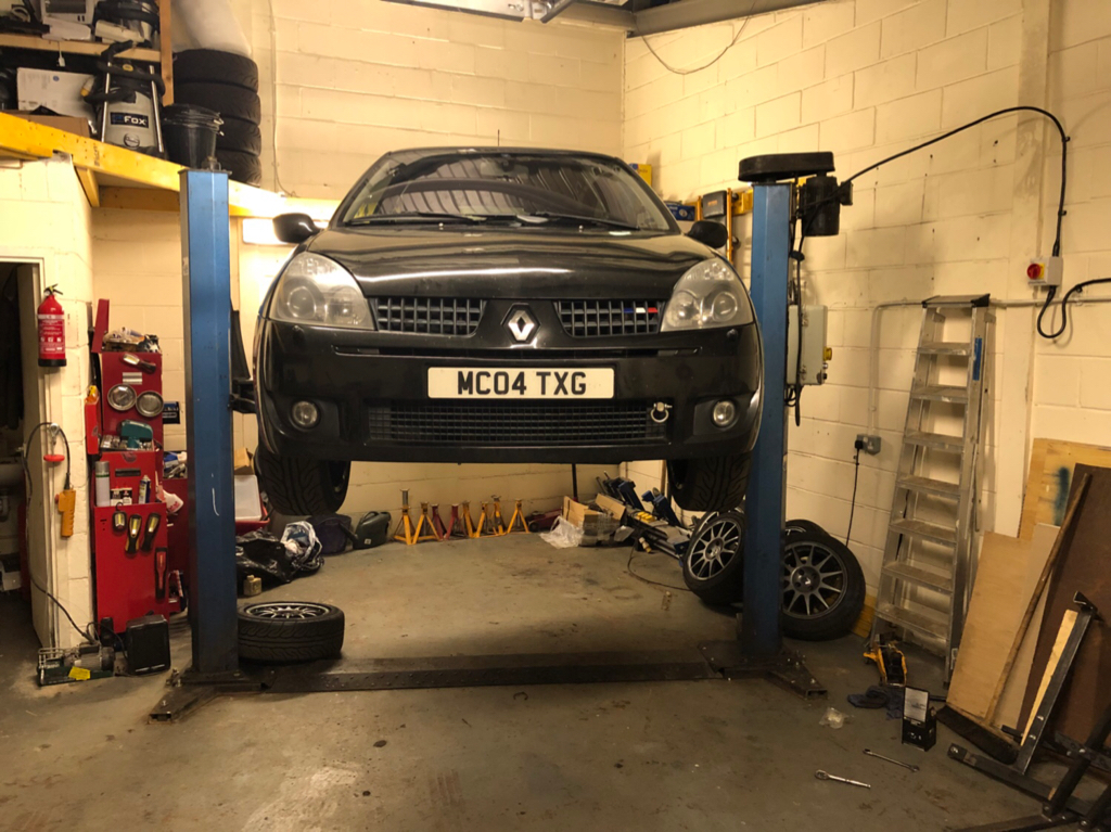

Number 1: big change at my lockup / unit. I have a ramp. What a difference this makes to working on the cars. Cost £400 second hand and split between the 3 of us it was a no brainier.
From this.
To this.

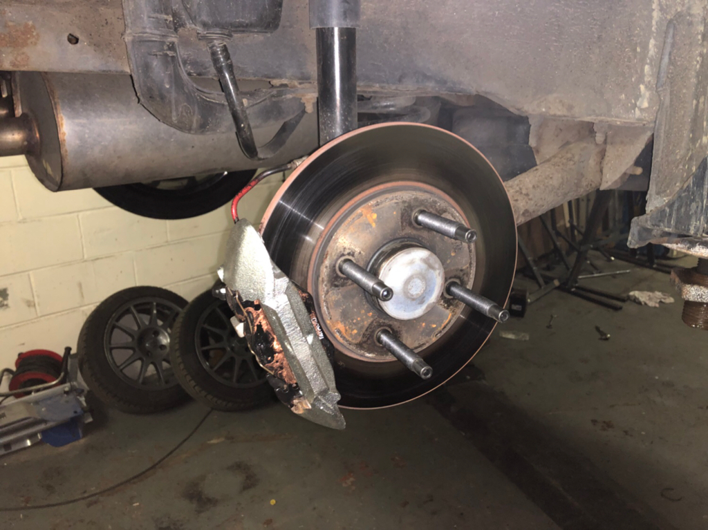

Went up tonight and changed a track rod and rack end (more about that in a second). I didn’t even change and no getting my clothes dirty crawling on the floor.
So this bloody track rod. Replaced so I could get the car tracked properly. The garage that done my tyres couldn’t get one of the lock bits off so had to track it with the steering off centre. After having a look I decided to replace that side rack end. Looking at both it was clear one was much older. All the parts ordered from RPD. I like buying gen parts when I can. Rack end was straight forward. Track rod doesn’t come with a new lock nut. The old one doesn’t fit as the TRE is a metric fine thread and all my packs of nuts were m10 standard.
A day later finally fitted after buying another TRE from euros.
Also replaced rear calipers as one was sticking. It took 50% of the pad life as well so new pads in.
New stud and nut to make changing the wheels easier.

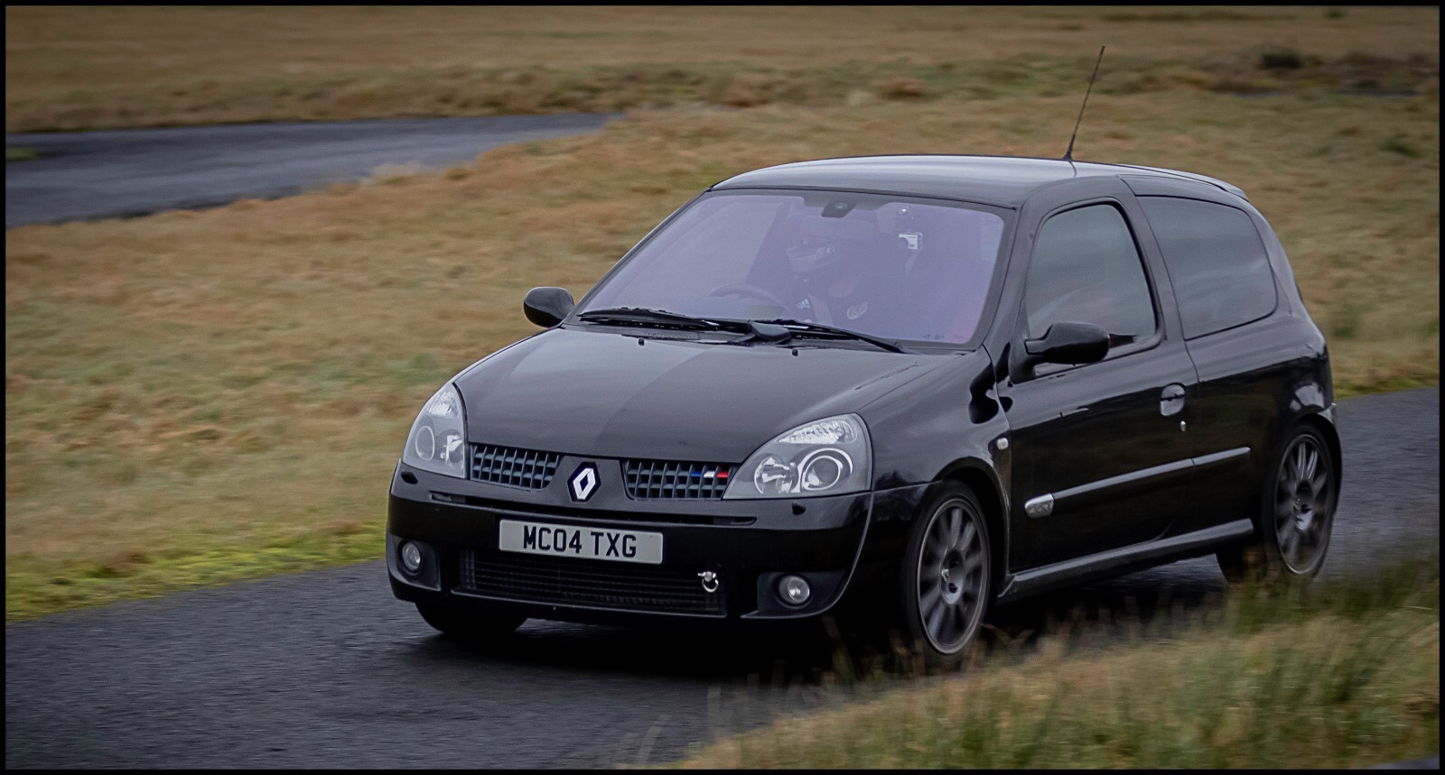

One picture from the hillclimb practice. My first time and I was a bit nervous. It was also very slippy with heaven rain showers and some dry spells. There is very little run off if you make a mistake so I took it easy for the first few runs.
After 6 or so runs I have a problem selecting gears half way up the hill. I nursed it back in 3rd and as suspected the circling came out and the selector bush popped out. So that was my session over.
There isn’t any official timing for track days but I timed roughly a 61 second best time. The best clips are running low 50s so I’ve got some work to do to get to that level.
It’s confirmed in my head that I should definitely go back to my original plan of running this as a hillclimb car. In the road class A2. So the recaro trendlines and snappy wheel will be up for sale soon and I’ll be going harnesses buckets and cage.

Spent the weekend in London with a good mate and today got chatting about cars. I think I’ve decided on selling the Clio. Interested in your thoughts on how to sell and thought values. I’ll put a proper for sale add together but if anyone is interested in the car give me a shout.
I can either keep it together as it is. Notably with the recaro trendlines and snappy steering wheel. One set of wheels (turinis with new rainsports) and all the TD 1.2s separately.
Or put back to standard and sell the recaros £750 ish and snappy wheel.
Together £3k standard £2k Ono doubt about right. Car has 99k miles and a lot of new parts as you see in this thread. Not perfect as it still has a leak from the gearbox and EML from one of the lambdas.
Let me know what you think.

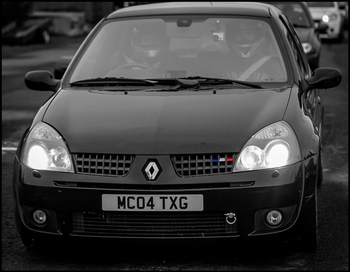

Video from Kames sprint test day today. I’ll do a bit of a spiel later.
My dad might have a few more photos of other cars including my brothers turbo’d classic mini and my mates saxo vts.
Here is me lining up for my first go.
So I’ve well and truly got the bug. Looking at using this for hillclimbs and sprints this year. I’m a member at two local clubs so can just do test days and track days without competing.
With a view to competing in the future. I’ll want to start building it to class 1b and compete in the road going class. Any recommendations:
