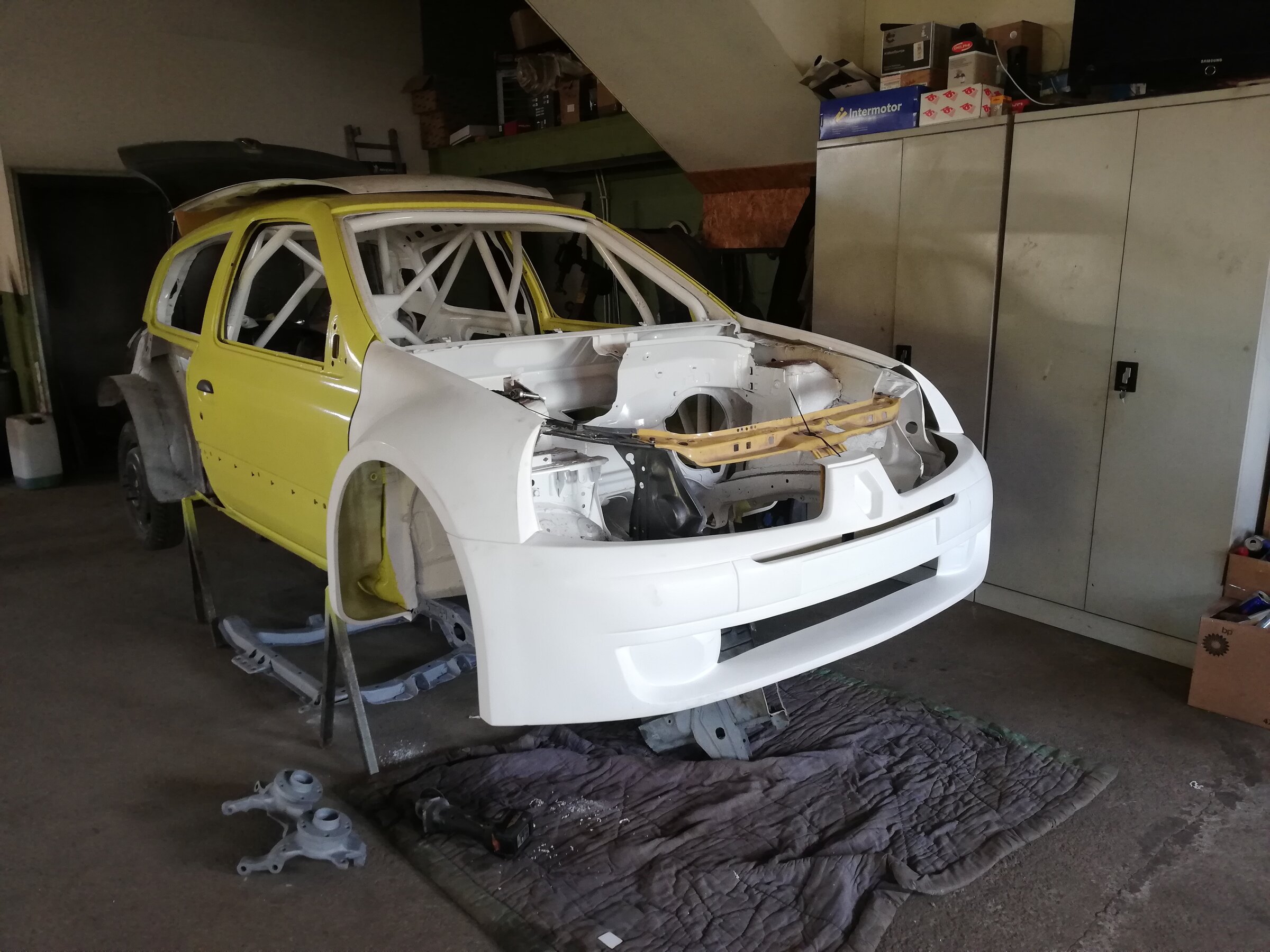

I will introduce you to a long clio project.
Car is not mine. I build that beast to my brother.
Currently performed
Safety cage

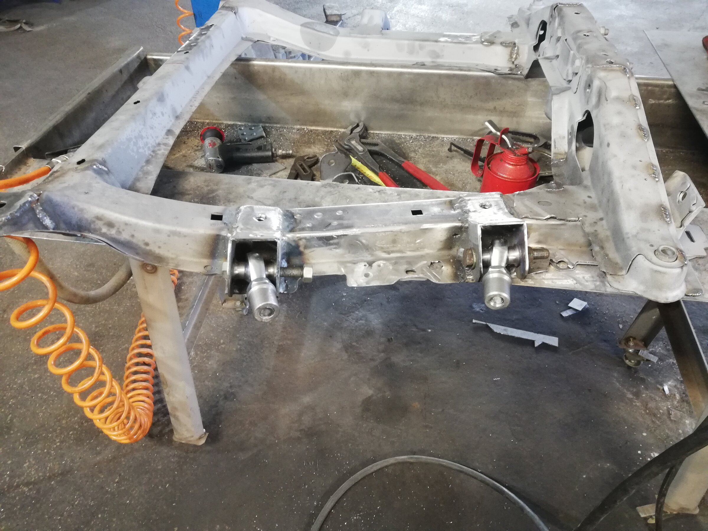

Rear axle.
Rear brakes
Half bodykit

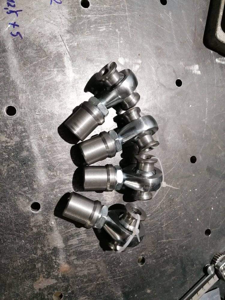

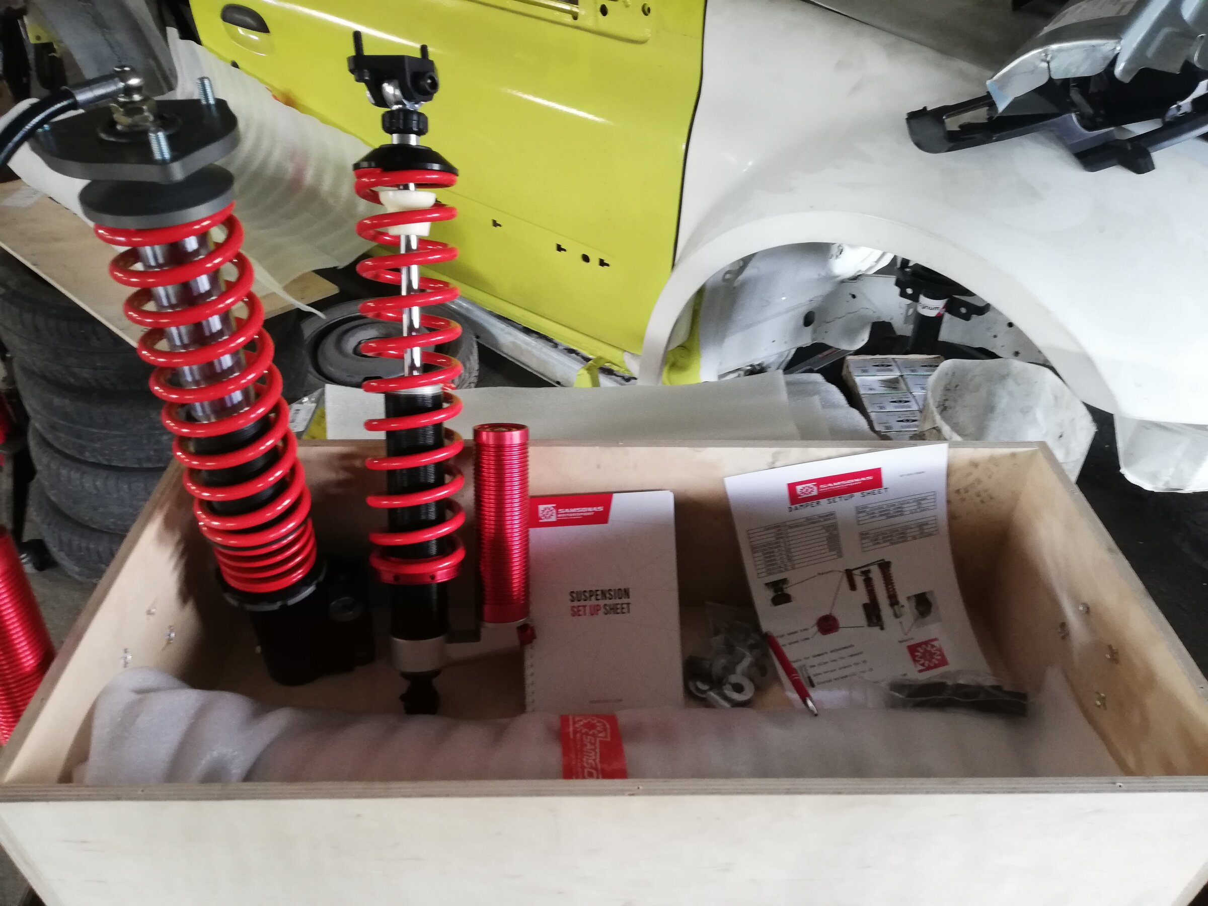

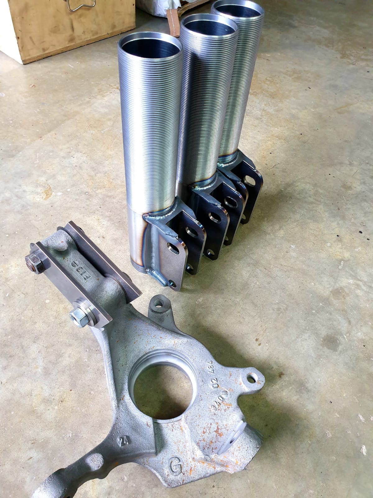

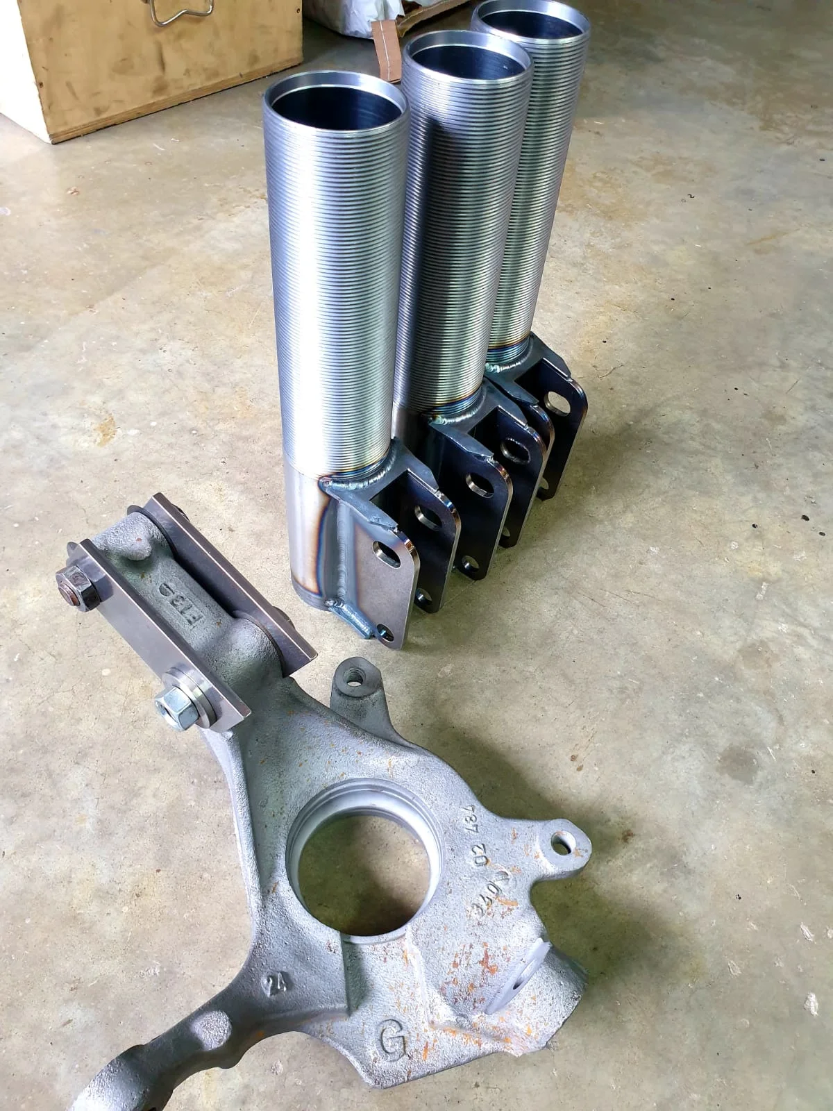

Front axle semi-finished. Laguna 2.2 uprights And ordered Samsonas motorsport dampers. With Laguna strut bodies.

Are you going to use a 1.6 engine & sequential box or are you sticking with a more cost-efficient powertrain?
A forced induction F4R for example would be an interesting way of achieving S1600 numbers, if not characteristics, without spending 60k.
I use f4r engine. Should squeeze out somewhere between 225 hp when 1.6L.
And gearbox between 2 option Samsonas or sadev. Don't know that yet.
