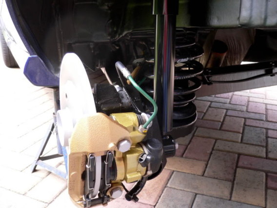

I'm guessing you've already taken them out on both sides and don't have a reference side to work from. I found this
which shows how you put the spring clips in place.

6. Replace spring clips with oval end clipping over top tabs of pads as in photo. Once clipped in place should hold there unheld
