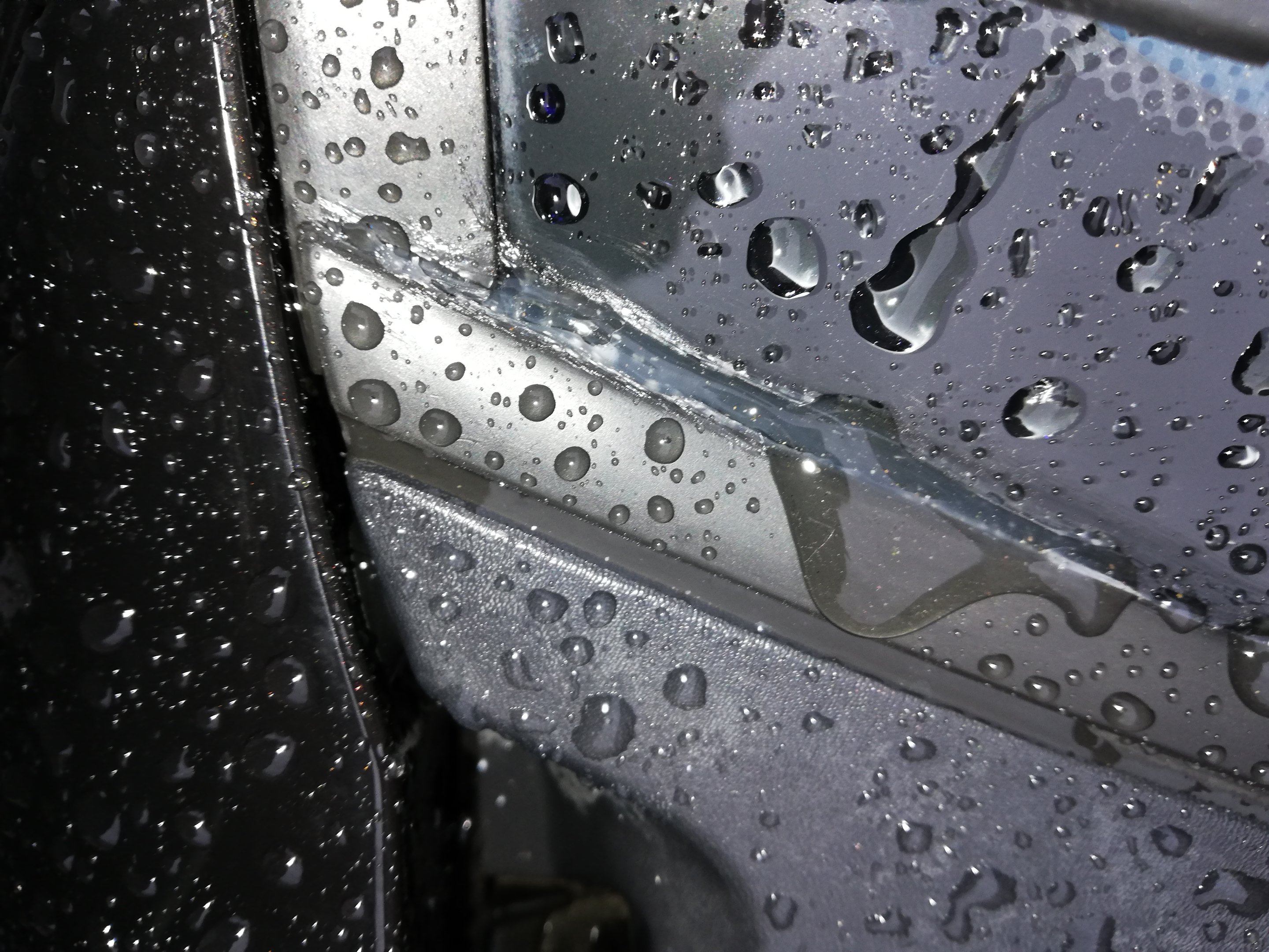

After taking off the skuttle panel yesterday to check the drains (couldn't actually find them) it was clean down there and all three holes were letting water out. When I went to put the scuttle panels back on I noticed on each end the seal the goes from the scuttle panel to windscreen is not flush and lifts up as the seal goes above the side seals it leaves a gap of a few mm. Is this normal or am I being daft? I really should have checked before I took it off thanks. I will add pictures soon
I put some silicone to fill the gap for now

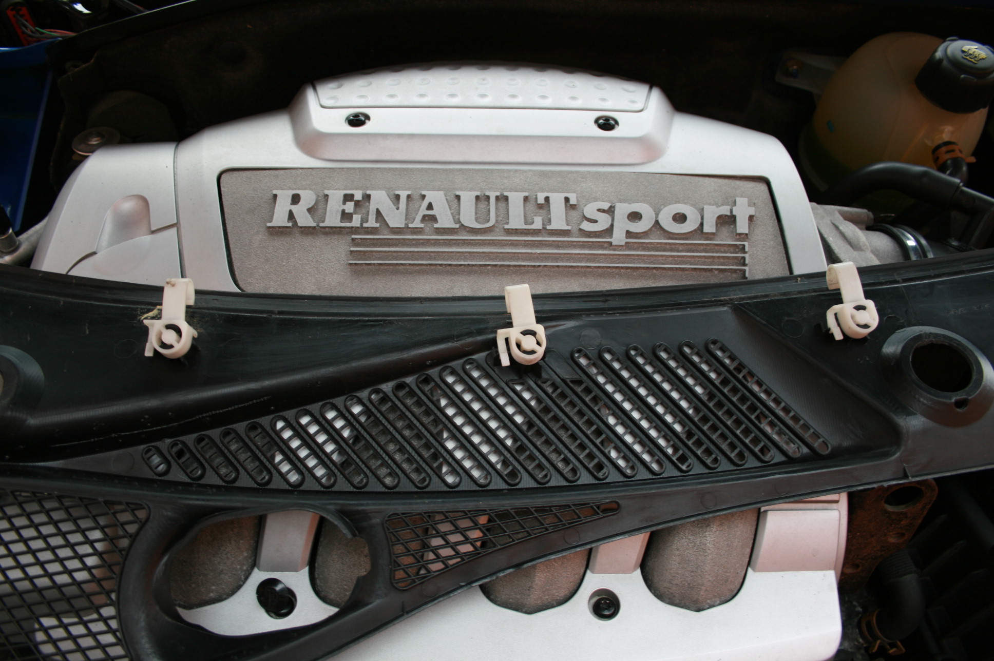

You may find that one or more of the white clips are broken on the underside of the plastic scuttle, it's the pressure that these create when fastened that keeps the seal snug to the screen (clips break easily).
No big deal though as the water only goes into the drains anyway.
Oh right, I will investigate when all this weather stops thanks
The clips I mentioned.....
One of mine had broken in the past and I had a similar problem, I replaced the whole panel.
