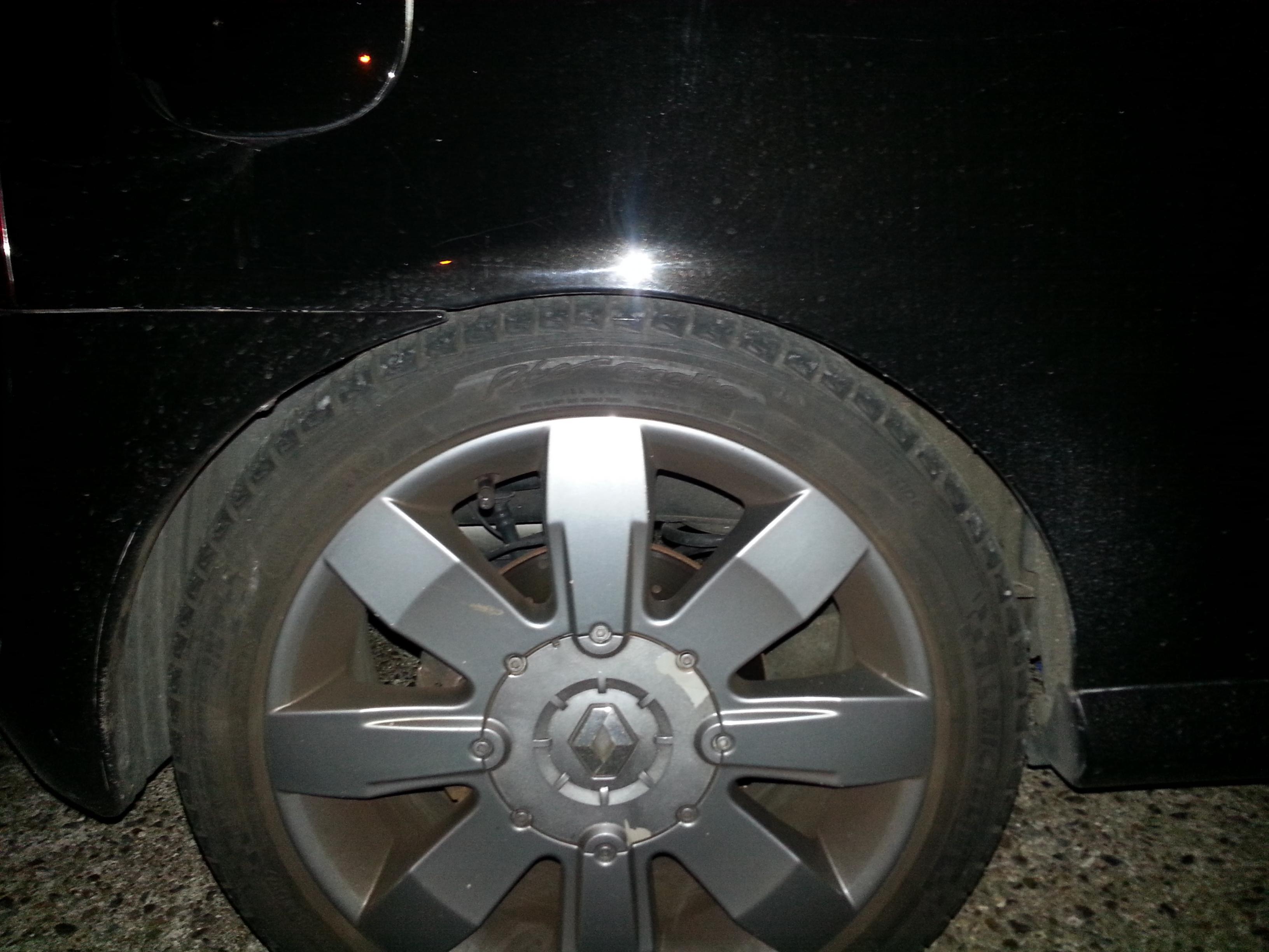

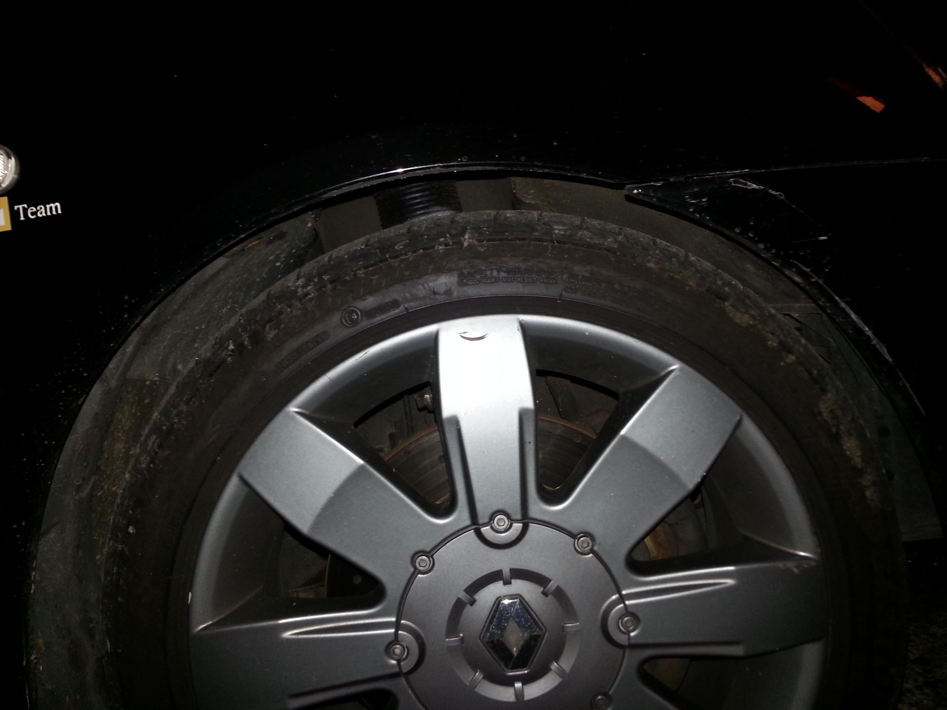

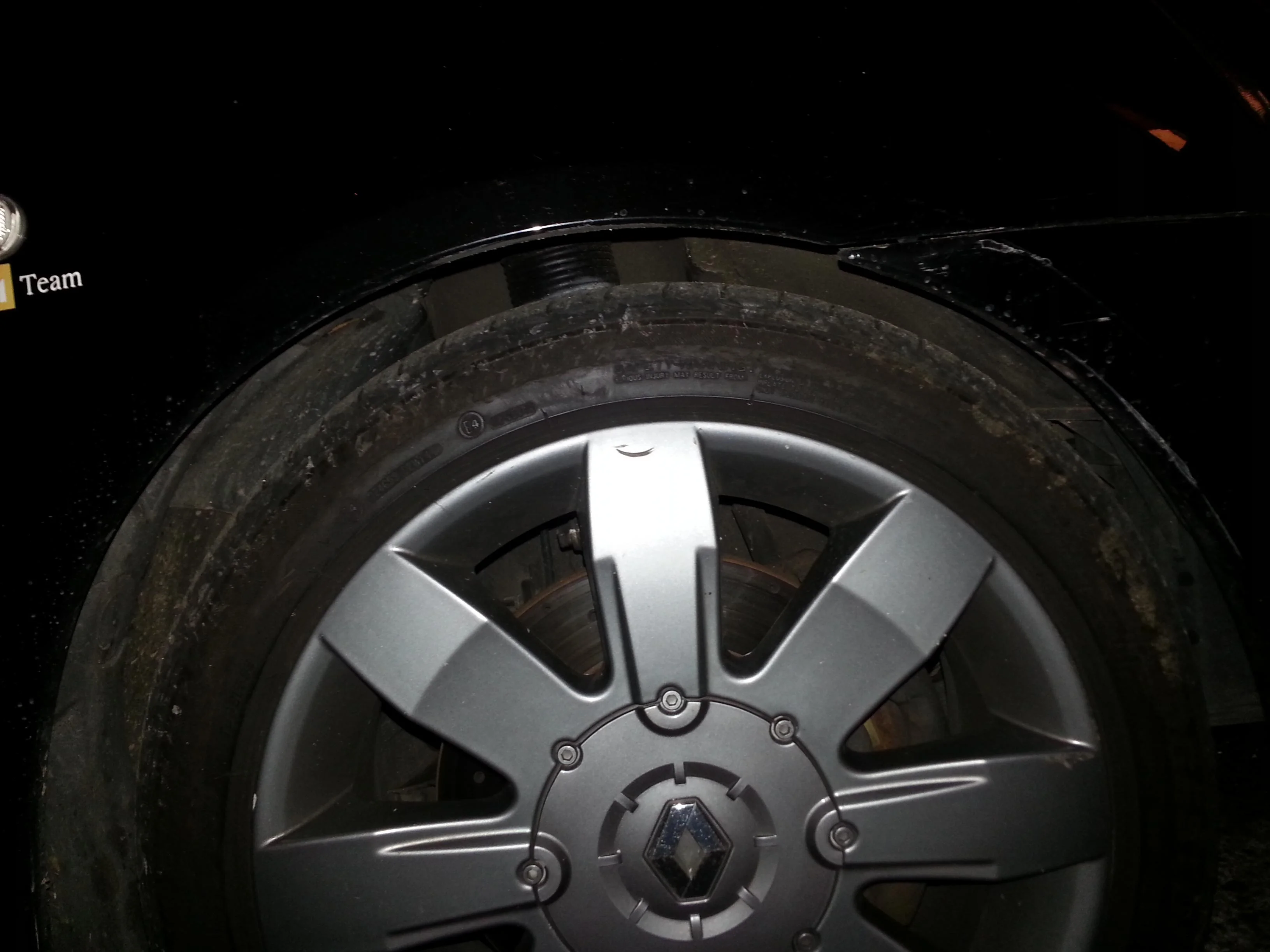

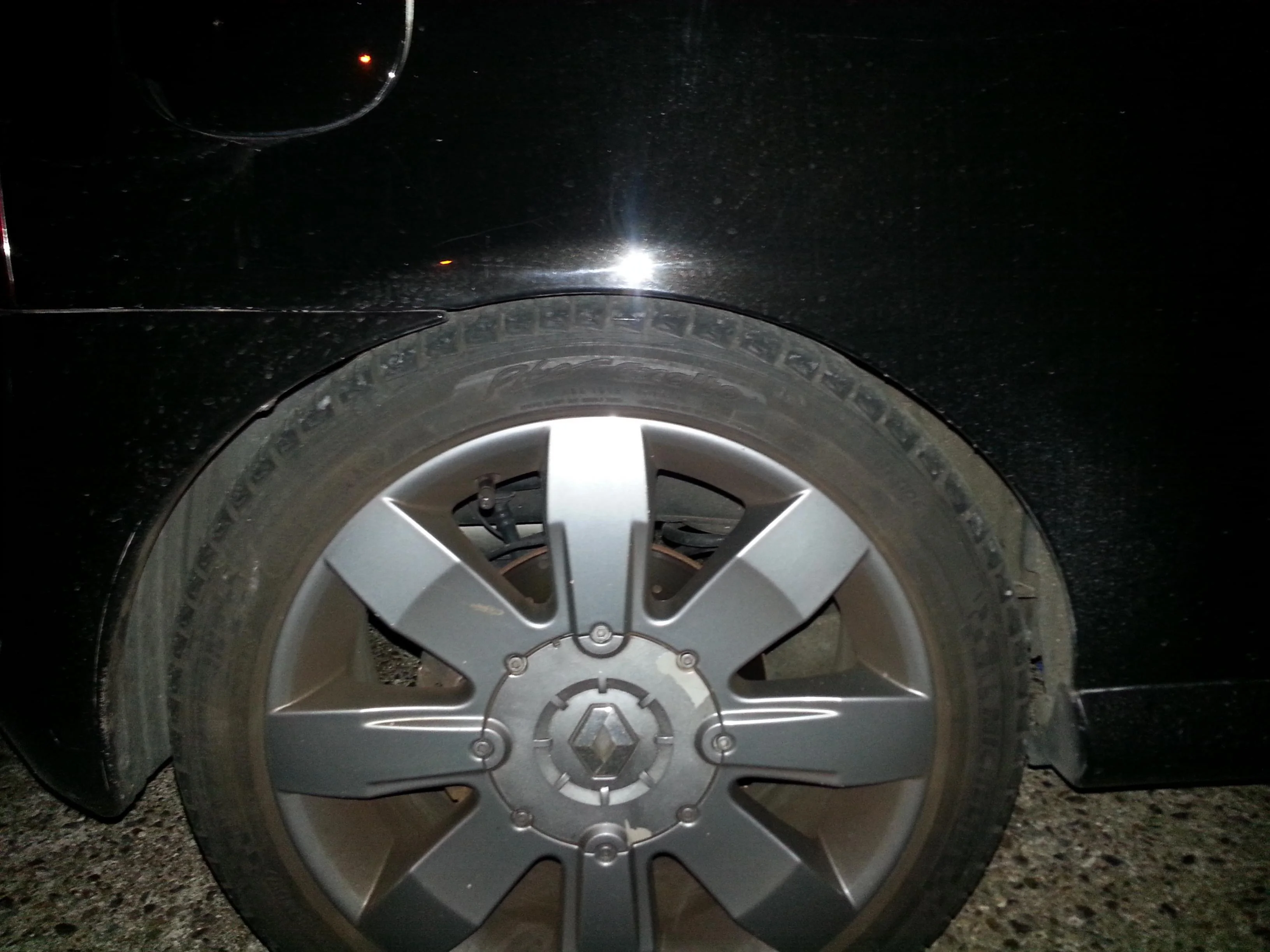

The rear looks quite low in these pics must be lower than i originally thought!
Front
Rear

Ahh, that's better.
Looking at the pics, that is the same arch gap all the way around (front picture) - which was the same as my Clio when it had Eibach Sportlines, I believe they give a 25-35mm drop - so there's your answer :).
