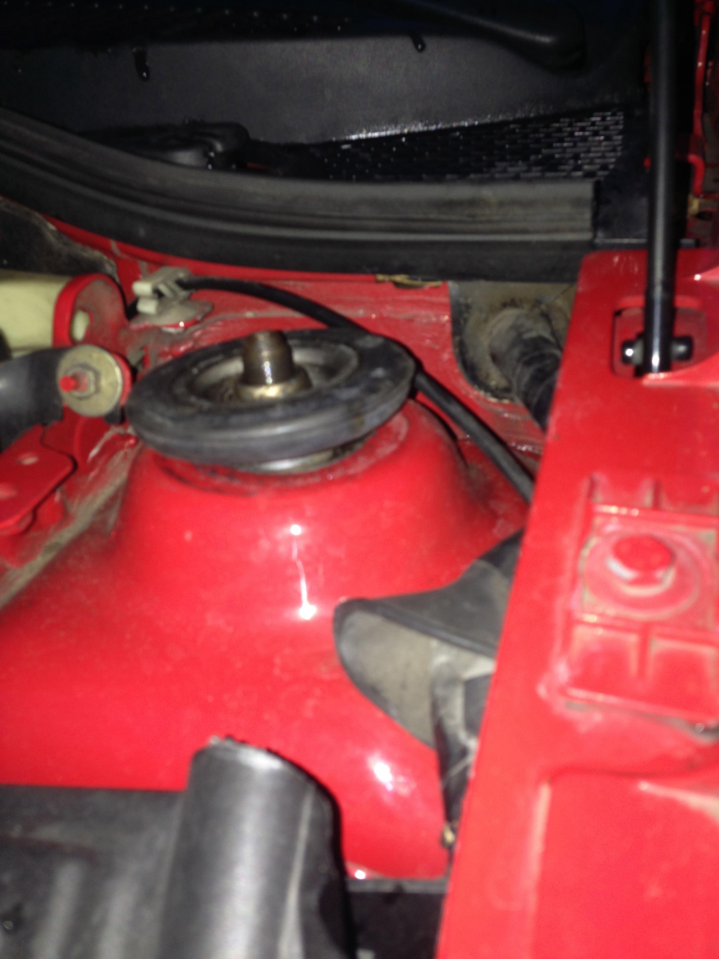

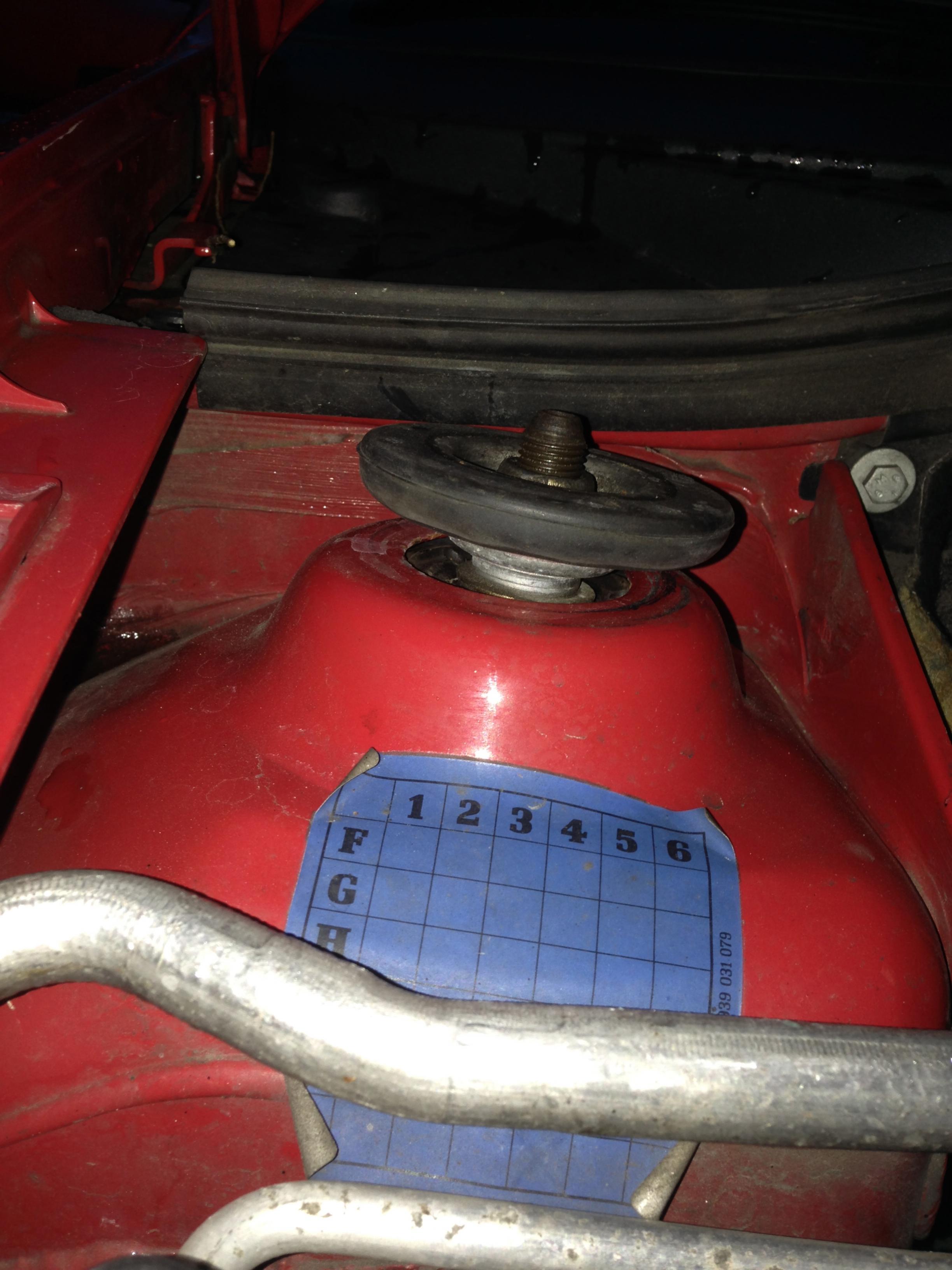

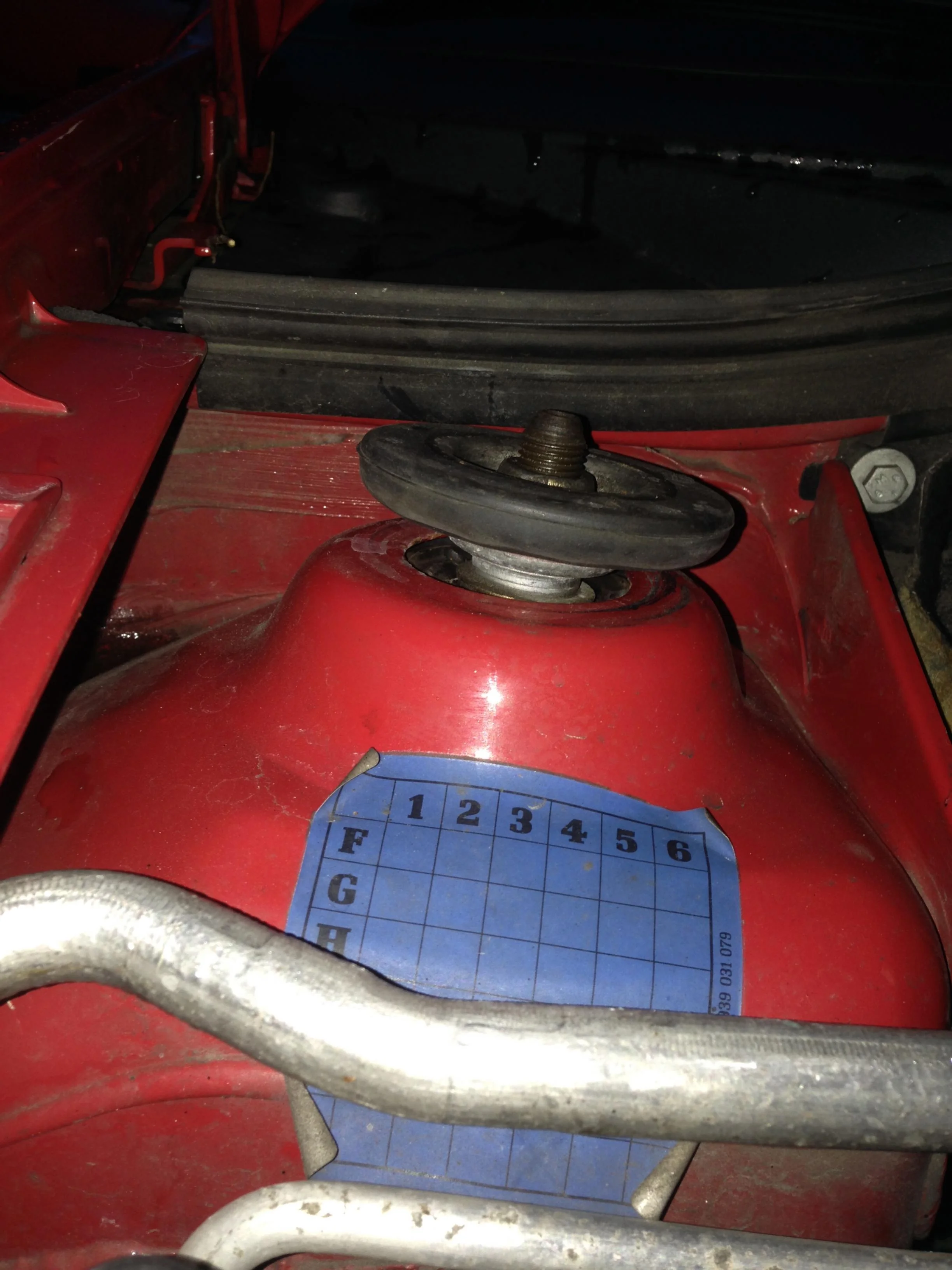

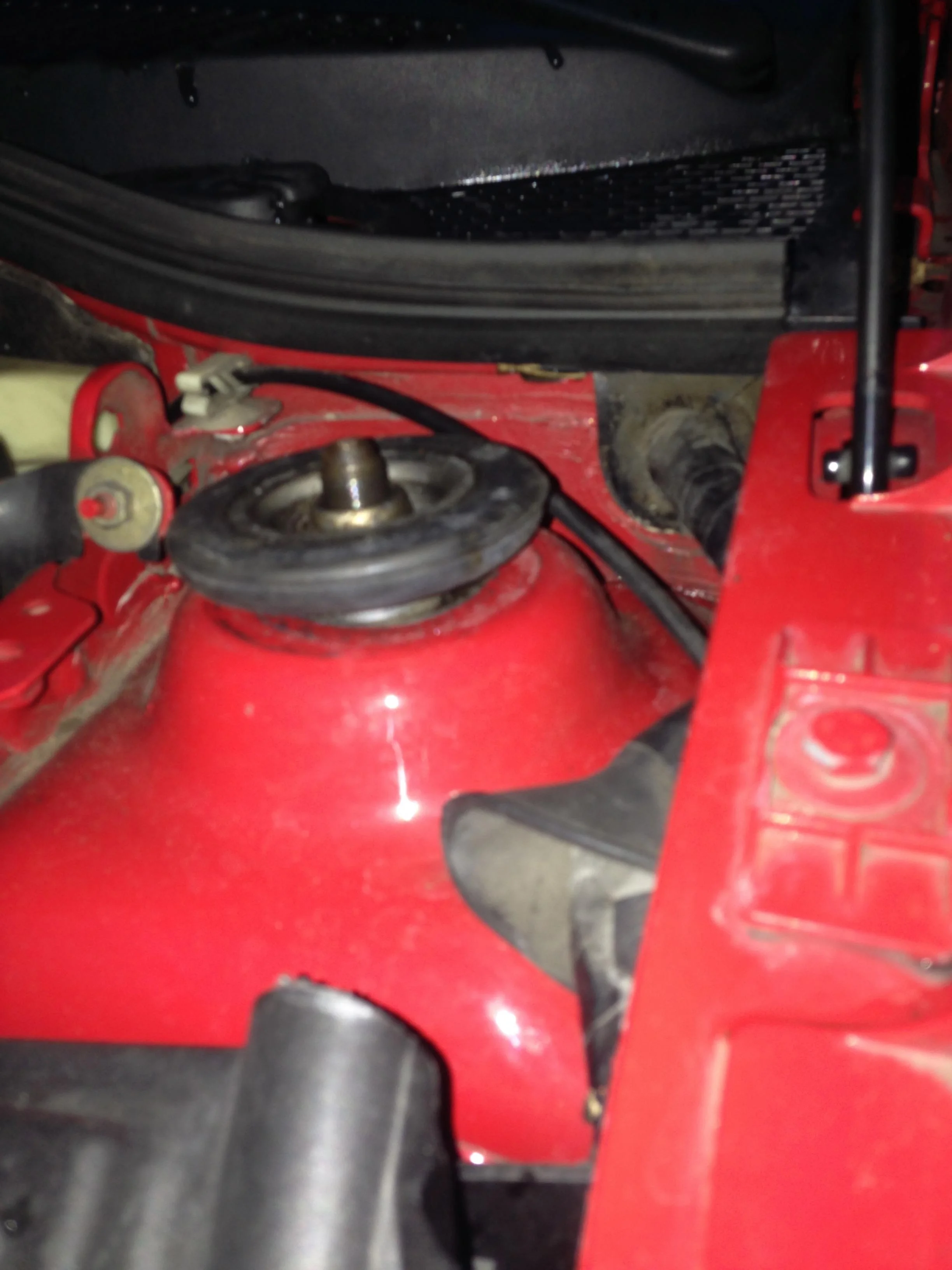

Hi guys I've recently noticed a knocking noise when on full lock, usually when just started in mornings, I've been to local renault garage and they said its just the suspension when cold. It causes a jumping and knocking sound. but I've just noticed under the bonnet, both the mounts has a gap on the rubber washer, should it be like that or should it be tight onto the metal?

That gap is fine.
The knocking is quite possibly buggered top mounts though to be fair. Have they ever been replaced? Renault now have a different design which helps to stop the knocking.
