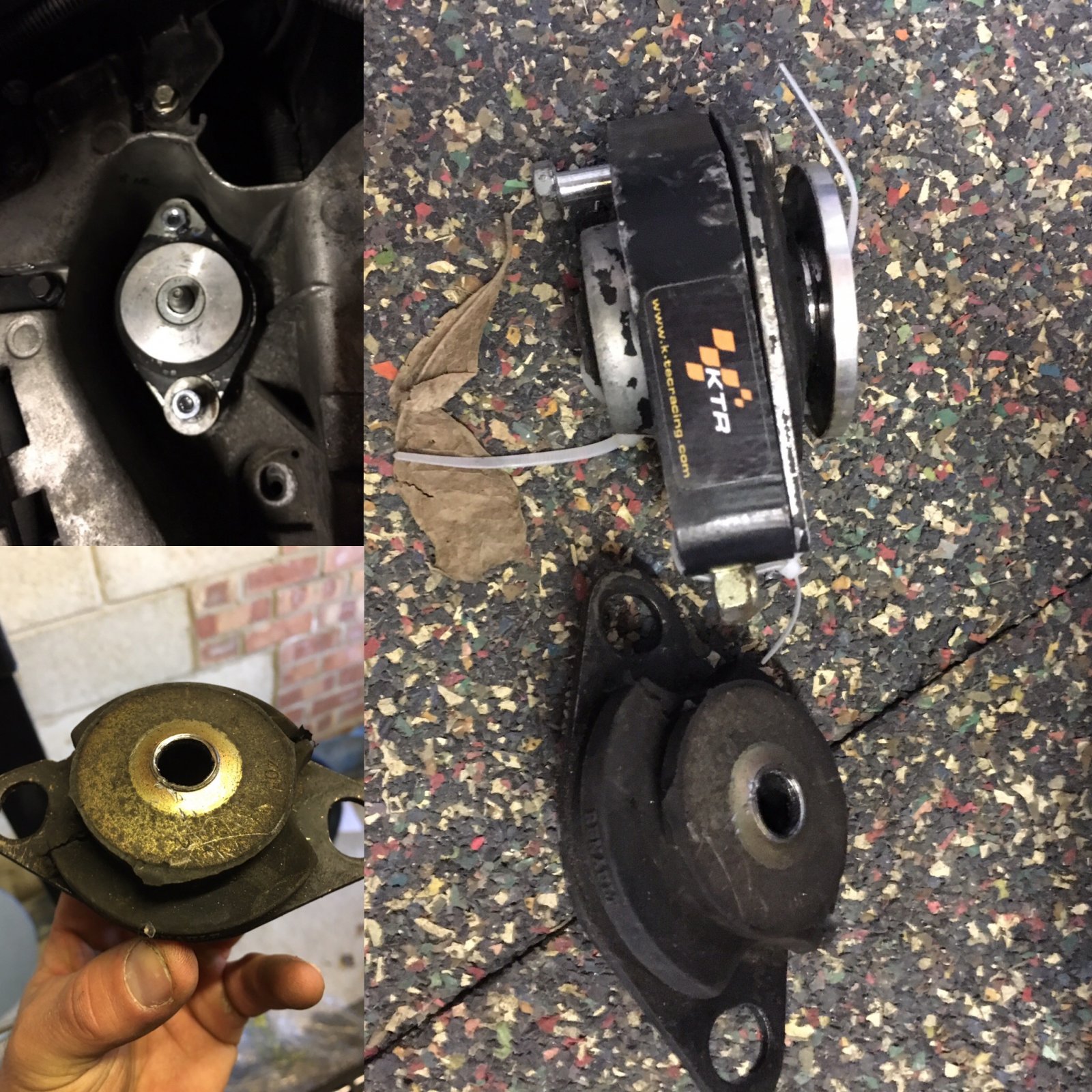

Replaced the powerflex bush with the ktec engine mount other day. Just got to fit the upper gearbox mount next

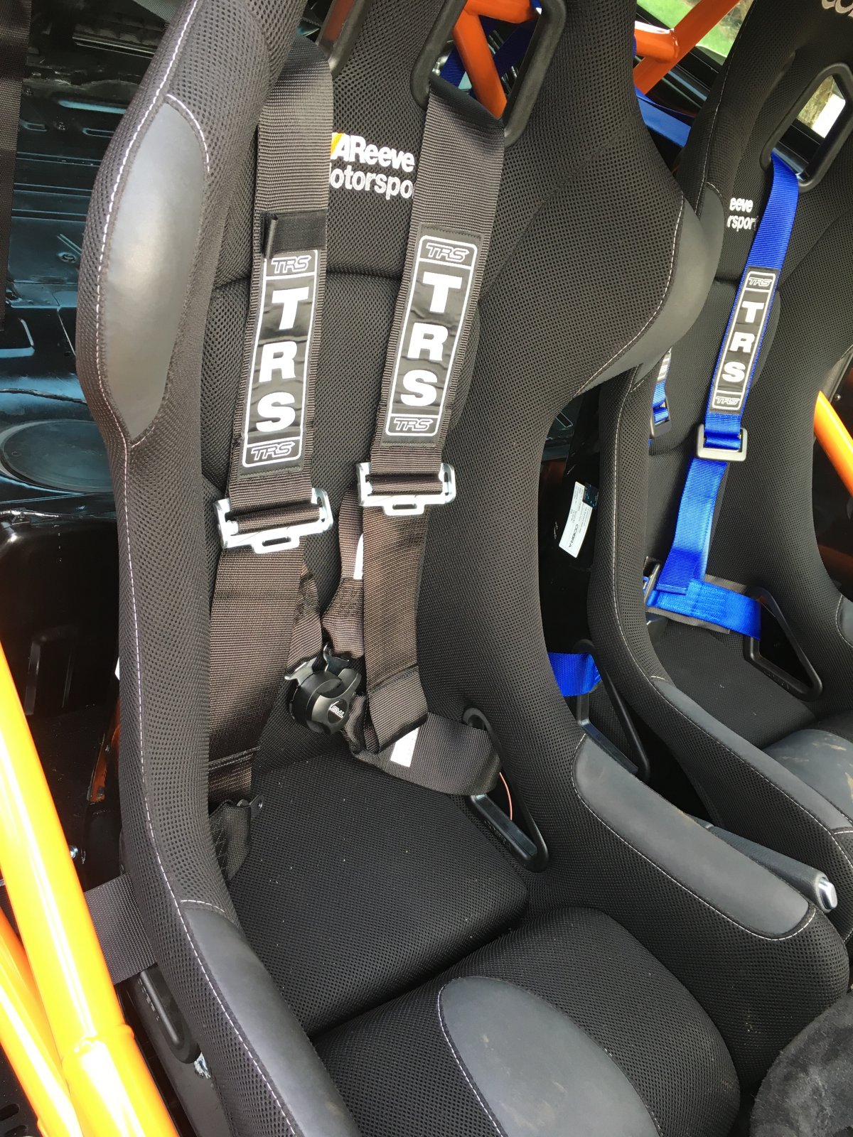

As said, I'll be looking at getting a new harness so my TRS 4 point belt buckle style harness will be for sale soon.

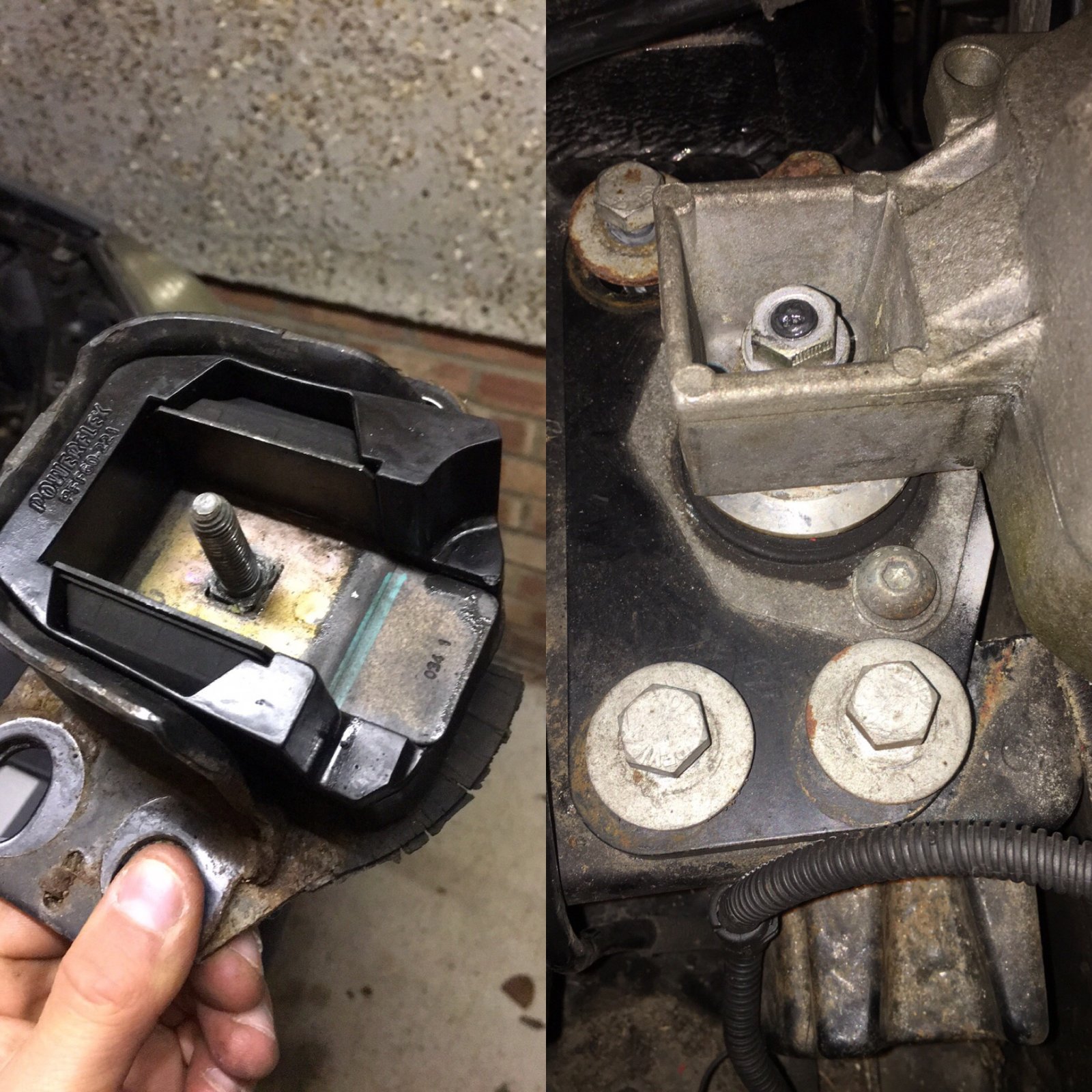

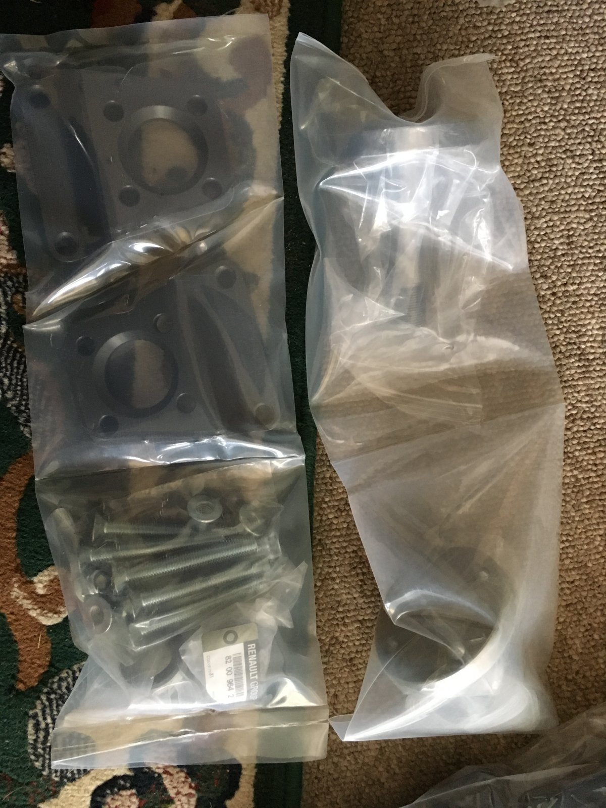

Out with the old in with the new. Replaced the original upper gearbox mount with the uprated ktec mount today. Had to remove the casing/ spider as had to fit longer bolts where the mount is bolted to the casing.
  Clio 172

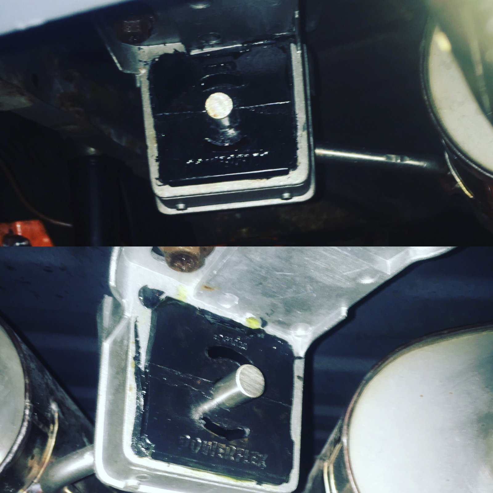

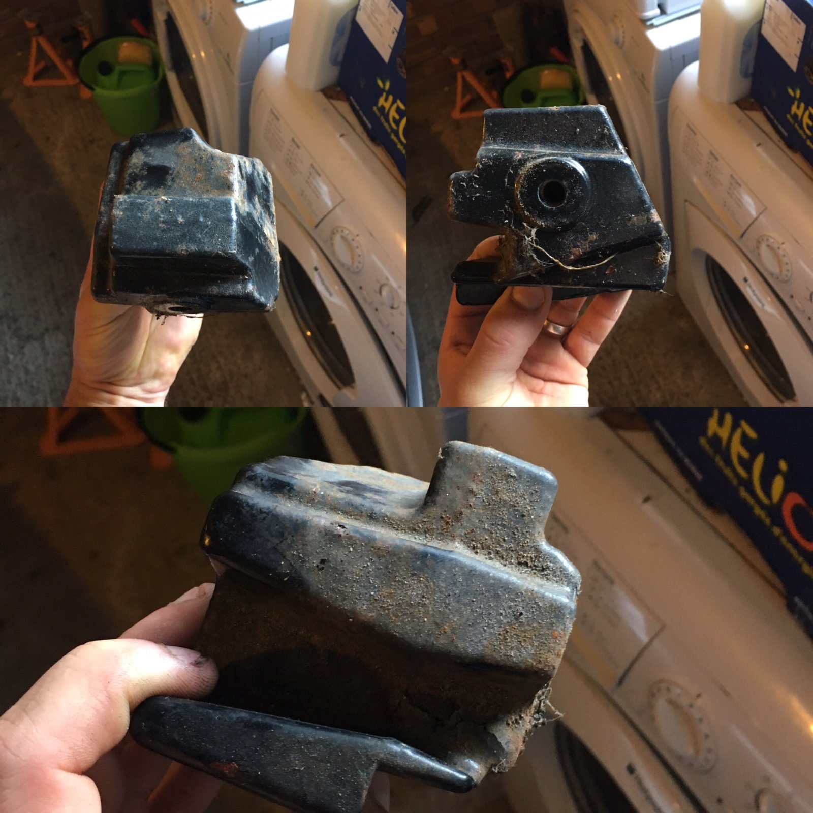

Fitted the PowerFlex black bushes to the exhaust mounts today. The left hand side original bush wasn't too bad but the right hand side bush had failed so the exhaust was resting on the mount itself.
Good job I had a spare mount as when we went to push the bush into the mount it cracked the corner! Had a quick google, and it looks like other people had the same issue with the black bushes. To remedy this, the tabs on the edges of the bush had to be cut off and made hell of a difference!

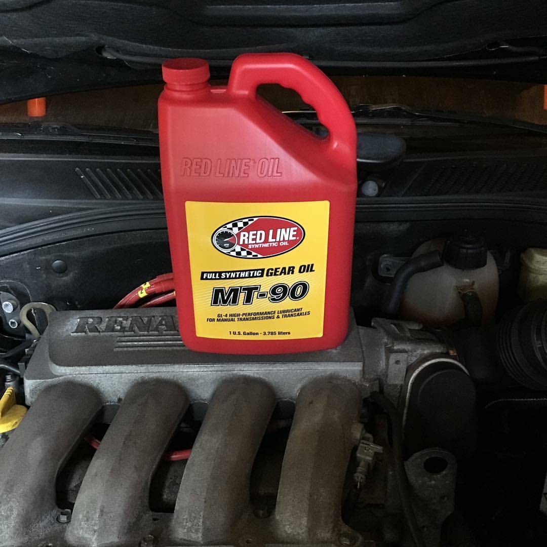

Also, got a oil drain tub for when change the engine and gearbox oil and a pump to refill the gearbox using the guide from here (remove the air box to access the wingnut on the gearbox oil full point).
I'll be using the
Millers Oils NANODRIVE CFS 5w-40 for the engine and the
RED LINE Synthetic Manual Transmission 90 MT90 75W-90 GL4 for the gearbox

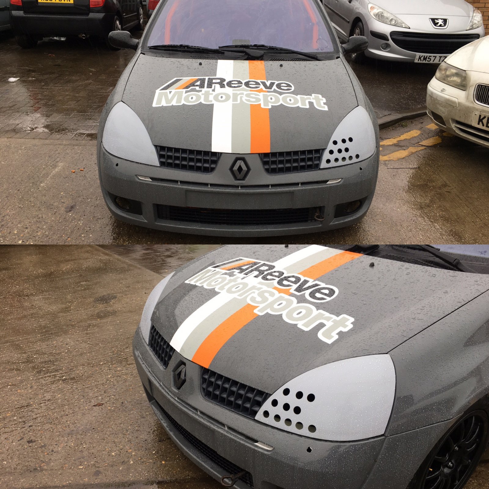

Had headlight blanks fitted!

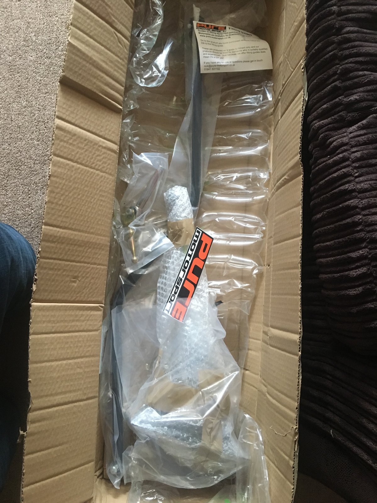

I'll be getting the pure motorsport rear stub Axles, and a 20min toe shim for the rear passenger side and adjustable wishbosnes shortly.

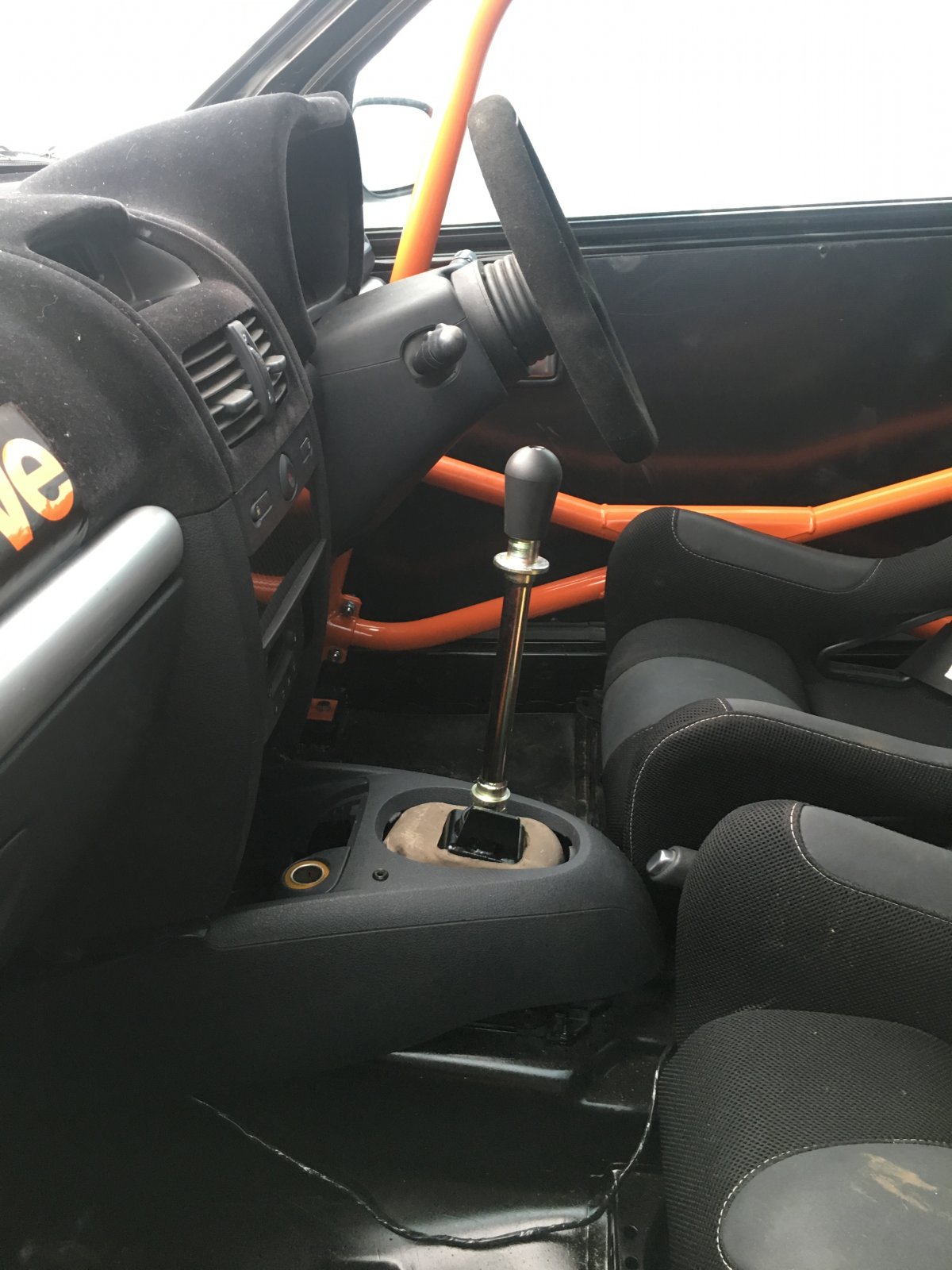

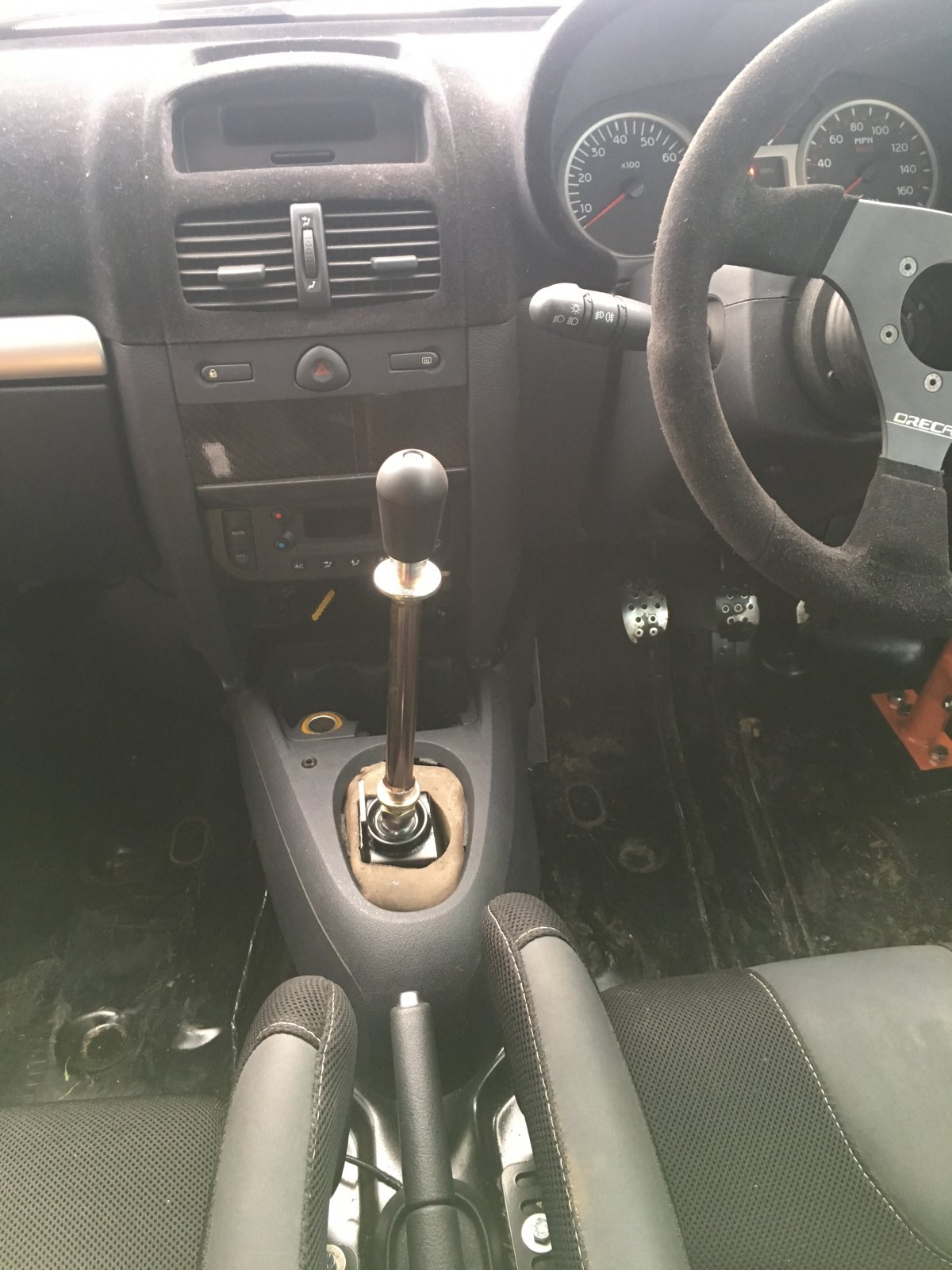

So I just order the PMS shifter :)

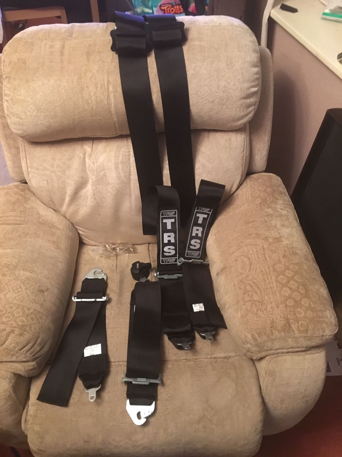

Also got a new 4 point safety Devices harness ready to be fitted waiting at home whilst I'm offshore

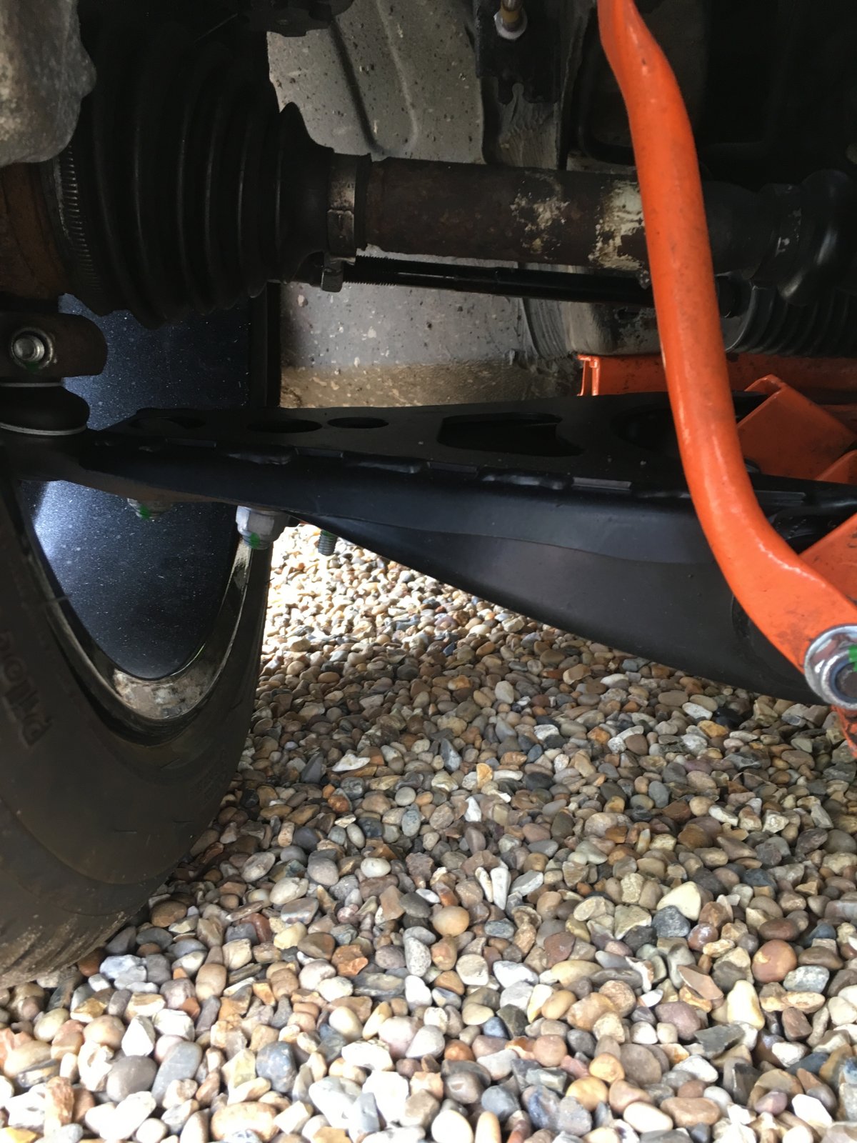

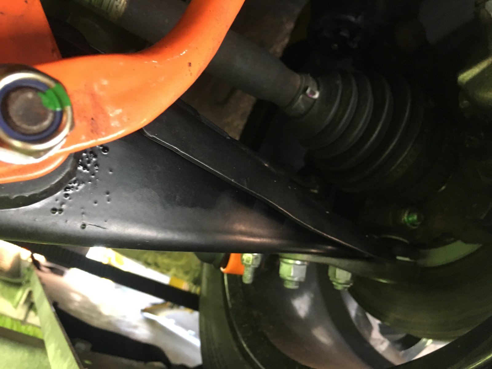

So small update

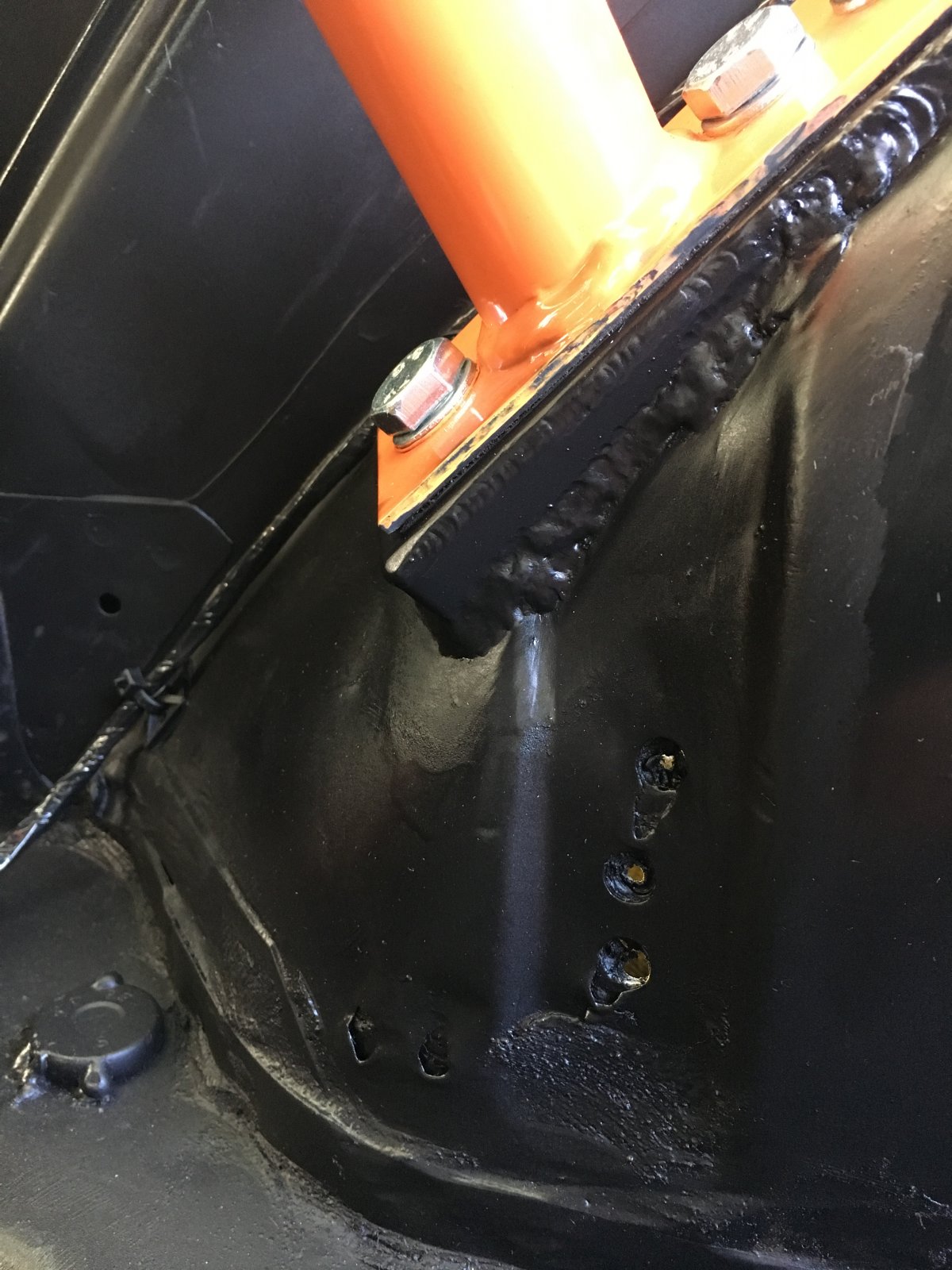

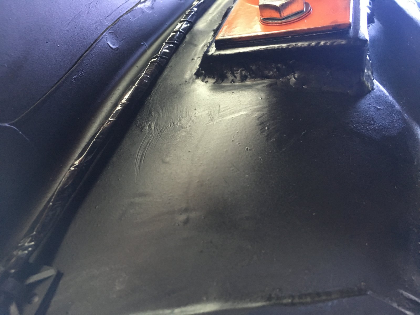

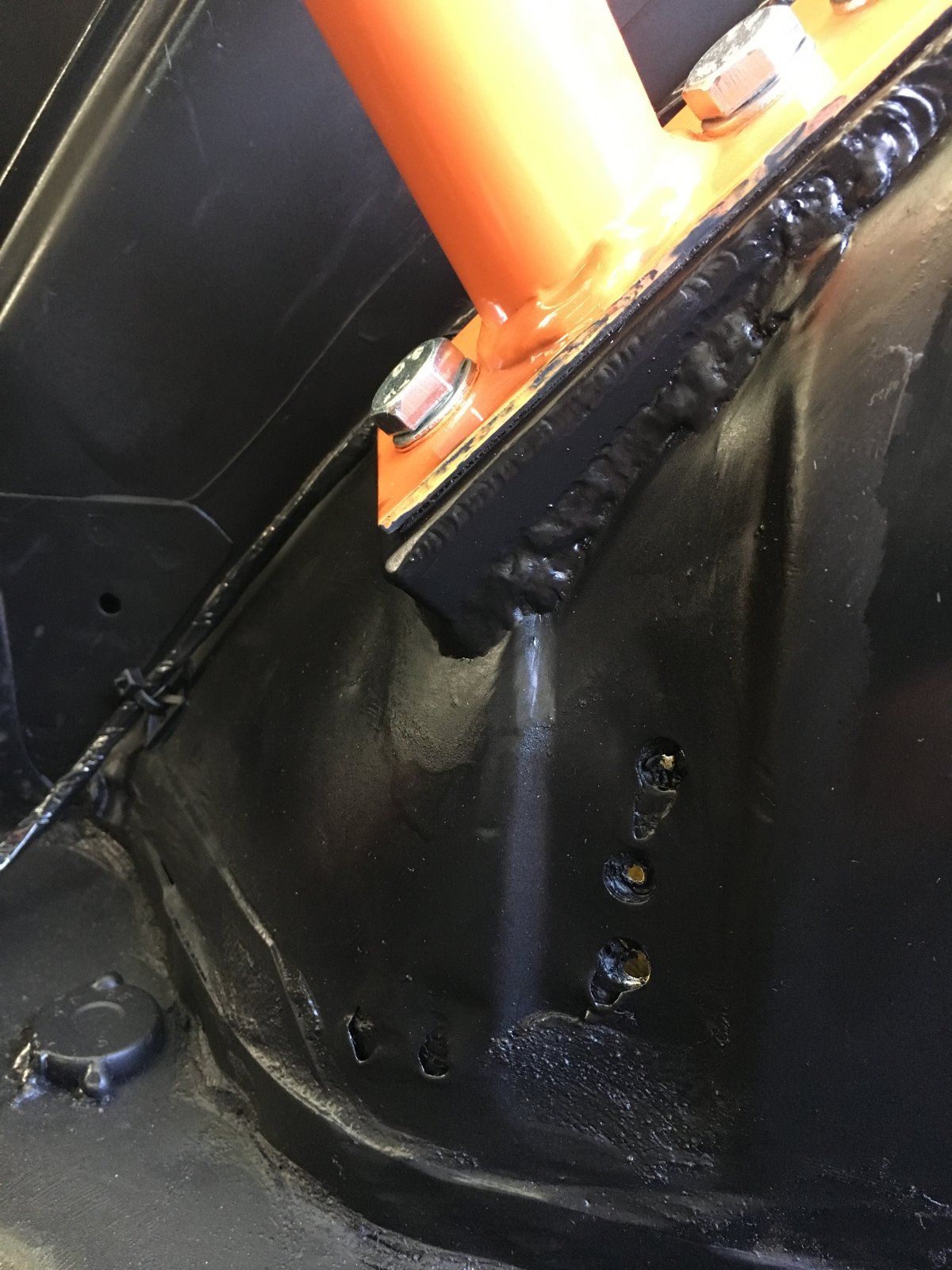

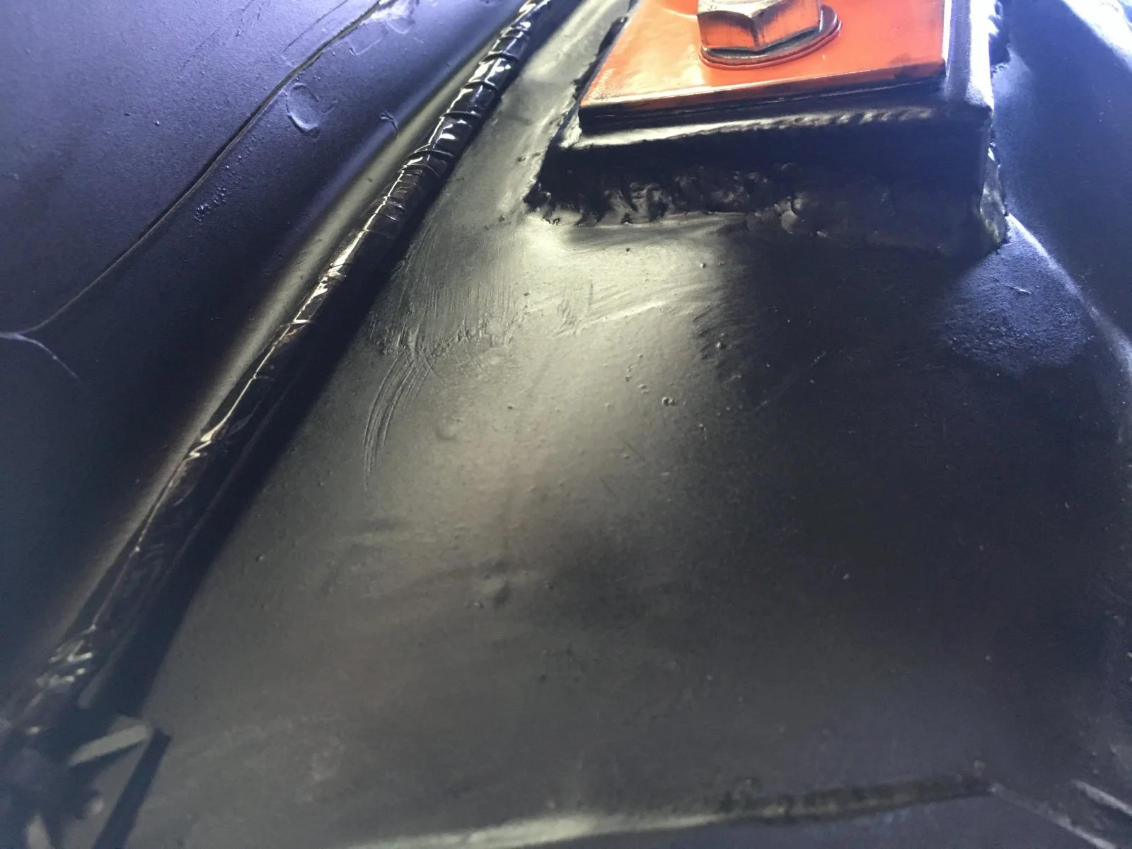

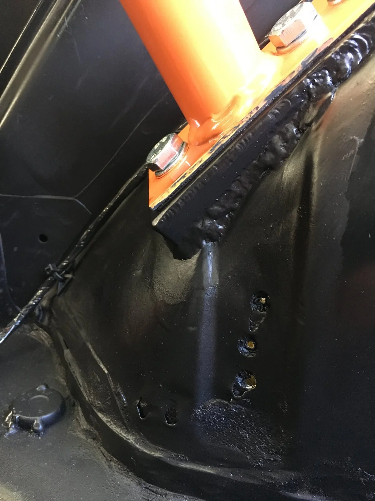

Clio went into AutoTest in Norwich yesterday to do a bit of welding on the cage feet plate on the rear drivers side as didn't look right to me!:nomouth:

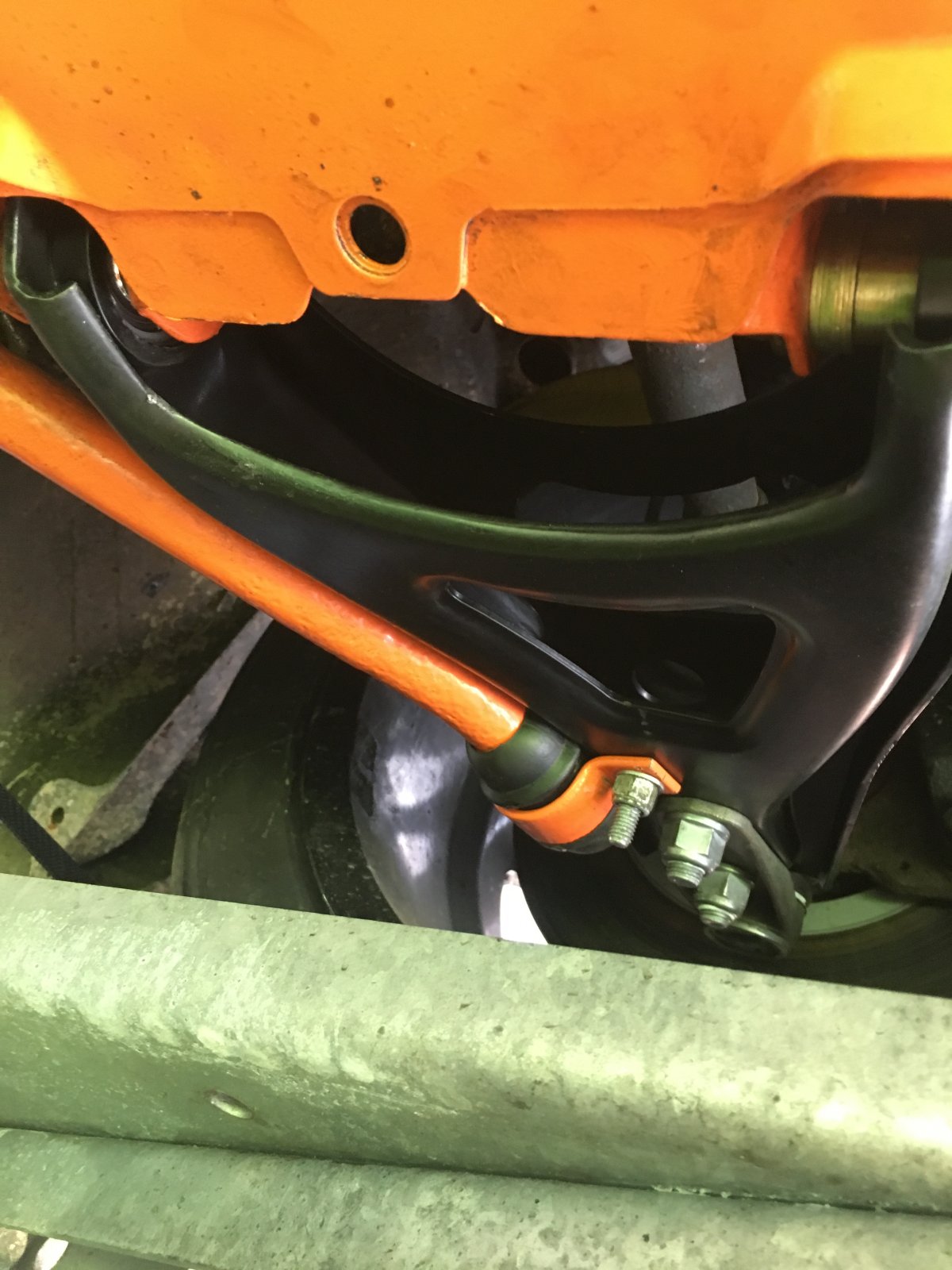

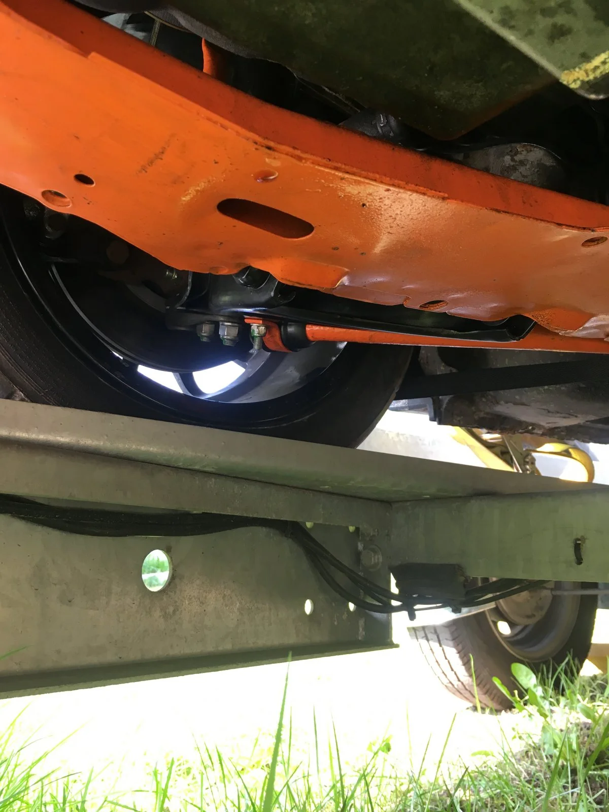

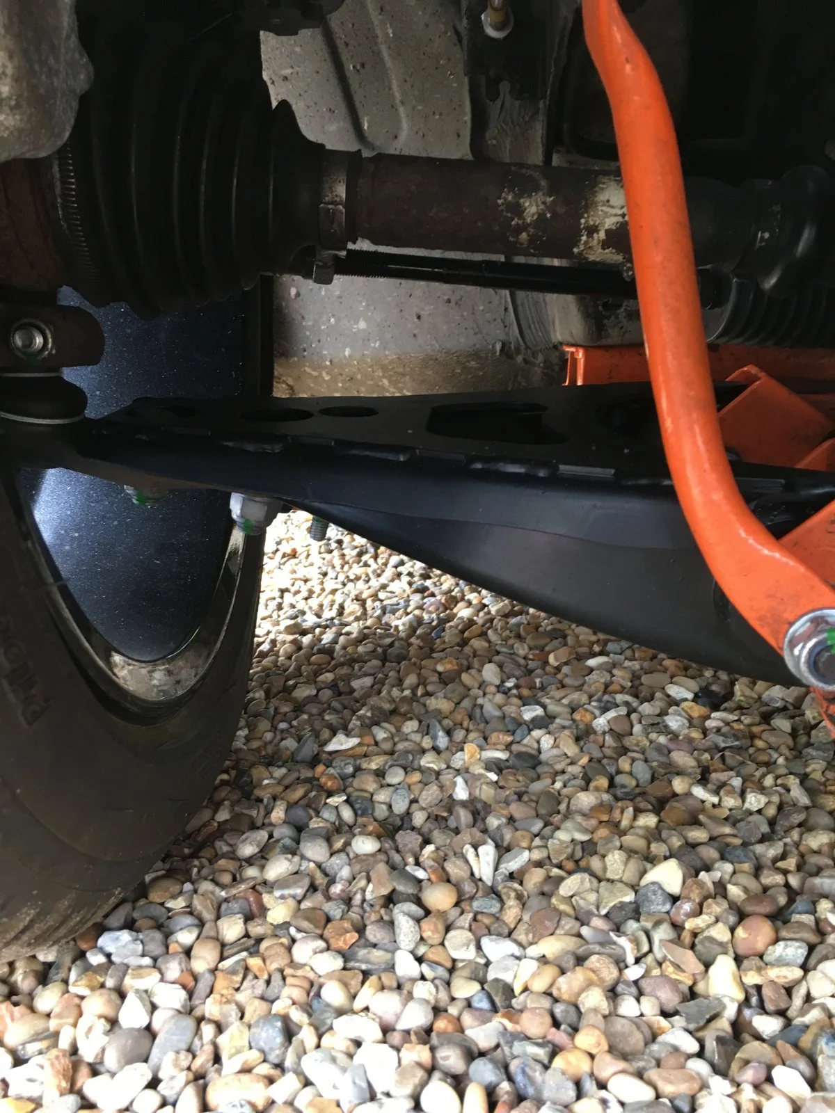

I also had the PMS adjustable wishbones/ PMS stubaxles/ PMS shifter aswell:tongueout:
Will get some photos up shortly:cool:
  Clio 172
So I had a look at the welding completed and looks spot on! The welder had managed to cut some metal to the shape of the gaps and welded into plae, can't fault it at all. How it should have been when it was built originally.

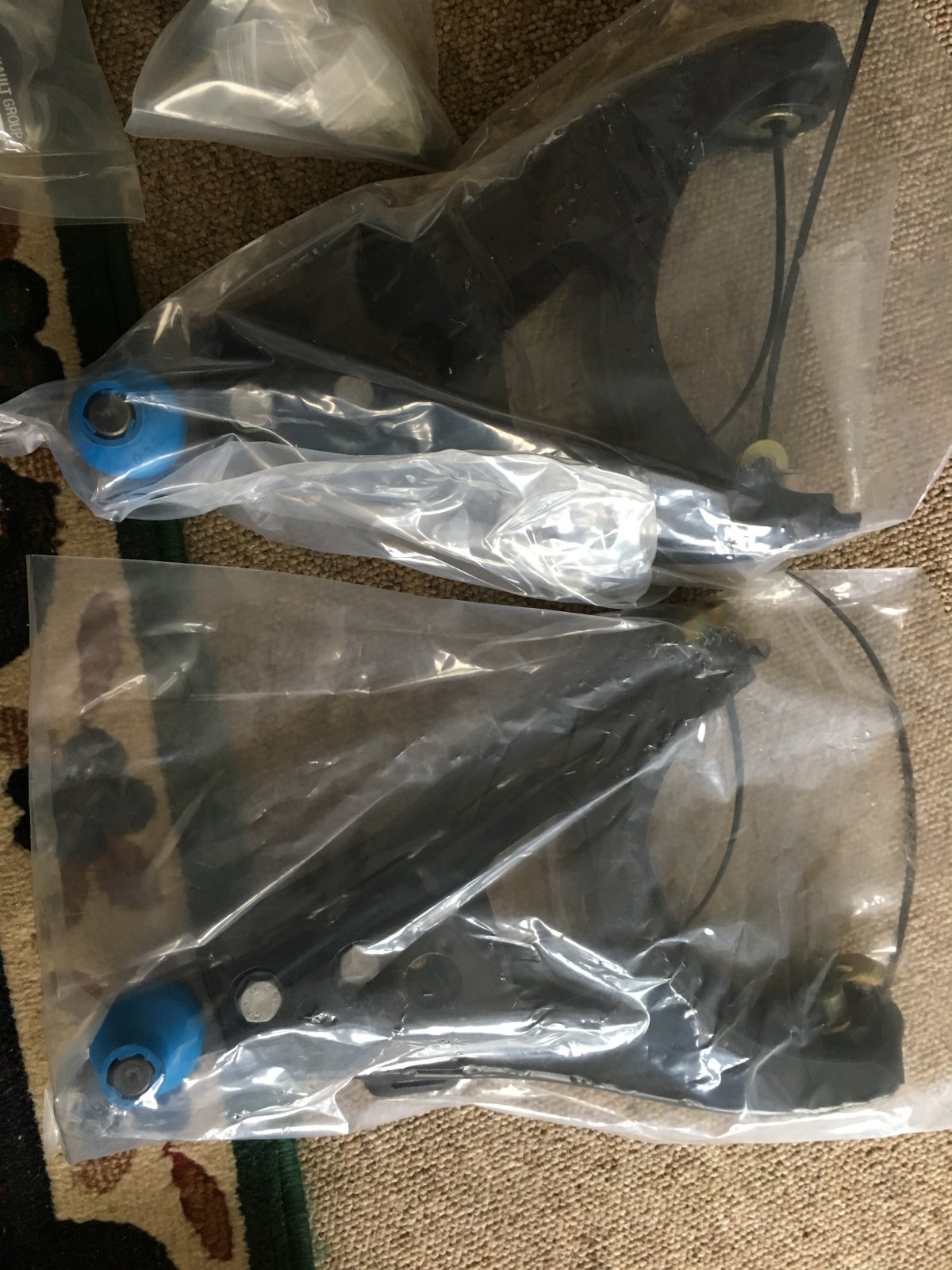

Also some picture of the wishbones and shifter
Don't have any photos of the stubs Axles atm though.
It's all coming together quite nicely now:smile:

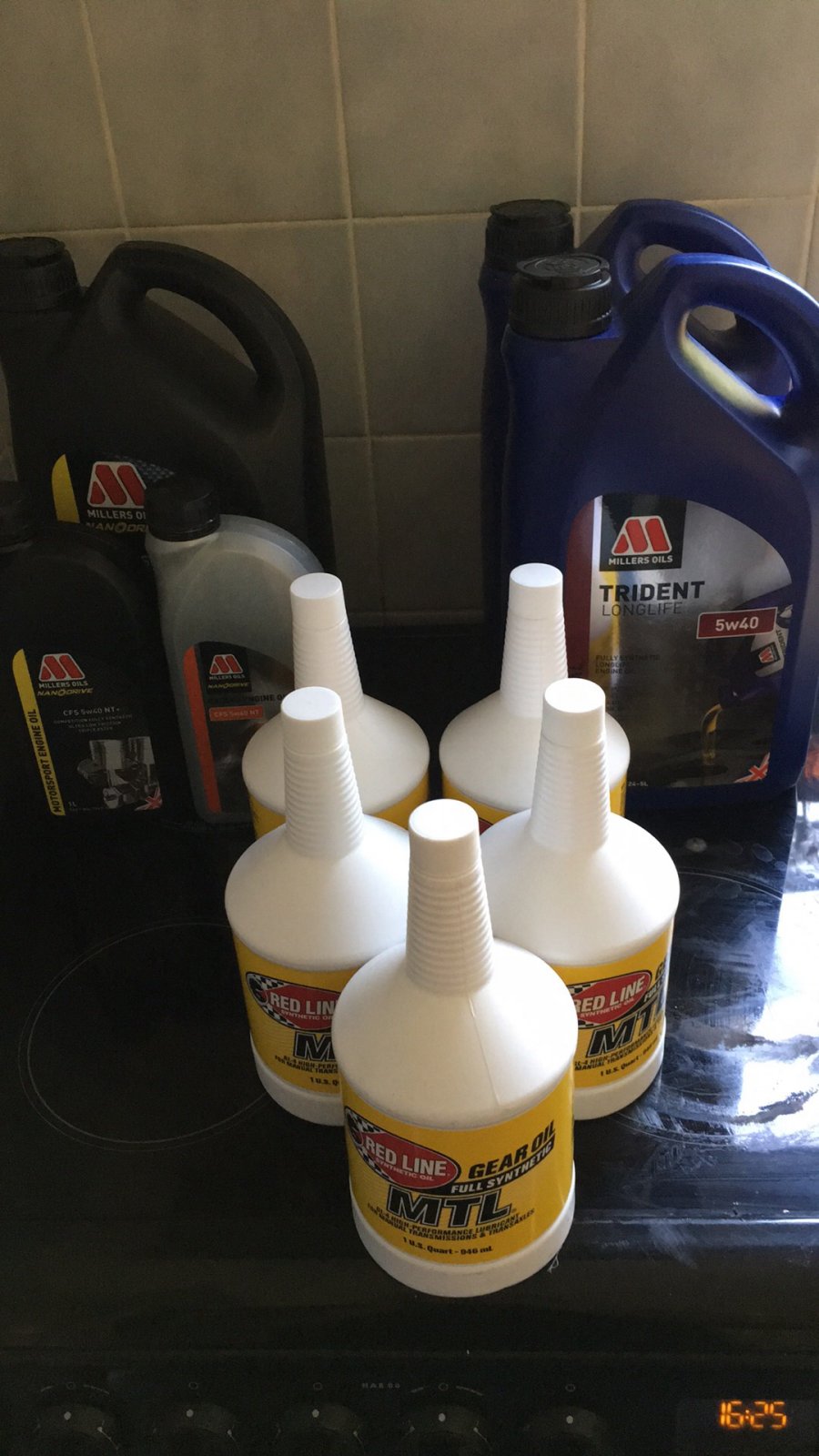

Have also ordered oils for next change, so again gone for the Millers NanoDrive 5w-40 & RedLine MTL 75-80.
Also got the Volvo new engine oil so gone for the Millers Trident 5w-40
  Clio 172
Millers NanoDrive for the Clio engine, Millers Trident for the Volvo and RedLine MTL for the Clio Gearbox

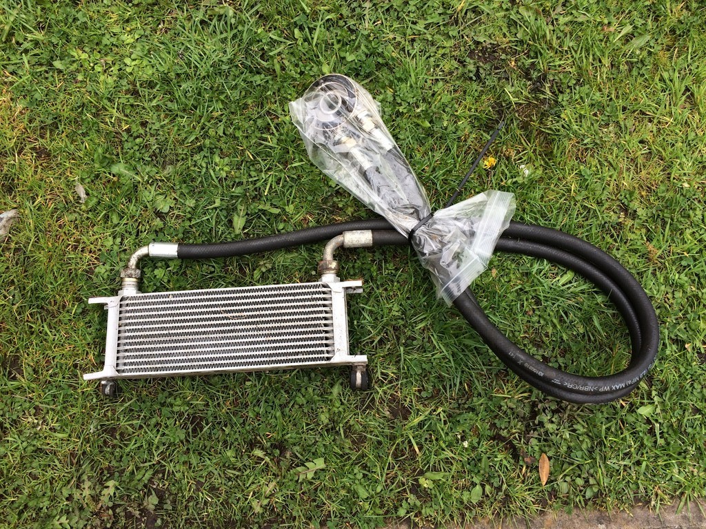

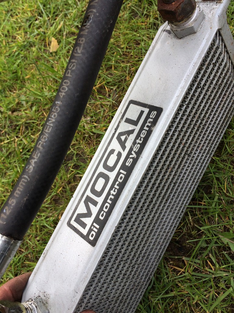

Got a 13 Row Mocal oil cooler coming which have brought from Forum Member f0xy

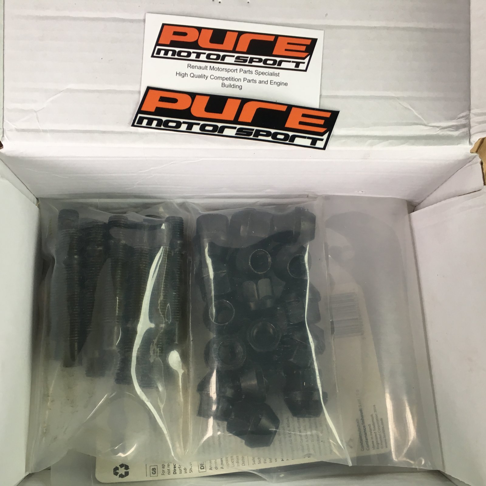

Pure Motorsport stud kit to be replaced the crap studs I had fitted to the car which somehow cross-threaded 3 studs on one wheel and 2 on another wheel:eek:penmouth:

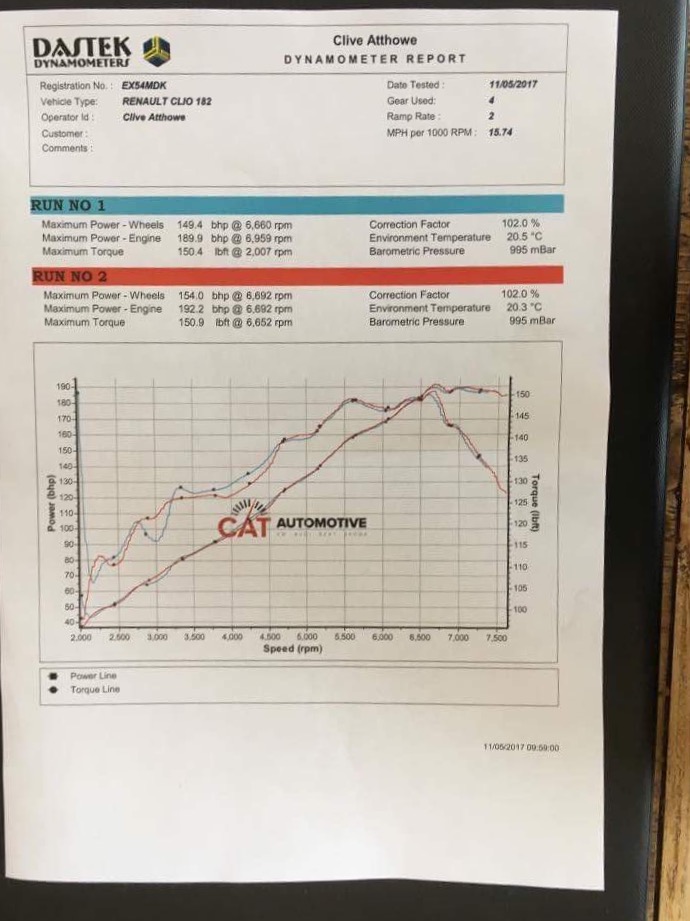

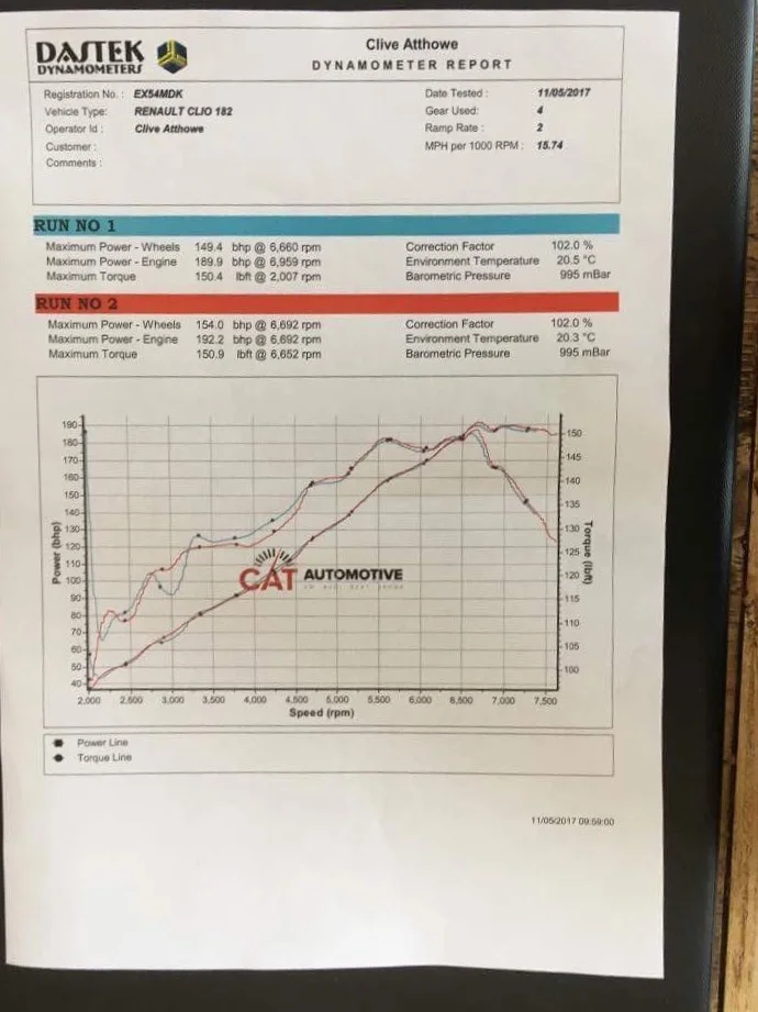

This is the dyno printout for my dads Clio 182 at Clive Atthowes in Norwich

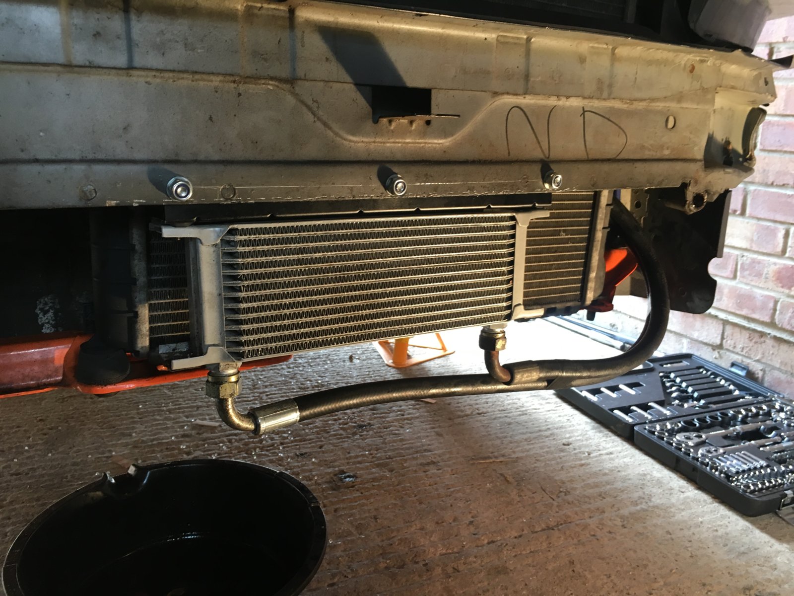

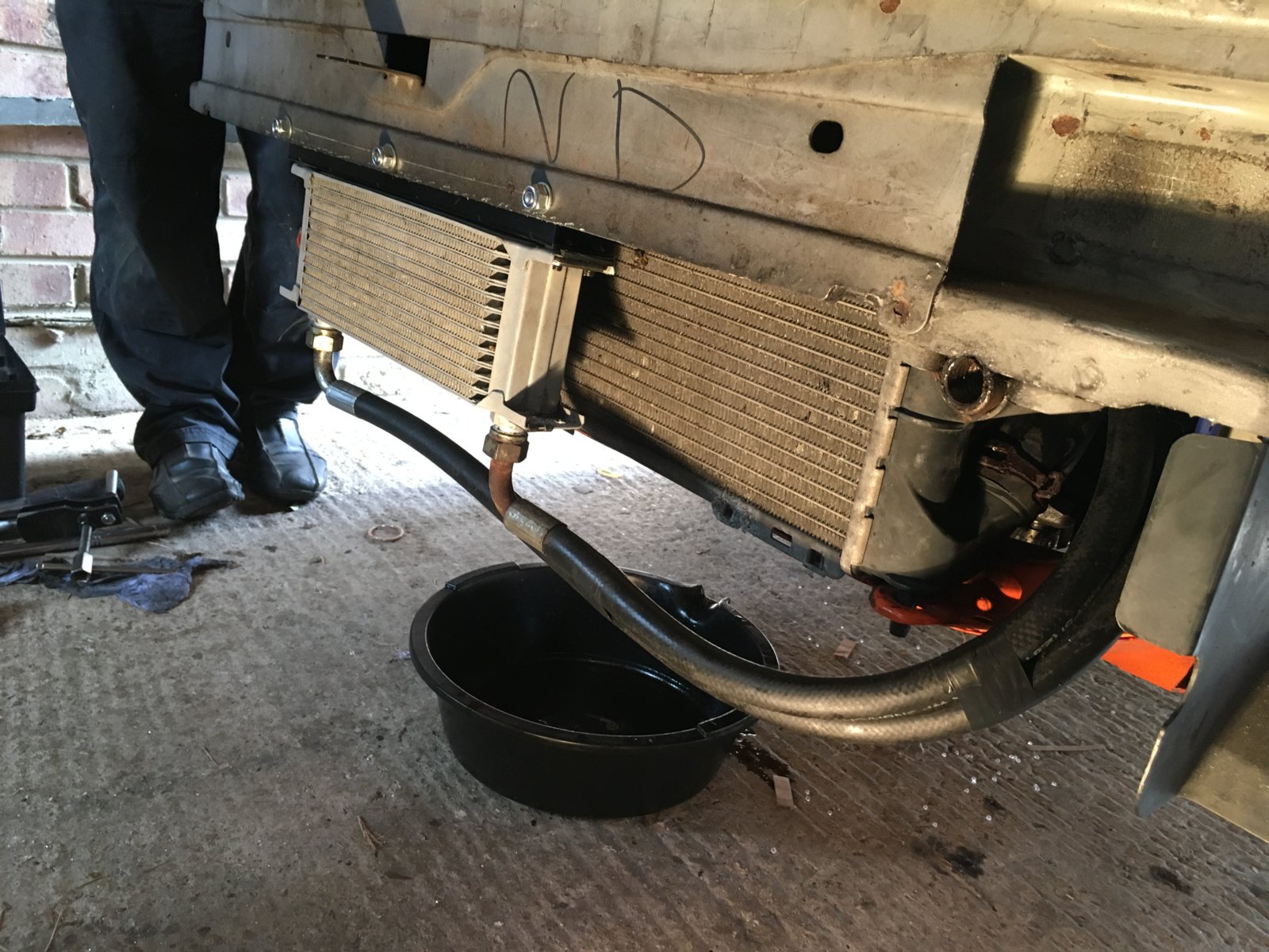

Don't think I posted any pictures of the oil cooler which had now been fitted with thermostatic plate
