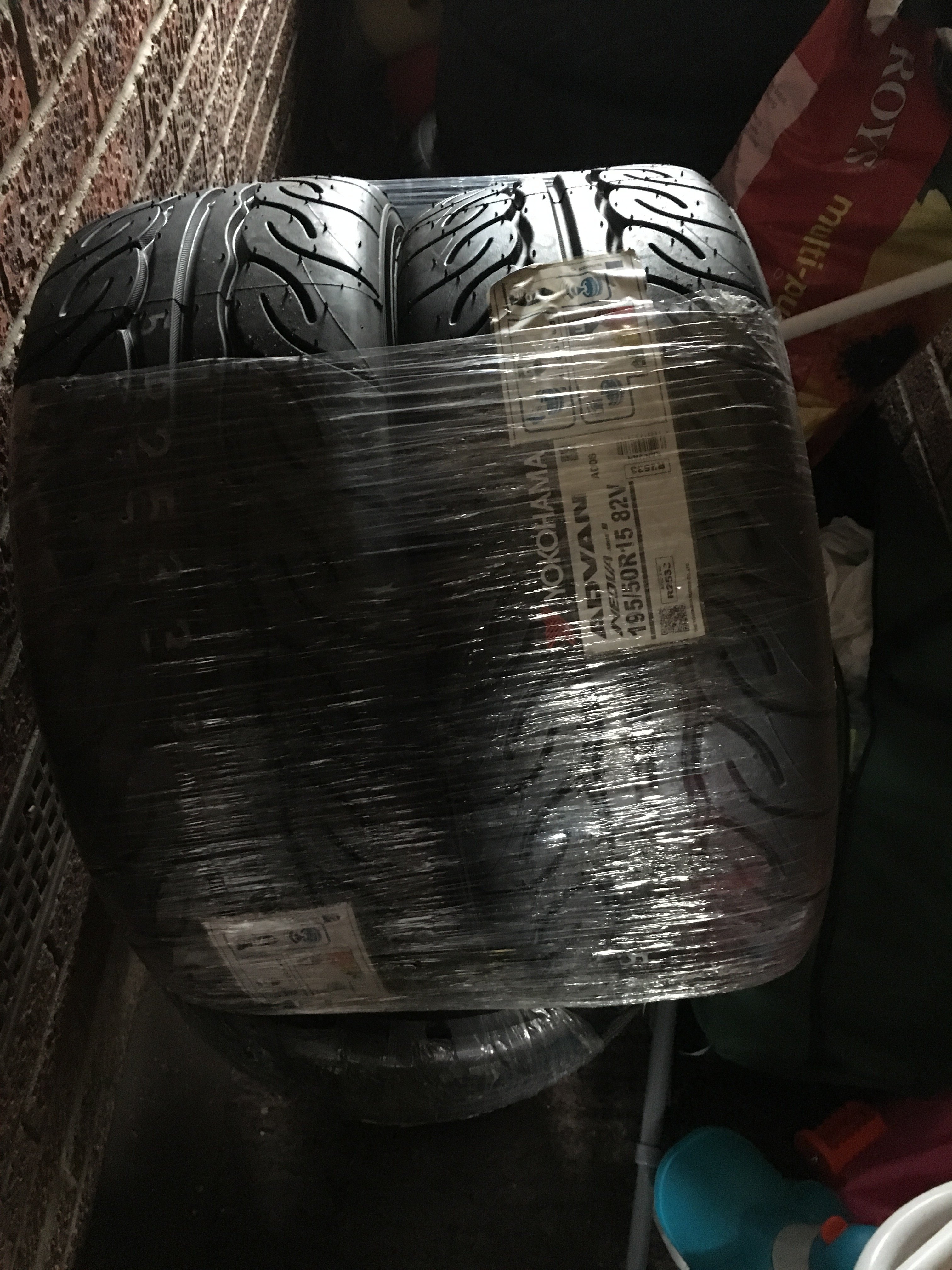

New ADO8R to be fitted, will be used as my "wet" tyres.

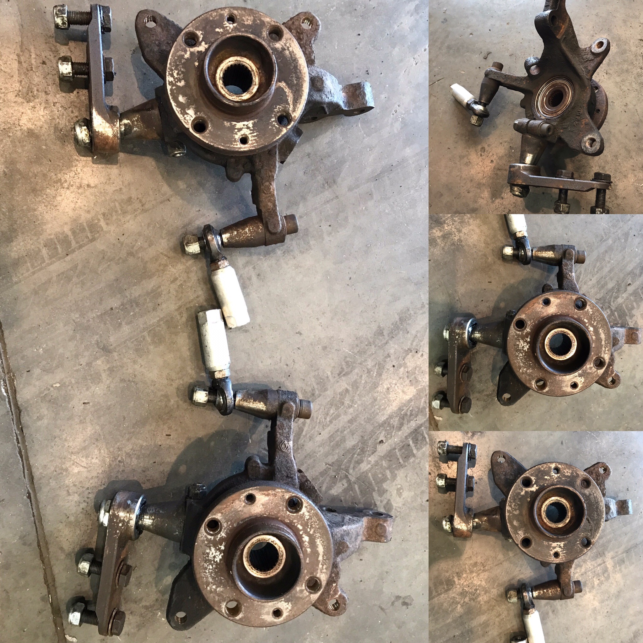

PMS Manual Quick Race and PMS PAS Delete Kit has now been fitted and garage dropped car off at home today for me for free as I came offshore yesterday.

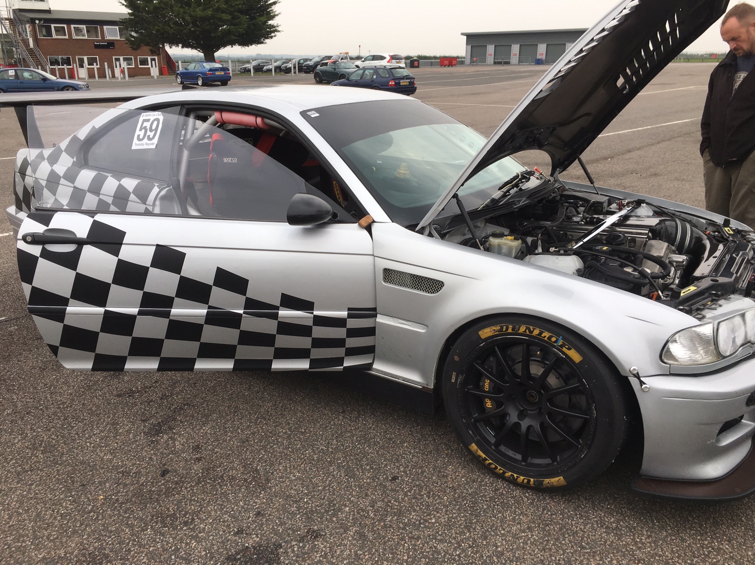

Was up Snetterton today in the afternoon as my friend was there in the below E46 M3.
Let me have a drive as said I could for a while.
Absolute track weapon, so quick!
