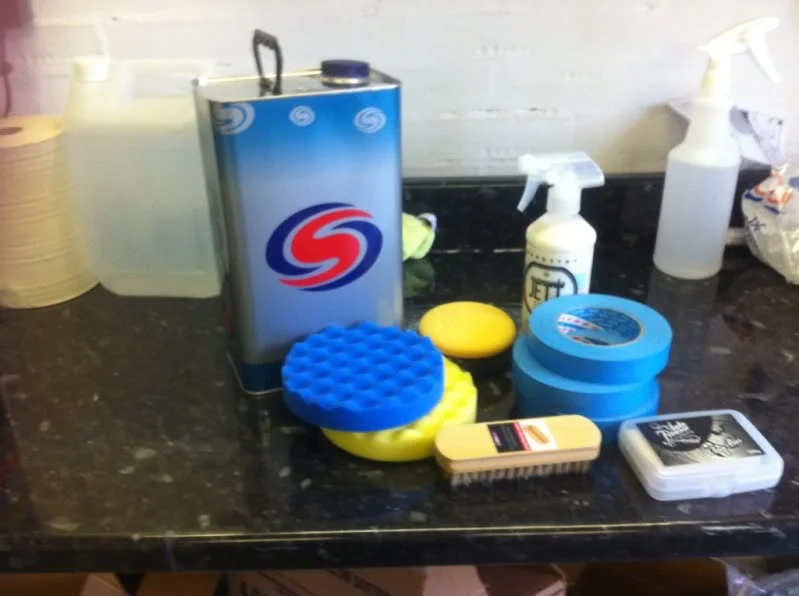

Products used
Dodo BTBM
PH neutral snow foam
Bilberry wheel cleaner
Tardis
Iron-X spray
Autofinesse soft clay
Dodo born slippy lube
Britemax #6 QD
I4d fluffy drying towels
Costco MFs for odd jobs
Supernatural buffing MF
Good quality short pile MF (unknown brand)
IPA 2:1 de-ionised water
4l de-ionised water douse
Silverline rotary and Festool backing plate
Menzerna Final Finish PO85
3M Yellow polishing pad
Werkstatt Prime Strong
Swissvax applicator
Werkstatt Jett Trigger – Carnauba
Aerospace 303
Autosol / Wire wool / WD40

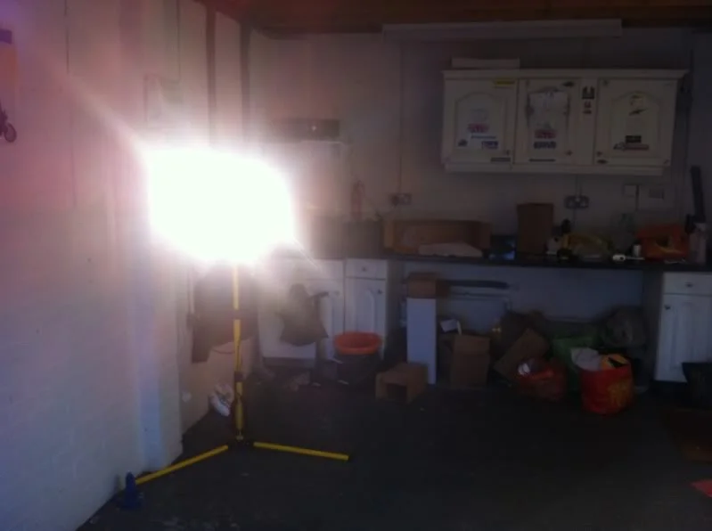

And 2x400W lighting rig

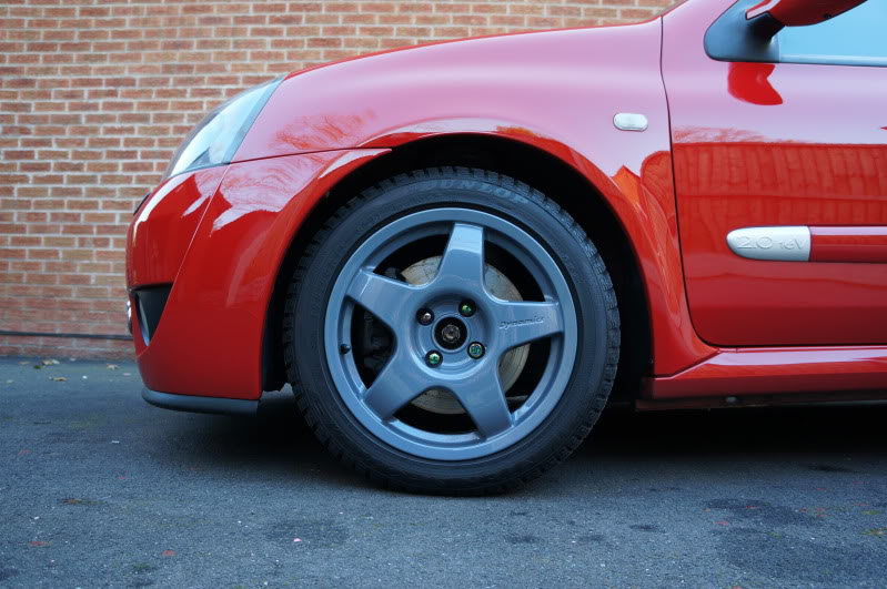

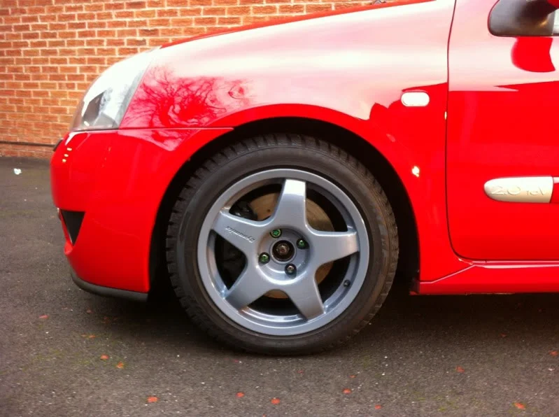

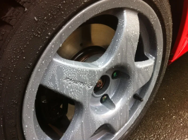

Wheels cleaned with a weak concentration of Bilberry, EZ brush, small brush for bolt holes, and a sponge for the flat external faces.
Wheel protection still active! (These are my winter wheels).

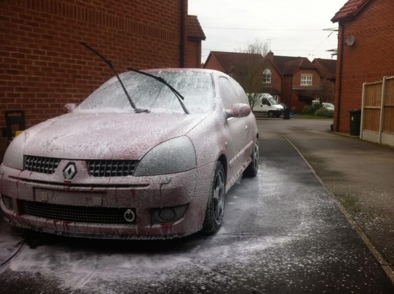

Foamed and left to dwell. Shuts, trim, and crevasses agitated with a small brush.

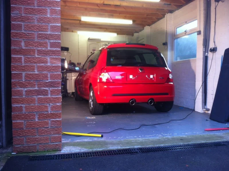

Anyway, the car was then re-washed, doused with 4l of de-ionised water and dried. I then rolled it indoors just as the rain came.
Then came inspection and masking. The pictures don’t show up anything here, but inspection via new lighting rig and brinkman handheld lamp showed only fairly light marks.
The rear end proved to be the worst area for iron, general dirt and therefore unsurprisingly, swirls.
I’m putting this down the exhaust (decat) and the hatchback shape of the car tend to create a low pressure vortex of air when driving, throwing exhaust moisture and dirt onto the bootlid/bumper.
Some areas would need something a little more aggressive, but for today I just went for PO85 on a 3M yellow pad and smaller areas with an Orane Menzerna spot pad.
This combination worked excellently, some defects remain but on the whole the car is at about 80-85% correction with an extremely glossy finish. What I lacked in ultimate correction I made up for in burnishing.

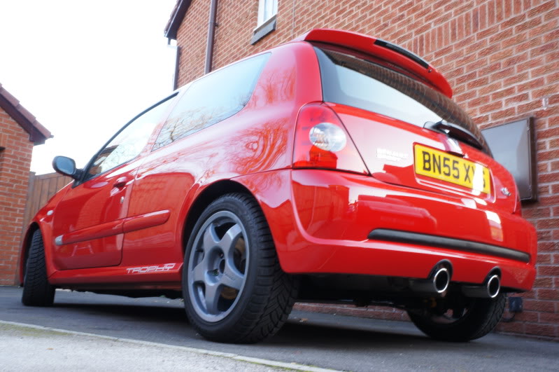

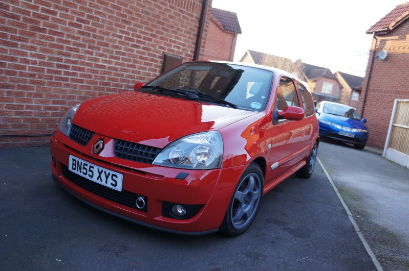

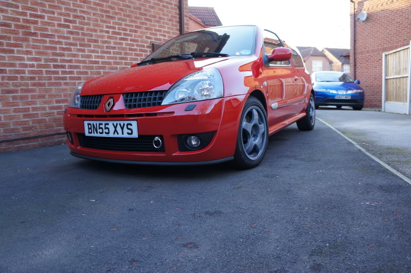

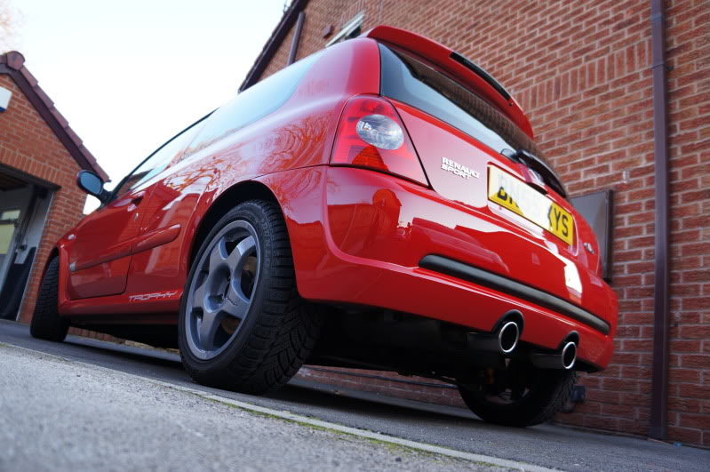

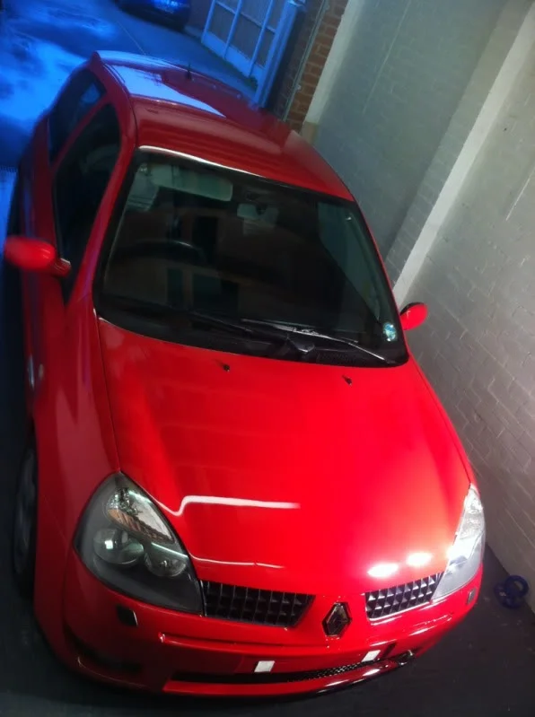

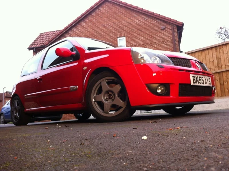

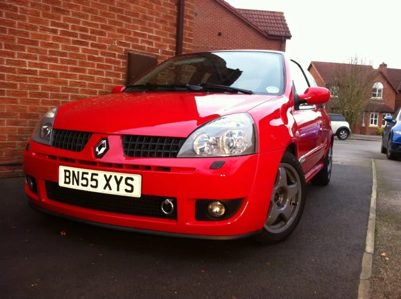

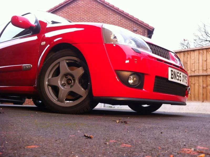

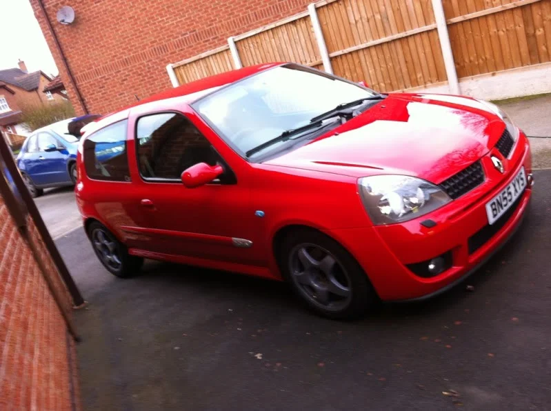

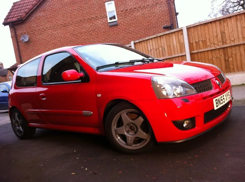

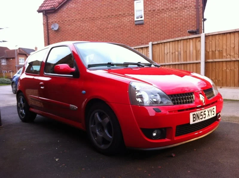

Polishing finished
IPA wipe-down followed
Prime strong applied by hand (and roof by machine, 3M blue pad)
Jett Trigger Carnauba applied with two MF method.
This pics are after 1 layer of Jett. Subsequent layers have added to depth and gloss dramatically. I will update the thread with more pictures if I manage to source the use of a proper camera.
