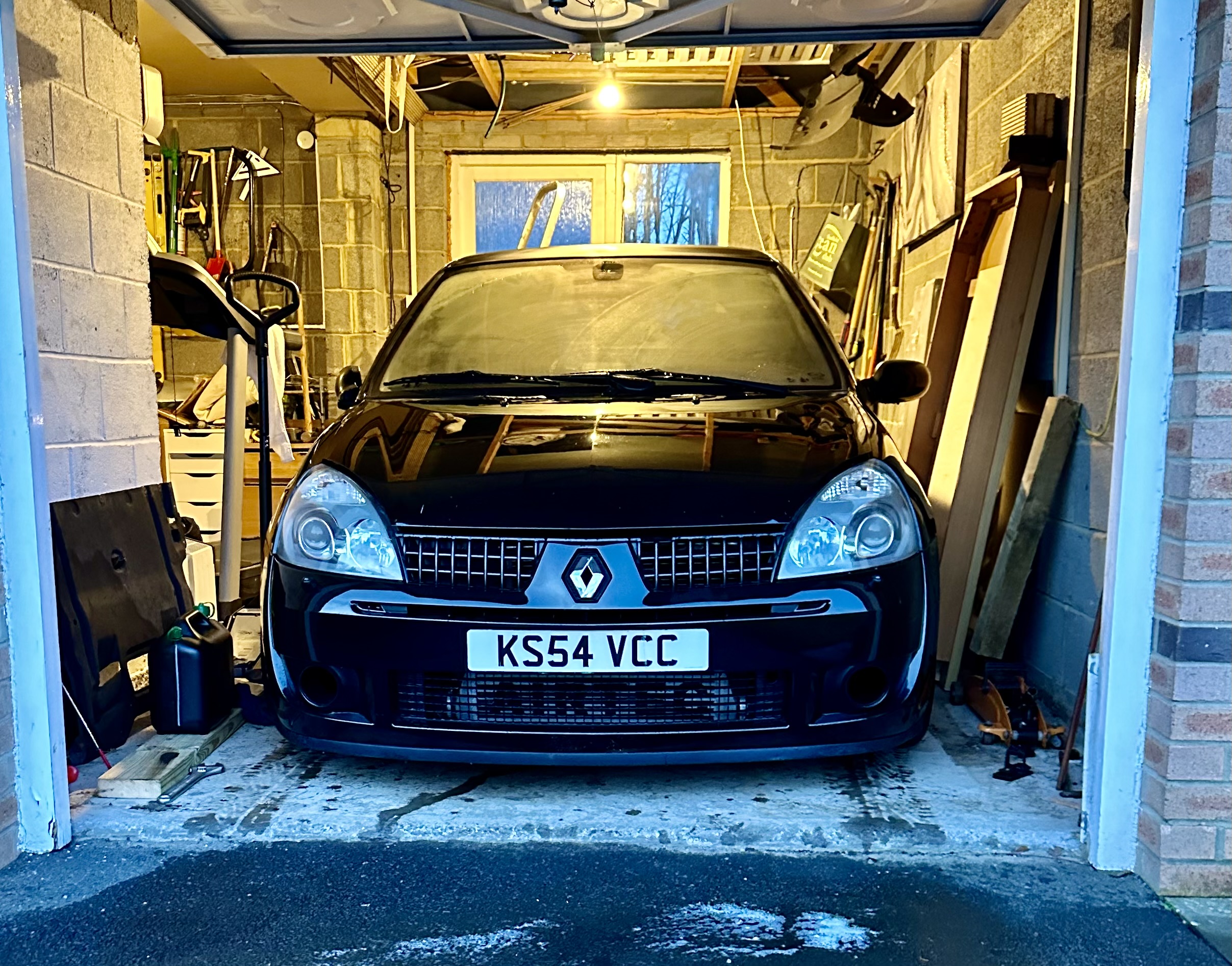

The Clio popped out for a wash today. It was about a foot thick in dust and shite from the garage. I still love how these look 😍.

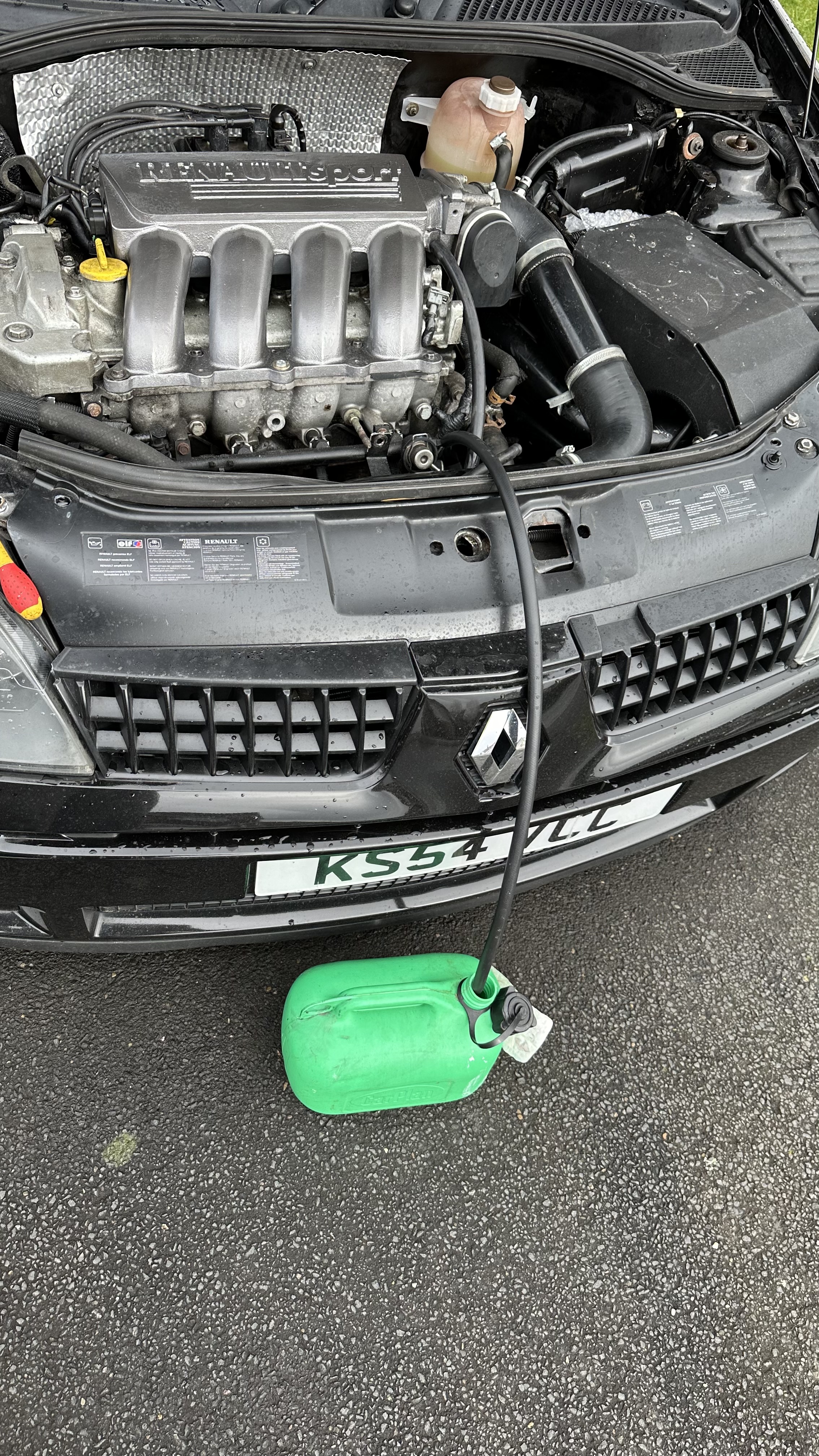

At some point in time the battery charger had tripped in the garage and the battery has died. It jumped the other week when I moved it and it’s been left on charge since but wouldn’t start today so looks like it’s killed it. I’d have to look back over the thread but I’m sure it’s only 18 months old so that’ll be going back to Halfords. I left it running for about 40 mins when I washed it and it wouldn’t start again by itself. On the upside, there are no oil/coolant leaks anywhere so it seems happy enough. It’s now tucked back up in bed
Clio hasn’t had a legit test since 2017. What could possibly go wrong….. 🫣
It needed a new battery to get it there. As we all know, dead batteries = spun bearings so thought it best to change. Cheap as chips at £37 on trade at Halfords.

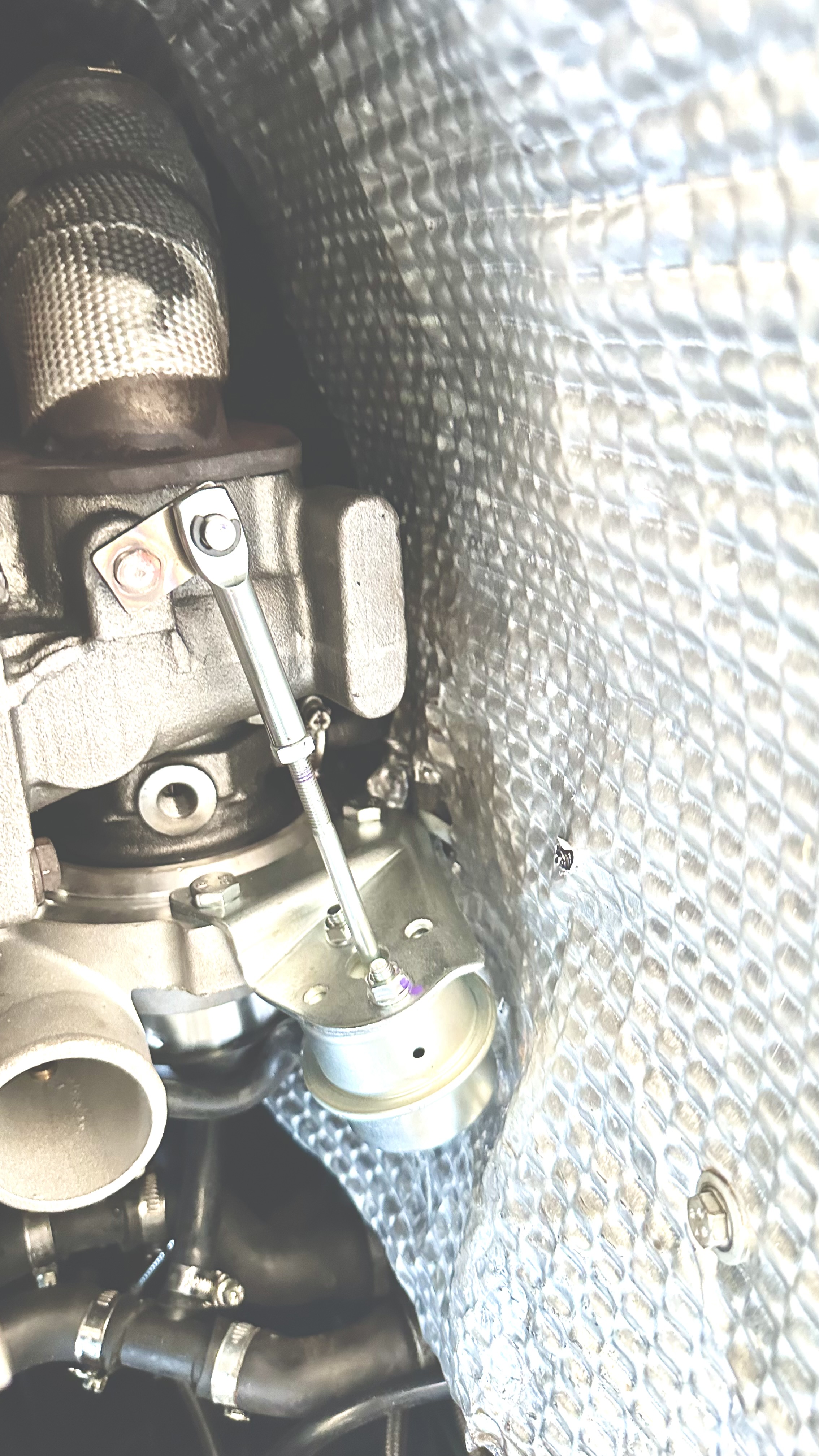

Irritating the wastegate is sticking. I popped the pin off the actuator rod and it moves but it sticks again in the middle unless it gets a wiggle. The actuator pushes down onto it slightly which seems to help it stick. I’ll try to put a little shim under the wastegate arm to push it up and stop it sticking but not sure it’ll work. Are there any other suggestions other than removing the turbo to attack it?

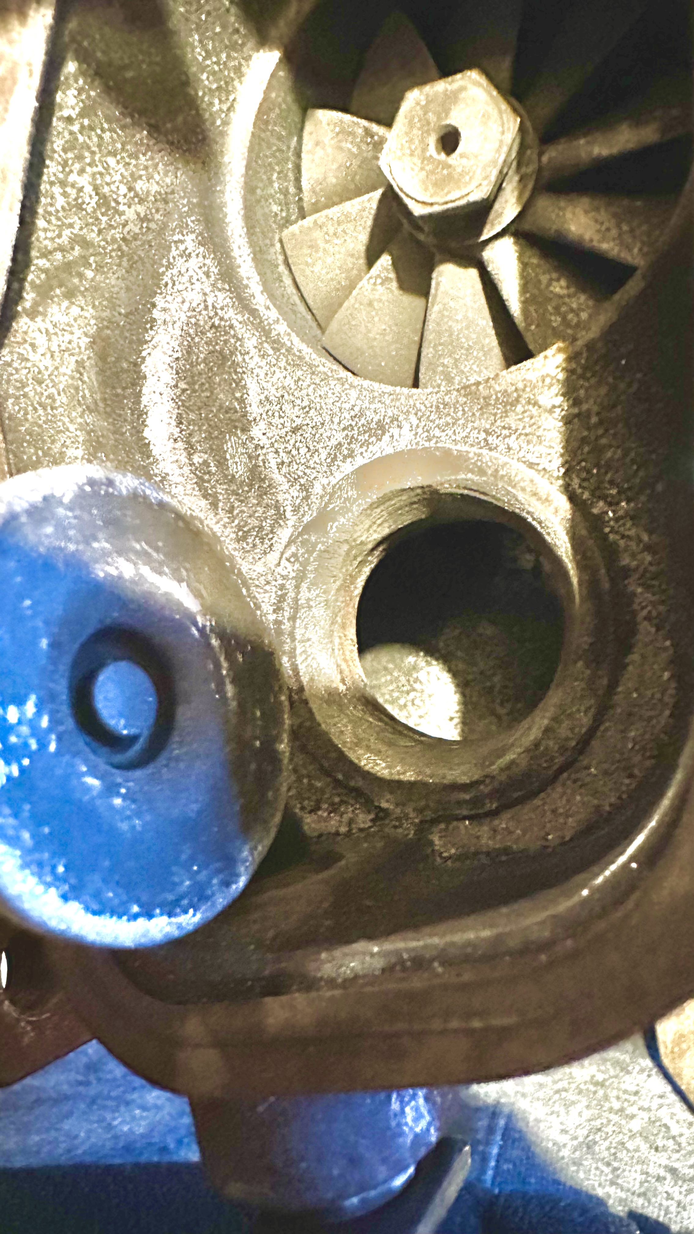

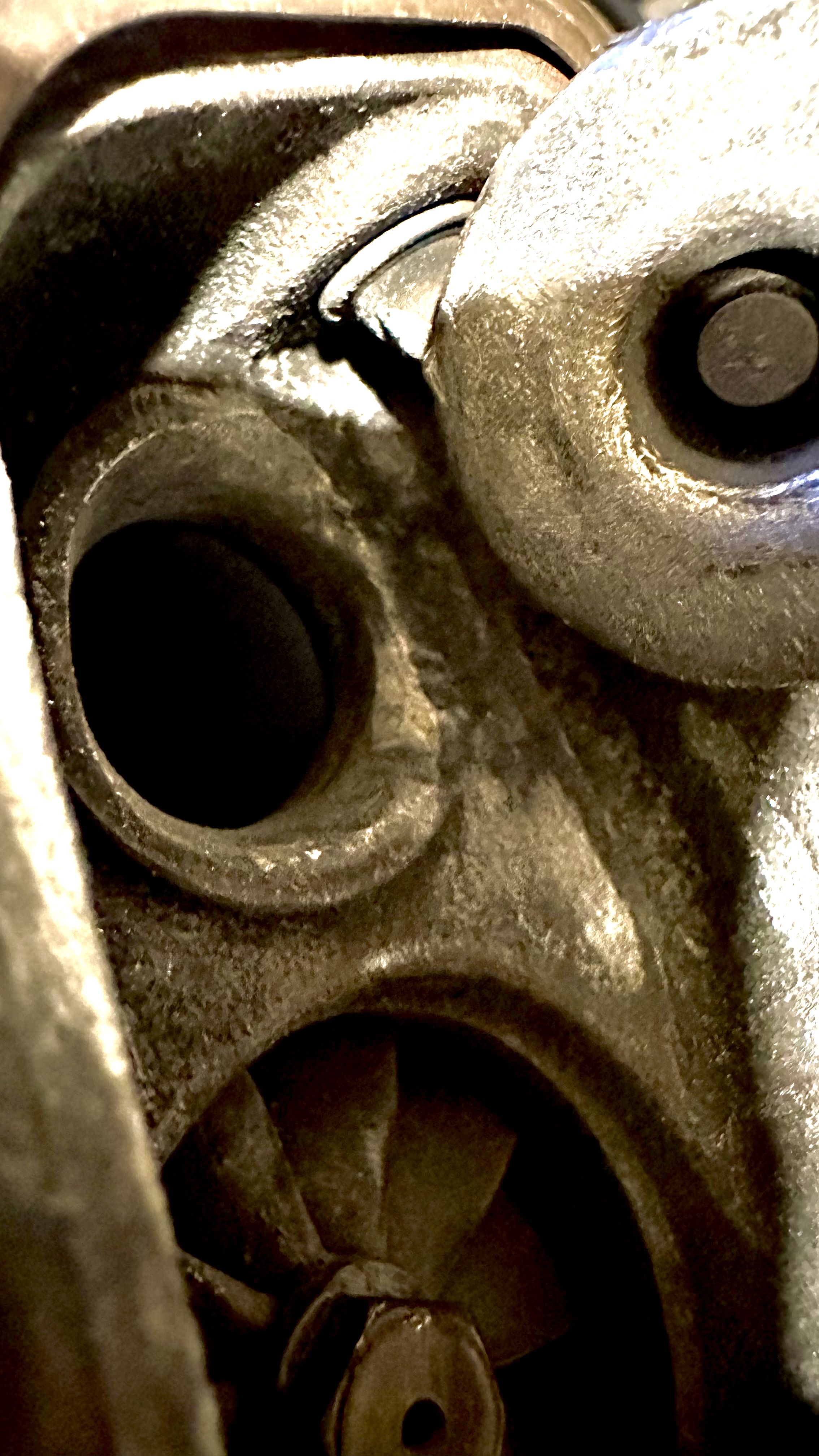

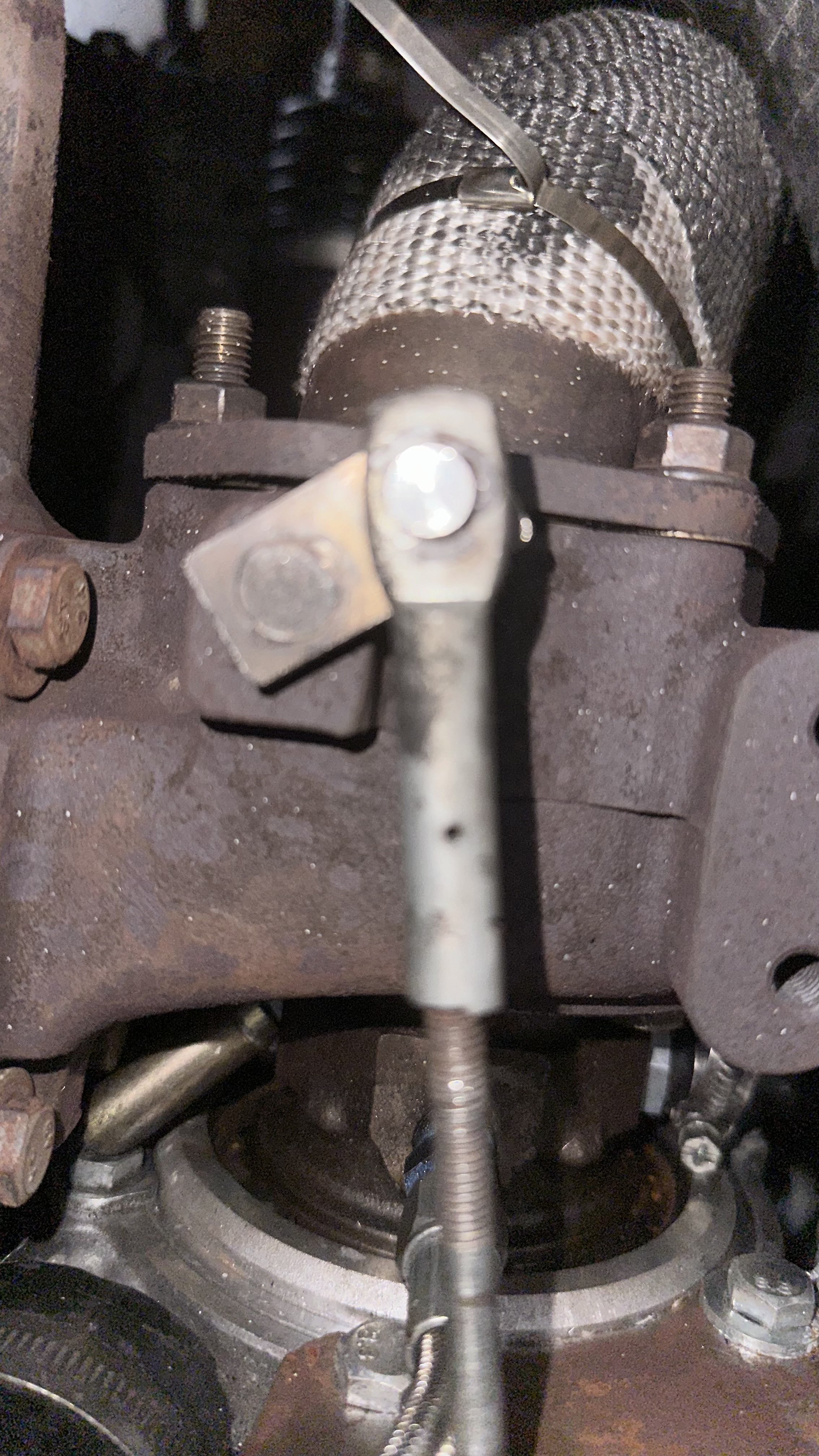

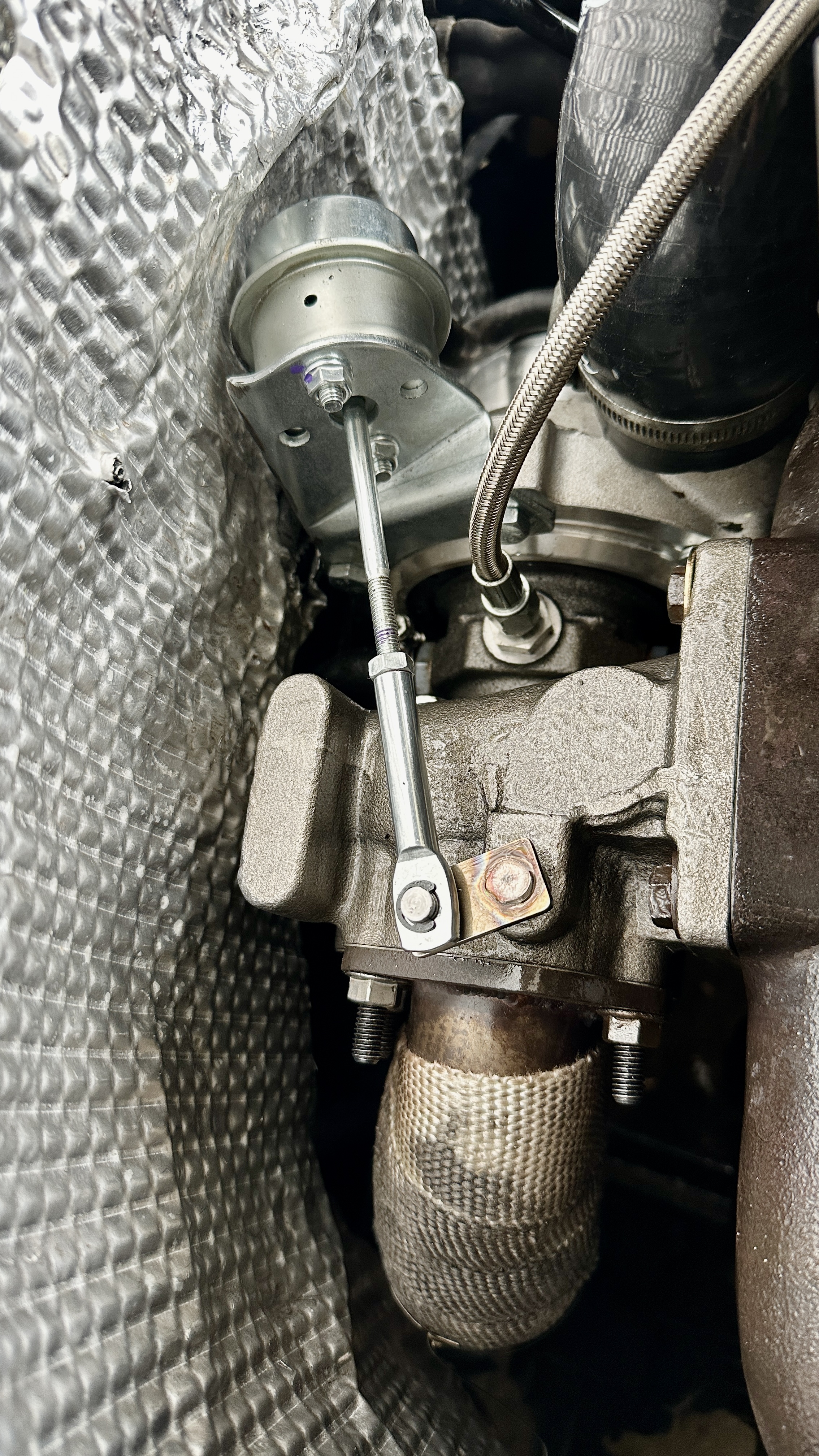

I had an argument with the wastegate today. It’s stuck as in the picture below at part open.
I blasted it with a bit of brake cleaner and then applied a bit of spray grease. It moves nice and freely if you gently pull it up when moving but as soon as that pull is lifted it sticks. I don’t think there’s enough of a gap under it to wedge in any form of a shim. It feels like it’s sticking on something inside the turbo which is odd because there’s nothing there! Any suggestions on anything else I can try before I have to take the turbo off because I really can’t be arsed with that job 🤦‍♂️?
Edit: this is an earlier pic of the exhaust side with the wastegate open. I can’t really see how it could be catching, there’s nothing there!
Is it binding on the downpipe flange? Looks to be witness marks on the edge of the penny.
This is very true. However, I can’t guarantee it wasn’t me that did them by accident when enlarging the wastegate port.
It could be the flange or thinking about it, it could be the turbo gasket too as there’s some level of play in the holes.
Whatever it is, it’s changed at some point between the couple test drives and going to the MOT centre. It was fine for maybe 40 miles and then started to stick.
I might just get it into stuck position and hit it with a hammer a few times to see if that moves whatever it’s sticking on out the way.
If that doesn’t work I’ll buy a new turbo. For the sake of £150 it’s not worth risking removing it then refitting it just to realise it’s still broken just to have to do it all again. Especially given the downpipe bolts have to come out too. It’s just too s**t a job to do voluntarily 🤣
Boost issues are sorted. Gave the actuator arm a bit of graphite lube and a few knocks with a little toffee hammer. Took a few taps but whatever it was sticking on it isn’t any more 😂.

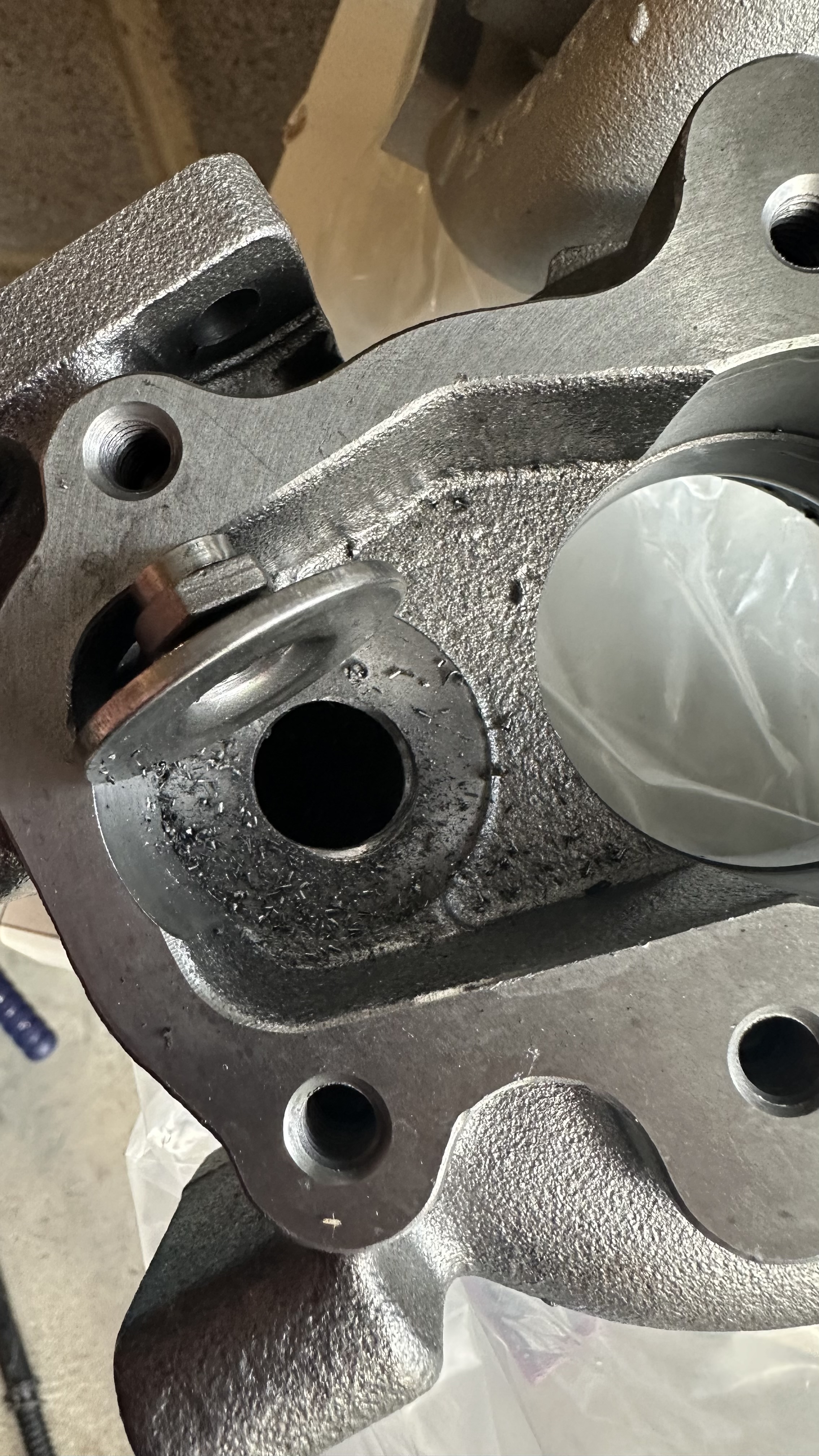

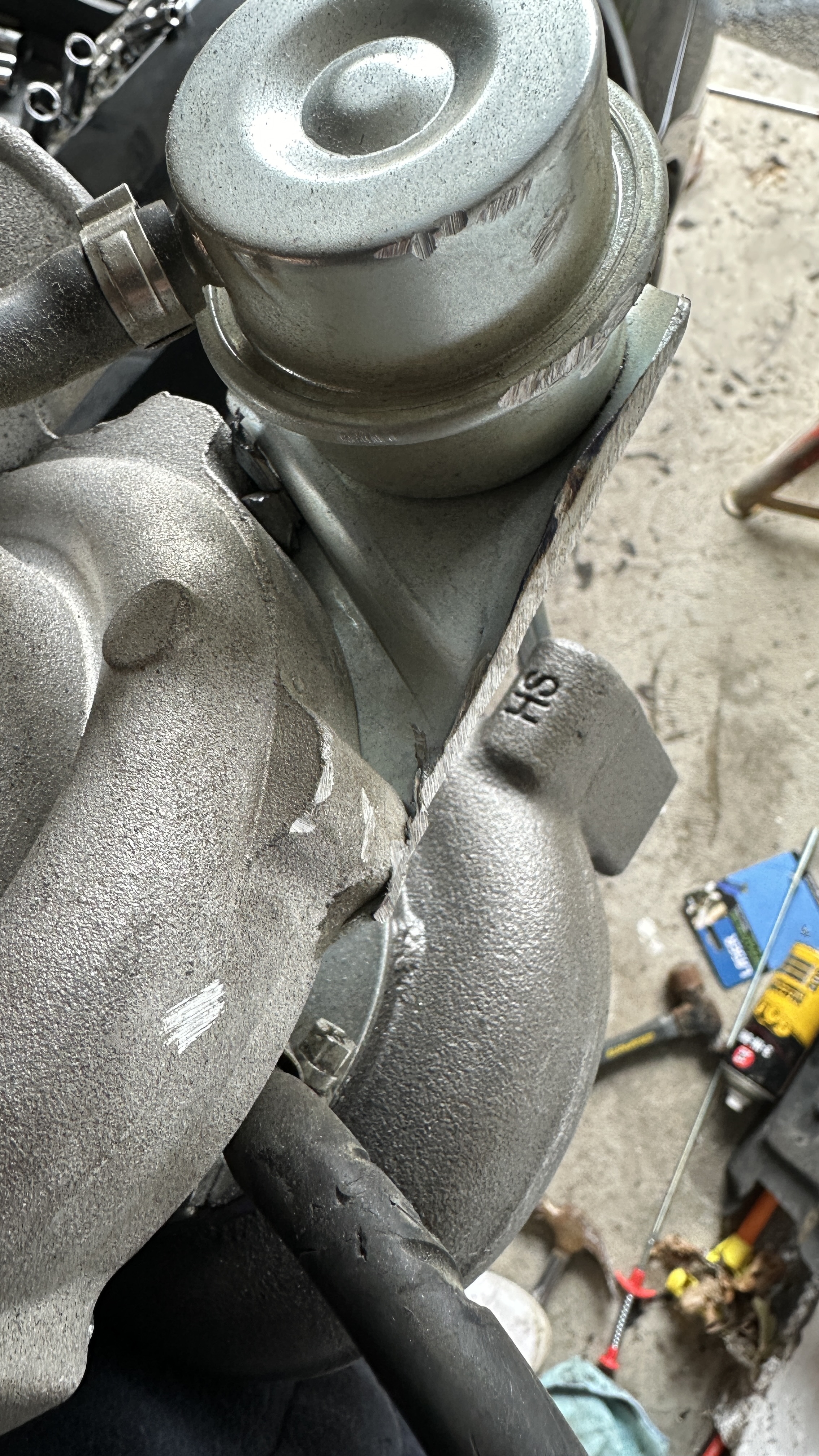

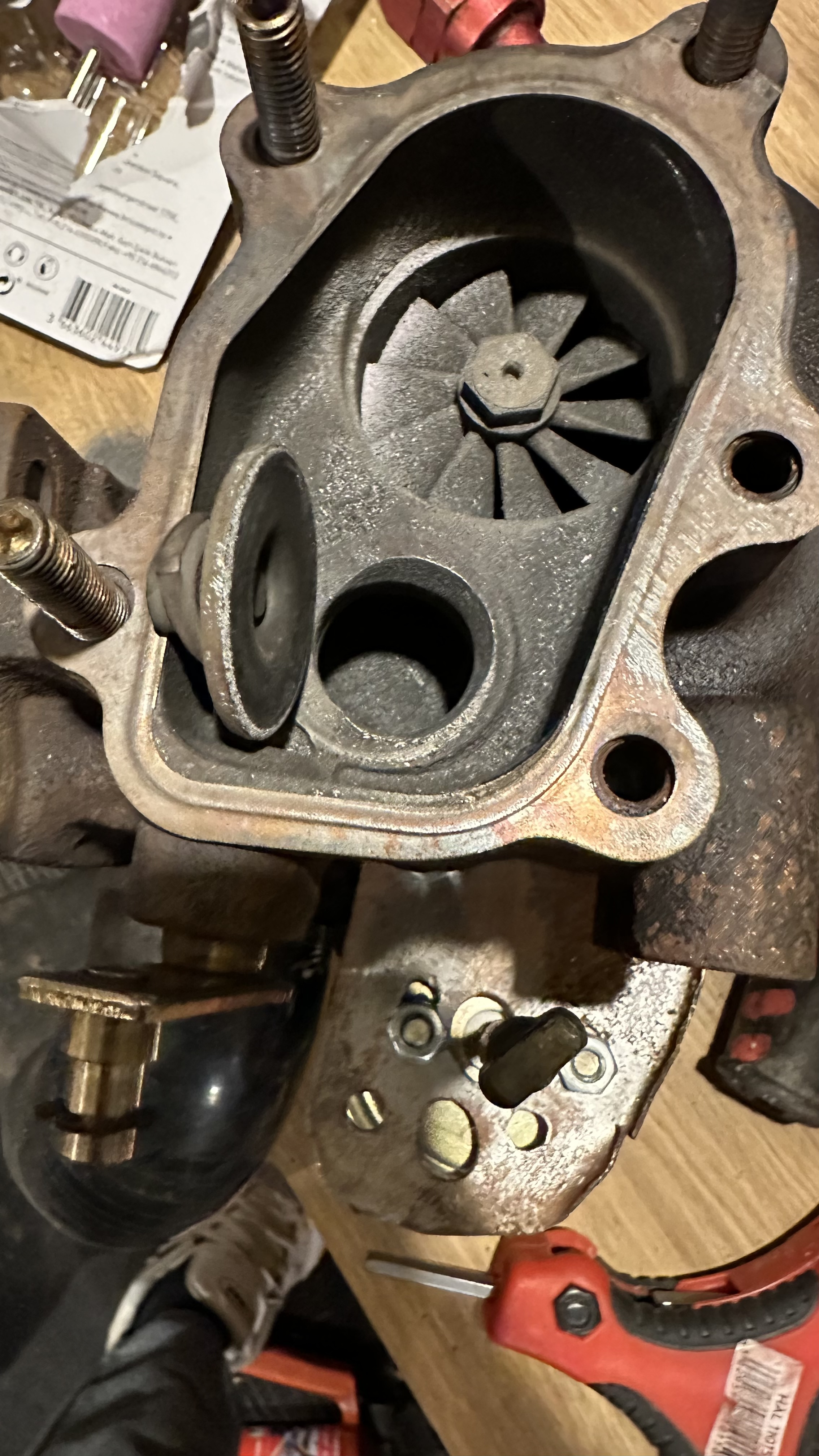

I took the turbo off tonight to see if I could work out why the wastegate keeps jamming. I’d not refitted all the nuts for the downpipe when putting it back together been a genius last time and left the impossible to access bottom bolt off.
As a result, turbo was off and out in about 20 mins with no need to split the downpipe from the rest of the system and avoid having to do those frigging nightmare bolts on the joint 😁

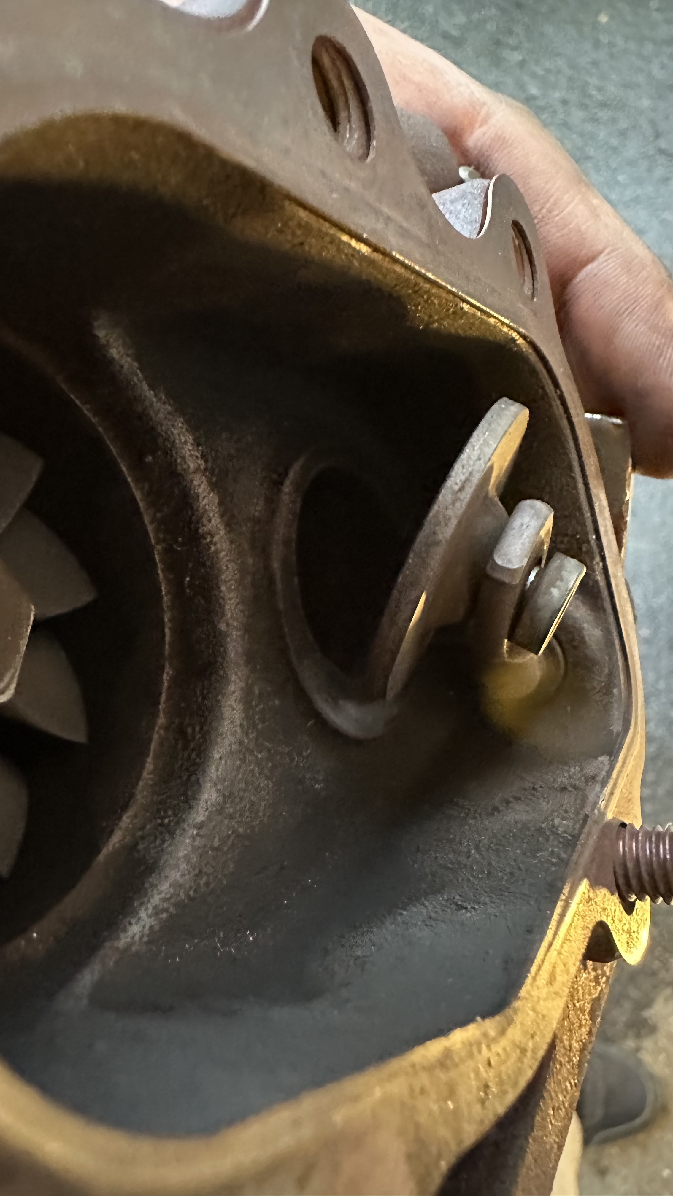

It appears the problem is an inadvertent consequence of widening the wastegate. Removing some of the material on the side closest to the arm has removed the smooth surface the penny slides over and if the angle is just right it catches on a bit of a lip. Did not see that one coming 🤦‍♂️. This is how it sticks, hence the lack of low rpm boost!
And this is the lip it catches on. I’d taken maybe 1mm too much off on that side which has allowed it to catch. You can kind of see that below
The issue could be sorted by fixing the penny in place but it needs to be able to move to fully open. The only option was to try to fully remove the lip. It took some doing but got there in the end. I rounded the edge of the penny a bit too. Not the tidiest but it’s not like I’ve got to look at it 🤣
I’ll hopefully get it back together before I go on holiday and see if that’s sorted it. If not then it’s new turbo time

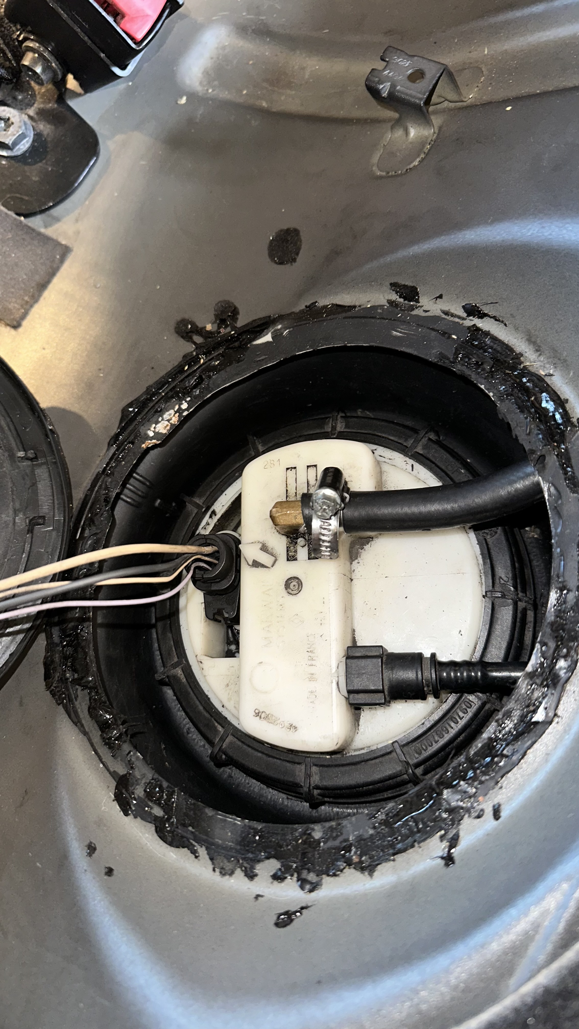

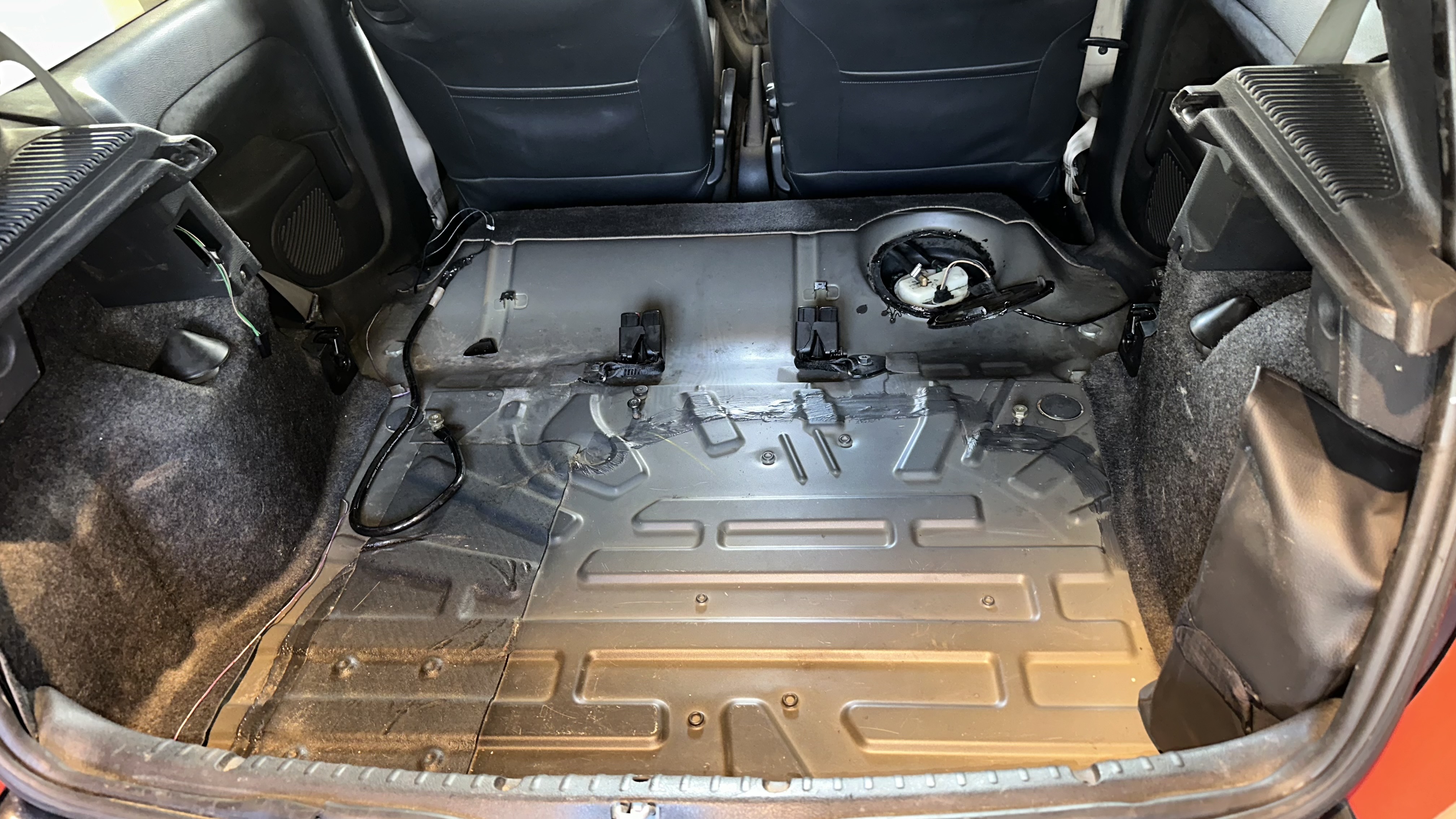

I’ve never managed to get the ring back on the fuel tank 100%. This has been ok but a bit of a bodge really. I decided when I was on hol that I don’t want to be on fire if I crash so ordered a collection of new rings. I drained the tank using a very special method thanks to the fuel return 👌
I’m not the smallest of people and trying to get into the back to get to the sender is always tricky. I decided the easiest way would be just to take the whole interior out to get proper access
I got the ring sat perfectly eventually. Took it for a drive and there’s not a drip. I’ll stick another mountain of window sealant round that cap and I’ll be perfect.

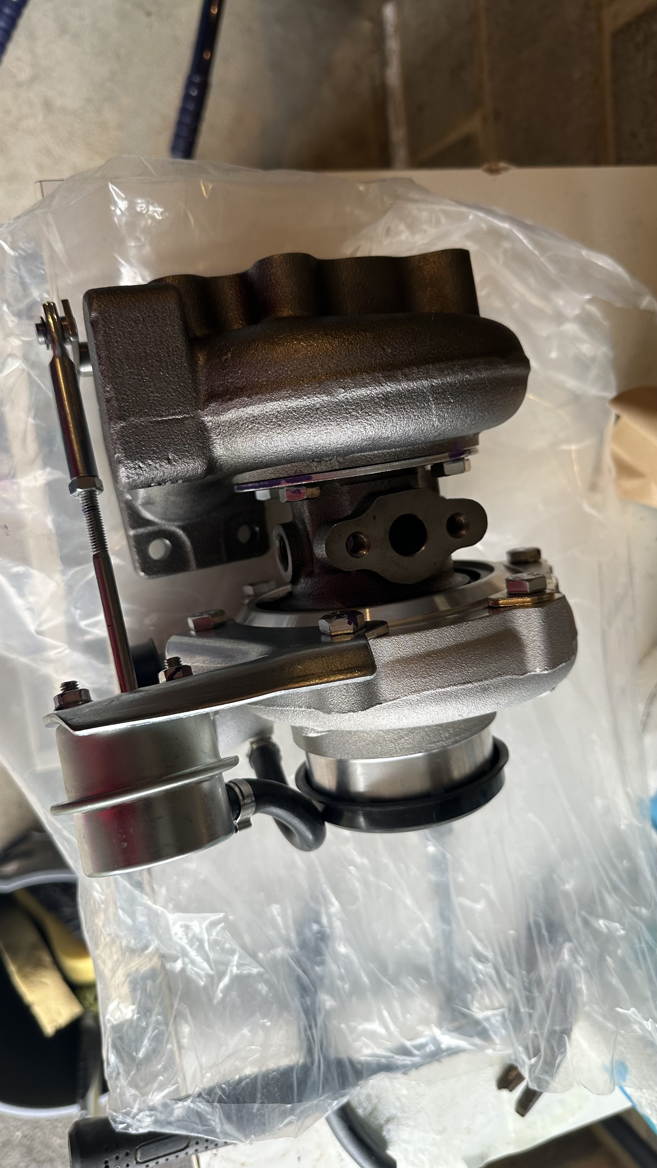

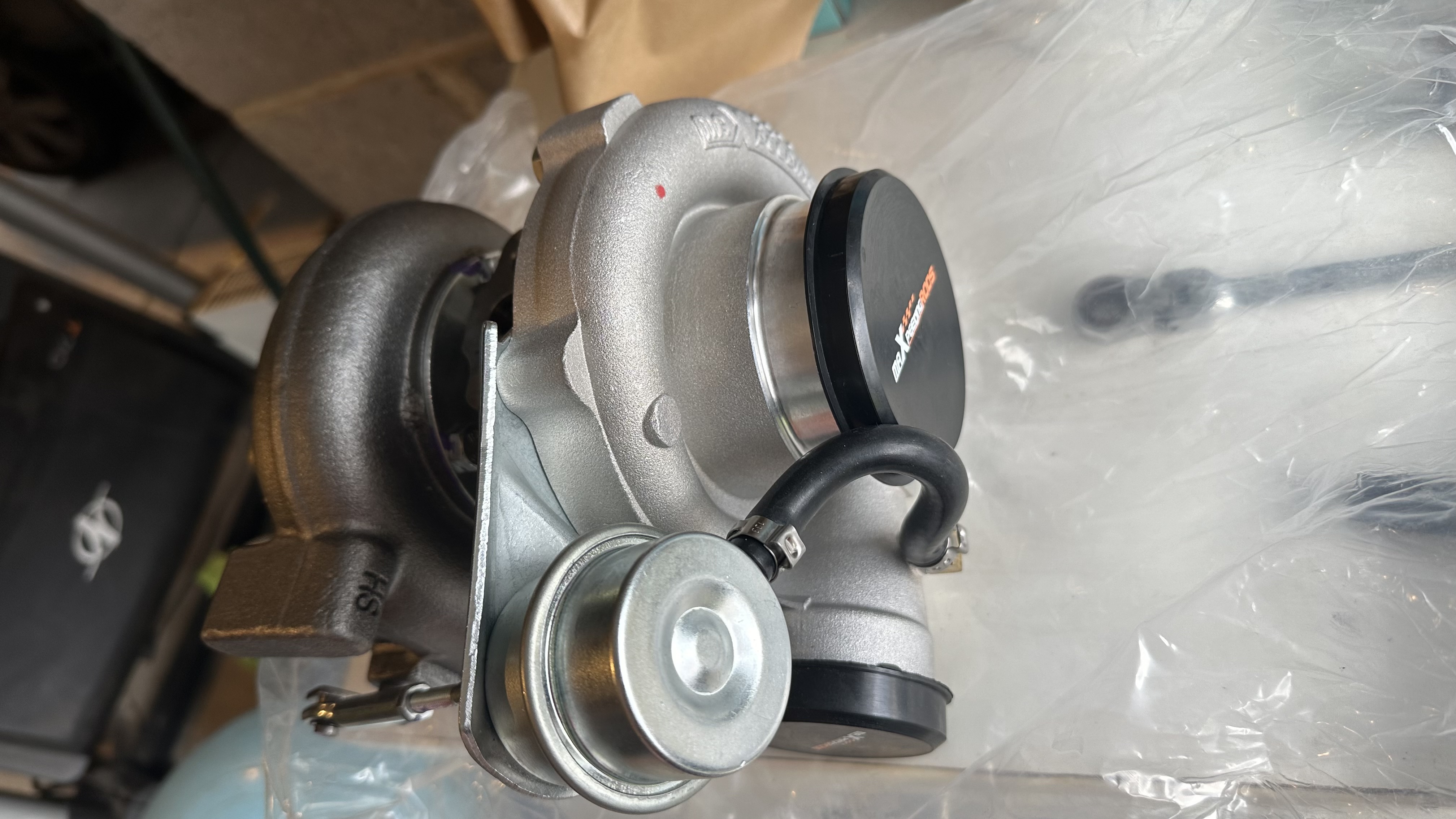

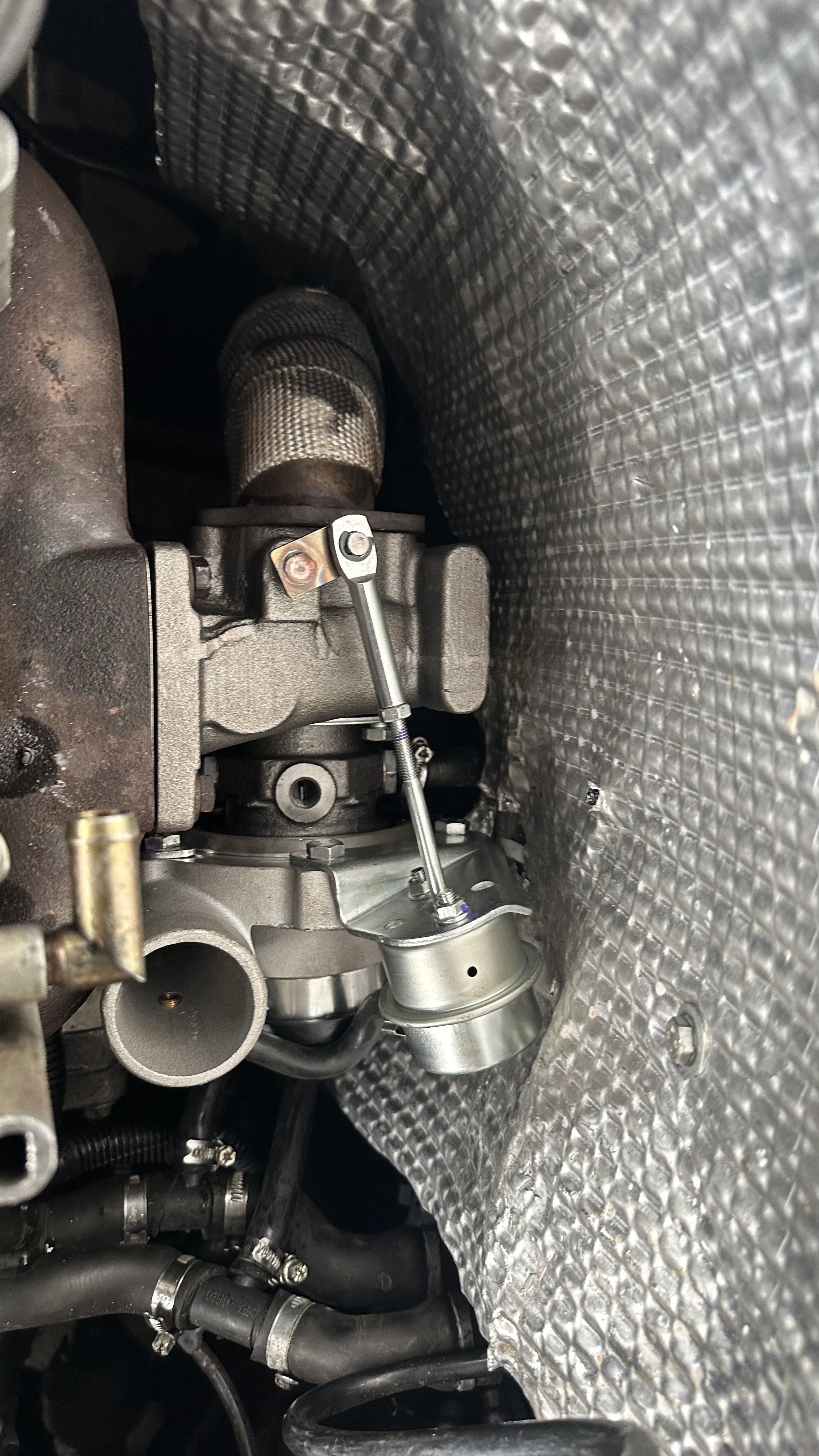

New wuhan whistler landed today courtesy of maxpeadorods. It’s the biggest GT25 I’ve seen 😂
Wastegate port is comically small. This time to save f**king the turbo up with bits of swarf like the last one, I stripped the exhaust side off and started enlarging it. Again, this time making sure not to touch the side the penny closes onto. The size/setup of this one makes it much easier. I was using a stepped bit with the drill on a pillar mount but because I’m a lazy mong the battery died and the other one was also flat. Got this so far, will do a bit more tomorrow then it’s good to fit
Had some spare time tonight with the wife being on child collection duty.

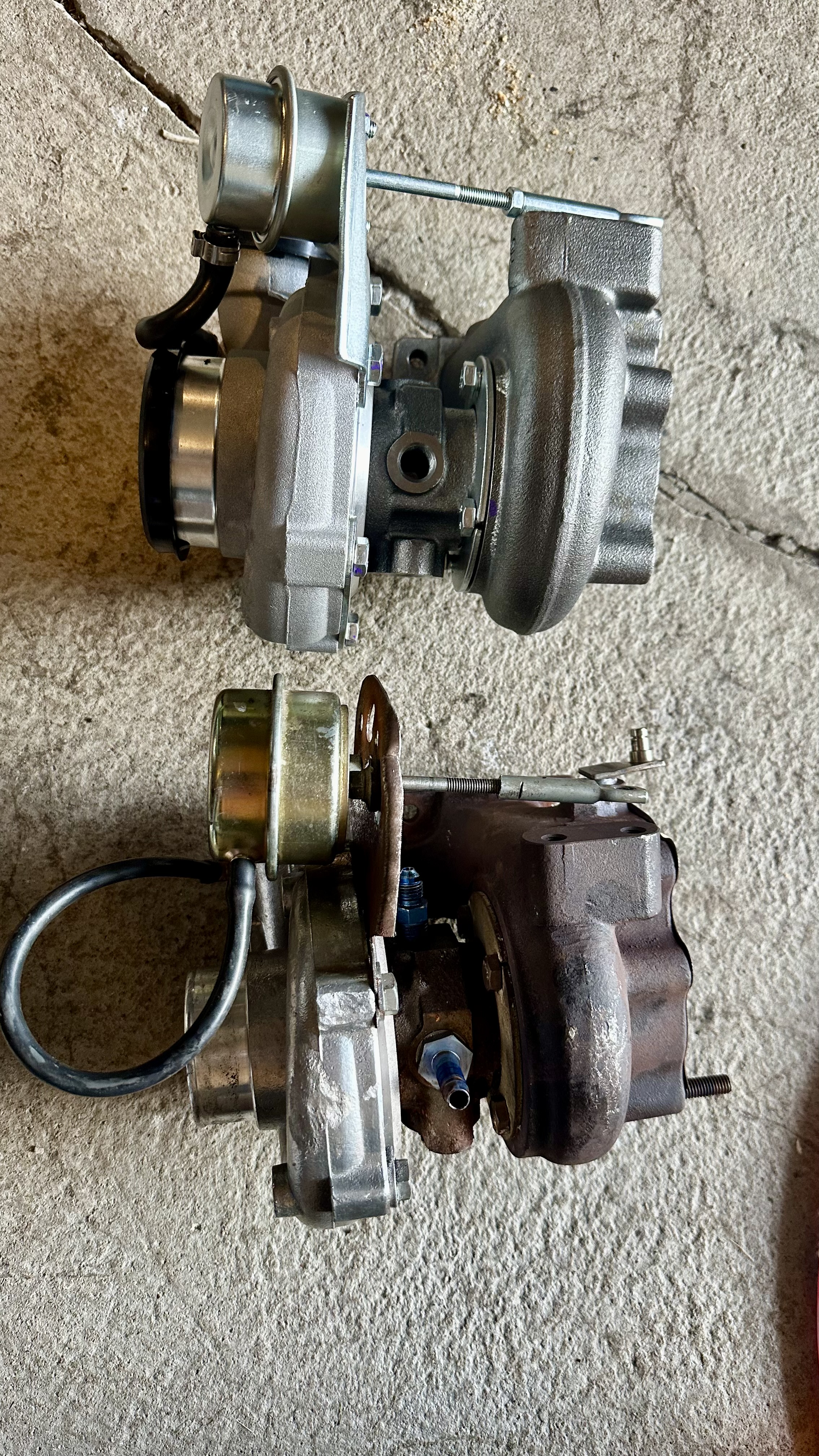

I got the old turbo off to swap the bits over. The new one is absolutely not a GT25 of any flavour. It’s bigger than the current one 😂.
That would just be quite funny if it wasn’t for the lack of any space. I negotiated it into the gap and it was hard against the bulkhead in a couple of places
Not any more, have some of that you c**t 😂
The pictures don’t really show it too well but there’s now a bit of space around it which is good. It would be lovely if I could just pull the whole engine forward by about an inch. Don’t think that’s possible without some serious effort unfortunately

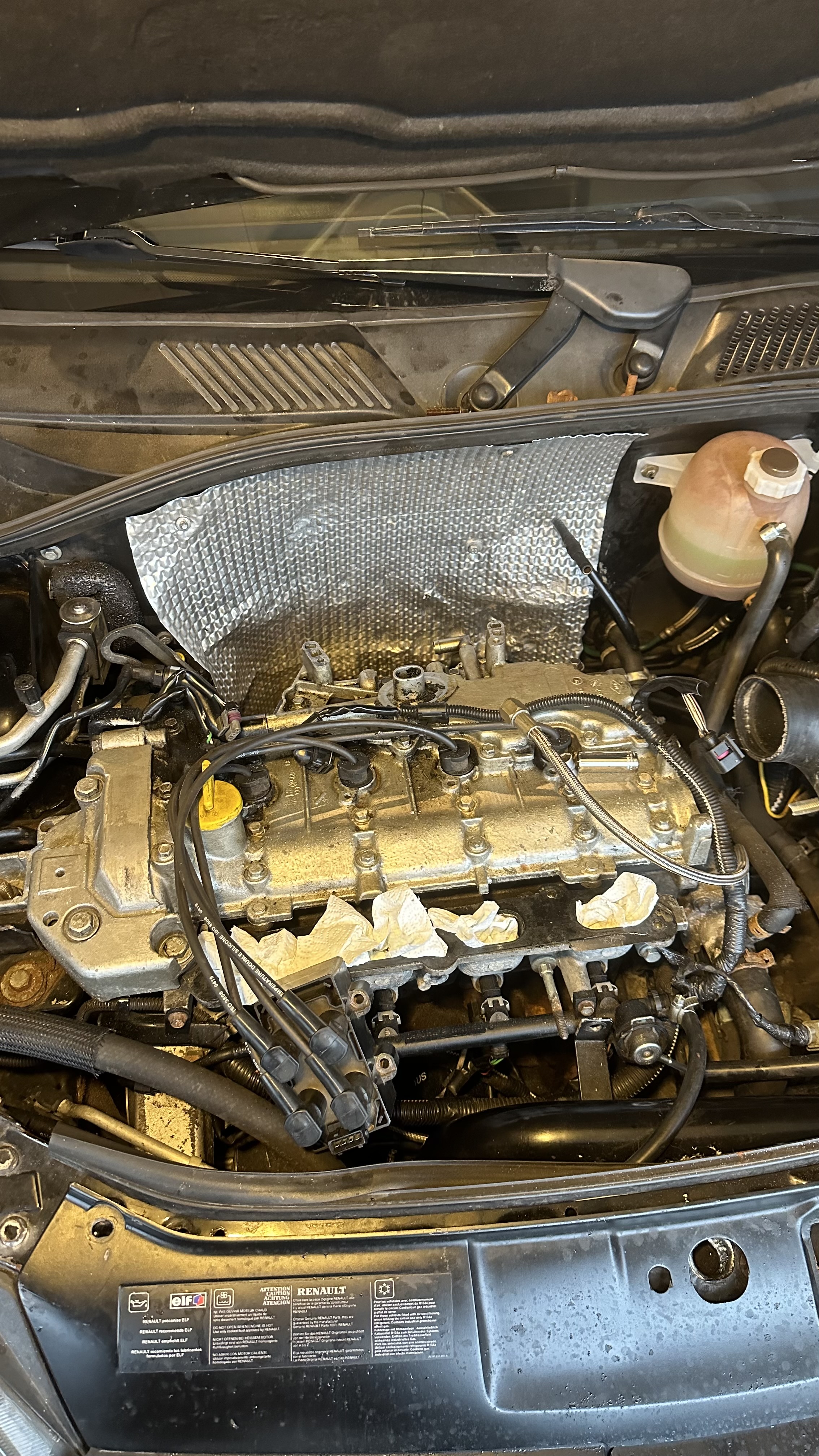

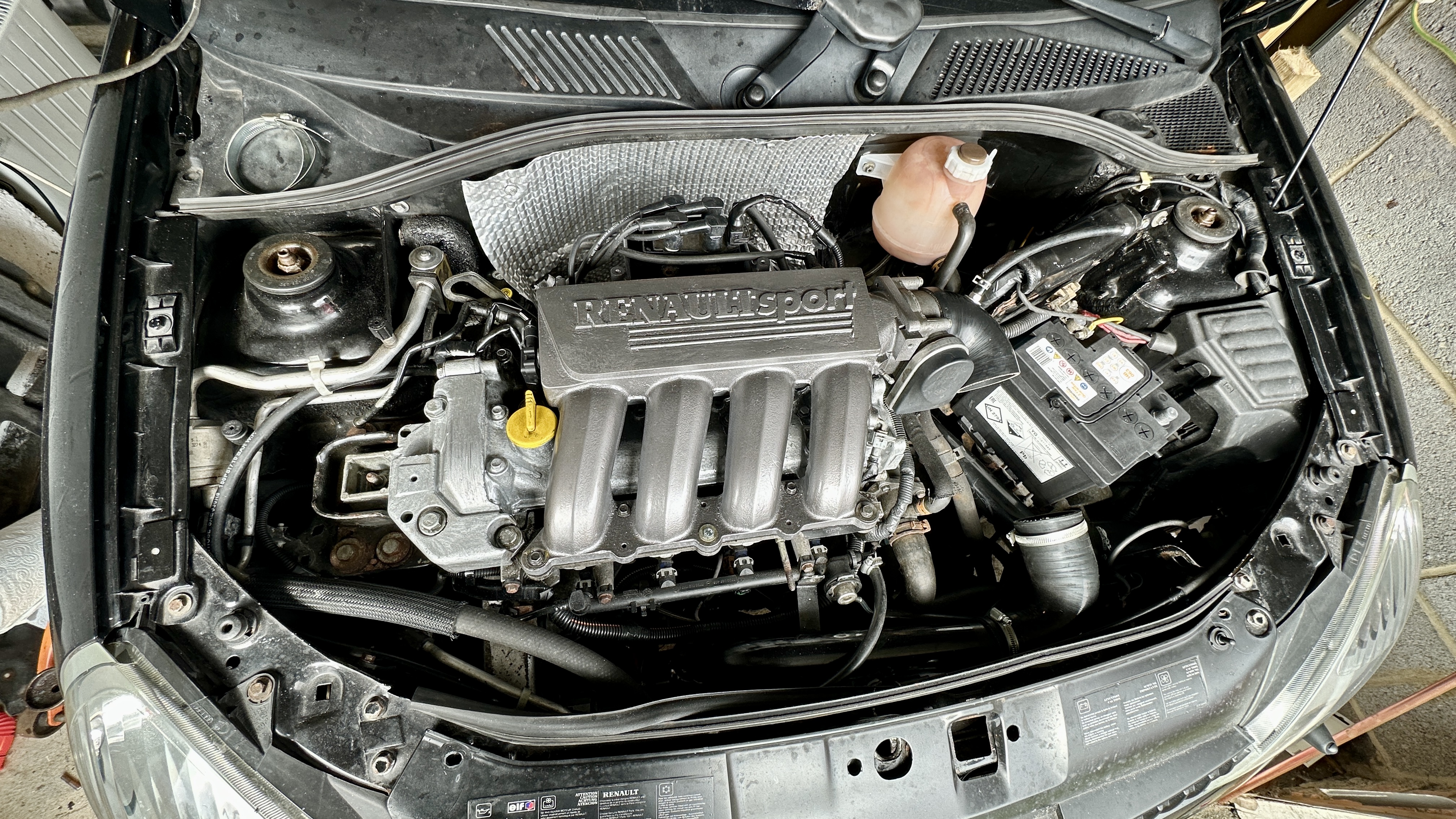

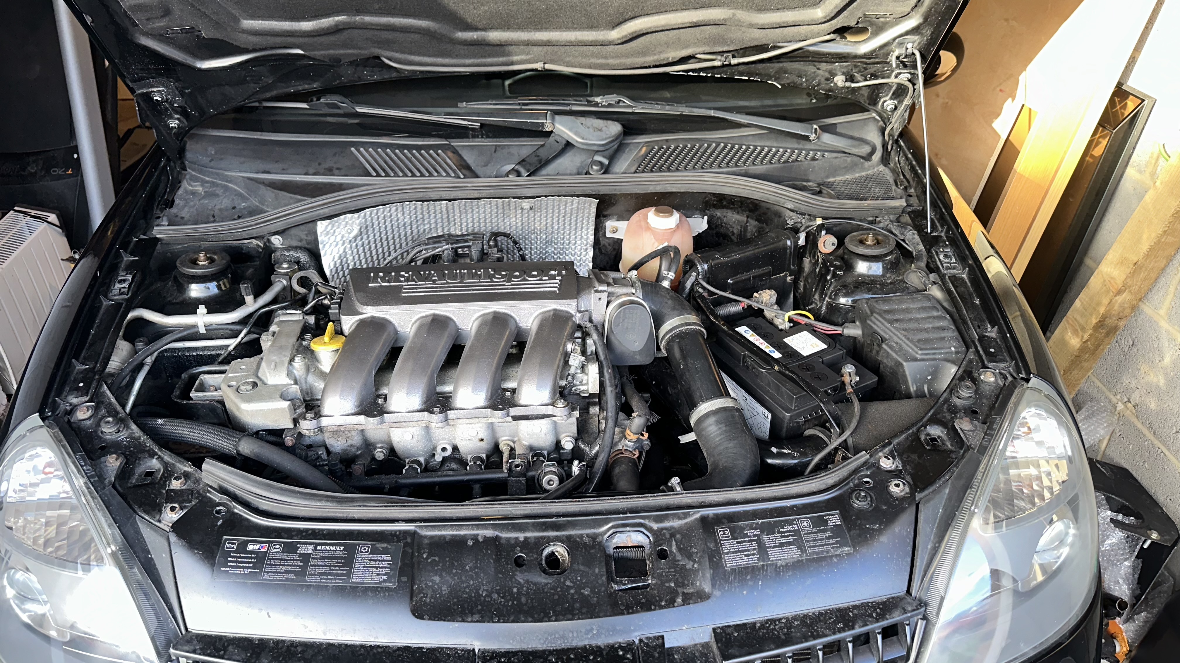

I got the turbo fully plumbed in and the top boost pipe back on. As you can see, I’m still not convinced it fits in the hole. The heat shield does sit slightly proud of the bulkhead and the turbo kind of nestles in the bit where the bulkhead bends back in towards the cabin so it’s not too bad.

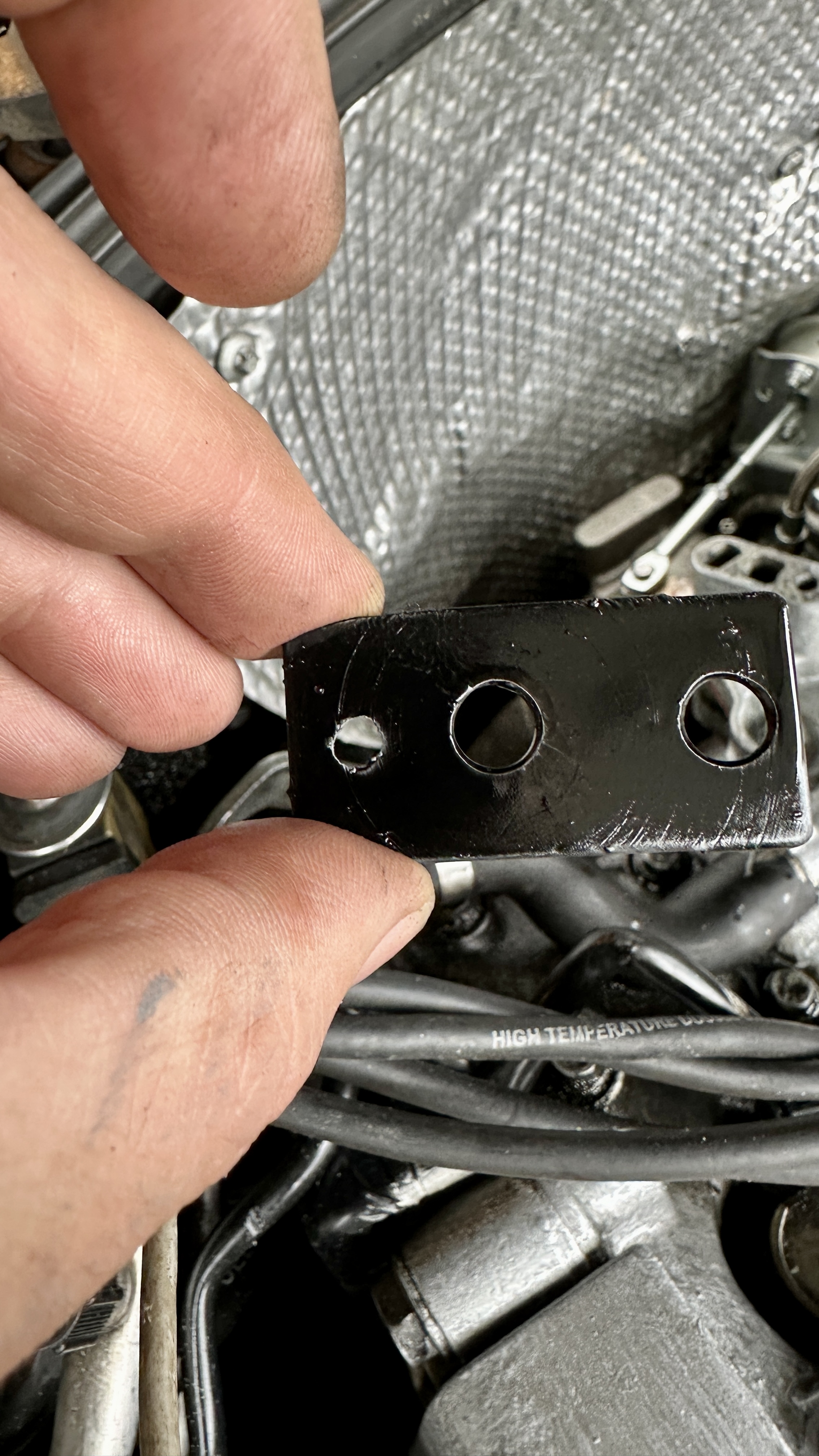

As with every Clio the ecu bracket is snapped so I made up a quick bracket to hold that in place nicely
I gave the bay a bit of a spruce up and a decent clean. I’ll give it a proper wash down once it’s out the garage. I’ll have to buy another another header tank as that one is terrible again.
You’ll notice I’m missing a few boost pipes. These are off for a lick of paint. Had to get imaginative with a couple of them
That was today’s progress done. The new turbo inlet is bigger than the old one so I need a 80mm - 60mm reducing elbow so I can get the air filter pipework back on.
I also noticed when driving it that the heaters were either hot or very hot. I think this is because the turbo coolant lines are teed into the heater pipes. I’ve left the feed coming from the bottom heater hose but the return is going to go into the pipe to the top of the header tank. I’ve ordered a T which should be here in a day or 2.

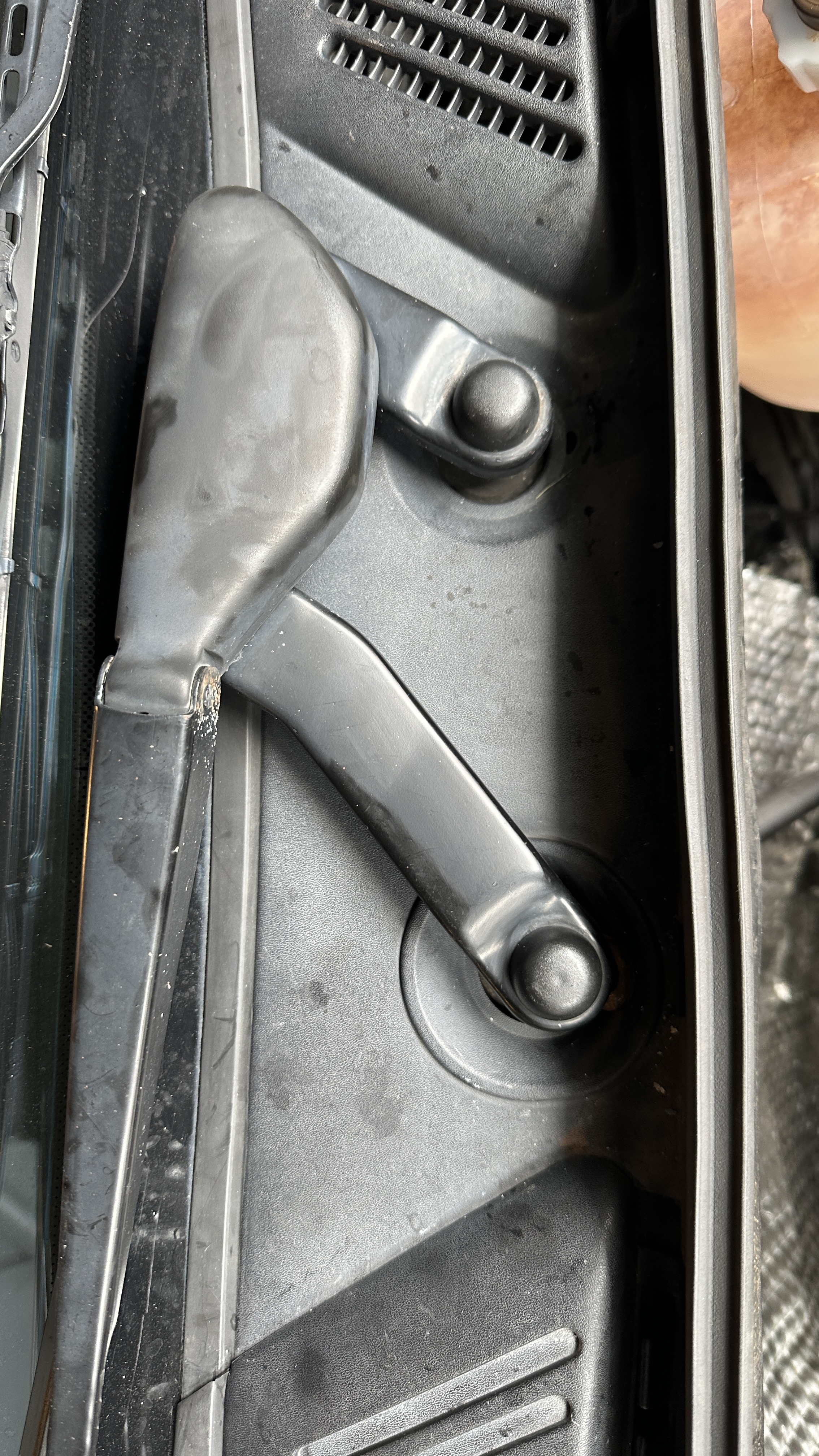

The last bit I’ll sort before it gets use again is the scuttle panel and wipers as they are looking a bit ropey. I’ll try some trim black on the scuttle and see how it come up but if it’s no good I’ll spray it satin black like I did with the front grilles. I’m not convinced the wiper arms will pull off though, so they could need masked off and painted in situ. We will see!
And that’s me done for the day. A thoroughly enjoyable experience and much better than the s**t show that was yesterday 😁

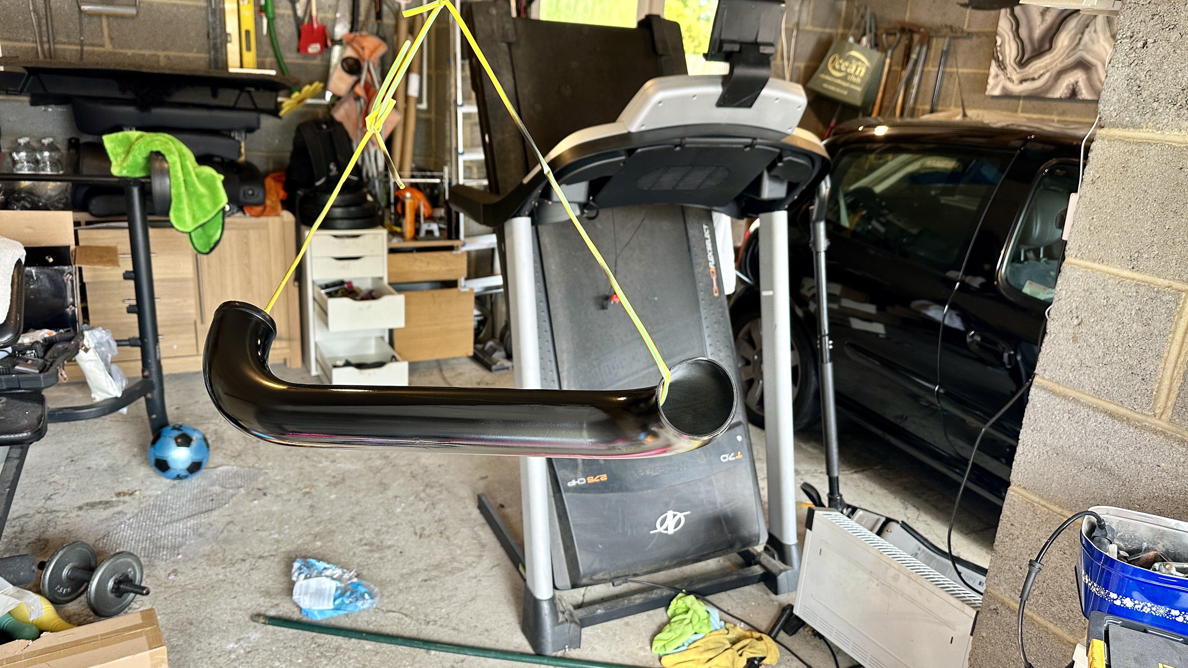

Interested to hear how you get on with painting the panel and the wiper arms.
Mine are looking a bit shabby too.
