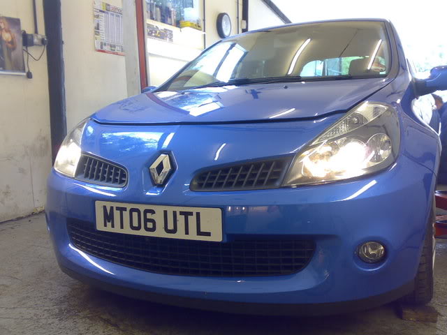

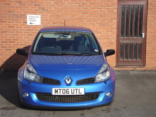

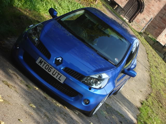

No Ball ache tbh I looked into it, i retro fitted the standard washer kit, and in the end HID'd up my cornering lamps.
That involved new washer bottle and neck, new pump, washers nozzles, and a bit of tubing. Even that cost me over £100.
Easiest thing you can do is,
If you have the silver standard halogens, upgrade to the black cornering lamps, then stick a 5000k HUD kit. Done.
Before (standard with black cornering lamps)
After the retro fit (looked like it came with factory Xenons) The old park it up a hill to make it look lowerz trick ;)
All the wiring was there on my car, the multiplu for the extra washer pump is simply taped up round the existing washer bottle.
