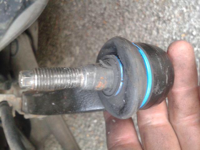

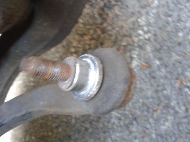

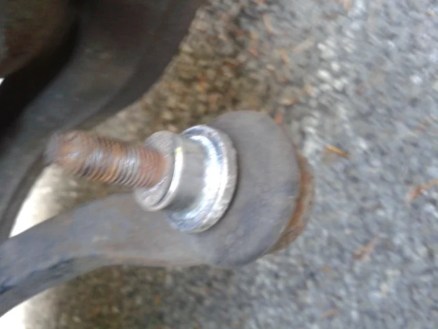

i cant seem to get a track rod end for my clio 197 i have even been to Renault they keep giving me a track rod end which has a taper on it but mine doesn't it sort of machined to fit into the hub any ideas guys? heres the one is need
but i keep getting one like this

You have the sleeve from the hub come out with the track rod end.
The ones supplied are correct.
Remove sleeve from old track rod end and fit back into hub.
Job done.
ah what an idiot i dont know how i did that haha ive chucked it out :openmouth: any ideas where i can get another insert from
Comes as a complete hub assembly over £200 from Renault.
b**ch to change most of the time as the pinch bolt that holds the lower joint in is usually siezed.
