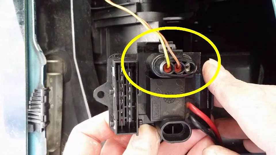

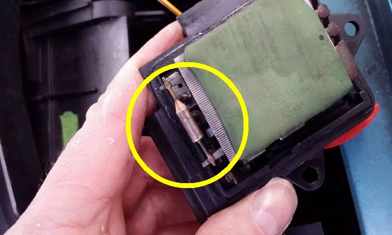

Our clio 2 interior fan speed only works on speed 4 - have pulled out the resistor pack from the blower motor underneath the bonnet and traced it to the thermal fuse being the problem. I shorted it out and all 4 speeds work with it shorted.
Was so tempted to solder a wire on , leave it permanently shorted and pop it back into the blower casing but had visions of it overheating and catching alight so I thought I better not do that.
Just wanted to ask - the big long wiring plug is obviously the power to feed the blower (well rather the resistor pack) but what is the plug for with the 2 wires on it? for?
