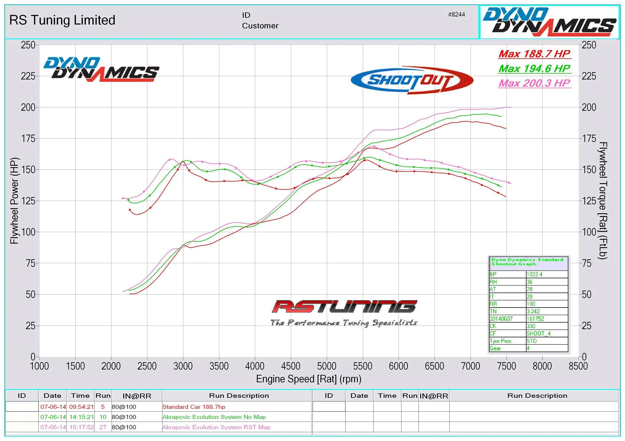

Clio 200 Akrapovic Evolution before and after graph
RSTuning
  R35 GTR
This is the first exhaust we have seen to make gains like this on a 200!

Nearly 6bhp from just an exhaust is good going.
Out of interest paul, how much of the other 6bhp do you think was down to the exhaust as well?
Ie if you had just mapped the standard car would you have expected to see that 6bhp from the map anyway or would it have normally only been say 4bhp and the other 2 was because the exhaust was working so well it leaned the standard map out etc?
Ie of the total almost 12bhp, how much do you think is down to the exhaust?

Usually see 4-6hp on the 200 with a map alone.

Cool, pretty much what I was expecting you to say.
So basically the exhaust is good for genuine gains of 6-8bhp. and 12bhp when done with an RS Tuning live map as well on a standard car.
Impressive stuff considering the standard one isnt exactly rubbish.
