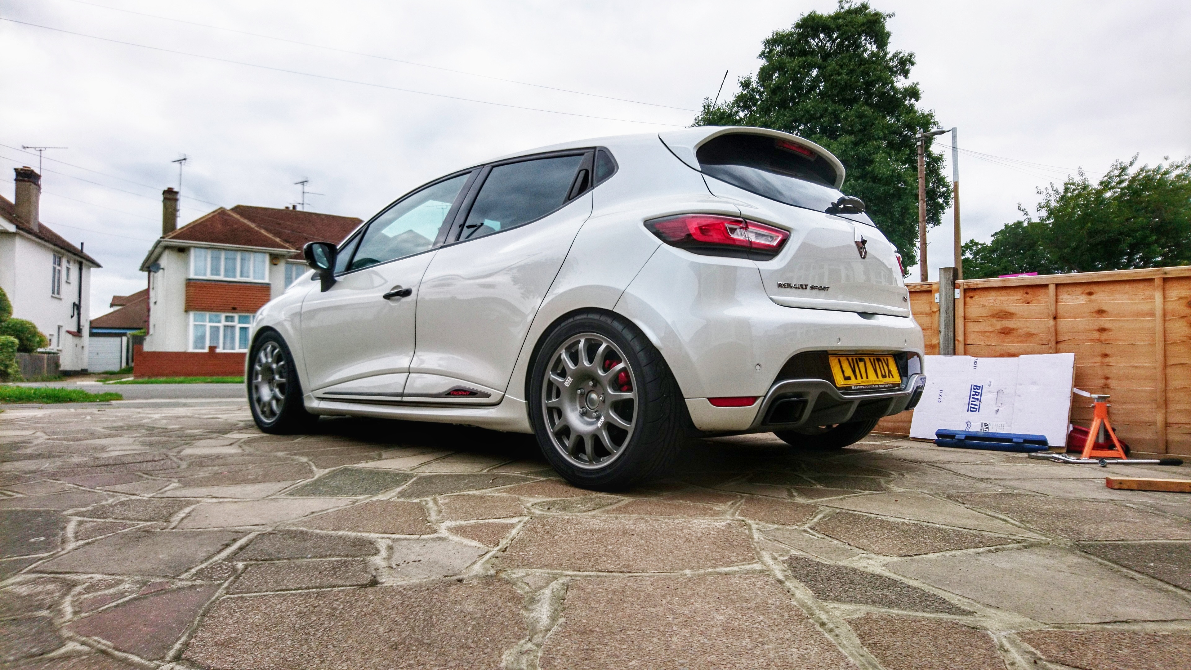

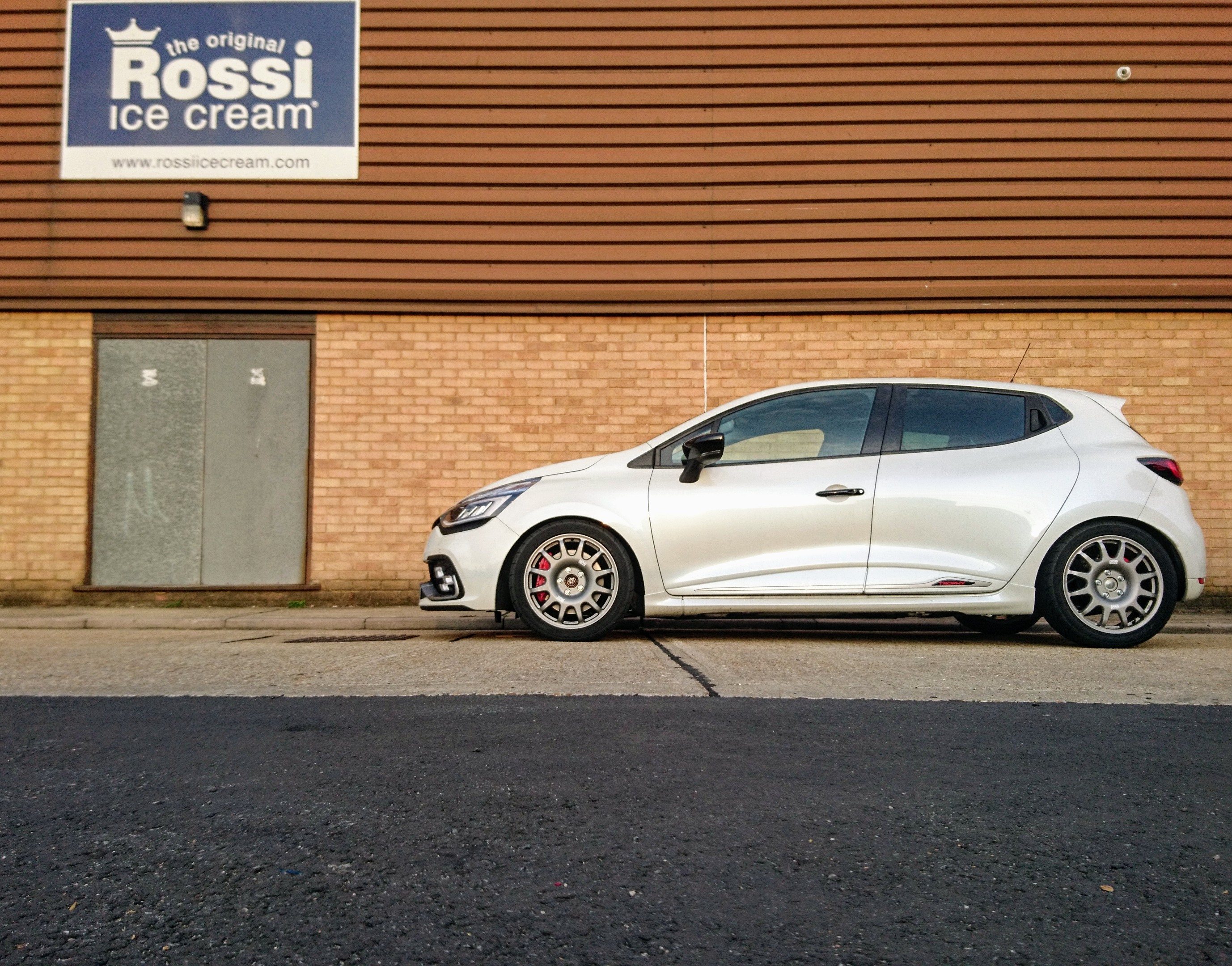

A bit of an impulse buy! I saw these on photos on the Internet so I called John at R Sport to enquire on price and availability. I then ordered them and picked them up last week, I also ordered new Yokohama ADO8R tyres from Ben Patey and picked them up today in Bracknell. Arrived home and had them fitted, then trial fitted them to see how they sit as they're a different size and offset to the original Trophy wheels. So with a little fettling they should sit right what with longer wheel bolts.

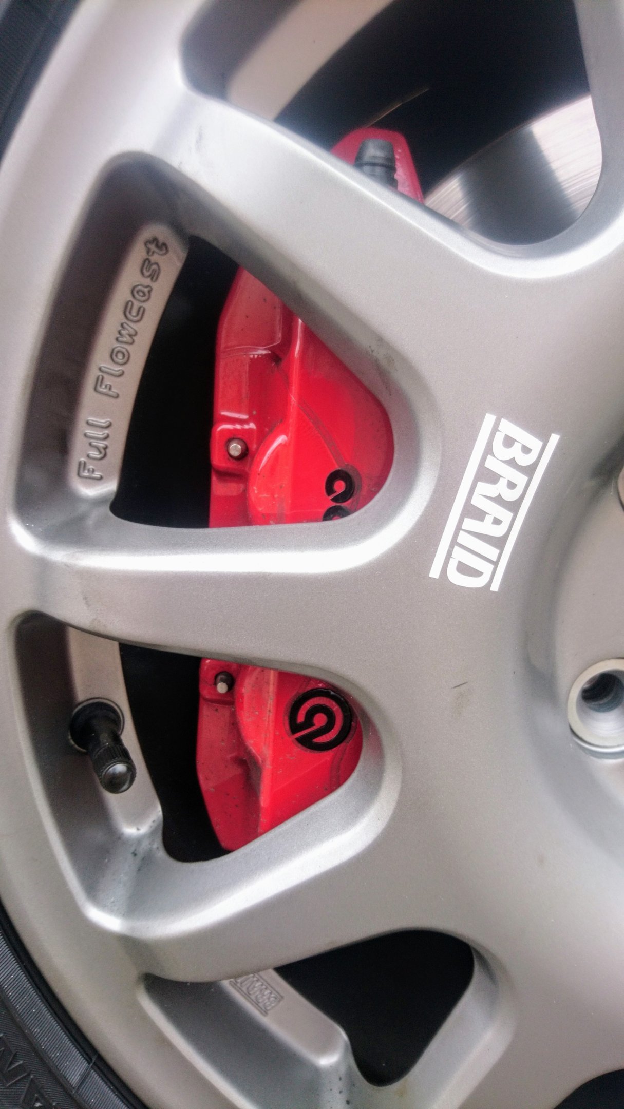

They're a tarmac spec wheel the Clio R3T rally cars use, they can only be bought from R Sport. Commissioned by RenaultSport as the std issue rally wheel for the series so they're the same PCD and centrebore with the added bonus of clearing the Brembo 4 pot calipers without the need for a spacer.

Really like the design , its just a shame they cover most of the Brembos which look incredible .

Spent the evening working everything out ready for CS18. I took out the PMS 10mm rear shims as the wheels sat just too proud for my liking, then put a 5mm spacer on up front as the original Eibach 16mm spacers were too much. Pretty damn happy with how it sits now, just need to pick up the new longer wheel bolts then I'm ready to go.
