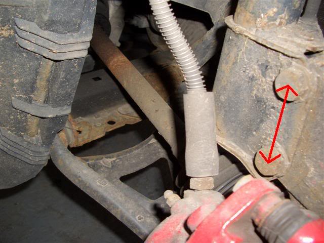

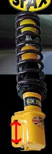

Im buying a suspension kit but i need to fing out the front strut bolt spacing. its a 1.2 16v clio dynamique (2003)
any help much appreciated:)
Most probably 58mm but could be 54mm or 52mm. Definite way is to get a wheel off and get a ruler out.
aww thank you - but you say its most likely to be 58mm. I'll measure it to be sure - thanks alot for all your help and your little pictures:approve:
I like it lol get someone to take the wheel off. Just remember it between the centres if u do measure
well i wouldnt trust myself to put it back on :S i might just go with it being 58mm if edde says all off them that age are:S
weather is pretty shitty in Glasgow at the mo so I would prob go with edde too, he seems to know his stuff.
turn the wheel onto full lock and you should be able to measure it without taking the wheel off - awkward, but can be done.
