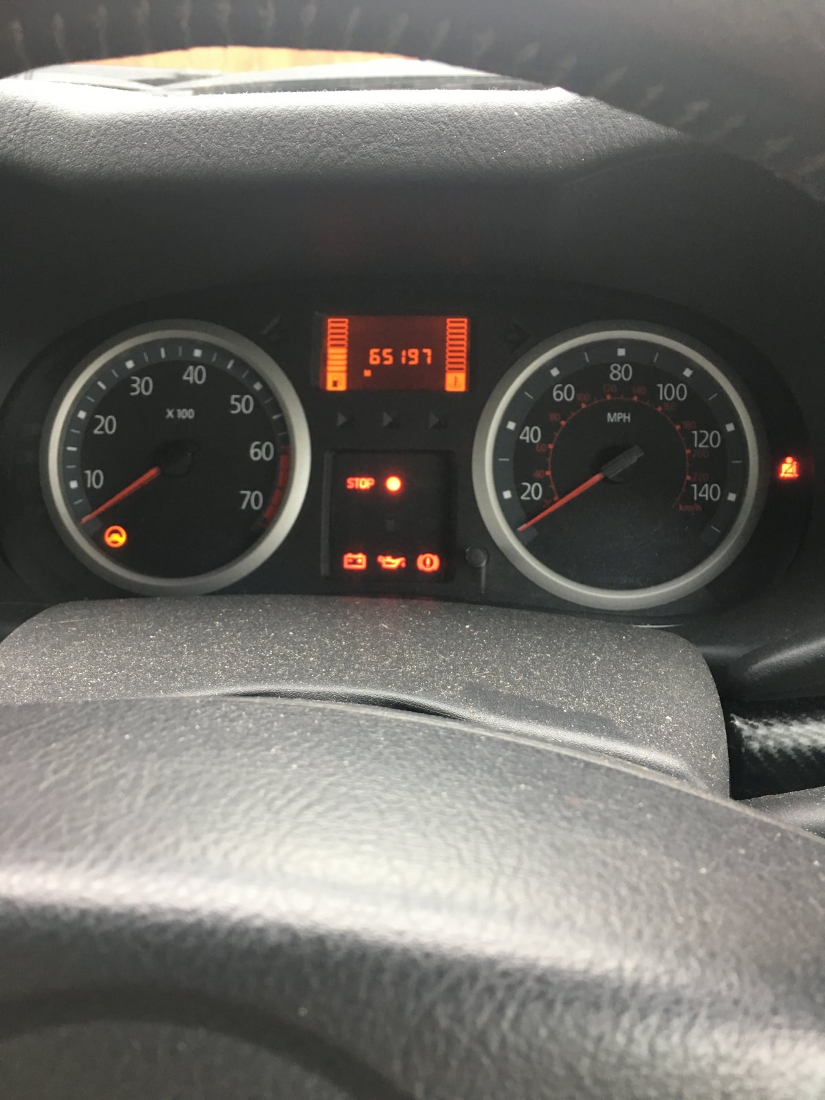

Hi guys,
My car wont seem to start, the immobiliser light stays solid when I turn the ignition on , The battery, oil, stop, handbrake and Amber wheel light stay on, all other lights go out. Picture below show what I mean.
The car will try to start and will turn over but only when you go and turn the key straight to position three.
If you try going from ignition on(2) to actually starting the car(3) it won't do anything at all relay clicks but nothing!!
Also had diagnostics reader on it but the car won't communicate with it.
Iv Recently changed the coil pack and spark plugs. Starter motor is fine iv checked the voltage. Tried putting a new earth to the engine with a jump lead and then starting it still no joy. Also had the crank position sensor out and cleaned that, but still nothing.
Any help will be much appreciated.
Many thanks.
Lewis

I've had same problem for the past few months, just won't start at all I've tried all the common faults and still nothing. Cant seem to find a solution anywhere, i did get it to start a few weeks ago by running a wire from the battery to one of the wires on the ignition (can't remember which one) but after the second time starting it wouldn't start again. Now I'm pulling all the engine loom and fuse box out to see if that's the problem. If you do get an answer let me know please because nobody answered my post lol
Hi mate, just an update, I managed to get the car running again , unfortunately I carnt put it down to a just a single thing that fixed it because I tried multiple things at once.
I cleaned the key with wire wool to get it down to shiny metal.
I took out every fuse and relay in the bay and blew out the housing with a compressor then reseated them all again cleaning each with wire wool.
Unplugged the white UCH plug which is under the passenger footwell, and blew it out.
Locked and unlocked the door a few times after this and then it started, and now starts every time.
Cheers Lewis

Might seem a bit obvious but have you tried a new battery? Mine was off the road for a week for a new clutch, when it was all back together I couldn't start it,
Electrics still seemed to work fine but no start up only clicking.
After quite a while trying to start it the battery level dropped low enough to send all the electrics in the car into crazy mode, flashing, beeping etc when I tried to start it.
I also had a short in one of my back light clusters which probably wasn't helping.
New battery solved the problem.
