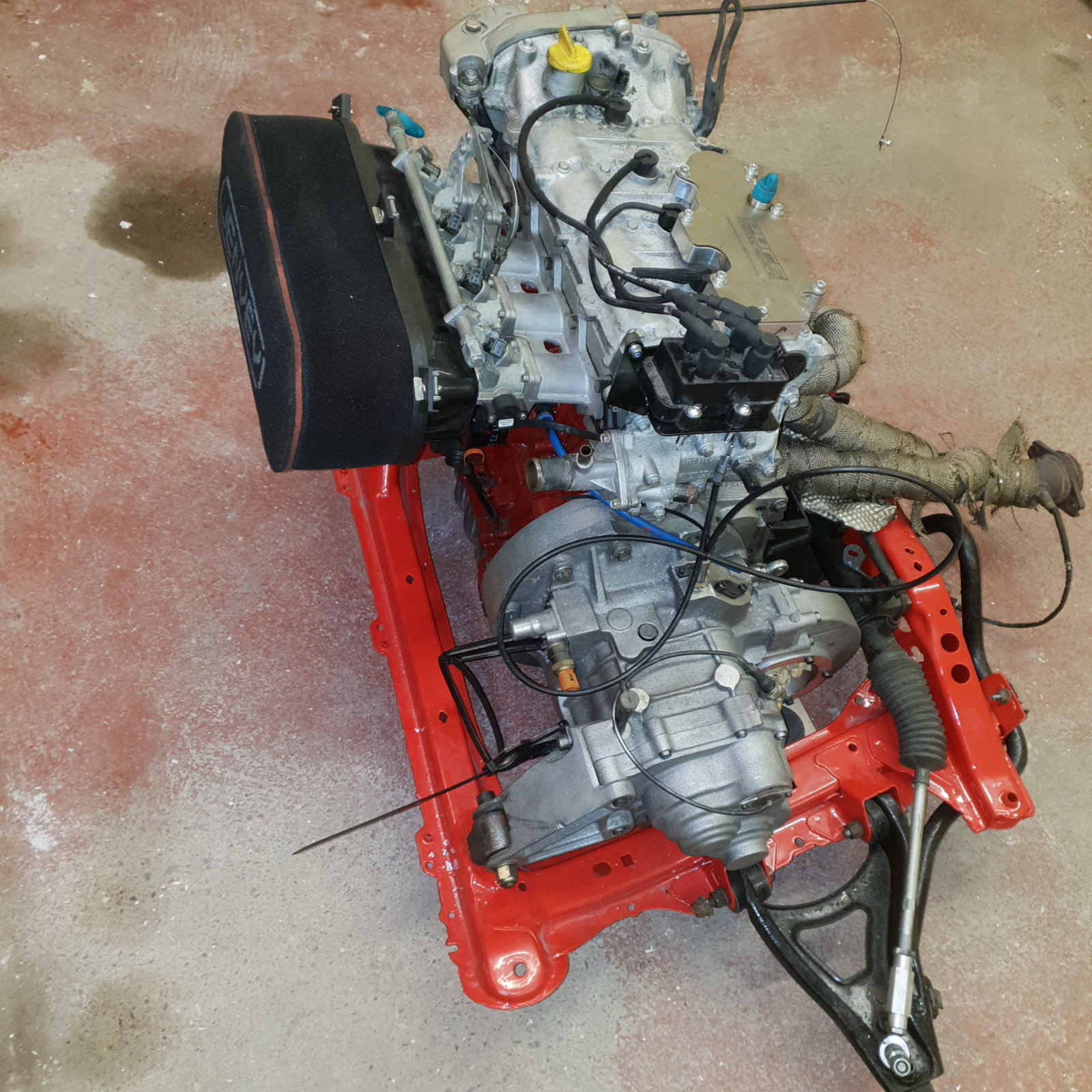

Milk nearly shot out of my nose when i saw the catch can setup!! Simple solution for the win. Also the engine mounts look completely alien to me guessing they lower the engine by a fair amount and make them not suitable for the road? otherwise they would have been copied surely?

The mounts have the engine at the same height but it is mounted to the subframe , guess this is to help with the shift on the sequential gearbox and also makes it quicker to remove the engine by dropping the subframe.
