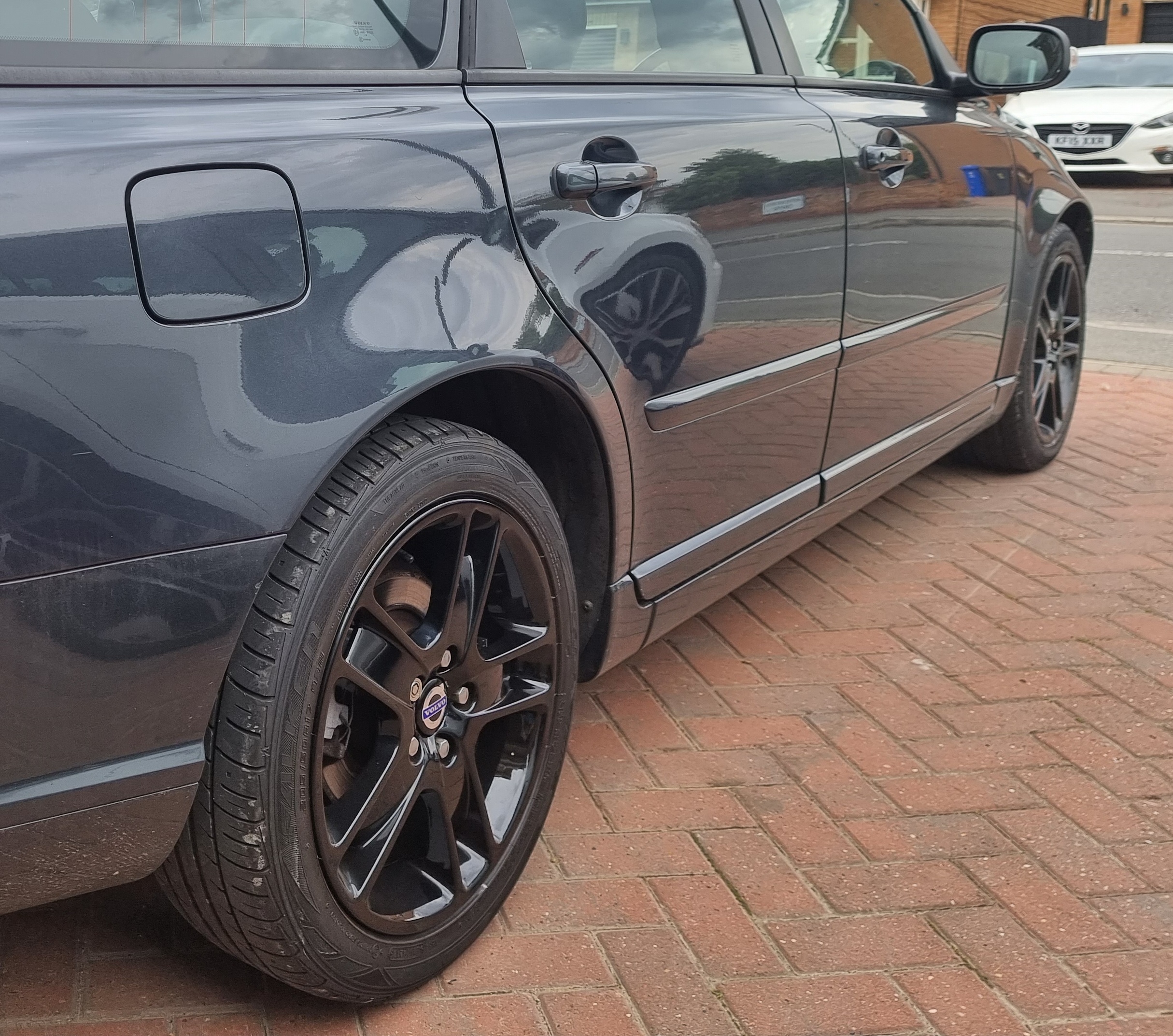

'Grandad' Volvo got some new slippers and has been perfect since bought it, super comfy and nice handling, packed in a 4 man tent and all gear for music festival with kids.

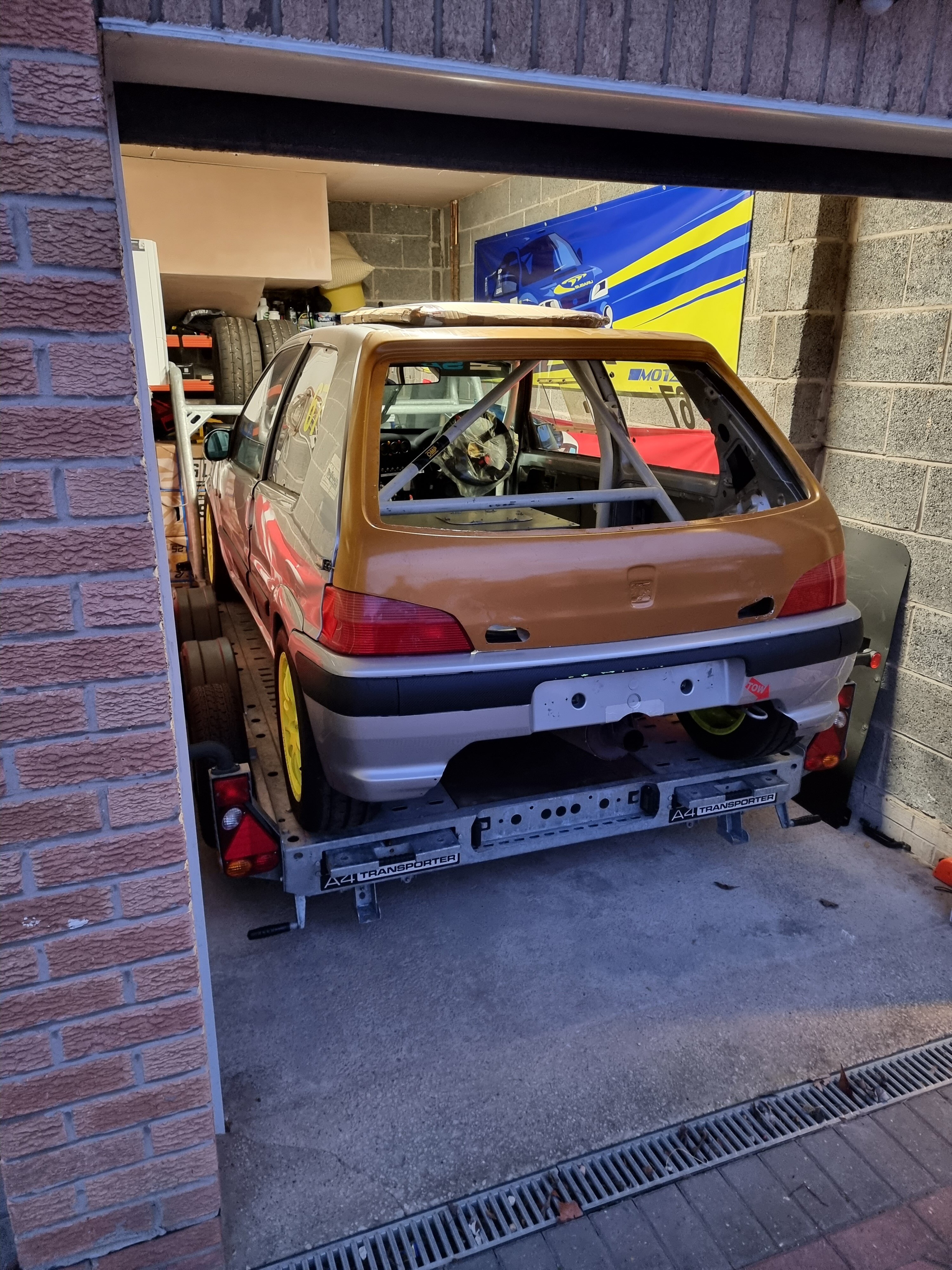

I under estimated how long to load and strap down a car was after having to play jenga on drive to prevent trailer getting knicked overnight then set off late for Curborough.

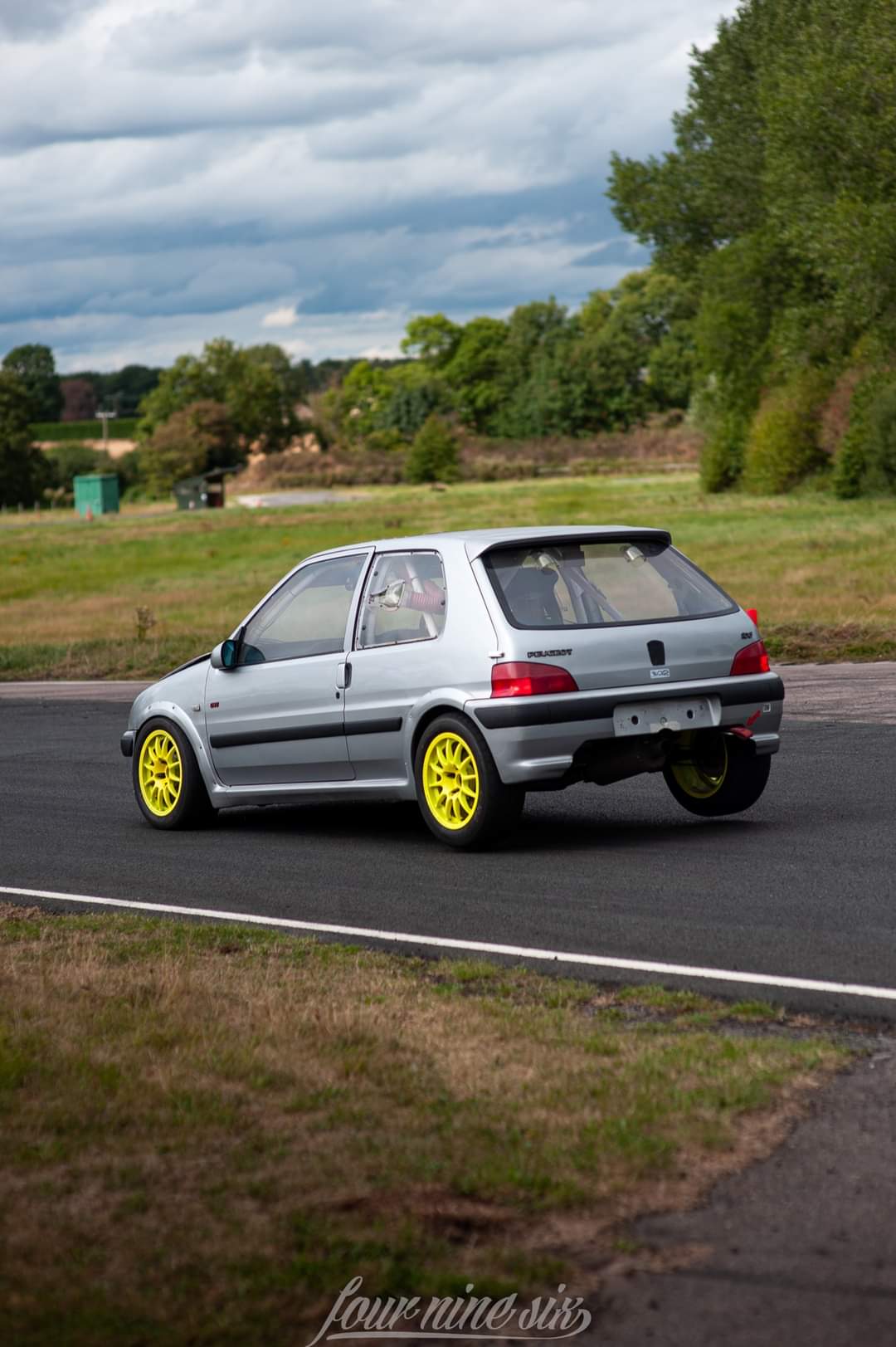

Got there to nice relaxing day of getting up to speed with the 106, started and loaded off trailer under own power. Then got all my gear on helmet and hans then it wouldn't idle, I was gutted. F'ing novice of the year I'd not put any fuel in and not brought any, off to collect a can and some vpower and started first time (idiot).
After that had a brilliant day, it's a little beast - so different to standard Clio obviously handlings amazing it's properly flat and sharp and diff pulls you through corners the engine is incredible. The noise is additive.

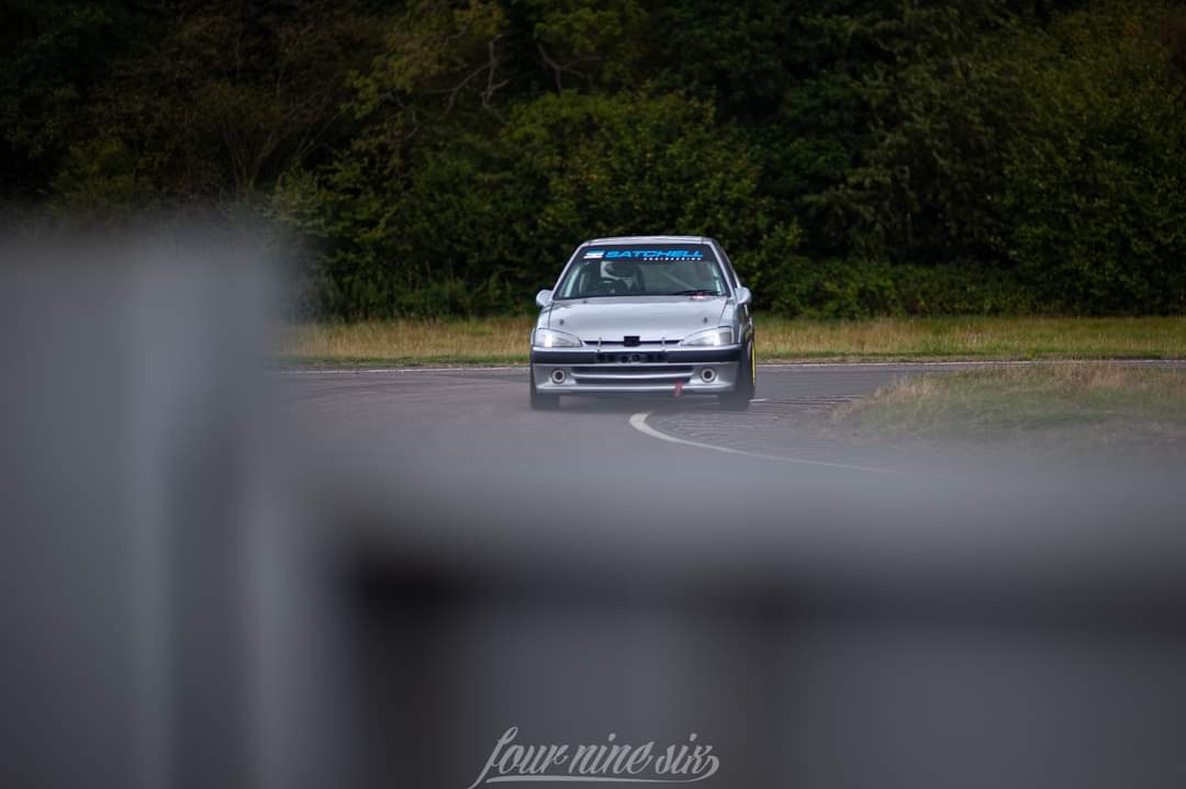

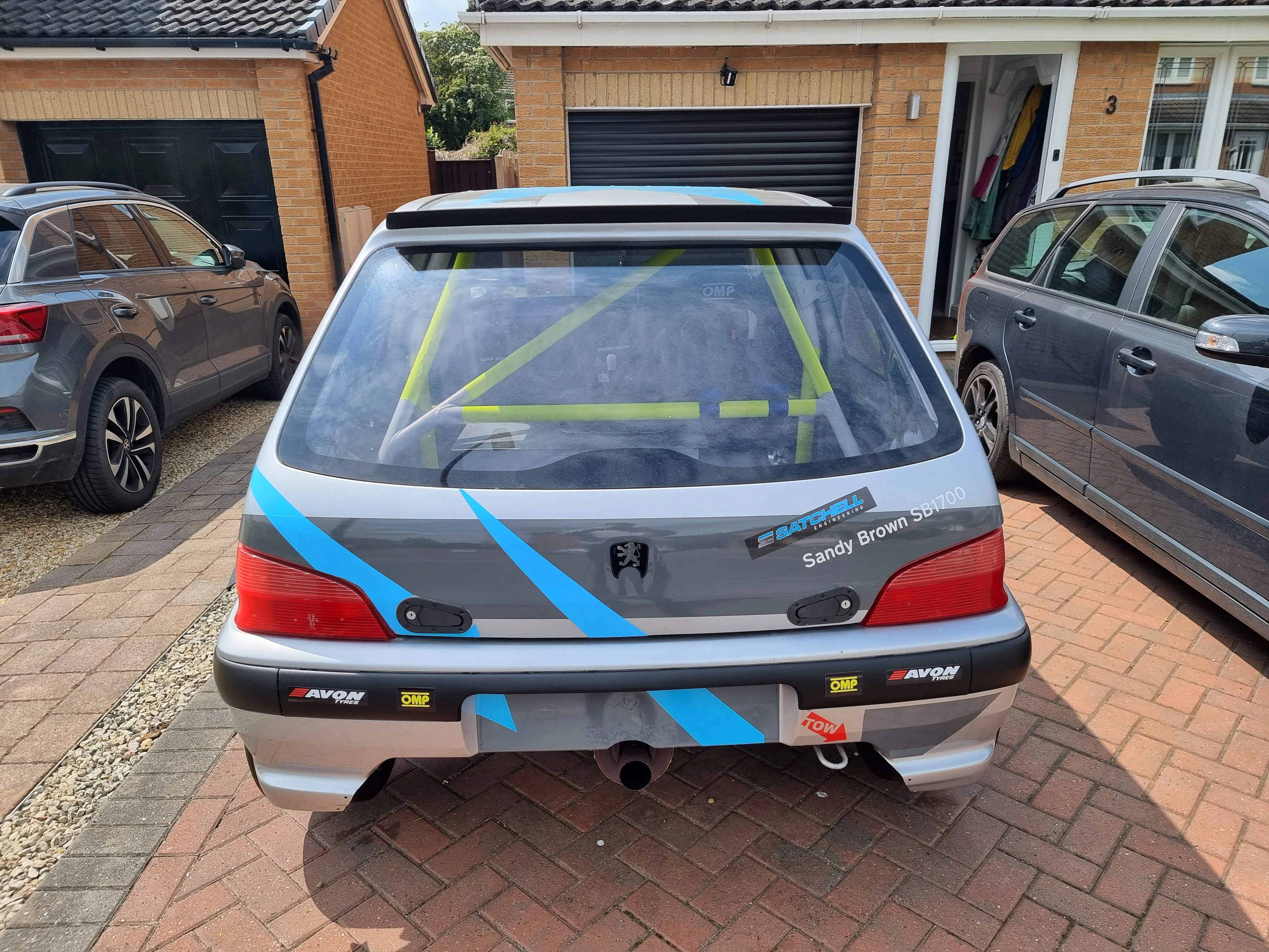

Anyway here's some more pictures...
I met the lads who organised it through sim racing in lockdown so great to finally meet in person. I even gave one of lads in E36 a tow home as his fuel pump died before heading off myself. A great day out, learned loads, love the car and cant wait to get out again and push it!

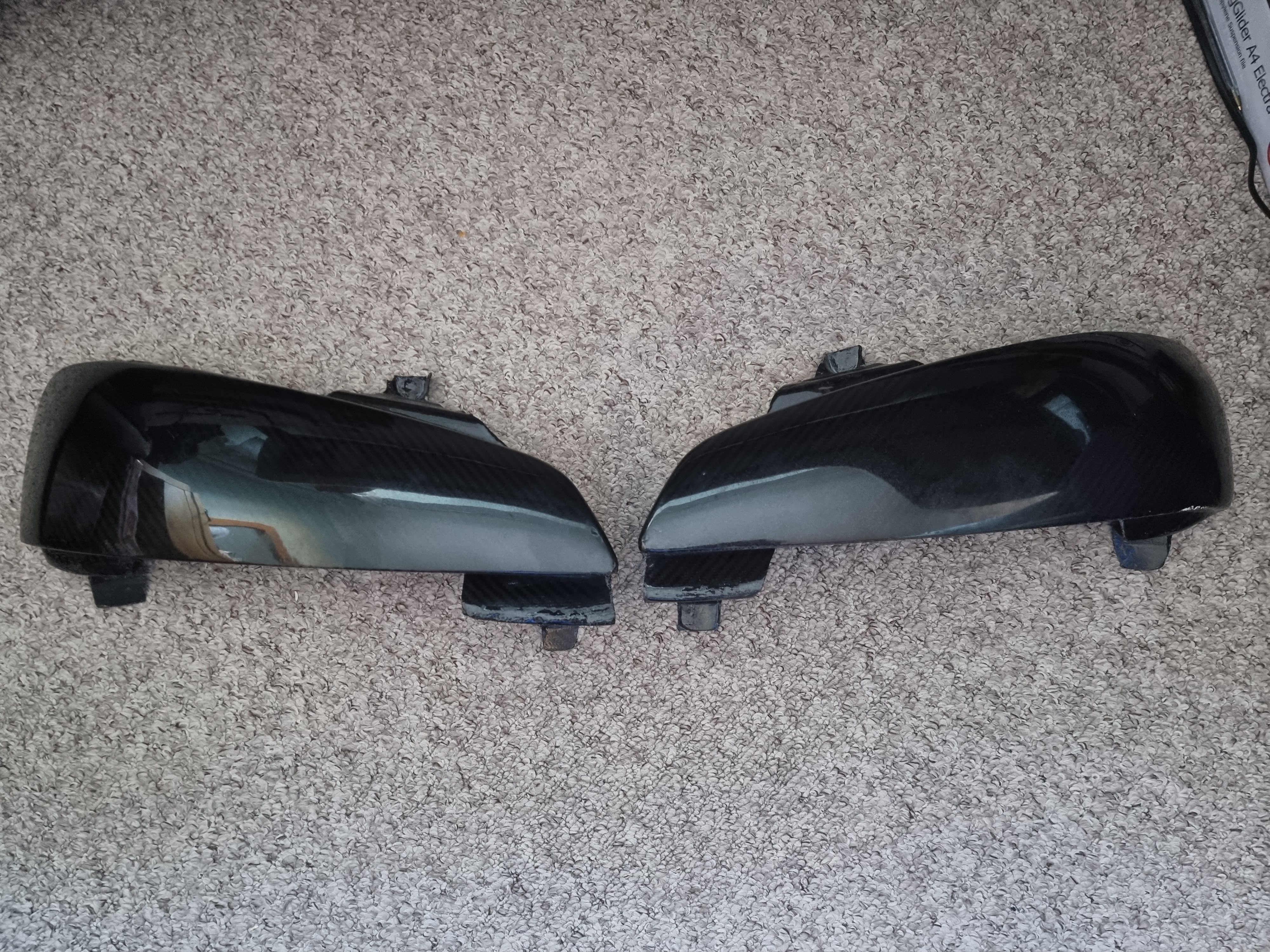

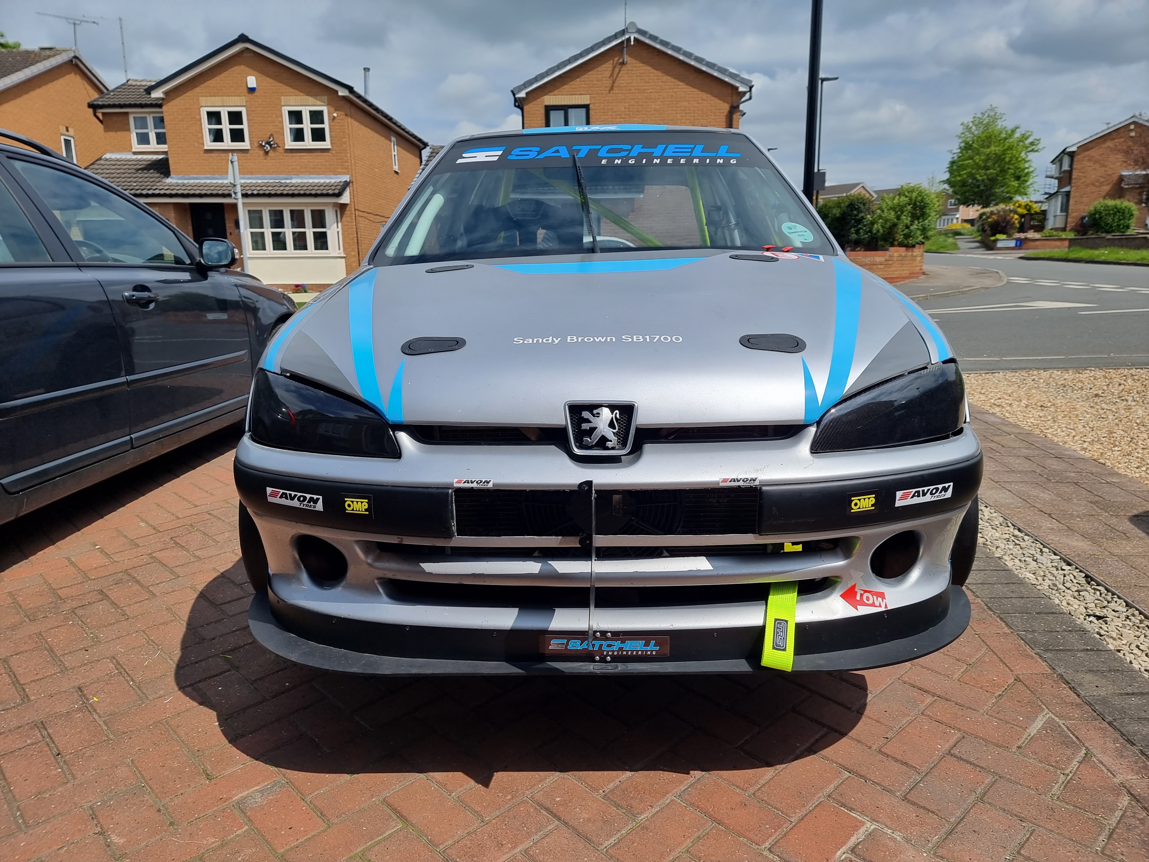

I wrapped all bump strips in carbon and got some one off carbon headlight blanks to fit. Then plan over winter is fibreglass panels and XXR wheels and Avon slicks, plus paint and maybe reduce loom too.
I also spoke to Sandy Brown who built the engine on phone, lovely guy spent hour and half talking me through history of this engine and builds including most recent in 2019. I've got dyno charts from his mapping sessions showing 230bhp / 168lbft.
Only thing I need is MSUK passport so hopefully get that on day on 4th just waiting on OMP to supply certificate for cage then all sorted.

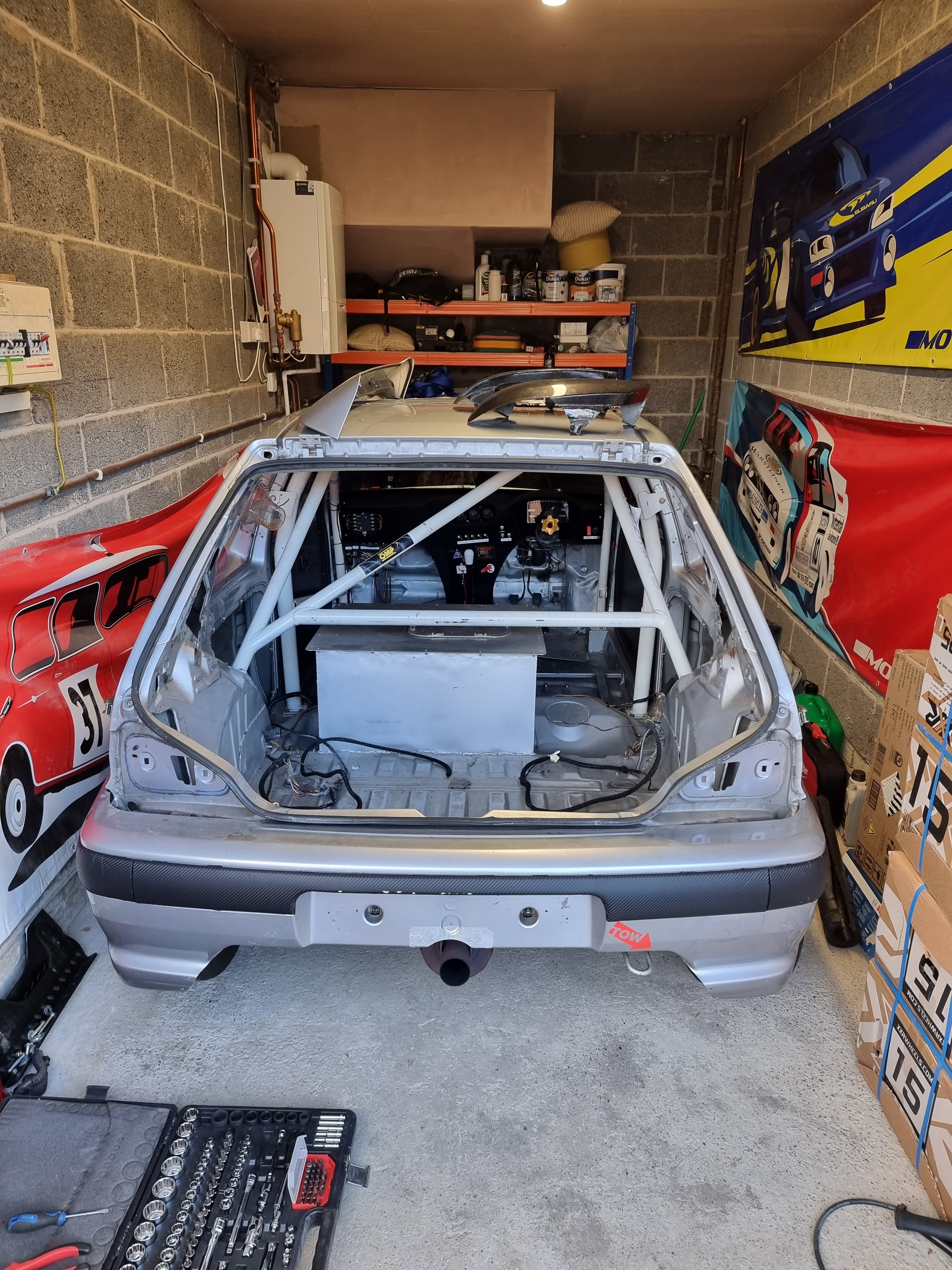

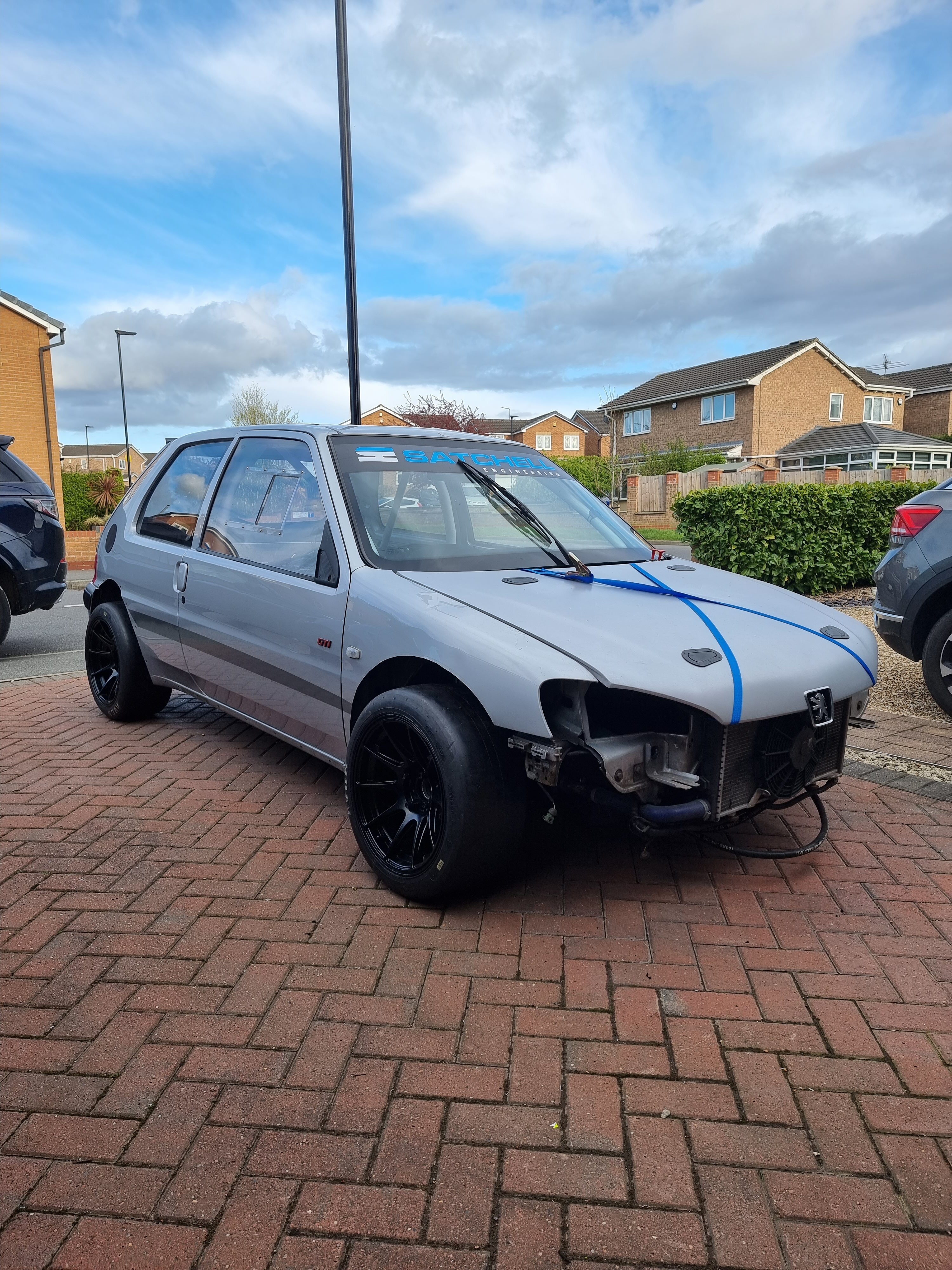

A while since update but little by little, the 106 is getting there, in a one step forward two steps back kind of way.

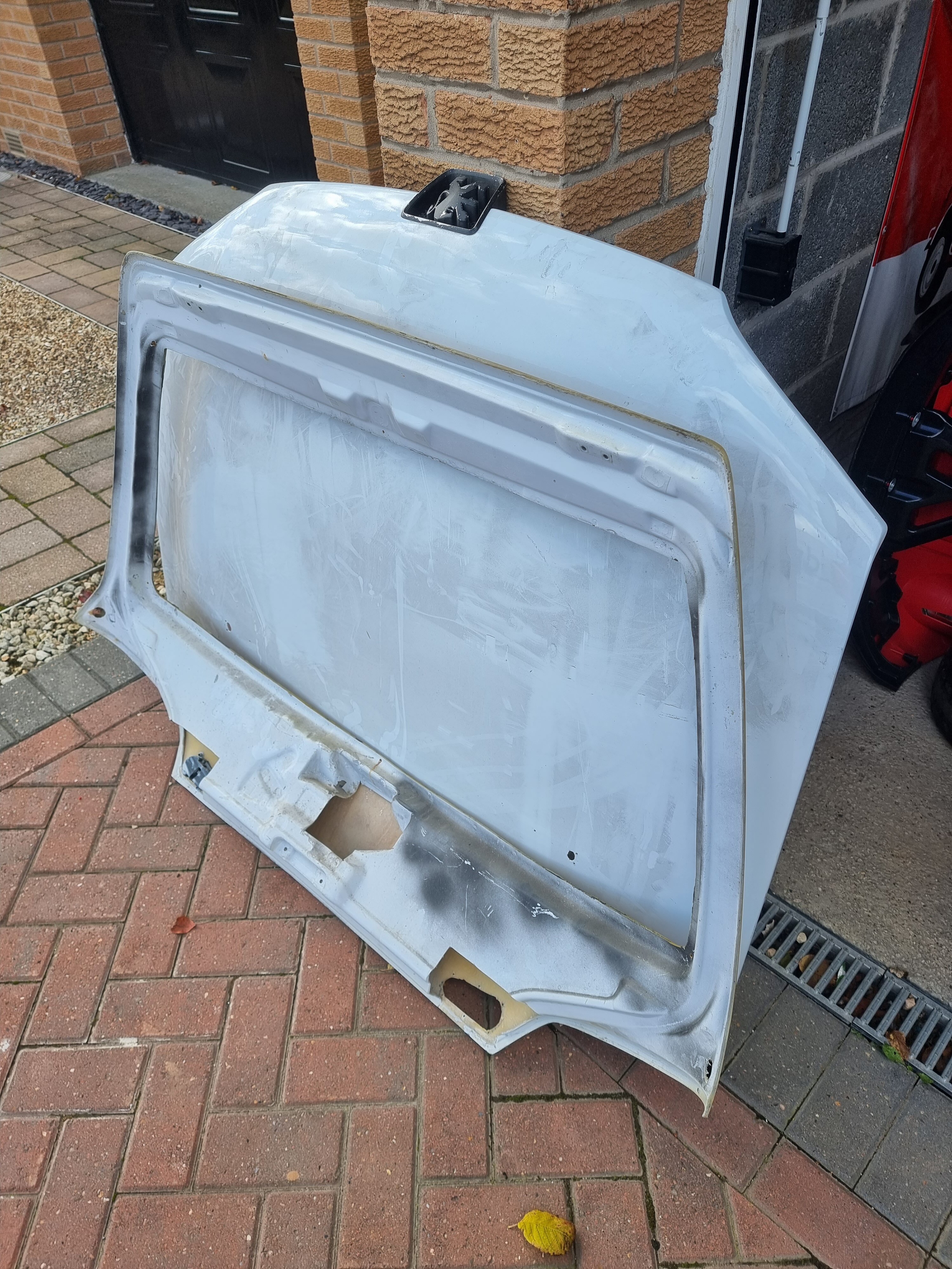

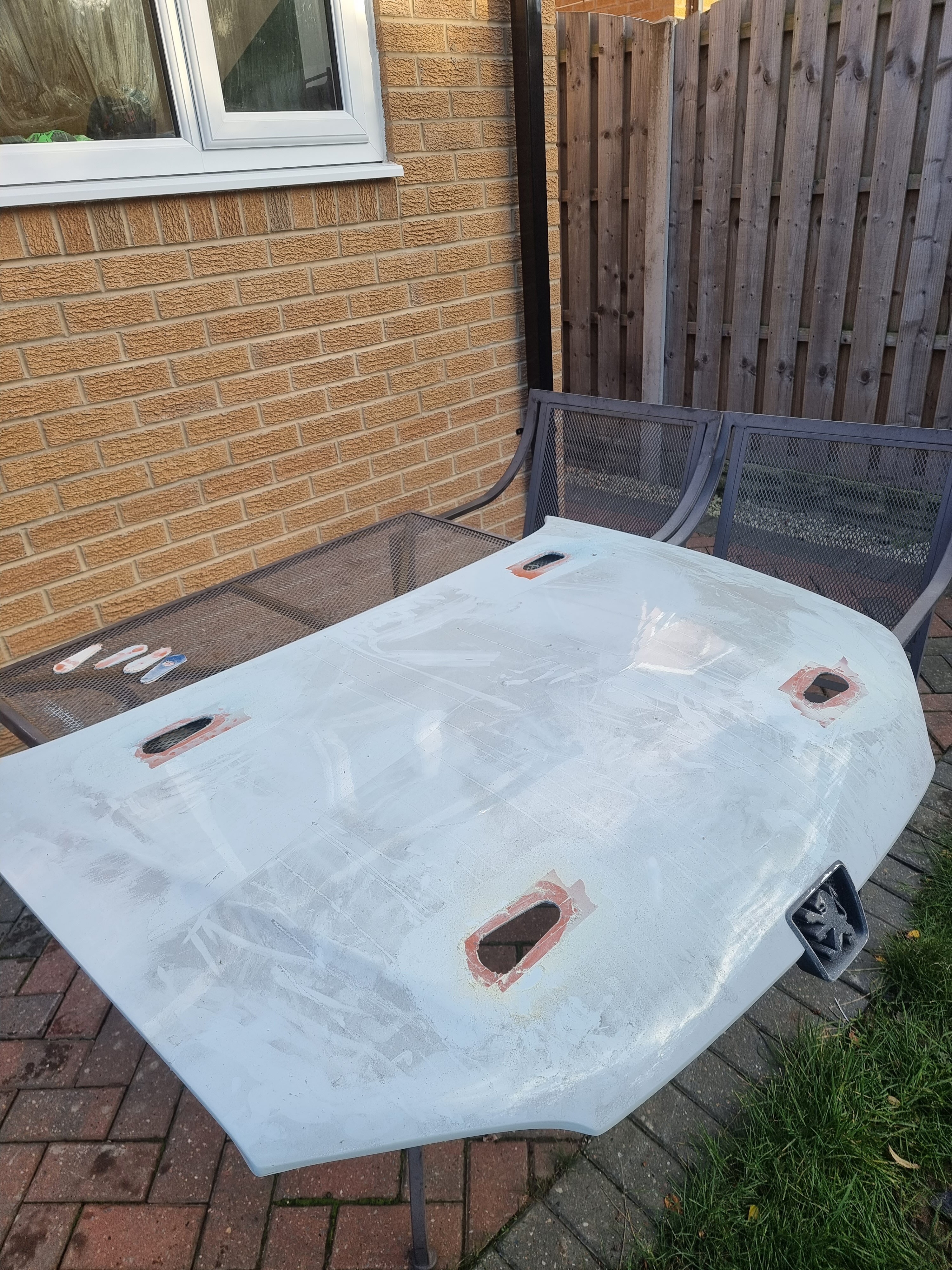

Over winter I rattle canned fibreglass bonnet and boot which came out good enough for purpose. A lesson learned on value of prep and not messing with it mid coats 😂. Removed my carbon wrap and sprayed trim black too. Removed all side trims, skirts and cut back bumpers.
New smoked rear windows and rear windscreen bonded in.

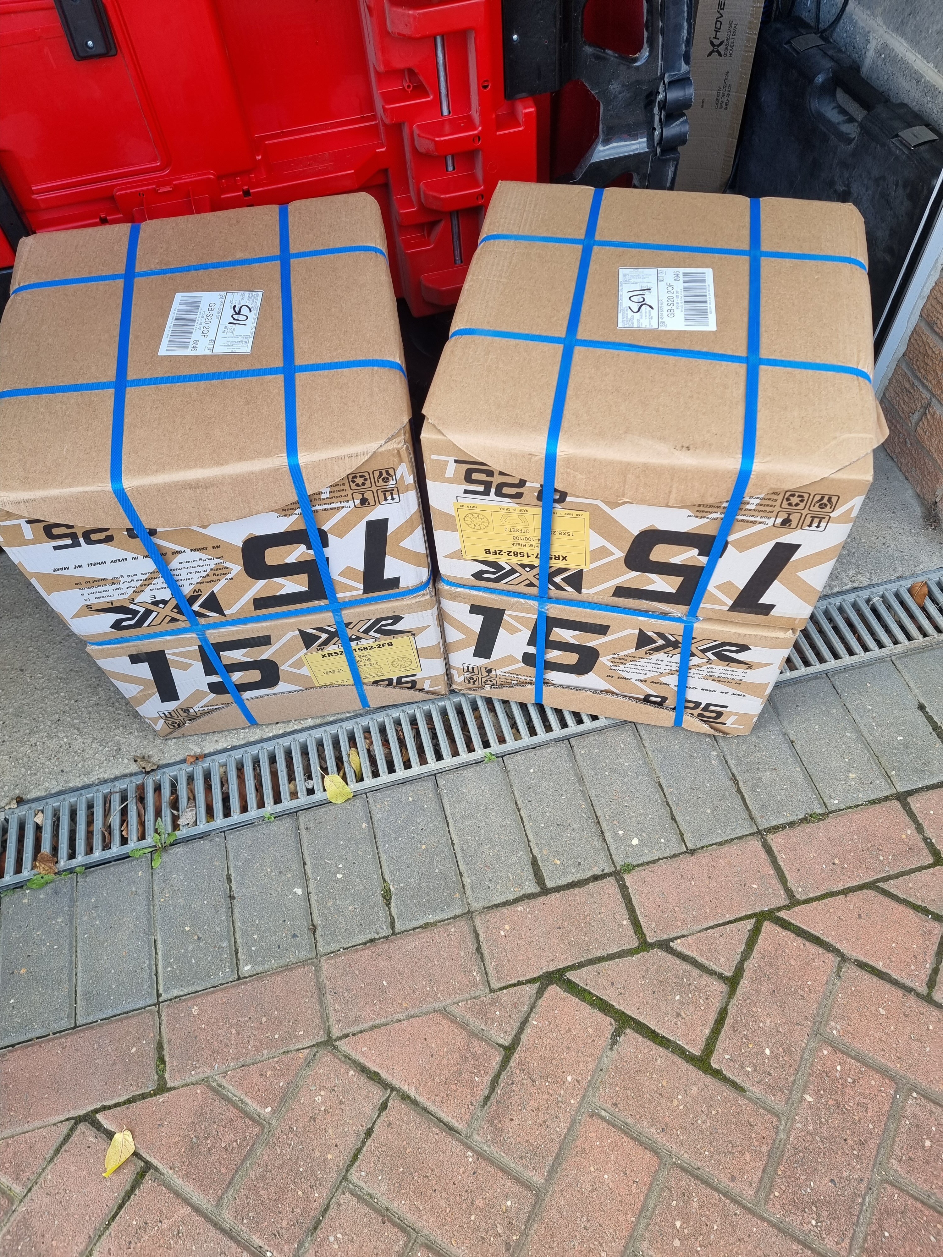

Avon A15 slicks fitted to XXR wheels all recommended spec from Satchell but hit issue with clearance over Brembos. My own fault for not checking just presumed going ET15 to ET0 would cause no issue on inside only outside. Arches cut back easily single skin so plenty of clearance there with arch extensions to bolt on.

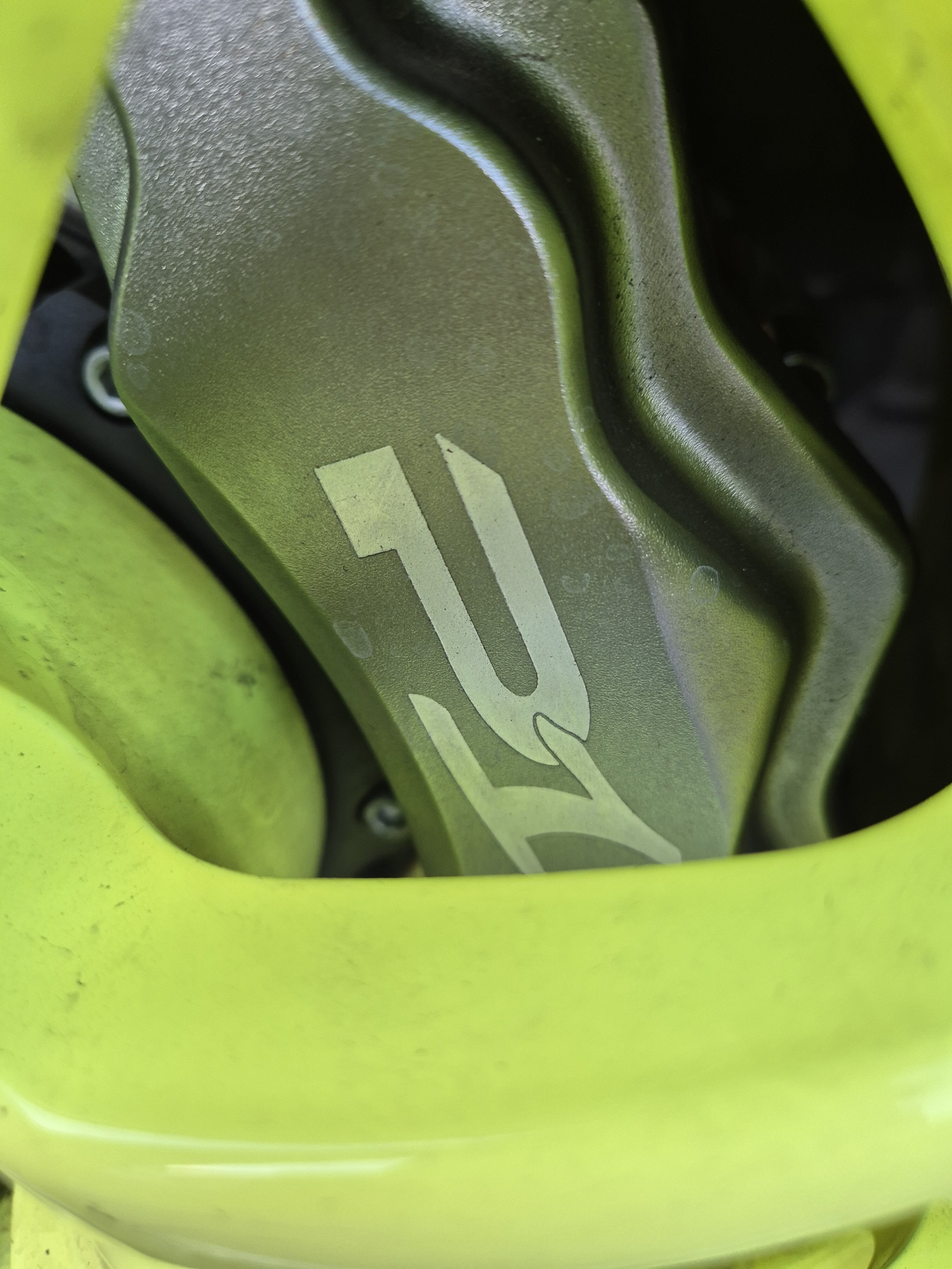

So now looks like selling that setup and getting 106 Super Cup AP calipers only 1.9kg as smallest option with bells and rotas from godspeed will save a chunk of weight and no spacers needed.
Other setback was fire extinguisher service brought up valve issue and Lifeline wouldn't replace so had to fork out for full new Lifeline FIA setup 😪
Remaining jobs are homemade livery to go on, homemade air dam and splitter spolier. Fit arch extensions and plumb in new extinguisher then clean inside and fit seats harnesses and new steering wheel, pedals and were good to go!

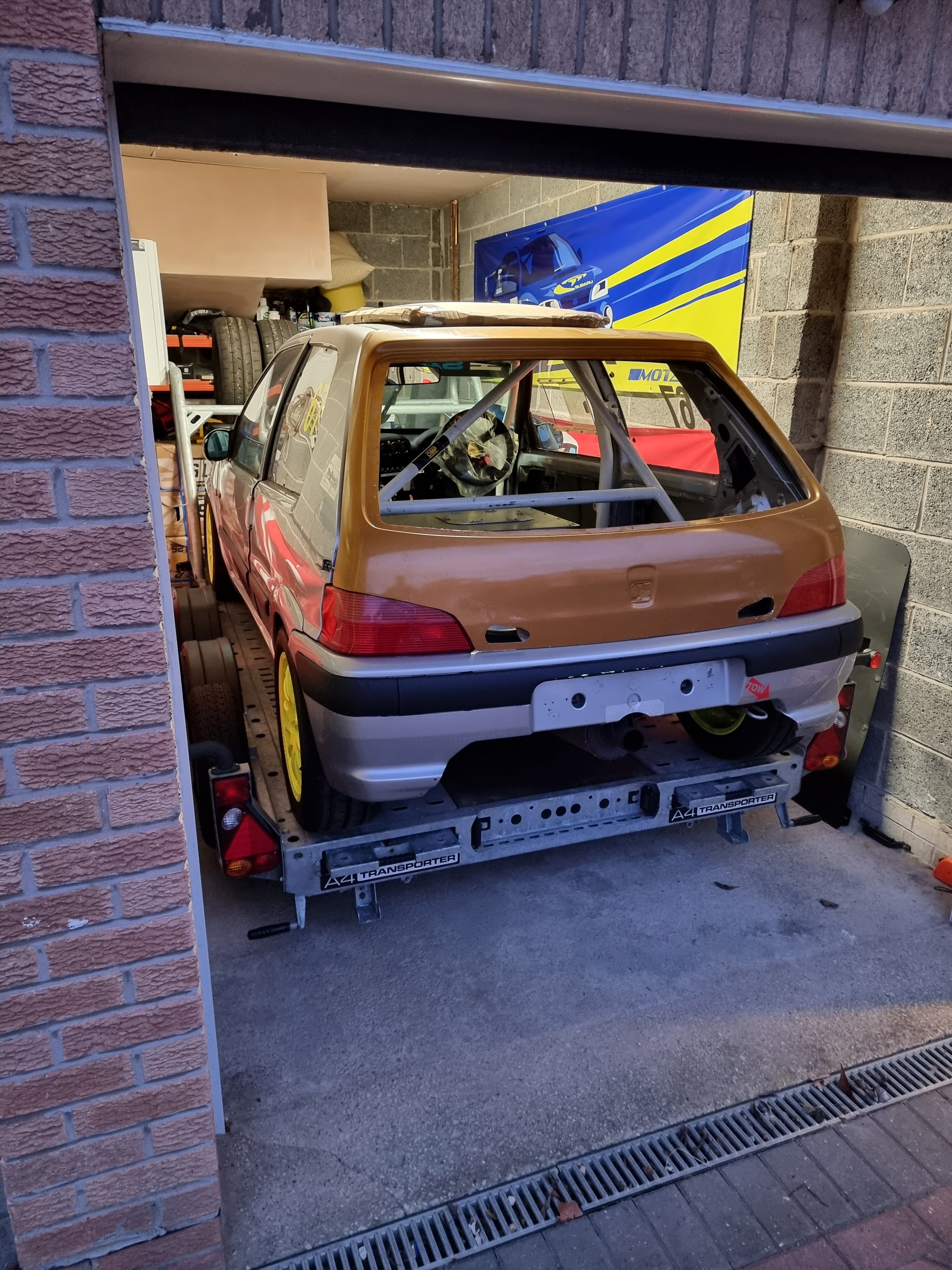

Also picked up the only trailer made that is wide enough to fit 106 on with Pro race alloys on but small enough to fit in my garage. Mm to spare! I must have measured a hundred time before drove to South Coast to collect for fraction of cost of a new one.
I'm aiming for 23rd April first race, planning to do Curborough Championship and some events at Harewood too. As soon as cars ready!

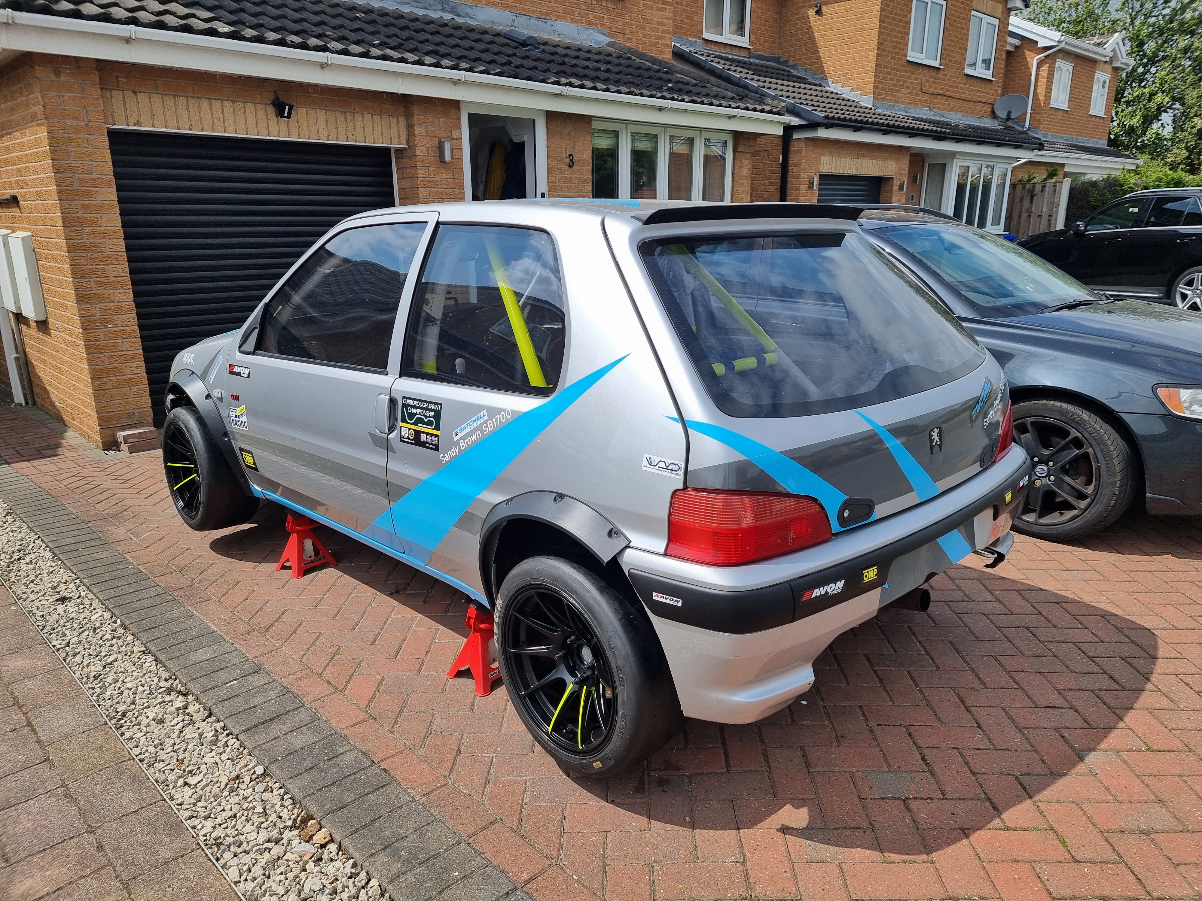

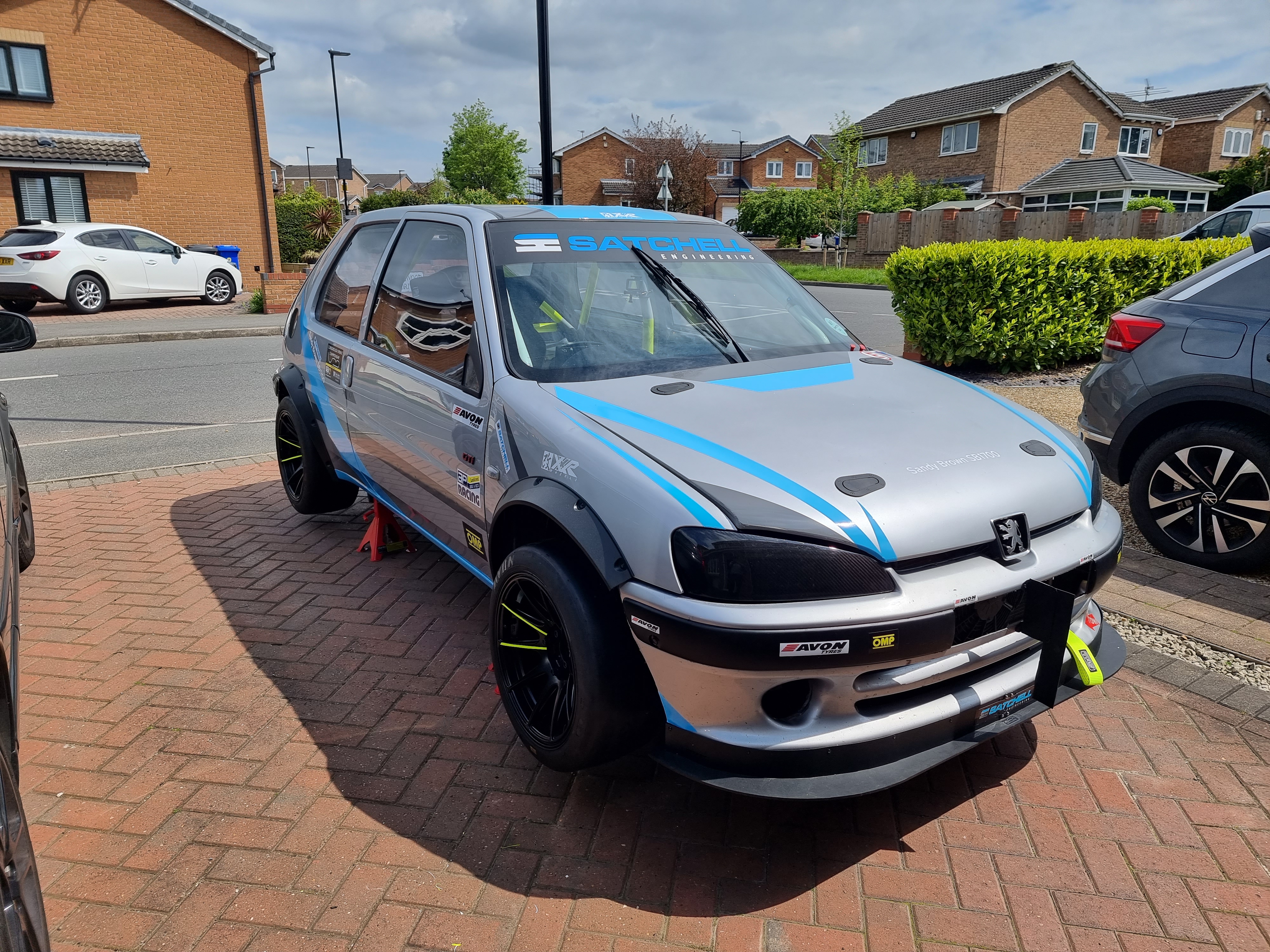

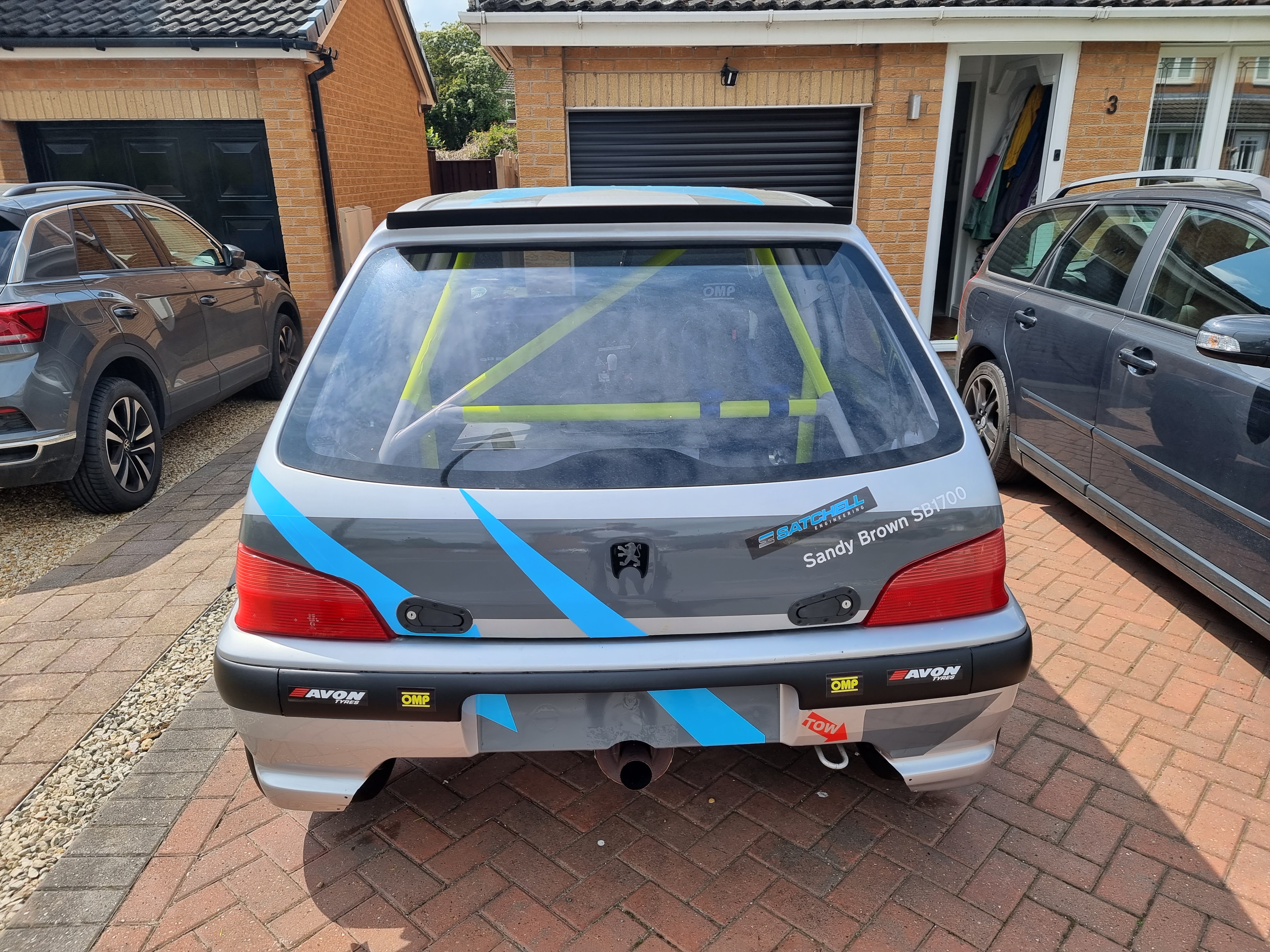

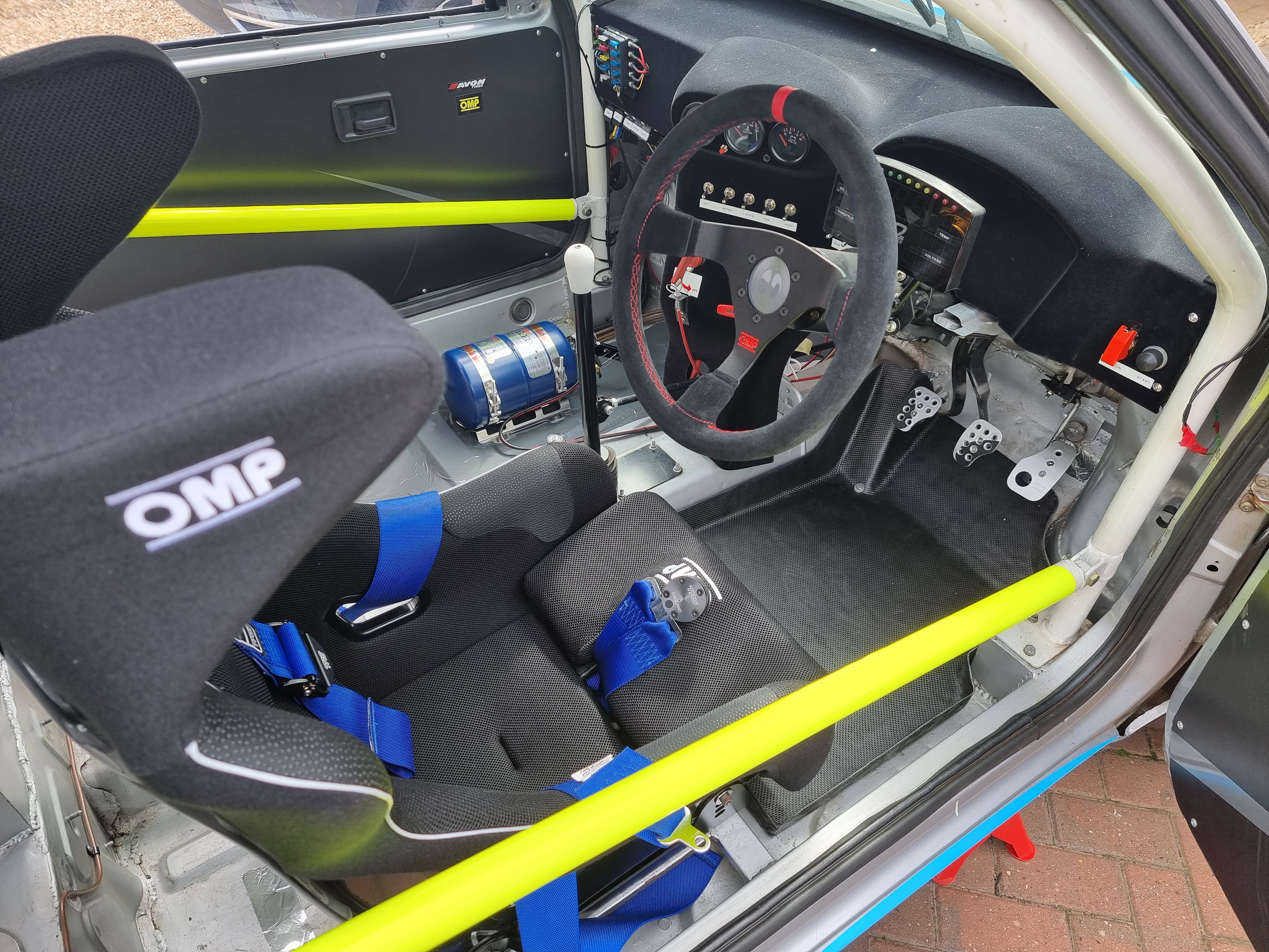

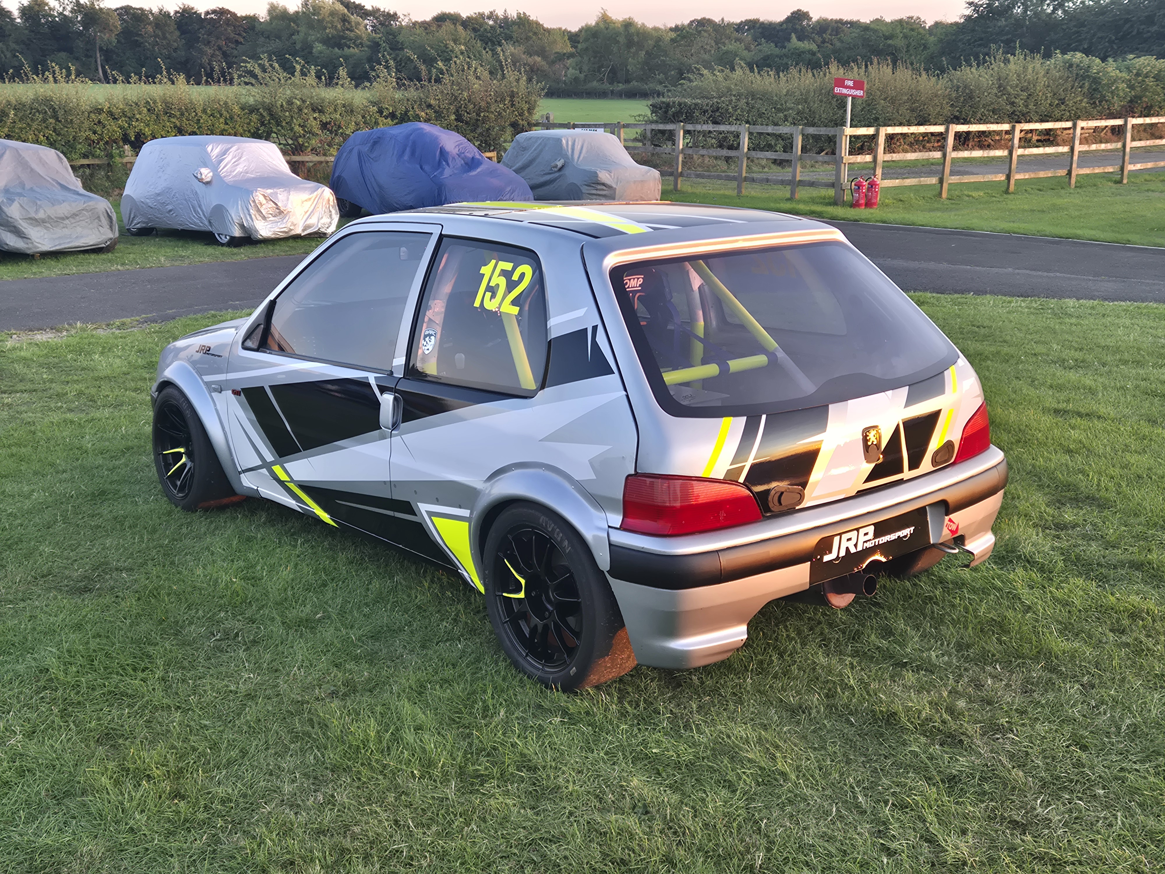

A quick update on work I've done to 106 to date...
Removed skirts
Removed door trims
Removed mirrors
Removed headlights
Removed interior fan
Removed lap timer
Lightened front bumper and fitted quick releases
Lightened rear lights
Custom front air dam and splitter
Custom spolier / gurney flap
Lifeline fire extinguisher
Carbon headlight blanks
Carbon drivers footwell
OMP seat
OMP steering wheel

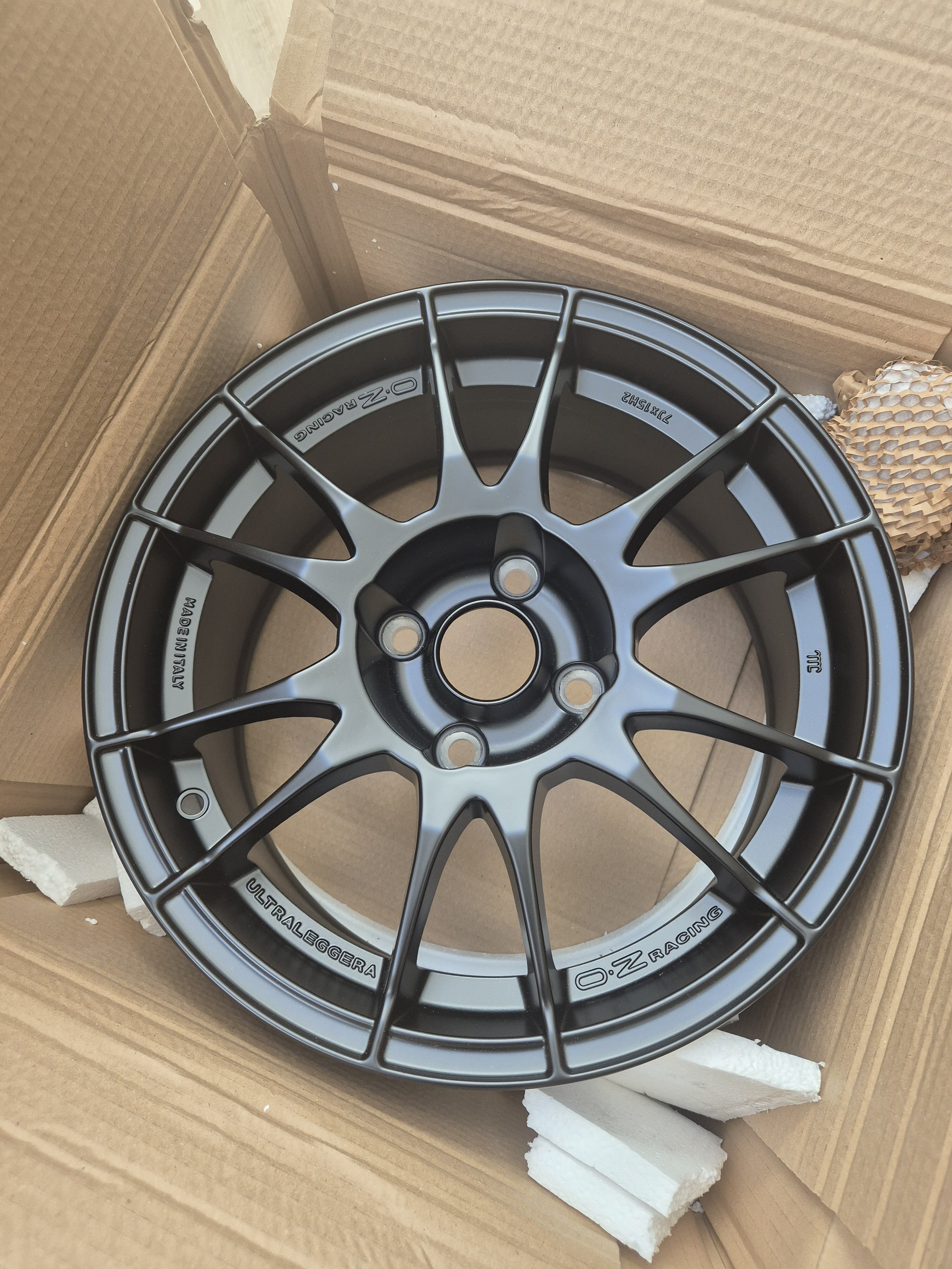

XXR 8.25 wide wheels
Avon A15 slicks
Arches measured many times and cut back once
Cheapo ebay arch extensions
Second hand fibreglass bonnet painted with rattle cans and aerocatches
Second hand fibreglass boot painted with rattle cans and aerocatches
acw light tinted poly windows
New tow strap
Interior deep cleaned and cage partially wrapped
Homemade basic livery and lots of stickers
Service and OEM filter
New crank sensor
New NGK plugs
All done myself so it's taken forever and some things went wrong but learning as I go! Will do better next time.

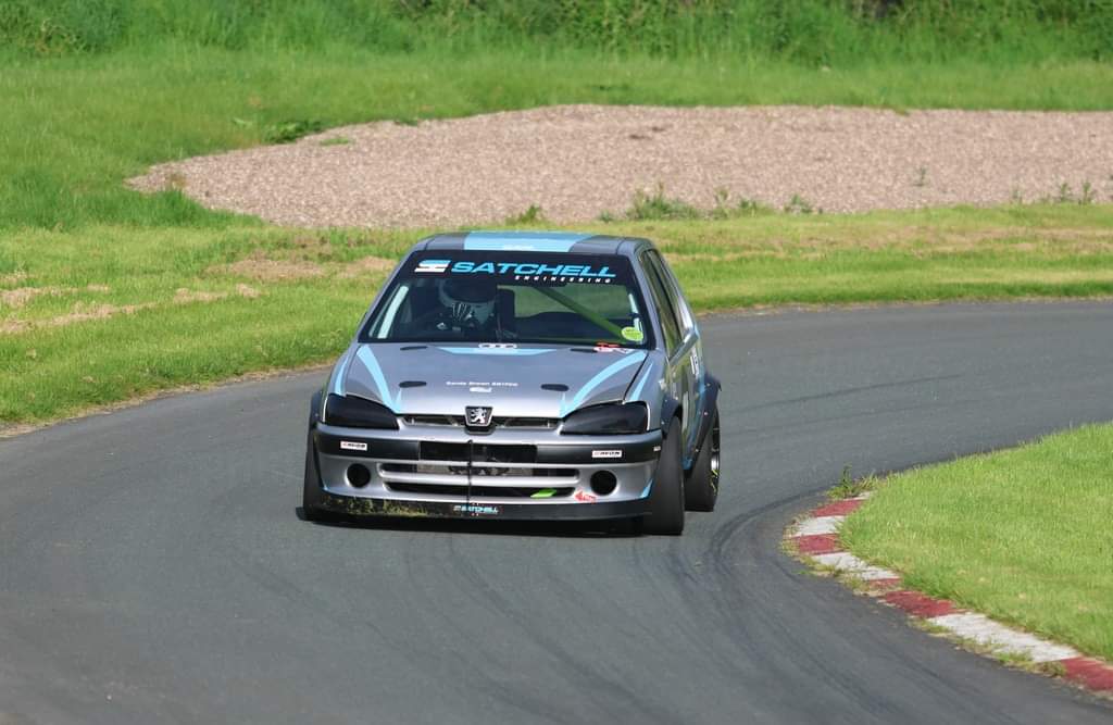

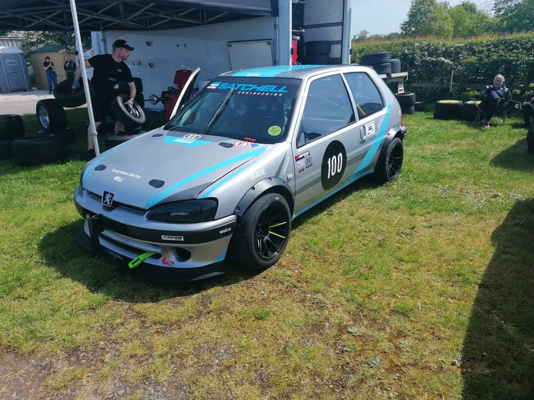

Some pictures, it's a looker even if say so myself...

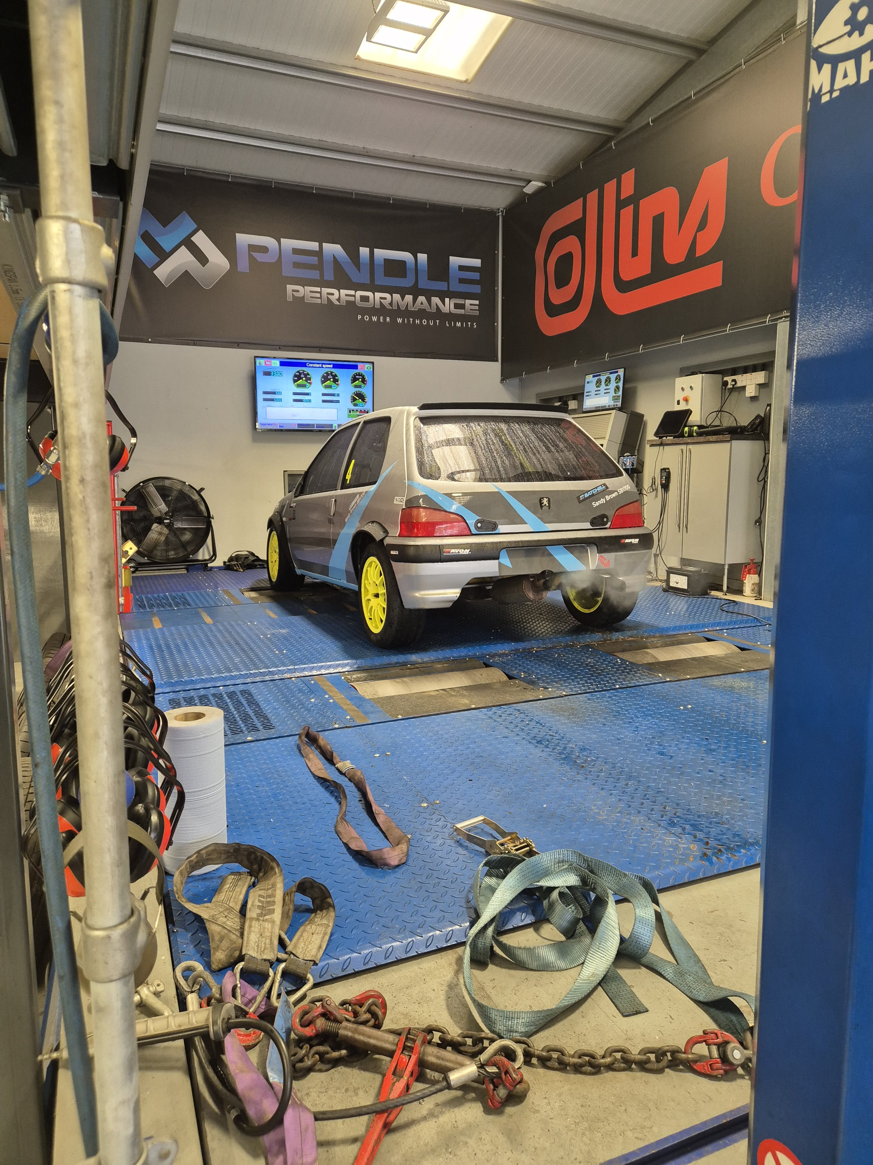

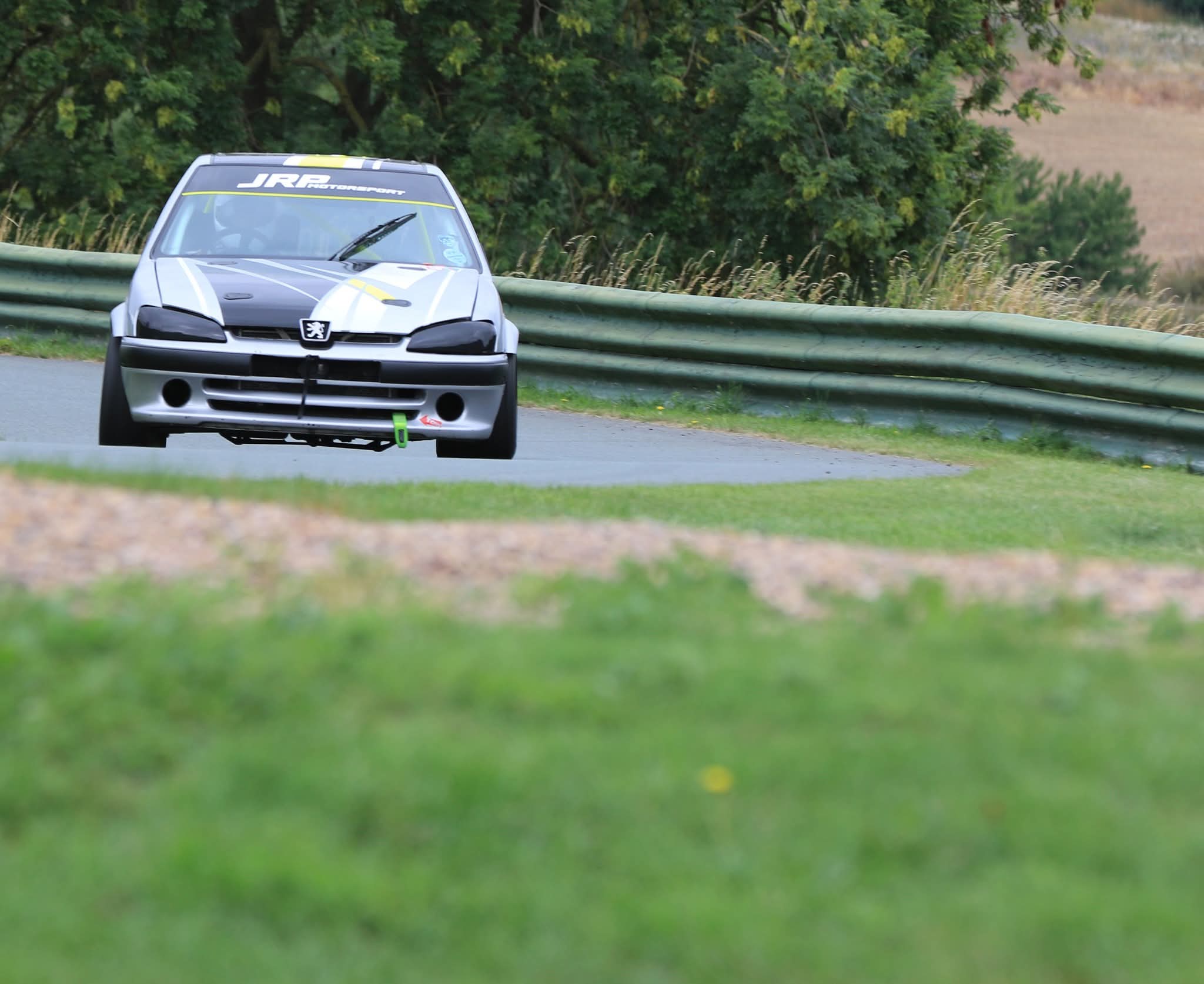

I fitted the diesel starter and took the car on a 14 hour round trip to Truro for Sandy to check mapping. In hindsight after power nap in Volvo and several cans of monster to keep going I should have stayed over but worth it, what a top bloke, learned loads was worth the trip alone plus found all to be well with car, very health numbers and he did few tweaks to improve start up and found a few extra bhp. Only issue was lift pump died on final power run but mapping was finished so called it a day. New starter with mapping worked perfectly multiple hot starts no issues.

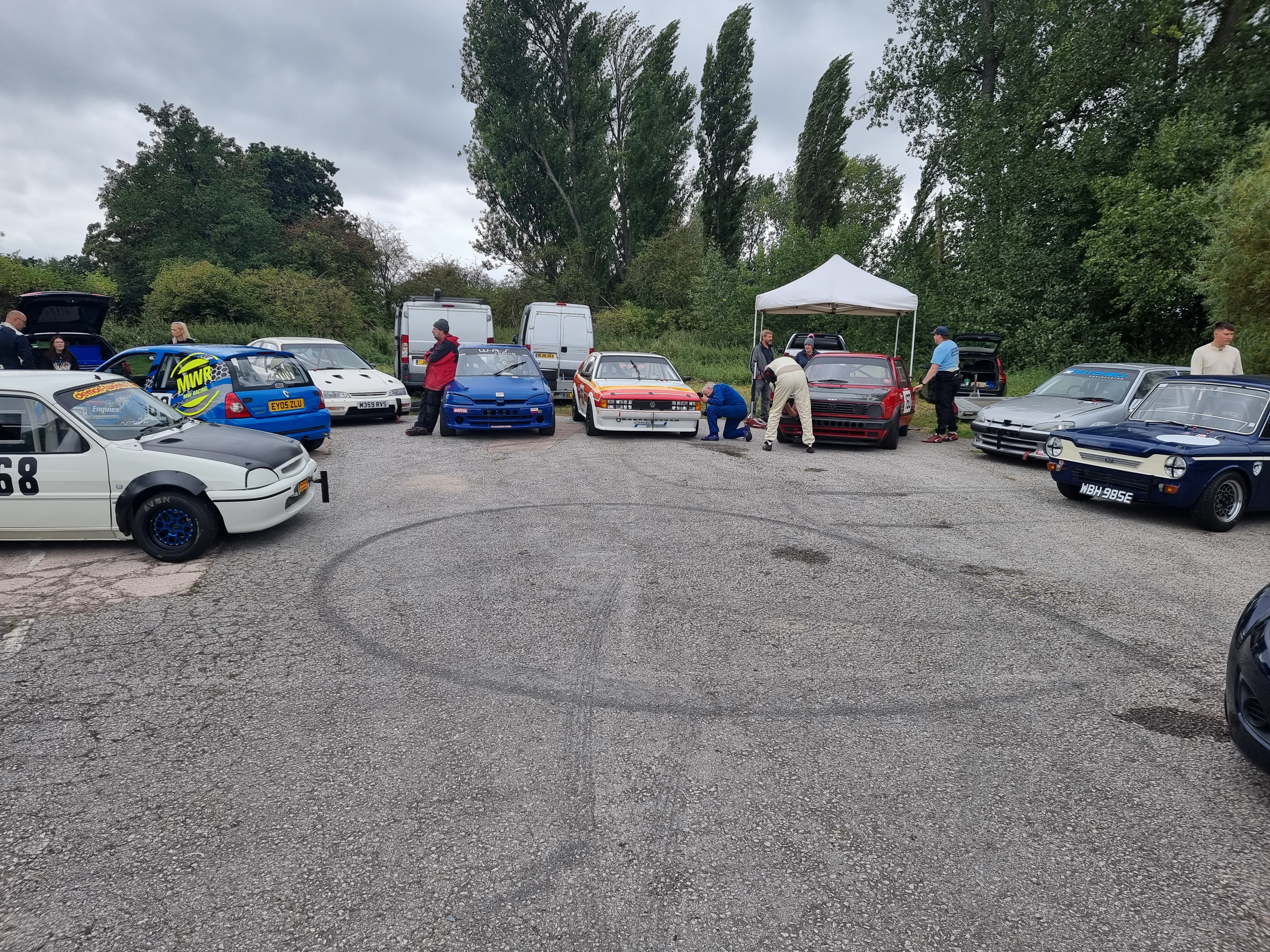

Then went on track day with Sim Racing friends to shakedown car, finally heat cycle slicks and check lift pump all sorted. A fun day and got what I needed out of it but only a couple runs to ready for Harewood. Very cool Formila G winning LS swapped MX5 was there and met Cliosport/youtubes RuskiWeldFab who was testing his new MR2.

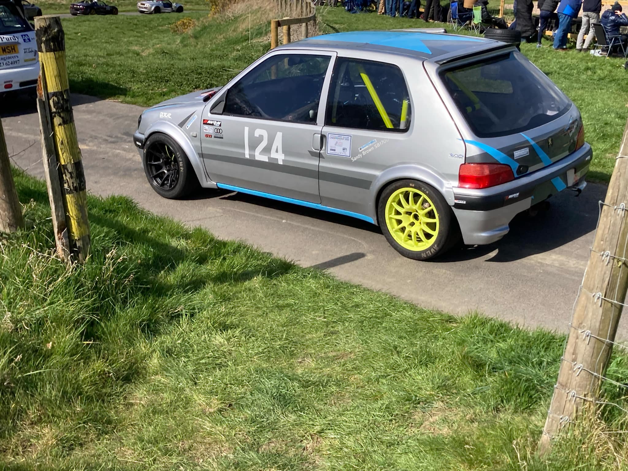

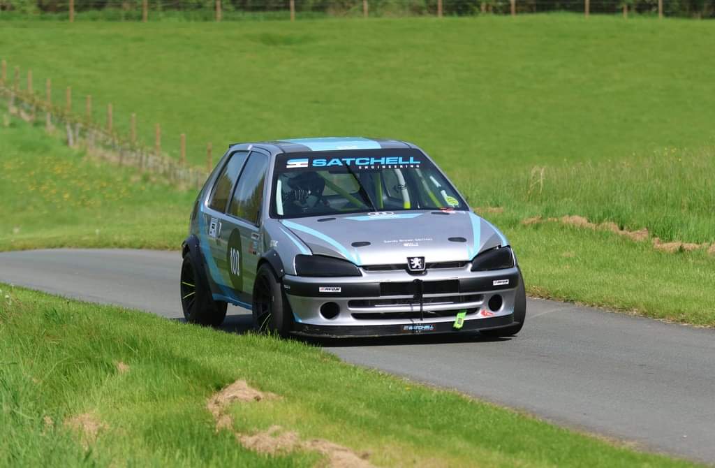

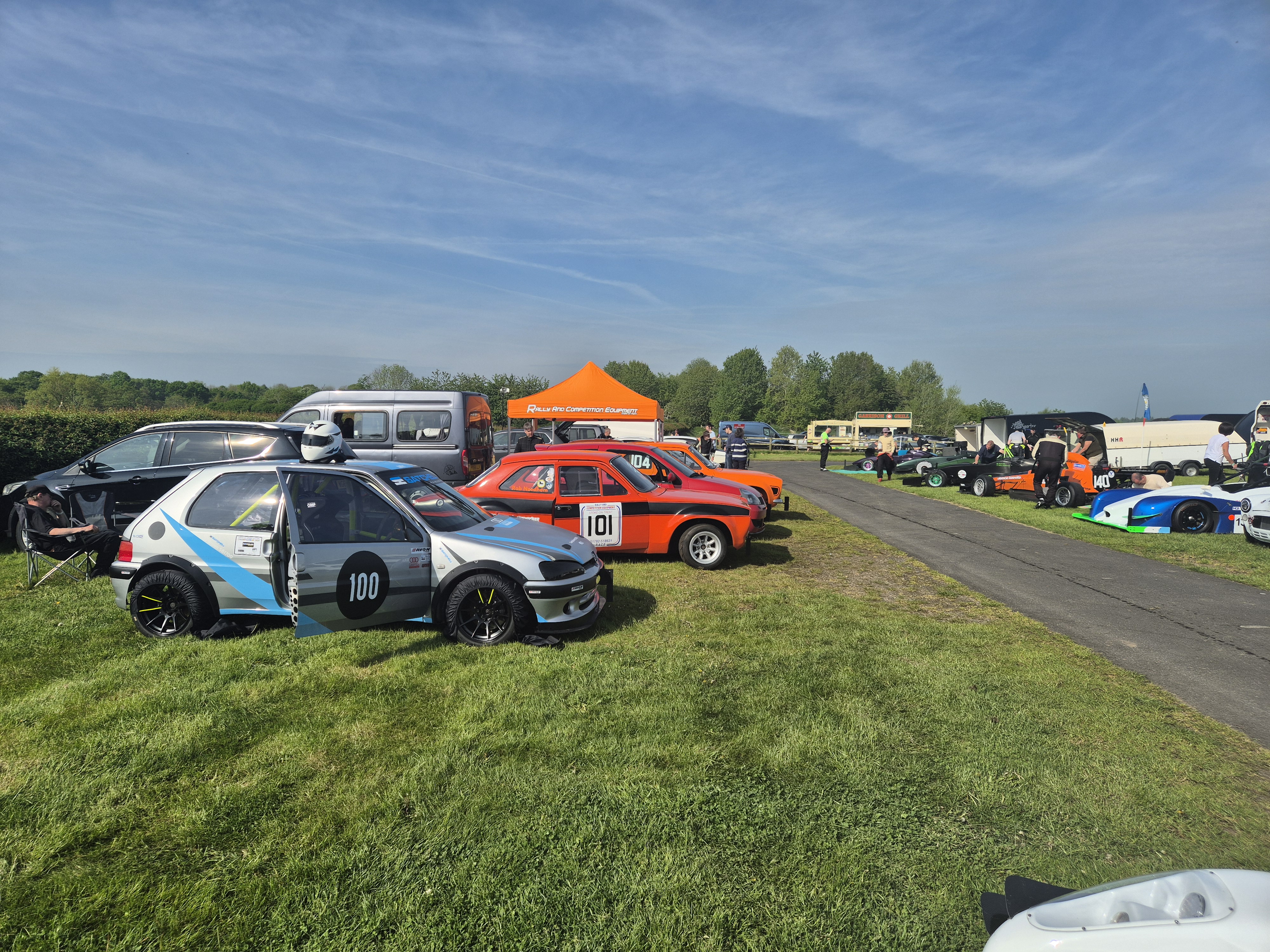

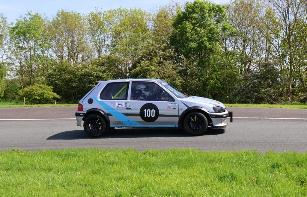

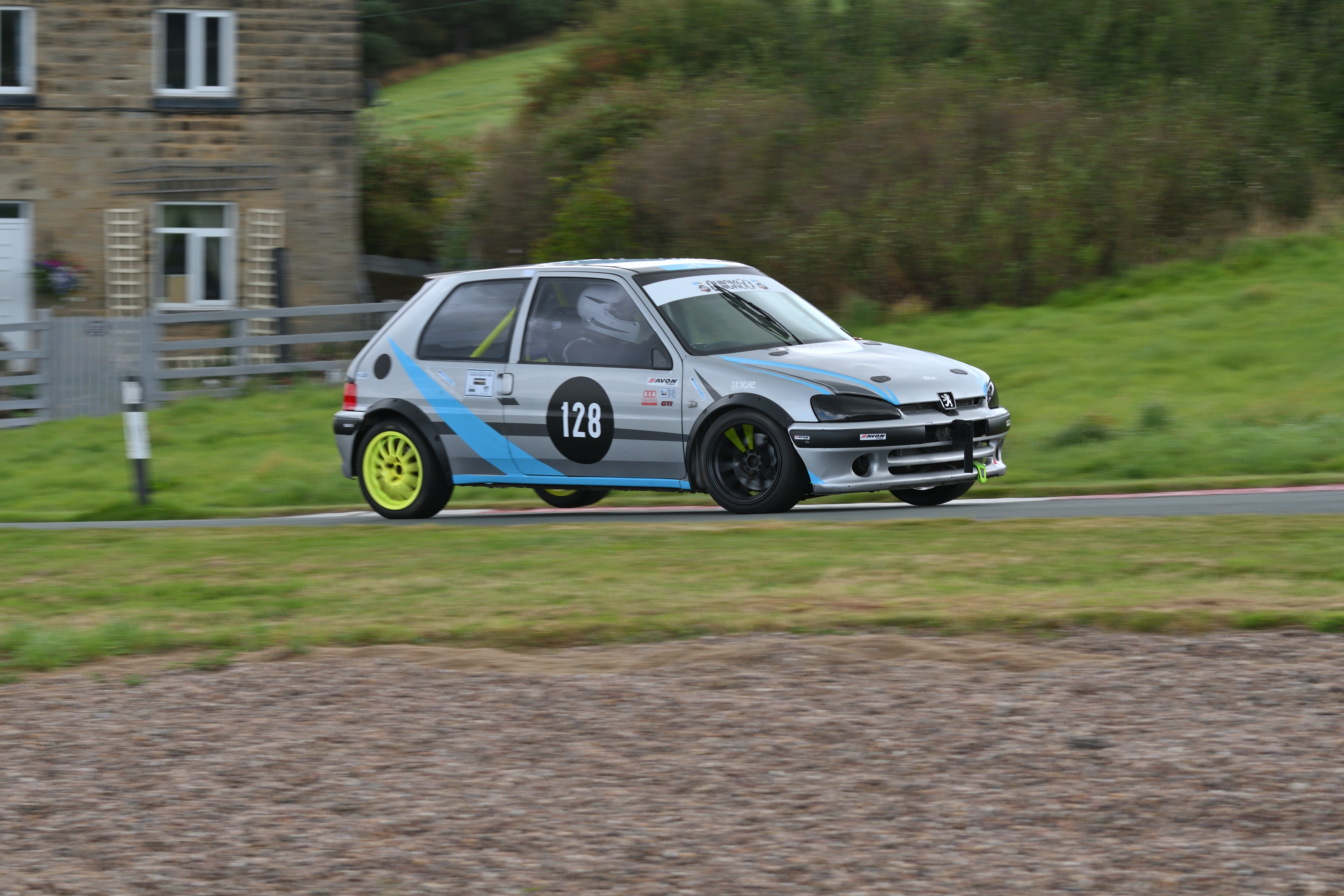

On 11th May finally just done my first race at Harewood Hillclimb was all worth it great fun, I finished 0.9 seconds off 2nd place (top 2 get trophy in class of 7) which was ok but frustrating as on my final run I was well over a second up on splits but went into 4th instead of 2nd at hairpin and soon as realised chance of trophy was gone for the day. A big confidence boost that there's is time in the car and not million miles off so next ones on 9th June. One cool bit was live stream on YouTube clip below you can see/head when I bog down in 4th. A lots of quick cars including top 2 in my class who also run the day after for British Hillclimb Championship.
I played with tyre pressures which helped but cars running so much camber and toe out it's great on open smooth track but narrow uneven hill it was hunting every imperfection including me going off on grass on straight, see splitter! I think I'll remove splitter as too low for hill and get alignment parallel and bit less camber more caster.
Also picked up a bargain AiM Solo 2 DL and Smartycam GP HD worth couple of grand for £300, was unwanted on someones motorbike but only needed me to do software and configuration updates plus new CAN cable and that will be my new dash/camera setup for next race including live few of lap time delta and videos with embedded data to look at after. I'm data engineer by trade so wanted to play with this side of things for ages for my own curiosity.
Anyway here's a few pictures and link to video...

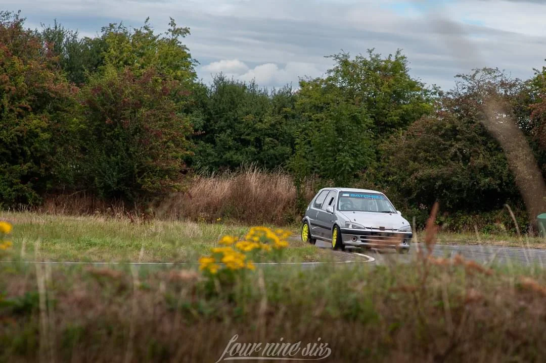

Forgot to do updates for a while but had a good year getting faster all time at all tracks, best result 2nd in class at Harewood was highlight with still time in the car.
Quick60 was fun got into quarters before knocked out, seeing Gobstopper 3 in person was so impressive, so quick and planted.

I've treated 106 to new livery as always wanted to have one designed and fitted at local place that does them, won't make me any faster but it looks flipping cool to me.

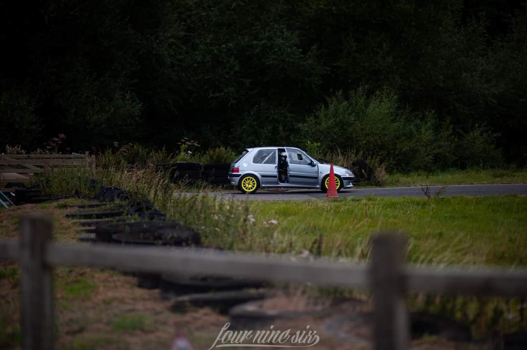

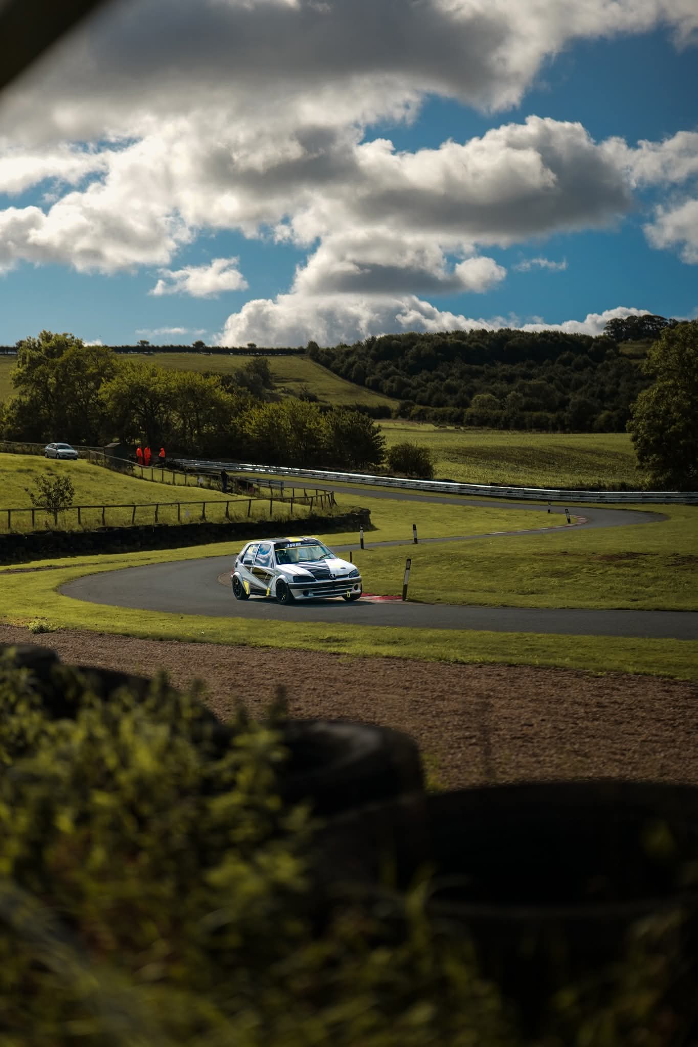

It was a close one but won again with another PB at end of August Summer Championship race so 6 out of 6 now and Championship is best 6 of 8 so effectively won class championship if they did them. I got a bit famous as the cover car for the event too.
Even had one of academy instructor in my class who's done masters etc so kept me on toes. To be fair his was essentially a 1b car just on rubber not allowed in 1b.
Final double weekender is coming around fast then decide what to do, different championship or different car in 2026, ie is it RWD time?

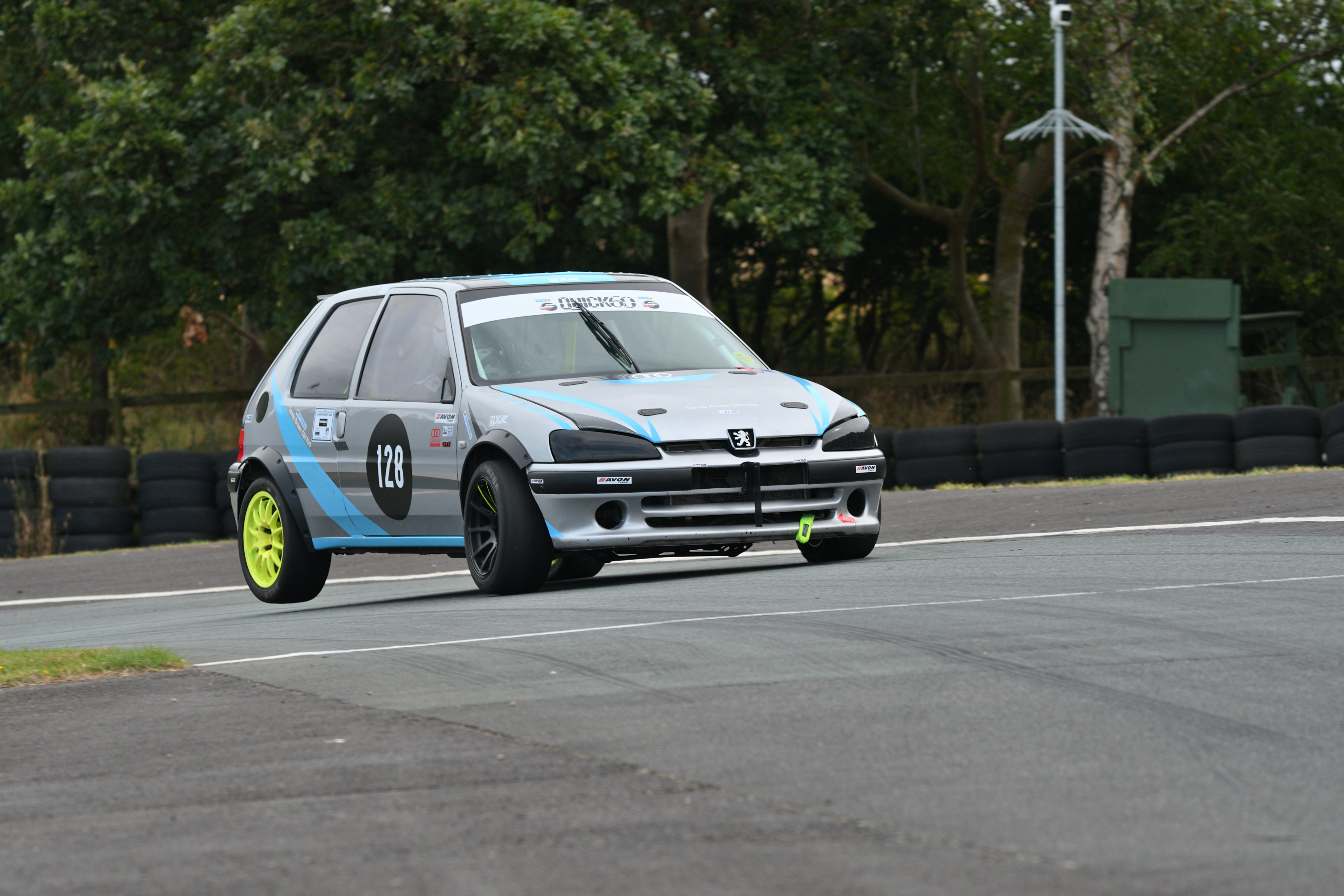

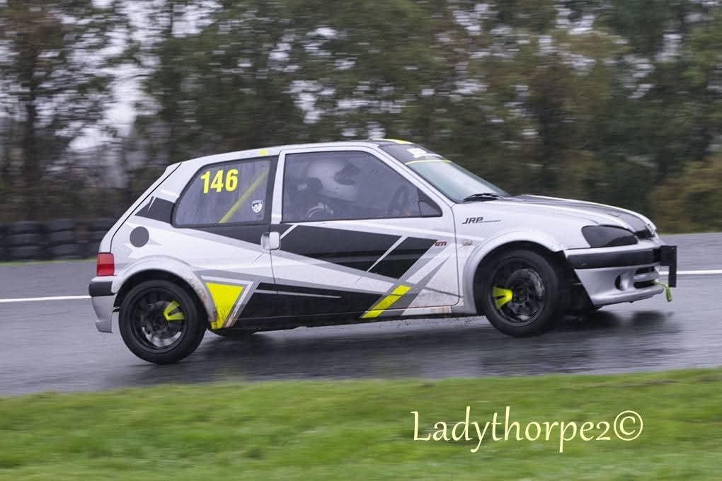

2025 Harewood Championship final double header 2nd place both days, torrential rain on Saturday was leading then went off at esses, then Sunday couldn't judge the grip on washed track.
So thats a wrap on my first full season in 106, here are the numbers...
6 x class P1
2 x class P2
8 x personal best times
1 x FTD top ten
3B class champion (not an award at Harewood sadly but I'm claiming it haha)
19th (of 201) overall Harewood Championship
