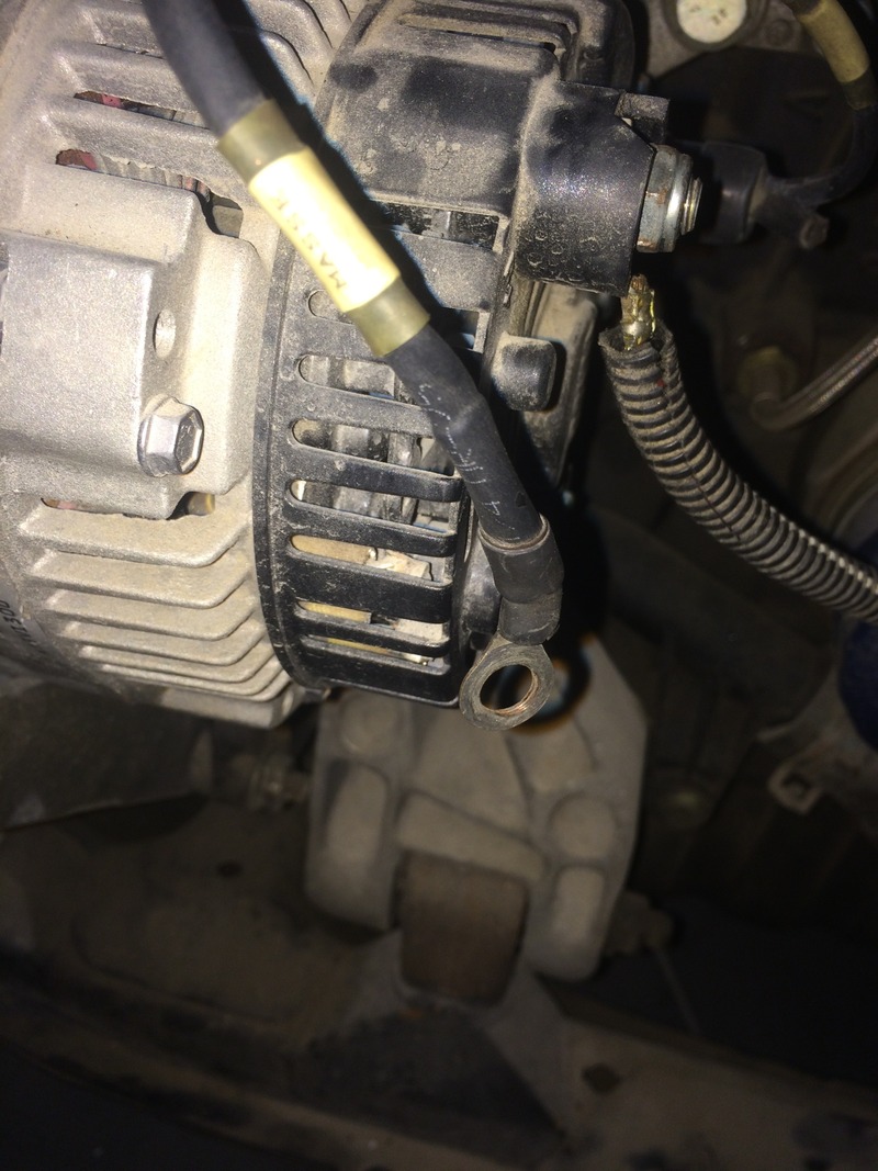

Problem sorted with several 260km round trips to check the wiring/voltages and pin-outs on the other local car.
Turns out the garage which did the swap put the engine earth terminal onto the alternator fed. Once the offending terminal was removed and earthed to the engine bingo.

Hope you wont be taking you car back to that garage again! The earth goes on that bolt in the top right hand corner btw, I'm guessing that's where you put it anyway.
  172 Cup Race Car
The nearest and easy point was the alternator bracket. I will swap it when the car get returned as we need to do bit of prep for the mini endurance races.
Actually one of the few decent garages here but for various reasons both personal and business they sub contracted the engine change to a garage beside them, who where the ones that put the wire in the wrong place. Also auto electricians do not exist here it seems that's why i can top go back to basics and sort it my self.
