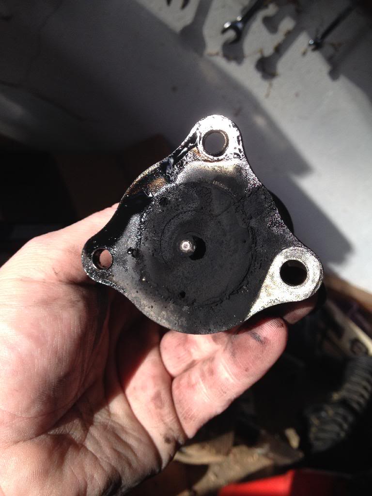

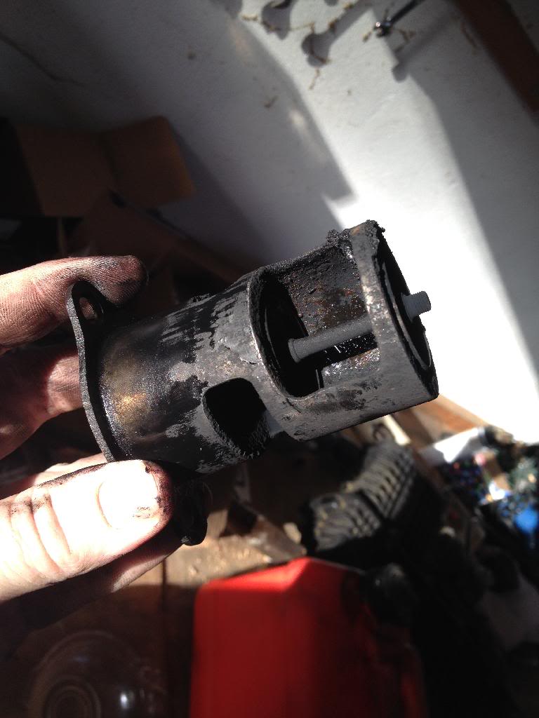

see when I took the egr valve out I watched a guy on YouTube, I later found it was only half that I took out (as was video), possibly the rest of the valve is causing this, below is a picture of all I cleaned:

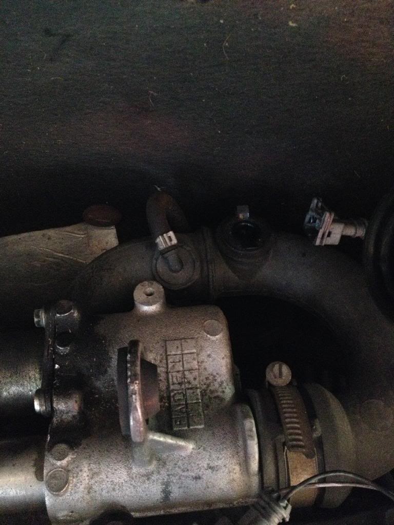

Take it this is the rest which didn't come out with my valve:

egr in two parts, first bit is the soliniod valve for control of the actaull valve. the second bit will be carbonised up so will be stuck in the egr casting.
it will come out, clean it spotless and make sure the valve can be opened by hand or the solinoid wont be able to push it.

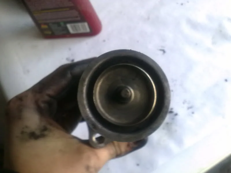

firstly started off with the EGR valve again, and ensured I cleaned the who thing this time, I did notice however a good wee but of oil around it, don't think that is common:

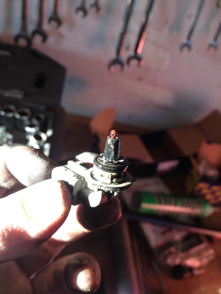

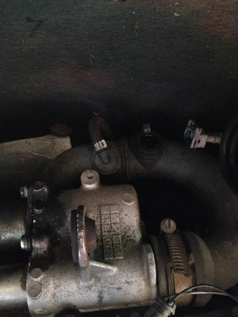

Also found this (I assume) a sensor of some sort in that pipe from the EGR, thought I would check that also to see and surely enough it had oil plastered around it as well, does anyone know what this sensor is?
now if I am not mistaken this pipe leads to the turbo? That would mean oil would be getting to the turbo and burning however there is definetly never blue smoke coming from the car, only the usual puff of black smoking when u belt ur foot down (which I might add I rarely do as this was bought for continuos motorway journeys up and down from uni)

A little bit of oil in the EGR is nothing to worry about. I'd only worry if you were finding puddles in it lol, then your turbo oil seals are probably on their way out. The oil you're seeing is just from the crankcase breather, which is connected to the black pipe coming from the turbo (hence the oil in there too).
That pipe is the boost pipe coming from the turbo which leads into the inlet (via the egr), so the oil in that pipe shouldn't end up in the turbo.
