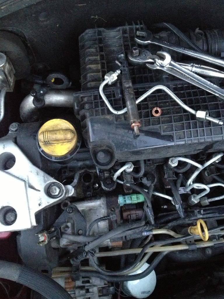

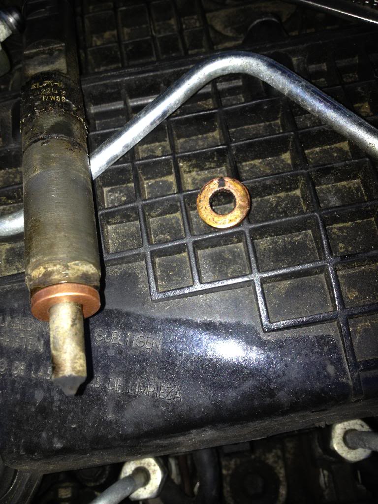

Look like....
Nice dirty job too
Thanks, the pics will help.
