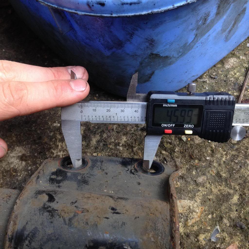

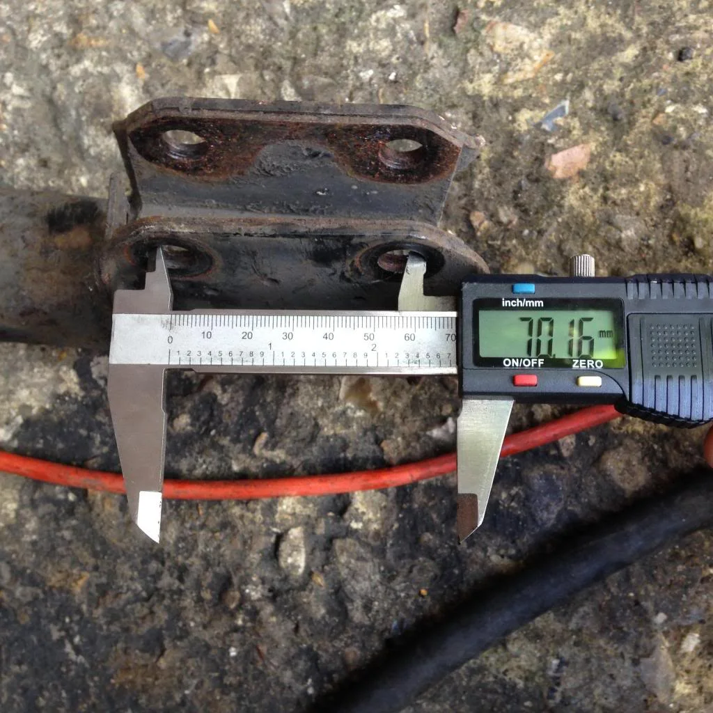

I'll have a measure of my old struts tomorrow.

@starmagsi Lovely and sunny at my abode so here you are :) Averaging gives 58mm

dci will 99% have 58mm spacing ive never in over 30 cars saw a 52mm one not sure where these apparently were?! im not sure if ph1 cars had 52mm but ive saw Y and 51 plate ph2s that all had 58mm!
