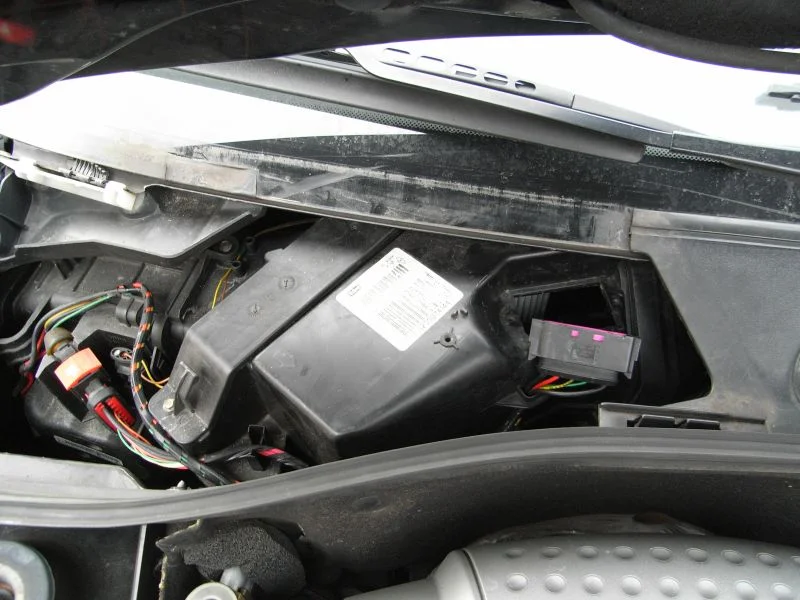

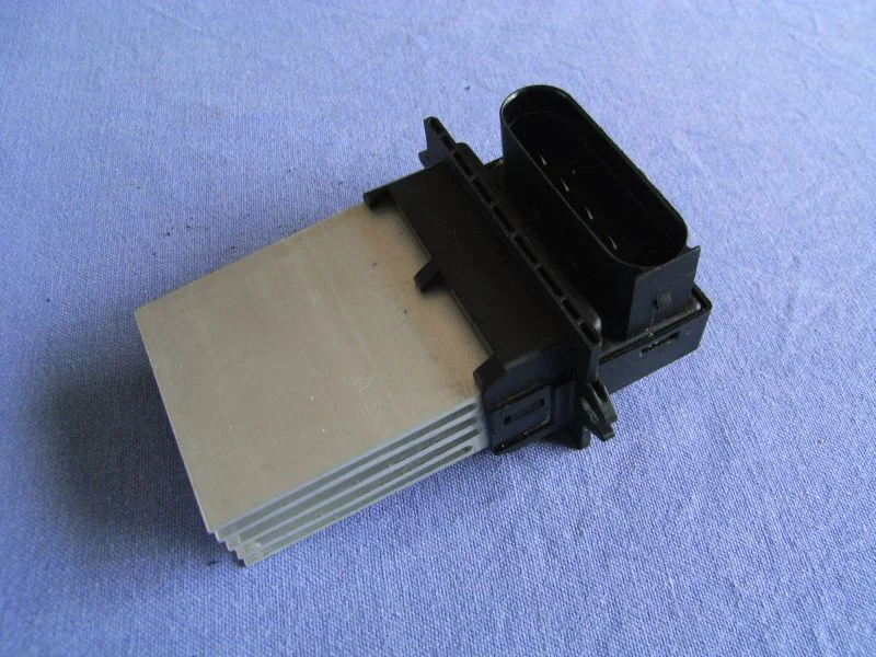

Yeah, I had the same problem a few weeks ago. It was the heater resistor pack as you suspect on your car. Its placed on the drivers side, under the plastic bit between the windscreen and engine bay. I'll see if I can find a pic in a min. I got a second hand heater resistor pack from french spares for £35 delivered. Look them up in the yellow pages or on the net.
  987 Boxster S
Pics. :)

Is it worth taking this bit out to check it? Or will it just be buggered and thats that?
Is there any other way to diagnose? I read that sometimes you get the lower speeds but not the higher speeds when the resistor pack fails is this true?

I bypassed the resistor by shorting out the far left and far right connections on the plug with a piece of cable and the fan went full speed. This proved it was the heater resistor that was buggered. If you have checked the fuses and everything else then it must be the heater resistor. Common problem with french cars??

Took the Rheostat out this morning and bridged the 2 outer pins of the plug which made the motor run, so it's fairly safe to assume its the Rheostat thats at fault.
After phoning round local factors/Bosch agents/Lucas agents etc, it seems that despite the fact that its a Valeo part, that it can only be bought through robbing Renault. So ordered mine at 'mates' rates, but still costing over £80.
Will see if that fixes it. Part is due in Thursday.
