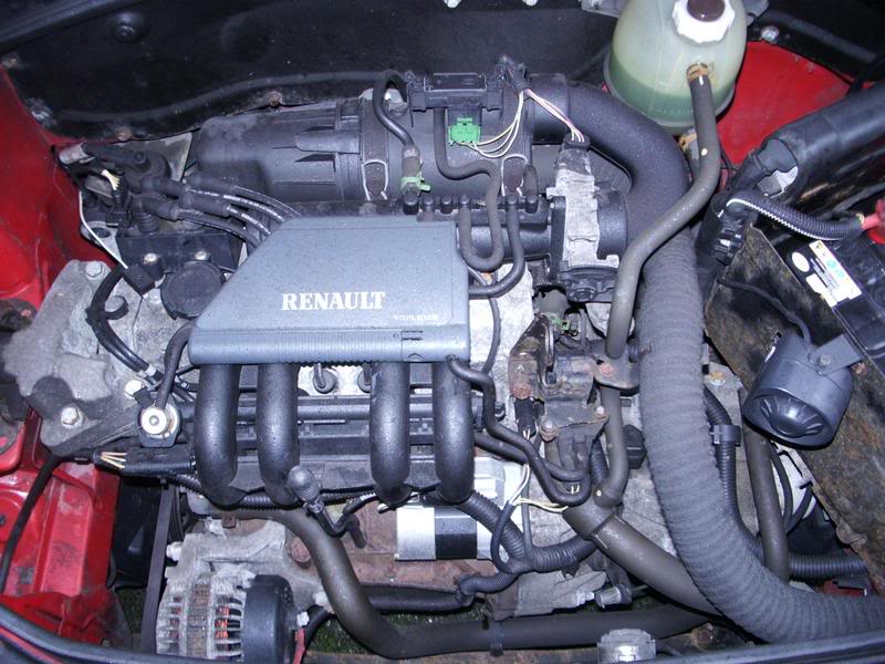

Youll have a d7f engine if its a 98 1.2 8v as below.

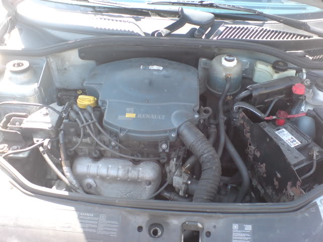

1.4 8v have e7j engine code and usually look like this.
