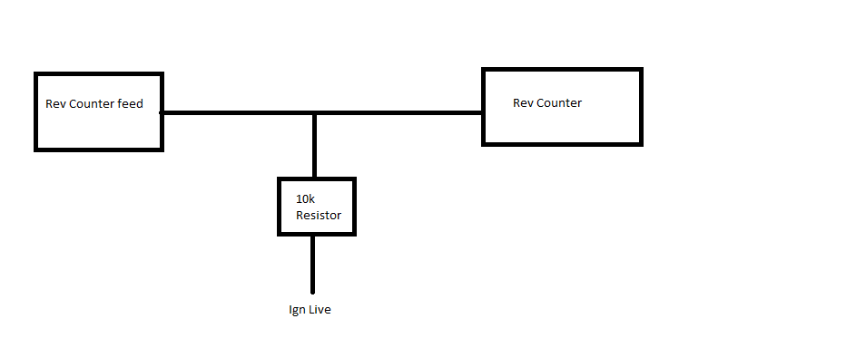

edit:
I know about the 10k pullup is this the correct way to wire it and is there any specific 10k resistor I need to buy? I noticed that maplins sold 10k resistors with different w ratings.
