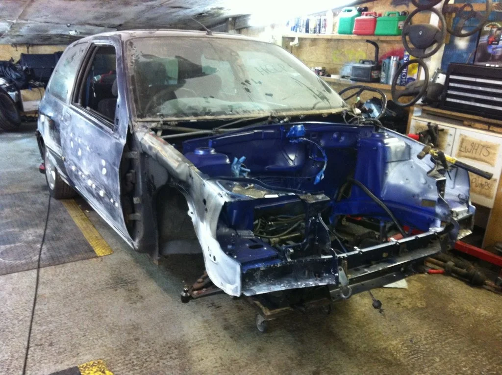

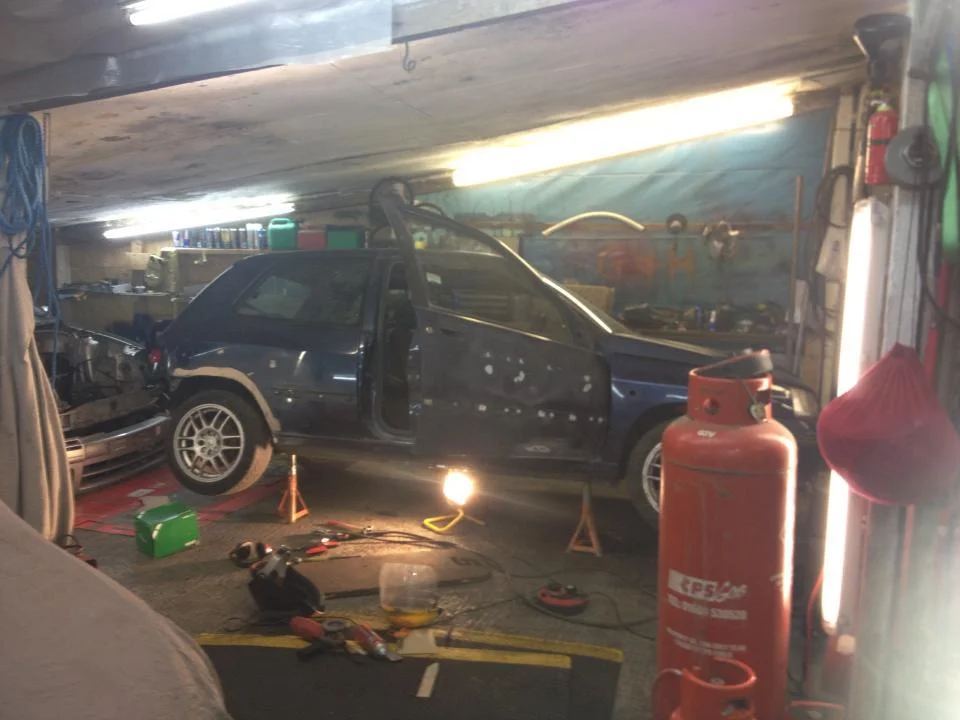

i started by completley stripping the exterior and removing and treating all rust, behind the front wings was quite bad but all have been welded up and primed to stop any water ingress.

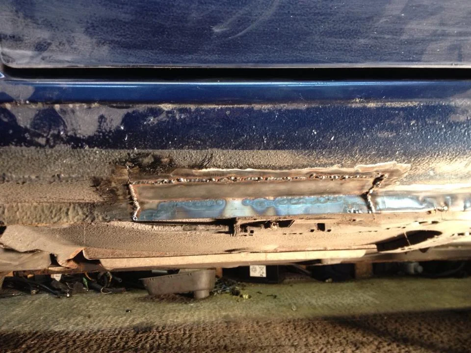

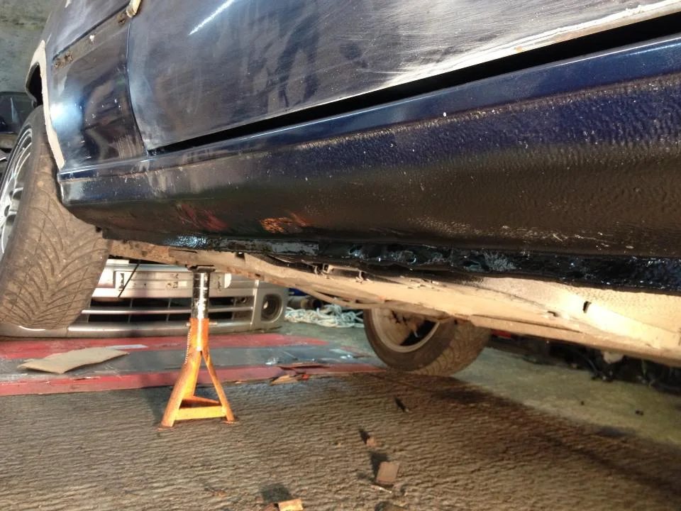

when i jacked it up and the jack disapeered into the cill i realised it may be a bit rotten
so while i was away the elfs went to work on the cill thanks to jamesb so when i retured to the unit the cill had been repaired welded and undersealed, as had the big hole in the boot.

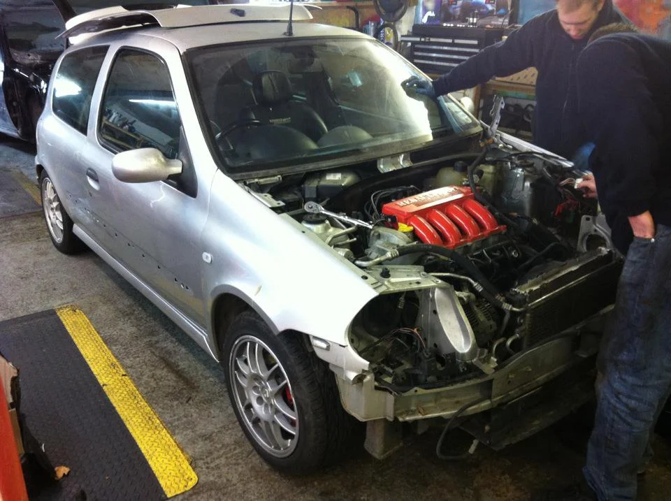

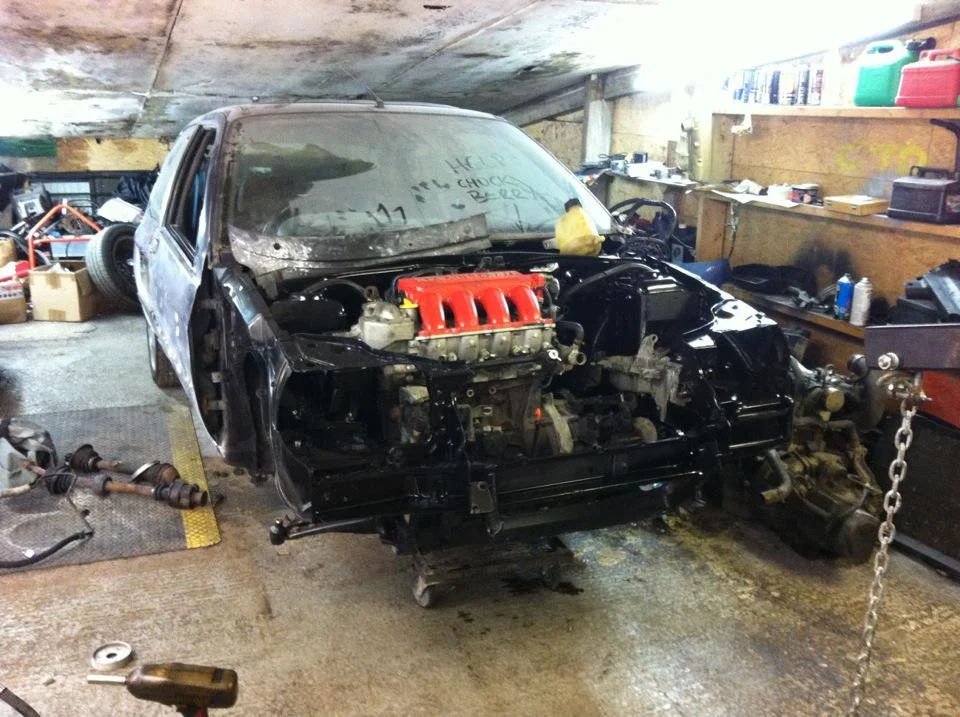

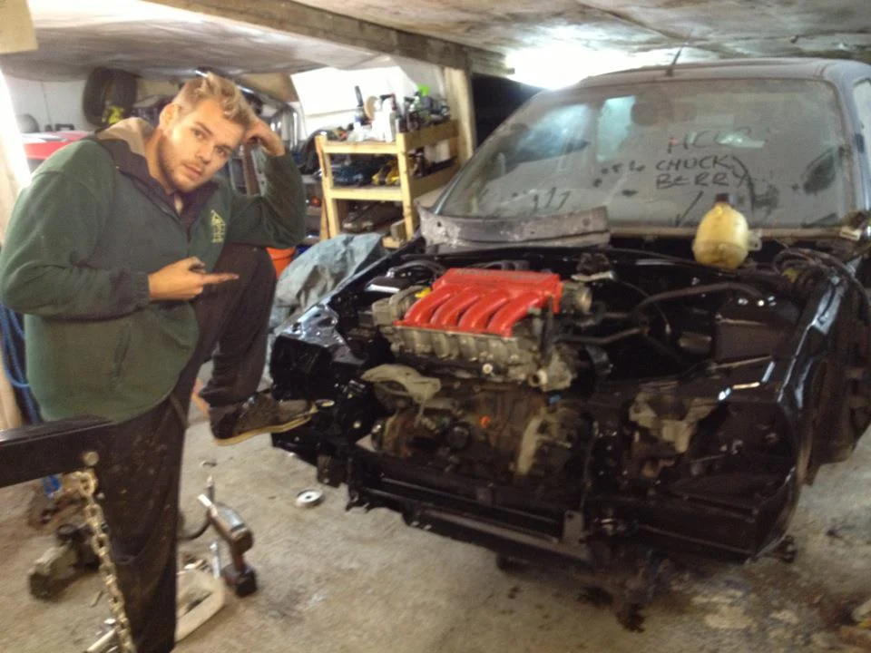

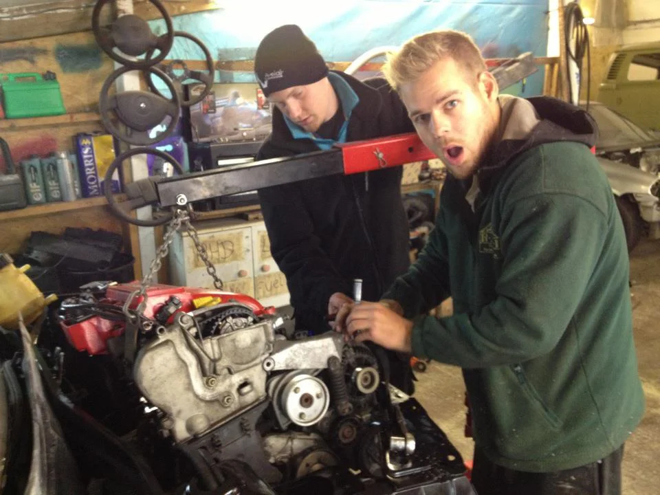

the trial fitting was goin well and i had the engine out and at 12oclock at night we decided to see if it was going to fit,
getting carried away i tried putting it in with all the aircon and alternator still on which is not recomended .
after removing all this while the engine was in the air it bolted straight in with no modifications apart from gearbox mount (thanks to dannyr for this information)

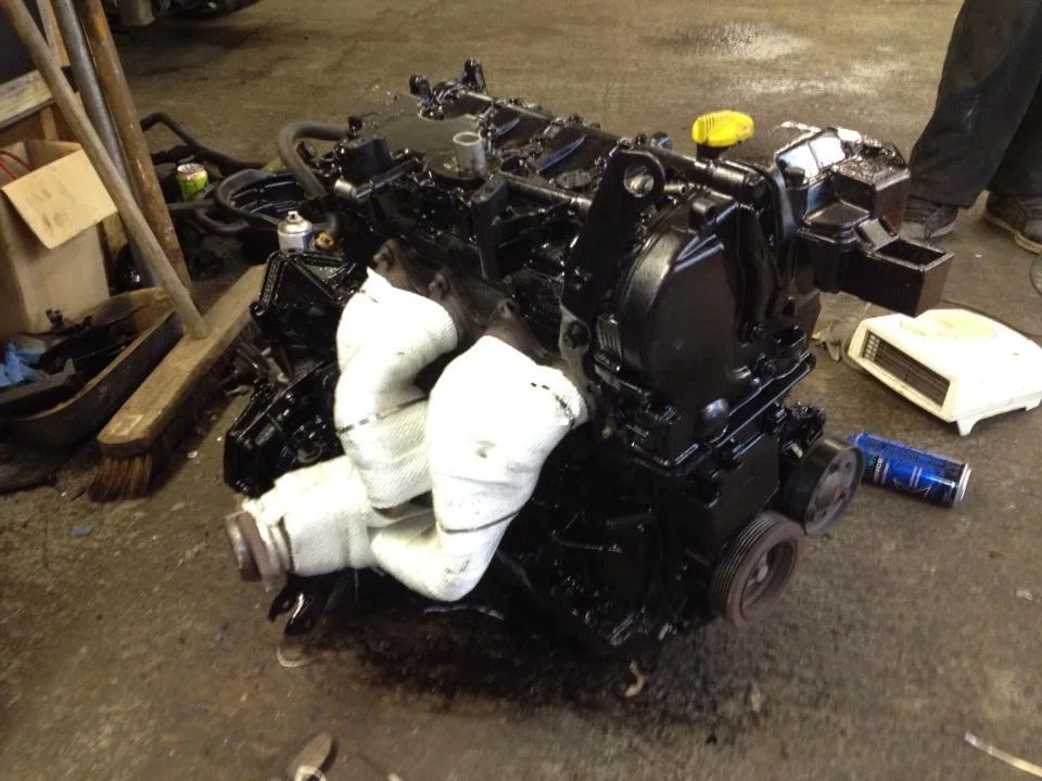

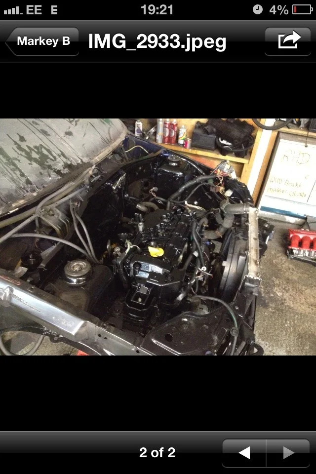

engine was back out for cleaning and painting which is not my favorite past time,
so after a full nights work the engine was finally ready for final fitting and the dreaded wireing

bad image i no but you get the idea this was the 5th night of work and the easy bit was done engine was all in mounts all on,
and found a brand new polyflex dogmound on the donor which was a bonus....... wireing time!!

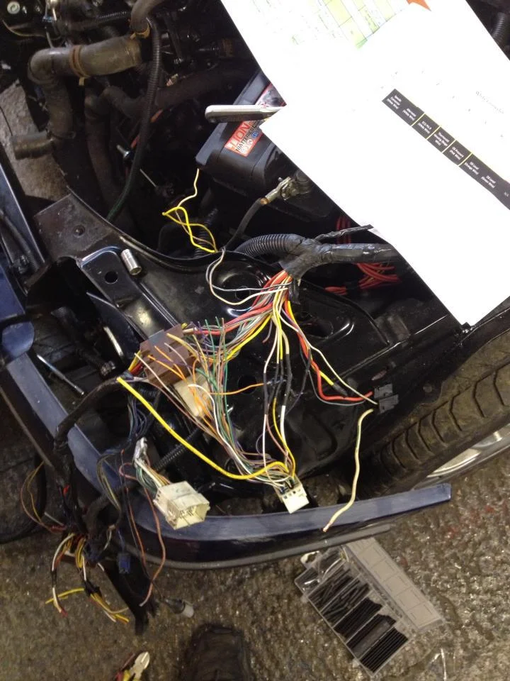

well i took a step back and let my good friend mark butterworth founder of the ctd club in suffolk take over on the wireing,
all the wireing was done in one nights work, i used 172 dash clocks and engine ecu, wired into the original valver car loom. unlocked 172 ecu and emulator chip.
after wireing was complete it wouldnt start, we tested all the solder joints, leads all were sparking and couldnt understand why it wouldnt fire, until the father in law came down to the unit one day and suggested a sollution to this problem............................................F.U.E.L
yes i forgot about an important aspect of the internal combustion engine, it had no fuel,
after getting over this brain teaser of a problem it fired first time!

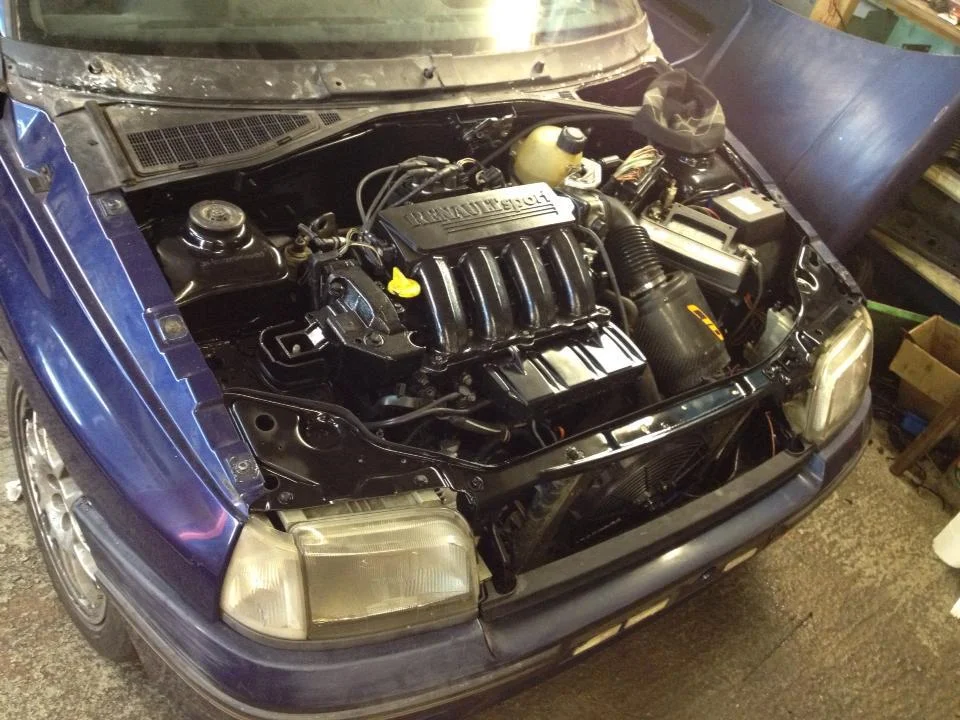

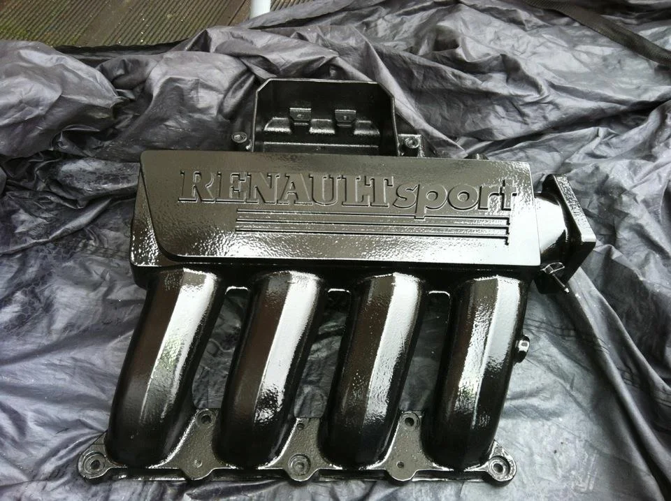

thanks to dannyr a friend of mine and a well known member on here i got hold of a pair of matched inlet manifolds,
after a quick clean and a lick of gloss black they were ready to go on
engine bay was pretty much complete and just needed a cup alternator set up and alternator

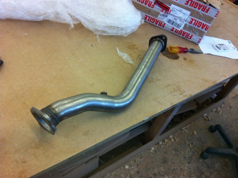

ktec ph1 172 decat arrived, so with a little hard work i had to drop the subframe and take most of the skin of my hands to fit this but it works!!!

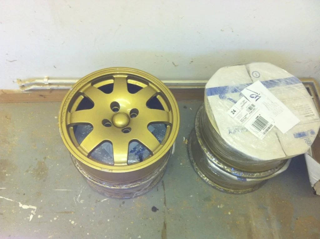

wheels arived, a rare find on ebay, these wheels were in good condition but good it not good enough for me,
they cost me a mere £160 with center caps
so as they had a decent paint job on them.... i sent them to the shot blaster lol
underneath the paint they were mint no dents cracks or repairs.
as we speak they are being painted by the brother in law but will not fit these untill last thing after the car has been painted

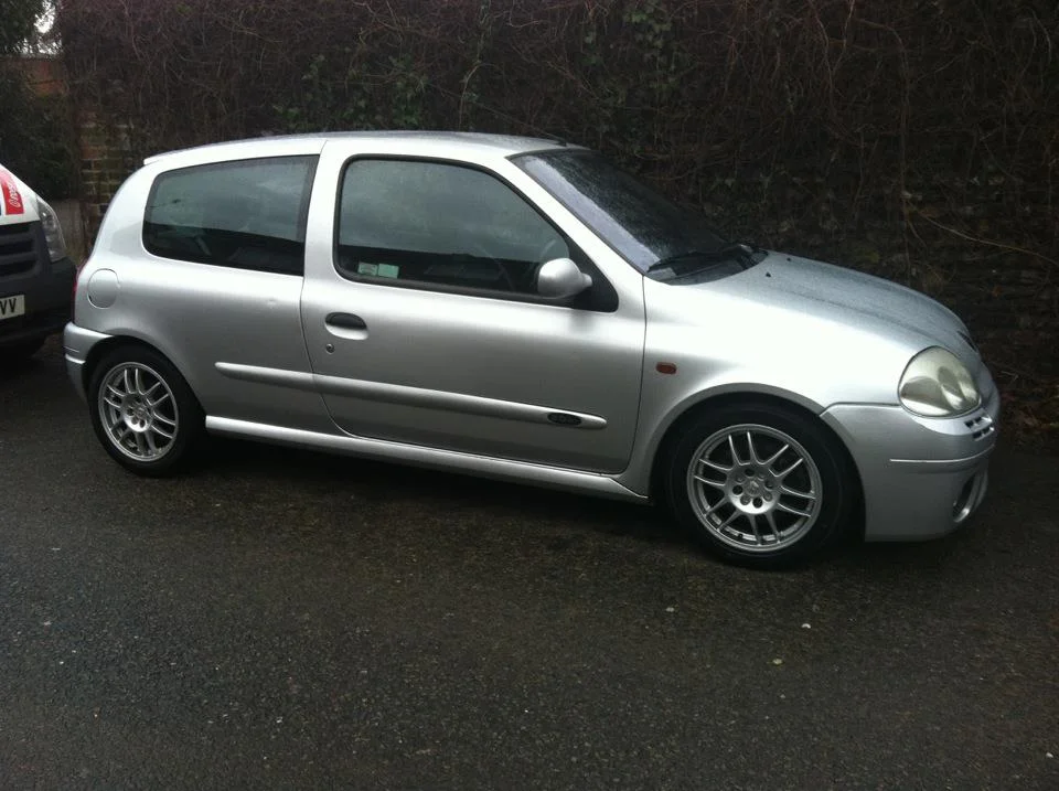

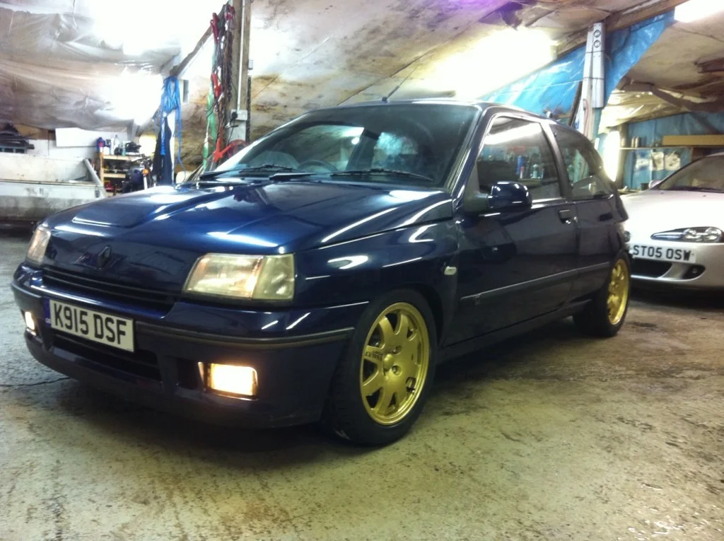

as im on hold over xmas and in the filling and sanding stage of the shell, plus dannyr is rubbing his gleaming new ph2 in my face, i thought id take delivery of a new daily sensible driver lol
so as with all dailys you just have to leave them standard.....
and then i was left home alone with my computer......
oops... yes so i spent a small bit on the standard daily
and yes i no ktec coilovers are not great but this is car is not meant to be a performance track car

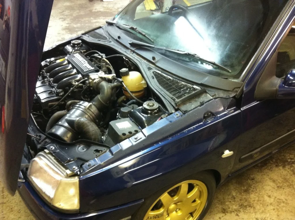

Exhaust was done yesterday full power flow custom system with 172 decat, 57mm all the way through with Center silencer and back box with 21/2 inch rolled tip,
Fairly loud may have to add something else when it's road worthy but it will do for now,

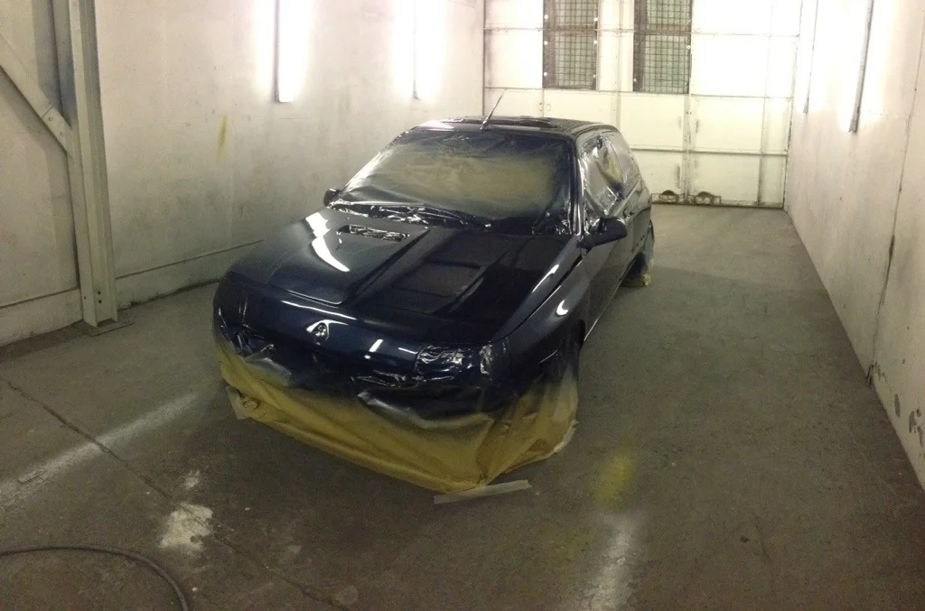

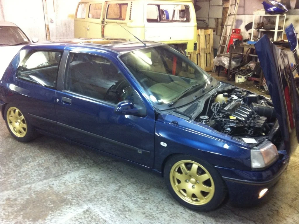

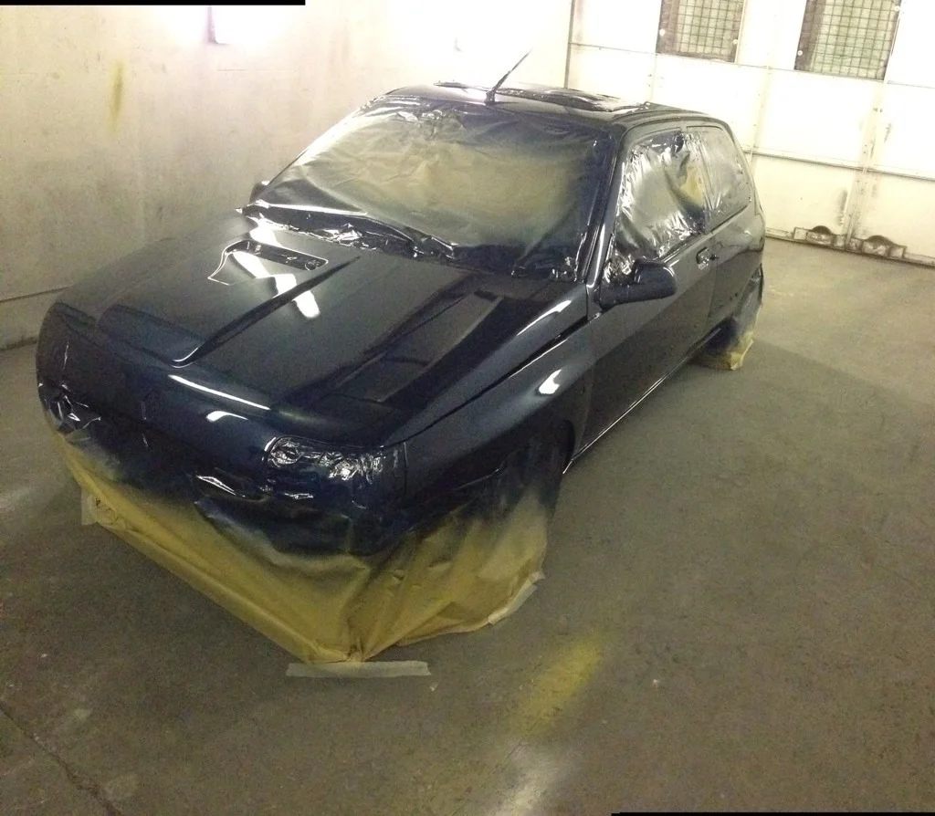

So all painted today after along wait tomorrow will be flatting and polishing by s.w detailing a local detailed in suffolk that provides an a* serviceImageUploadedByTapatalk1368899370.677555.jpgImageUploadedByTapatalk1368899389.034836.jpg
